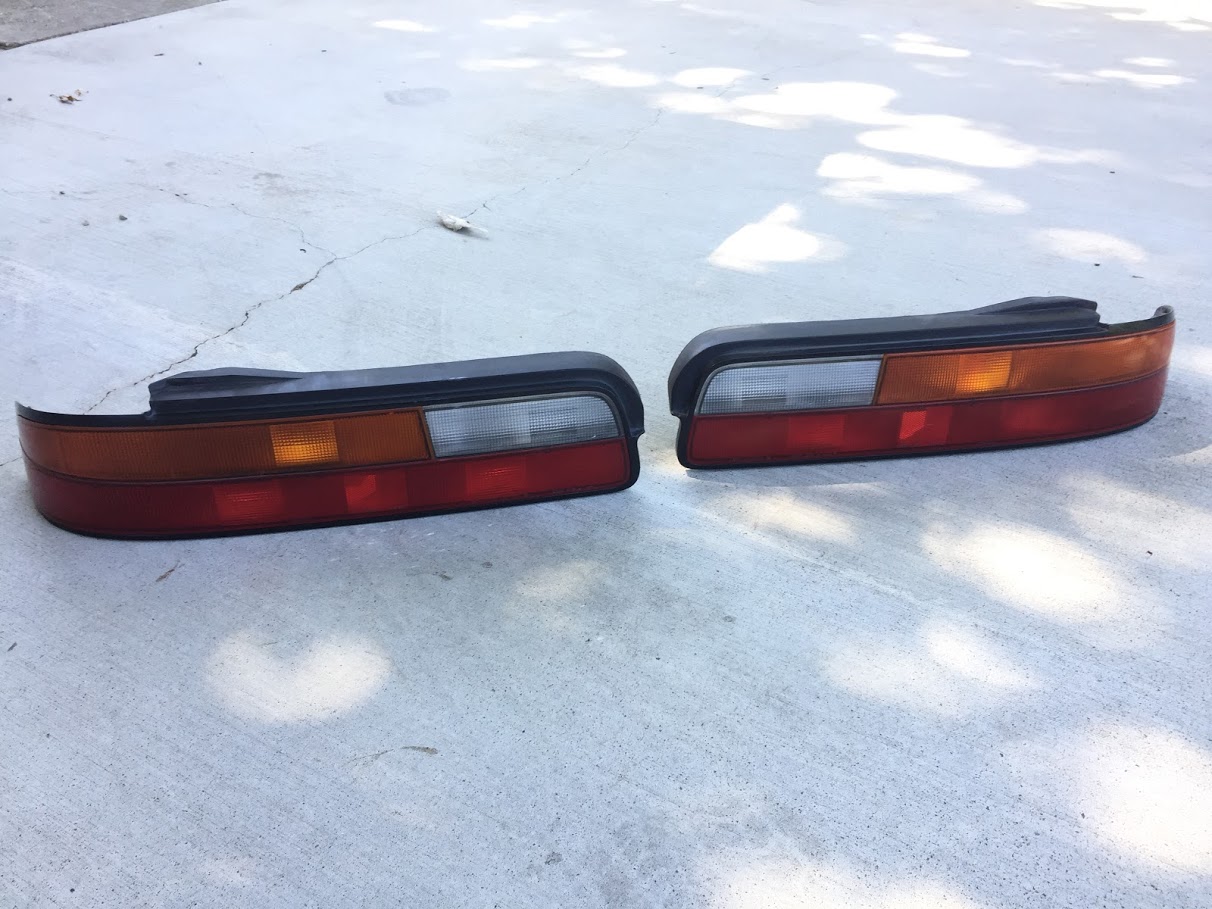

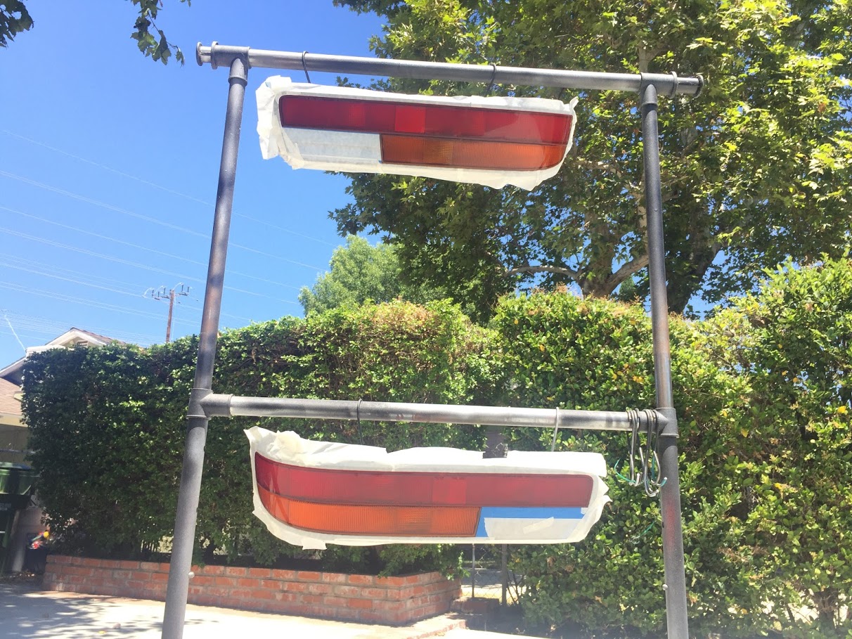

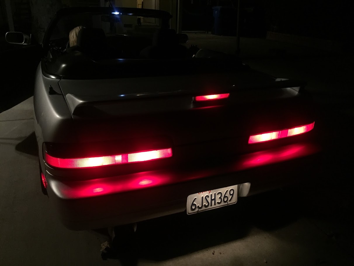

Some small updates on exterior

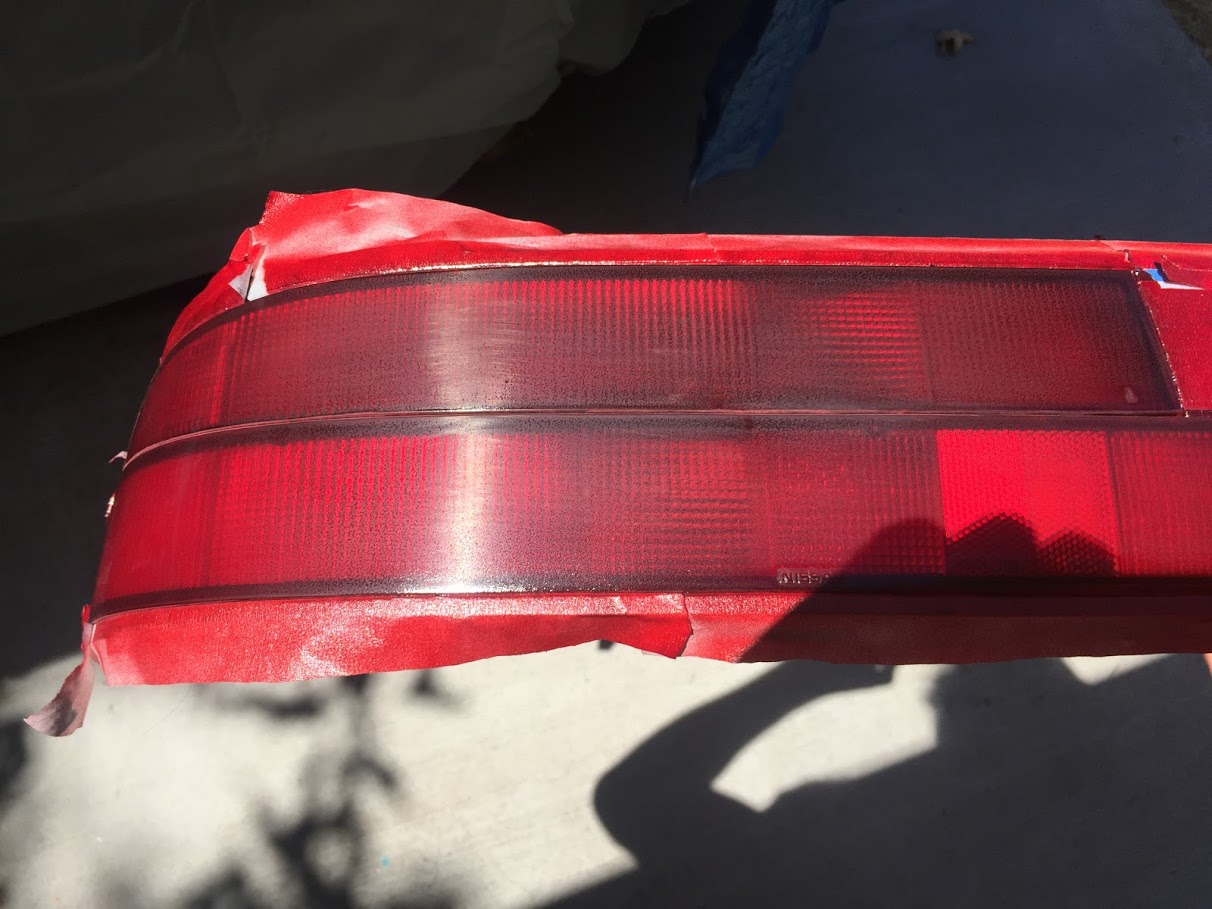

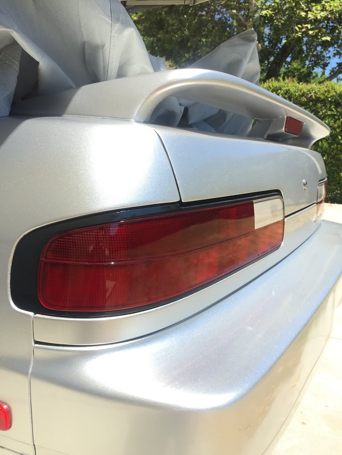

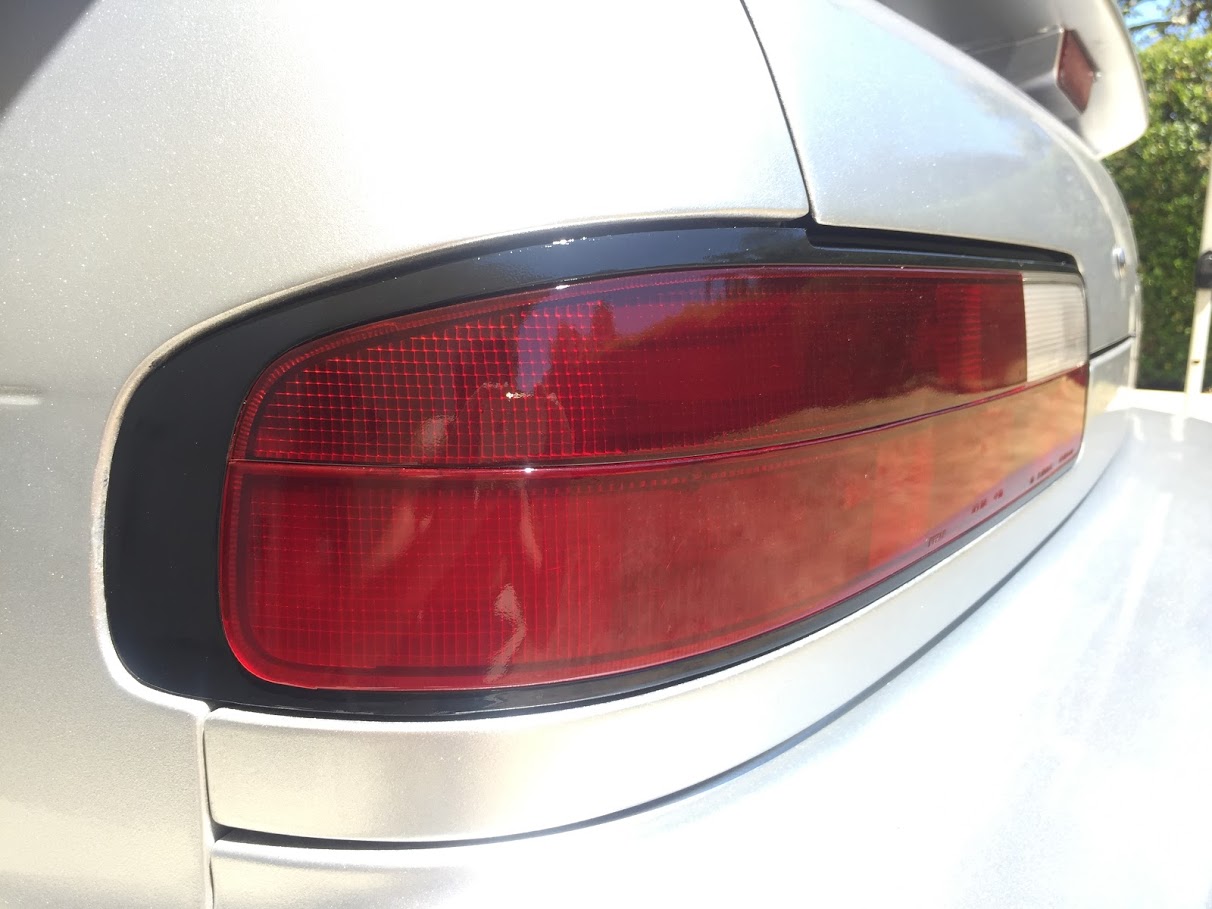

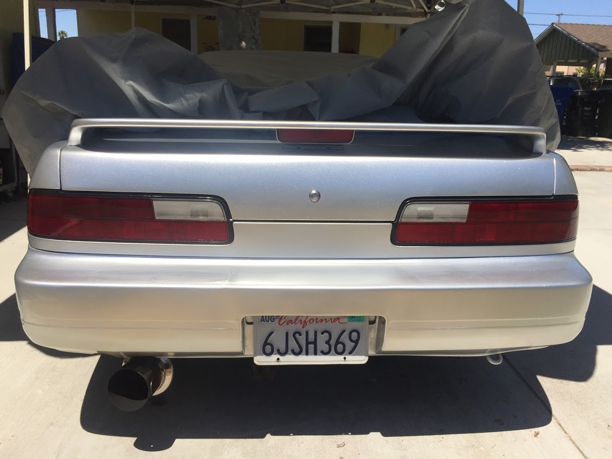

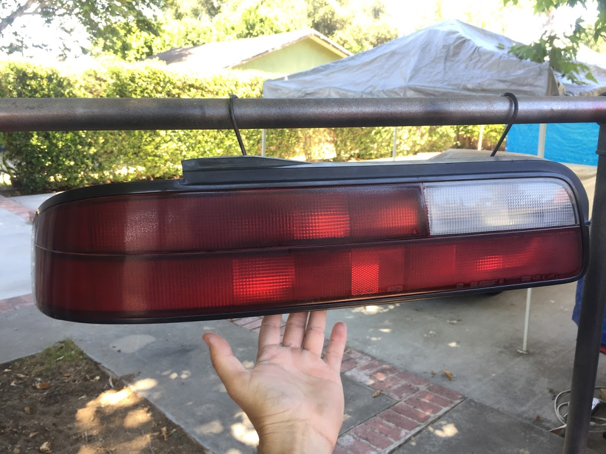

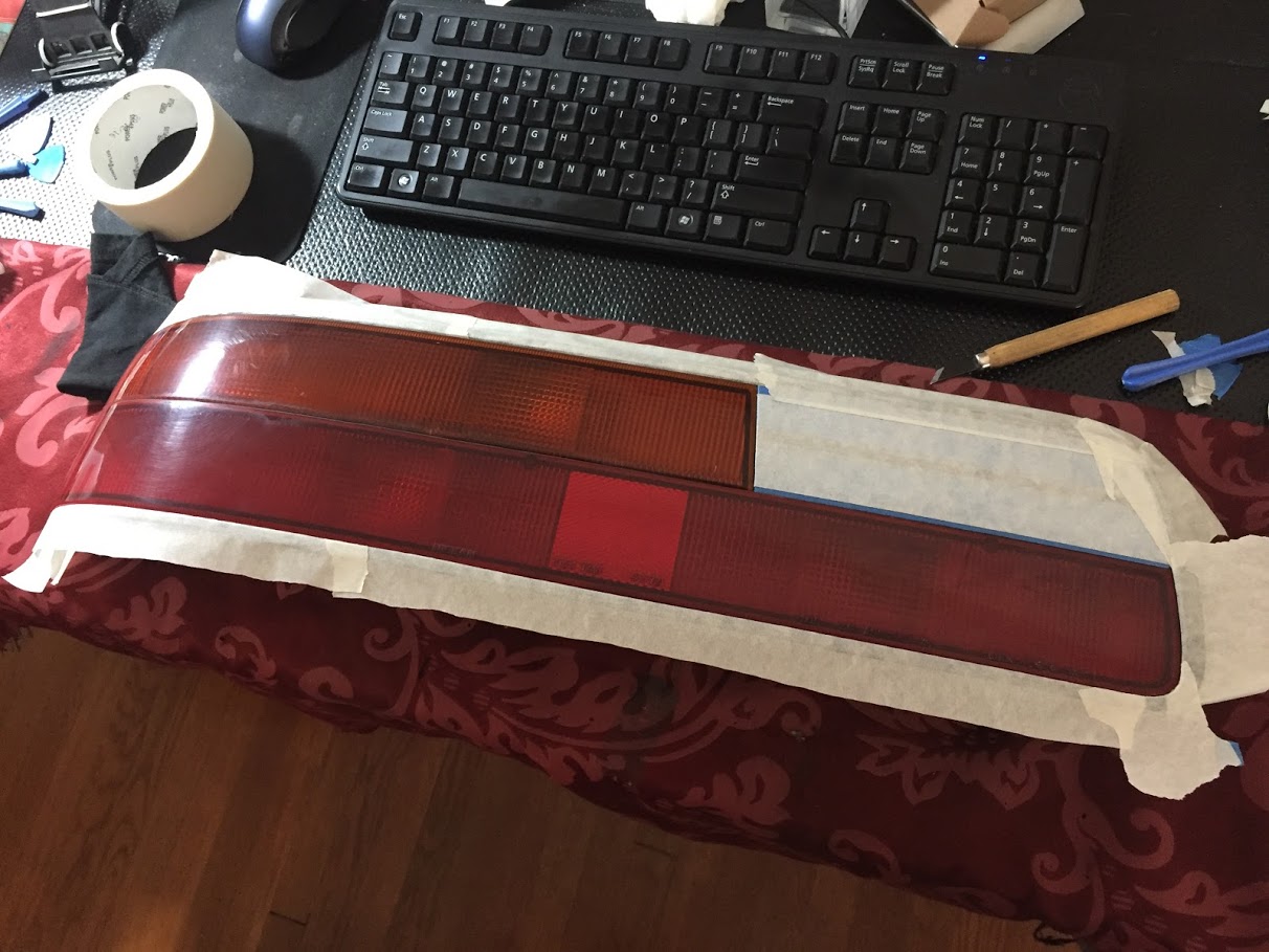

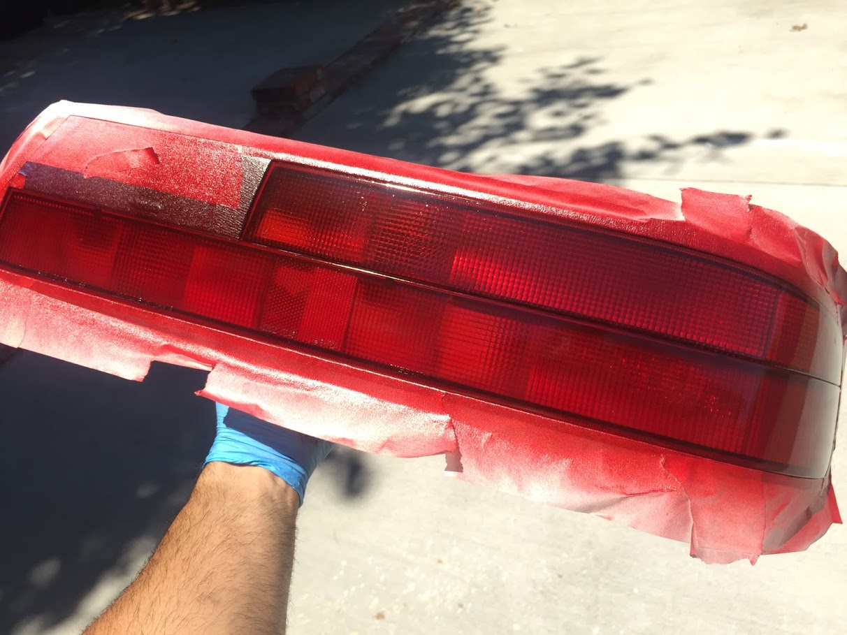

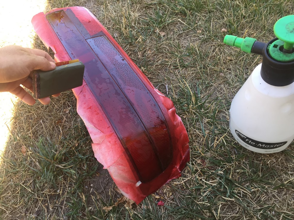

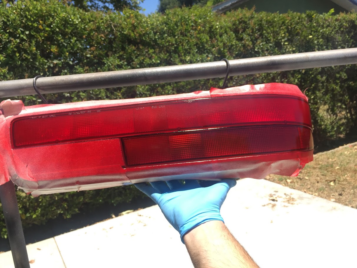

I had D-Max smoked tail lights and it was an excuse for cops to stop me, so i found some OEM for $20 bucks and the idea is have them all red Masking ready to paint VHT Nite shade in red will do the job After paint them They look awesome i wet sand them to remove some orange peel before clear coat them u dont need to do this but i was bored enough ready to paint Finished and installed! Light is even and brighter! |

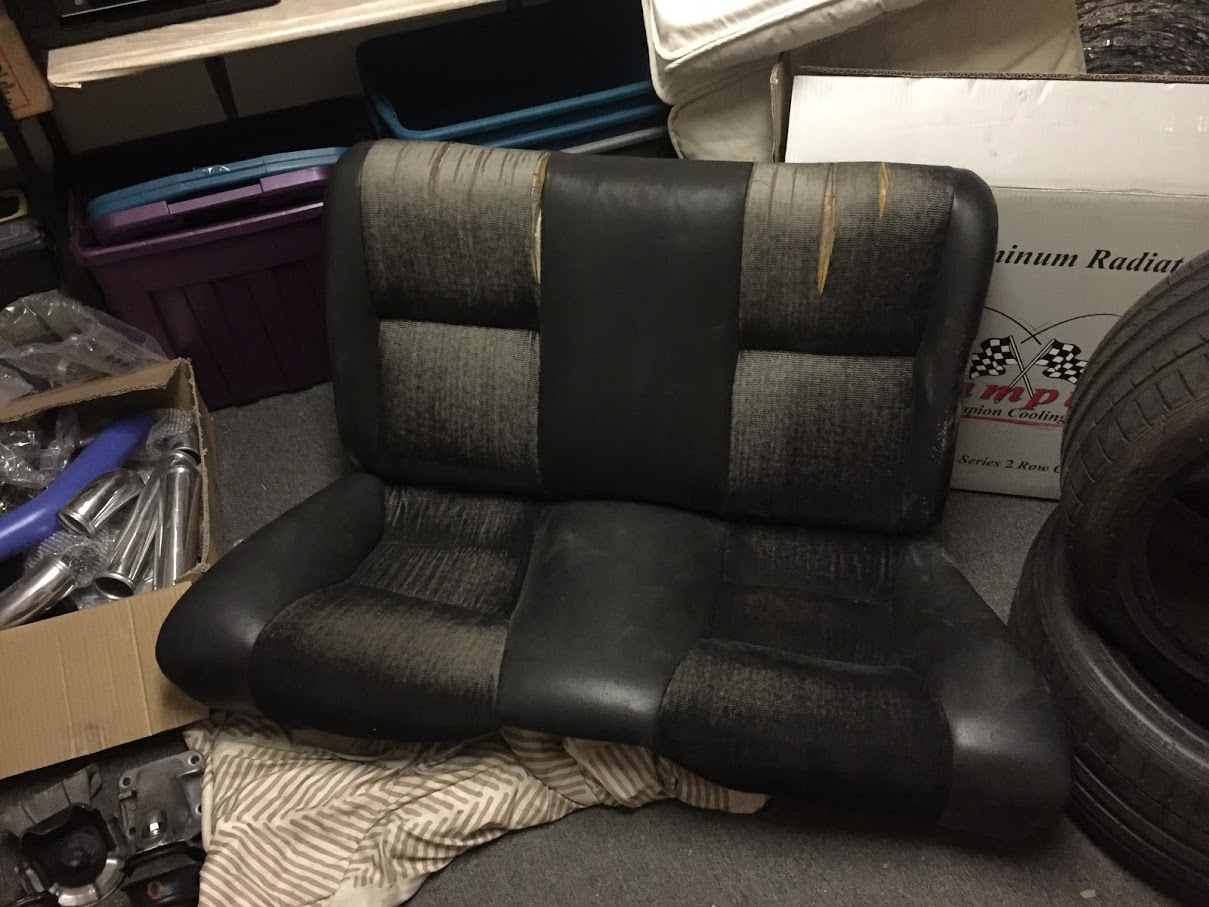

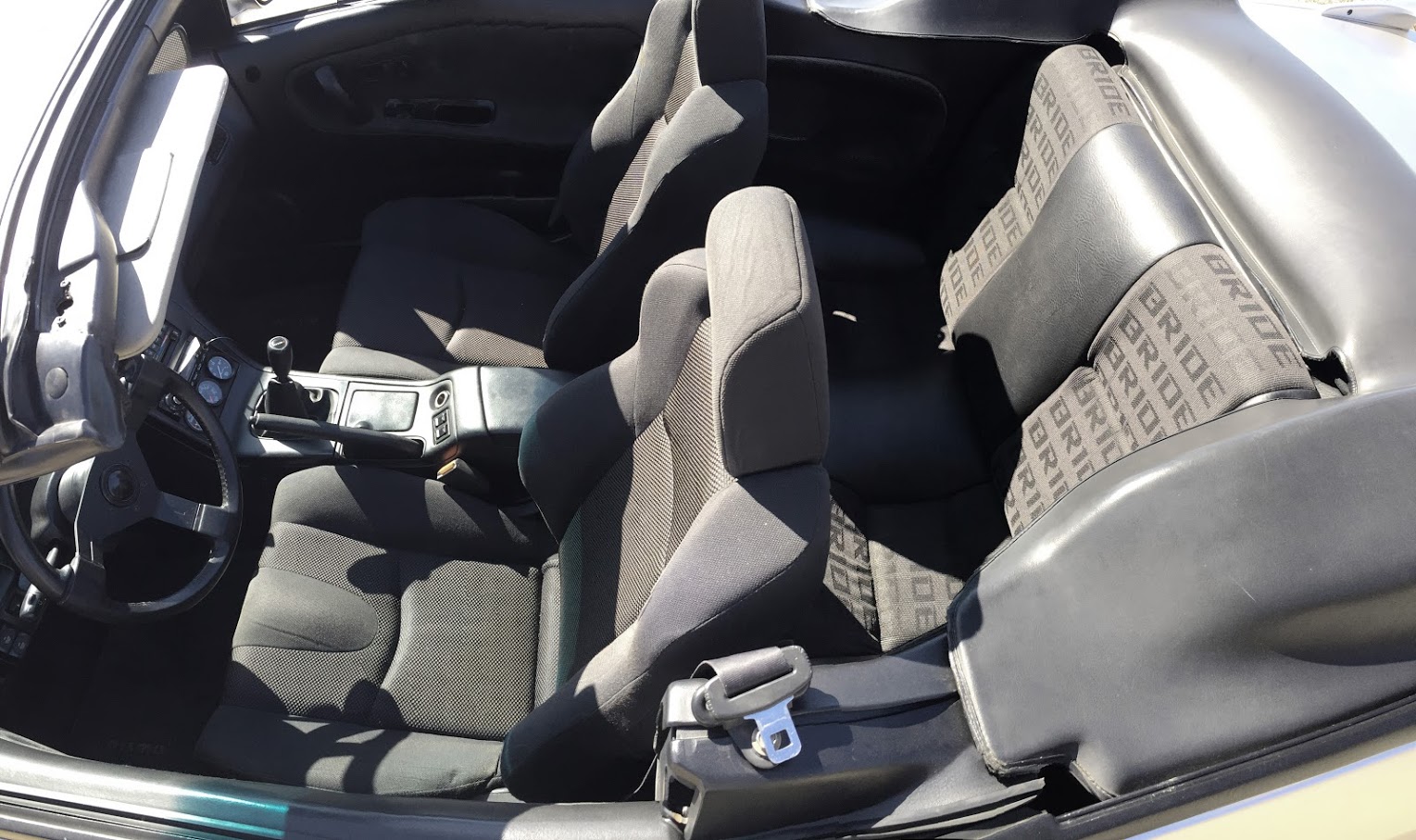

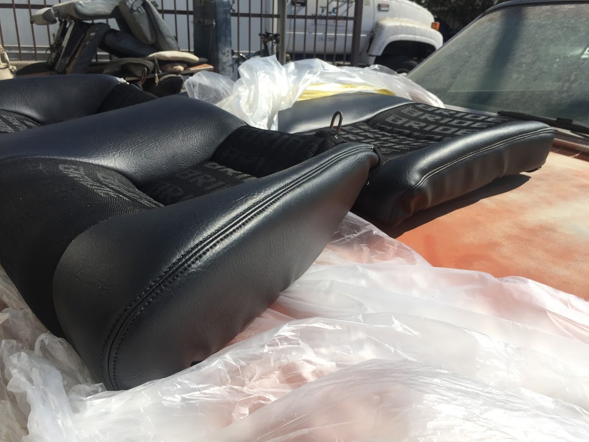

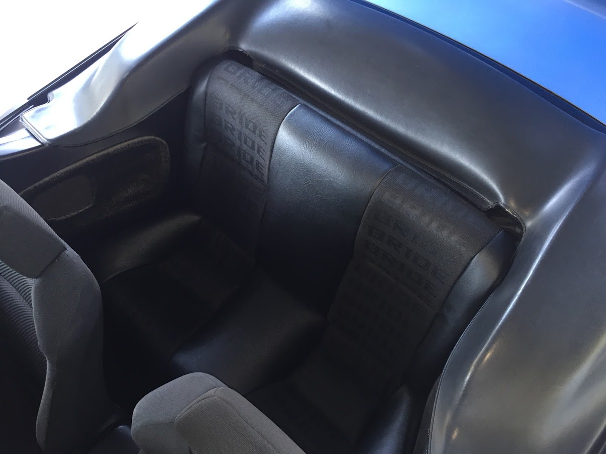

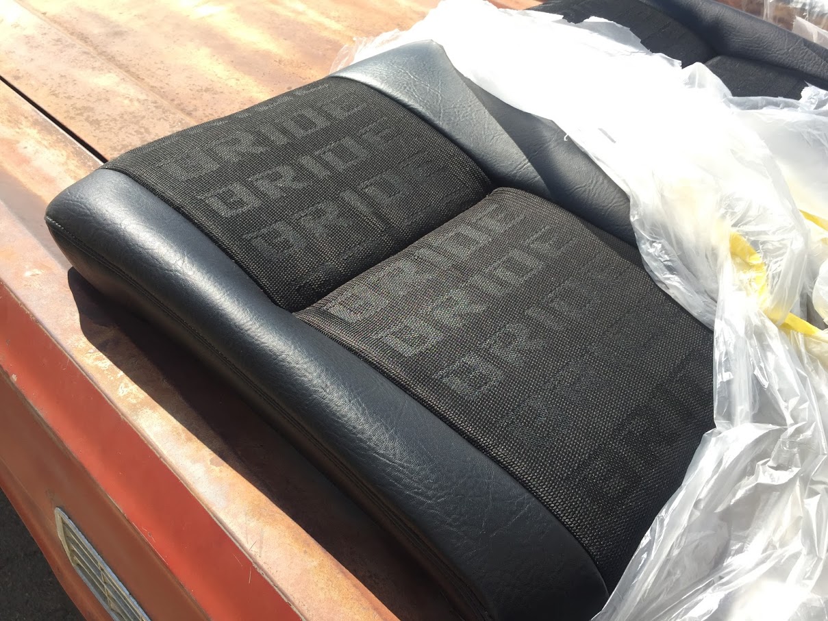

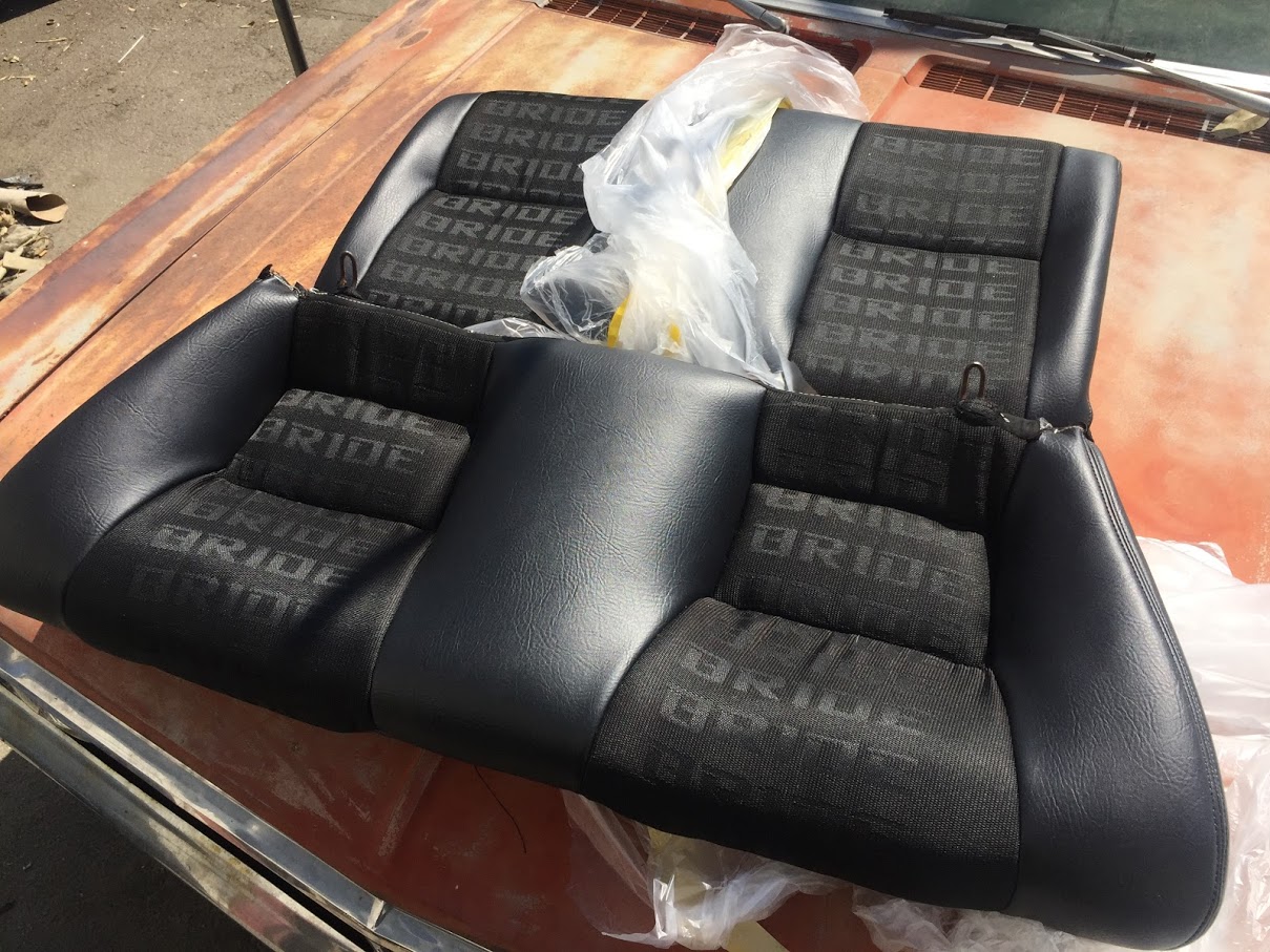

Rear windows regulator sliding clip... Original were blown so windows moves like crazy i found these on eBay from BMW for $3 so lets make them fit doing some cutting to make them fit making the hole bigger and Voila! now it moves straight, no play anymore! ------------------------------------------------------------------------ My rear seats were $hit since day one i never care about but ended up being the worst looking part of the car so.. i bought some 'Bride' fabric off eBay for $33 bucks to wrap the seats And... finally i found a deal on a real steering wheel and got rid of the NRG Nardi Personal - model: i still can't find any info about it |
