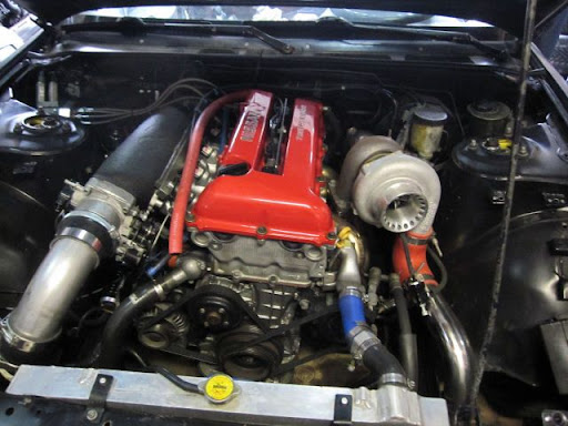

That engine bay is pretty awesome. Diggin the color, but its screamin for an ISIS turbo manifold or something other than stock.

I actually plan on going tubular with MAZWORX when I get that GT2871R up to snuff and snag an external wastegate and such.

build looks good but wtf happened with those tubs??

What do you mean, what happened to them? They're wider than what people run so it has a little notch in it. They aren't the small ass trailer tubs people hack up and use - fully custom.

Looks awesome, For the time being you could sand down and try to either polish that exhaust manifold or repaint it with some black hightemp paint.

Nah take it to a machine shop ans they can wire brush the ports and throw it in a tumbler.
I had mine cleaned for $20 then painted with VHT paint.
Paints been holding great so far (2 months). Just follow the instructions on t he can, Primer it and bake it.

How much clearance do you have between the hotpipe and tub? it looks pretty close.

I have decent clearance, and I may coat it. I have a couple things I want to do before I worry about the ONLY eyesore in the engine bay especially knowing I will be going tubular in the very near future. Going to basic in February is going to be a damper on the work for a couple months, but when I come back, the build will continue and will continue STRONG; ARMY STRONG.

looks pretty - but working in the engine bay with those tubs is gonna suck. I love how tubs look... I just dont like the confined space. I think my turbo would def hit the tubs in your car.
For reference - mazworx manifold / billet 6262sp
I'm thinking you might wanna stay bottom mount with the lack of space.

The point for wide tubs is to get the best possible angling I can without smashing into my OEM wells while being able to run a decent sized tire in the front. As for top mount, it was test fitted and will fit with about 2 inches to spare. I will most likely stay bottom mount, though. The tubs are only a little wider than the widest part of the strut tower - the reason they look huge is because the strut towers aren't straight up and go up at an angle, so it looks like they're massive. Also, when you hit full lock, with the angle of the tire, I want them to be able to clear as well. It's all for a purpose.

The reason people are giving you shit about your tubs is because they ARE overkill. There's no way they allow anymore steering angle than "hacked up trailer tubs", because you're limited in THAT extreme of an angle with the rear of the tower. All in all I like your engine bay... it looks really nice with the purple, I just figured I would let you in on why the criticism. And they ARE going to make working on the engine a bitch.

That purple looks awesome...i love where this thread is going. Those tubs are intense though.

I'm in love with the color of your engine bay.

It's absolutley gorgeous, when do we get to see the body painted?

Color of the engine bay made me re-read through this topic. Those huge ass pics are almost as big as your tubs, but that's cool. Hope it all works out.
