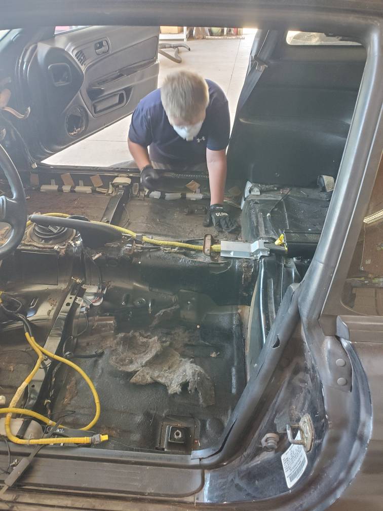

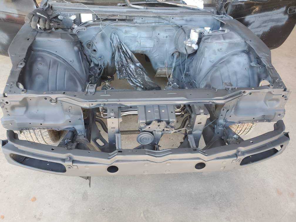

My son who is 13 years old has wanted a S14 since he was 8 years old. Well we started 3 weeks ago with the purchase of the car. We have all the surface rust sanded and prepped. After doing research of the power plants.
We landed on the eco. We are not building a drift car, but a daily driver that will do auto-x events and hallett events. He will get his race license and run spec 4s at Hallett next year. We have a shop that is doing the build and completed eco swaps on other cars. My son and I just left the race shop and the guy then came to ours. He has accepted the build. It will go to him in November. Since he is a ford performance guy and we are building this for my son. He also has a son at 11. He threw out an idea, which was something that I was going to ask about. He wants me to buy a full wrecked mustang. That way we can use the full ecu, while taking the abs system, trac control and stability. He is also going to try to make the my key system to work as well. If it doesn't he is just going to dyno tune a detuned tune for driving around. I will post pics later as they are too big to upload and I am too tired after working on his car today. We cut out the battery tray out today as this is where we are most likely going to mount the electric power steering pump. Anyone have a wrecked s550 mustang 2.3l with a 10 speed This is the guy that is doing the running gear and helping us with any questions. https://www.optimabatteries.com/en-u...s-championship Djetok is online now Add to Djetok's Reputation Report Post |

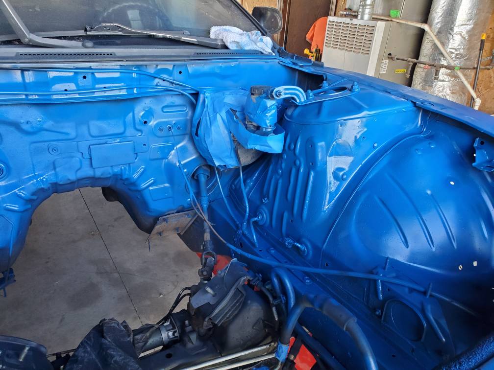

I would have covered the bay in a rust preventative rather than spray bomb it. It's going to be a pain to sand through that to get a nice coat of paint on it - especially if it's leaving shortly but that's in hindsight.
