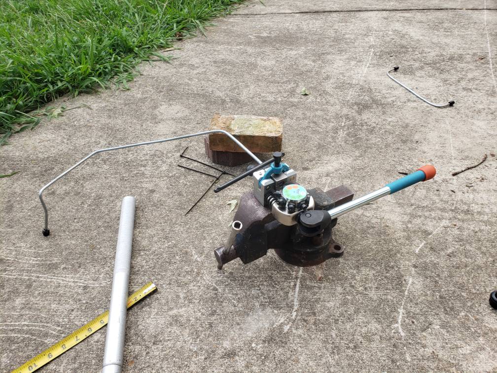

After speaking with tractuff I rerouted the wastegate cooling lines so that theres a greater pressure differential on them. Before I went from the oem oil cooler feed to the back of the head but now I'm running them basicly to the oil cooler feed and return. The k24 doesn't have oil cooler ports from the factory so the return is taped into the water pump housing. Due to the complexity of the lines and the area they would be running through I swapped them to metal lines along with the turbo feed line. I also deleted the heater core for now as it's a high point in the system, the swirl pot will be the heater return and bypass feed. This combined with a filler port inline on The top rad hose has greatly aided in the ability to bleed the cooling system but it's still not prefect. I havent tried to drive it yet cause it was late but Tuesday I will mostly see if all this pays off before my custom swirl pot comes in next week.

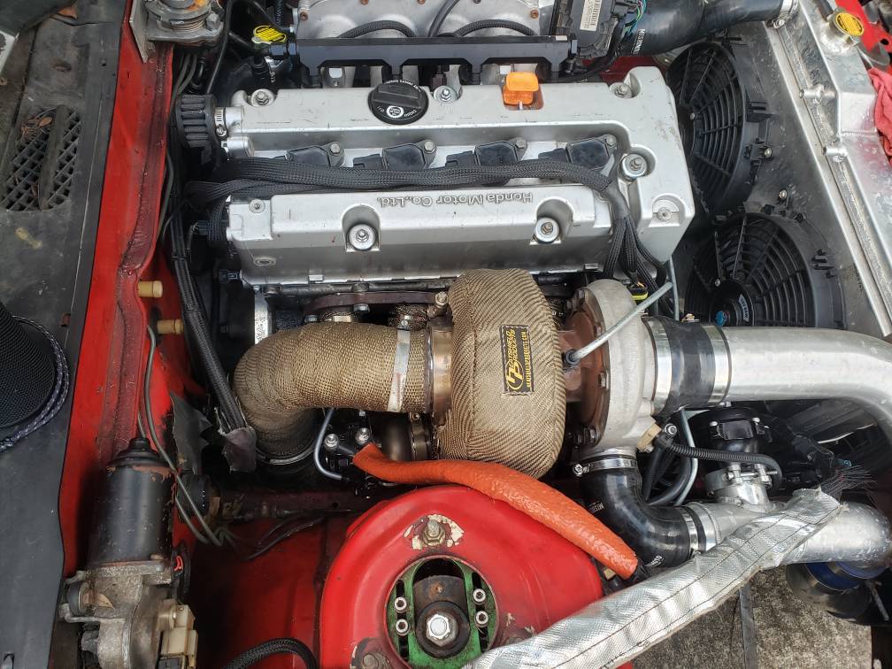

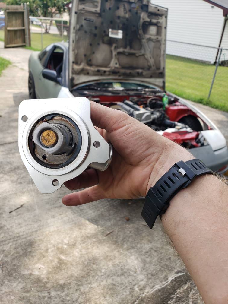

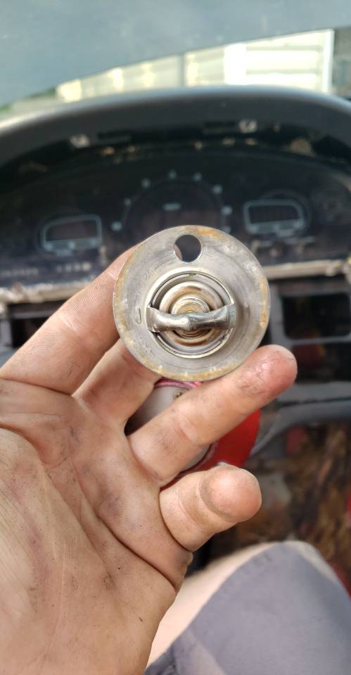

Found some more time to work yesterday. After reconfiguring the lines it still ran hot. So I turned my attend to the brand new tstat. For starters Ktuned install the tstat upside down. They must just plop it in the cause theres only about 90degrees of usable positions and in my position it was on the very bottom.
I took it out and ran it. Engine bleed what seemed to be instantly and ran cool with the fans only cycling on for about 20 seconds every few mins to maintain below 195F.
After testing the tstat to confirm it opened. I drilled out the weep hole to 3/8. This was to help give it a fighting chance sense the Ktuned tstat housing does not restrict the bypass flow once warm like almost all OEM tstat housings. on of the things I think I've been fight this whole time is lack of head(pump pressure) to flow water threw the rad and it takes the easy route threw the bypass.
Filling it up with the tstat installed it seemed to bleed instantly again. I let it cycle twice with the cap off the took it for a drive. Around town it seemed fine hold temps 193-197 but once I got on the highway the cooling didnt want to keep up. After while of crusing at 70Mph at 3300rpm the temps settled at 205F. This hotter then I'd like but the system is functioning properly now as the tstat housing and CLT (at the start of the outlet hose) were always within a few degrees of each other except when the running the fan at idle. As the tstat temps would drop up to 10 below the CLT.
Got another week before the swirl pot comes in so I'm not gona try to bleed it any more till then but I'm content for now. I'm now comfortable driving it away from the garage. Although it still not happy with the temps at highway speed.

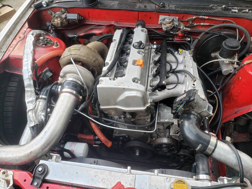

After some test driving the cooling setup got bleed to the point where i could cruise at 70mph @3300rpm and hold 185F CLT. Then swirl pot came in, fits perfectly and really cleans up the engine bay. I havent got it run that cool yet but i think its dependant on the weather. generally it crusises around 191-195F during the day and almost thermostat temp at night.
i also swaped out my the VLSD for a welded diff with the Skyline diff cover i picked up while i was in Japan awhile back.
now that temps are under control I've been talking with greaser about getting a tune soon. Driving this around is real fun and its tough not beating on it yet. I got the AFRs close and all functions are currently on except for EBC. on the highway its tough to keep this thing out of boost with how quick it wants to spool after 3000 rpm then VTEC kicks in hard at 4000 rpm (for now). it reminds me of driving the shark car with a stock RB25DET NEO except I'm in the low-mid 300hp range running only 6 PSI. cant wait see the tuner and put some timing back into this monster and enable boost control. heres a little tease with how soon the S257SX-E wants to spool.

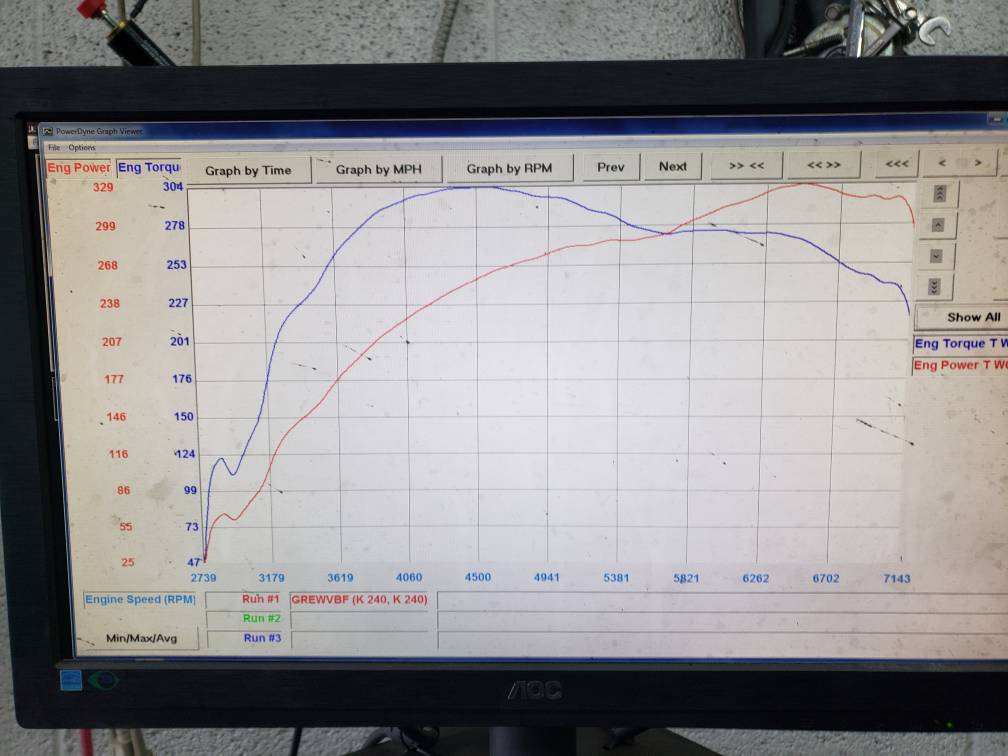

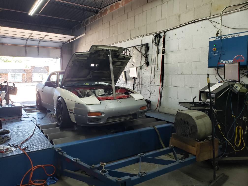

Here it is guys. 330whp and 305ftlbs on 12 psi on 93 octane. I'm a little disappointed in these numbers as I was expecting 400whp on 9psi as I've seen in couple dyno sheets but hopefully that will come with some tinkering. I need to figure out why the torque just starts to fall off after peak at 4500 rpm in not like a honda motor.
Got a couple things to play with to improve output as boost control wasnt setup to Increase spool yet. The 12 psi comes in alot later at 4000rpm then when the wastegates werent opening and hitting 14 psi around 3300rpm. It's also very rich on the street the dyno said 12afr, I need to look at the logs to see what my gauge was reading on the dyno, but I'm seeing AFR in the 10s on the street. Thinking about getting an adjustable exhaust cam gear to help with top end power.

Well MRD has a mustang dyno which reads lower than a dynojet. Don't know how much lower though.
there is nothing wrong with enjoying the build. however, we sometimes have to remind ourselves that the build is only one part of the puzzle, and that ultimately - enjoying and driving the car is the number one priority.

.....aaaaaand thats why I don't care for dynos for numbers sake.
Numbers mean next to nothing. Too many variables. For a tuning tool, absolutely great thing.
Does the car run good and feel strong? Thats what counts. If not, make changes.

^^ If a similar car on a similar dyno with similar conditions makes xxx amount more than yours, with that xxx amount being say 50-90 whp (and there are multiple cases of this considering how vast the Honda market is), then a number is good way to determine if there are any inherent issues with his particular setup. He is down some 70 WHP @ 3 psi MORE boost. That is not just up to conditions as that is a significant swing.
Blanket statement about "numbers" doesn't make sense in the grand scheme of things. Comparison and repeatability of results, do.

For all that work and effort in this swap, id be EXTREMELY disappointed. Im sure youll figure it out, maybe wastegate or boost leak issuse.

Looking things over there is some improvements that can be done to the tune that Imma work on myself. Something that I am starting to realize with a bit of research and messing around with Borg Warner's Match bot is that the 1.0 A/R turbine housing on my S257 is choking the motor as around 5500rpm engine delta pressure starts to go negative. I doubt I can fit a larger s363 or EFR8374 as it would probably hit the hood or valve cover. one thing I can do is get a 1.22 Twin scroll housing to help the top end breathe better and match bot shows it wont even hurt spool noticeably till I try to max out the turbo on E85
Yes these dynos read low but is a large expectation difference. The setup feels like my old 14 psi KA-T with more power between 2000-3000rpm and I'm making the same power (same dyno) as my buddy with his SR20 on 16psi, but I'm making close to double the torque . Looking over other k24a2 STOCK BLOCK dyno charts I see some motors havea flat torque curve and there's others where the torque cruve only drops maybe 10% between peak and redline. Meanwhile I'm lossing about a 1/3 of my torque. I believe the turbine housing is choking it but I do need to play with EBC as its not a perfect 12 psi it fluctuates about a psi.
Here's what I was hoping for I believe this is with a 6262 or a T04z on 9psi in an automatic TSX

Low to Mid range is strong AF, top end feels lacking.

I feel like something else is wrong, Thats a pretty good size hotside..

I'm slowly cleaning up the tune I got it was done kinda quick.... once I finish expanding the fuel tables back up for the 3 axis "intake cam angle". Then get the VE tables within .02 lambda and review the to see where peak EFF. is at every MAPxRPMxCAM cell. I can use that data build a cam angle table to keep the engine in peak VE throughout the fuel map for top performance. Once all that is done I can come back to hopefully just get the Ignition tables tuned up and safe and ill be making more power. ill have to review a before and after of a few things tho before i warrant another trip to the dyno.
One thing I have noticed after leaving the dyno is AFR on the street was in a the 9.5-11 WOT, very rich which could rob some power. The injector duty cycle at peak is 62% (1035cc) which is almost 400whp of fuel being put into the engine. the big thing i think it will come down to is cam angle timing. Due to the fact the tuner collapsed the 3 axis and used a single map for a 50degree sweep of cam advance for fuel and ignition i find it hard to believe it was running optimally at each cam angle. Comparing the dyno tune to a K20 base map i used there was about 10-20 dregees of timing adv. pulled after peak torque comparing the 2. Also the Hondata K24A2 I/H/E and 7 psi supercharged base tunes has more cam adv up top then the dyno tune.

I'm just gonna accept these results for now. After alot of reading this just seems to be the norm. Soon imma try out e85 maxing out the id1000s. After this underway coming up I may fork out the 400$ for a k20z3 head and get that top end power I'm looking for.

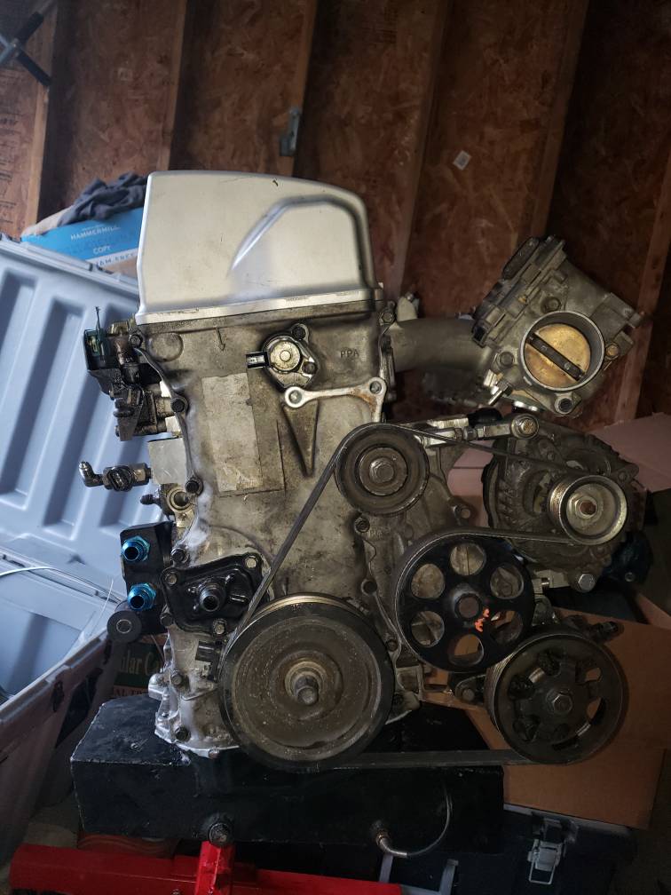

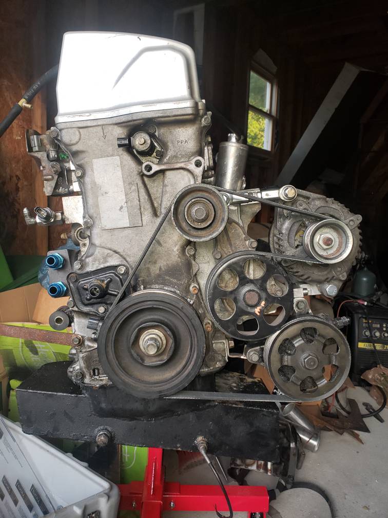

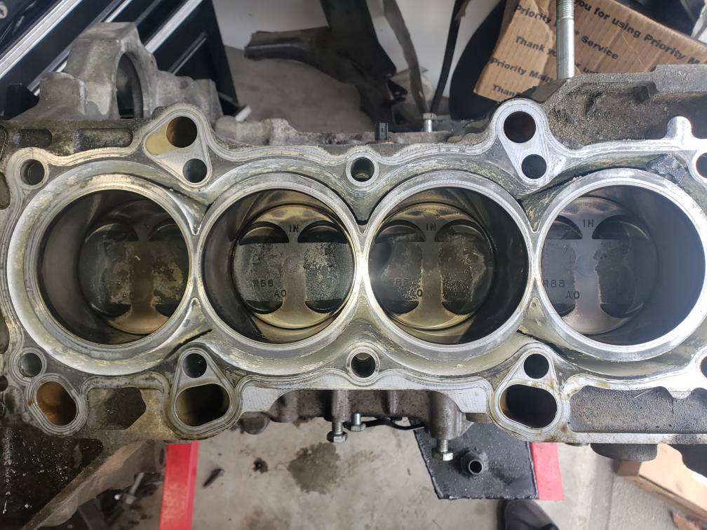

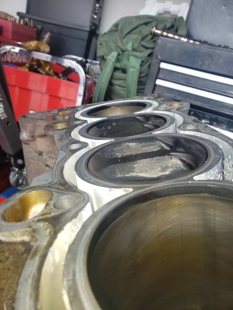

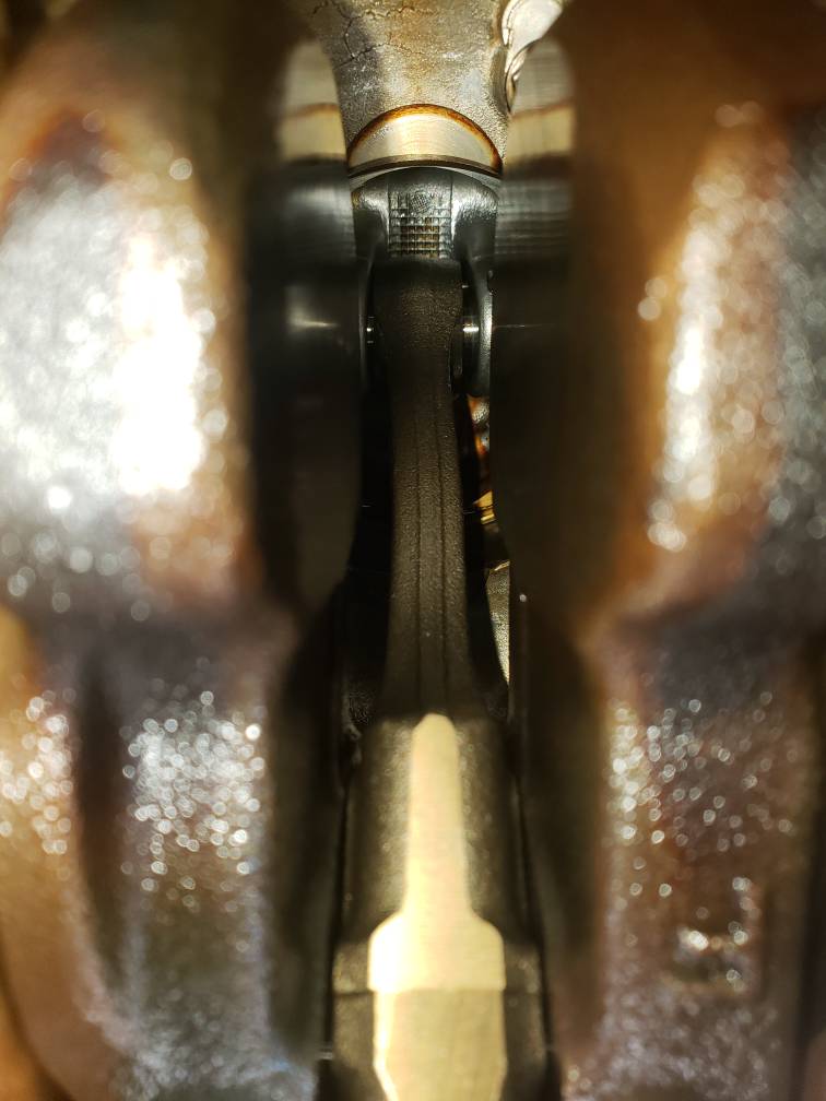

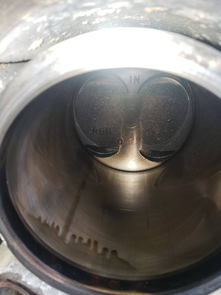

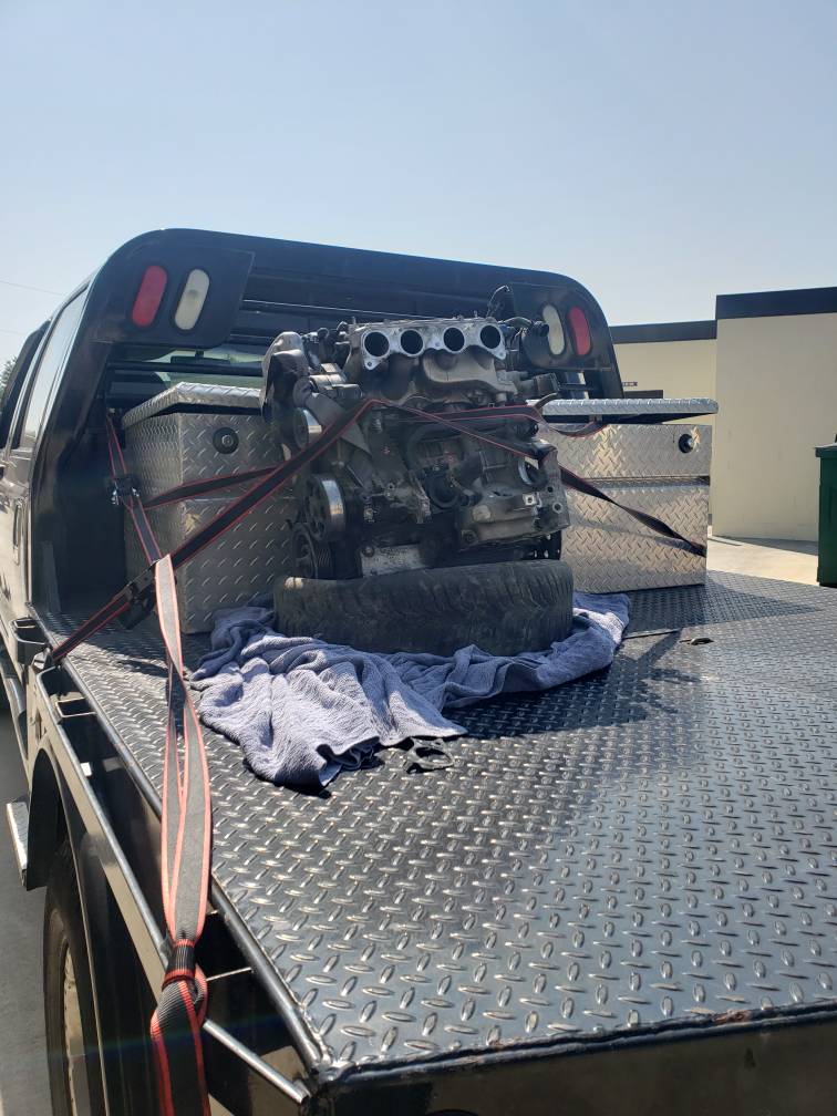

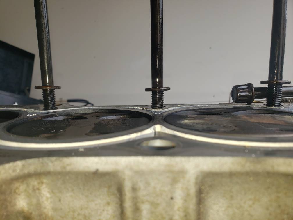

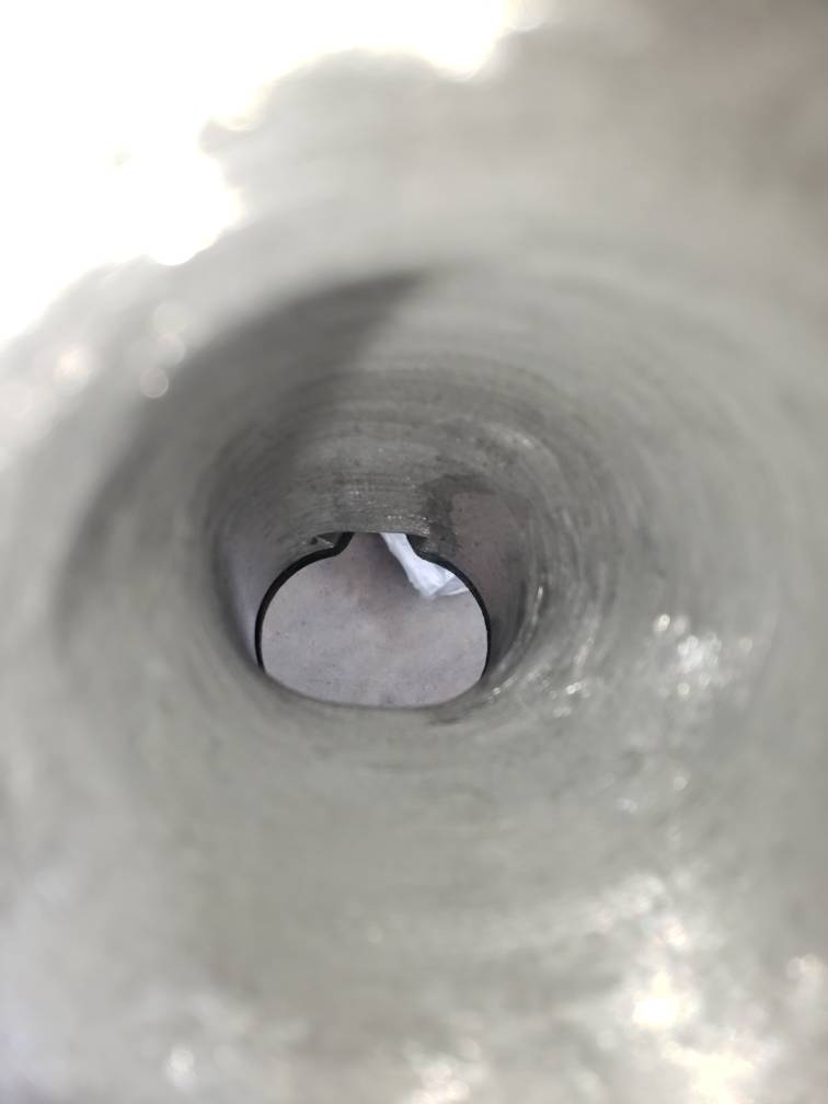

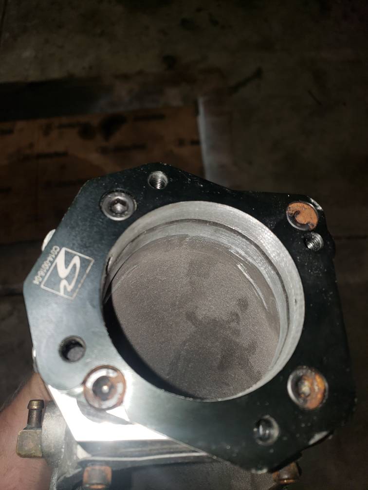

Good news and bad news. Good new is got another motor for 700$. Bad news is I found the torque limit of the factory rods at 350-375ftlbs and it started knocking.
Over the last week I've been pulling the motor and working on my new alternator and PS pump relocation. Today I finally started tearing down the knocking motor.
After pulling the windage tray I could see rod 3 with a very slight S curve in it. The motor still turns over by hand freely but there was a slight tick at TDC.

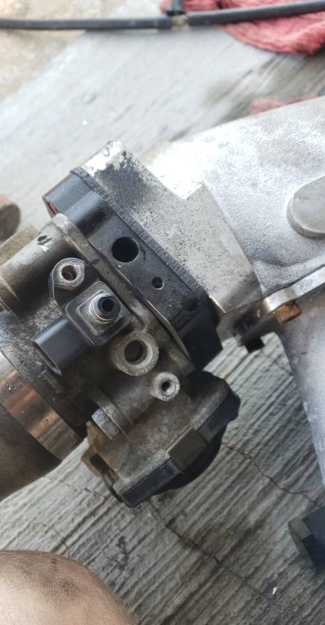

While I've been tearing it down I've noticed a few other things. First off I found a vac/boost leak with a 2nd map port that never saw before on my TB adapter. I use nether as I'm running haltech built in map sensor. It's getting plugged and I'm moving my BOV vac source to the map port on my j35 TB after taping it for 1/8npt. And my Watergate will now get reference from the compressor housing, hopefully this will help with boost control wanting to initially spike and help me get traction in 1st by lowering base boost by about 1psi. 1/8npt.
Next came making a prototype bracket for my new belt setup that allows for easier tensioning and removal of the alternator with out removing the intake. Prior to this the TB was actually laying on the top bolt of the alternator. This involved hand machining 3/4x1 1/4 AL bar stock and welding a few pieces for the idler pulley and ps pump lower bracket. Soon I have a buddy of mine mill a billet version along with an actual bushing for the idler not a m10 bolt welded to a m8 bolt... picture of my TIG welding jig for that

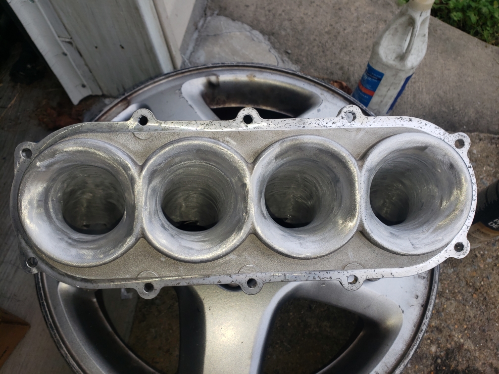

I've always used thermal gaskets on my intake especially if they come with the intake manifold but the Skunk 2 one that came with my intake didnt match the port correctly nor did the throttle body adapter gasket. So I matched them to the port while lightly polishing the intake to help with top end power.
I got a little more instore for this but I'm outa time as i have to go to sea for a brief underway. Wont be a long wait tho before I have it running agian.

New motor is in and waiting tranny fluid to put in after work today. I think I know why my old motor firstly was lacking power and second why I only bent cyl 3s rod. When installing the intake gasket which i opened up to the size of the S2 ultra intake i noticed that the center ports lined up nicely but 1 and for were offset by a few mm to the side. This is probably because the intake was designed for a k20 not a k24 which have slightly different ports. Out of all the port cyl3 had the best alignments of ports so it was the most airflow and the leanest.
After pulling the head it's clear that only cyl3 bent a rod and the motor is still buildable. Hell I could probably just toss a rod in it and send it. I have yet to pull that piston to see its condition tho. There is one scratch on the right side of the picture the barely catches the tip of a knife. This motor will be save to be built. Which at a minimum will be getting rods, pistons and porting of the head. Maybe I'll even toss a k20z3 head and port it out.
Negative delta pressure or exhaust manifold absolute pressure (emap) is really common on engines with smaller turbos. This doesn't mean the engine is "choking", just that there is a lot of drive pressure. You can get the turbo to hold the same boost if you adjust the boost controllers duty cycle or run stiffer wastegate springs. It's just the price you pay for response. You could move up to the 1.15 or 1.22, or even 1.27, but you will lose response with the bigger housings. To put it in perspective, on a two liter 4G63 this turbo in the 1.22 housing doesn't reach full boost till almost 5000rpm, and that's with stiffer wastegate springs and an excellent tune.
I'd keep working with the tune and the boost controller before I changed out hardware.

Thank you I need to do some updating as I've been driving around on the new motor and have it mostly retuned just gota redo EBC as I move the refference to the compressor. Maybe this weekend I'll do an update.
But the main thing I think is the issuse is port misalignment with the k20 intake and k24 head. I did some cleaning up of the gasket and light porting of the intake but to get the right transition I would need to gasket match the head. Basically all of my intake gaskets overlapped the porrs by a few mm. Even the TB thermal gasket (came with the intake) was smaller bore then the TB adapter and intake by about a 3/8" in dia.
