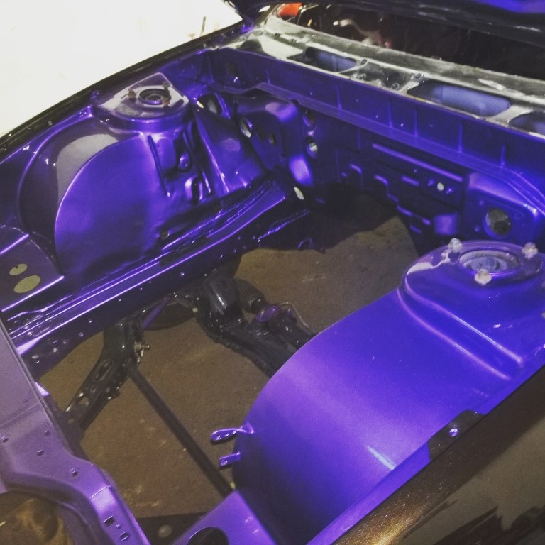

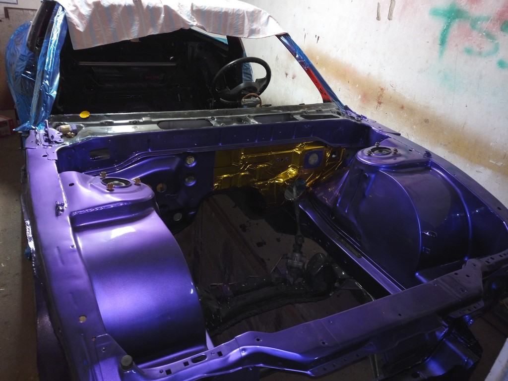

Thanks for the support guys. I dont like to shoot the whole car without the suspension and wheels, so be patient
But today I take the pic of the enginebay

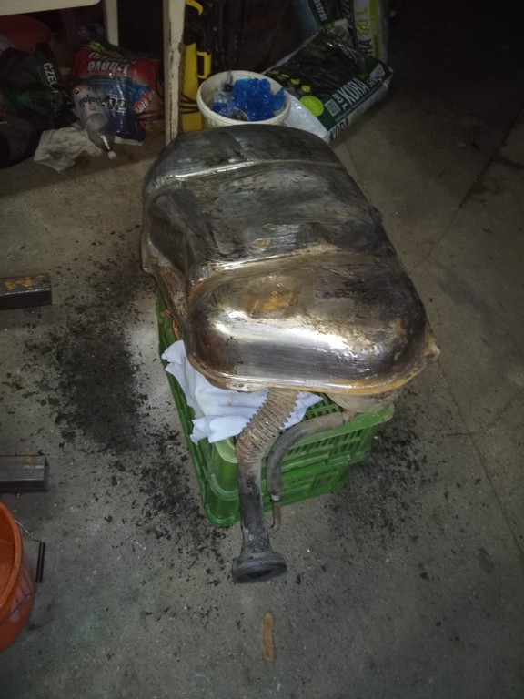

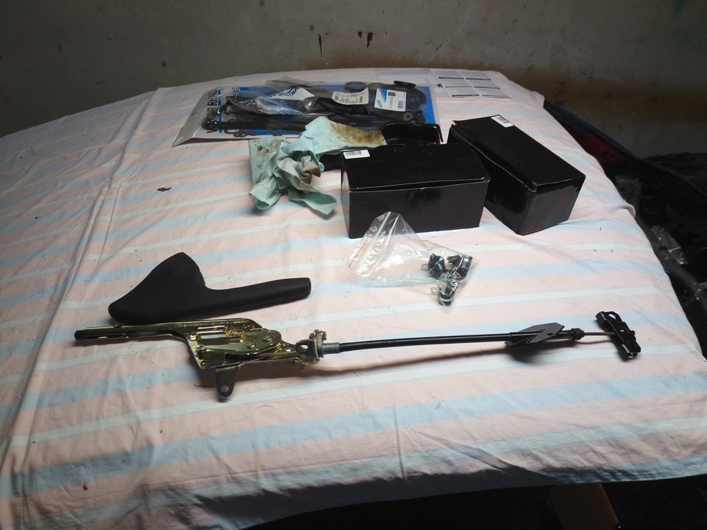

Thanks for the support guys, I can't wait, when I can going to first cruise with this but I have lot of things to do before.

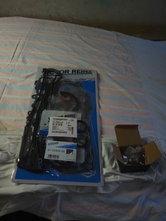

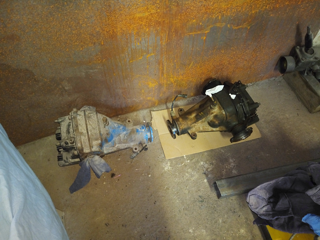

I bought the another VLSD with outputshafts

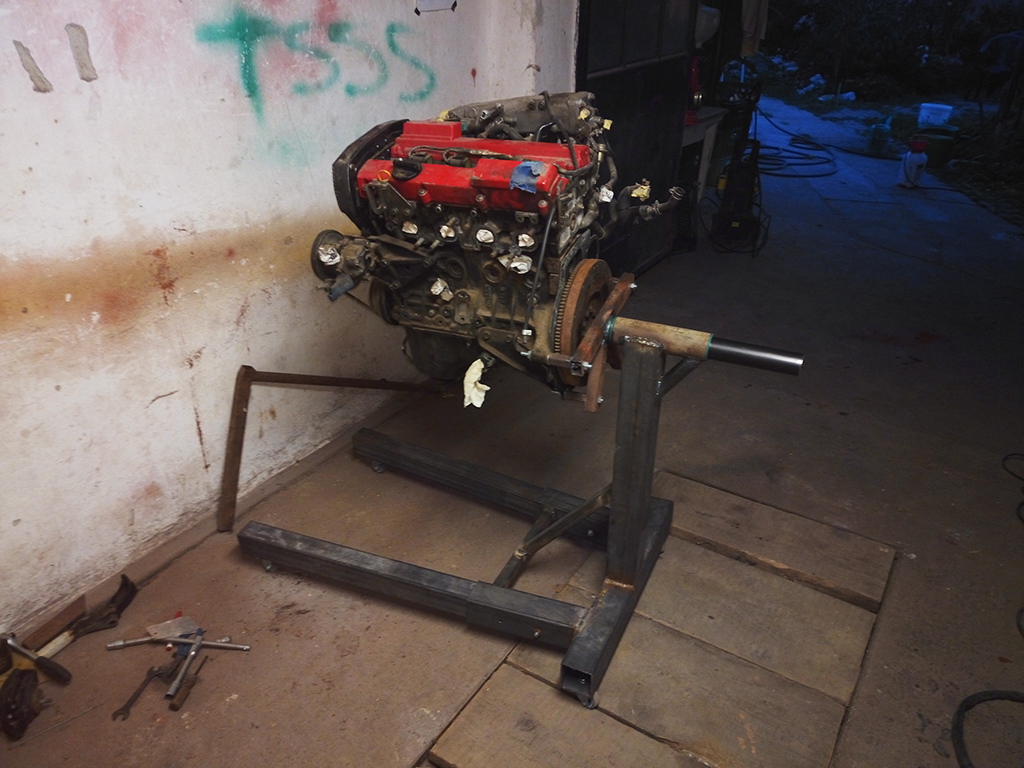

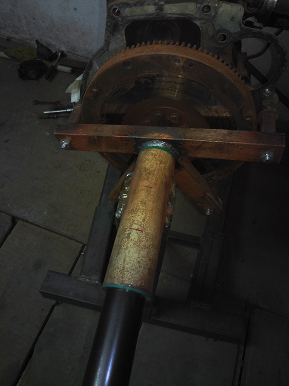

When car was in painthsop, I welded the engine stand for the CA
wirh 3D printed bushings
victor reinz gasket set

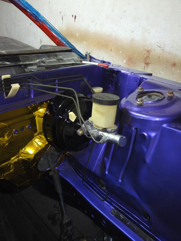

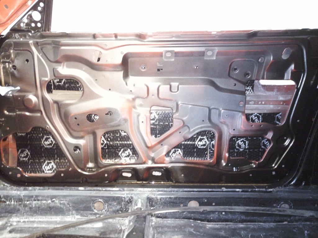

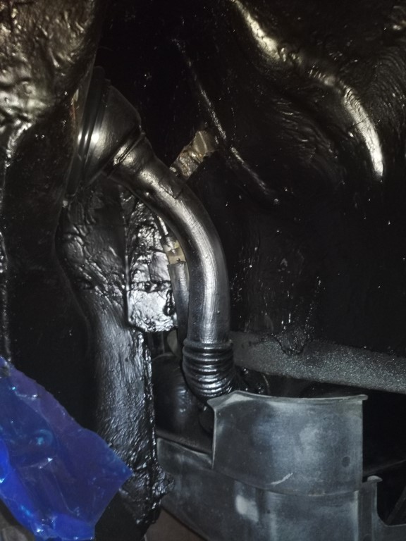

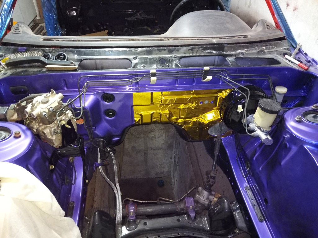

STP black silver sound dampening and heatshield for the inginebay and cables

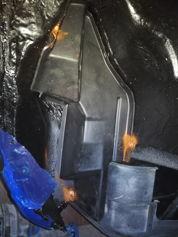

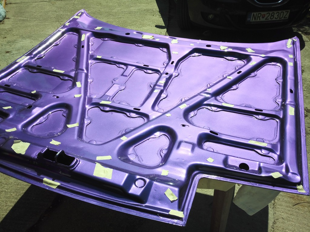

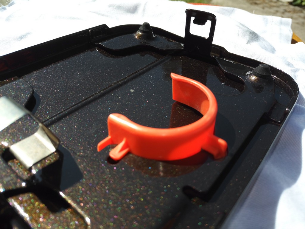

Detail of the gasdoor
Cavity protection applied

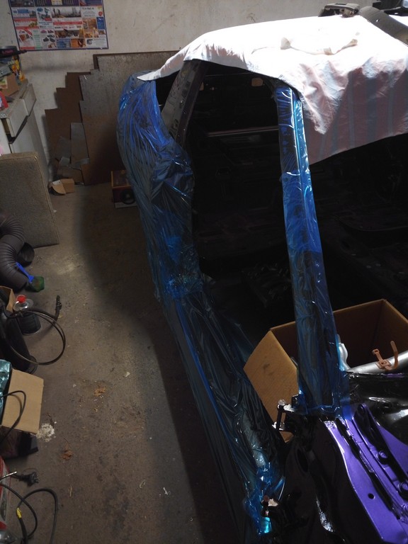

I use selfadhesive foil to protect the new paintjob
Refurbished fueltank

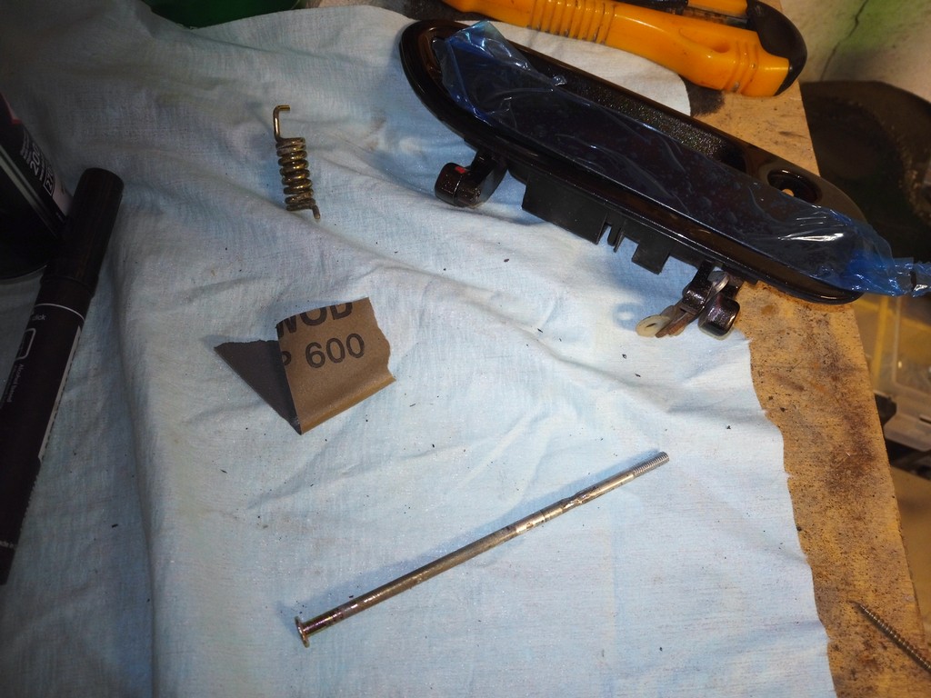

Doorhandles assembled with welded bolt

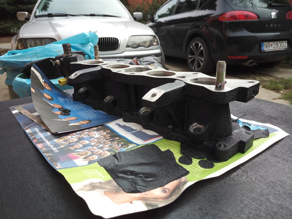

Wrinkle paint used for intake

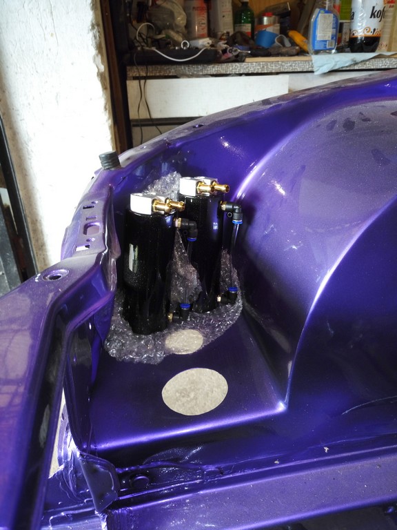

Oil catch tanks from Ebay, one of them I like to use for coolant reservoir after light modifications.

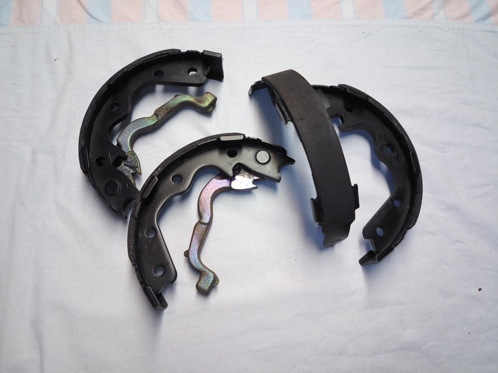

Refurbished handbrake shoes

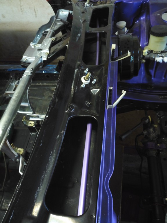

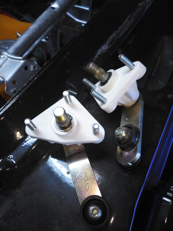

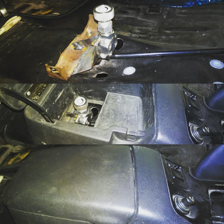

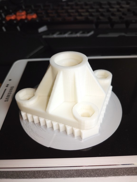

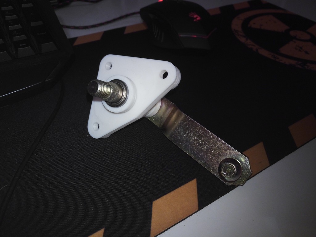

Assembling the handbrake, and I printed the prototype of my wiper pivot mount for s13, I redesigned them for new bearings.

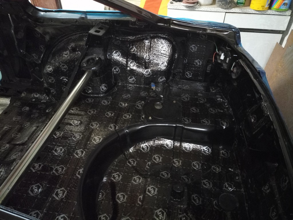

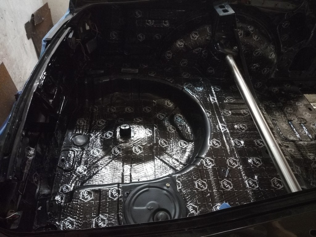

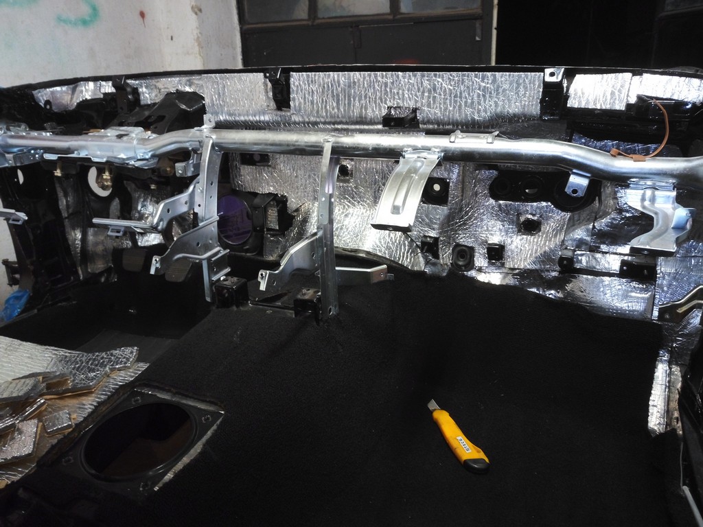

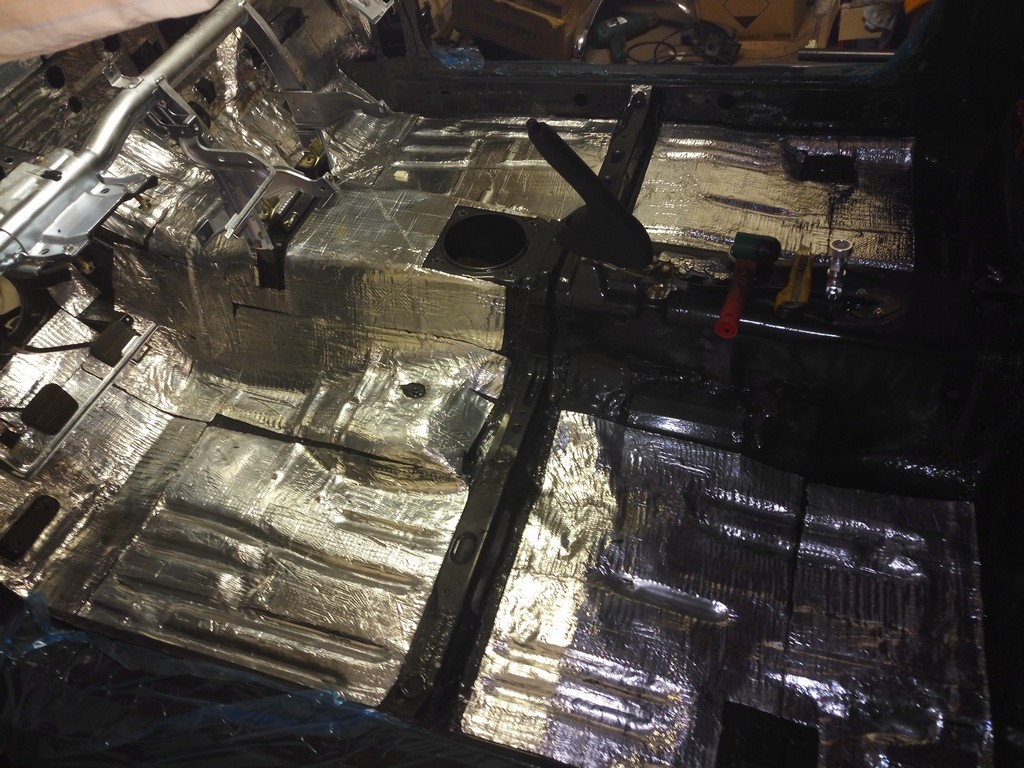

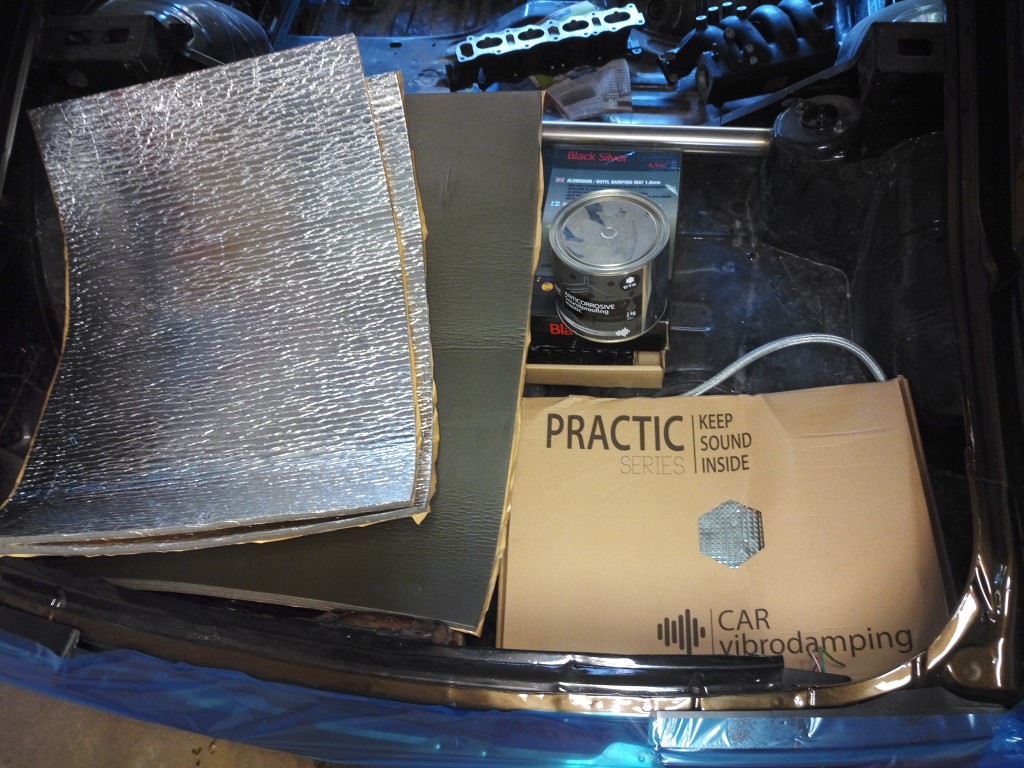

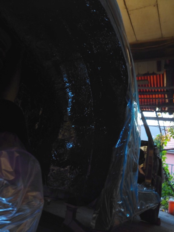

Lot of materials for soundproofing

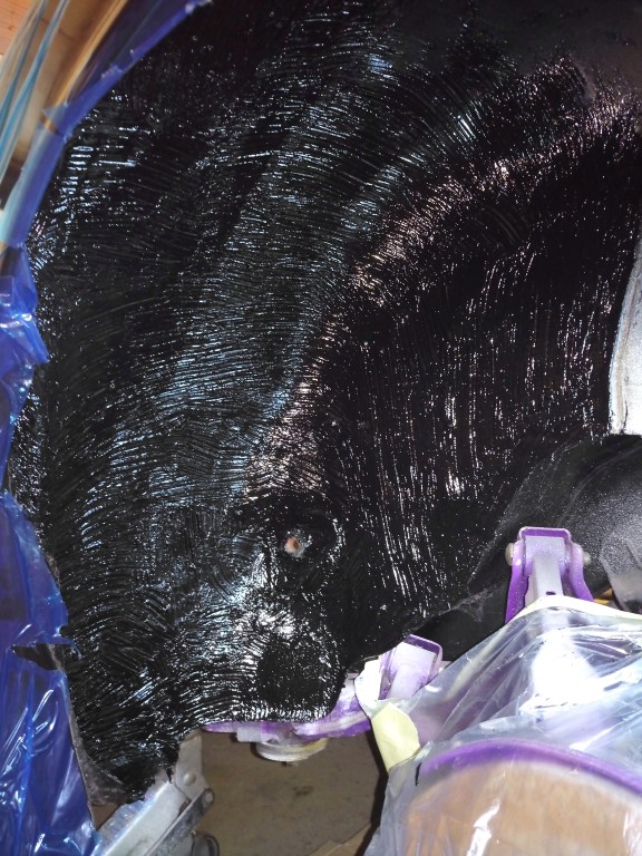

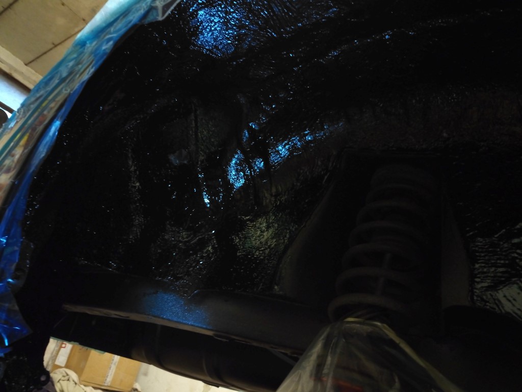

Rear wheelarches

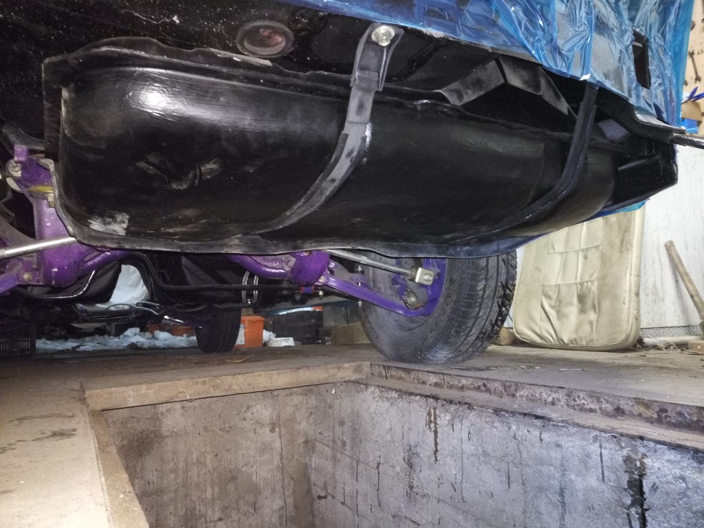

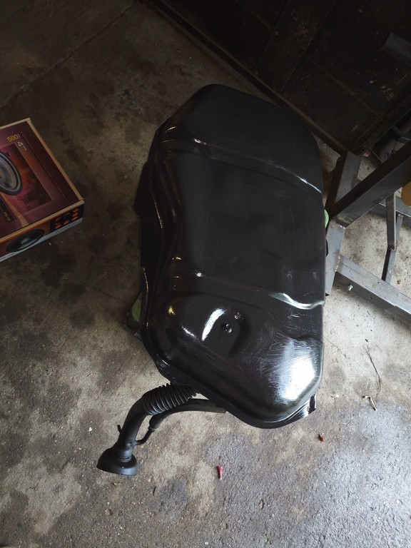

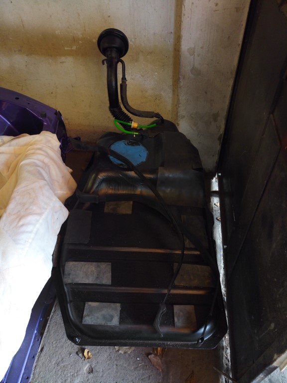

The fueltank is finished and on the place, I changed the fuelpump to new Walbro because the old one is some noname pump.

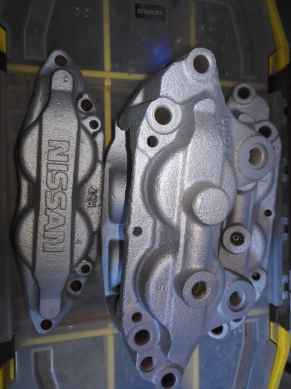

The front calpiers are ready for powdercoating

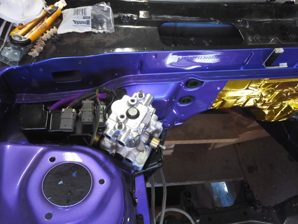

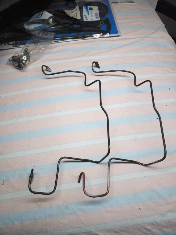

And now I am working on new steel brakelines.

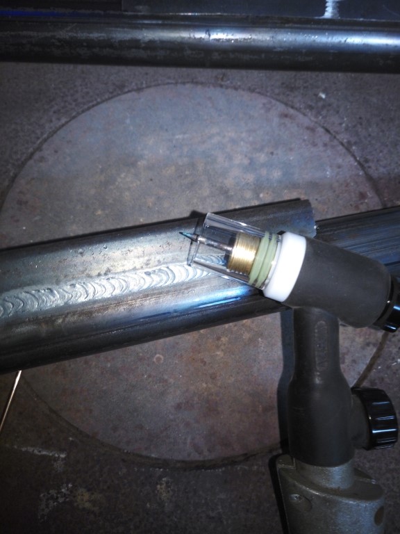

Testing the new but cheap gas lens on TIG

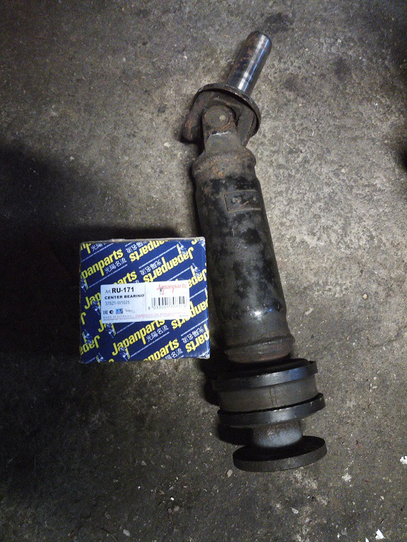

Replaced center bearing on driveshaft. The number is: 37521-W1025

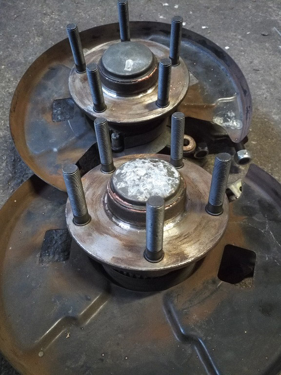

New 63mm Grayston studs in front hubs

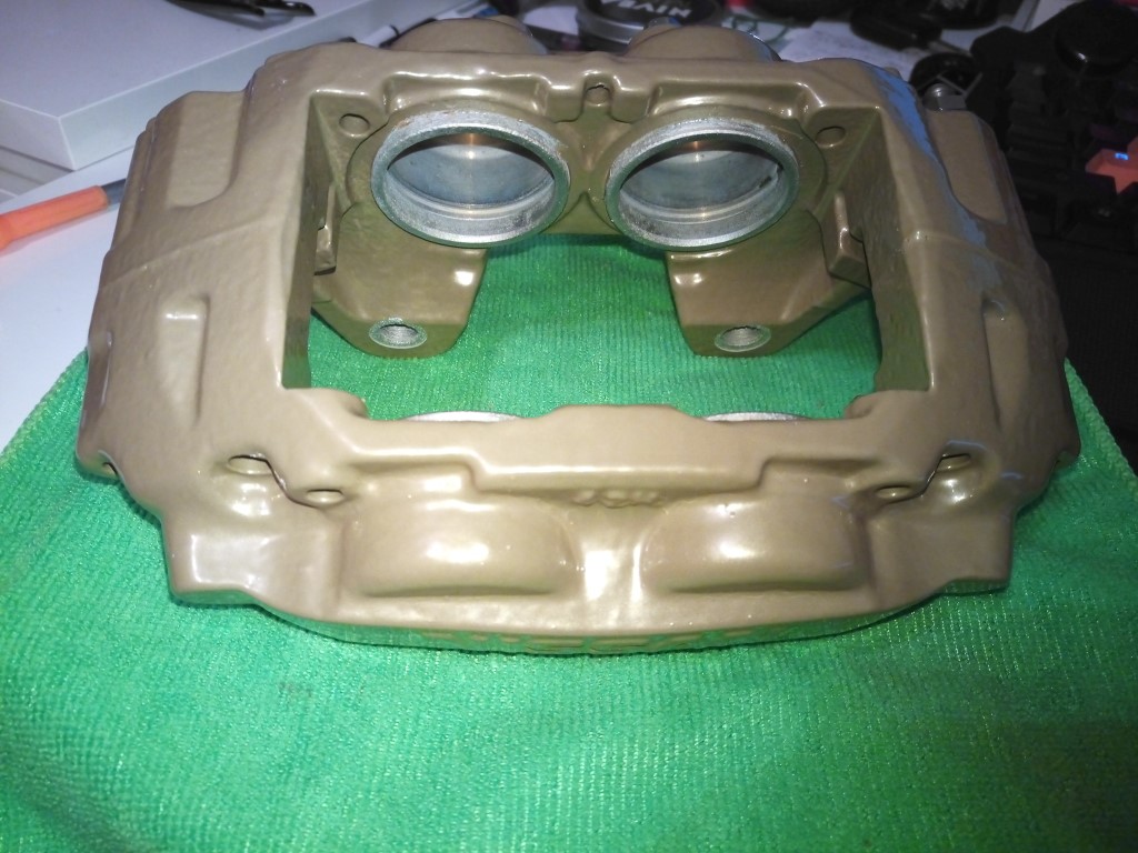

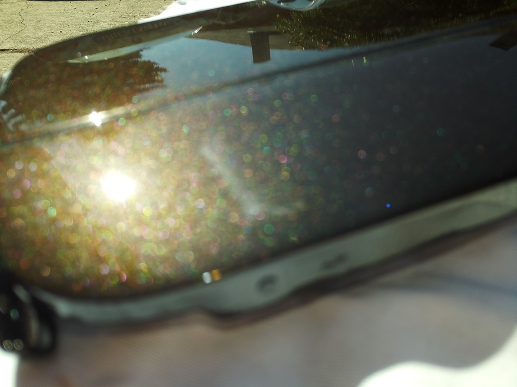

Little update, powdercoated brake calpiers, is this gold metallic ???

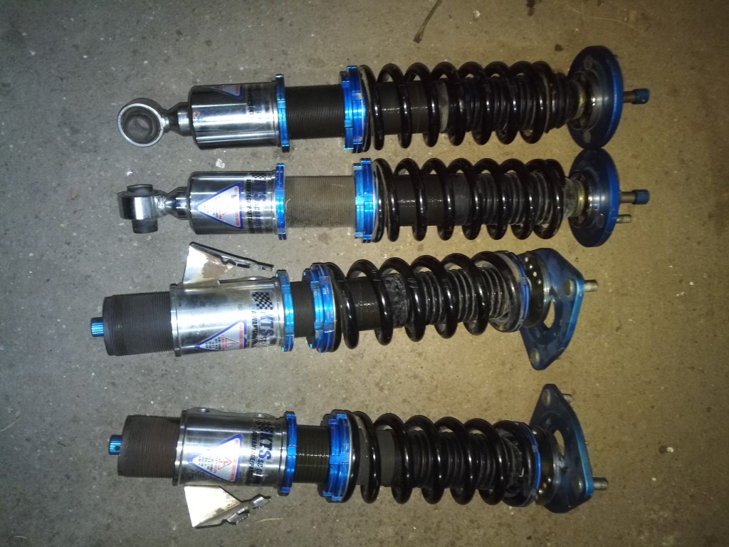

Reassemled coilovers with new dust covers from JP

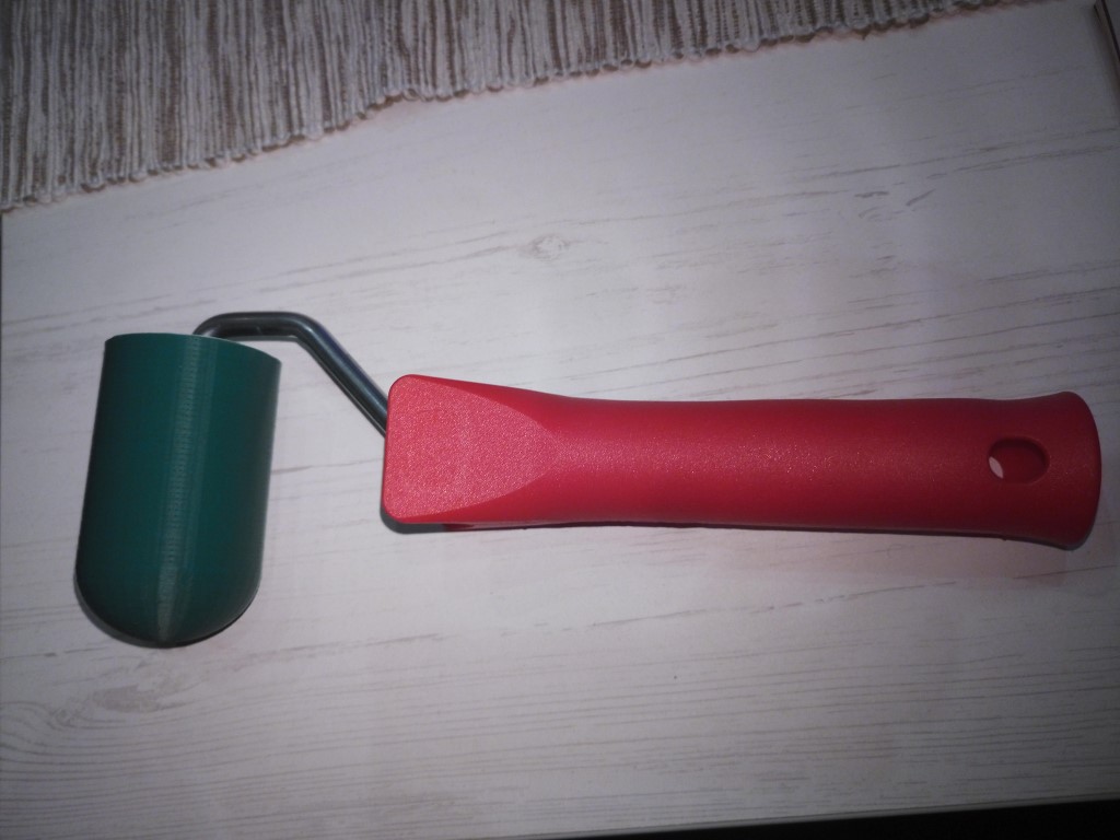

I am printed the plastic roller for better apply sound dampening
and finished refurbishing the ABS block

the calipers look beige haha but cool progress

Alpha version of the pivot mounts with bearings printed and mounted.

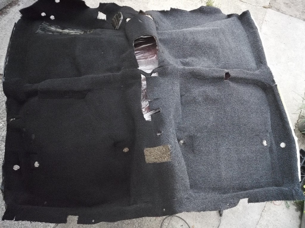

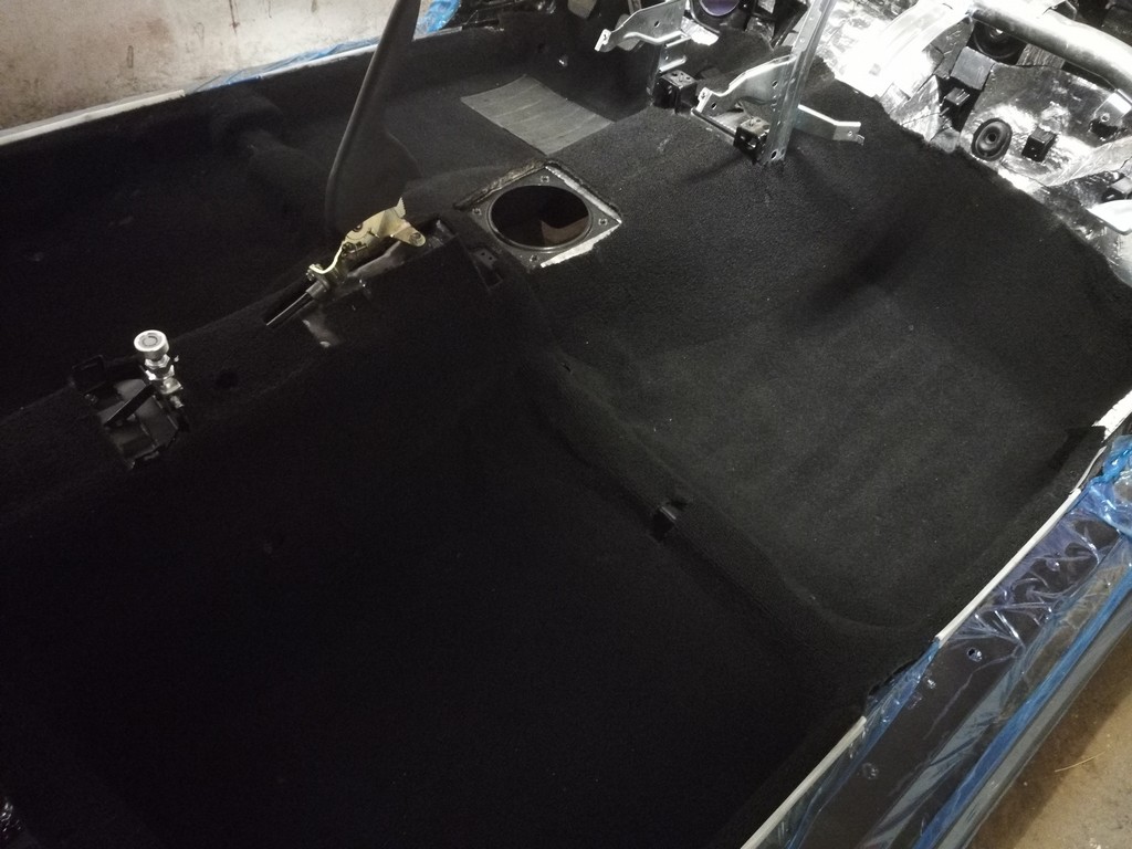

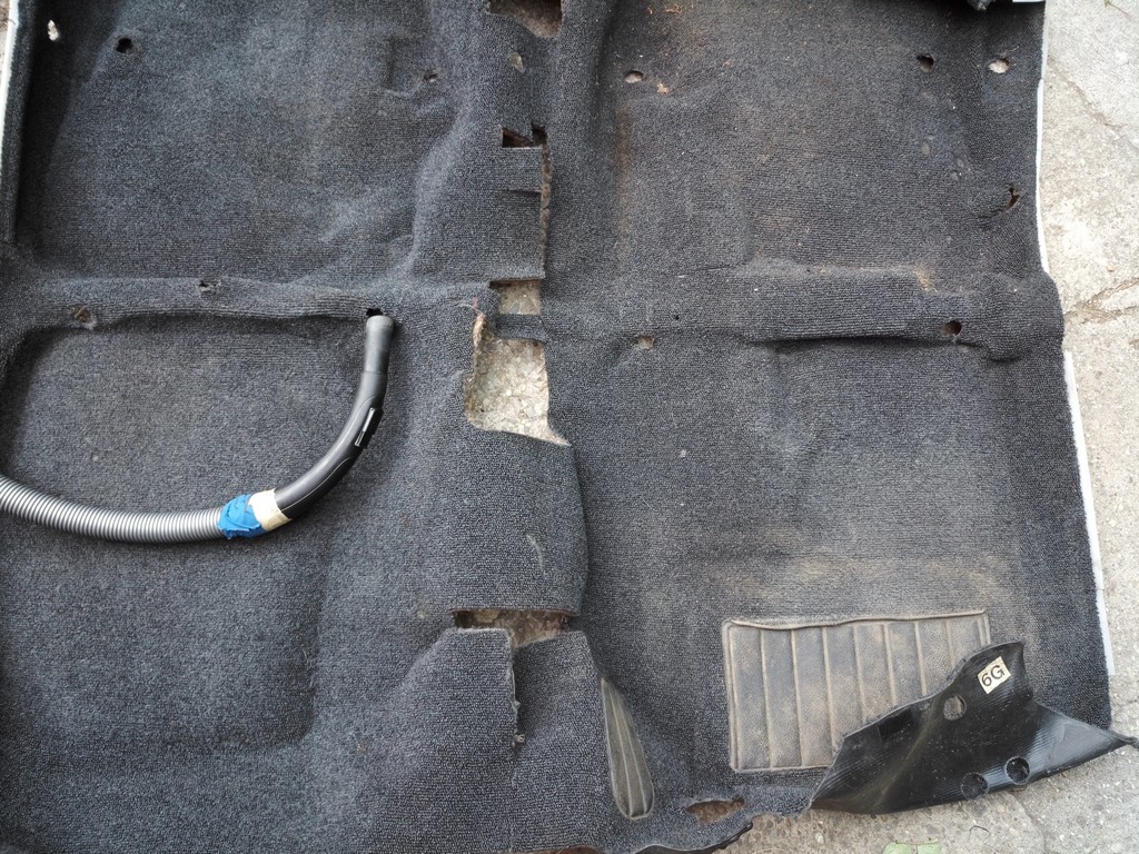

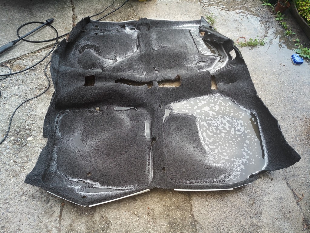

Cleaning the carpet before painting

Painting the carpet

Been following this build for a while. Its very nice and seems to have a well thought out build process to end result. To you, the build serves a purpose and you are happy with it. Looks great so far!!
I am curious if you can send me the 3d print file/link so i can have a friend print 2 new wiper mounts for my car. i really like the bearing install instead of bushings. Did you also print new ball joint inserts for the arms?

Thanks, of course I can share the stl, I am uploaded it to thingiverse for you and others for test purposes. Plese leave the comment if you test it Now I am used the old inserts in arms. I am planning to design some replacements but now I am working on some other thing so no time for it
Here is the link: https://www.thingiverse.com/thing:2961561

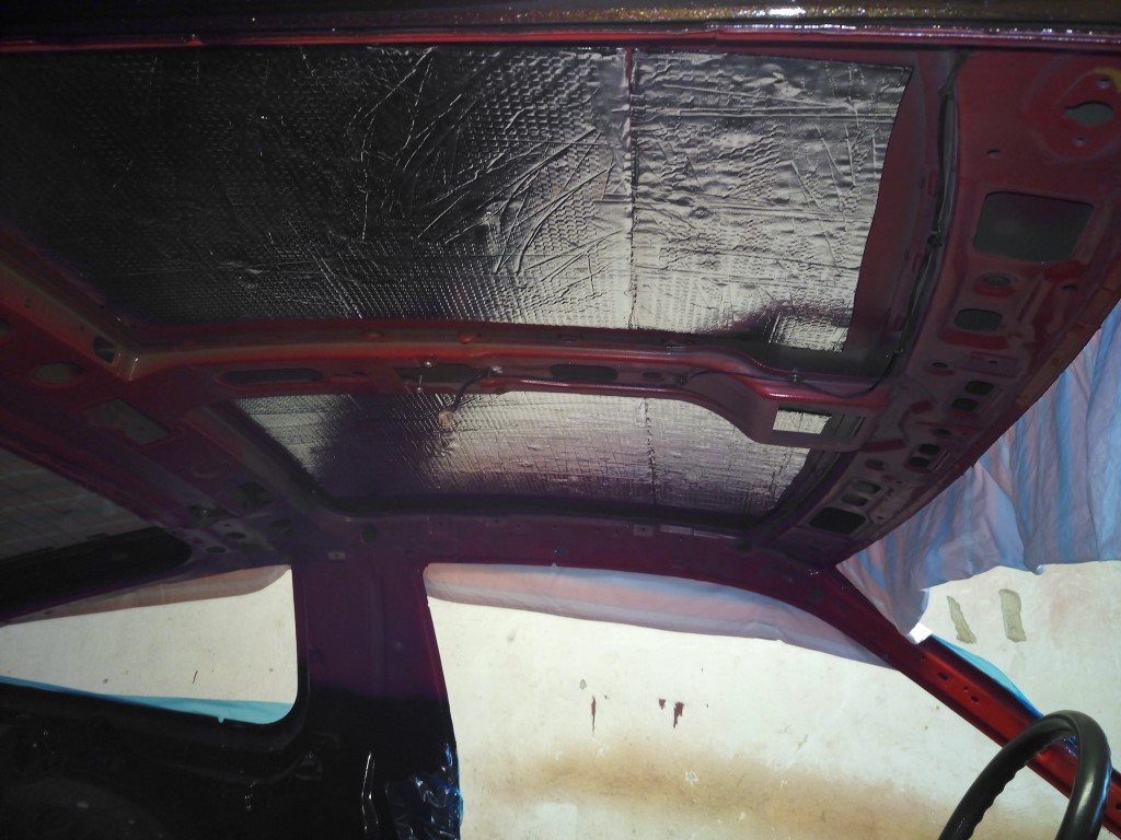

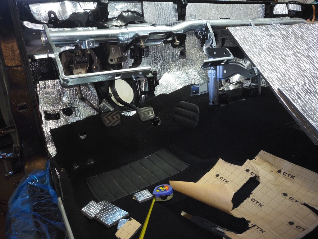

Sound dampening is finished, now I am ordered some foam rubber under carpet, and working on the firewall - putting on foam with alufoil.
