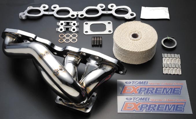

I like my Tomei Expreme un-equal length.. It micro-cracked at the collector after about 3-4 years of solid usage, but took it off welded it up and its been good for almost another 2 years so far.
my 2 cents..
EDIT: Why I recommend? Sounds awesome, nice bump in mid-range pwr/tq, fair price, Tomei quality, oem positioning

I have pretty much decided on either the Isis V3 Manifold or the Tomei Expreme, so my budget is in that 400 to 600 on the manifold alone. Any further input on these models

The only thing Tomei replicates is the factory positioning of the turbo and lines, which unless you are going big retarded top mount is a must-have in my opinion. Its so easy.
No personal experience with the ISIS one but for the price its probably ok. It comes without any sort of material finishing so if you do go that route I would get it coated in something to your liking, otherwise rust will happen sooner or later. Idk, I'd go Tomei
