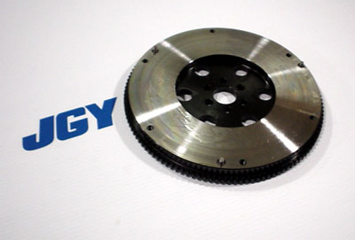

Just came across these JGY flywheels.
14lbs.
12lbs.
Is JGY a reputable brand?
Goto google and type in JGY sucks or similar and just rad the horror stores. Absolutly terrible customer service and shop. They've scammed the FWD crowd for years.
