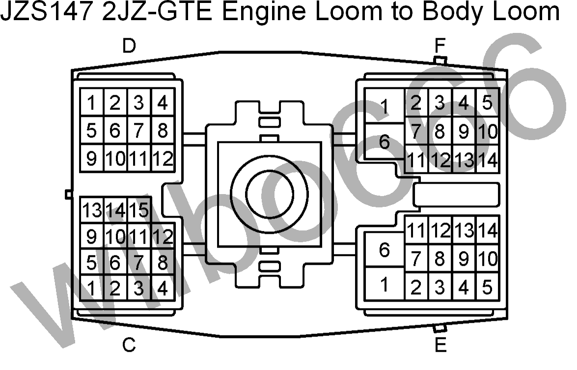

Its alive and just some new pics getting a downpipe made cant beat it for 50 bucks at local exhaust shop.
Then the girlfriend acting like she knows cars.
ok so onto wiring
and here is the pinout i used they are all bout the same.
step one u need a digital volt meter, some automotive grade 14 and 12 gauge wire with four 30 amp relays, more grounds than power wires and all your power sourcing can come from the fuse block under the hood oh and u need the e10 connector which i got at a junkyard out of a wrecked gs300 any will work that had a non turbo 2jz just cut it out. and leave a tail.
ok on the e10 connector
[pin 1] needs be switched so your ecu knows when to come on and isnt running all the time no need for relay u can tie into one of the nissan ones under the hood
[pin 6] is your check engine light i just hooked mine up behind the instrument cluster one wire to the bulb.
oh do not mess with the park switches i assume your not using the auto tranny i thought i had to have a neutral safety switch but just cut pin 76 on the e9 connector or you will be rev limited at 5k rpms
ok back to the e10 conn
[pin 24] is the efi relay that needs to run to your sensors i will get back to that
[pin 31, and 32] need to be tied together and run to a 30amp relay this is what powers the ecu oh and it needs to be switched if u dont wanna run pin 1 to the ignition switch.
[pin 33] needs to have constant power its your ecu memory no need for relay does not pull enough amperage
Onto [e9 connector] [pin 4] needs to be grounded to chassis
[pin 28] no need aristo is map based only
[pin 65] ground to chassis
[pin 69] ground to chassis
[pin 79,80] ground to chassis.
now on the starter extend both your old starter wires to the starter now u dont have to do nothing but turn the key.
http://wilbo666.pbworks.com/w/file/f...ody+Pinout.png
now the link above is to the chassis loom the big connector on your harness you need a few wires off this
[E 3] needs to be cut and connected to pin 24 on the e10 connector its your low voltage for all your sensors
[f 6] needs a switched 12v source with a relay. this is power to your ignitor and efi
[f 11] chassis ground
[f 12] is your tachometer output from your ignitor for when you get your dakota digital box
and the fuel pump i run to a switched relay i got lazy i will be hooking the fuel pump to the ecu this week.
but the car pulls hard ass hell with no idle issue
thanks for looking guys more updates to come any questions just ask.

dude your my hero! finally someone that posted up some wiring info. i dont why people are giving you shit when your contributing to society!
