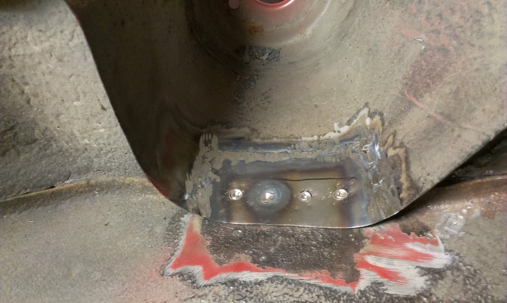

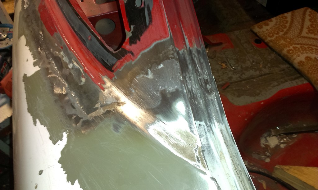

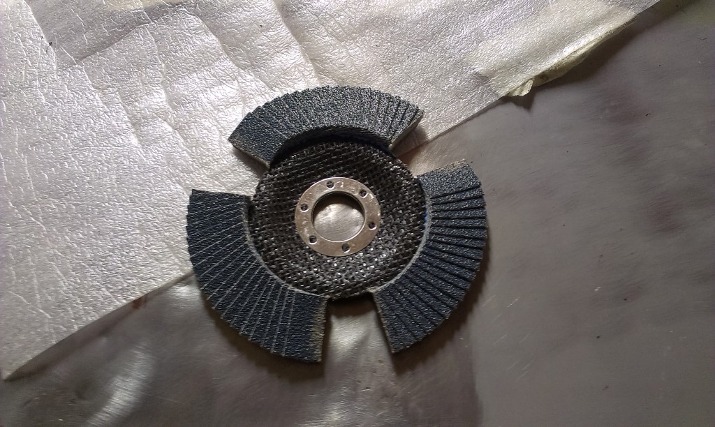

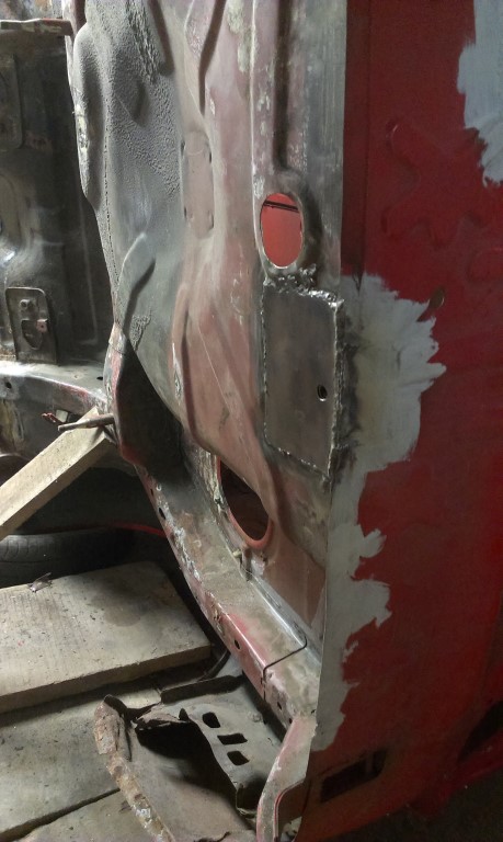

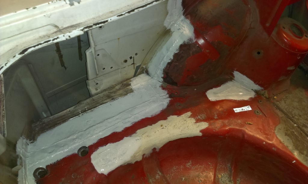

New photos:
:P
Little bit body tinning
Primer

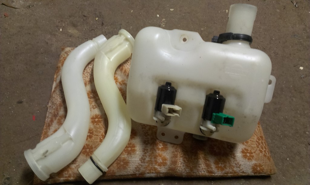

Where did you get the wiper motor?
The wiper motor is original but it was disassembled and renovated.

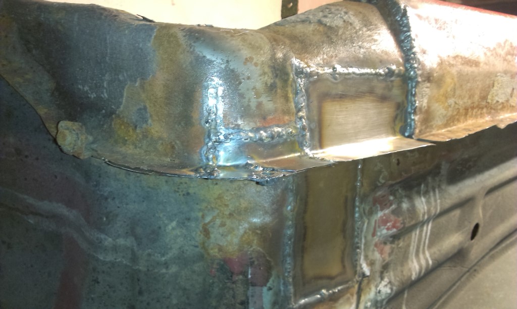

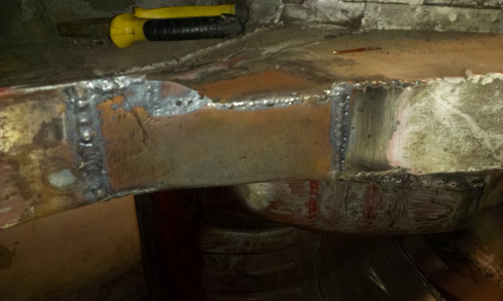

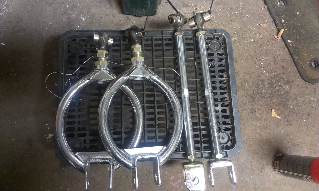

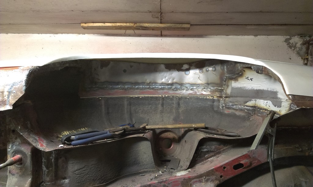

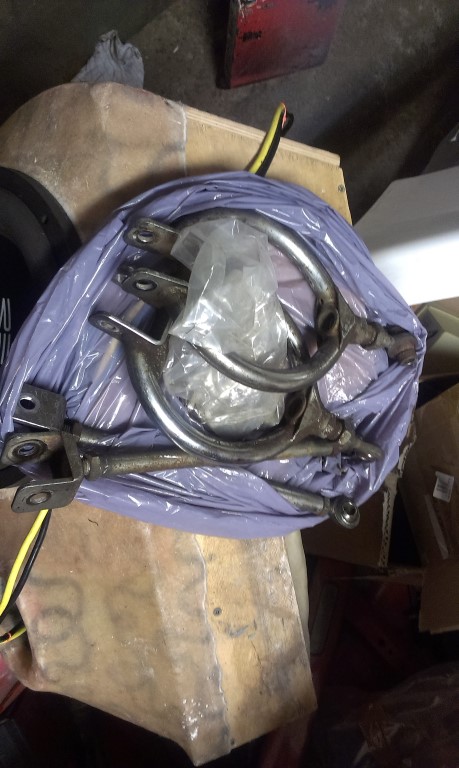

Tinned weldings
Rear camber arms import from JP

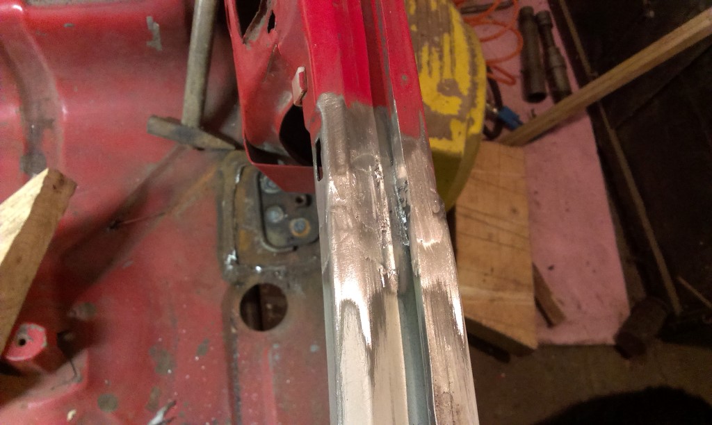

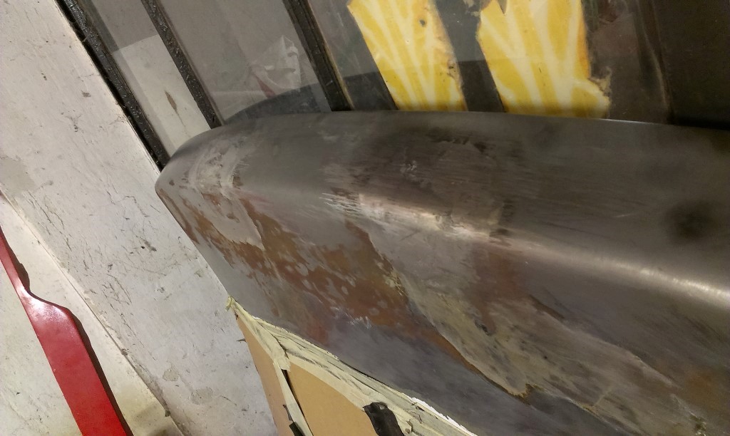

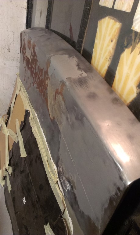

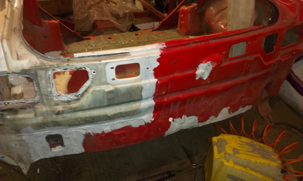

Alu filler

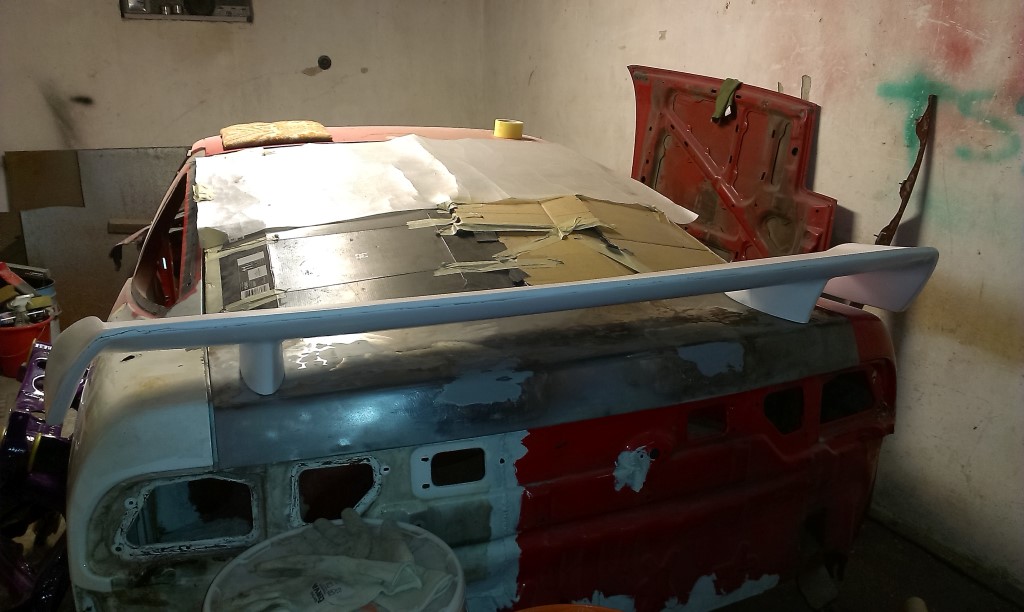

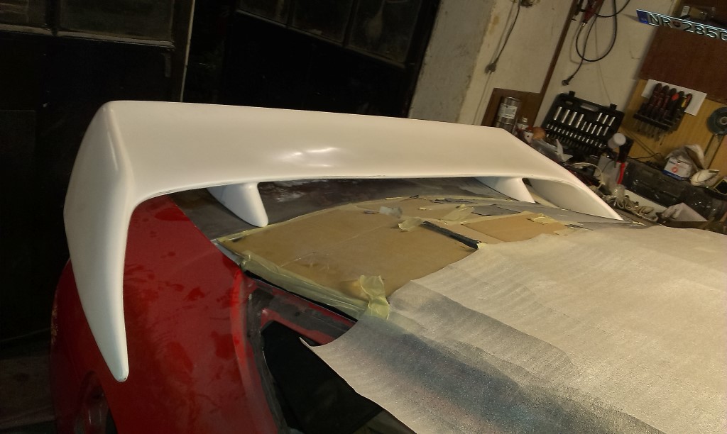

326 POWER (style) WING in da hause

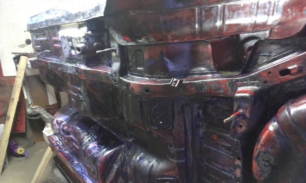

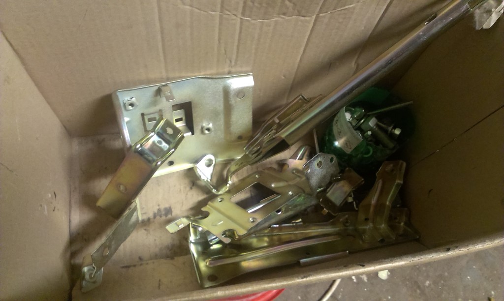

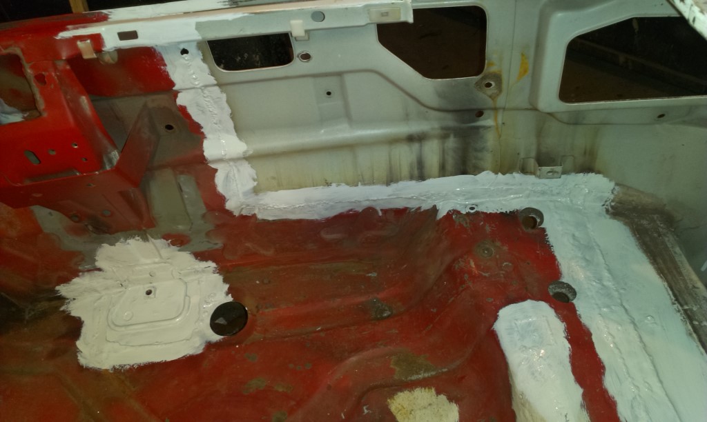

Restored:
Some galvanized things.

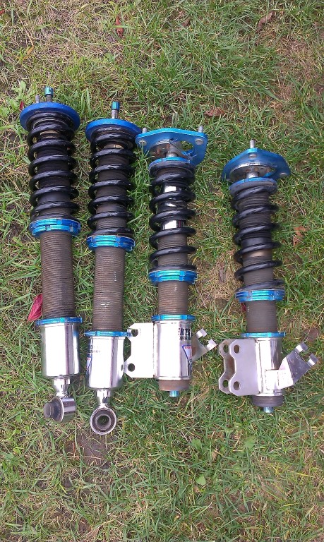

New T-shirt NewSensationZ.
KTS coilovers for s13 from JP

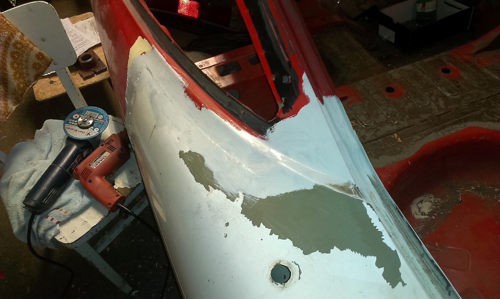

Originally Posted by TSSS22 View Post
New photos:
can you explain why this was done? I use them regularly in stock form..this is intriguing
@UpshiftEngineering
Old 11-24-2014, 09:15 PM   #50
Hoonigan19
Join Date: Feb 2013
Location: Alberta
Posts: 97
Hoonigan19 is an unknown quantity at this point
im going to assume that it allows the flap disc to flex a little bit......

This is for, see through the disk when you using it, so you cant over grind the weldings for example... You will see this in action on this video at 3:40
http://www.youtube.com/watch?v=3eV_wRTLHsg
wow, i learned something awesome today! thanks for the response

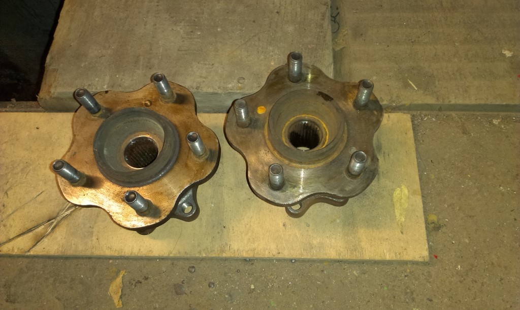

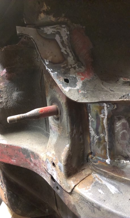

rear 5 lug hubs from JP

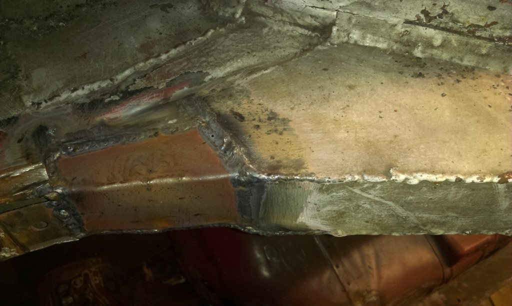

Some weldings

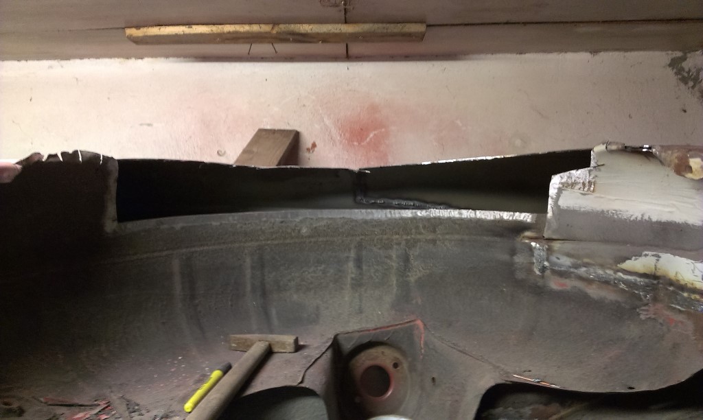

Cutting rear wheel arches...
