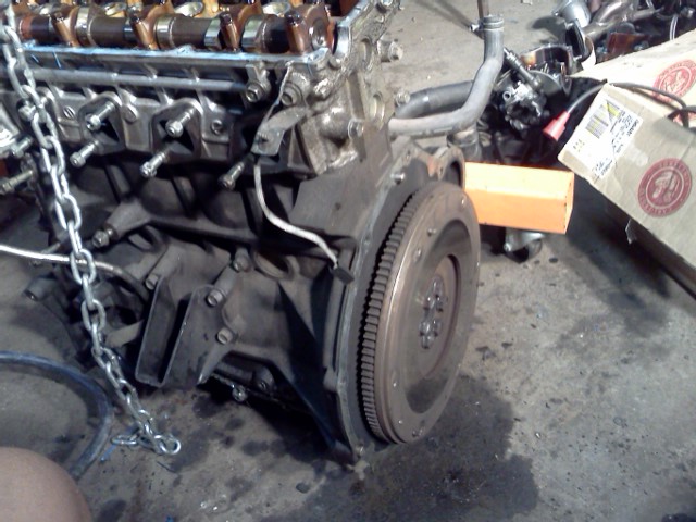

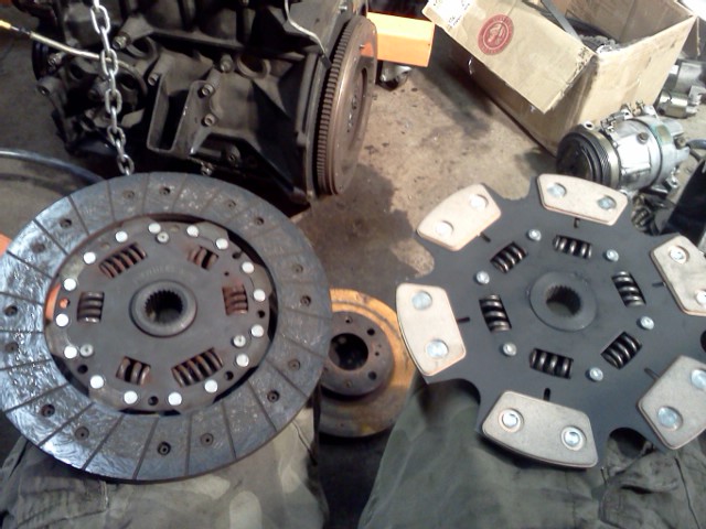

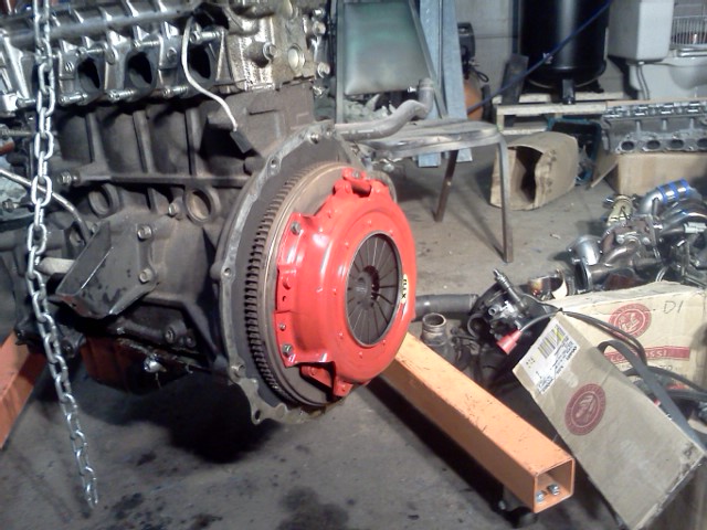

So engine didnt go in this weekend but heres an update and some pics.
This isnt what you want. Notice something missing?
Old clutch
What a difference!
And here it sits but at least its clean and all back together

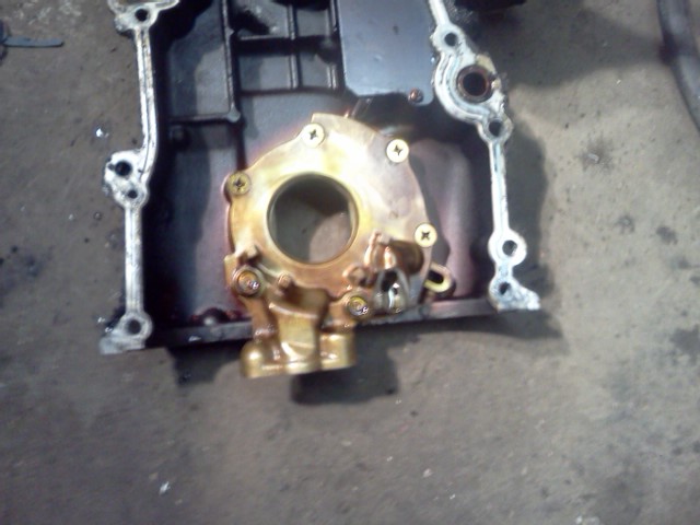

Chris, I'm pretty sure he said that because you didn't make mention of the head being redecked. I think regardless of whether the headgasket blew or not, every time you remove the head, it should be decked or at least checked for levelness (spelling).
What happened to the front cover/oil pump?

haha yeah I know. Somehow that piece that comes down that has a bolt in the bottom ( I believe its the oil pressure valve?) Broke off :/ I think it was cracked already or just weak and when I was trying to change the oil pan a few weeks ago I broke it. But it is all fixed now. Im really hoping that Ill have enough time next weekend to finish it all up and have pics of it actually in the car running doin burnouts and backflips. lol jk gotta break clutch in first
