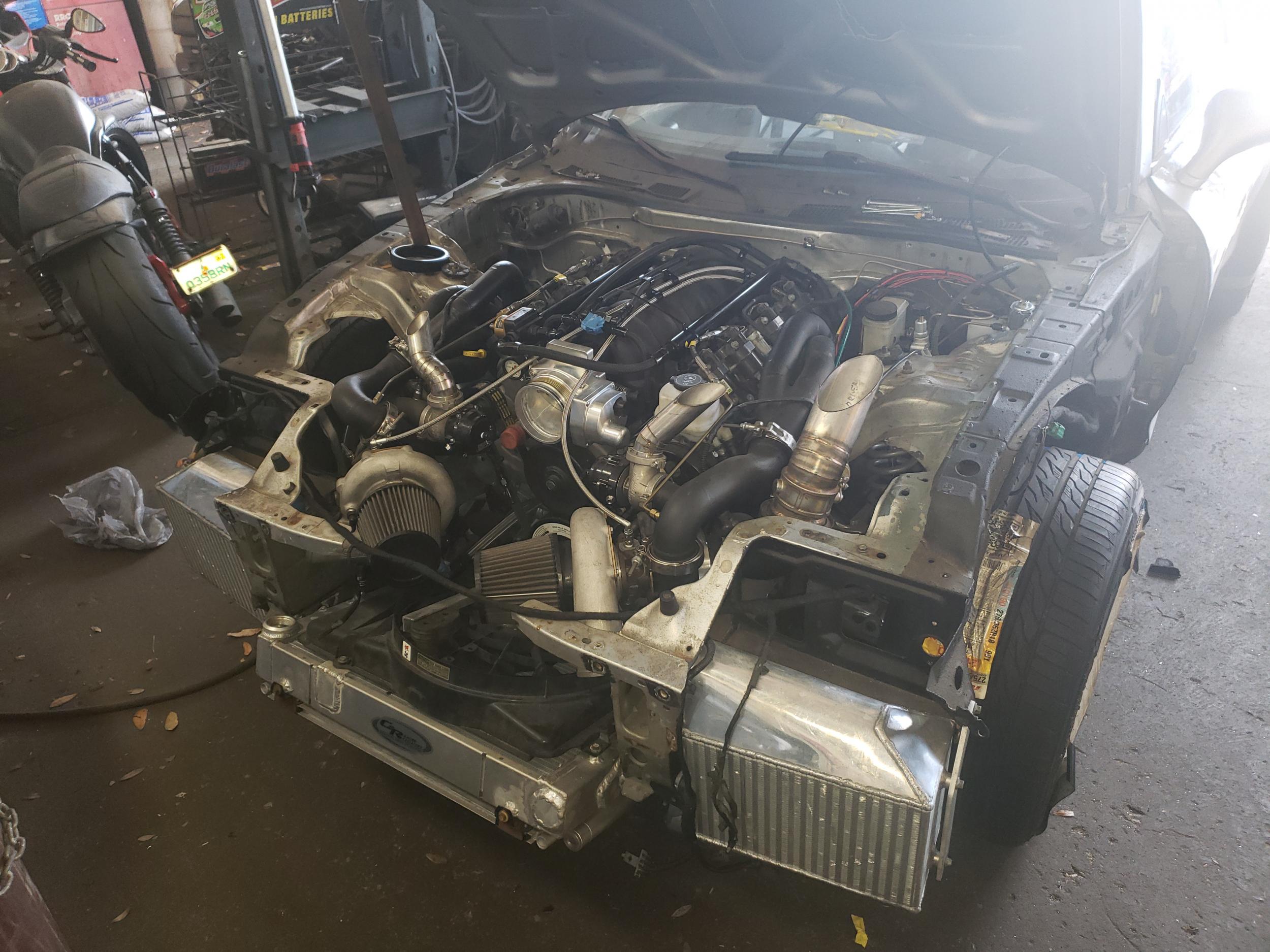

fd3 twin turbo 6766's lsx engine proefi ecu magnum t56 8.8 rear end
if you want to check the build this is the link
https://www.norotors.com/index.php?topic=13533.0
