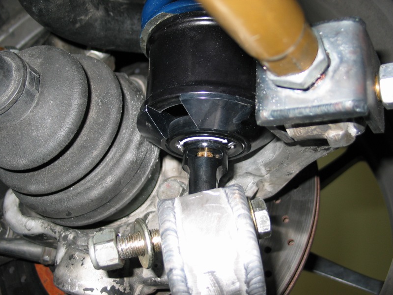

as promised - here is the latest update for you guys:
To start this installment, many hardcore car guy know that the best suspension in the world is MOTON. Seriously - nothing else comes close. I researched my options - considered ohlins, bilstein, kw, penske but at the end of the day, none had what i was looking for except Moton. I HATE upgrading parts and only want to buy good suspension once, so i bit the bullet and what showed up was heavenly. The quality of these absolutely exceeded expectation, and im blown away (im a very picky engineer, this doesnt happen often) suspension of this caliber is seriously next level :bowdown :bowdown :bowdown :bowdown :bowdown :bowdown :bowdown :bowdown :bowdown :bowdown :bowdown :bowdown :bowdown :bowdown MOTON
^^ a total thing of beauty. Moton double adjustables (15 independant bump and rebound settings, blowoff valve system for high speed bump control, huge main piston, remote reservoir compression adjusters mounted on swivel banjo fittings (makes mounting them easy!), and 2.25" spring hardware.
^^this is the top-secret R14 front suspension ive never shown anyone before. consider yourselves lucky :rotflmao the Motons fit so perfect, its like the motons were just meant to be..
this is showing the drivers side remote reservoir compression adjuster
(pass side)

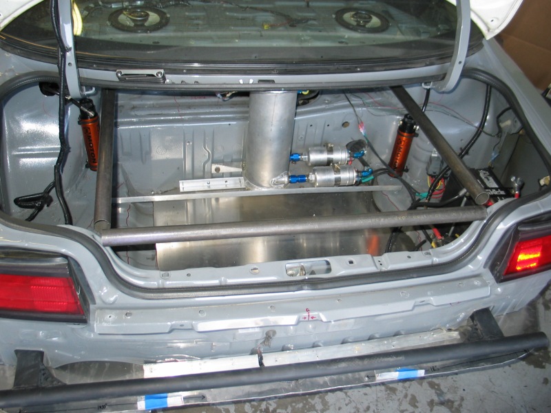

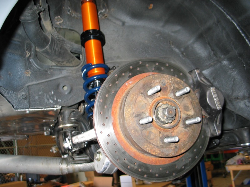

now to the rear --
installed (but waiting on the tender springs to arrive)
reservoir located, you can also see the fuel pump wiring
easy to see how the adjusters are mounted facing inwards, easy to access without removing the wheel
tire clearance at full droop
tire clearance at full bump
both reservoirs mounted, and the wing mount i am building now from 0.035 4130 cromoly
