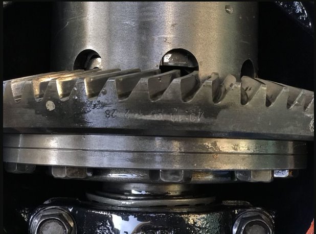

Old 04-28-2020, 04:03 PM   #14
s13silvia123
s13silvia123's Avatar
Location: where waldo is
Posts: 3,256
bumping this up from the dead.
now need a little help. is this a a R180 or R200 diff
http://zilvia.net/f/tech-talk/261219-18g-20g-turbo-users.html

I think the R180 looks ancient, different rear cover shape.
But I (think I) know it's the ring gear diameter. Measure it.
mechanicalmoron is offline   Reply With Quote
that's why i'm asking if this diff was one or not. about to pull the trigger and buy it. since i can't measure it. if it turns out to be a R180 i can always sell it to the 280z guys. but the difference is the shape of the diff. looks more like a R200 as well as the rear cover.
Oh, I assumed you had access to it.
If I just saw that in a pile of random manufacturer diffs, I'd assume it was an r200.
That looks like a S13 4.08 R200 diff.
The ears on the R180 stick out more because of how narrow the whole pumpkin is.
Oh, and FYI for the info in earlier posts, non-turbo S13 & S14 cars did come with R180 diffs. Not sure if it was only the Euro cars or what, but it's wrong to assume all s-chassis cars came with R200 diffs.
