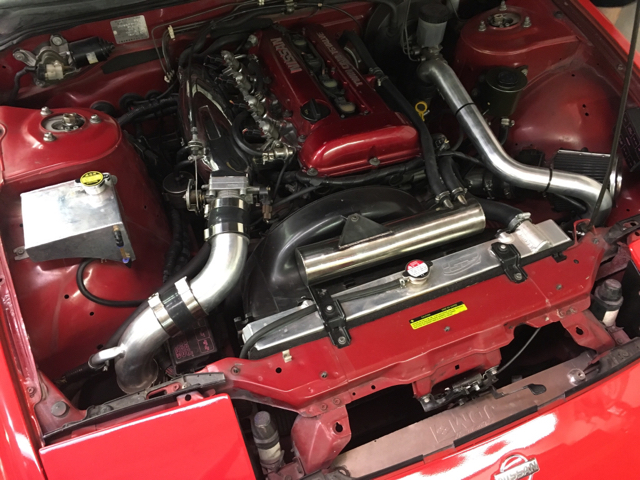

Hi all,
For anyone who has ever ran a Greddy/Freddy intake manifold on the SR, you've definitely ran into the issue of the cold pipe fitment issues.
Obviously for those of us doing extensive mods, cutting and clamping a few charge pipes is no big deal, but I'd like to see others setups and their way around the issue. So if you have a Greddy or Freddy IM and a FMIC, post up a pic of your cold pipe!
Here's what I fabbed up on my hatch. I am looking to do something different for my coupe:

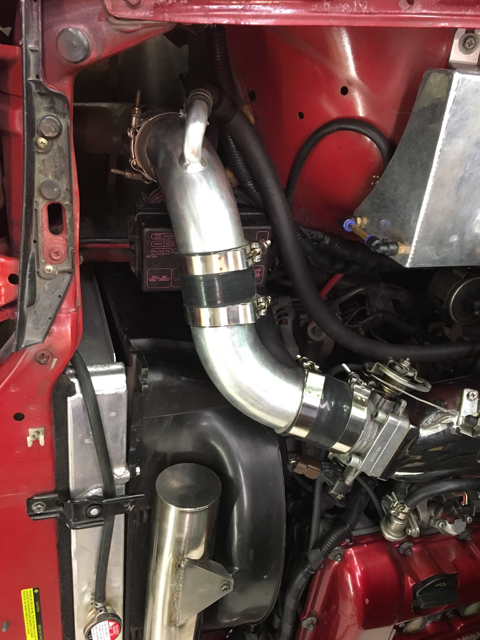

I think with that 90 degree elbow right off the IC, you'd be able to fit the original cold pipe with chopping very little material off of it. I'm concerned about the idle air bung. This may also concern those who still have their OEM fan shroud (which you should) as the piping may come in contact with that.

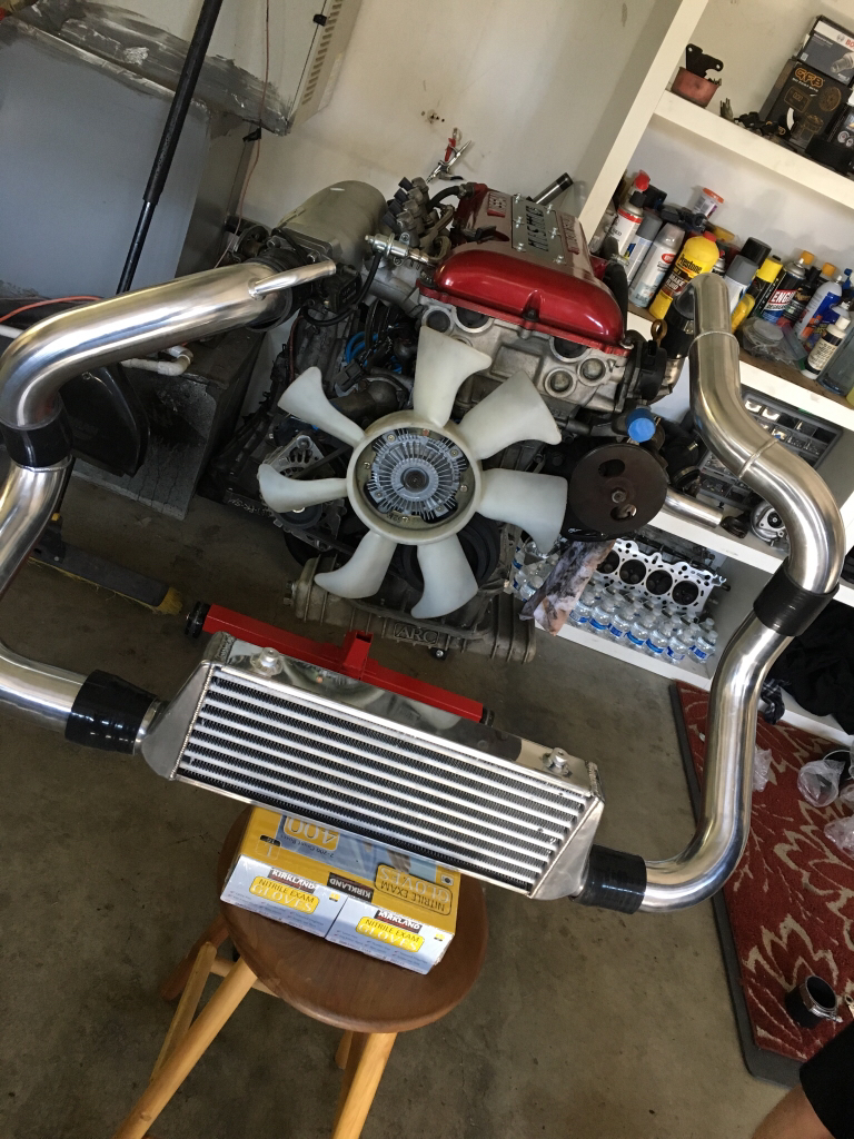

most intercoolers fit around the same. Most FMIC have the inlet and outlet around the same location, so worst case scenario you would have to slightly adjust your no-name intercooler to fit a pipe that was intended for greddy IM and IC.
It's just piping everyone...
This is my rb setup fwiw

This is also how I mocked up my coupe setup.

yeah, except your picture wasnt taken with a potato xD
I also had the intercooler intalled at some point. Best way to check your piping for leaks before going in.

I think your pipes are backwards. but uh yeah like someone else mentioned they make piping for that already.

On the hatch? Yeah.
I cut the cold pipe in half and flipped it to fit...
