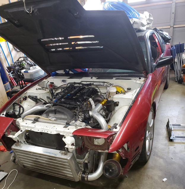

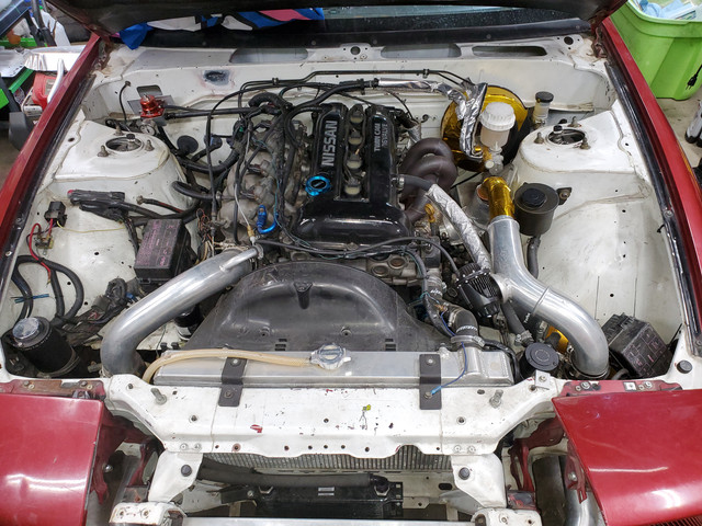

My 1991 240sx Track Build
I'm finally in a position to own and maintain a track car!

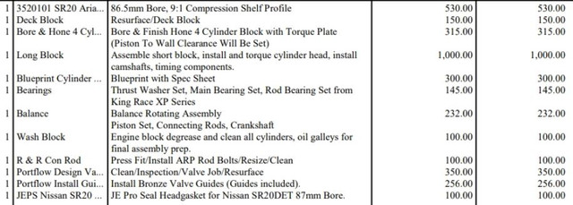

I've also looked forward to starting a thread on here since I joined in 2010. So here we finally go. I'll start with the current mods and follow with some pictures and continue to add updates. All advice is welcome! First things first I'm not starting from scratch. To save money I found something priced fairly well (at least I think so)Chassis/Suspension NISMO POWER BRACE ES HYPER FLEX BUSHING KIT ES SUBFRAME BUSHINGS MEGAN OUTER TIE RODS DIF SOLID STEERING BUSHING MEGAN TRACK COILOVERS Any thoughts/recommendations on these? ICHIBA FRONT 5-LUG HUBS STEEL BRAIDED BRAKE LINES MOOG REAR BALL JOINTS OEM Z32 BMC HAWK HP+ PADS Z32 CALIPERS ENGINE/TRANS/ETC NISMO CLUTCH SLAVE FIDANZA FLYWHEEL WALBORO 255 FUEL PUMP TOMEI OIL BLOCK MISHIMOTO SNEOSR ADAPTER WIRING SPECIALTIES ENGINE HARNESS (CHEAPO ONE) N65 MAF W/ PIG TAIL S13 SR20DET SWAP GREDDY OIL PAN 750CC JECS INJECTORS HALTECH ELITE 1000 ECU + ADAPTER CIRCUIT SPORTS FILTER RELOCATOR EARLS OIL COOLER S13.4 VALVE COVER ISR V2 MANIFOLD MISHIMOTO OIL CATCH CAN MISHIMOTO COOLANT RES 5353 COMP TURBO W/ .018 RESTRICTOR SCREEN TOMEI FPR + GAUAGE AEROMOTIVE FPR CXRACING INTERCOOLER KIT B&M SHIFTER 3" ISIS BLAST PIPES Engine build sheet: Thoughts appreciated ![]() ![]() ![]() ![]() ![]() Things i'd like to tackle first: (Please send any advice) 1. Wiring; the wiring in the engine bay hurts my eyes. I'd love to clean it up a bit. 2. Paint; I've purchased the necessary equipment to be able to paint and would like to give it a go. I hate red paint. This list and pictures will grow I wanted to get this started though |

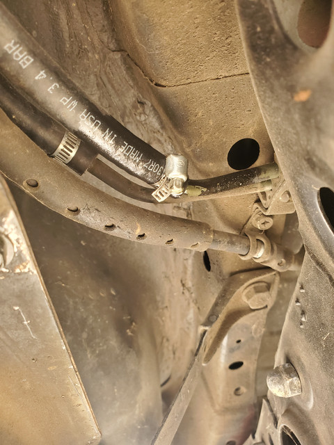

Purchased my seat rails from Street faction and they came in today. When I backed my car out of the garage (garage is a mess no room to work) I noticed a drip from under the trunk. Found a fuel leak.
![]() Never had to tackle a fuel leak looks simple but looks can be deceiving i'll be searching the forums and youtube for some assistance. |

Regarding your leak, check for cracks in the hardline and tears in the rubber. Make sure you're running J30R9 rated rubber fuel injection hose and using proper fuel line clamps, and not the ones you have there. Have fun with your build |
