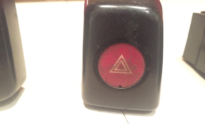

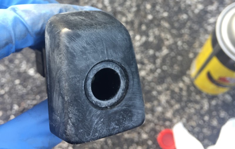

Later that week I decided to restore my cluster buttons due to them looking nasty. Bought the button lens from Restomod.Ninja
How it looked originally

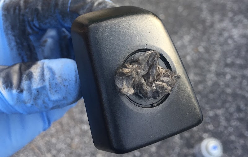

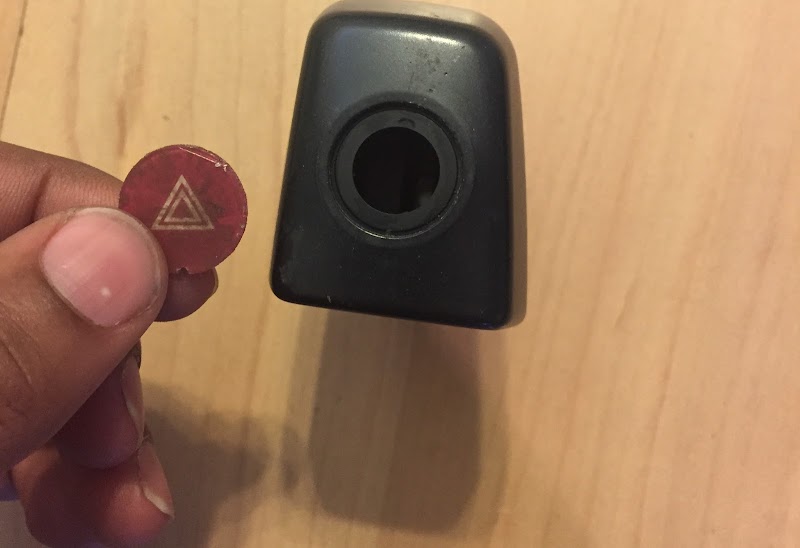

Used a hair dryer and a small flathead to remove it.
Used some goof off
Spayed it using duplicolor black

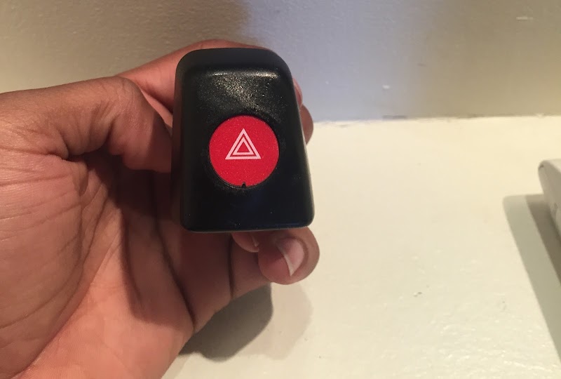

Then simply peeled off the back of the lens and stuck it into the button. Looked really nice all done. Did the rest of my cluster buttons as well. Really makes the inside feel newer.

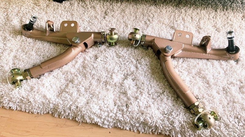

PBM Front Lower Control Arms
PBM Rear Lower Control Arms
I dont think I will be buying PBM rods and their other arms, I watched a video and saw how heavy they are and I wasent a big fan of that. Anyway thats it so far. Next update maybe in Feburary or March. Should have most of the parts by then and a new set of wheels finally.
