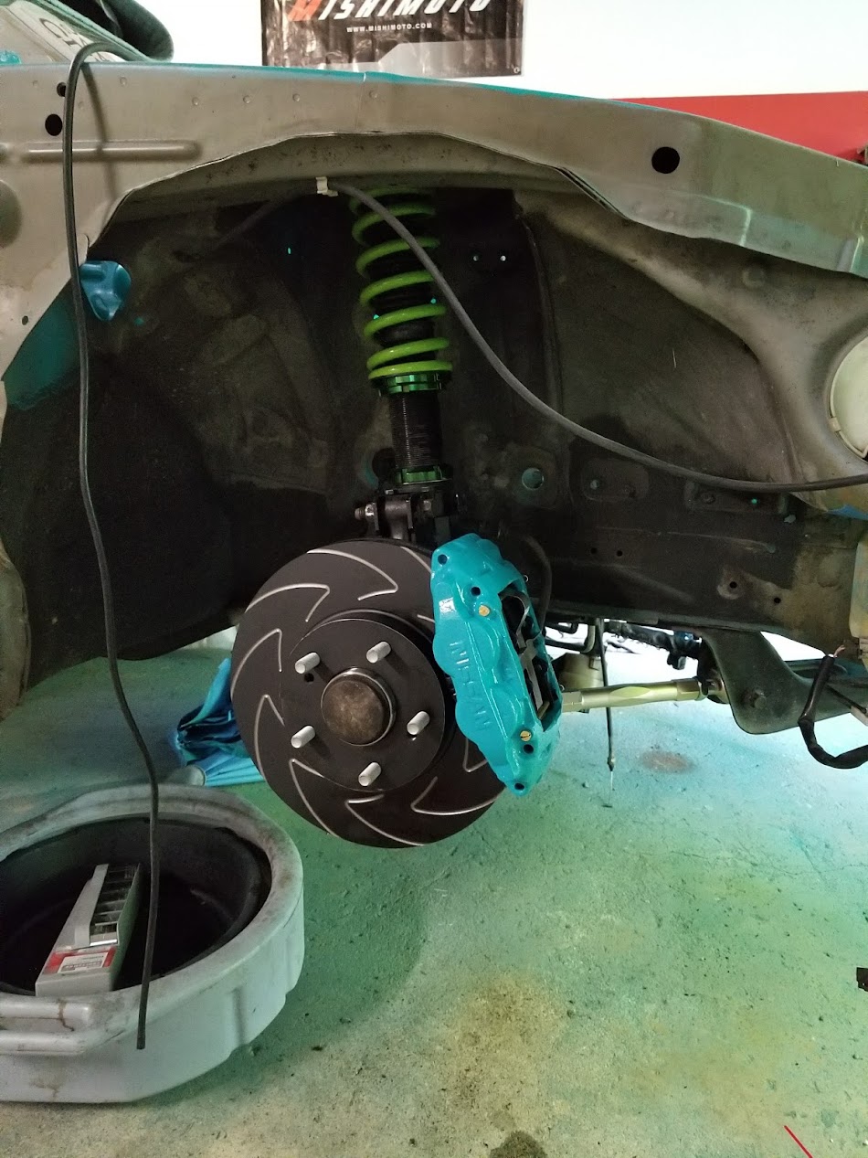

Fortune Auto Coilovers
DIF Solid Rear Subframe Bushings
Parts Shop Max dual caliper rear knuckles
ISR Front Tension Control Rods
ISR Rear Traction Rods
ISR Rear Toe Control Rods
ISR Rear Upper Control Arm
Sikky Sway Bar Front w/ Sikky End links
Parts Shop Max Dual Caliper Knuckles

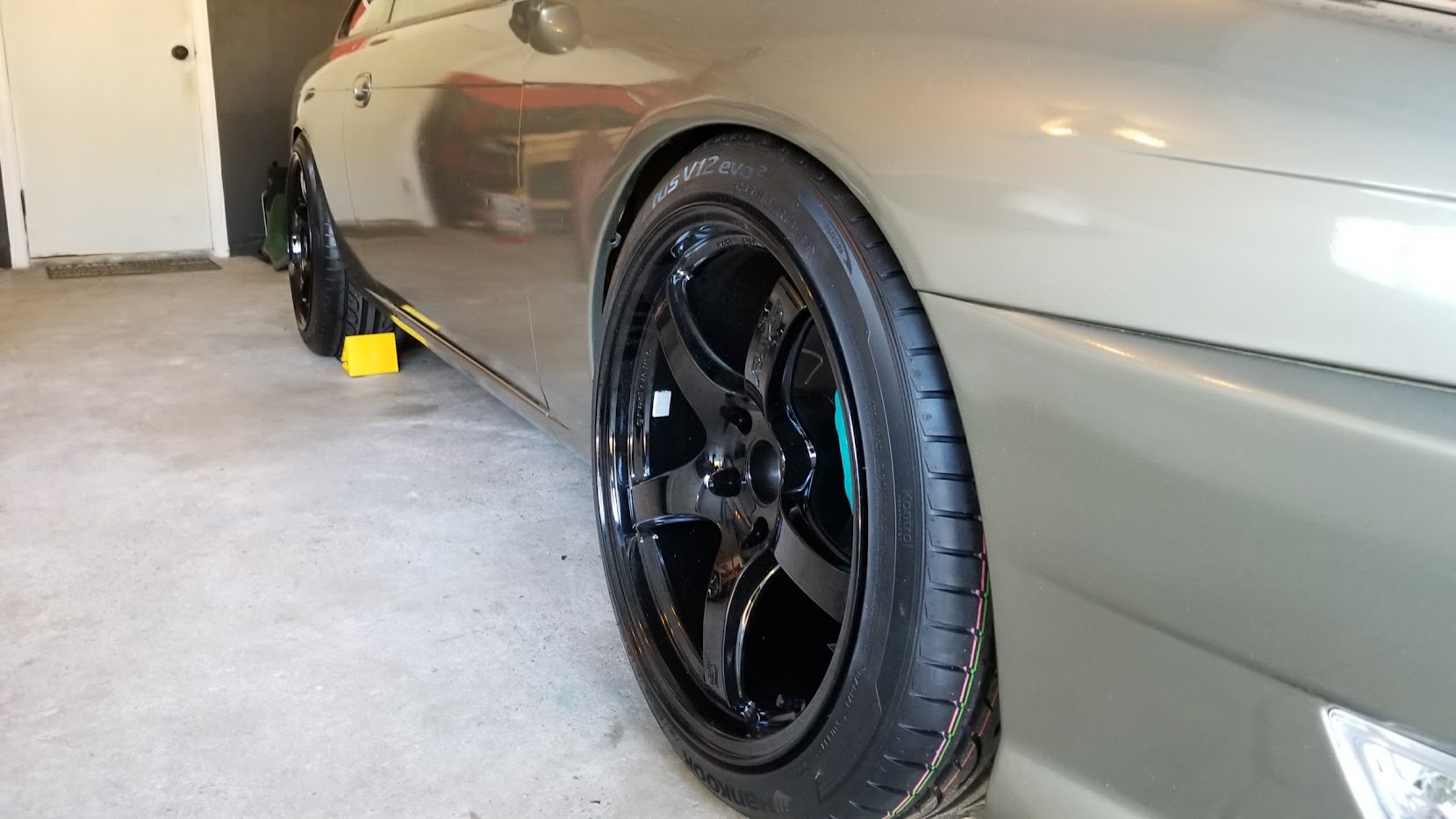

Wheels & tires
Muteki Lug Nuts
Rays 57CR Gramlights (18x9.5 & 18x10.5)
Hankook v12 Tires
Brakes
Z32 Master Cylinder

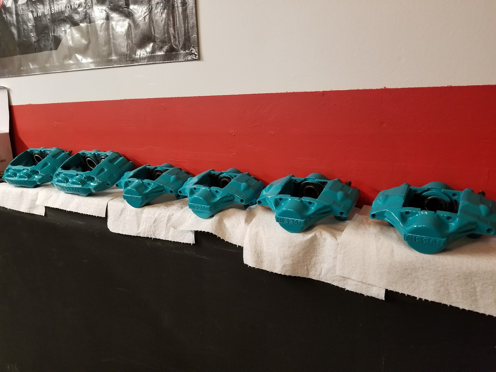

350z Front Calipers - Powder Coated Teal
z32 Aluminum Dual Calipers - Powder Coated Teal
EBC 350z Front Rotors
EBC Z32 Rear Rotors
ASD Pull Up Hydraulic ebrake and lines
DIF z32 Stainless Brake Line Conversion (Front & Rear)
New OEM Nissan 5 lug Front Wheel Bearings
Chase Bays In-Bay Brake Lines

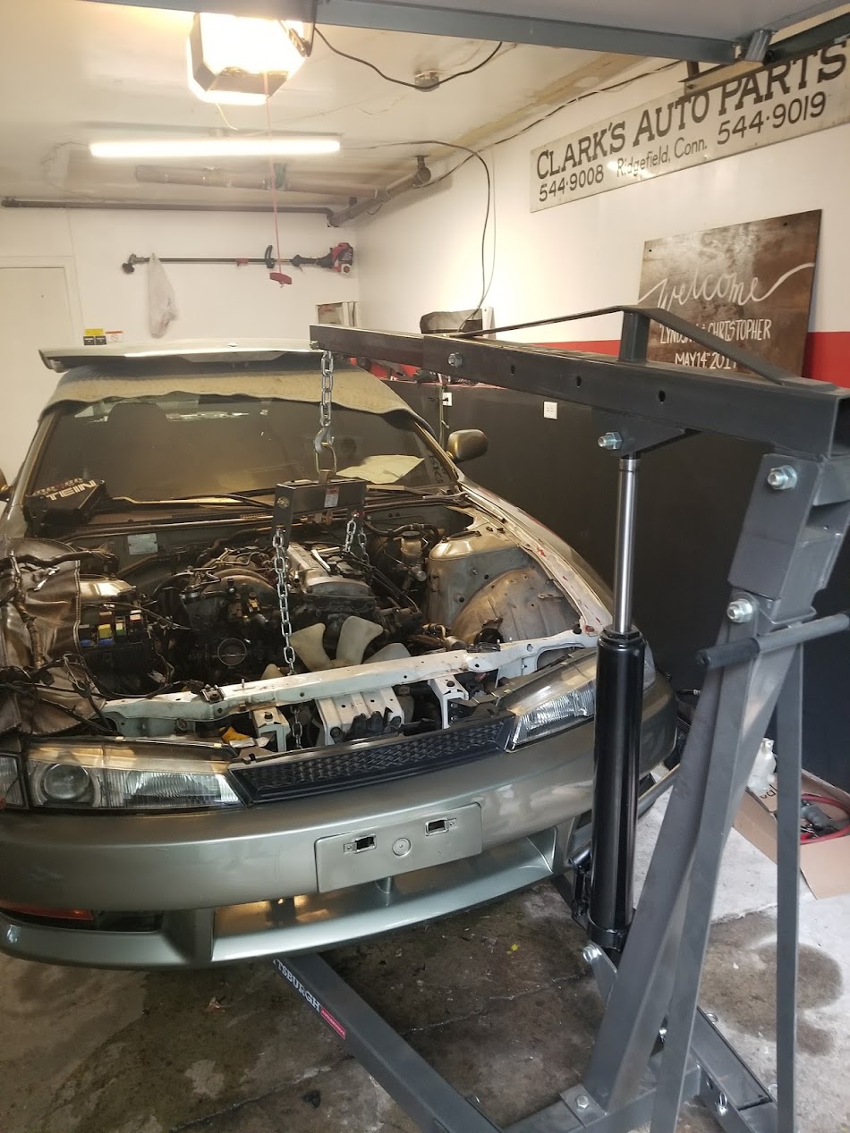

And it starts...
Pulling the stock Motor and Trans...
Cleaning the bay...
Painting the bay..
Color matched the calipers...

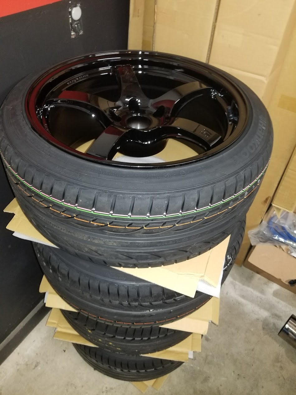

Mounted wheels and tires...
