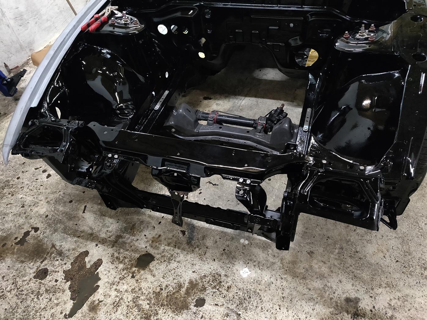

As you can see, it requires a lot of love. But luckely, im going all in on this build. Ill do as much as i can myself, and get help from my friends.

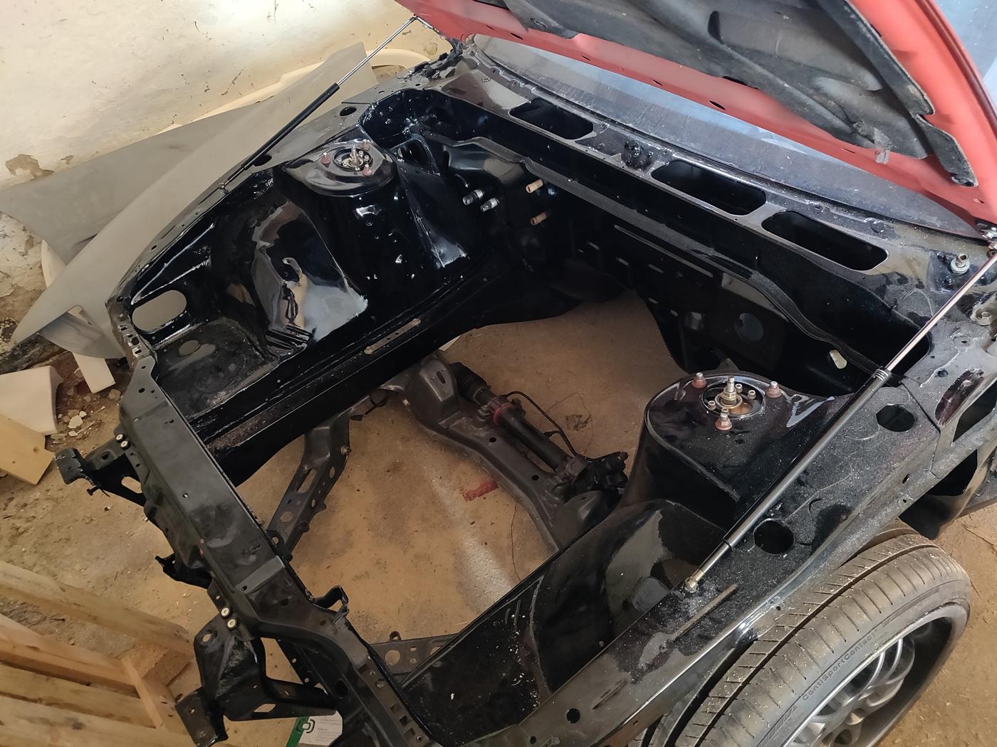

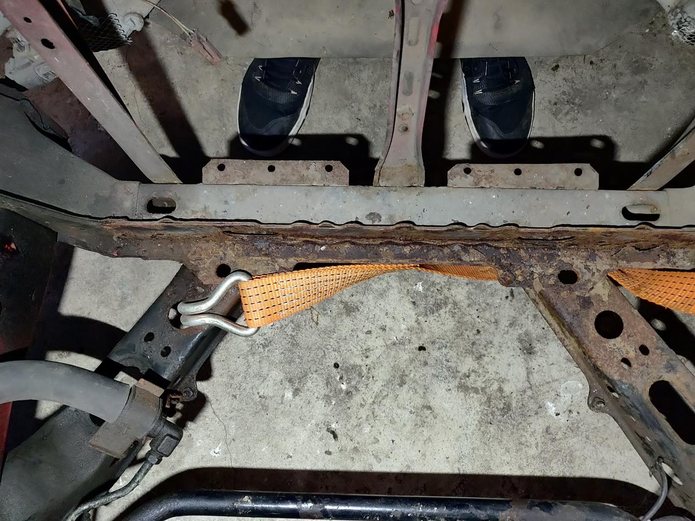

Anyway. First thing i did was to remove the subframe so i could get it cleaned up and installed new bushings.
https://billeder.bazoom.dk/biler/alb...13-ca18det.jpg
It had a lot of surfacerust. So i handed it over to a local company to get it cleaned and painted.

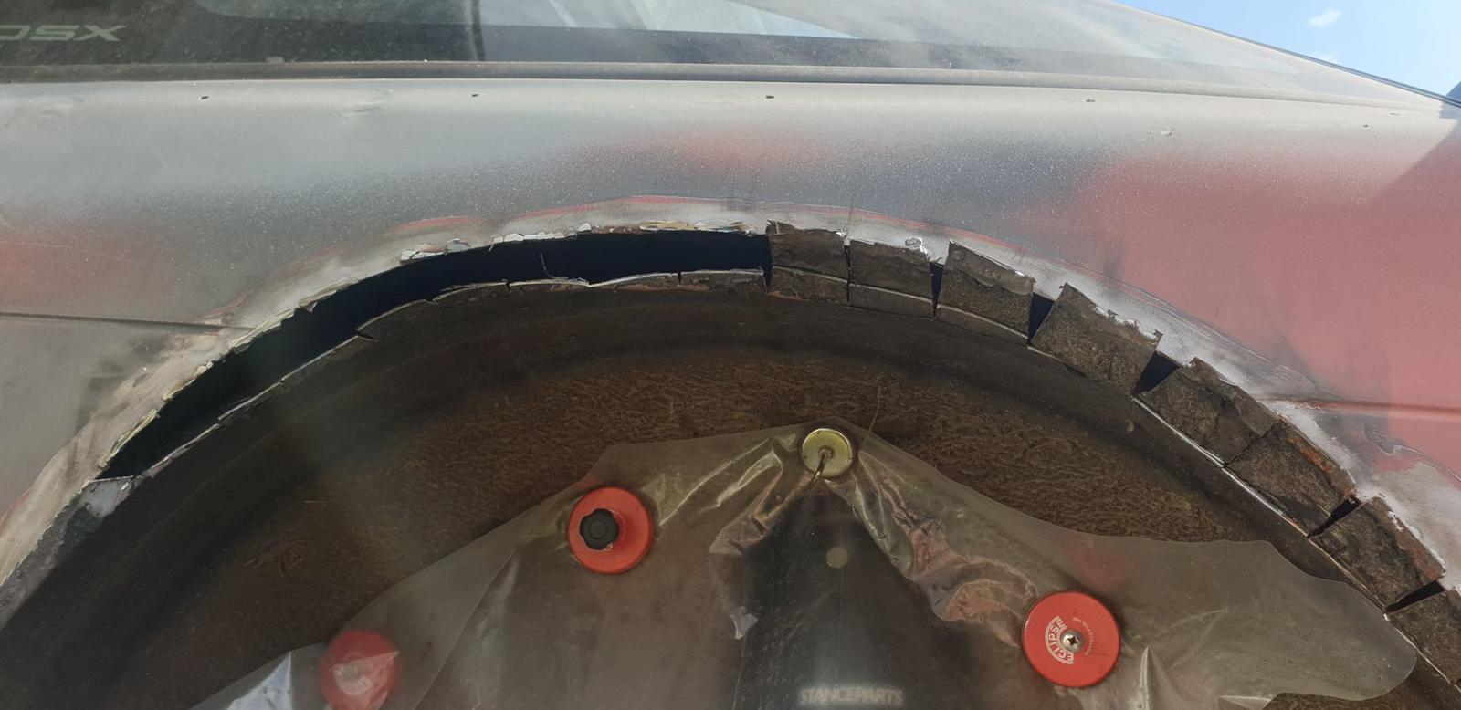

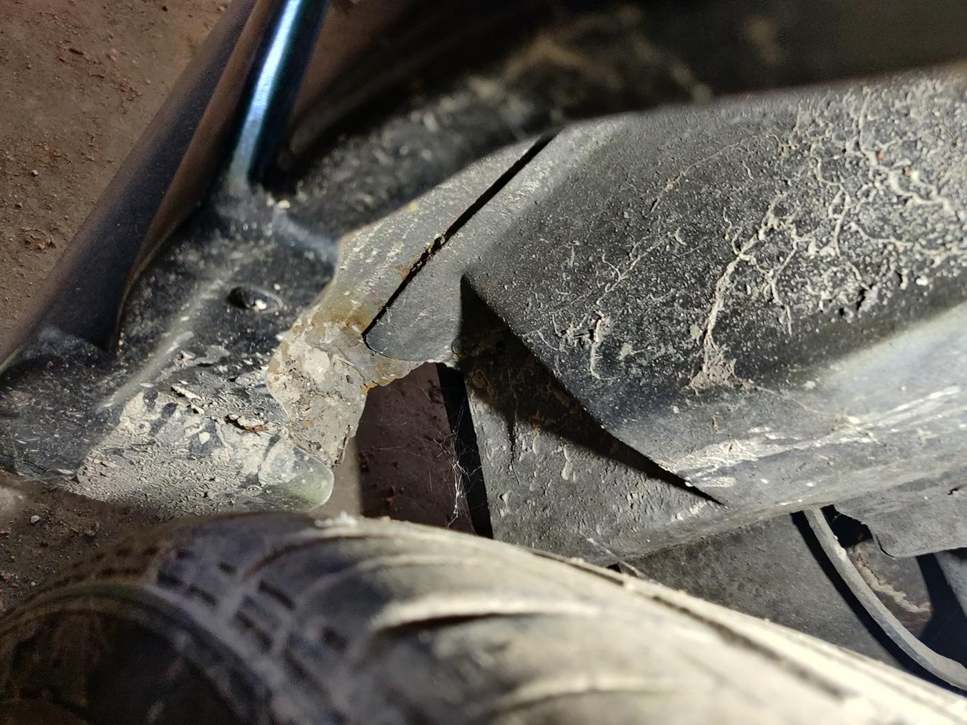

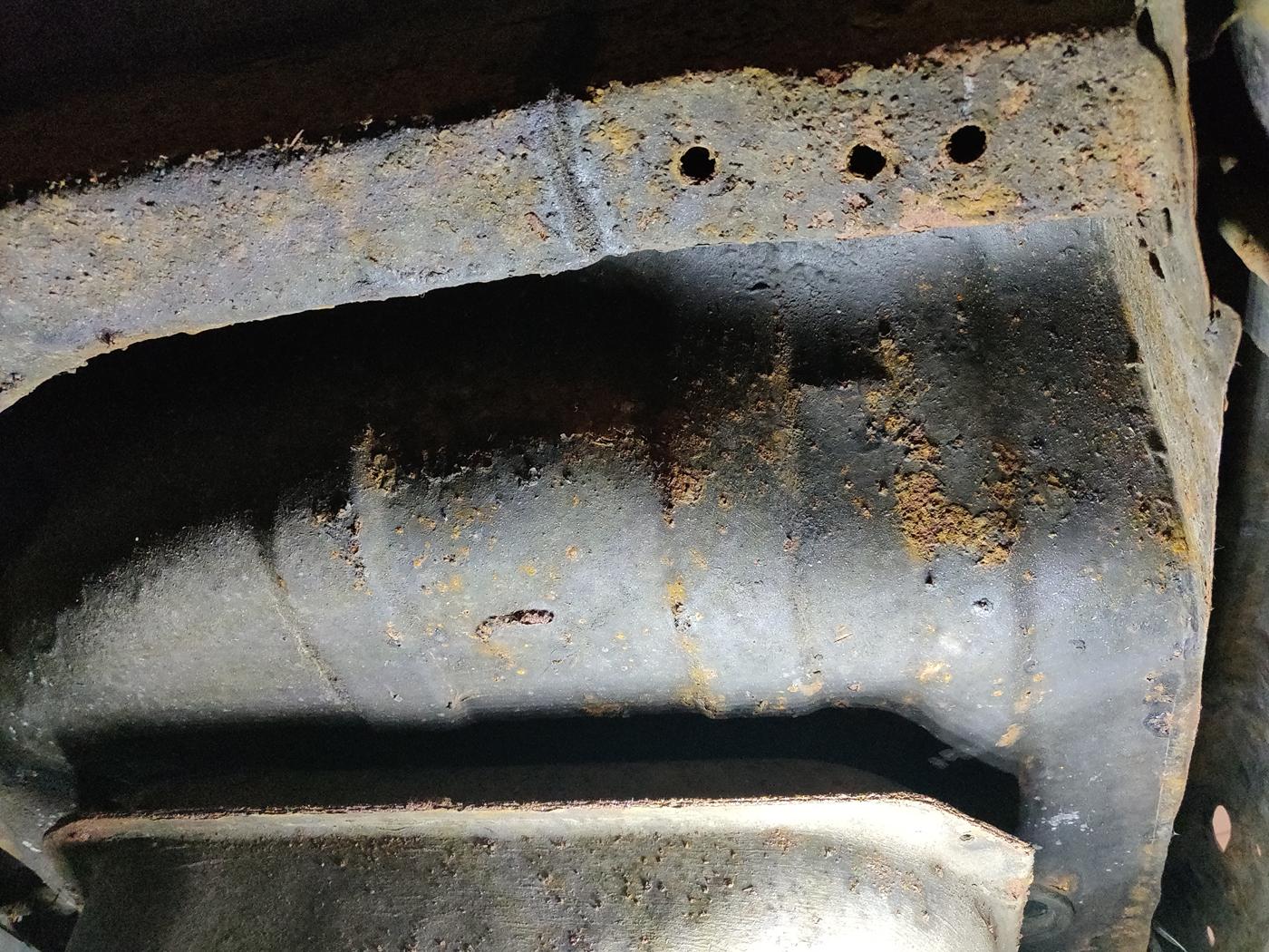

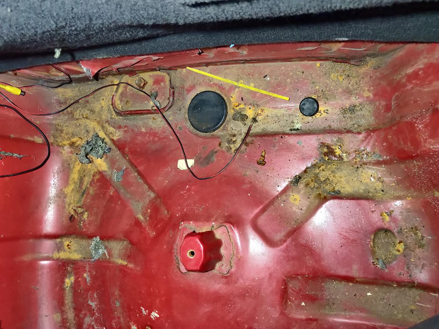

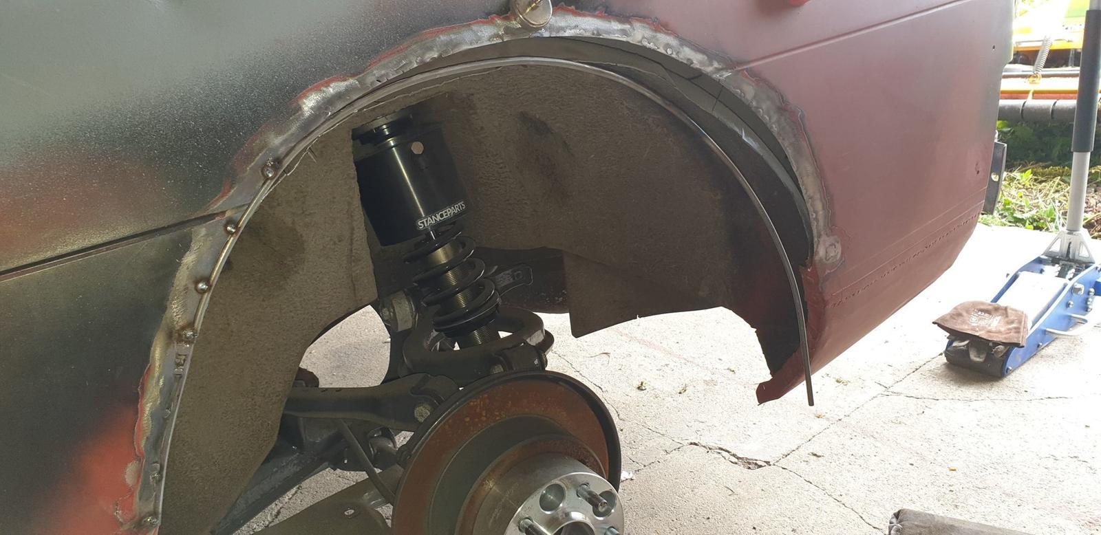

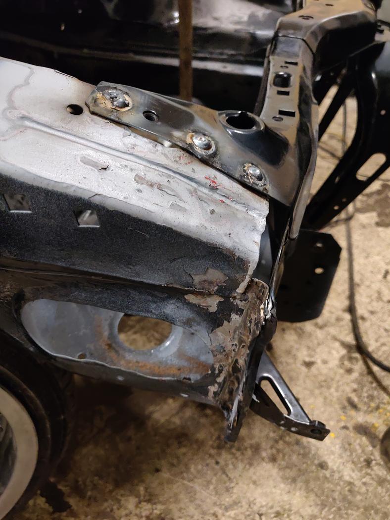

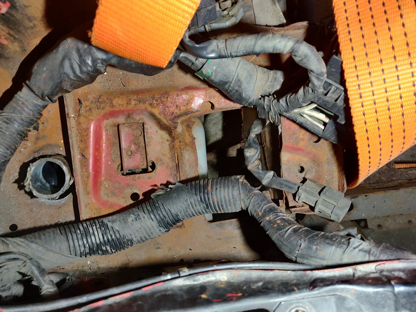

After a lot of looking around on the car i found more rust. so the best thing to do would be to cut it out and remove it. This means my front fenders have to go and the same with the rear ones.
This gave me and excuse to buy wider fenders.
I ended up with 30mm in the front and 50mm in the back

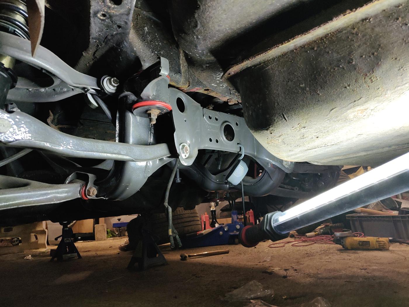

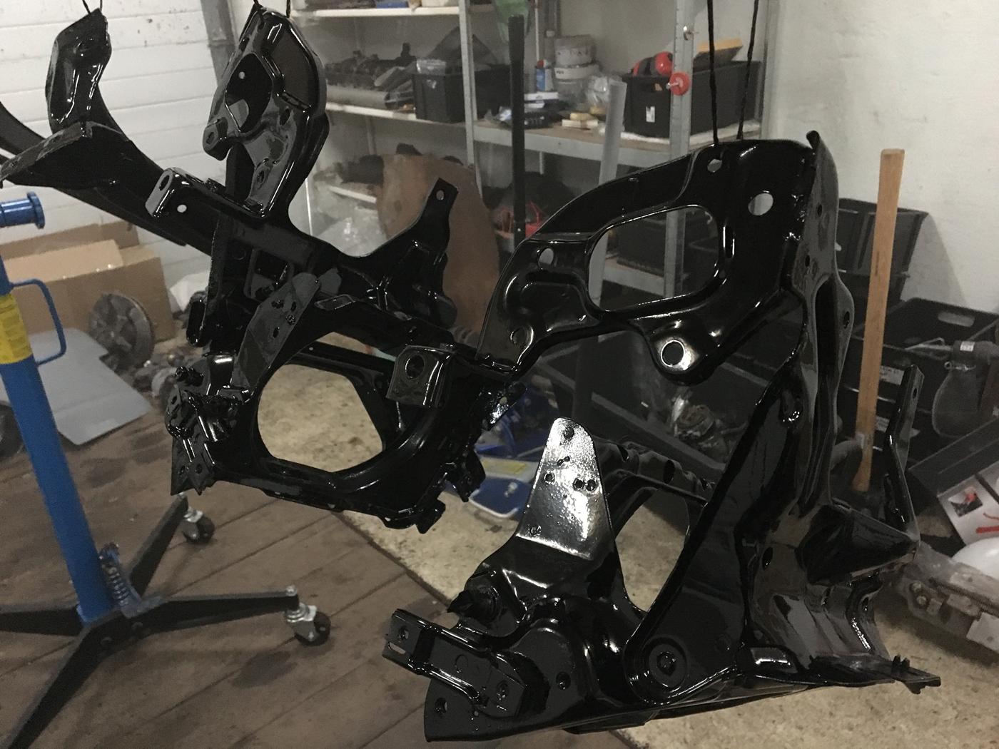

The subframe and arms came back from the local shop and have been blasted and powdercoated. I wanted to go for a bronze/copper color, but they didnt have any i liked. So i went for a BMW grey color with a bit of flakes in the clear coat.
Its hard to catch with a camera, but here you get the idea:
Poly-bushings installed and i could put it all back together
It looks so wrong that the whole car looks shity, but the subframe looks like new. This might be the new ratlook :P https://billeder.bazoom.dk/biler/alb...13-ca18det.jpg

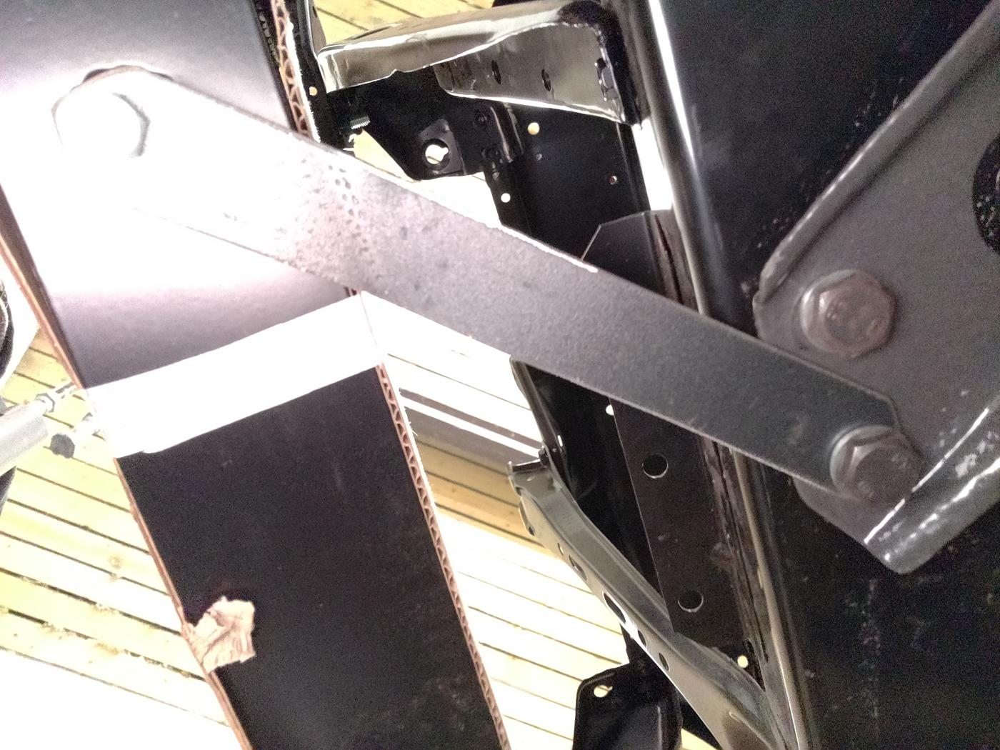

And because of the steering wheel, i would like to have nice and precise steering, so i went for a solid steering bushing.

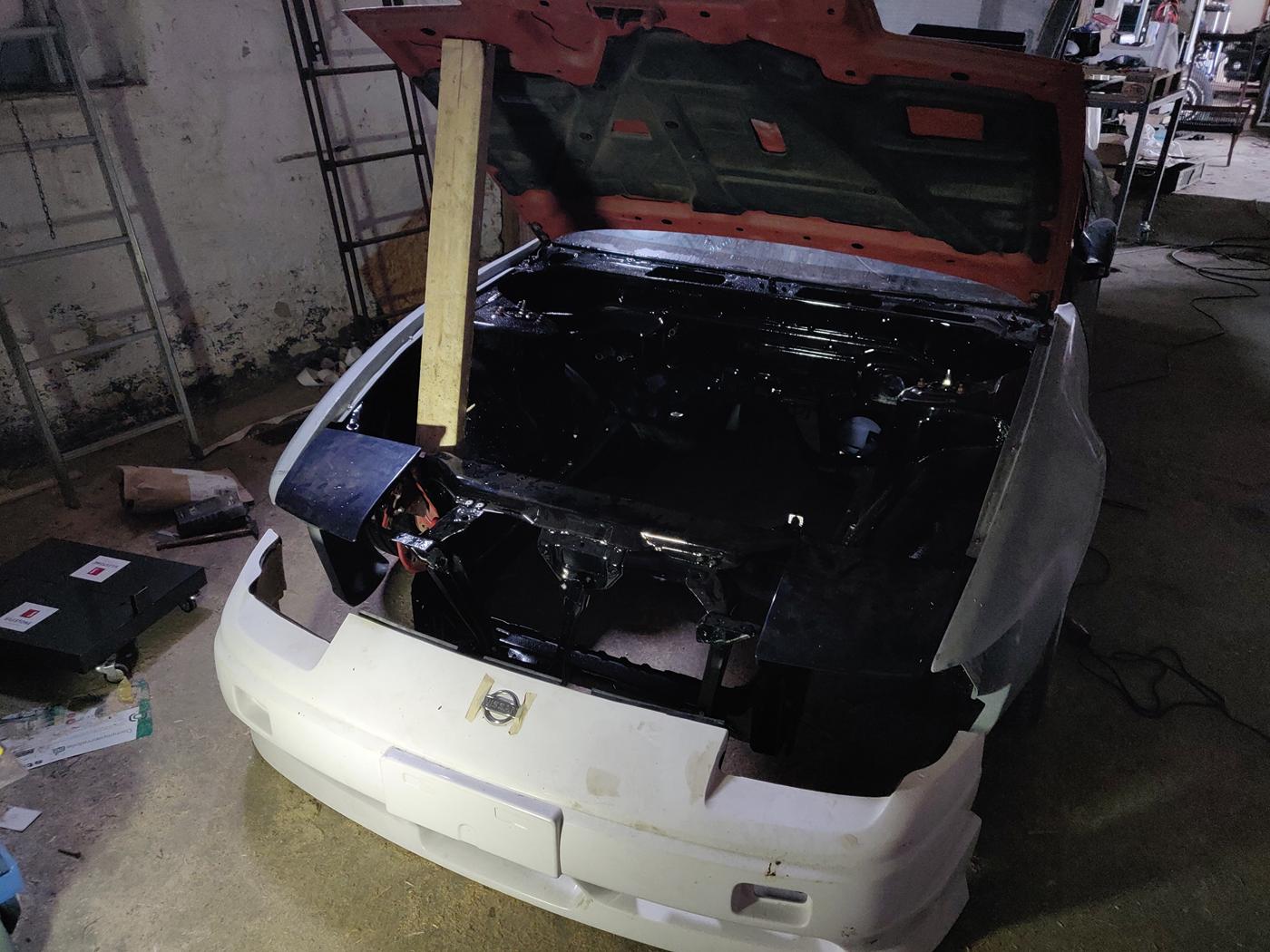

Anyway. The day i had to remove the car from my work was getting close. So i had to install as much in the car as possible. i took this opportunity to see if all the interiorpieces was included in my purchase.

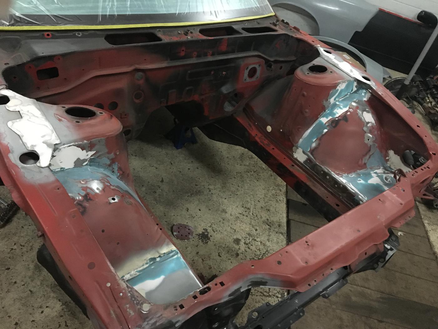

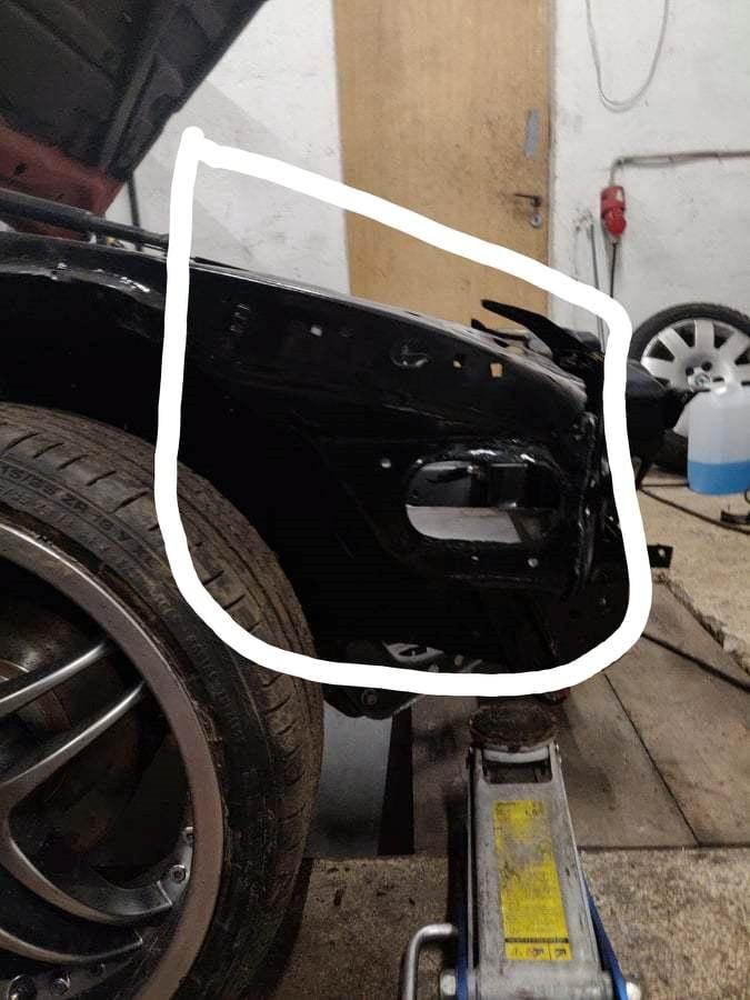

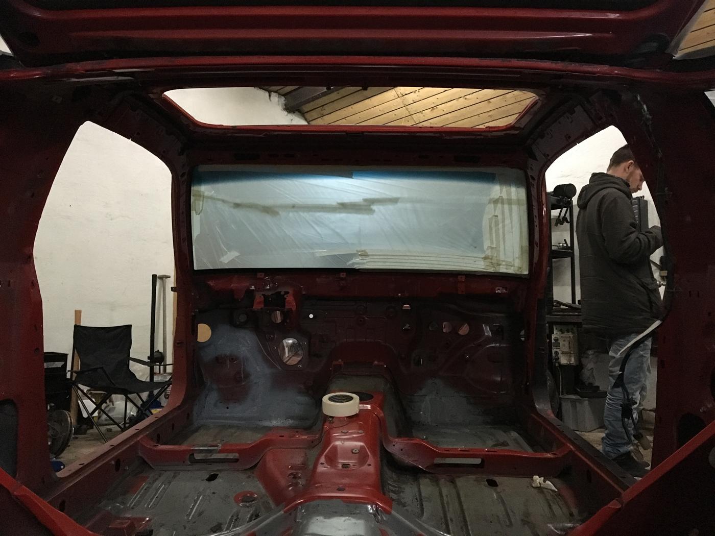

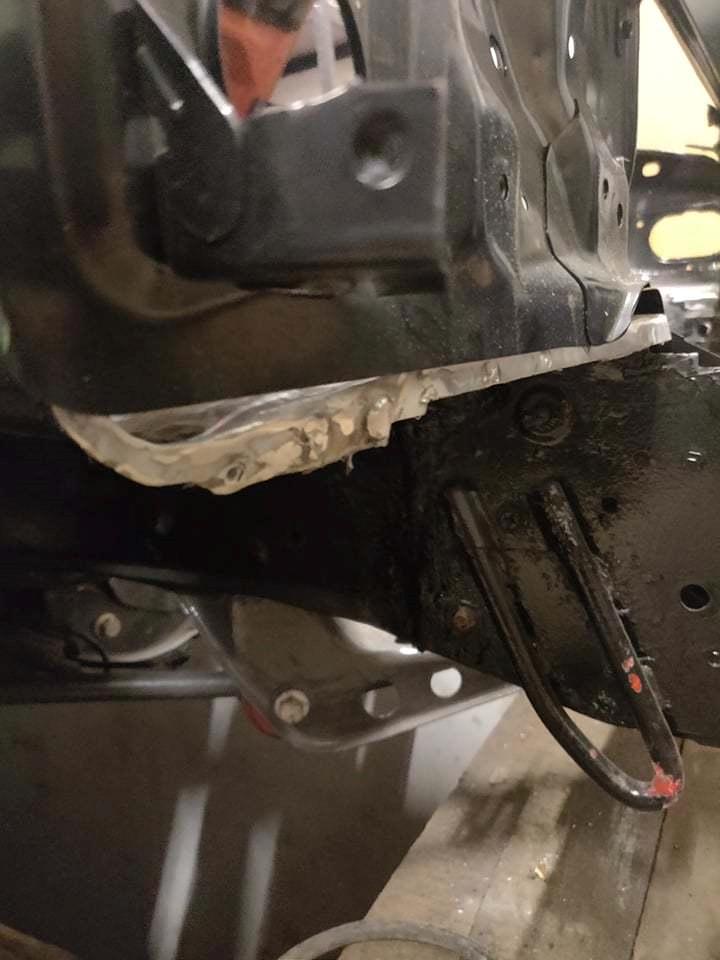

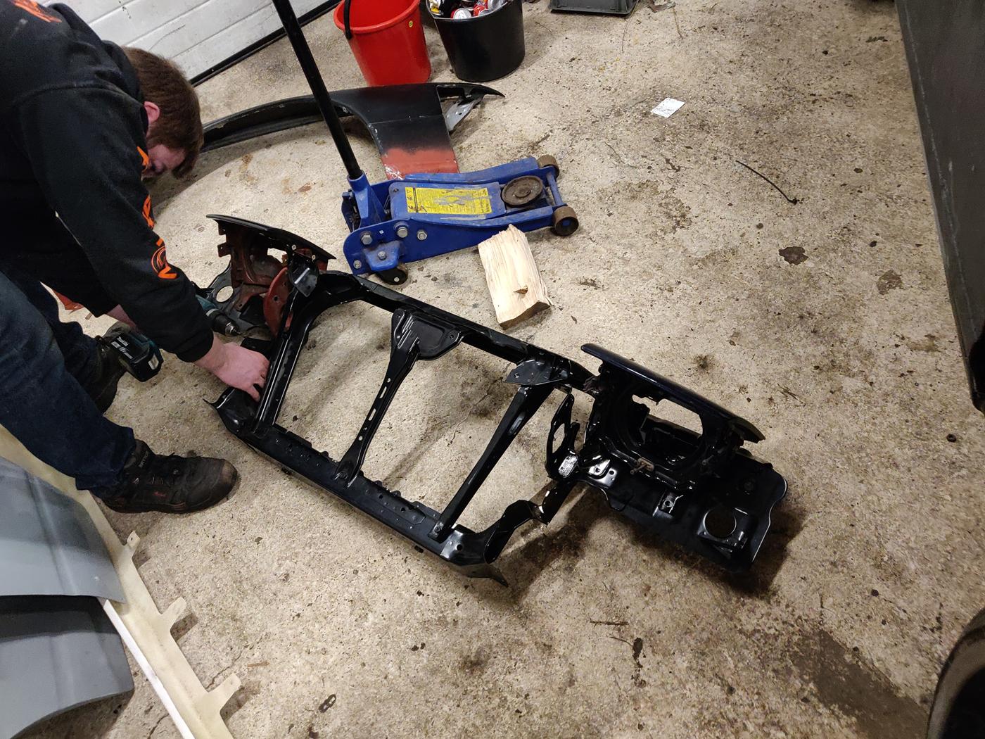

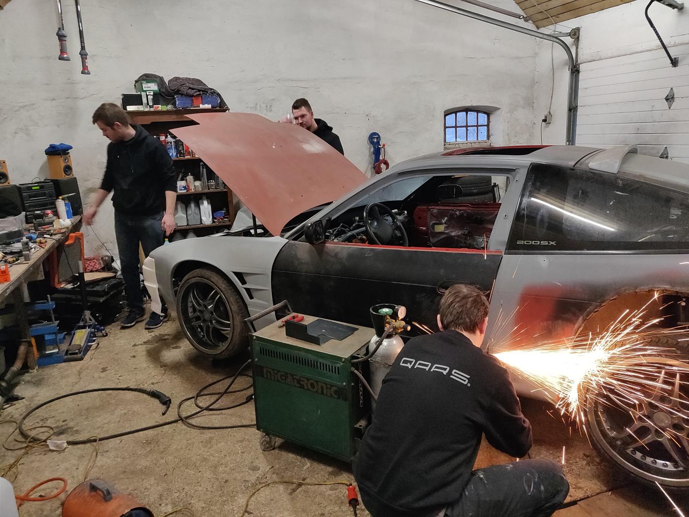

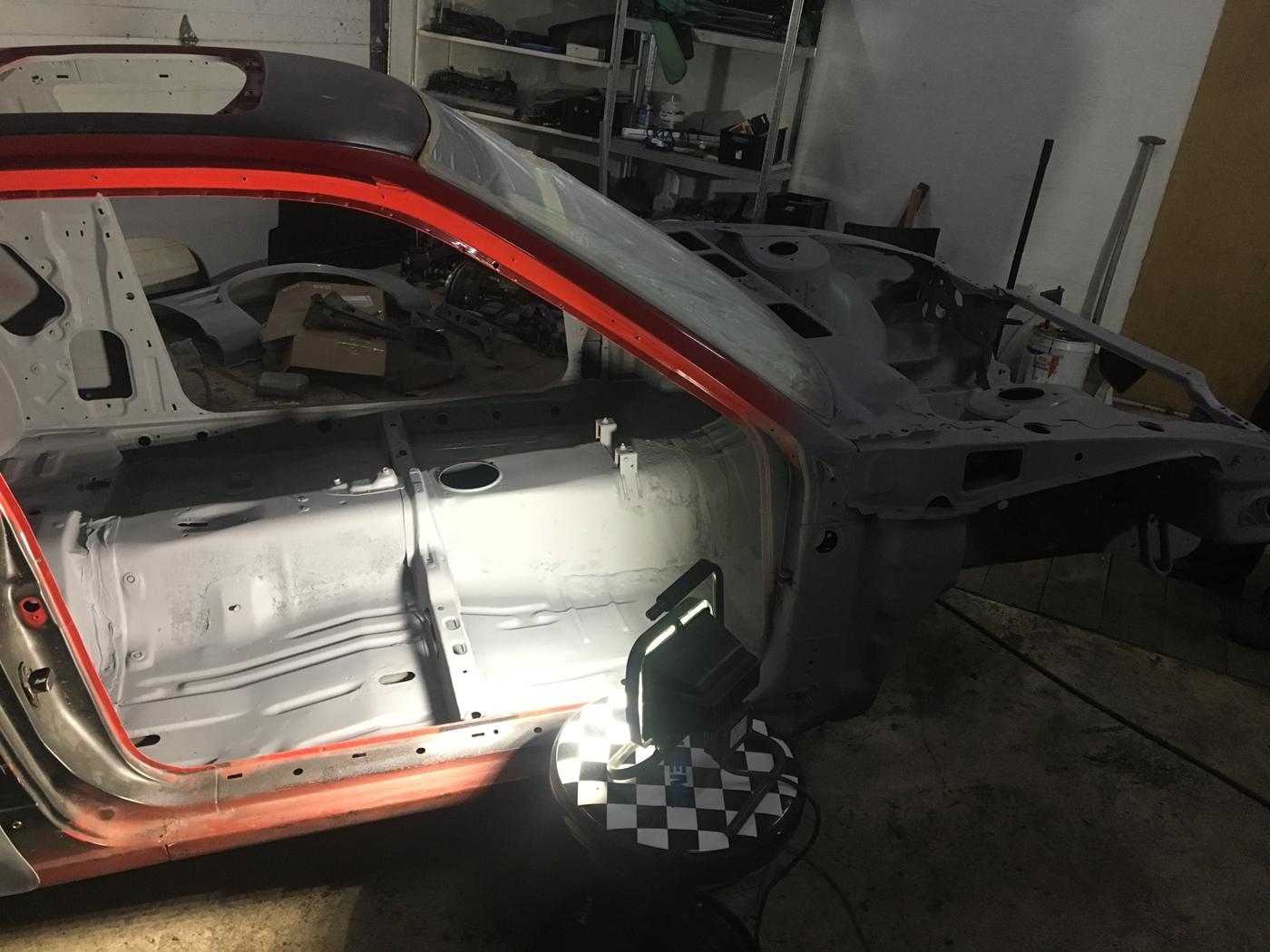

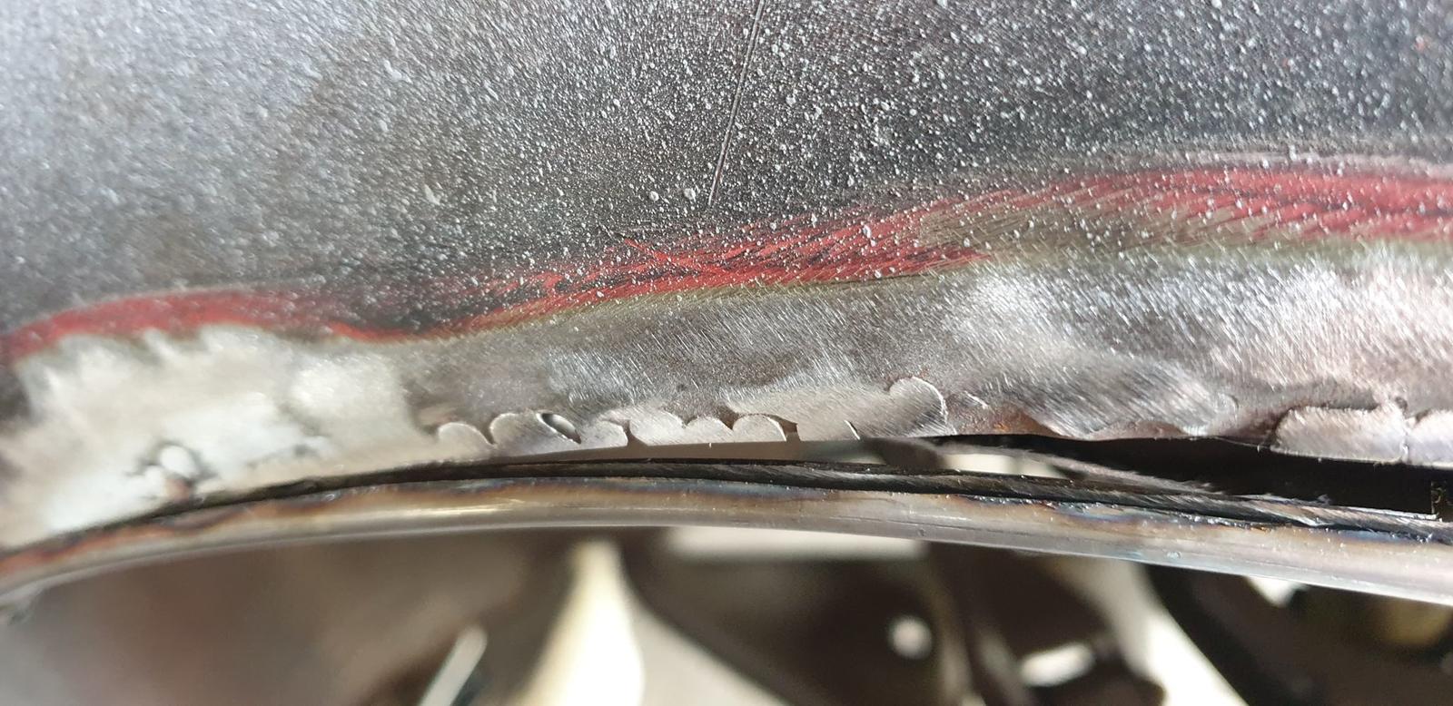

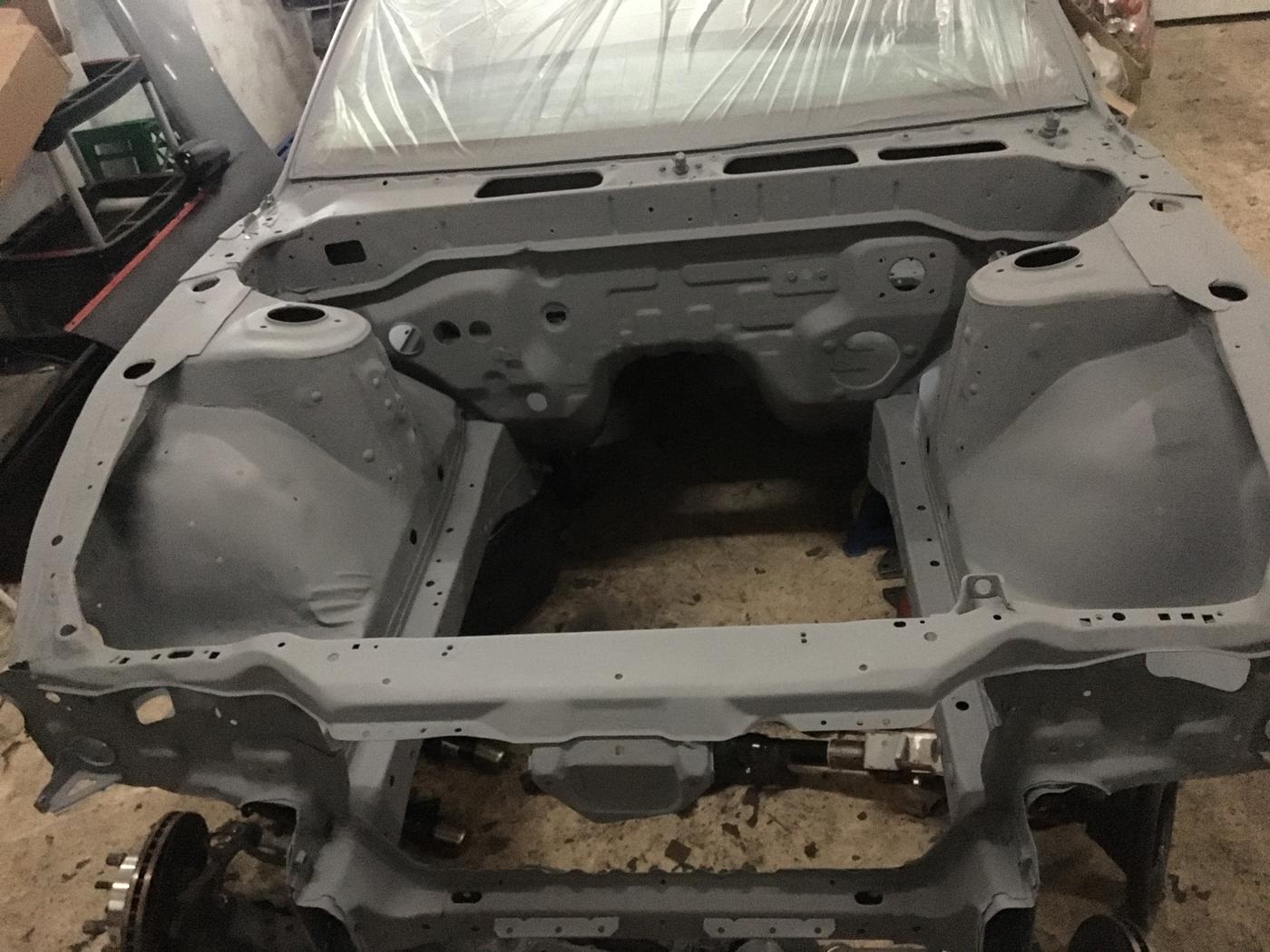

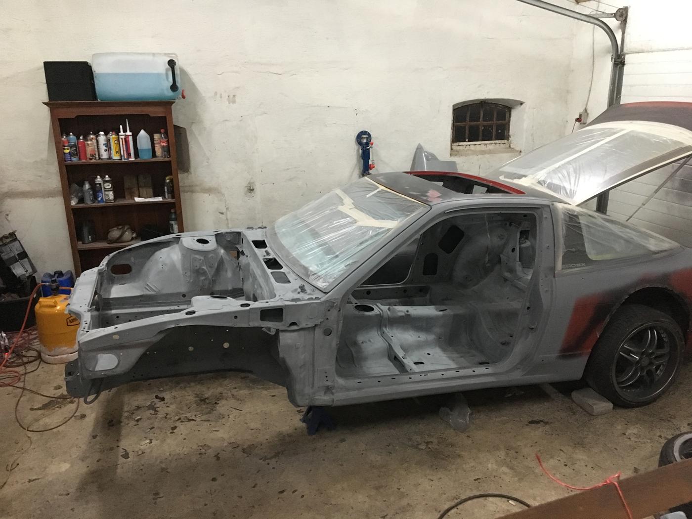

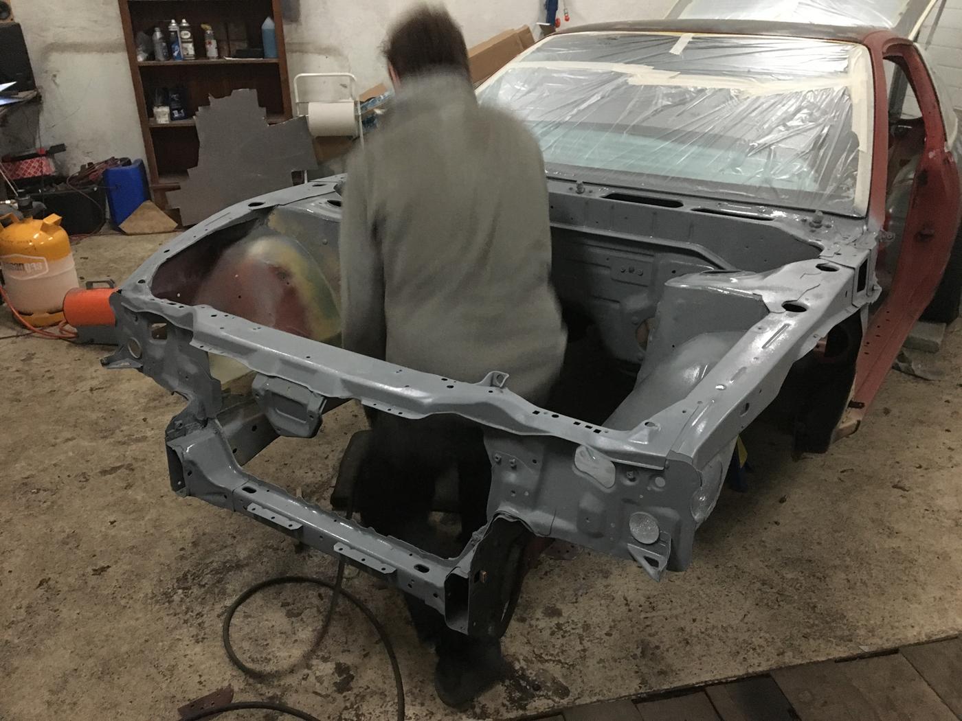

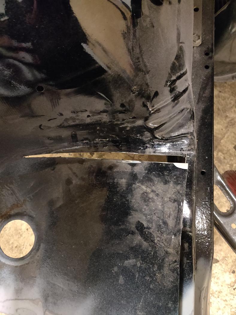

My friend started to look into the rust there was on the car and at the same time cut out the original fenders to make space for bigger wheels under the wide body.

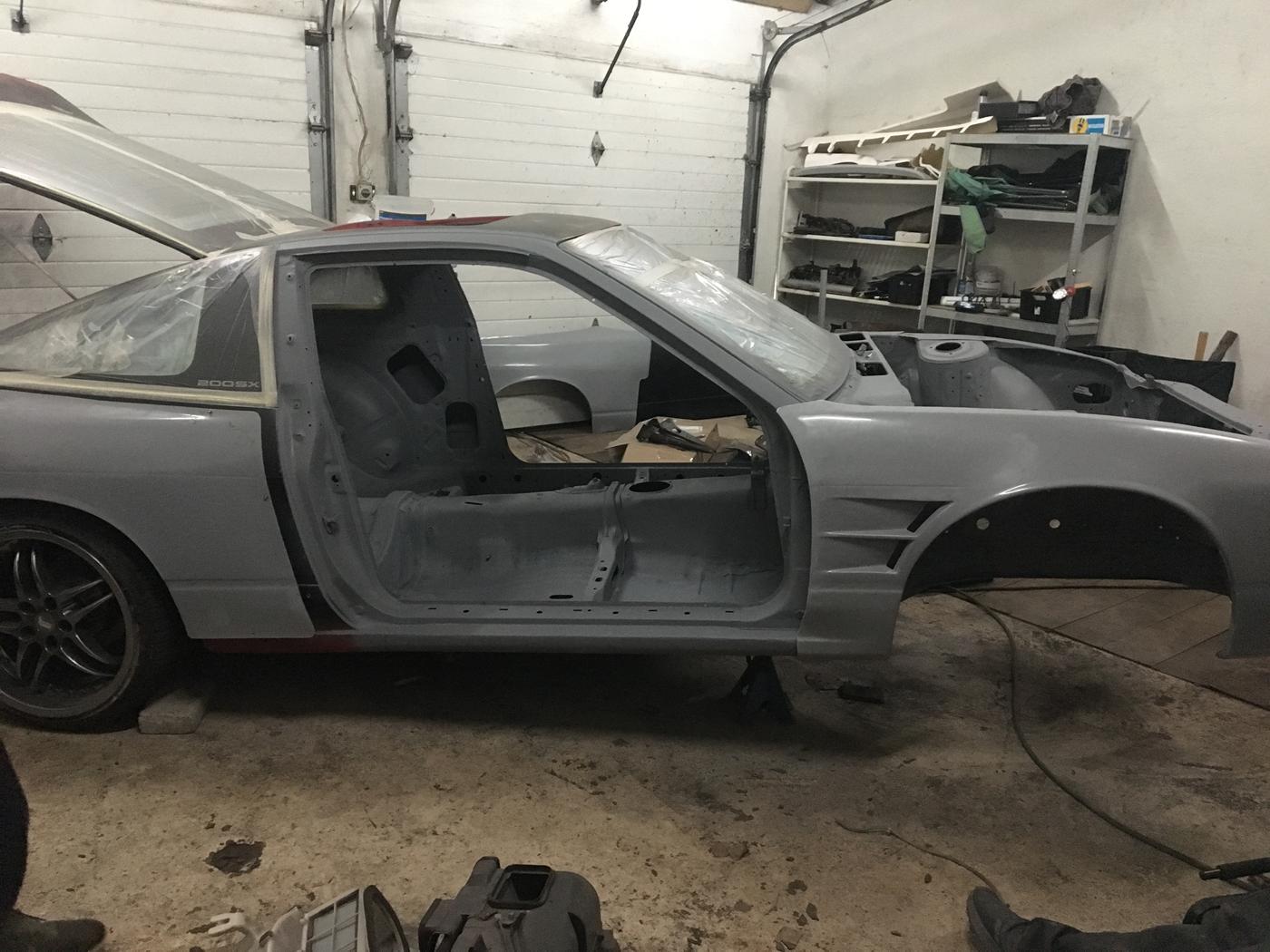

Testfitted the overfenders. And DAMN! Its gonna be wide!

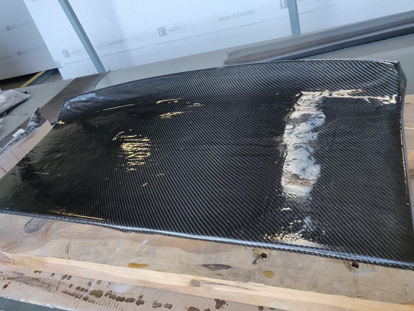

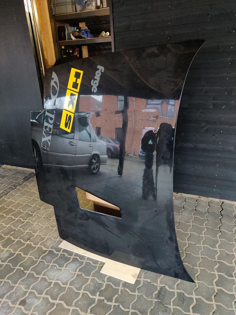

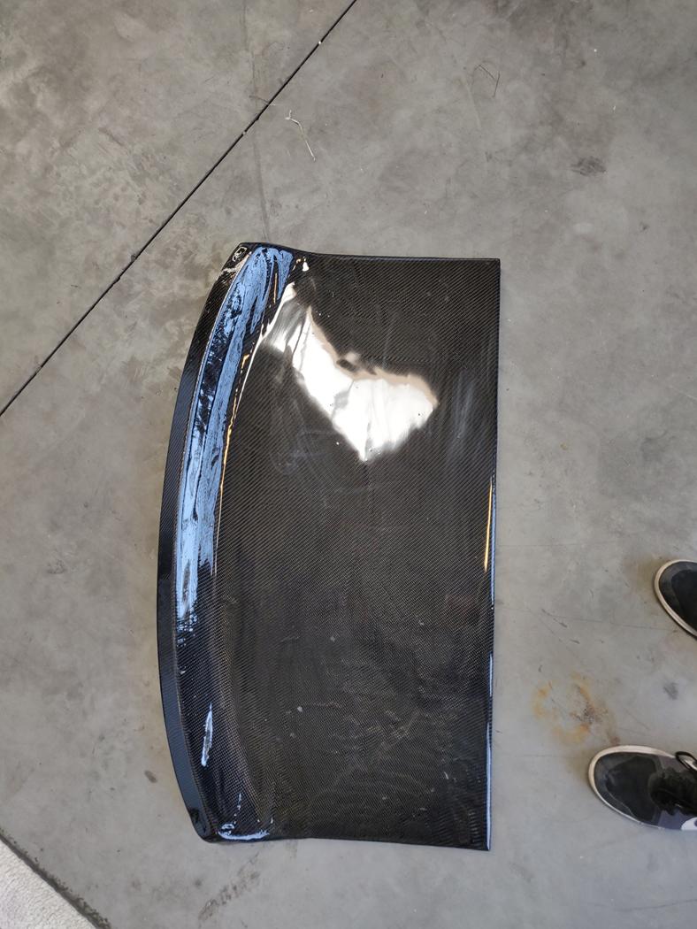

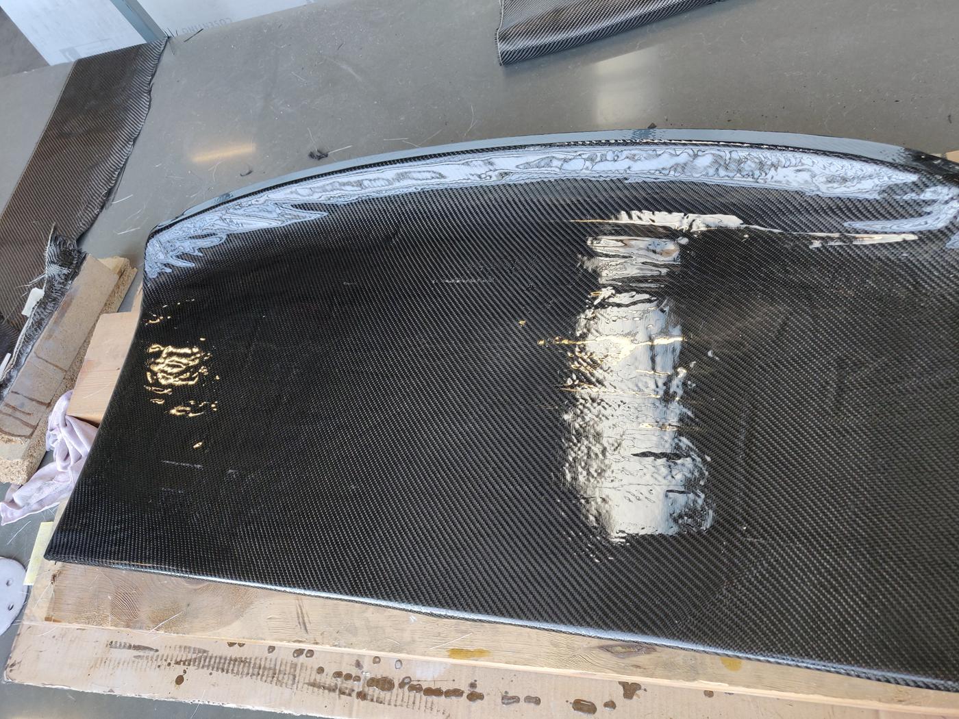

So. i also wanted something else than the Kouki spoiler. So i ordered a roof spoiler and a 326 Power Wing from JDMbodyshop where the rest of the fibreglass is from. Unfortunally the 326 spoiler was in so bad condition when it arrived, i had to scrap it. The same with the overfenders as the fitment was so bad we could not get it to fit properly. So i found a set of OriginLabo 40mm for the front and 50mm for the back.

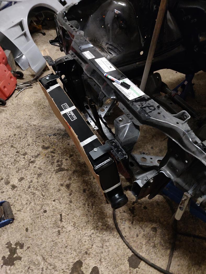

With a balck Mishimoto intercooler and oil cooler, it was pretty obvious that i also needed black silicone hoses for the intercooler piping

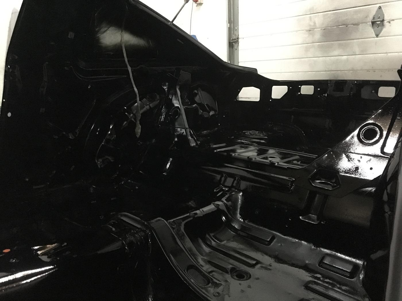

A few weeks ago i had to pick up my painter so we could work on the car. I asked him if i should being some tools. Only thing he replied: If you are coming before 11, bring beer. So this was the only right way to bring him beer :P
Its Carlsberg red. If you can find it anywhere, try it! Its fantastic! (Yes, im from Denmark and Carlsberg is danish)

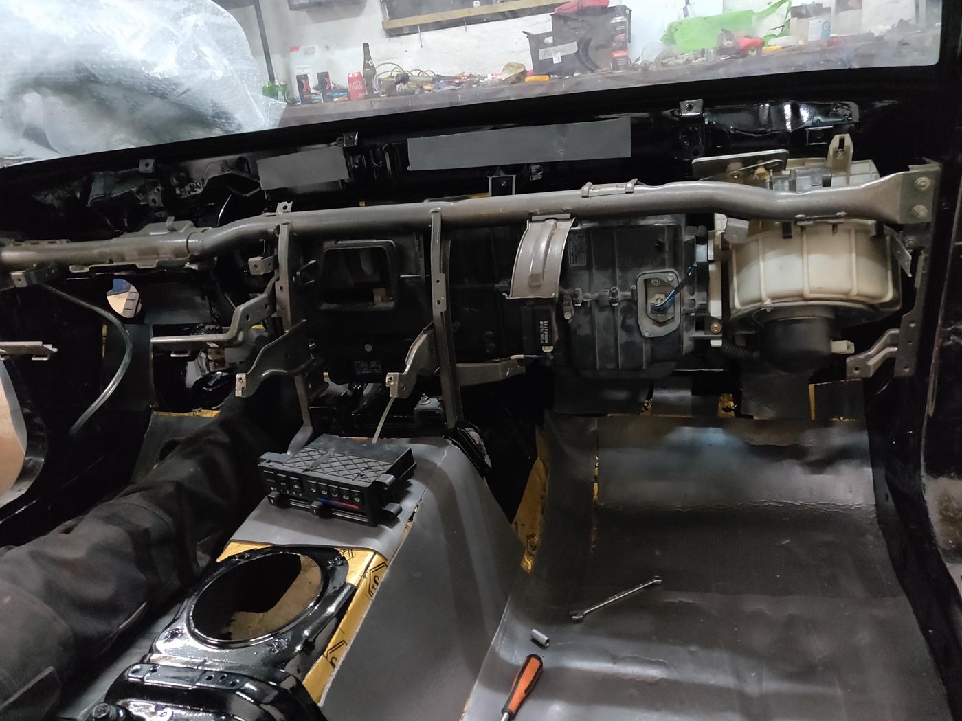

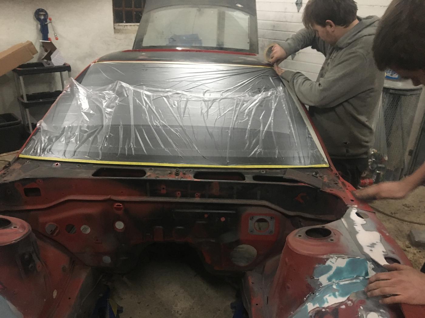

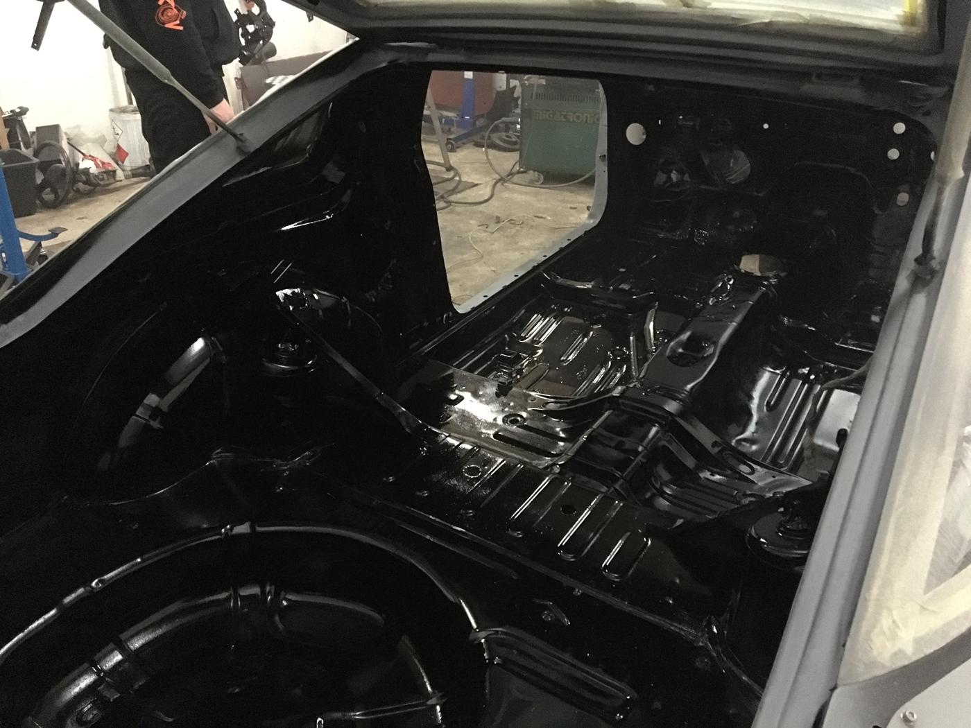

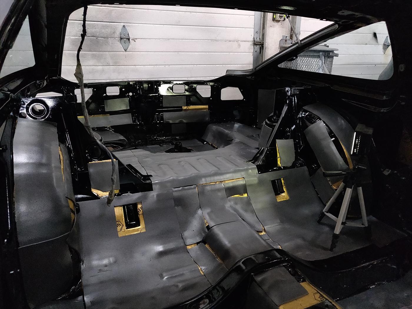

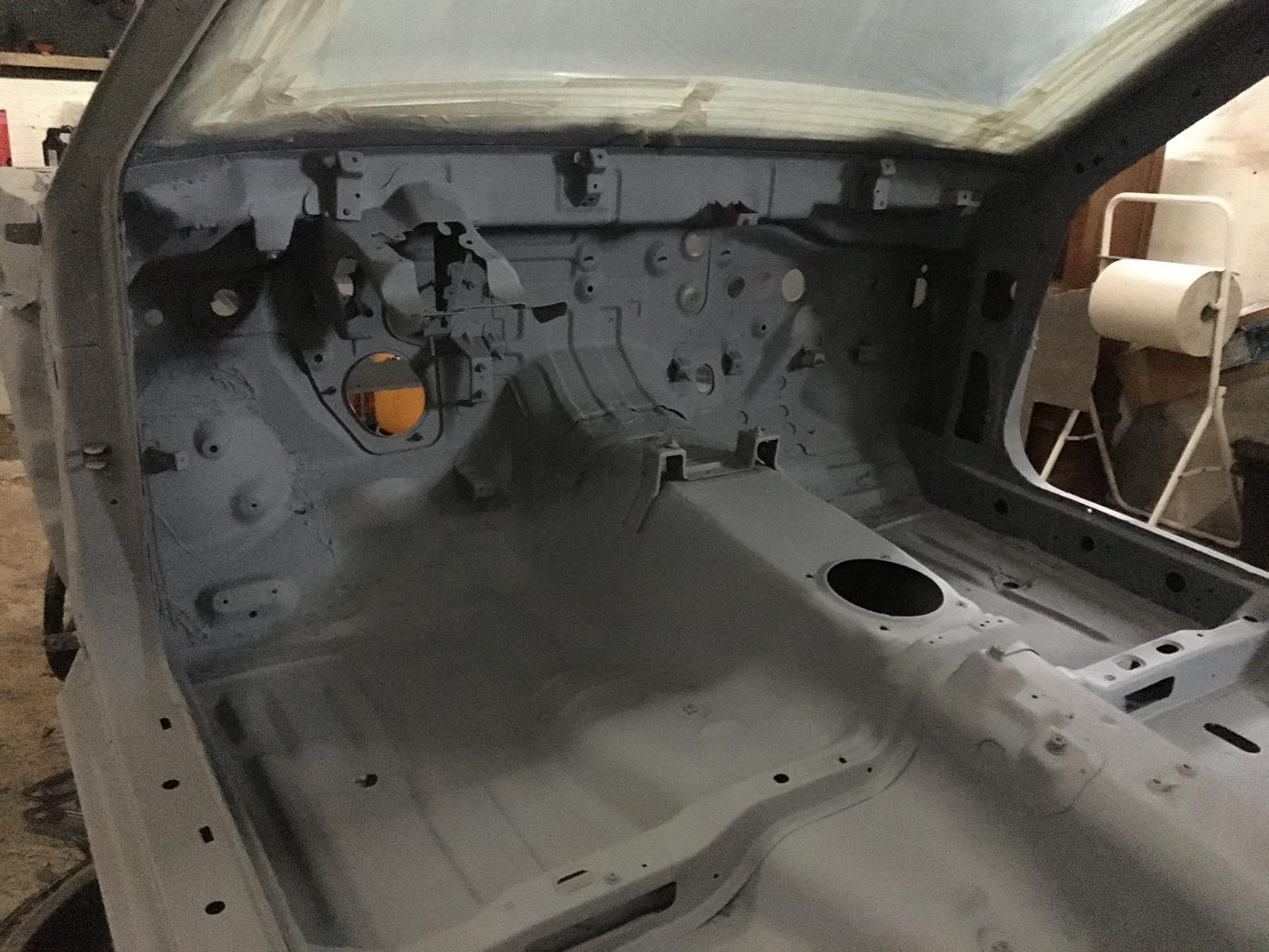

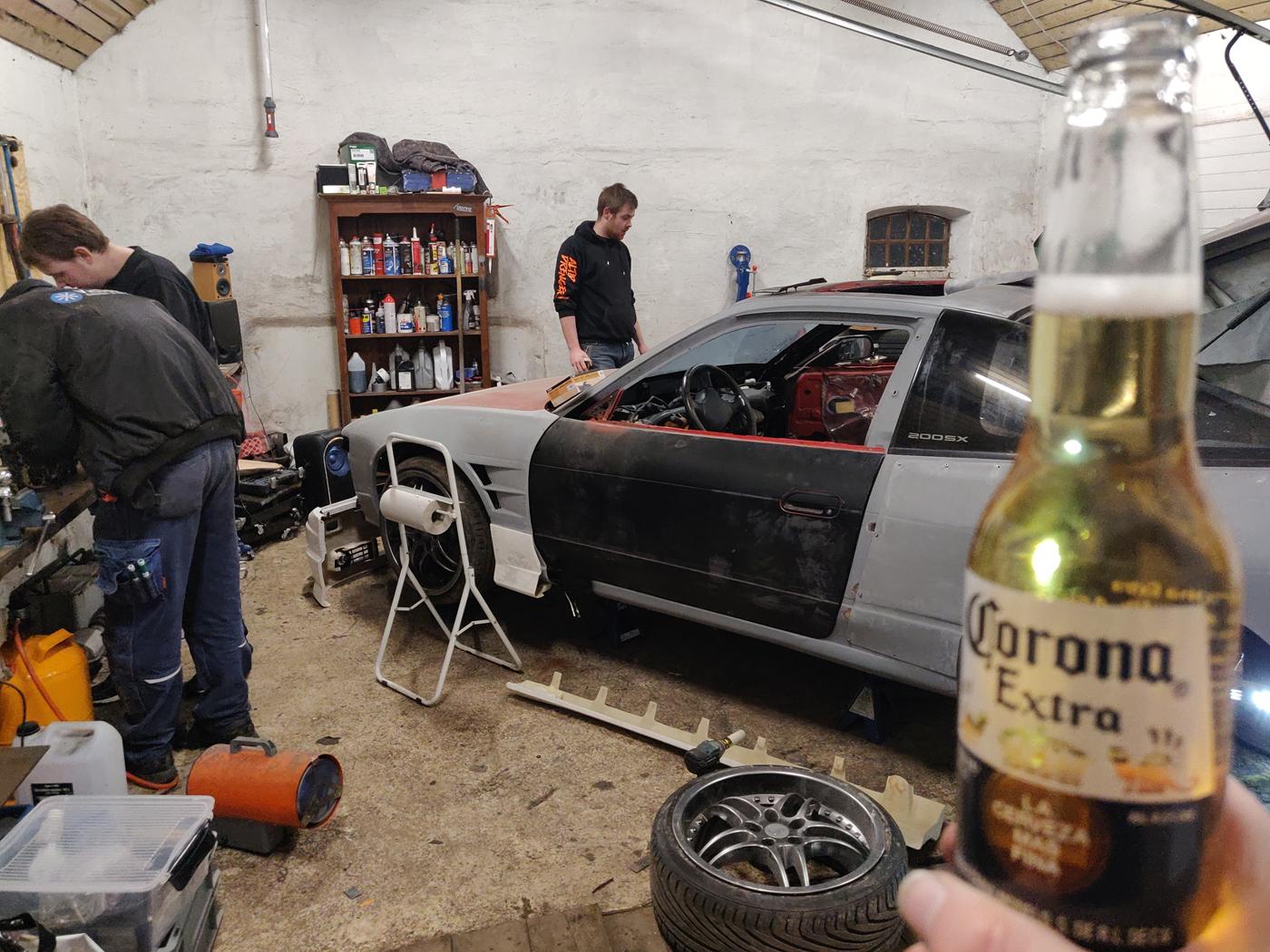

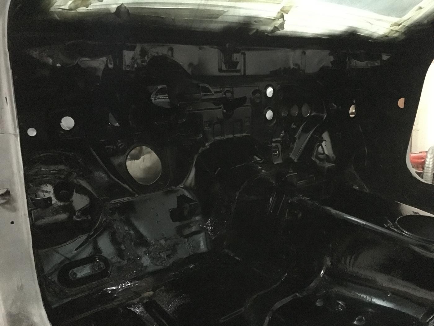

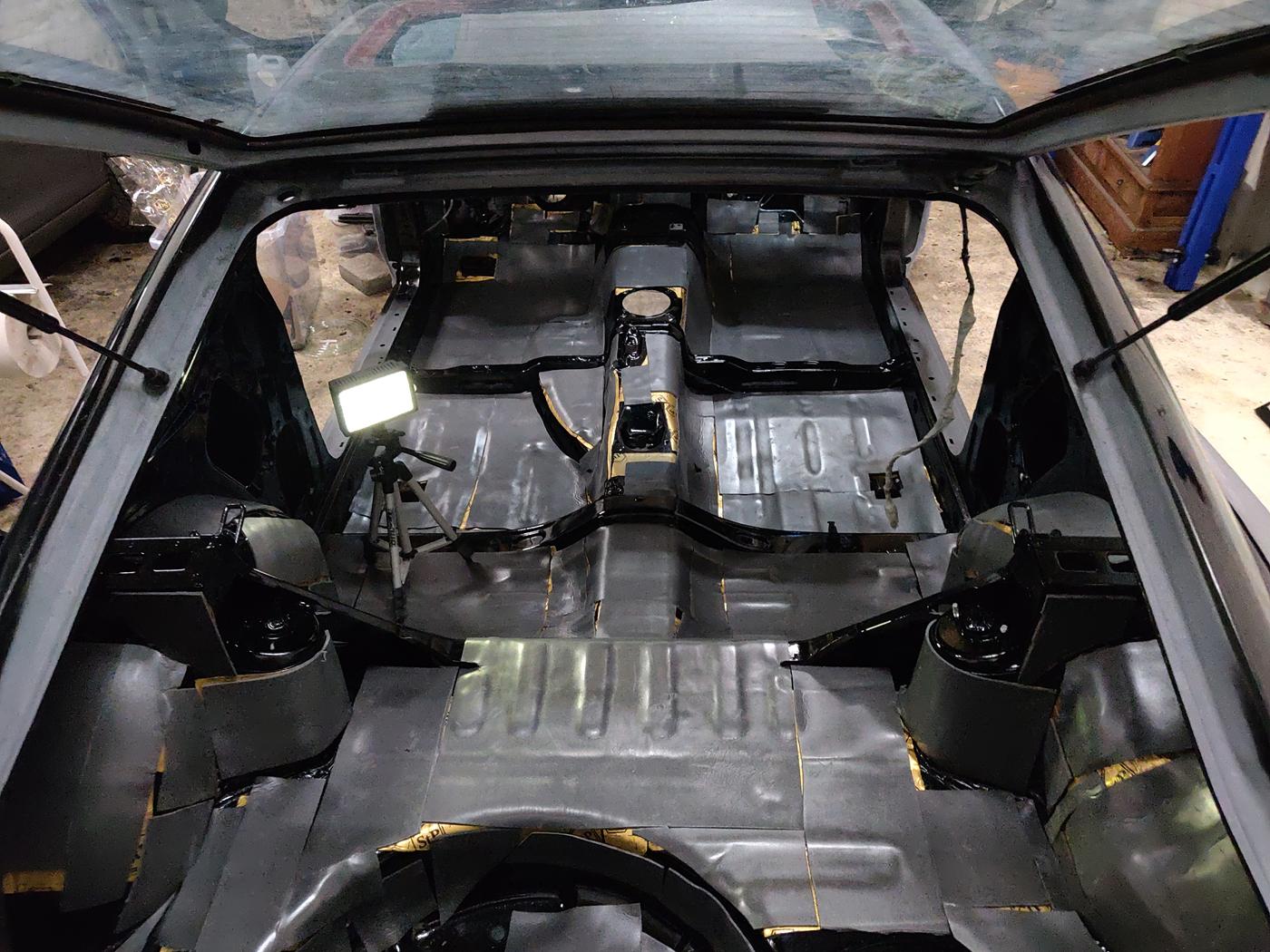

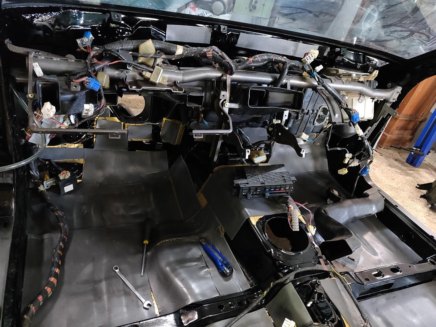

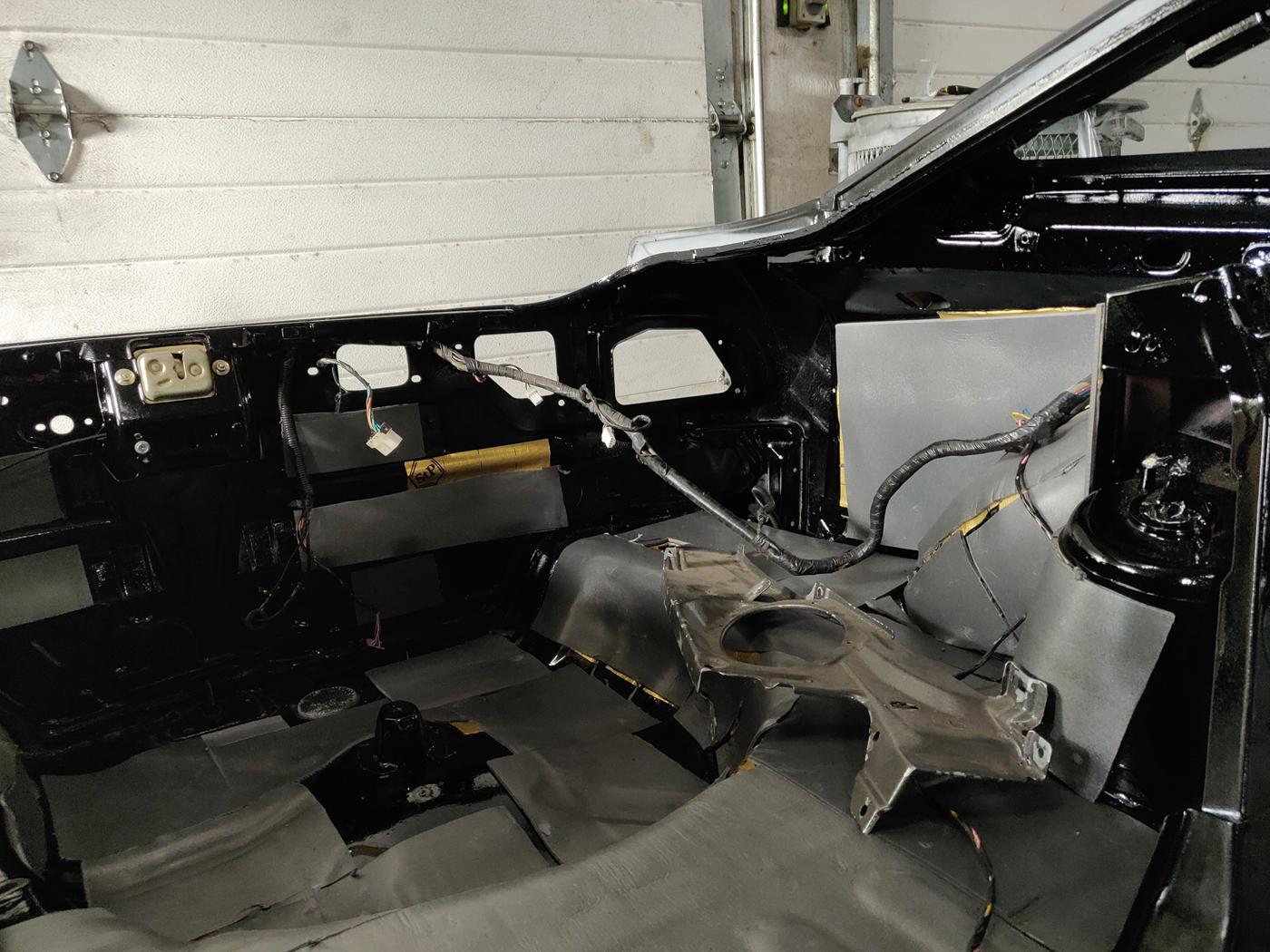

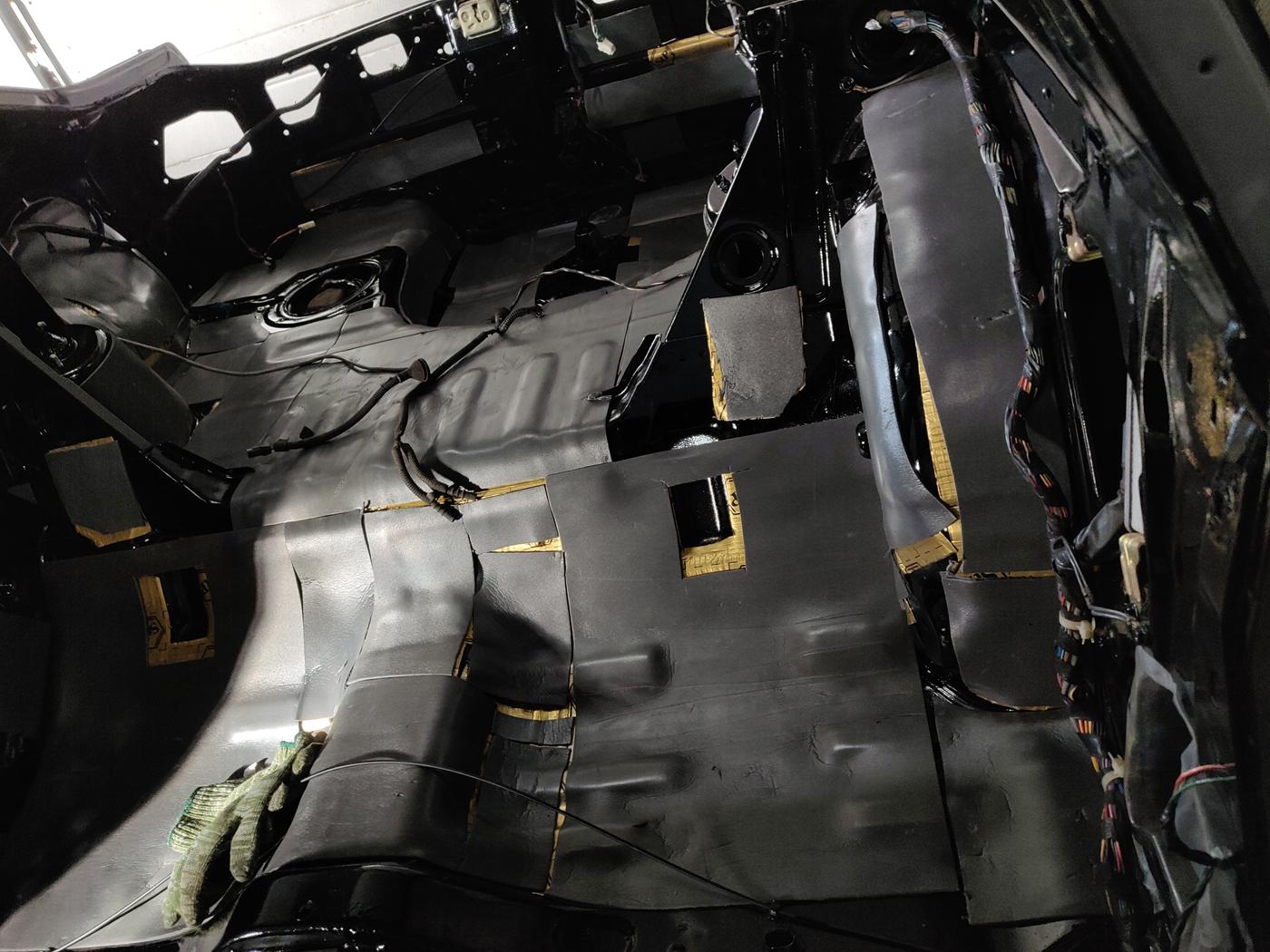

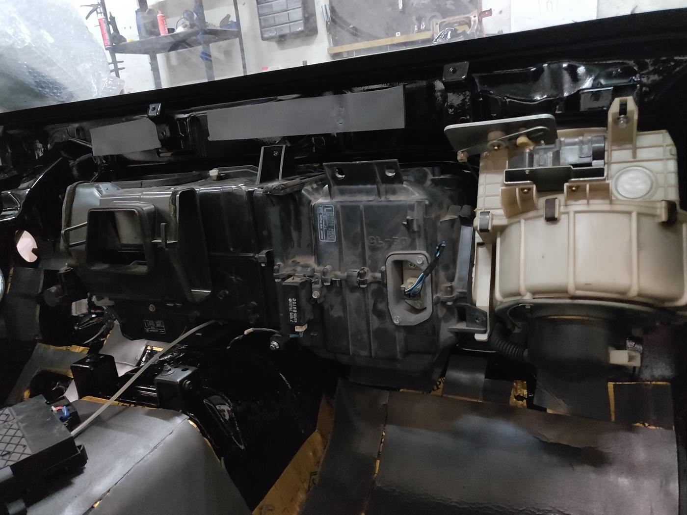

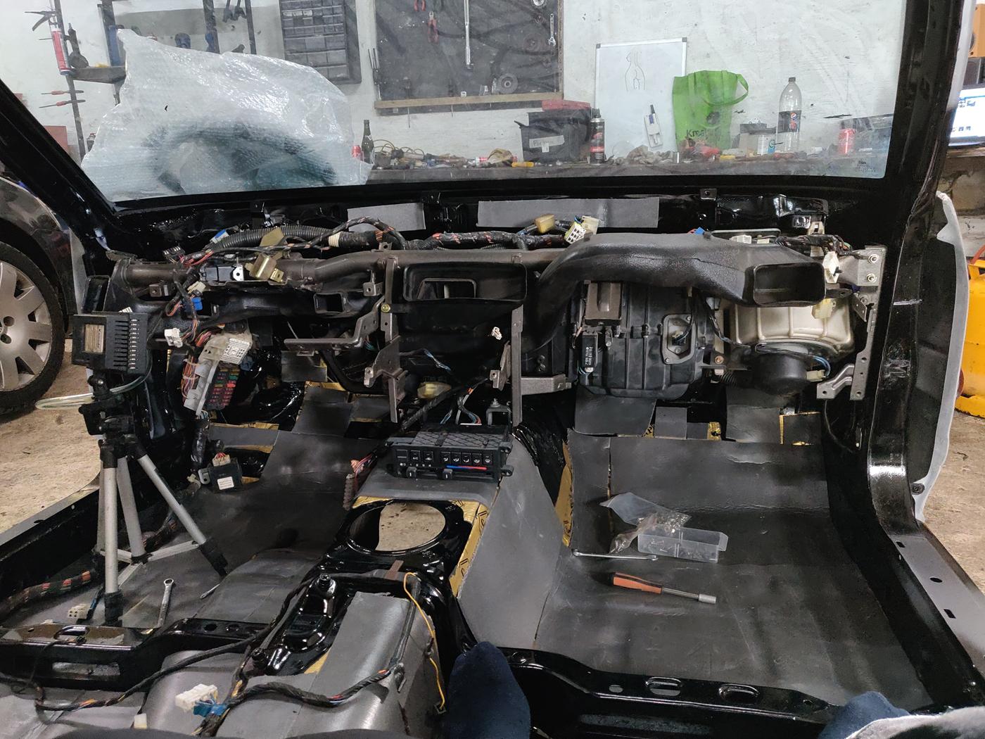

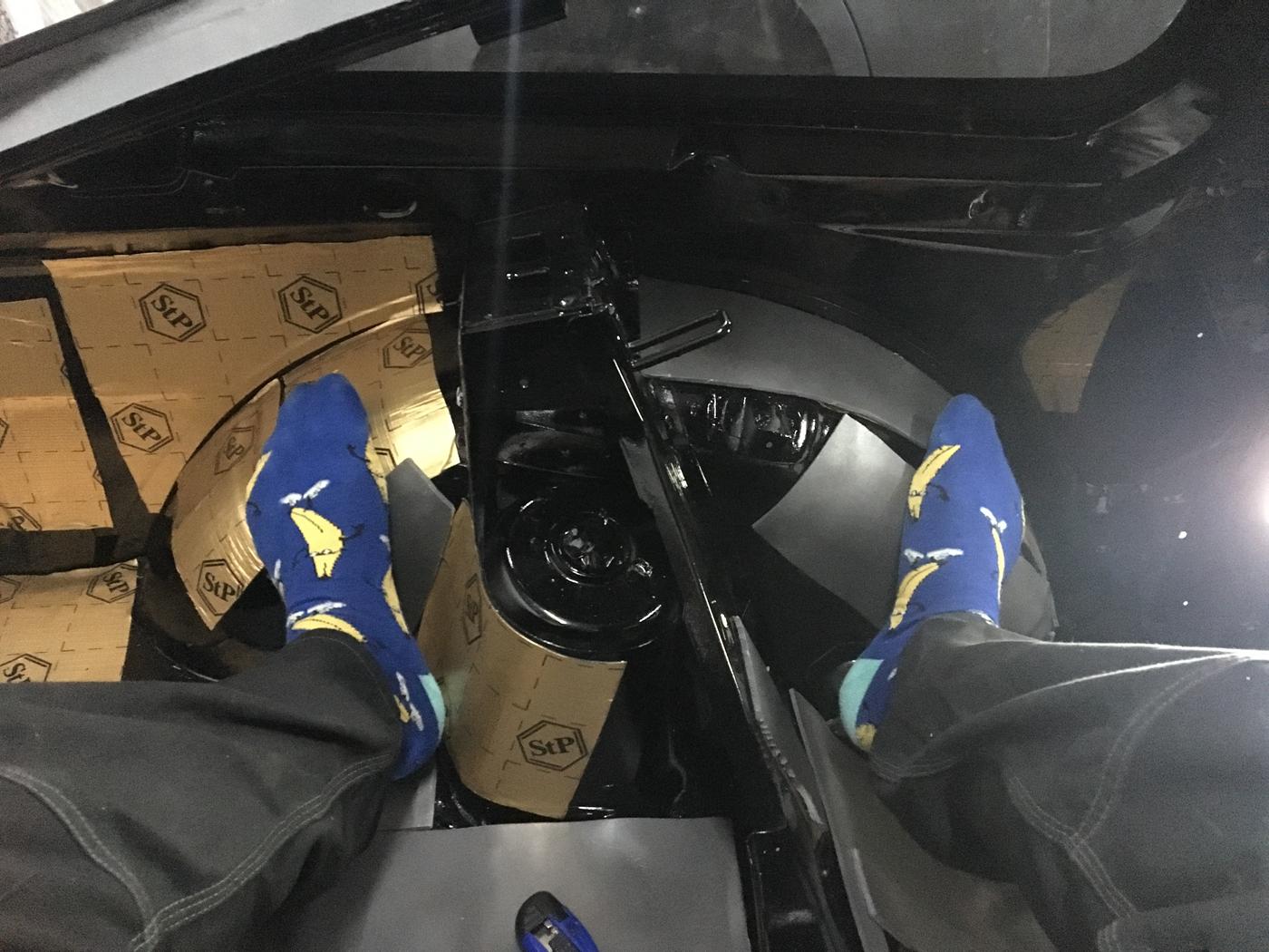

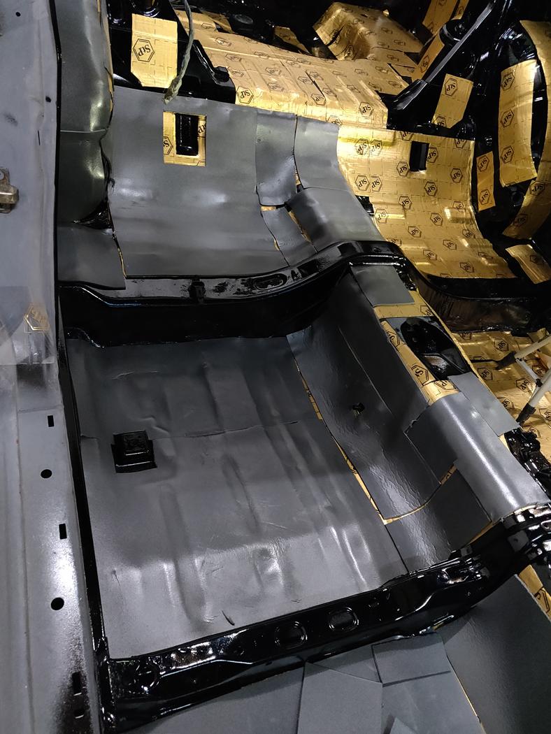

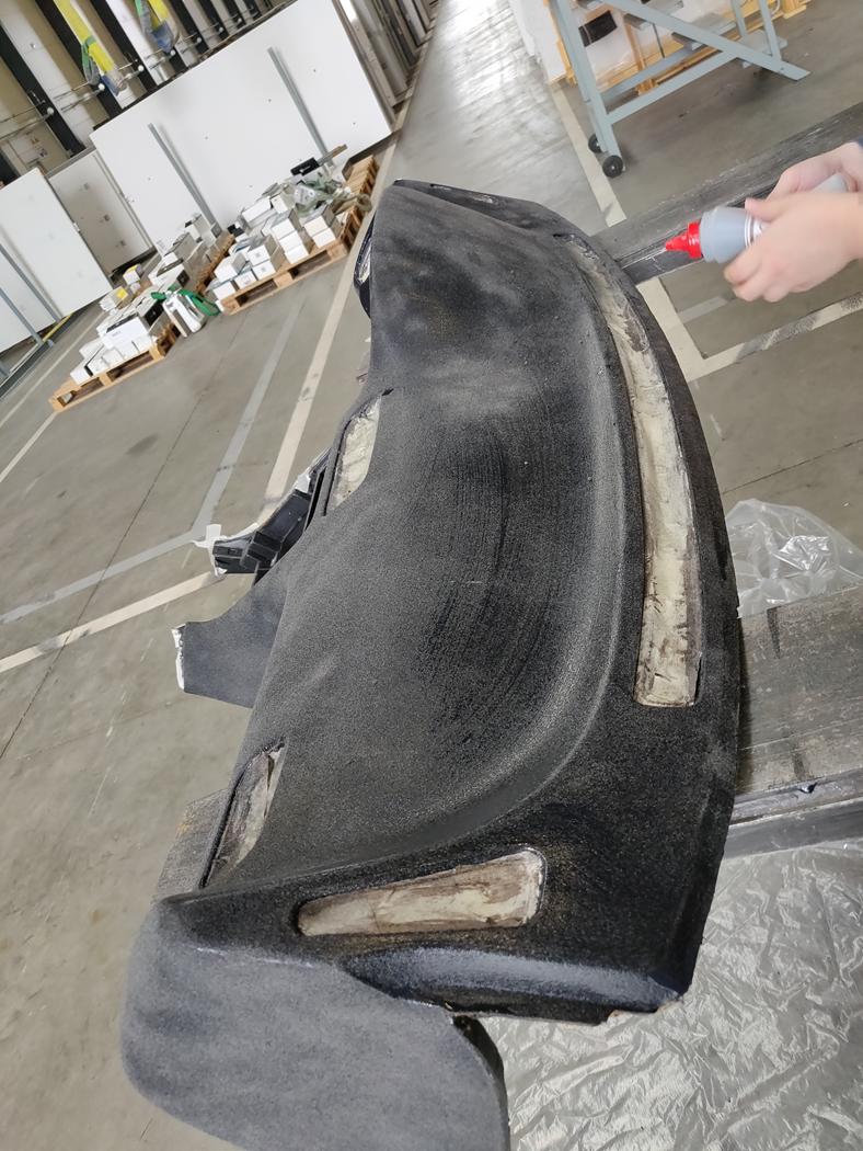

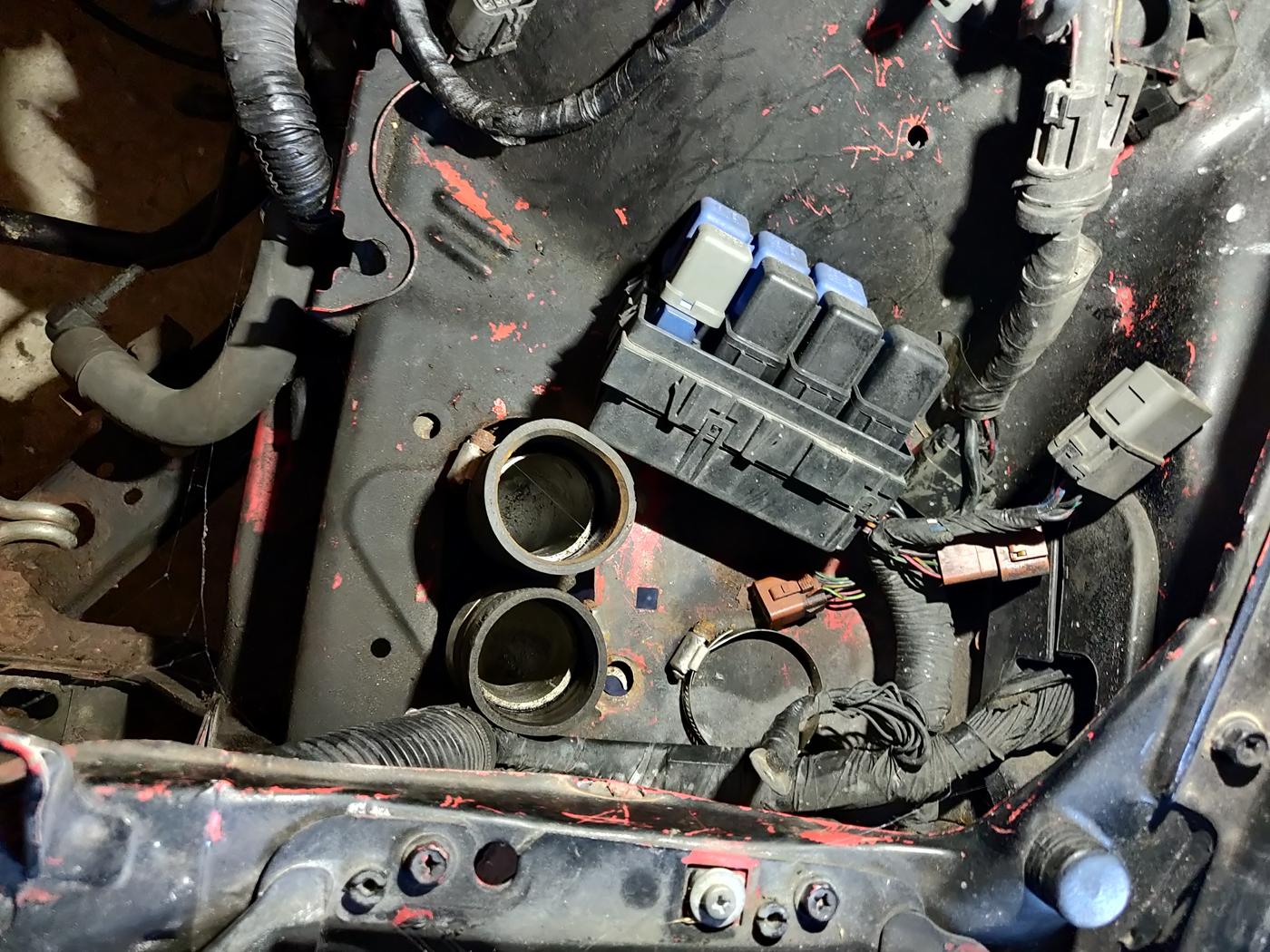

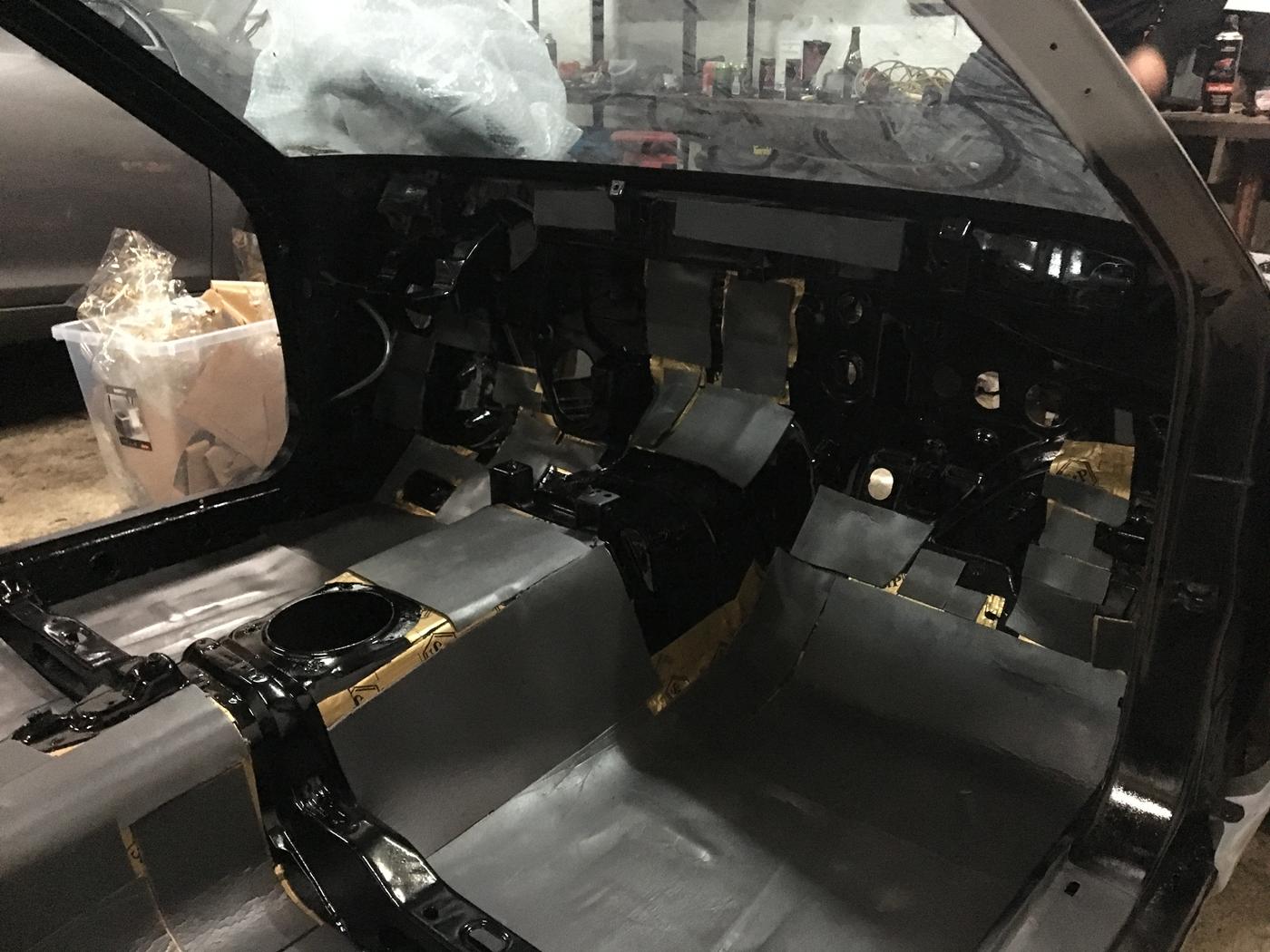

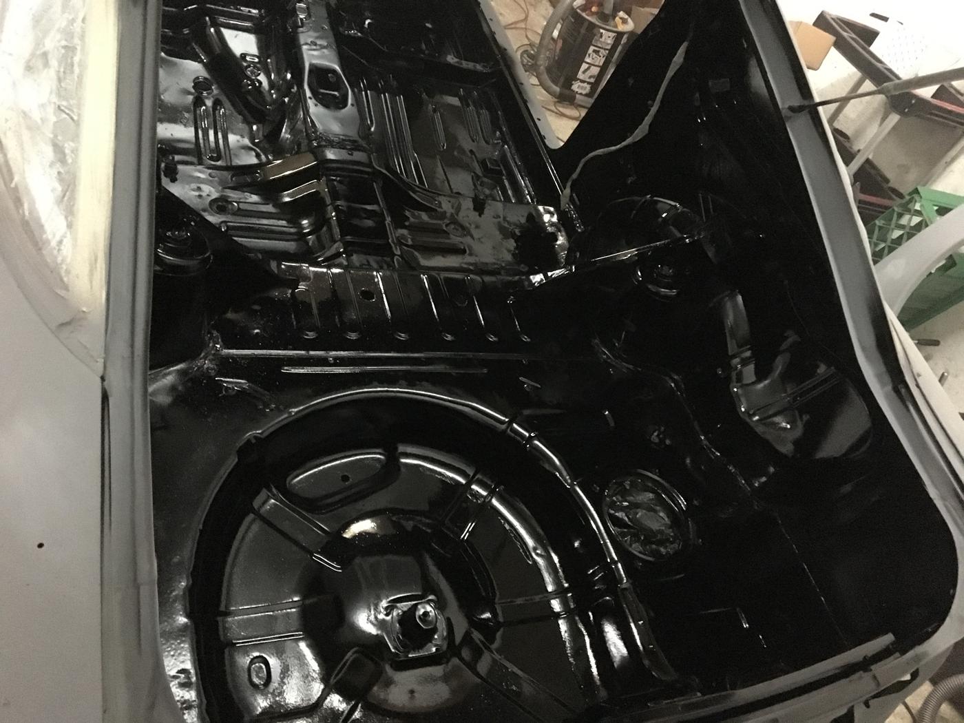

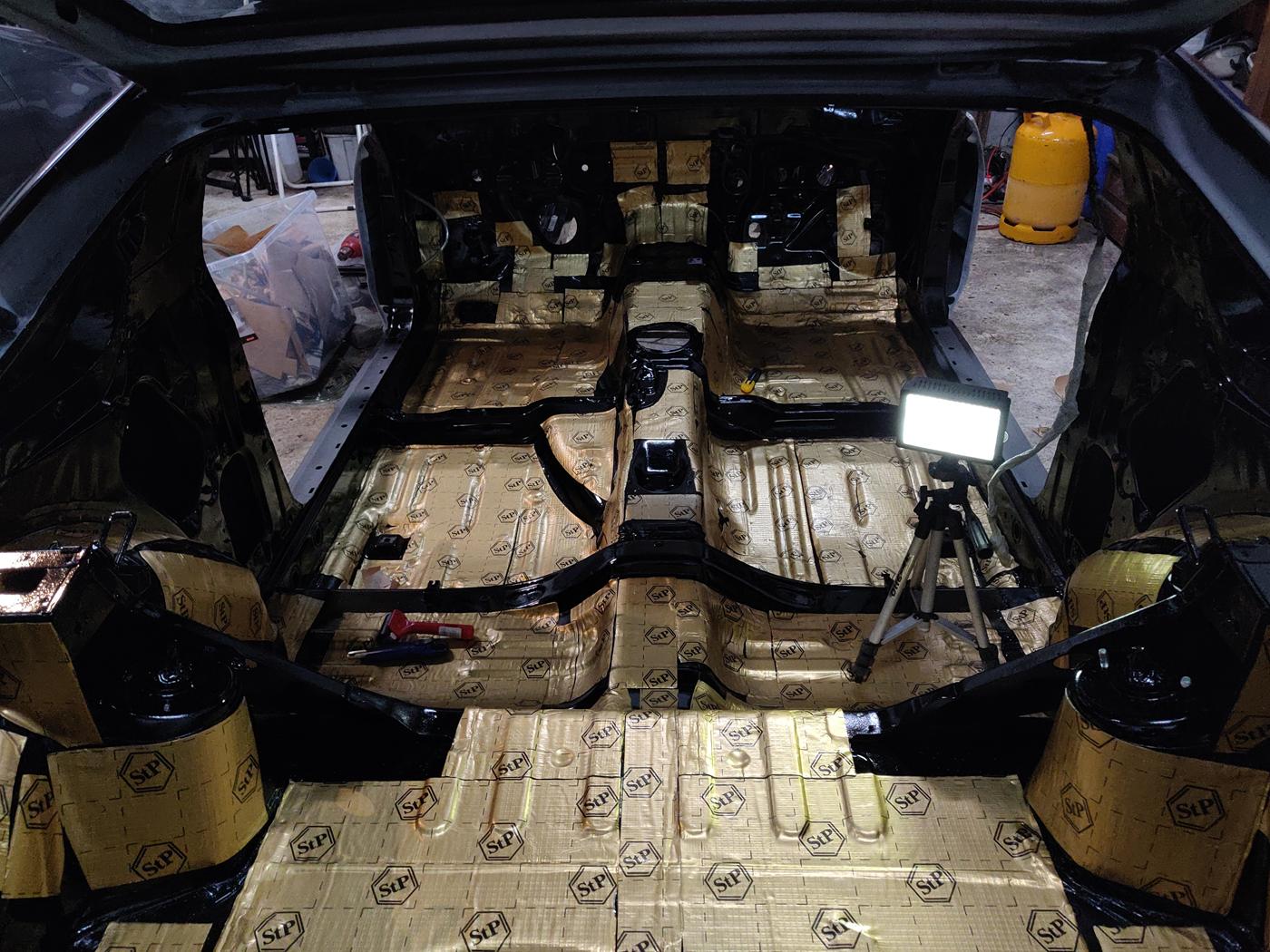

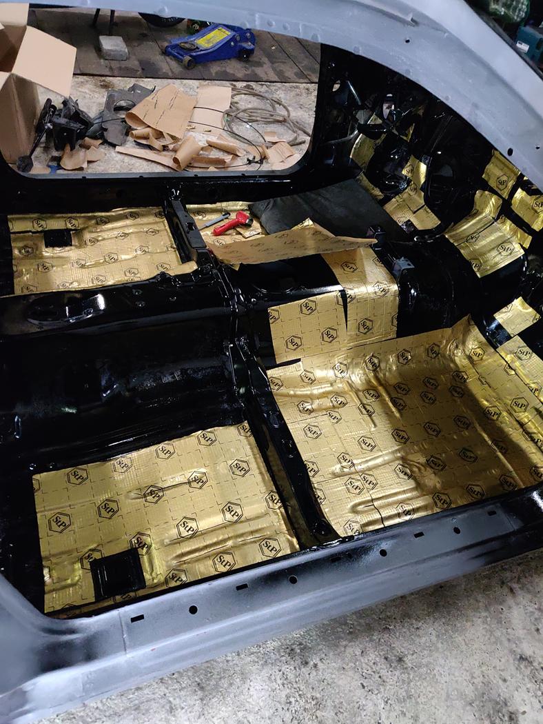

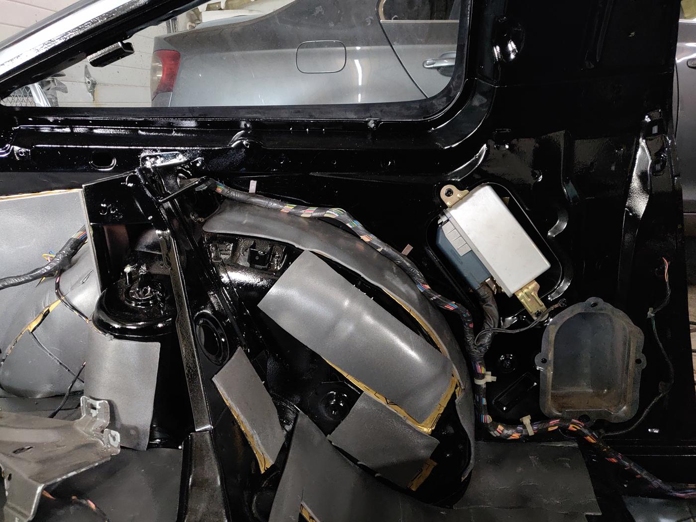

Anyway. My friend and i started to remove all of the sound deadening. What a fucking nightmare.

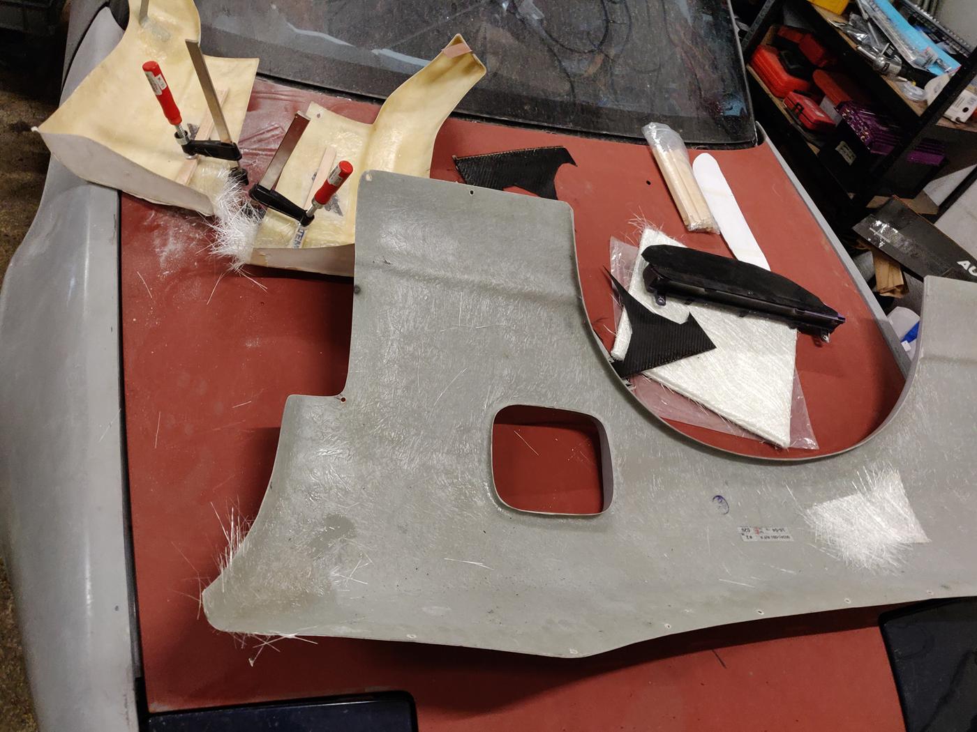

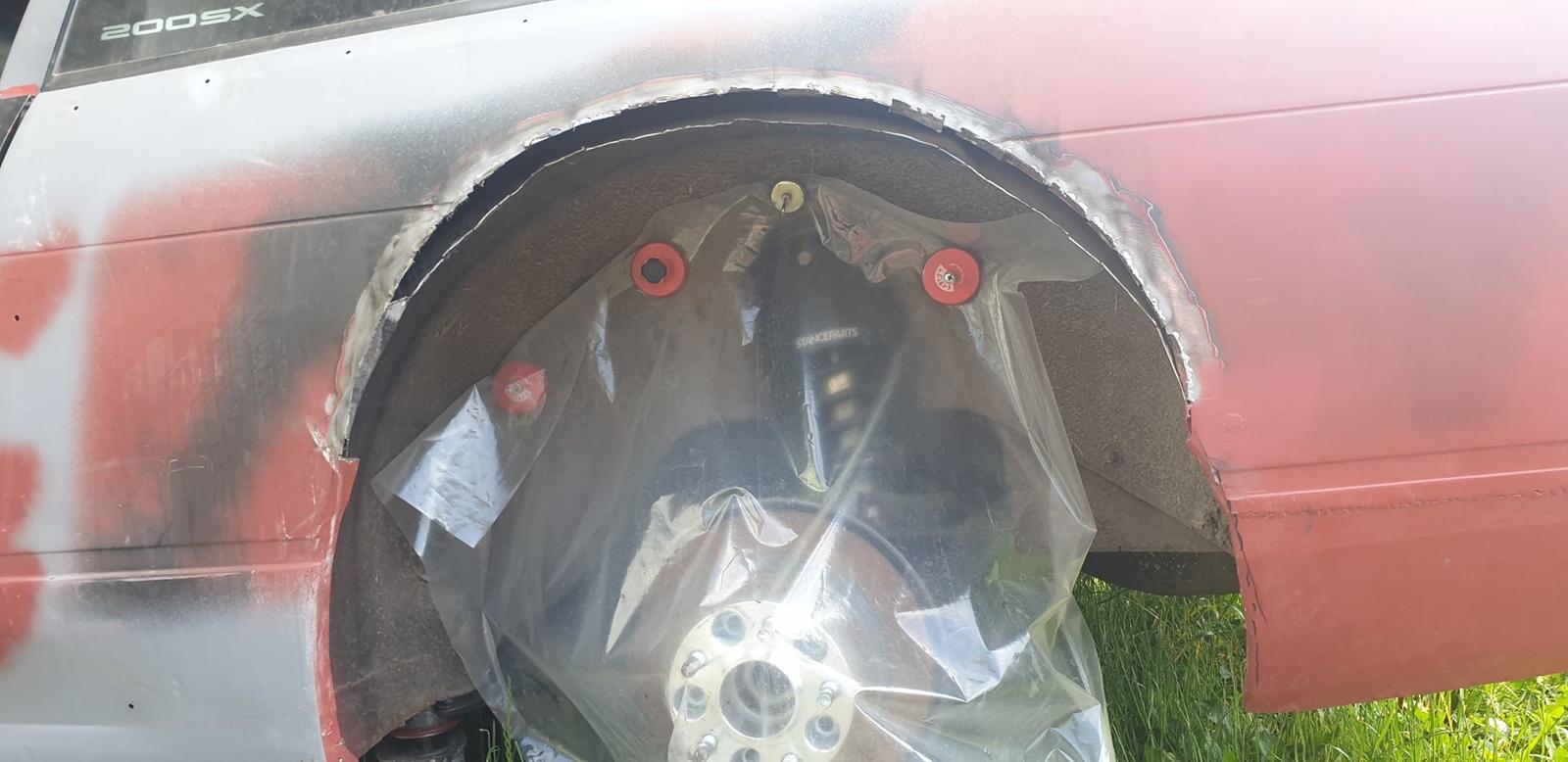

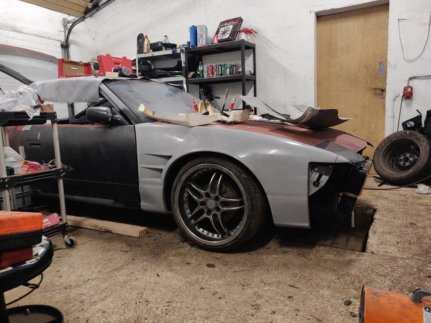

As i mentioned before, i had to scrap all of the widebody and ordered a set of originLabo.
Fitment looks great. I've just mounted it loose for the sake of the pictures

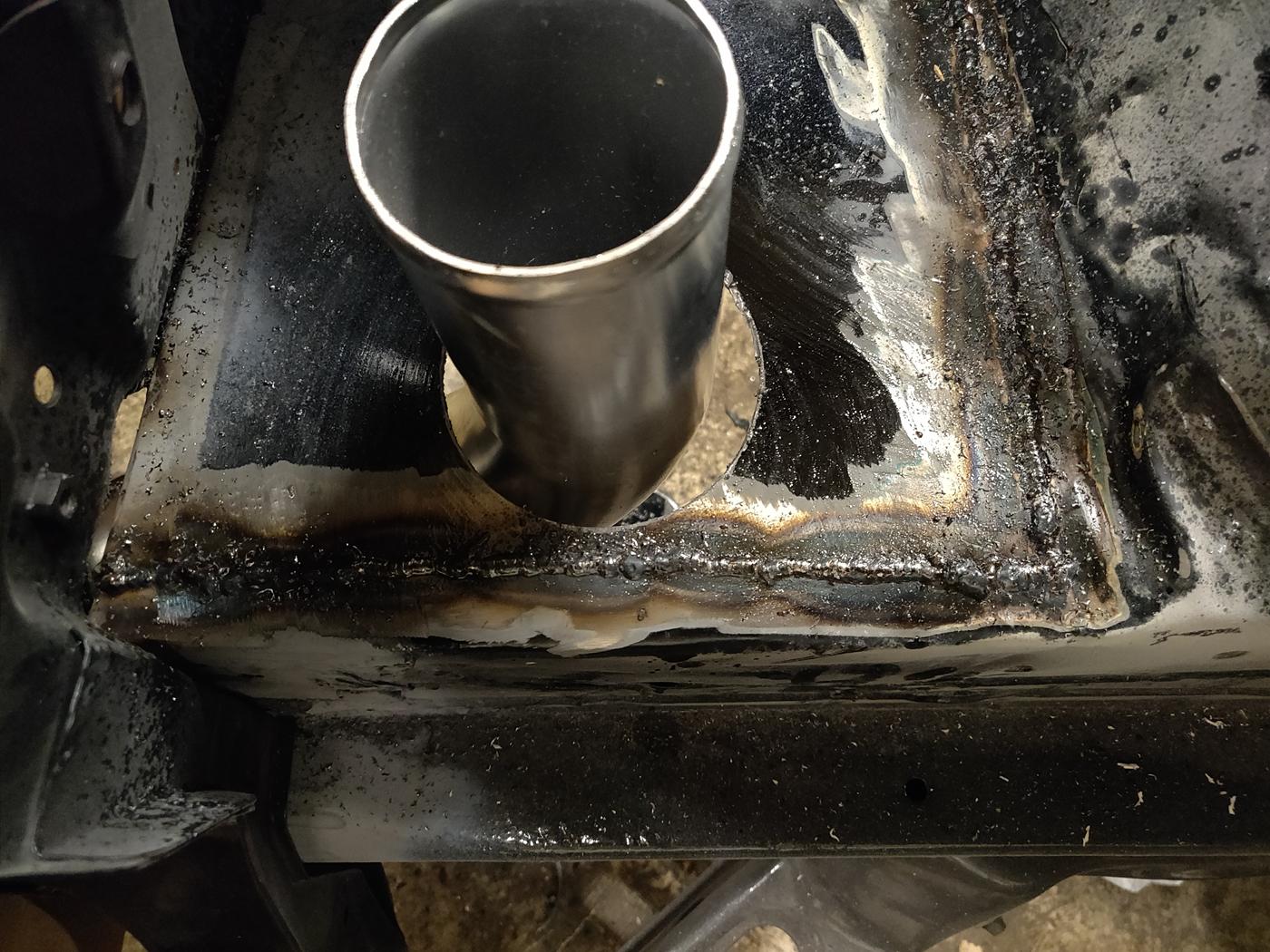

As i want the car to be a summer-car, i had to find the perfect exhaust-solution. I had a Japspeed V2 catback system laying around, but ive always hated the huge 4.5"muffler. Especially when the car would be really low, it would get cought on everything. So i had to find a solution. I wanted to find a dual exhaust just like the original one, but with better flow.
So after searching all over the internetz, i found a danish shop selling Xforce Varex. So ofc i ordered one right away. The company emailed me stating the delivery time would be 12 weeks! So i had to wait. But boy, it was worth it!
If you look closely, you can see my slave holding the muffler :D :D :D

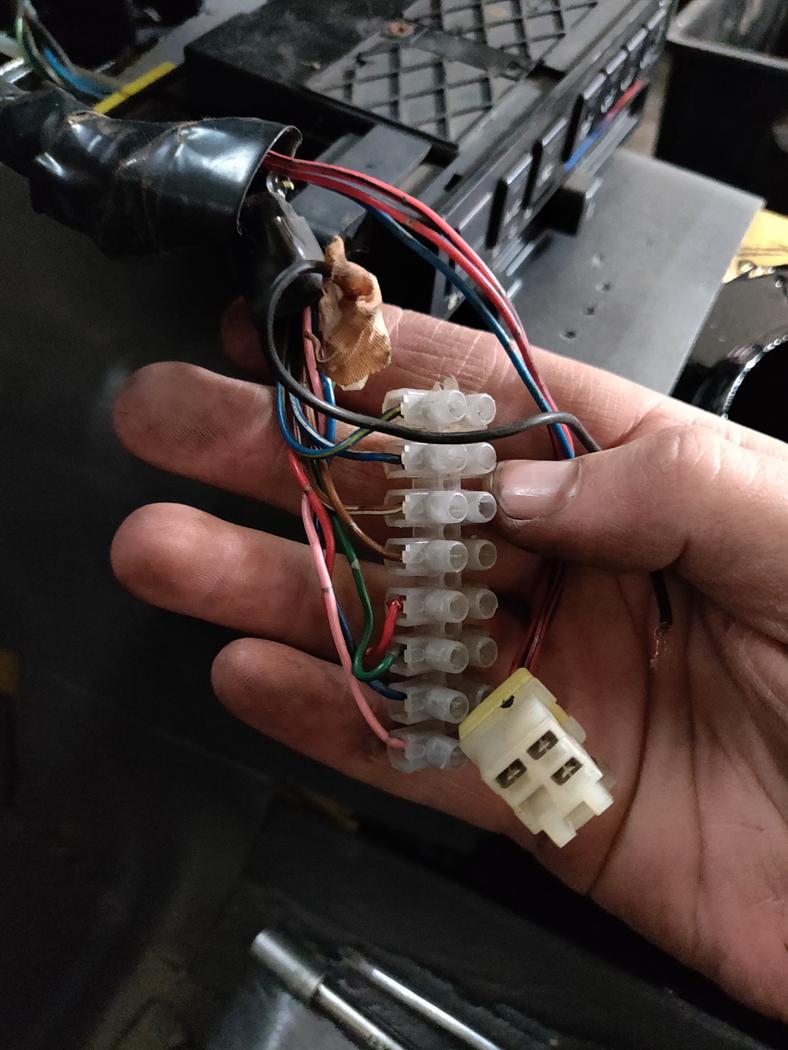

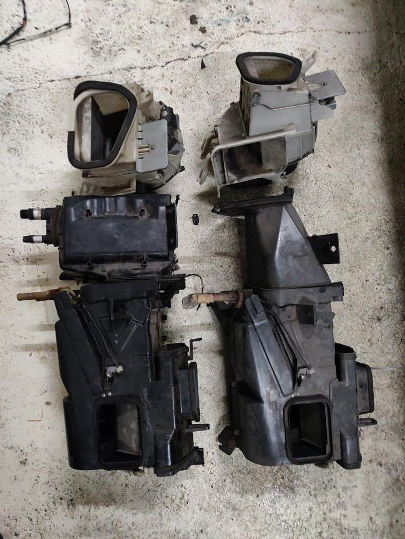

Anyway, as this car wasnt born with A/C, i had to install it. This meant i have to find all the pieces. Not easy! hopefully im getting the condenser and filter this weekend!
I would love to get the digital climate control from a late model 180SX, but its really hard to find everything i need without paying an arm and 3 legs.

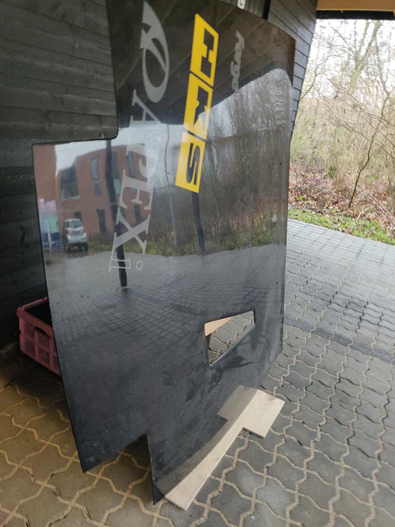

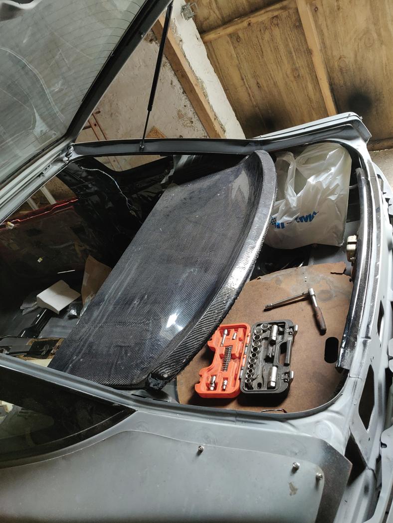

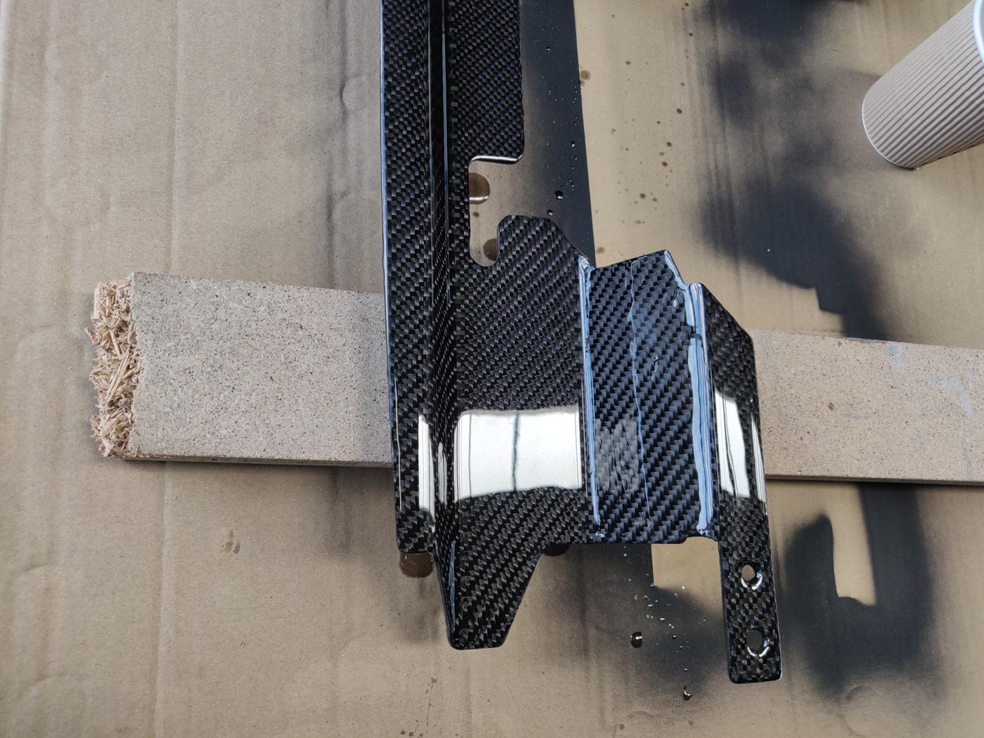

I picked up the carbon coil cover so i could see how it looked.
I approved :D

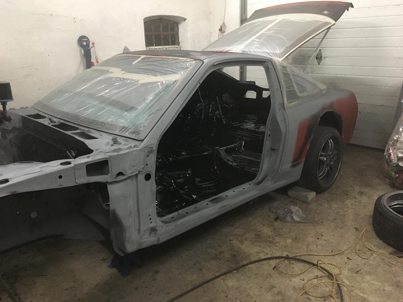

My friend tackled the front right side as its previously been hit, so the whole headlight bracket was bend. I ordered a new straight from Nissan here in Denmark so it could be replaced. But the previous owner did some "rustwork" where the battery used to be. This was not good enough for us, so it had to be redone.
End result of this peace looks something like this: It still needs the last finishing touches, but a LOT nicer than before.

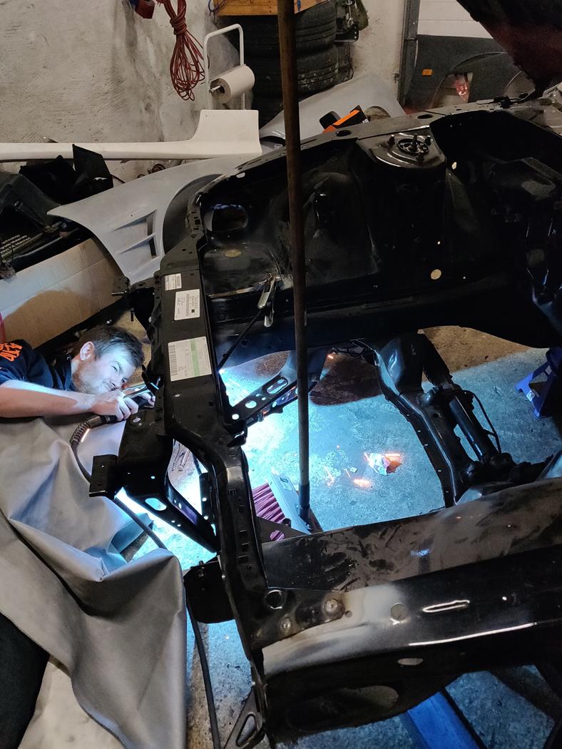

The 2 guys do a tag team on the car. One is welding and the other is cutting out rust and making patches. Thats how you do progress :D
Inside the car there was more rust than expected. But im so happy it was found now, and not after it has been painted, installed sound deadening and undercoated it all.
But what looked like a small hole, suddenly grew a bit bigger :P

Time flies and im to busy to actually do much work on the S13.
But im happy that my friend is slowly welding everything.

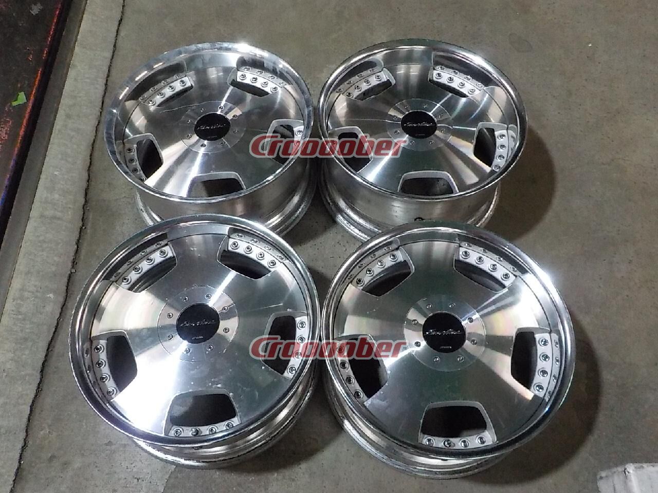

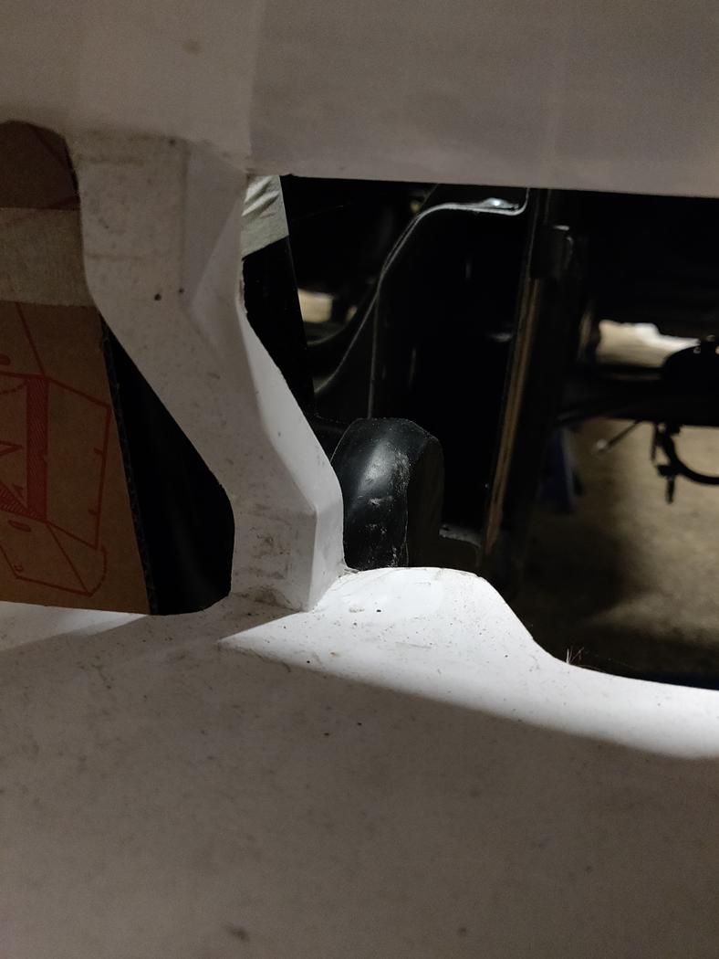

In on the lookout for the perfect wheels. Its a bit problematic as im running Aircups. And i dont want to use spacers if possible.
Here you can see a 18X8,5" ET33 wheel. And its gonna hit the aircup when its under load. Its a pretty big problem if that happens ;)

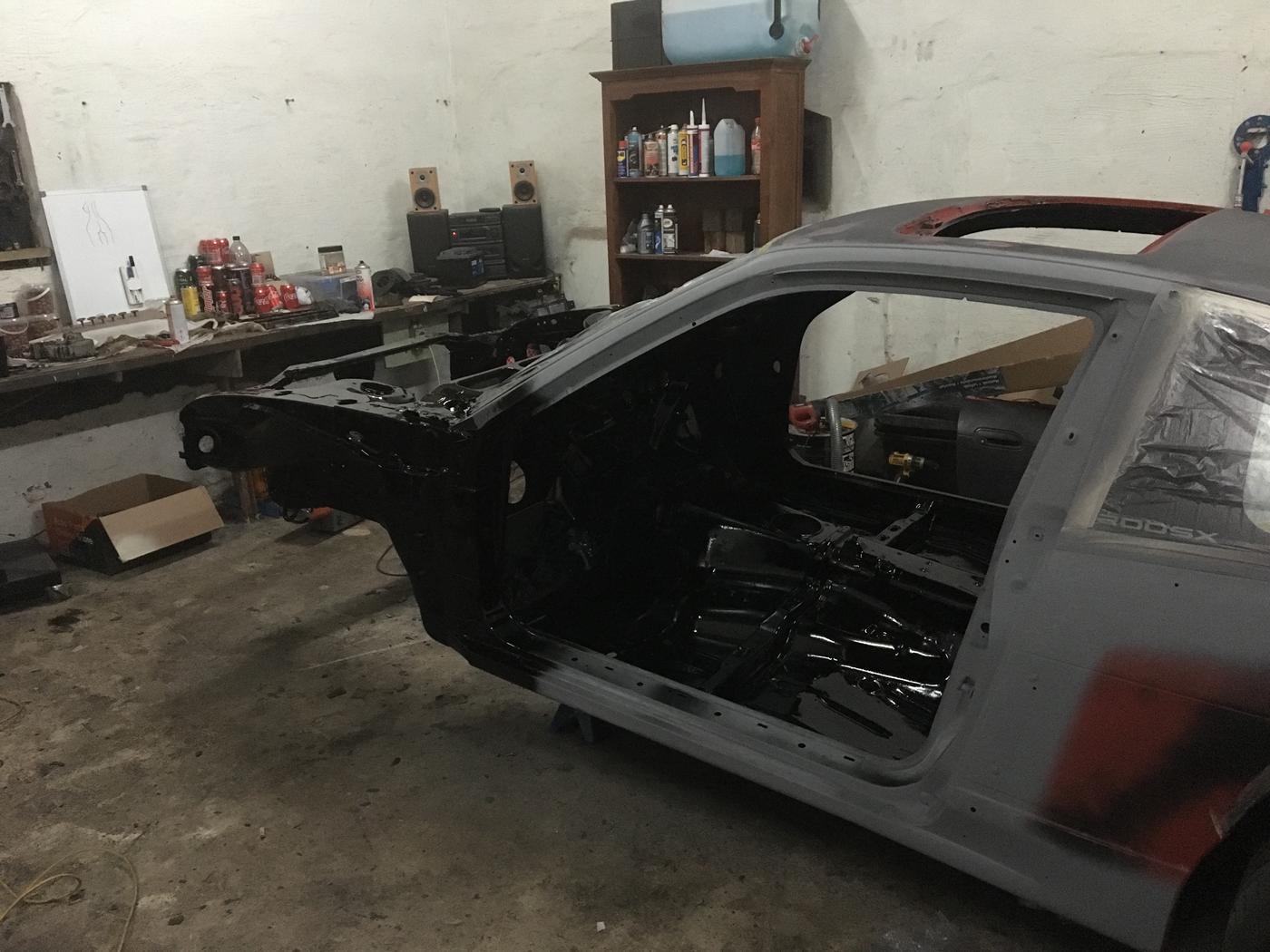

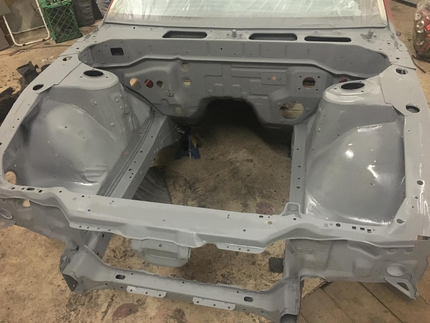

Jyttah 10-15-2018 02:33 PM
I think its time for a small update.
The enginebay is 95% ready for paint.
I bought a small bundle of random parts for cheap. I only needed a engine harness, but i took it all.
There was some B450L injectors that should fit the CA18DET perfectly and a lot of other parts that i could sell and earn a bit of money back

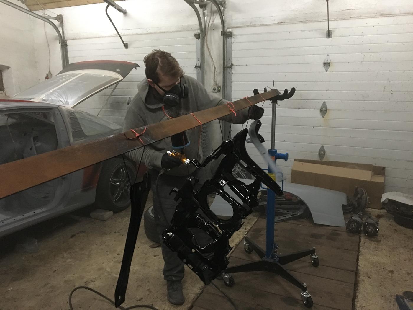

This weekend i went back to my friend so we could continue fixing the Nissan.
And ofc, i had to bring drinks
We cleaned up in the Nissan storage room, and i had to make it look nice :D
Everytime i see how wide the car is gonna be, im surprised.
Always stay baconated!
This picture gives me so much joy :D
Taking up all the space in the garage

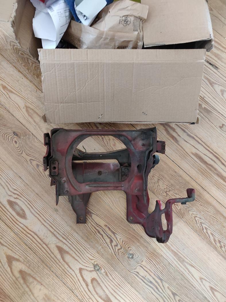

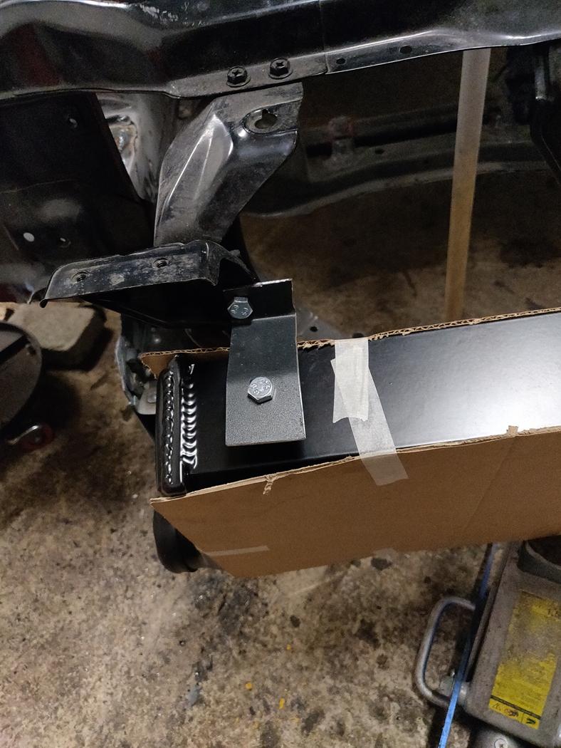

Here you can see that a previous owner cut open the radiator support. And we really dont know why. But it doesnt matter, its getting replaced with a brand new one.

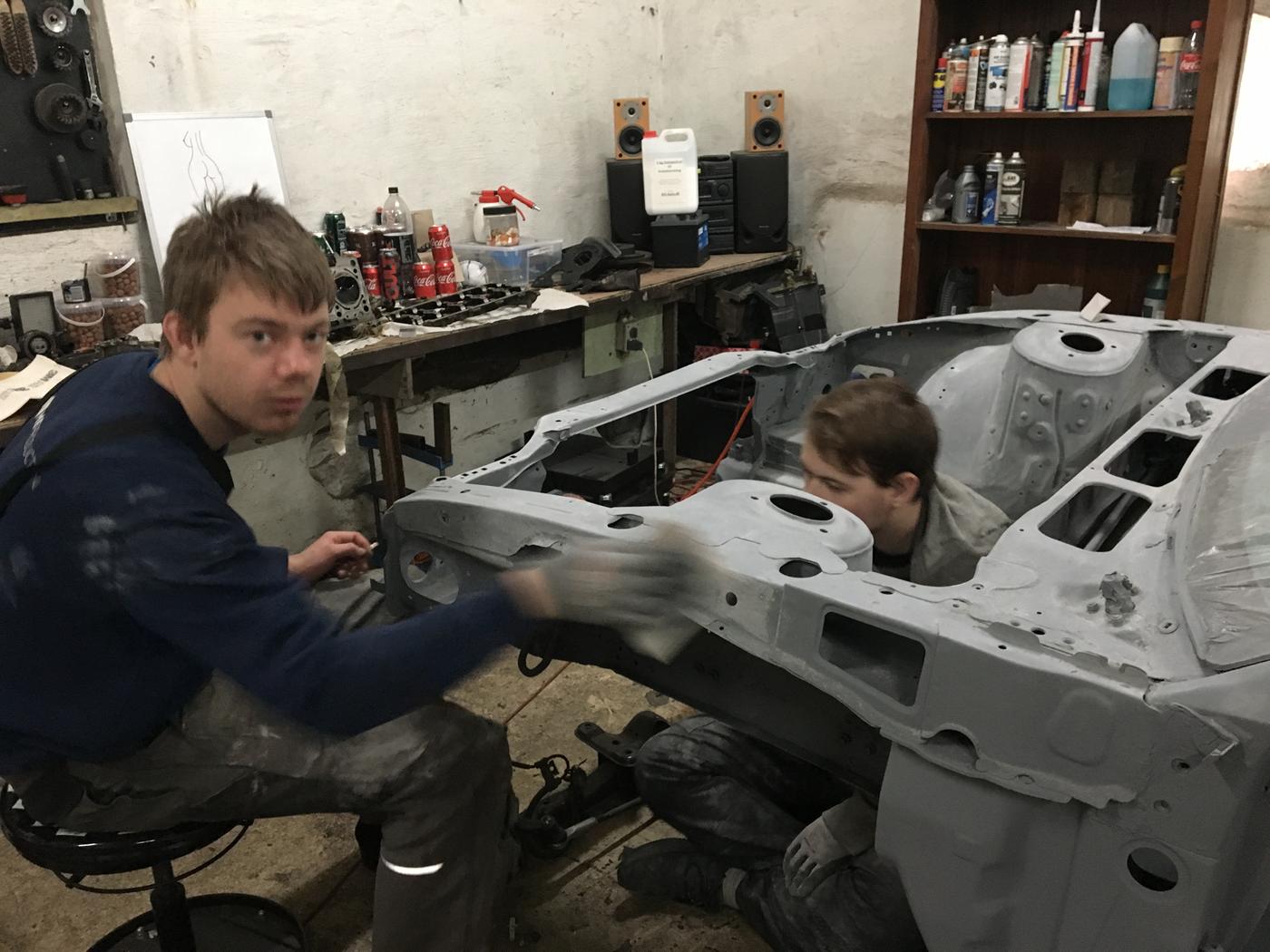

Again, there was a tag team going on. Always nice that people come to help saturday night.
Its hard to work 12 hours a day :D
This is the stuff we use for the enginebay. Sponsored by Autolakhandel.dk

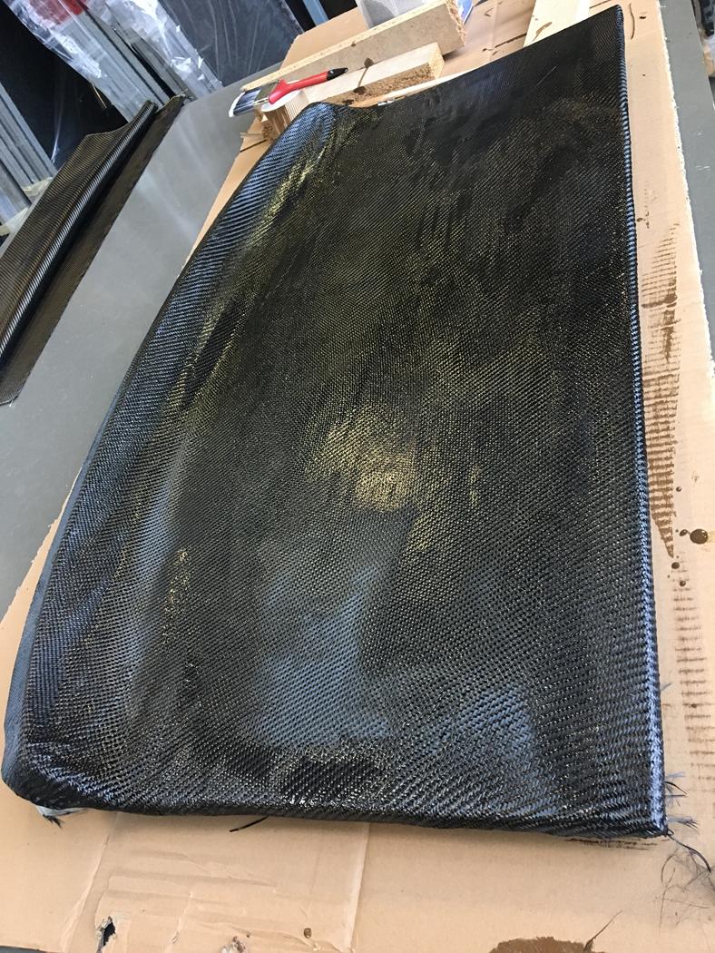

Anyway. A small update.

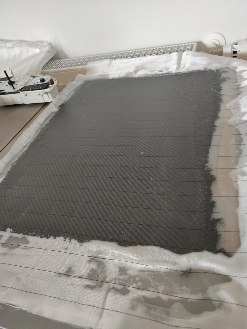

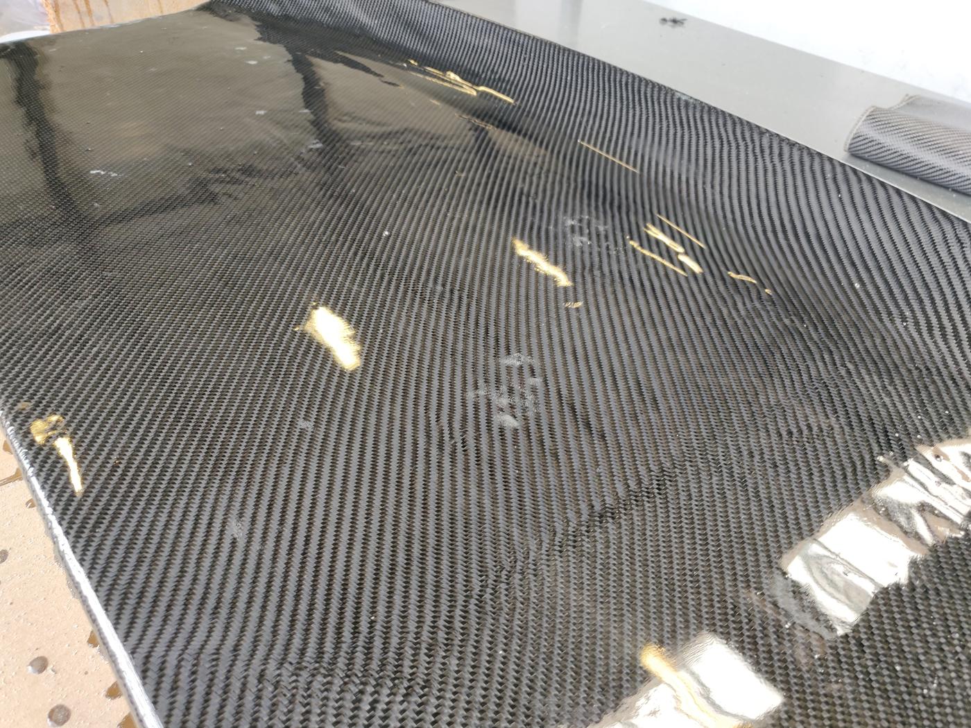

Besides the 5 squaremeteres of carbon fiber cloth, i also bought a single squremeter of cheaper cloth to test with.
As i only had some old intercoolerpiping, i desided to try and wrap these with the carbon fiber.
This is the first time i tried something like that, and it ended horrible. or, actually im not done yet. But i learned a lot of do's and dont's.
First of i painted the piping black as the carbonfiber cloth is a bit see-through.
Then i layed a layer of epoxy. This was the first mistake as the cloth was sliding around and made a lot of airbubles underneath.
I had to wait untill it get tacky and then put down the cloth. This took forever (over 5 hours) as its fairly cold in the warehouse where i did it.
I tried to make the connections on the backside so it wouldnt be vissible when they are installed. even though in not using these pipings.
Then i put down another layer of epoxy. And its still in a cold warehouse with around 10 degrees celsius.
Again. because of the cold, the epoxy wouldnt harden as fast as i would like it to, and then it would just run. So theres a lot of sanding to remove the runs.
And because its piping, and not something simple as a flat panel im carbonwrapping, i have to twist and turn it multiple times to get an even coat of epoxy. But again. Im learning by doing this :D
Here you can see the backside that will be hidden if these pipes would be installed:
It would be cut off and sanded down so it would look smooth.

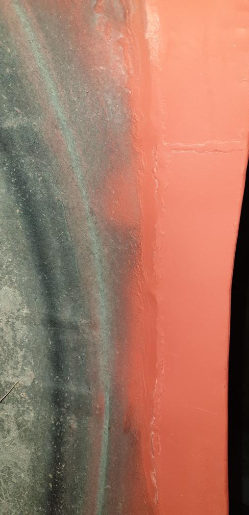

First off... My friends found some more rust holes in the car. And as everybody knows, a small rusthole becomes big pretty fast!
But luckily they fixed it :P

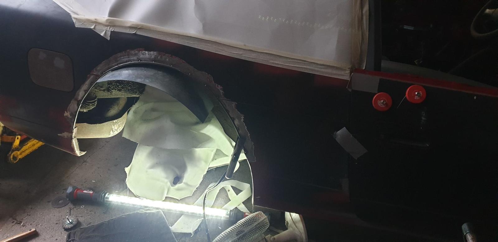

Because i changed my mind with the rear overfenders, we had to remove the holes we previous drilled. and at the same time the hole for the original antenna was filled out.

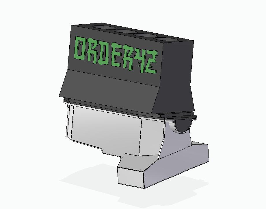

Another friend made some logos and got them printed on some holographic sticker. Looks really cool IRL. (and you can find a small video on my instagram: https://www.instagram.com/gogo_gojira/ )

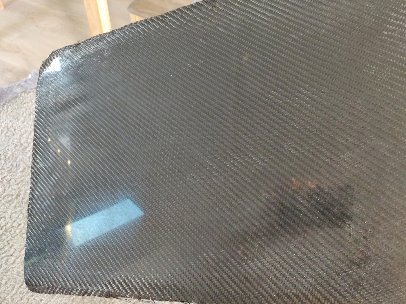

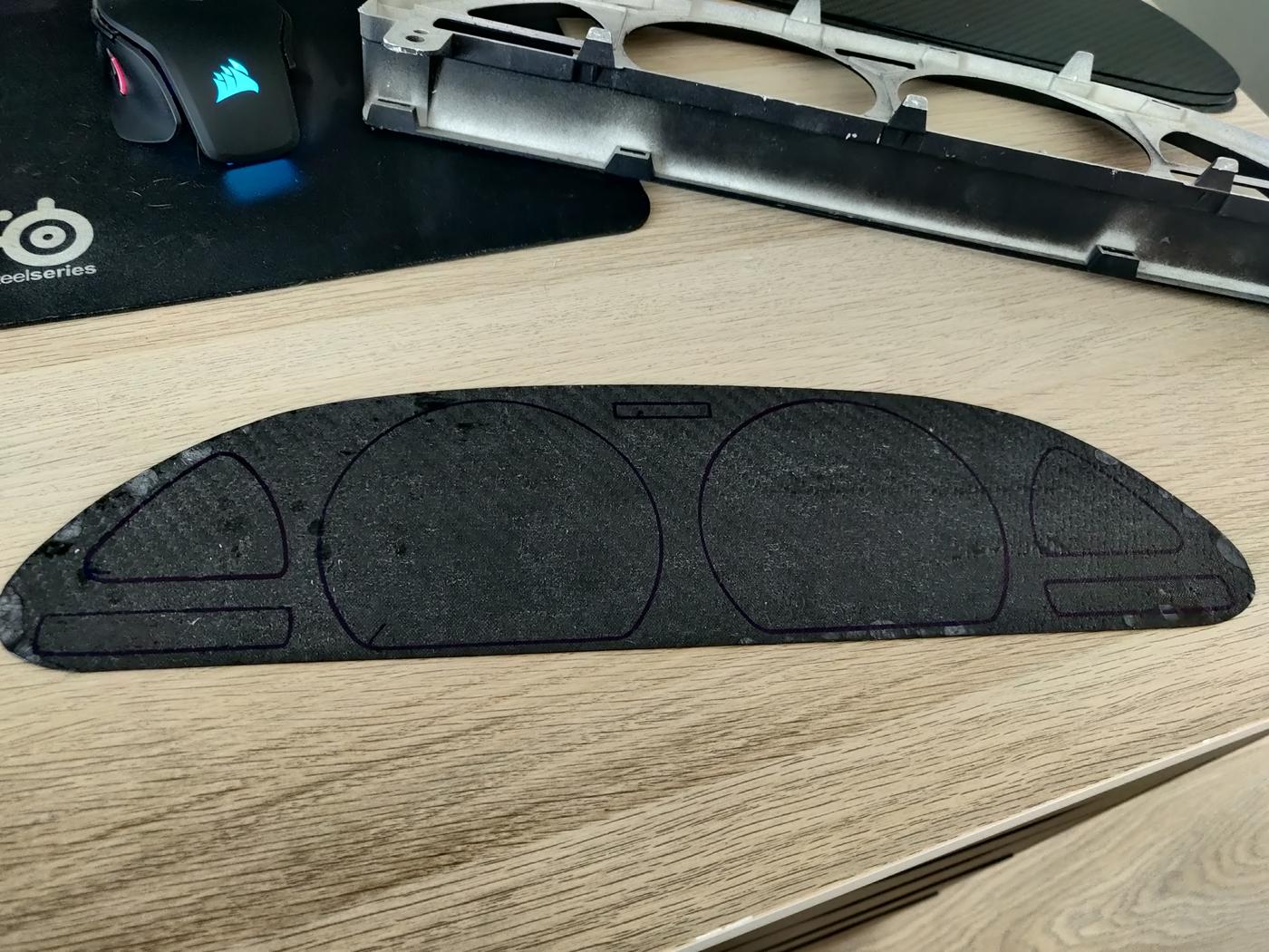

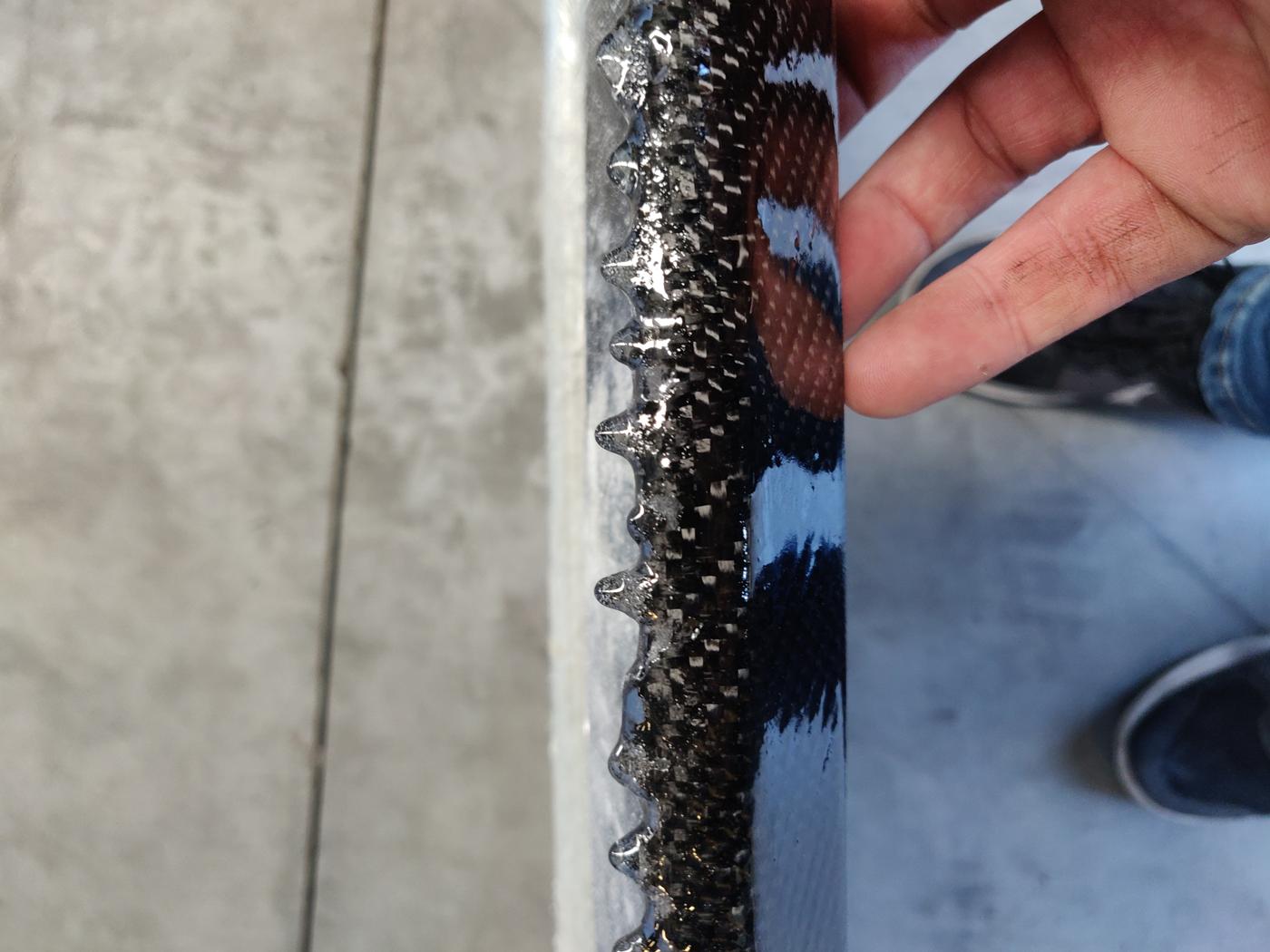

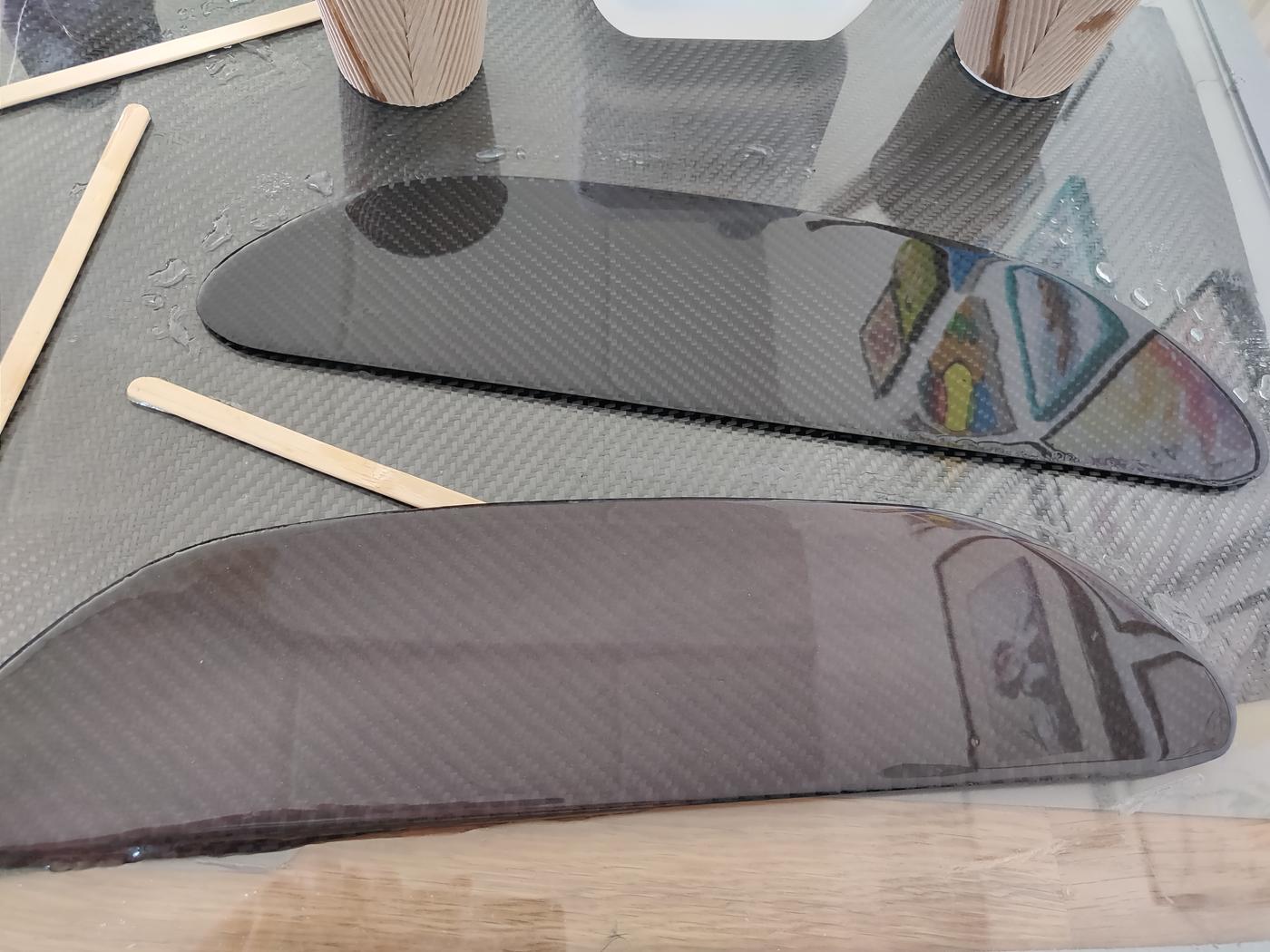

And here i have a small update on the carbonskinning i tried earlier on.
Ive learned a lot of my mistakes and im actually pretty happy with the result. Here its a small test im doing on the steering reservoir.

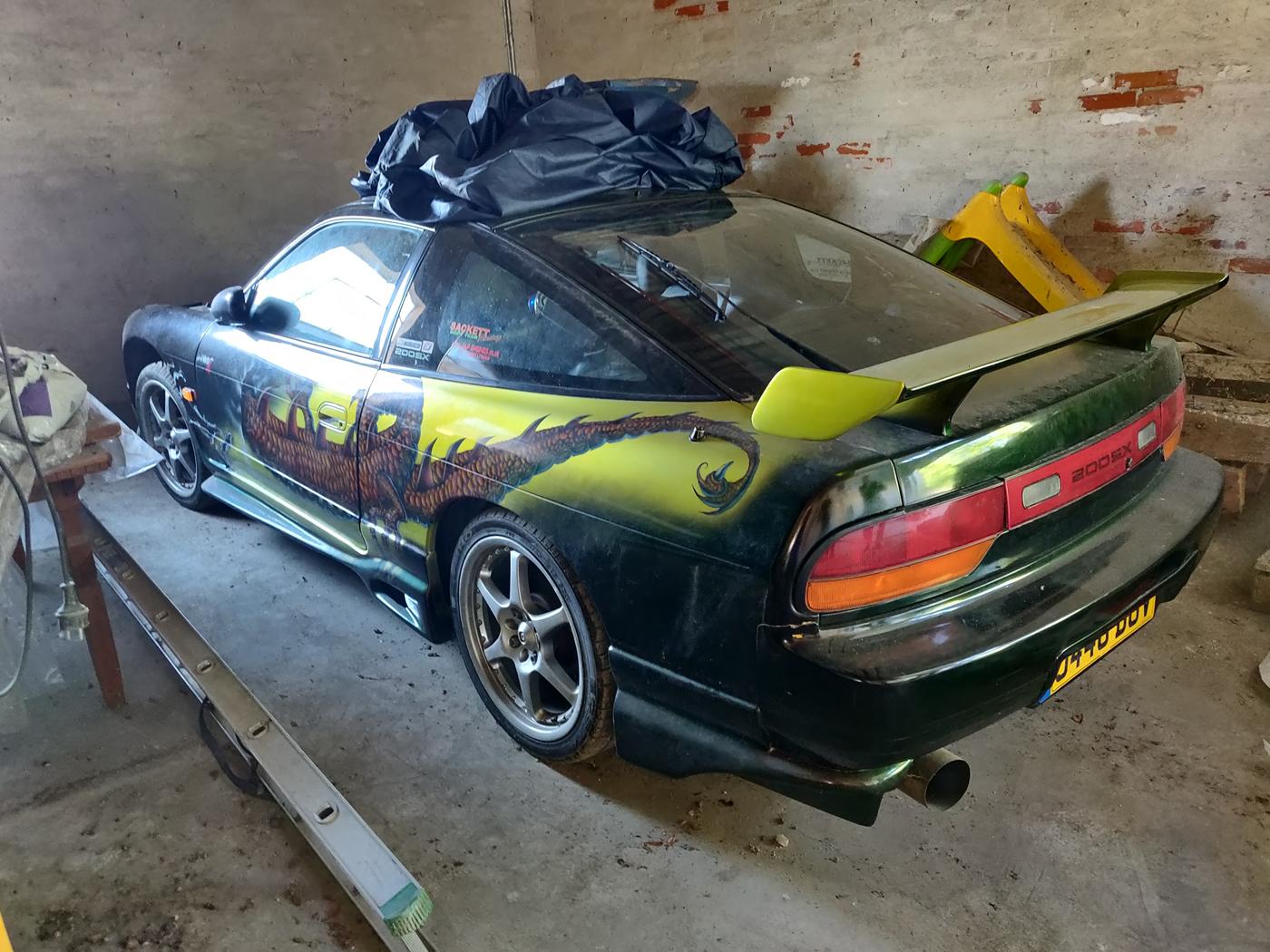

Funny enough, i found an old picture of my previous S13

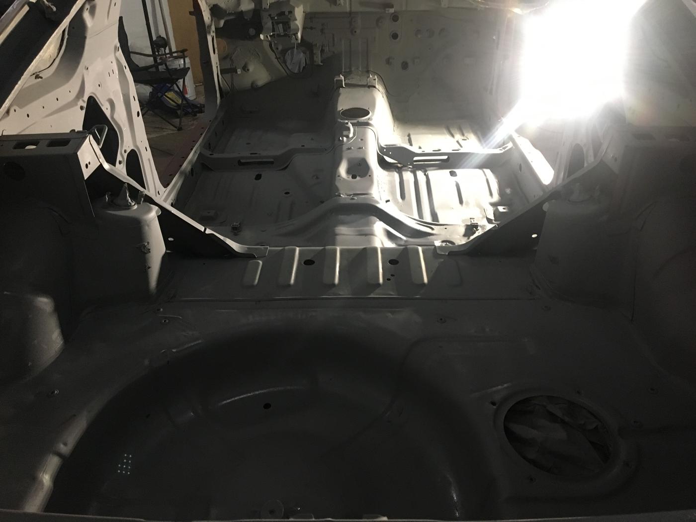

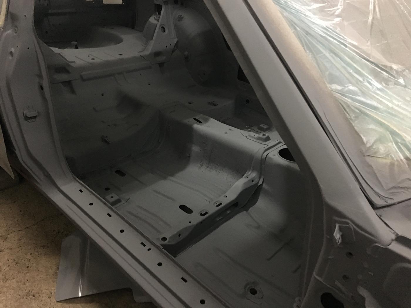

2 weeks ago the car was primed. So this weekend we went crazy with scuffing the primer and throwing some black paint on it.
As you can see on the pictures. its a pretty decent job taken in consideration that it was done in a garage. But these mistakes will be corrected when the rest of the car will be painted.

Jyttah 03-04-2019 11:34 AM
So another weekend passed and we got a bit more progress on the car.
But first we had to clean the garage a bit. I borrowed some floorcleaning chemicals from work. And "accidentally" dropped a bit of it undeluted on the floor.
I think the picture speak for itself :D

When that was done, we installed the light mechanism and the other stuff in the front.
Unfortunally we figured out the right light mechanism was bend a bit. But luckely i already got a new one.
We did some sound deadening. I found a good deal om some STP Gold and some other stuff for the whole car.
I actually liked the gold on black theme.
This step took a bit longer than necessary, but i wanted all the "STP" logos to be in the same direction. Thanks stupid OCD :D:D:D
After the first layer of sound deadening, my friend wanted to test out my new racing seat
And back to next step of the sound deadening install
And heres the difference between non-AC and AC
And then installed
Then its time for the interior wireharness
as i bought this harness secondhand, i only found this small problem. Its the speaker-wires that have been cut. This is not a problem for me, as i wanted to upgrade the speakerwires anyway

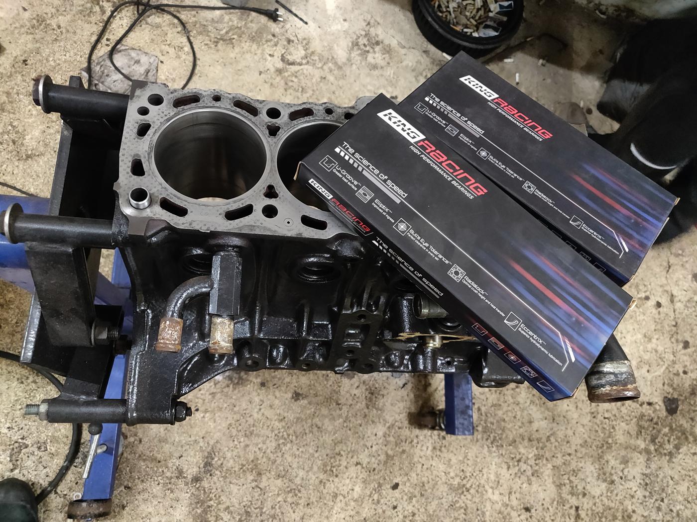

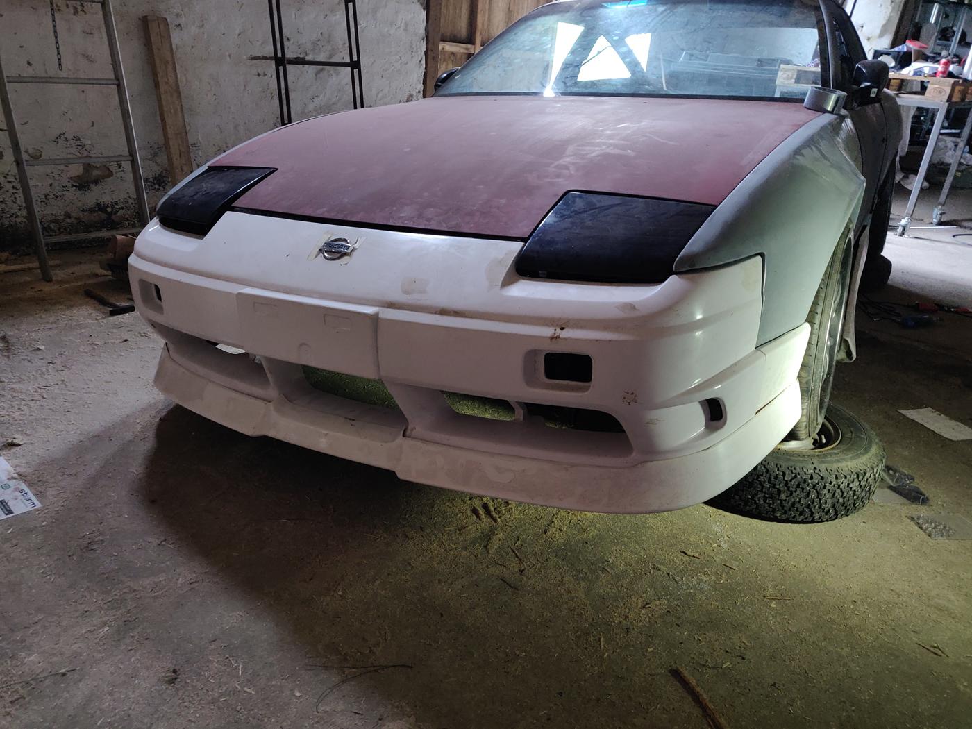

Jyttah 05-01-2019 03:42 AM
Well... Finally i got the time to work a bit on the S13.

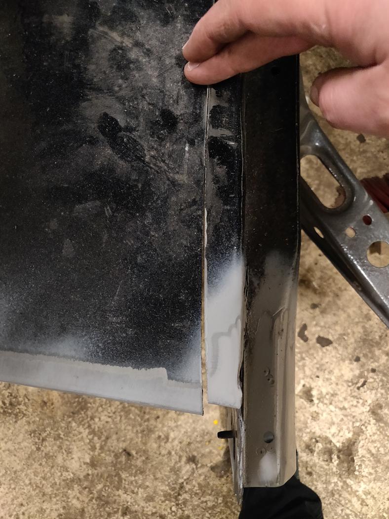

Unfortunally we didnt have a lot of progress as we figured out we need to repaint some of the enginebay. The reason for this is that it was damaged in the right front corner. This destroyed the right headlight. So we welded it and painted without being able to testfit the headlight - Rookie mistake, i know.
So now the headlight sits to high and we cant get it flush with the hood and fender.

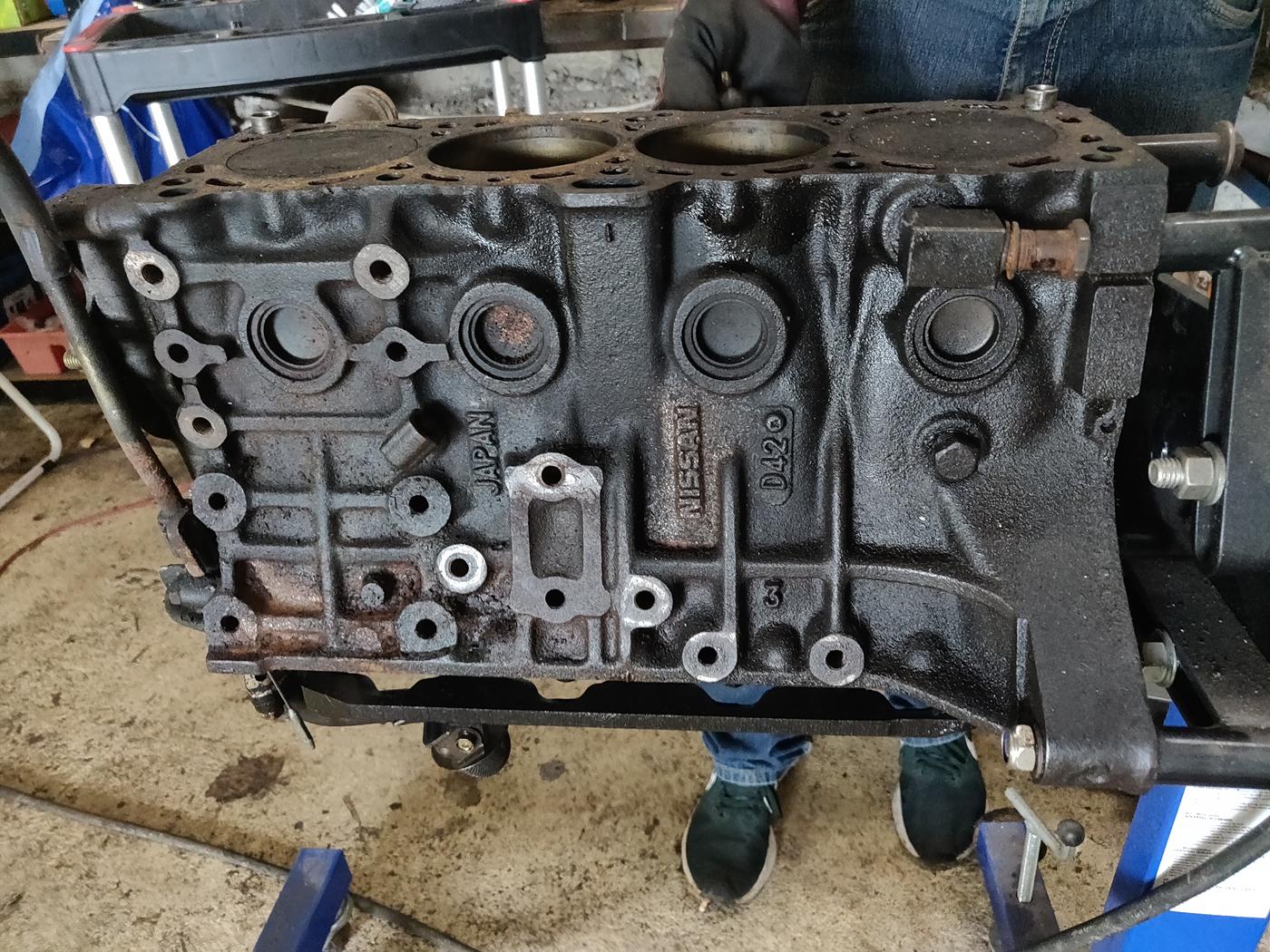

But good news. We did clean up the engineblock and gave it a bit of paint. And ofc. i bought a lot of random parts. i even found a set of cheap replica Bride seats. I know its replica. But with replica i wont be sad when i spill stuff om them.
Anyway. Heres a few pictures of the car so far:

Ohh yeah. i accidentally ordered these:
https://img1.croooober.com/api/v1/ph...02003951s0.jpg
Fuglychuki91 05-01-2019 12:12 PM
I almost got those eurolines for some spares! They were priced good too
Jyttah 05-01-2019 12:15 PM
Absolutely. at 179USD plus shipping i couldnt resist :P But i might throw some other lips on them in the future.

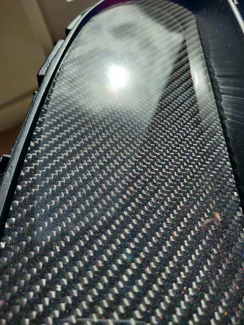

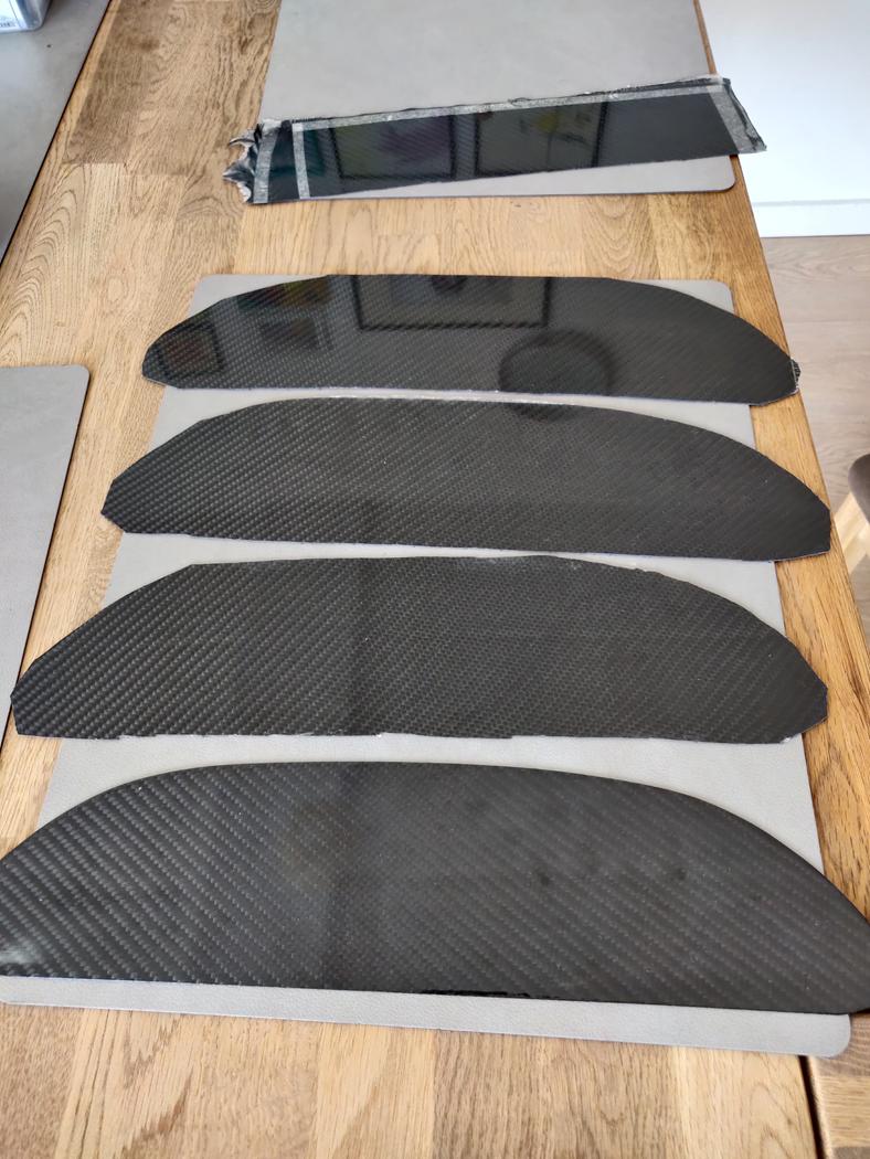

Thanks. Unfortunally its only a prototype as its full of errors. But im working on creating "The final one"
Originally Posted by da_crew10 (Post 6341507)
Yeah where did you get the carbon privacy cover??????
I made it myself ;)

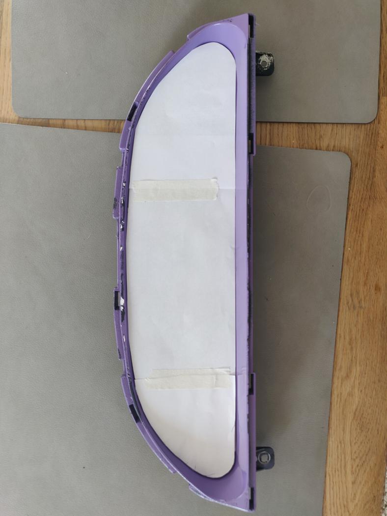

Heres a few pictures. As you can see, i used an original to get the shape. But i hated the big holes for speakers, so this was the coolest way to remove them :D
https://billeder.bazoom.dk/biler/alb...hattehylde.jpg

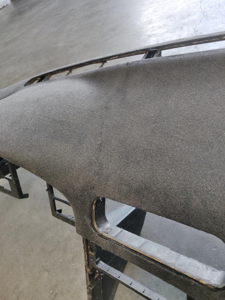

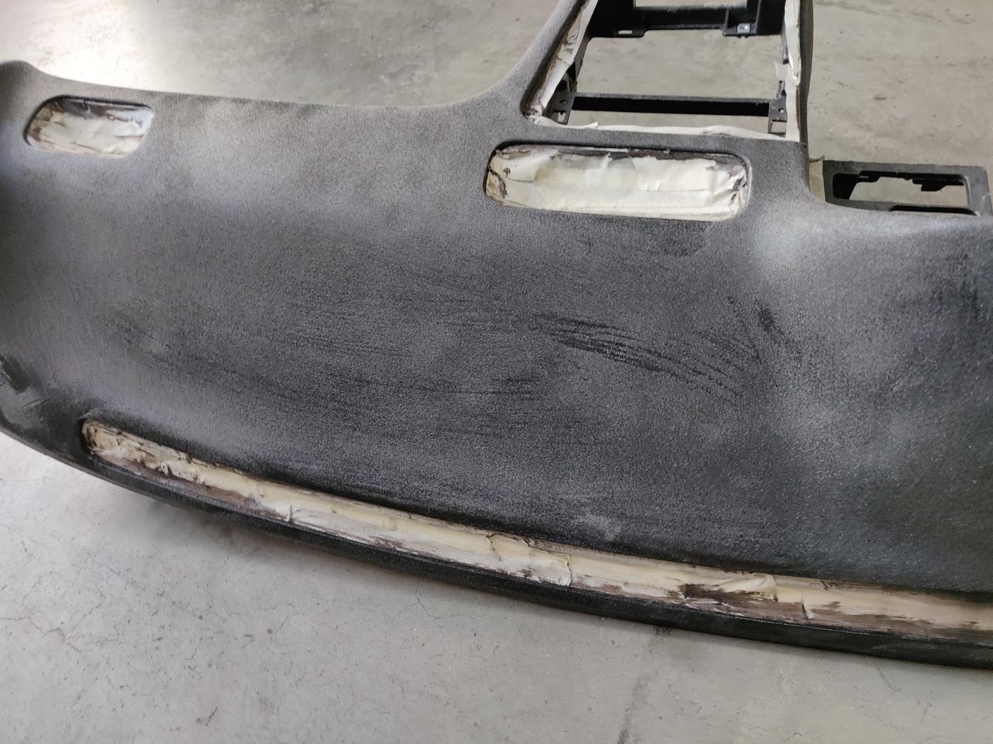

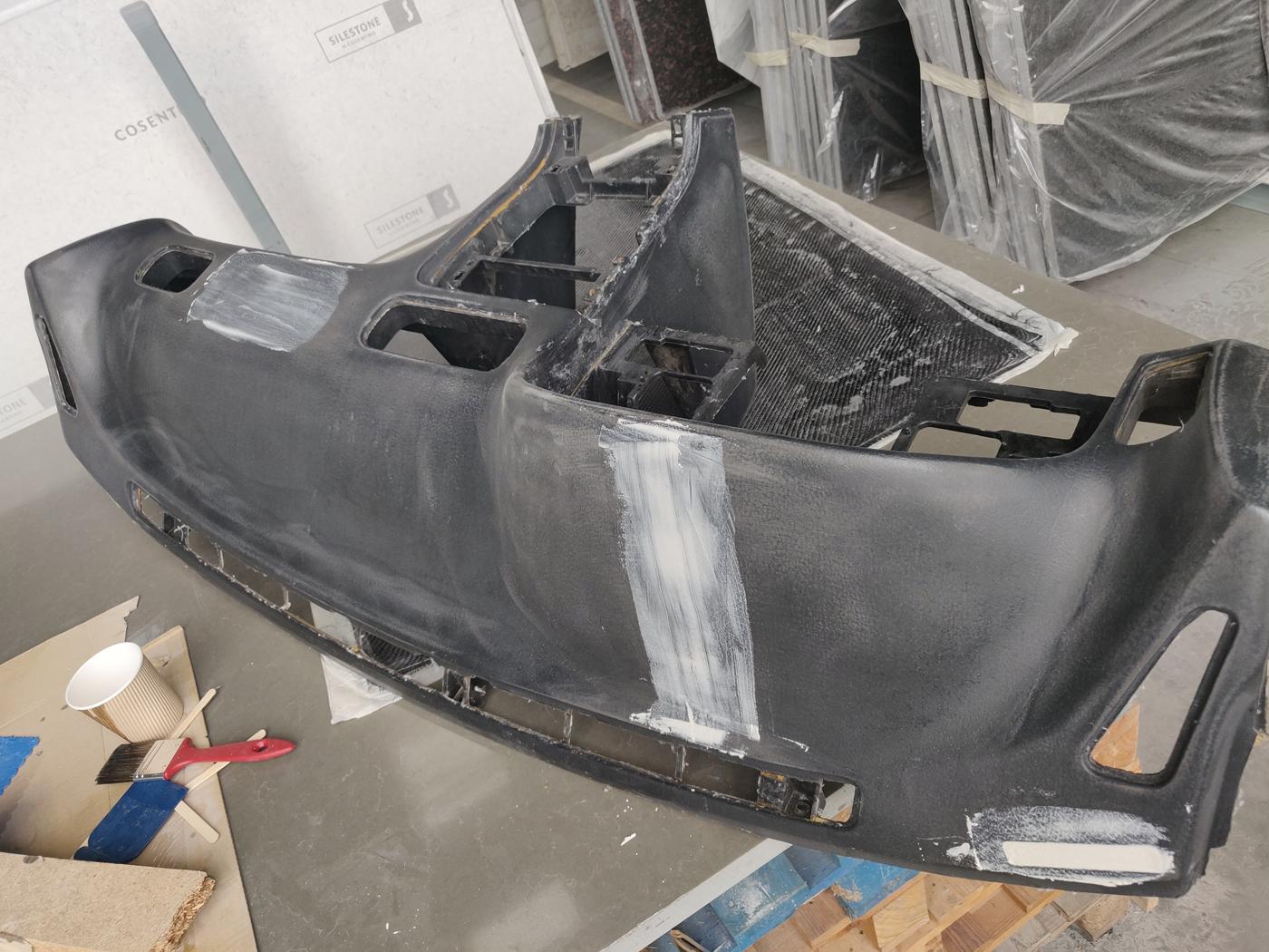

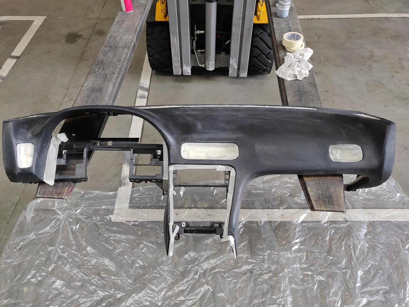

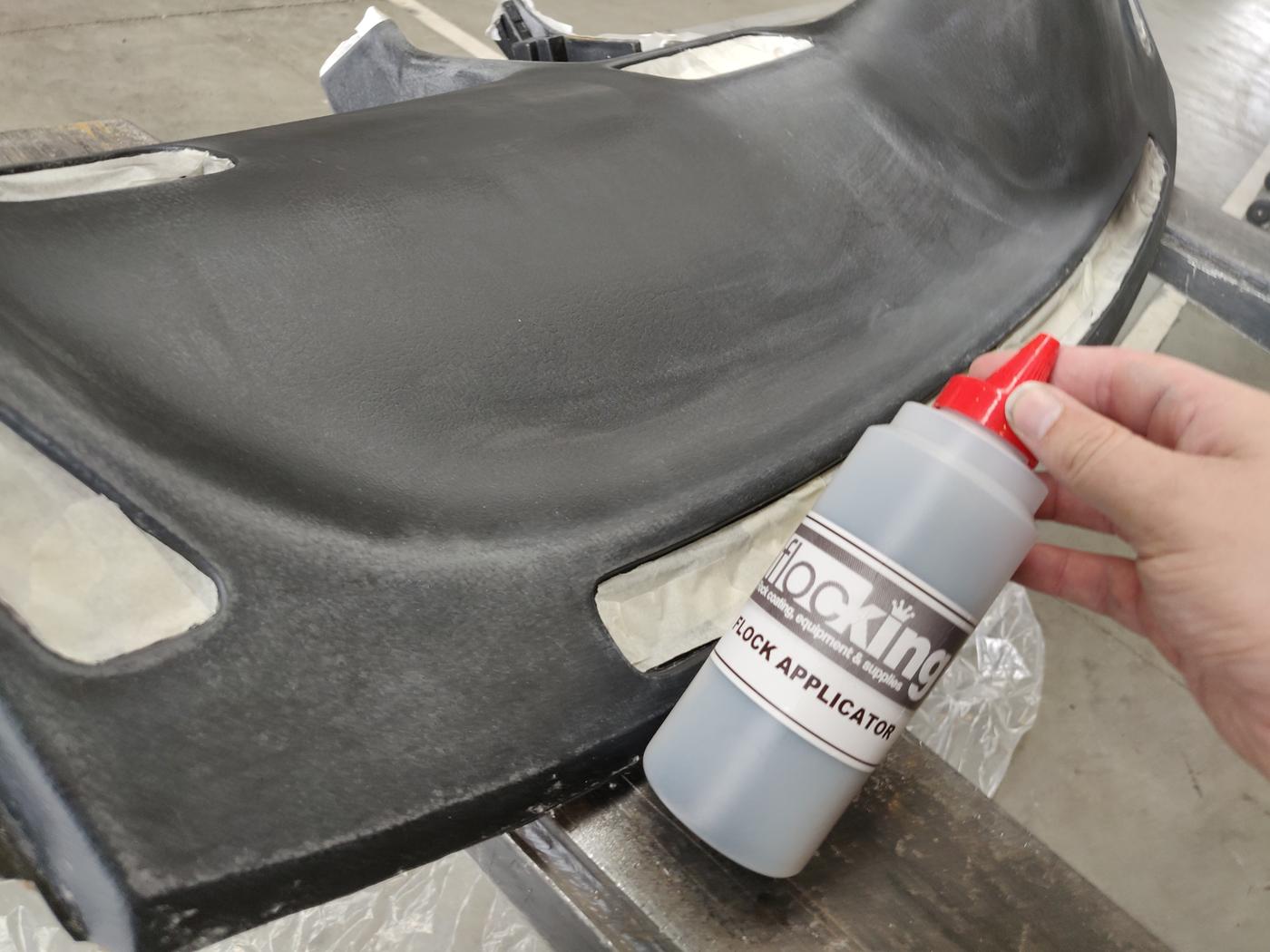

Over a year ago i bought a cheap dash, that i wanted to do something to. In the start i wanted to integrate some 52mm holes for gauges, but figured that it would be to 2005. So i desided just to flock it. I went on ebay and ordered a complete flocking kit and went crazy.
This was a BIG mistake!
The "glue" was some paint that dried so fast that 3 people couldnt put it on properly, so we had to put it on over 3 days - and it looks like shit. Im very displeased, but you can see the result in the pictures.
Next project will be to remove the flocking from the dash and try something else.

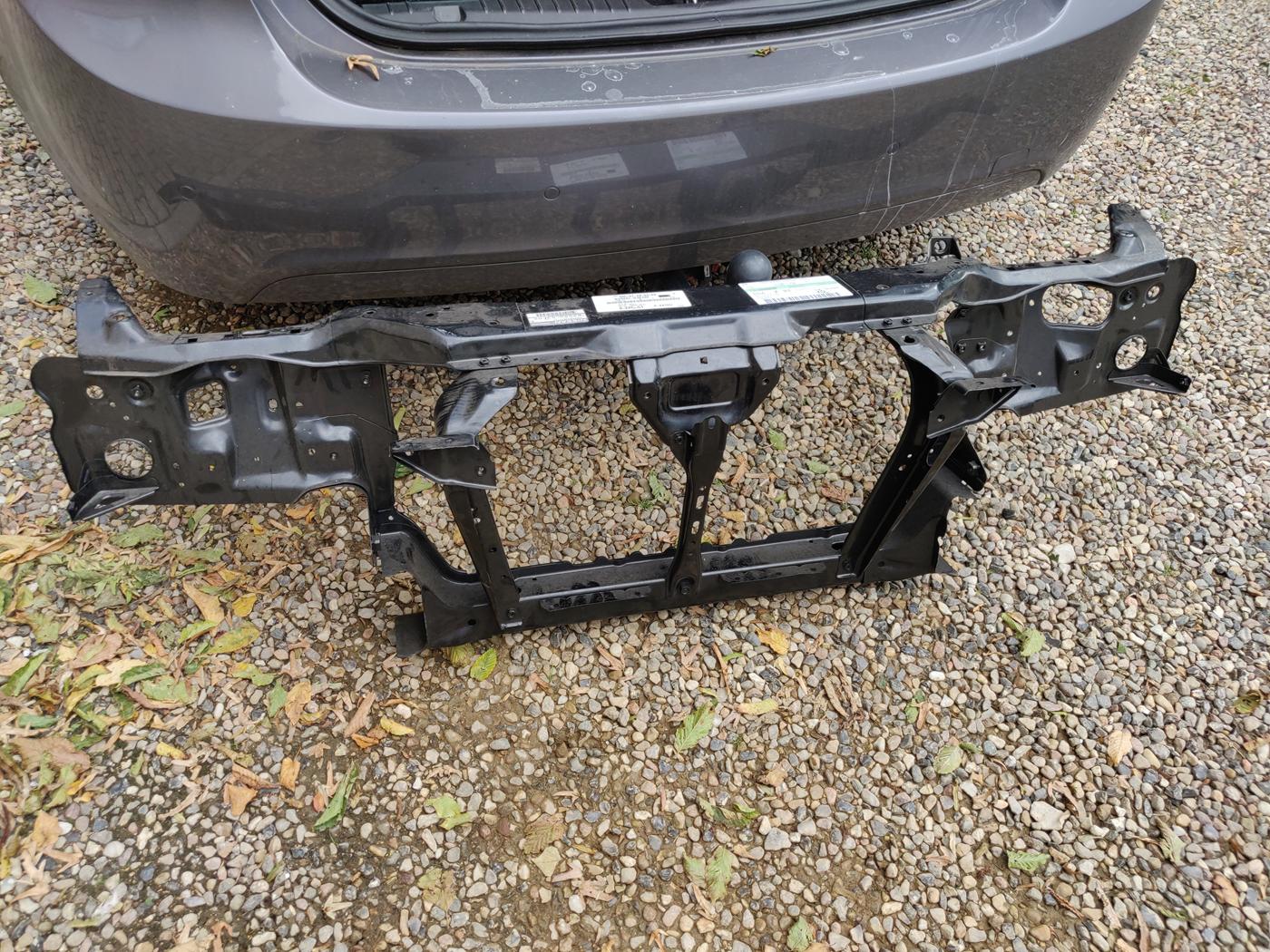

Another really bad thing about the car - we have to install a new radiator core support as mine is bend more than we thought. I ordered and paid it 2 month ago, and hopefully it will arrive in the end of this month.
But i received my Work Euroline DH wheels! This have been hell. The danish postal service is extremely bad. Dont know anything about customer service.
The story is kinda funny though. I ordered the wheels from Crooober in Japan with cheapest shipping (about 2 months of shipping) It arrived in Copenhagen, Denmark. The danish postal service returned the wheels to japan because they were to heavy. Didnt even give me the opportunity to drive 300km to pick them up myself. And they were returned by air. A few days after i was contacted by Crooober customerservice telling me that the wheels have been returned and suggested to ship my 4 wheels in 4 individually packed boxes. I agreed and waited another 1½-2 months.
All 4 wheels arrived in Copenhagen, Denmark and was there untill i paid the import charges. This was done instantly.
The 2 first wheels was delivered at my work where they were left together with some trash and my colleague was very close to throw them out. I contacted the postalservice and said i have never received anything, and the day after the deliveryman came by and asked if we didnt find the wheels, I told him that we had the wheels there the whole time, but i just wanted to make it perfectly clear for him that NEVER leave packages without a signature at a company.
Wheel number 3 came a few days later and it was signed for.
But wheel number 4...
Ohh boy... Let me repeat that the danish postalservice have the WORST customerservice ever!
I wrote to them telling that i can see the package havent been released from customs. They said it was because i havent paid the import fees - i had, and had proof of this. They couldnt help and told me to call their customerservice. I called the customerservice, waited around 30 minutes and because they dont have access to the import-information. I was told to call another number. This was a direct line and it only took 5 minutes. Here i was told to send the receipt of the import fee to the same mail-address as i wrote to in the start... After a week i called again, and they couldnt find the fucking package!!!
In the end the last wheel arrived, so i now have a complete set of Work Euroline DH 18x8/9.

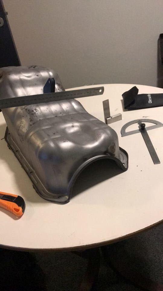

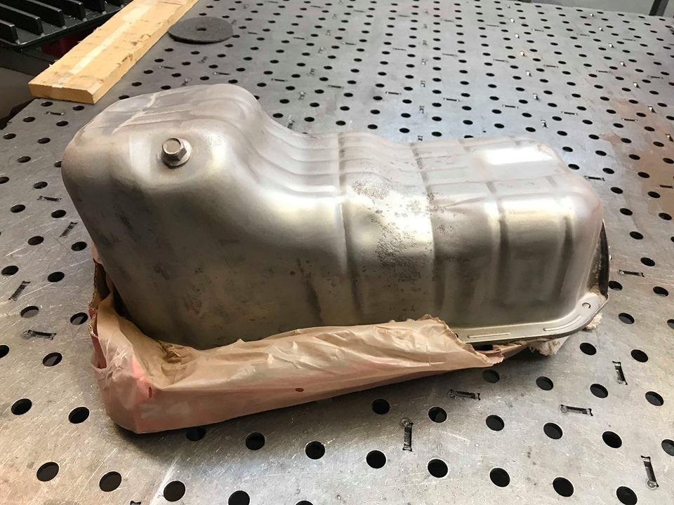

An old friend who is going to modify my oil pan/sump send me a few pictures of the process. And it looks very promising!
It was sandblasted on the outside, and he started to draw the larger pan so theres room for more oil, and of course some baffles. Do i need this? no. But we do this because we can :D
Also, after months of waiting, my part from Nissan finally arrived! Only took about 2 months as it needed to be shipped all the way from Japan. But here it is!
Item number 62500-53F00 - The complete front!
So now we can finally get it all put properly together so my painter can do his job.

Wow, how did you manage to get a new front core support assembly, I thought they were discontinued?
Jyttah 09-18-2019 01:35 PM
I just went to the local Nissan dealership, threw around 500USD after them and they ordered one from japan. 2 months after it arrived ;) But yes, they are getting hard to get.

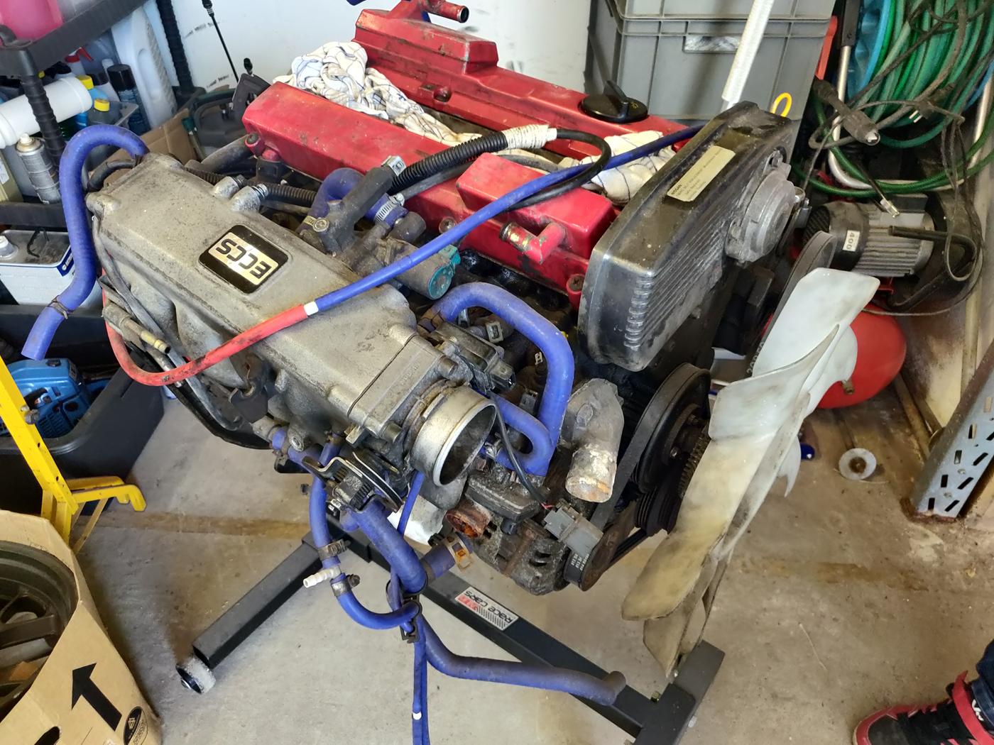

I have a small update on the engine.
We finally got some of it back together.
We started with freshly honed cylinders and a beer to plan the weekend.

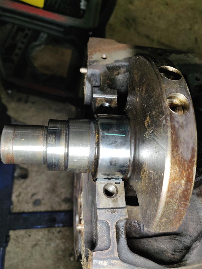

I ordered King Racing bearings in standard size for both main and rods
And they were installed with plastigage 0,025 inch / 0,076mm
And the result was this:
Looks pretty good so far.

Jyttah 01-06-2020 12:51 PM
So... Disaster happend.
My mechanic took the front apart to install the new radiator support. And he found this small error:
Is this even possible to safe? if so, how?
Making a tube front is not an option as its gonna be used for street. And the laws in this country does not accept something like that.
But on a sidenote, i finally picked up a hood i bought 10 years ago for my old S13:
cherryhatch 01-07-2020 09:10 AM
Hopefully one of your awesome friends owns a frame rack!! Hahaha, but seriously it is unfortunate finding that damage after the engine bay had been painted :(
ingmar F 01-08-2020 03:50 AM
in the netherlands they have company's that have a frame straightening bench.. i don't know if you have something like that in your area. but i think they can fix that for you
Jyttah 01-18-2020 12:30 PM
https://pbs.twimg.com/media/CILw47_WsAAENCU.jpg
I had an awesome friend who got the front back where it belonged. We spend hours meassuring so everyting is exact where it should be. All with the help of a big hammer, some wood and a jack (and some beer)
Here is the after pictures where you can see how much we moved the front:
Installing the lights on the radiatorsupport for easier install:
And welded it back where it belonged after even more messurements
Now when the radiatorsupport FINALLY is installed for the last time in the cars lifetime, i moved forward tomaking brackets for the frontmount Mishimoto intercooler. This is the first edition to see how it would fit behind the TypeX bumper.
Unfortunally it didnt fit as the TypeX bumper sits pretty close to the radiatorsupport.
But by making the lower intercooler brackets shorter, it got more angle, and it looks like it would fit if i trimmed the bumper and indicator plastic a bit.

When we are working on my car, we always have fun and play around. Its always better to have some friends who enjoy the same hobbies.

I had a quick look under the car, and realized that i cant wait until we have the whole underside rustfree and coated. Theres a few spots where we need to weld in some new metal. But overall it looks pretty good for a 30 year old car in a country where we use excessive amounts of salt on the roads in the winter.

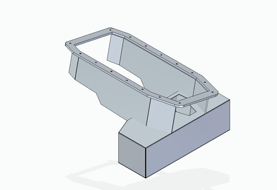

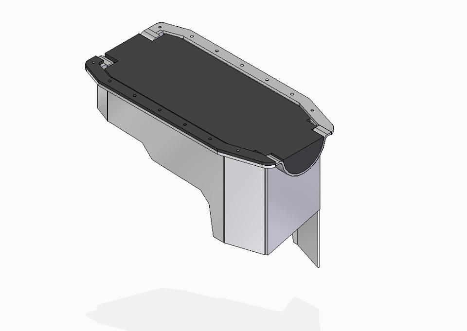

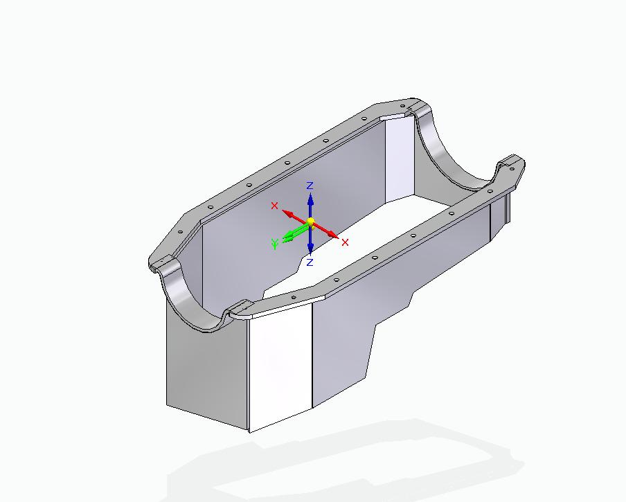

Jyttah 01-19-2020 02:14 PM
And i just got a few pictures of the progress of the sump. It looks really promising!
https://billeder.bazoom.dk/biler/alb...kar-design.jpg
I would love to design stuff for the car, so im starting to learn how to use Solidworks. And no, its not easy, but i like a Challenge :P
Jyttah 02-25-2020 04:00 AM
Time for another update.
I had a single day where i went to look at the car. This time i had to do something different.

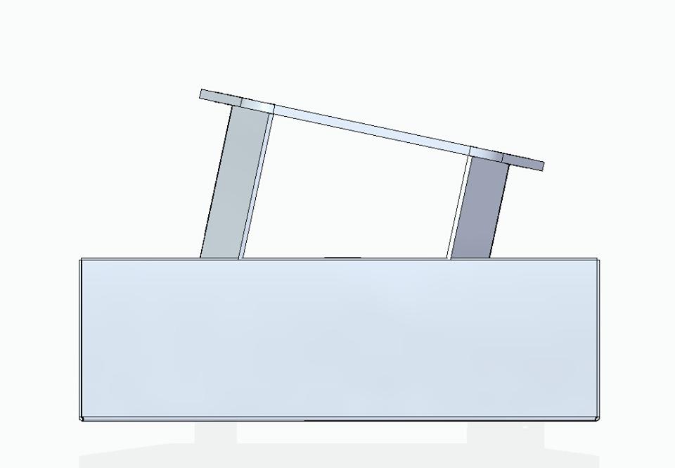

My friend who are creating the oilpan for me, asked me if i can figure out how much space there is for a intake and exhaust manifold as he would like to design these. So i had to figure out how to get these measurements. The car is 360km away from him, so its not possible for him to go and do the measurements himself.
After a LOT of research, i found a solution. My friend is a technical designer among other things, so if i could create the enginebay digitally, he can work with that. So the solution is a 3D scanner.
https://www.instagram.com/p/B86oz2unQtz/
So now he can create everyting without even getting his hands dirty :P
Next stop, is to 3D scan the CA18DET engine.

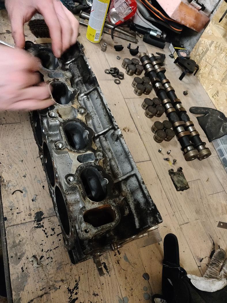

My mechanic took the valves out of the head, and they look pretty good. No need to change anything here

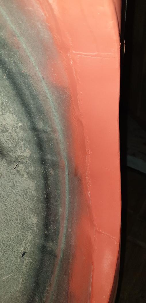

Last but not least, I have to do some fiberglass work, so we can get the car ready for paint.
The rear valances have to be extended around 2-11mm to follow the OEM lines and the right overfender had to be shortened 2mm in the end.
Nothing a bit of fiberglass cant handle :P

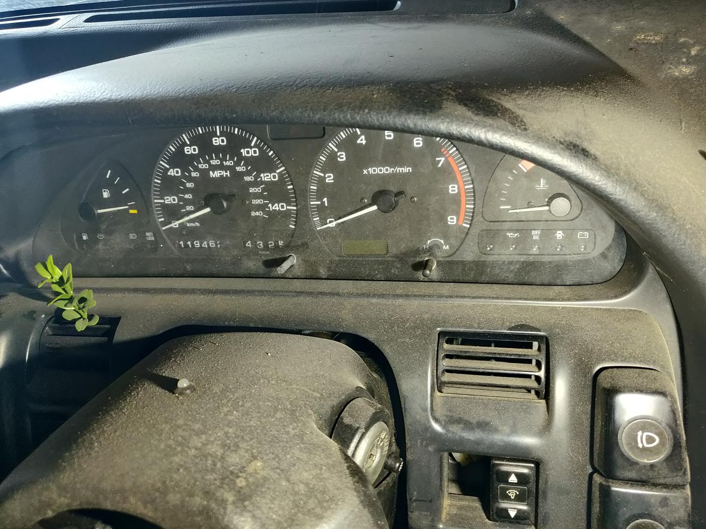

I have a spare instrument cluster, so i wanted to install my Defi Advance ZD instead of the rpm. But after some looking around, i noticed its not possible as i couldnt access the bottoms. So i wanted to do something else.
Ive previous been working with carbonfiber, i figured it could be cool to have inside the instrument cluster.
I started with a small piece of carbon i had laying around. As its only 2 layers of carbon cloth, its very thin. but its perfect for this application because we dont need any strength.
https://billeder.bazoom.dk/biler/alb...plus-andet.jpg
I cut it down and sanded it so it would fit inside the instrumentcluster.
And remember, ALWAYS use a mask when cutting or sanding carbon fiber.
https://scontent-arn2-1.xx.fbcdn.net...f2&oe=5EA71BB9
After all the cutting and sanding it was washed to remove the dust. Then its time for some epoxy. Here i can give it some extra color/glitter. and it gives me the possibility to wetsand it so it gets extremely glossy.
I also painted the surrounding plastic as previous owner painted it purple, so i found some mat black that fits the whole theme.
Together with the carbon, it looks really good and clean.
