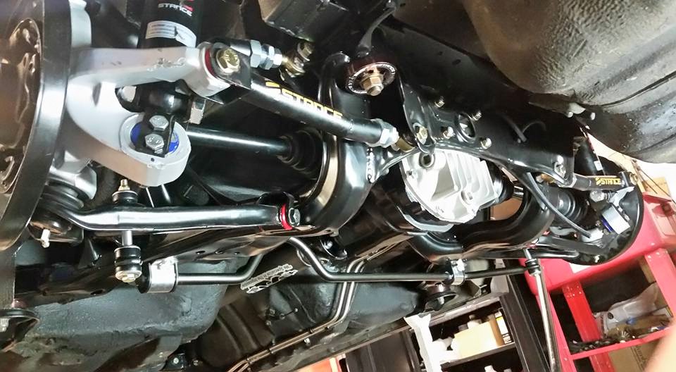

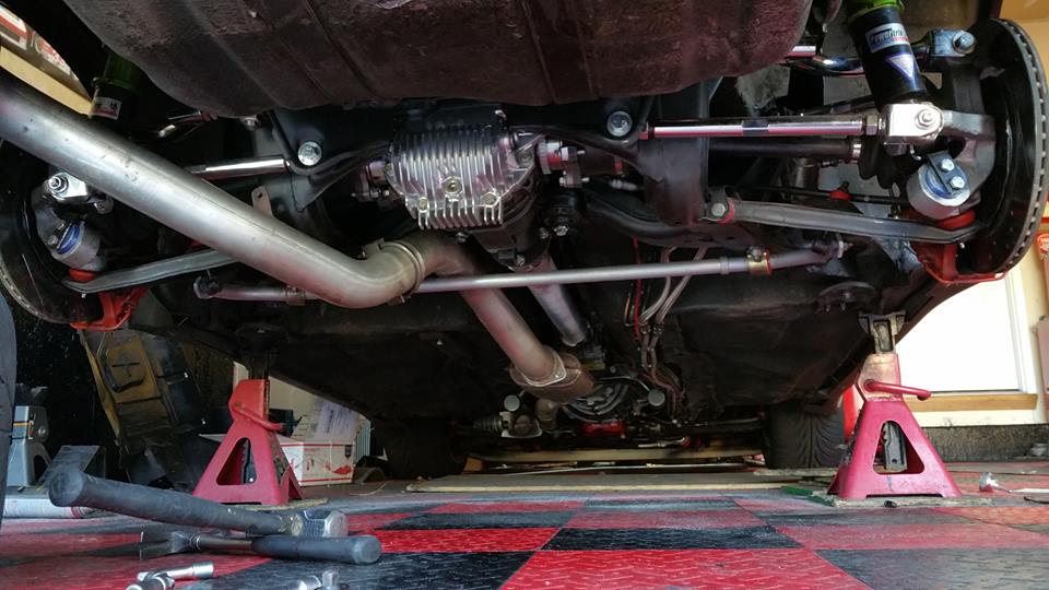

Blksrt4 11-06-2014 08:29 PM
Got mine in last week, I must say I'm impressed with the quality of the kit. Was a breeze to install and didn't take too long. I've yet to drive on them but I figure I'd post pics of them installed.

[email protected] 07-04-2015 07:14 AM
Another successful conversion :)
http://responsetype.com/imagedump/z32upmnt-tjp.jpg
JSimpson 07-17-2015 12:12 AM
How are you guys liking these? From the guys who have driven on them, is the bind gone like on an S14 knuckle or is it still present (like using Z32 knuckle on S14)? Thanks!!
[email protected] 07-17-2015 01:32 AM
You see the pic I posted last?
You can clearly see the near side, where the adapter matches the inward tilt of the coilover body.
On the far side you can see the misalignment from the upright mount to the coilover body is not a problem either.
So far I haven't received any complaints, just questions...
