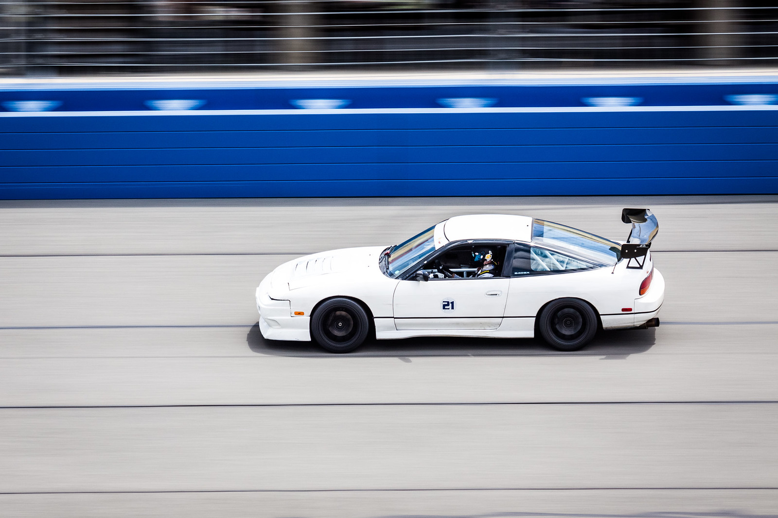

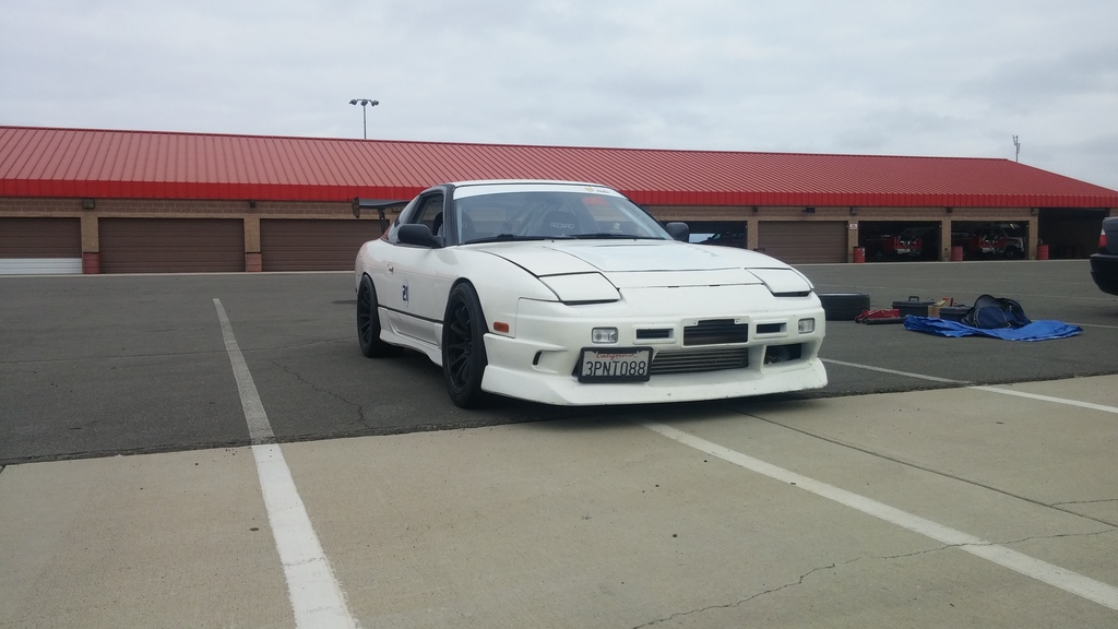

June. 2016 Auto Club Speedway (ACS) Roval
https://s3.amazonaws.com/static.fixp...psl6juufcd.jpg

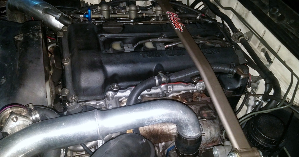

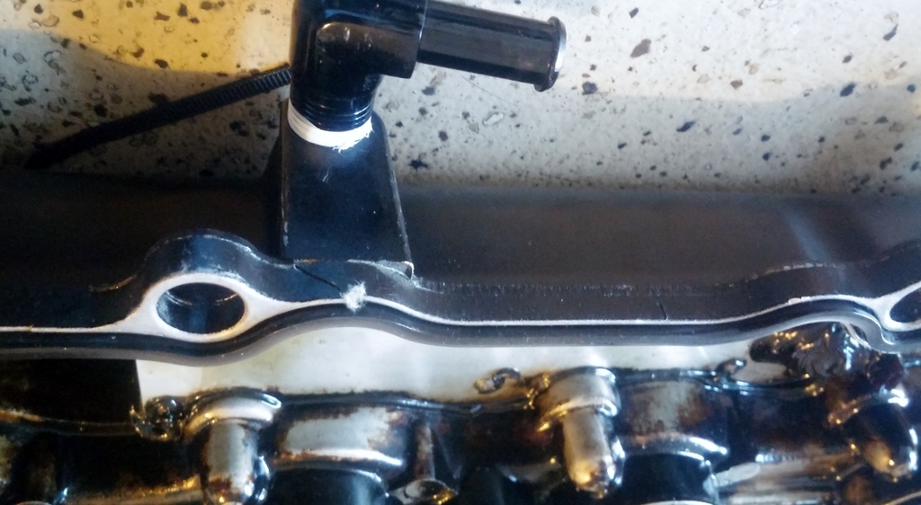

The day started fine but after revving high on that bank, oil started shooting out from valve cover. I think the ebay catch can I have was too restrictive.
https://s3.amazonaws.com/static.fixp...psq6poh40y.jpg

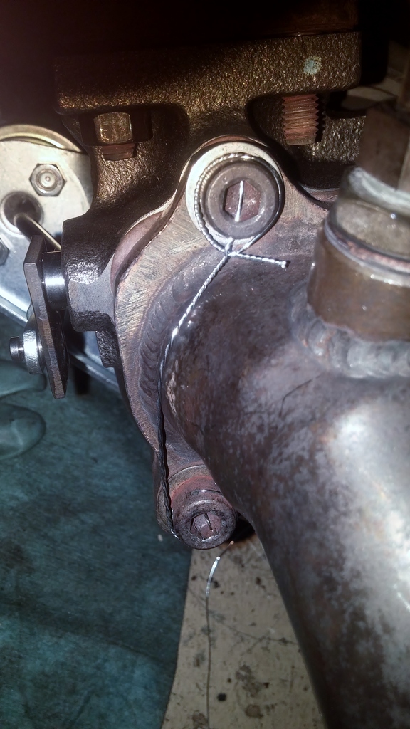

three downpipe bolts decided to shoot out after continuous heating/cooling/vibration. had to tow the car home :-/
http://www.youtube.com/watch?v=UkdVeXS2RWw
Best time of the day was 2:03.8.
Still have a lot to improve. hopefully I can get my sway bar/ oil catch can in by next track day.

installing the factory oil separator or utilizing a s14 SR valve cover will help with pushing oil. These engines like to do that without either or.
Yea definitely, I'm looking into modifying my valve cover to pull some pressure out. Thanks.

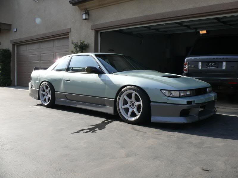

Originally Posted by rawgarage (Post 6077504)
1 year in the game...
1st year time attack but not the first 240
here are some from past:

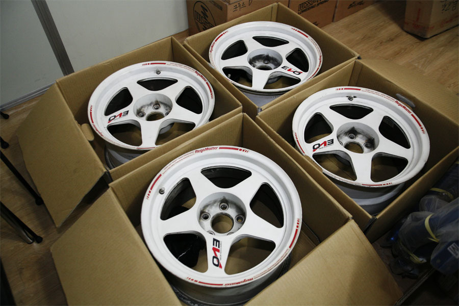

once I get the tires, I can rock the new wheels!
https://s3.amazonaws.com/static.fixp...ps9sogmixc.jpg

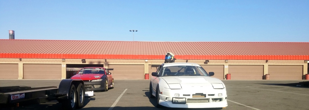

Getting ready for ACS Roval (California Speedway) 8/13/2016
https://s3.amazonaws.com/static.fixp...psnyy2mm9h.jpg

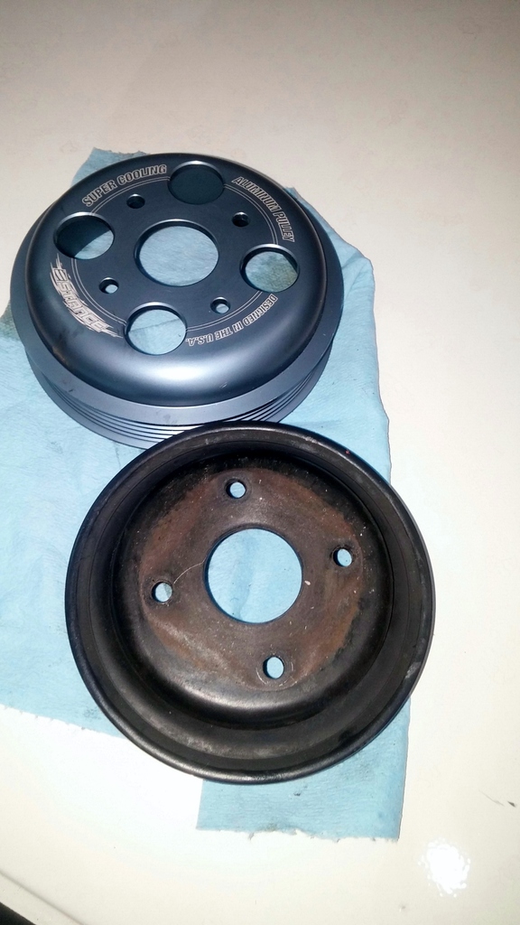

Changed water pump pulley
https://s3.amazonaws.com/static.fixp...psrmdxxbbj.jpg

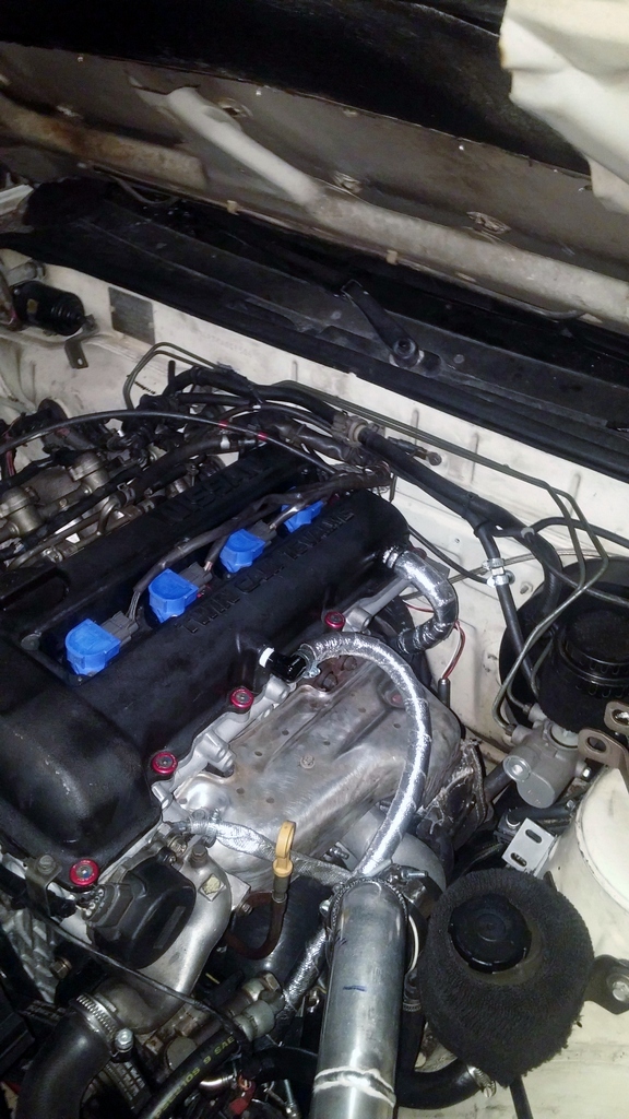

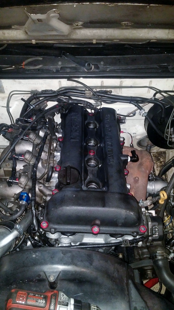

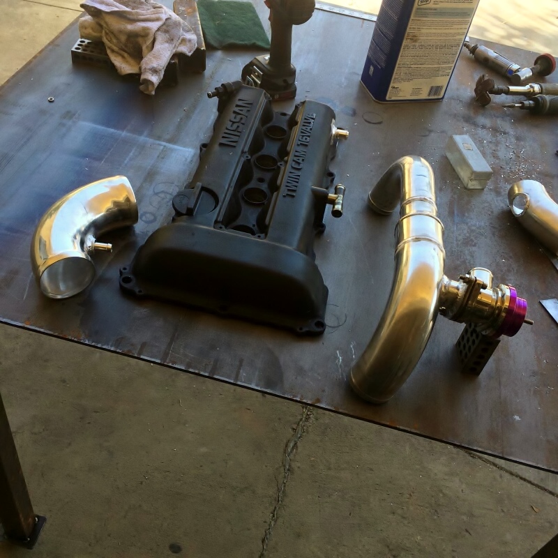

Added stock oil separator to see how much better it is. If this doesn't do much, I'm gonna have to modify the valve cover
https://s3.amazonaws.com/static.fixp...psfbbljcbp.jpg

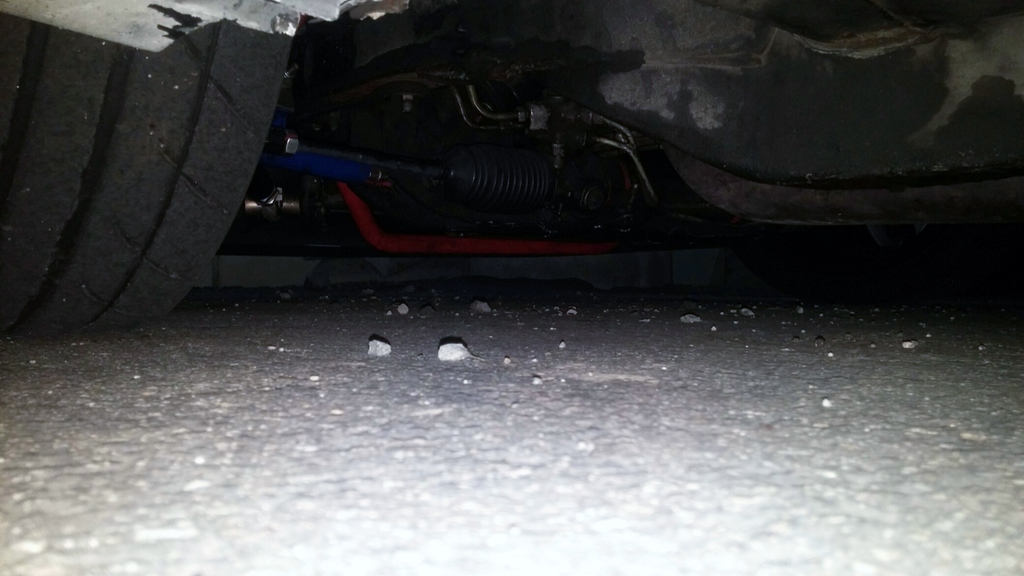

Added whiteline sway bar on the front.
When I installed both whiteline fr/rr, car oversteered just as before.
I ended up with 27mm front and 15mm on the rear. Hopefully this setup works better.
Is anyone else going? I think there is nissan challenge this weekend.

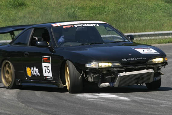

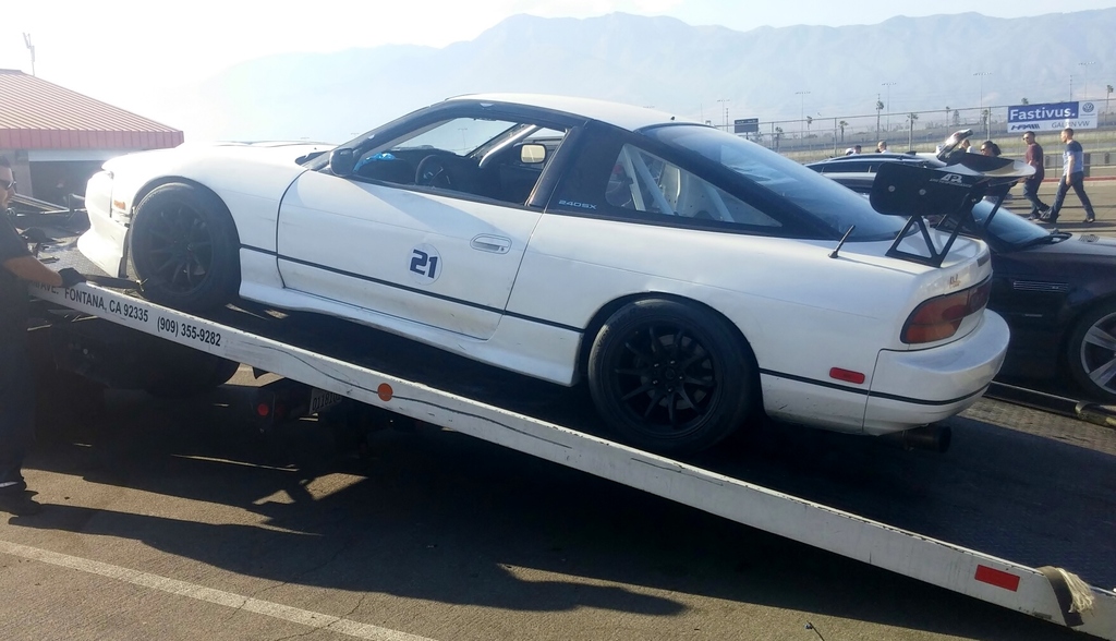

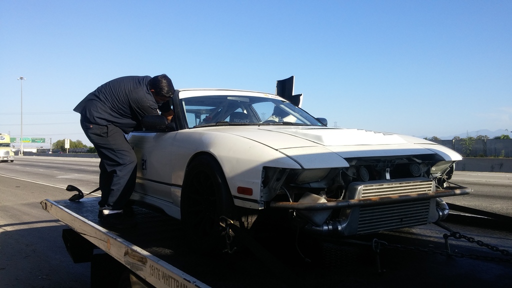

battery1882 08-18-2016 04:08 PM

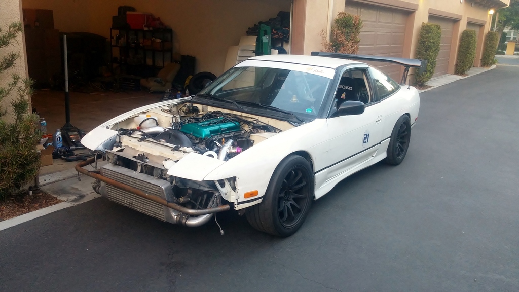

I went back out to ACS only to find more trouble.
https://s3.amazonaws.com/static.fixp...ps4wxx76n8.jpg

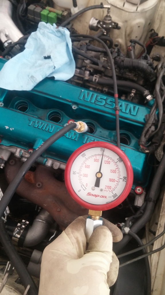

First session after warm up lap, my intercooler hose blew. No big deal, just clamp it down tighter and go out on the next session.

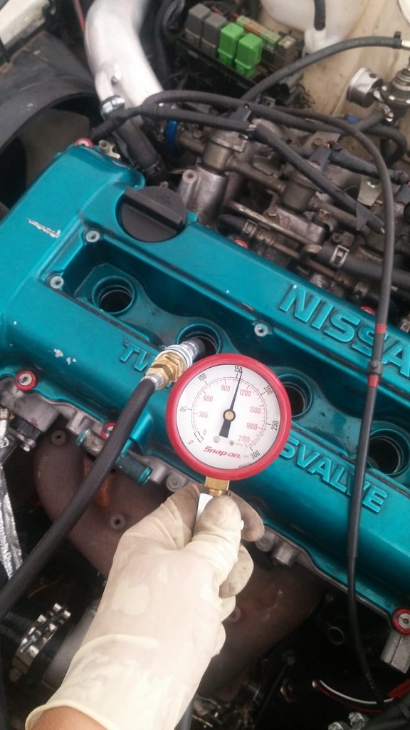

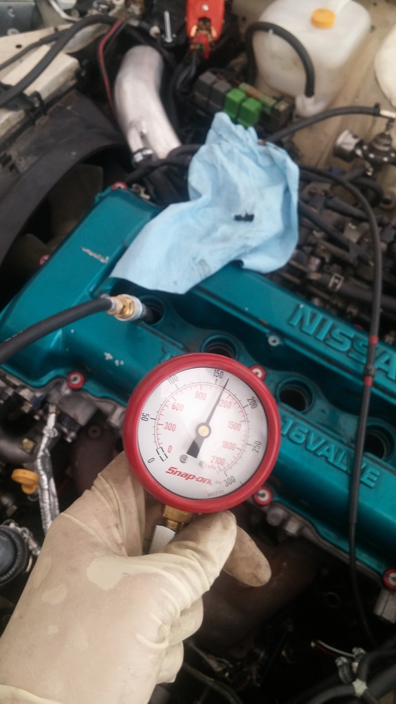

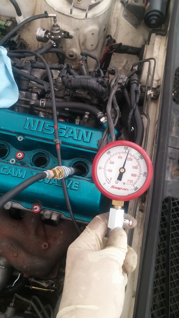

Session 2: as I finish my lap 1, car started to lose power. I look at the temp gauge and it was pegged hot. I try to pull over to a safe area but car eventully died and never started back up.:facepalm:
Looking back, I think my timing was set wrong (on retard) which caused my engine to run hot. Once it got hot and built pressure, one of my radiator hose clamp was not fully tight as all of the coolant leaked out.
I verified this by pressurizing coolant system.
compression on cylinders are 90-90-90-20. probably seized the piston as well.
It's all my fault. having a warning gauge would have been nice in retrospect.
I'm gonna try to figure out where to go from here. maybe another SR or VQ.
Definitely planning on keeping the engine stock as possible.

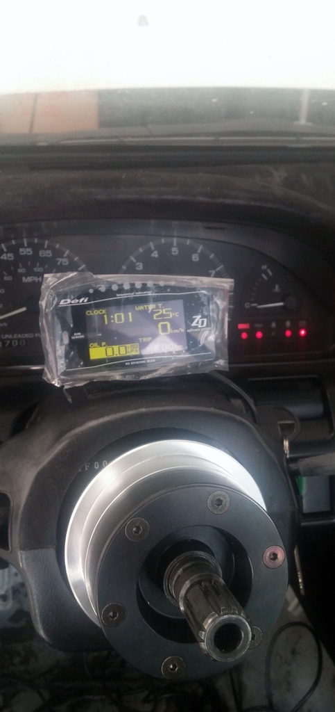

I was actually talking to a buddy that has set of defi gauges with warning lights for his car and he told me he saved his engine one time from oil starvation.
I always thought they were waste of money.. time to change my mind.

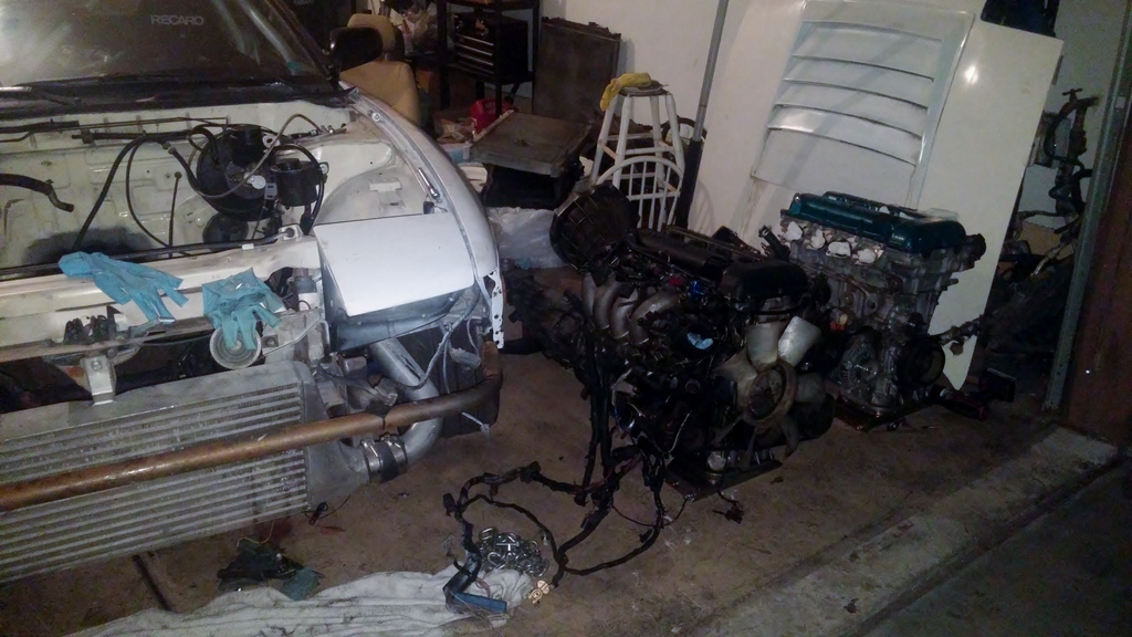

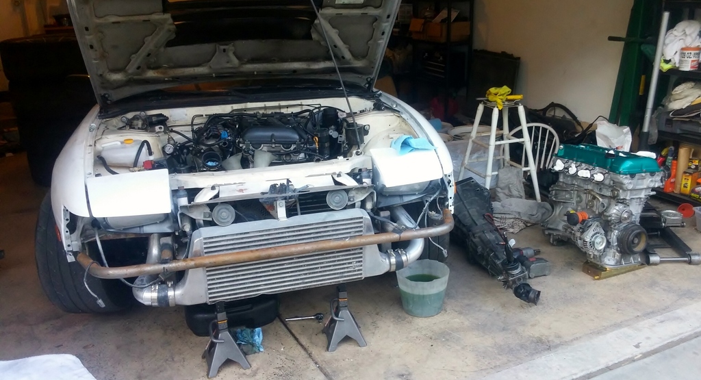

battery1882 09-15-2016 10:52 AM
Been busy with traveling and some personal issues..

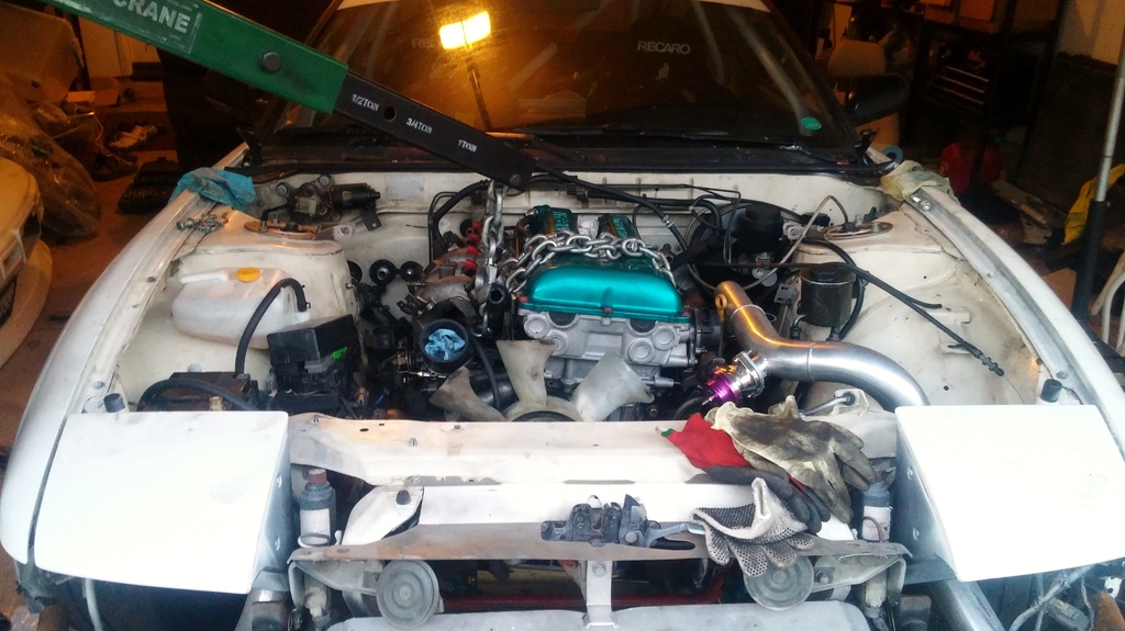

https://s3.amazonaws.com/static.fixp...psz9khsd65.jpg

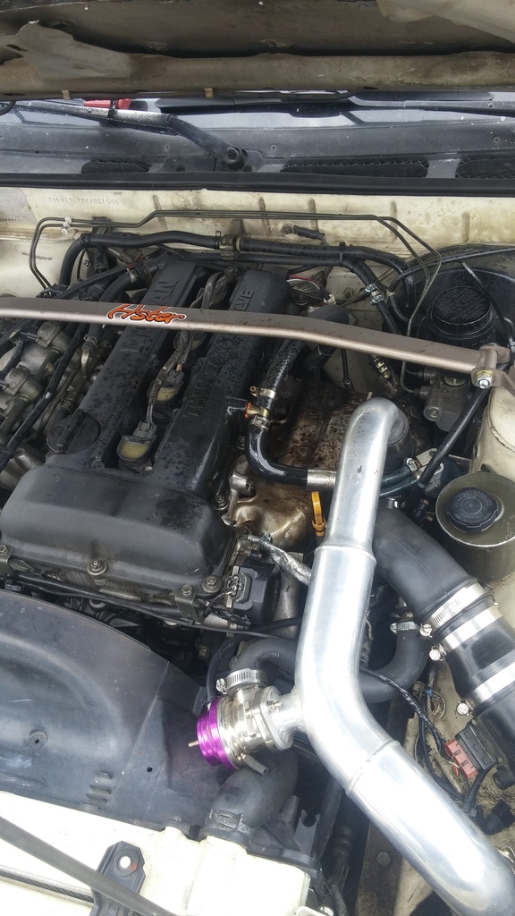

Managed to pull the motor out
https://s3.amazonaws.com/static.fixp...psxwkpares.jpg

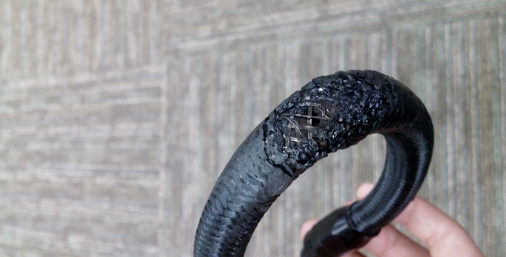

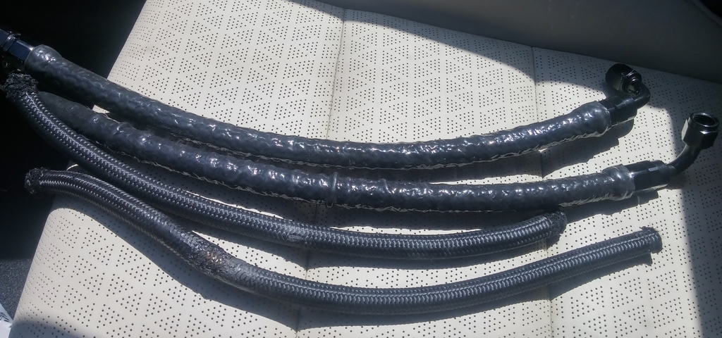

Found this! looks like it was resting against the turbo. Perhaps, that's the reason for overheating...

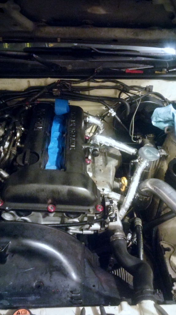

https://s3.amazonaws.com/static.fixp...psklz7mkcn.jpg
Upgraded the hose from nylon braided to steel braided with heat sleeves.
https://s3.amazonaws.com/static.fixp...psdkw21unj.jpg

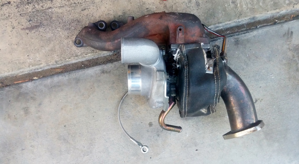

Mounted gt2871r
https://s3.amazonaws.com/static.fixp...psjtvcreqz.jpg

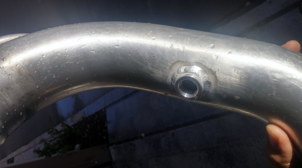

Safety wired the elbow
https://s3.amazonaws.com/static.fixp...pscjz5d57d.jpg
Ogura for added power
https://s3.amazonaws.com/static.fixp...psdcyph4kd.jpg

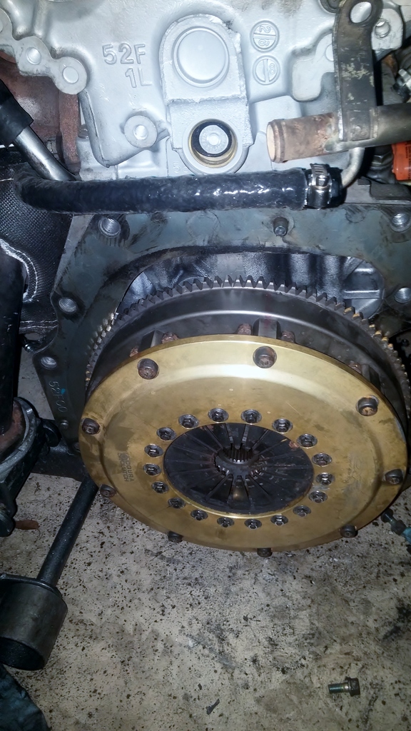

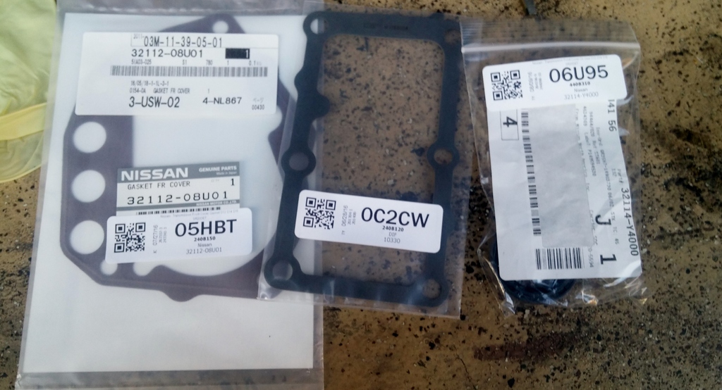

Changed trans front seal along with couple gaskets
https://s3.amazonaws.com/static.fixp...psja2bovjh.jpg
Got the motor back in
Still need to do alot more, but hopefully car will be running soon!

Had a welder weld in some bungs and intercooler pipe
https://s3.amazonaws.com/static.fixp...psvydzcgdt.jpg
https://s3.amazonaws.com/static.fixp...psudbpudsj.jpg
https://s3.amazonaws.com/static.fixp...pslor0nhi7.jpg
https://s3.amazonaws.com/static.fixp...psffob40dw.jpg
compression were all good
some more minor work and it will be ready for shakedown!
tacotacotaco 10-10-2016 02:16 PM
Found a cool shot of you from the last Corner3 Motorsports Nissan Challenge.
https://farm9.staticflickr.com/8267/...916a9a60_h.jpg
battery1882 10-11-2016 09:28 AM
Cool, Thanks alot!

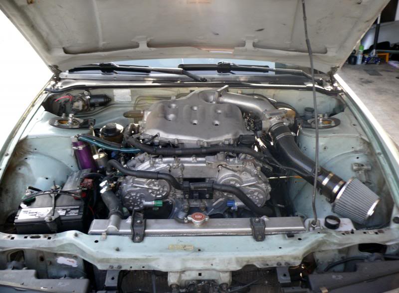

Swapped the valve cover with modified crank vent.
https://s3.amazonaws.com/static.fixp...pscvc9s63d.jpg
https://s3.amazonaws.com/static.fixp...pson7cue3j.jpg
https://s3.amazonaws.com/static.fixp...psx8gfngfj.jpg
I got the idea from slider2828's thread but I believe I can use the rear port for crank vent, kind of like s14 setup. S14 valve cover definitely has advantage with sloped rear to push fluid towards the front vent but I believe this setup would work too.
If it doesn't do the job, I would have to source a s14 valve cover. This is cheapest method so might as well try.
I will report back after getting the aem ems tuned. Looking for a tuner right now..
battery1882 11-07-2016 10:30 AM
https://s3.amazonaws.com/static.fixp...psqrhoyqju.jpg

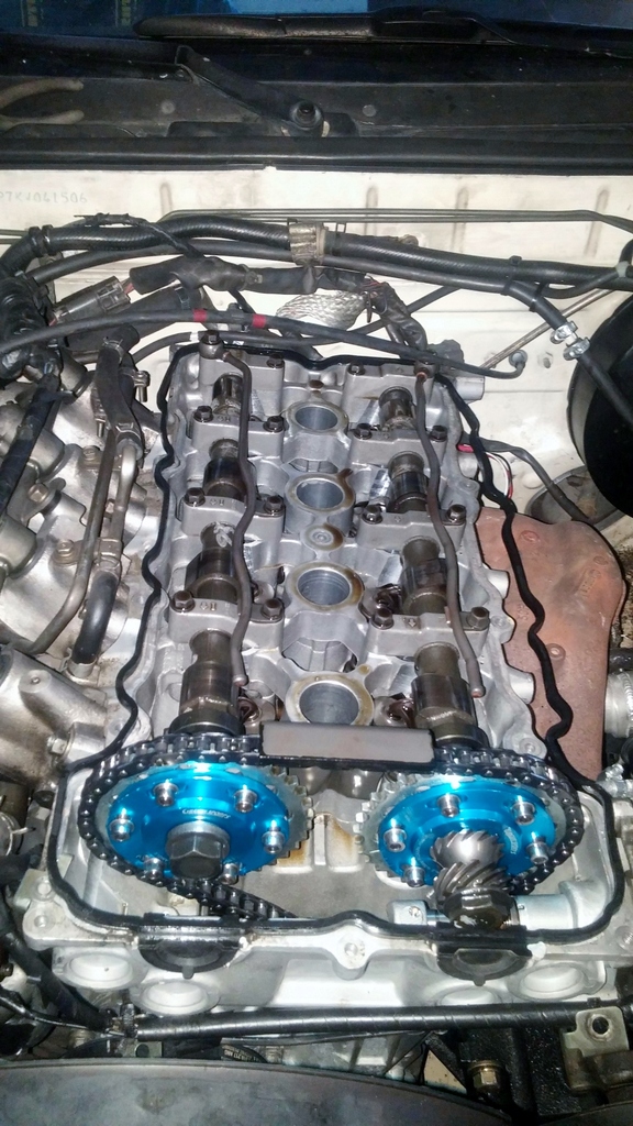

I opened the valve cover again to do the cam : jwt s4
Valve cover decided to crack. I think I over tightened the npt barb fitting.
Luckly, I had an extra valve cover but I had to have my welder weld in a bung for crank vent hose.

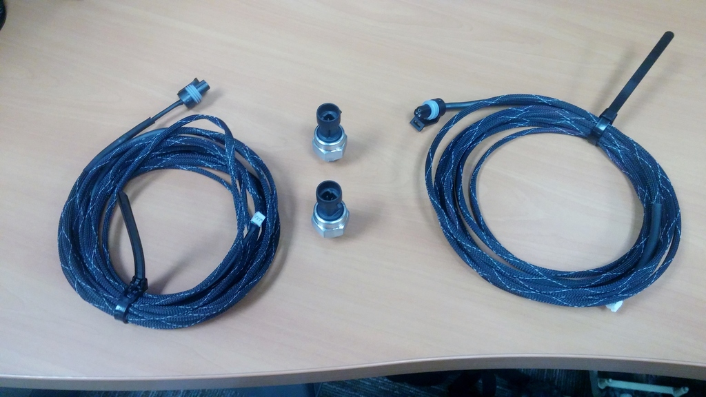

I then took out the maf and put in gm 3bar sensor along with gm ait sensor for ease of tuning.
https://s3.amazonaws.com/static.fixp...pstfn4afln.jpg
https://s3.amazonaws.com/static.fixp...psluiqlfjc.jpg
Wired up 6 sensors (4 of them had to be lenghtened like picture) for Defi advance ZD. Hopefully this will save me from engine trouble in the future (knock on wood)
https://s3.amazonaws.com/static.fixp...ps9flvwdsv.jpg
Mounted oil catch can and moved the intake down low.
https://s3.amazonaws.com/static.fixp...ps0thgxmql.jpg

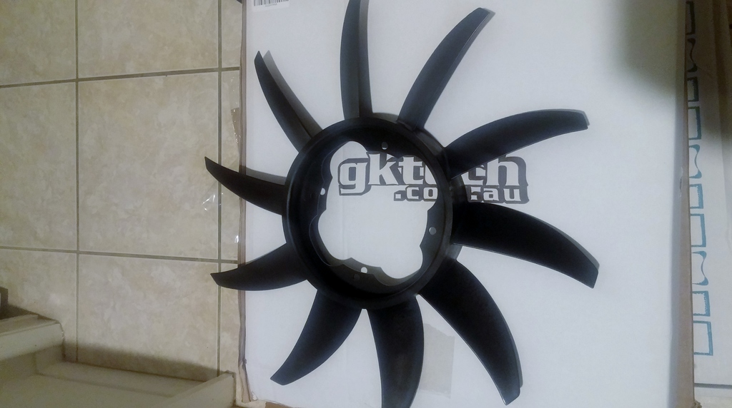

Mounted gktech fan
TheRealSy90 11-07-2016 11:25 AM
You'll love the S4 cams, best sr20 cams out there.
I like the safety wire method for the o2 housing. What did you do for the nuts for the turbo to manifold? Is it difficult to drill the bolts for the safety wire?
battery1882 11-08-2016 08:52 AM
yeah I'm tuning the car this friday so hopefully s4 will perform well.
I used stock nuts and locking plate on the turbo to manifold side. I've had alot of problems in the past using aftermarket headers where those back out, but with stock manifold, it should be good.
To drill the bolts, you just hold the bolt tight and use drill press.
