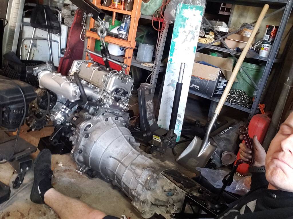

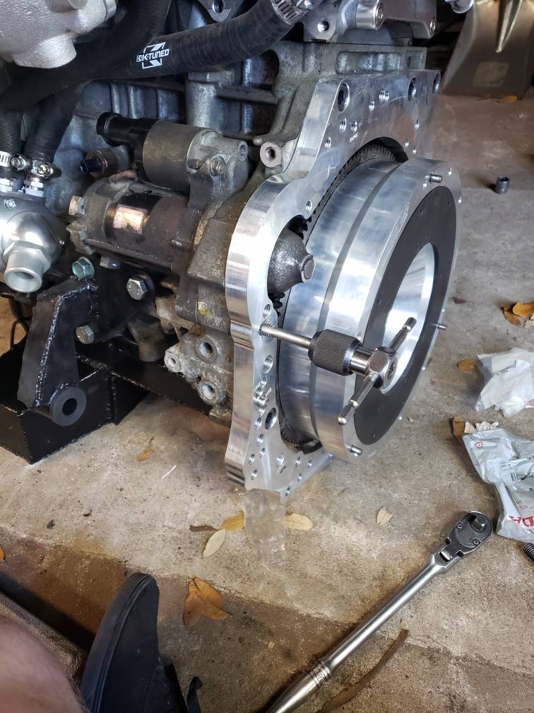

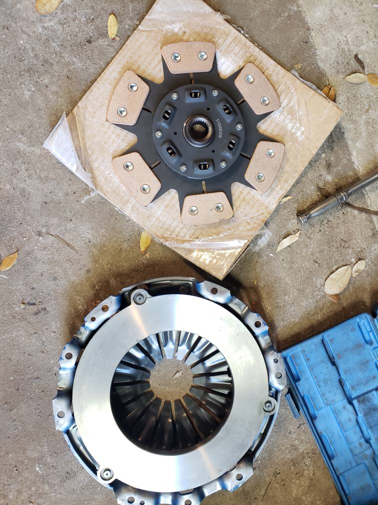

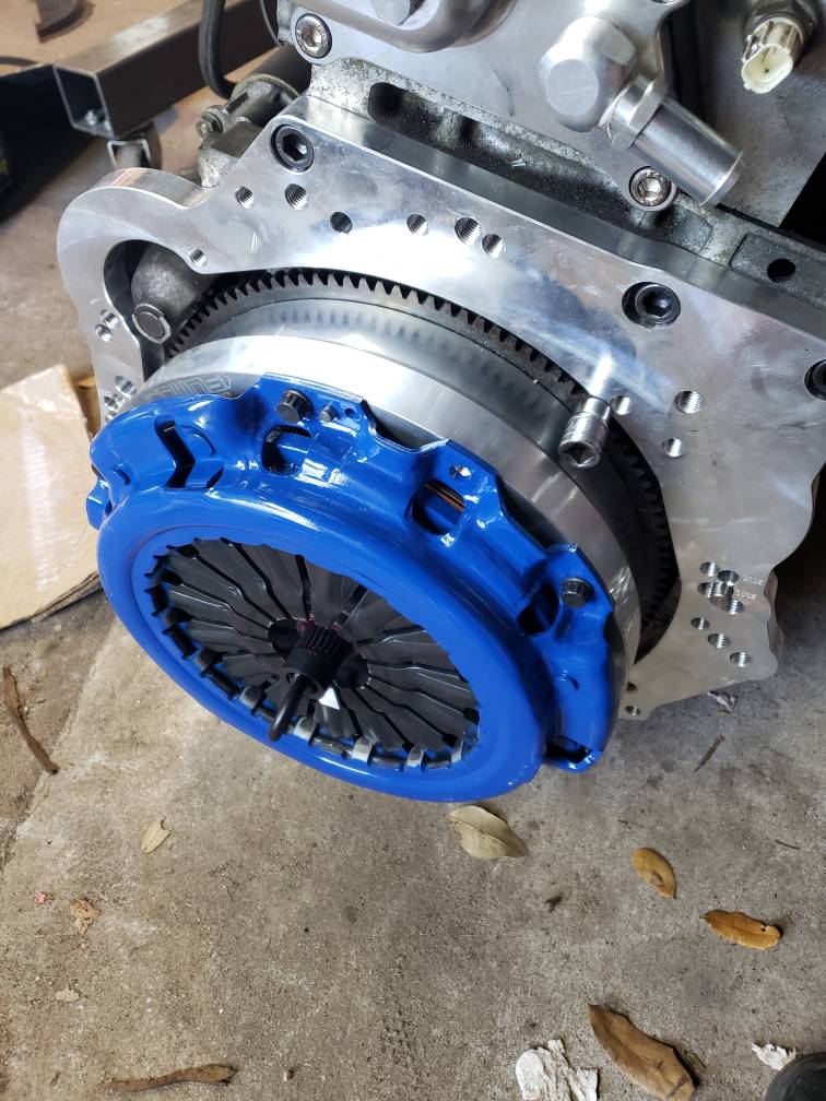

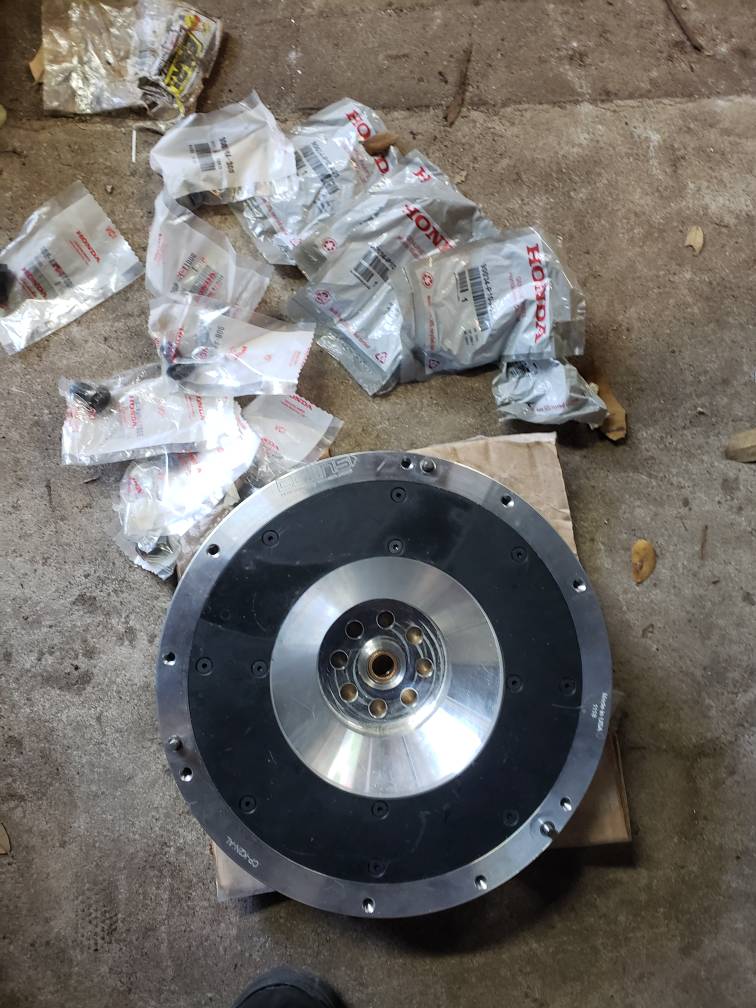

The clutch finally goes on after waiting 9 months to get it and another 2 to get home. Fits perfectly with OEM Honda hardware. When I went to install the clutch I noticed a part number on the 6 puck. Now I havent seen any logos so I looked it up. Turns out collins ships there trannsmission adapter kits with a stage 4 Ebay clutch. It's not a problem as I've used them before but it makes me wonder why this kit costs 2300$. I Also had to retap a 2nd hole on the adapter plate near the starter cause I found another hole that wasnt tapped al the way through.
https://uploads.tapatalk-cdn.com/201...81f324145c.jpghttps://uploads.tapatalk-cdn.com/201...927b9608a8.jpghttps://uploads.tapatalk-cdn.com/201...0ac401d7e5.jpg

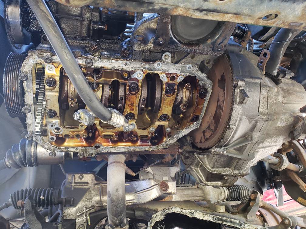

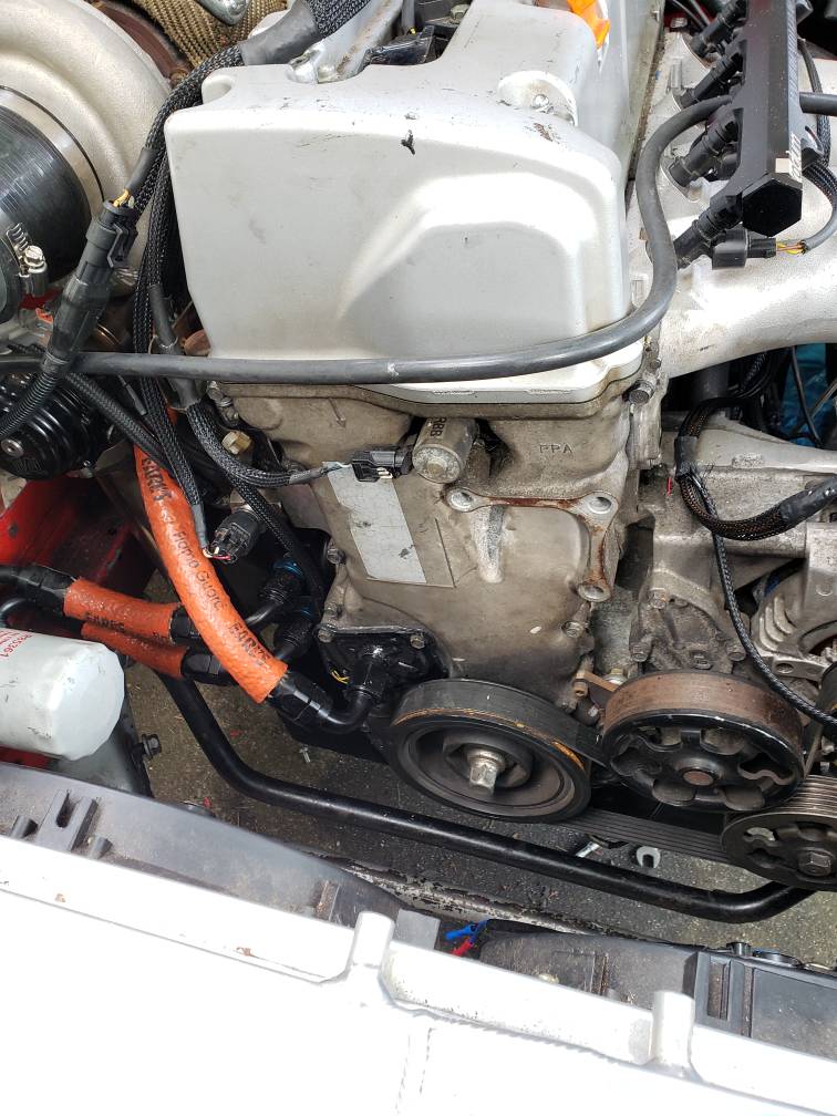

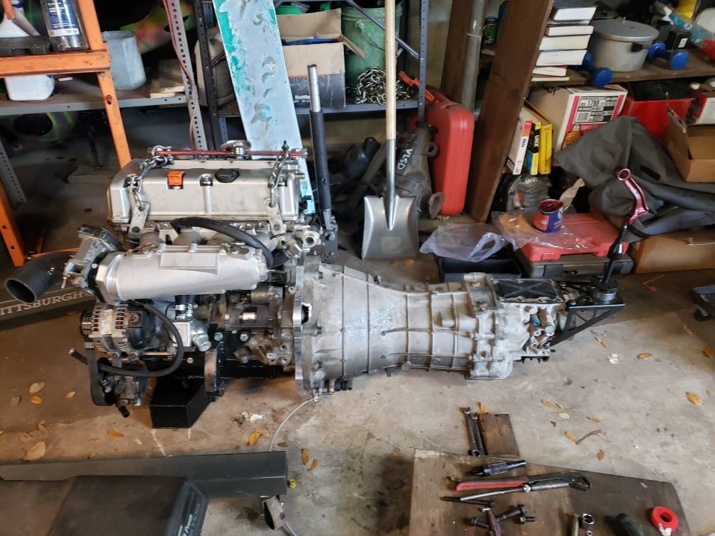

After getting the transmission on for the first time I wanted to test the clutch engagement before putting the engine in, as theres no room to pull it in the car and many people in the CD009 everything theard have had issues with this. So I got creative and pulled the master off my car, bench bleed it and then gravity Bleed the slave. I couldnt get all the air out but with a bit of squish in the pedal and a heavy pry I could get the clutch to disengage. Something tells me I'm not gona like this heavy clutch so when the Ebay clutch goes I'll get the inlinePro twin disc.
https://uploads.tapatalk-cdn.com/201...cc2ab3887e.jpghttps://uploads.tapatalk-cdn.com/201...ce484d2d3d.jpg
The transmission has to come off as I only had 6 out of 9 pressure plate bolts at the time. But after I hammer the tunnel on the next dry day I'll install the motor and get cracking on the last of the odds and ends. While it rains tommorrow I'll just knock out welding on the exhaust.
https://uploads.tapatalk-cdn.com/201...5b0061b967.jpg
https://uploads.tapatalk-cdn.com/201...1437aa3081.jpg

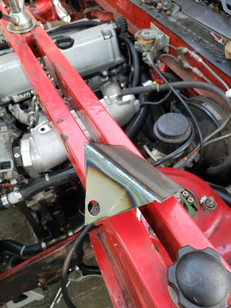

Friday I knocked out a heatshield for the fuel lines and body. Cleaned up the firewall from when I was using a VW coolant tank on the KAT and extended the body harness to fit around the heat shield. Also, while the motor was still out i went ahead and upgraded the oil cooler.

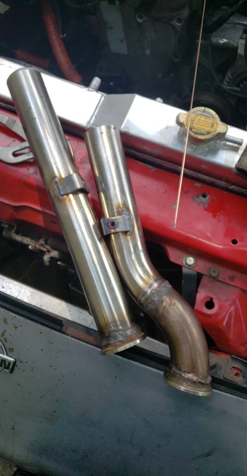

After wards I went about finishing the turbo manifold. I couldn't weld it the garage cause its only on a shared 15amp circuit with one of the bedrooms and it over 200ft from the breaker. Can only reliably weld exhaust in the garage. Even though this house has a detached 3 bay garage cause of this is almost useless for fabrication or hobby work. The bays are also only like 3 foot deeper then an S13. Because of this Ive always had to use the air compressor from an outlet by the water heater room outside the house. Well told I decided to try and weld in that tiny ass room. I don't know what amp this outlet is rated for, this old house has a shit labeled breaker box, but it let me weld constantly at 130A which was what needed.
https://scontent.forf1-2.fna.fbcdn.n...74&oe=5D2DAA4A
After finishing the tight spots on the runner 2 and 3, I attached runner 4 when the collet on my tig torch wore out. It would no longer hold the tungsten. At this time my neighbor dropped by and told me had a package on the porch, parts from summit. I then started cleaning up the wiring in prep for fire sleeving them. One thing I like to do when building my own stuff is to over build in hope to eliminate failures. Every drift event I went to the in the past I didn't have a second vehicle so I drove to the event 4 hours away, in it and home from it in the 240 with out fail. Then to work the next day for a well needed oil change. I can now trailer that car but I want to maintain this kinda of reliability with the this build. As such with all the extra power I've been working on a Z33 diff/axle swap with Aramada cover into an S13 subframe but i haven't worked on it in a long time, as its hard to find the right ring and pinion at a good price.
https://scontent.forf1-2.fna.fbcdn.n...c1&oe=5D3437A2
https://scontent.forf1-1.fna.fbcdn.n...03&oe=5D3AF438
https://scontent.forf1-1.fna.fbcdn.n...44&oe=5D4EC489

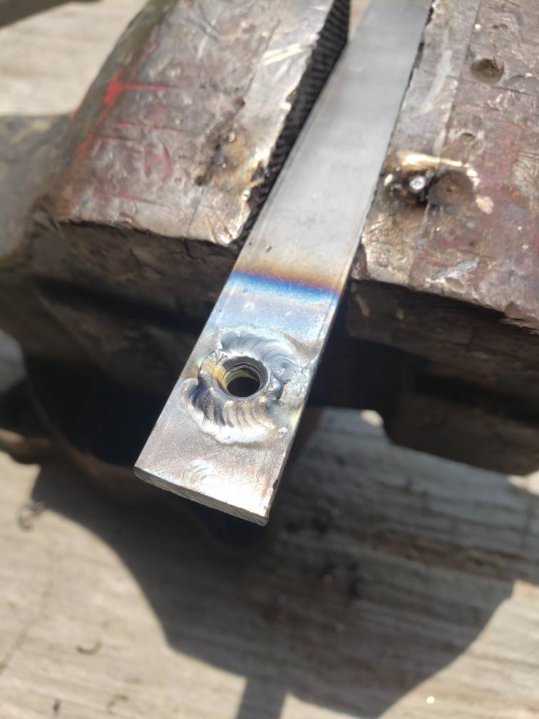

foreverdeath 04-17-2019 06:55 PM
It's been a long weekend piecing together that parts to make it run. Started off making a new radiator coupler using the summit one and a chunk of an old wastegate dump pipe. Looks pretty cheesy but it gets the job done.
https://scontent.fphl2-1.fna.fbcdn.n...83&oe=5D3EDB45
Then got back to and finished welding the turbo manifold. Upon install I started to learn a hard lesson. When I first started making this manifold I was challenged with how to bolt up the turbo to the flange as there was no threads and it was to big to tap. At the time I thought it was brillant to cut the heads of some old KA headbolts, as they were also long enough for my collector flange heatsink, and weld them into place with the TIG. Oh, how wrong I was! Each time i went to thighten the nuts on the turbo on stud would break free of its welds. After about the 3rd time I gave up and got bolts to go threw the flange. Then in quick succession broke a drill bit and my favorite carbide burr, this was making for a really bad day. chucked another burr in the drill and eventually cleared the holes for through bolts, and notch the heads of the bolts.
https://scontent.fphl2-1.fna.fbcdn.n...de&oe=5D75BAC8

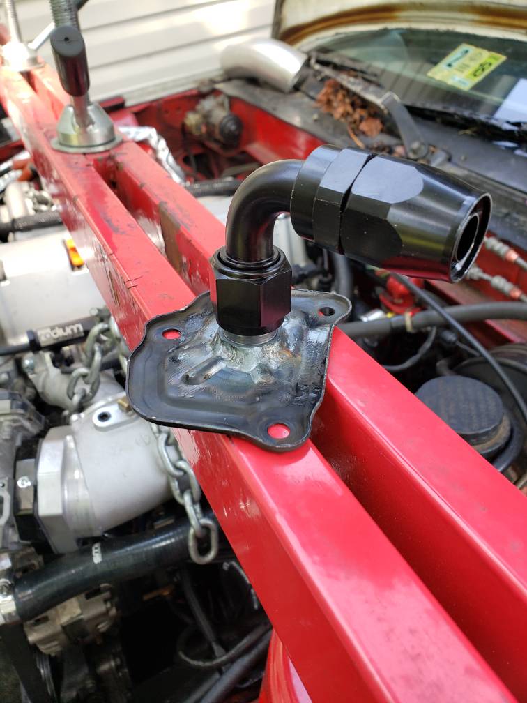

Once everything was in place I installed the new AN to banjo fiting. Its really tight fit to both the wastegate and the heatshield. In the future i may have to slightly notch the wastegate for the banjo.
https://scontent.fphl2-2.fna.fbcdn.n...25&oe=5D44FC9B

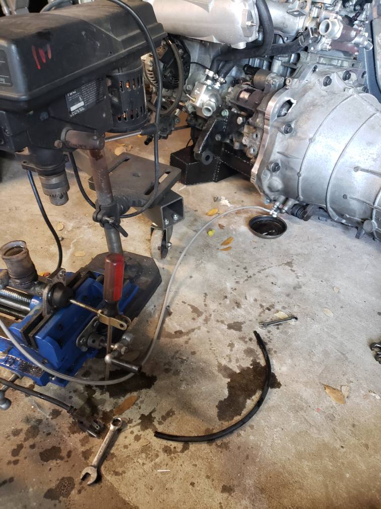

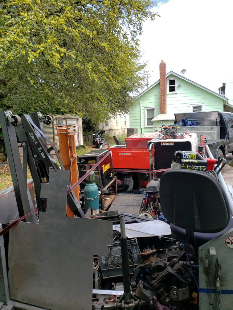

The other day I have the 240 put into storage at friends house along with all my tools at another friends. Already made it worth it getting my F250, this thing is a beast at towing didnt even feel the 240 was behind it. The overloaded tool trailer tho took a bit more slipping of the clutch in 1st to get going smoothly.
While I had the car on the trailer I took some important measurements for making a new oil pan, non one stitched together from a old pan. I missing key measurements for the oil pan flange but the pan is starting to shape up in Autodesk Inventor. Took some pictures for reference. With custom made pan I belive I could drop the motor another 1/4 to ³/8th of an inch to get the vavle cover under the hood if I want to drop the motor more. Right now part of the oil pan flange is basically sitting on the rack as you can see.https://uploads.tapatalk-cdn.com/201...69e98d26de.jpghttps://uploads.tapatalk-cdn.com/201...7616768a71.jpghttps://uploads.tapatalk-cdn.com/201...060aa35e2f.jpghttps://uploads.tapatalk-cdn.com/201...31f75c0169.jpg

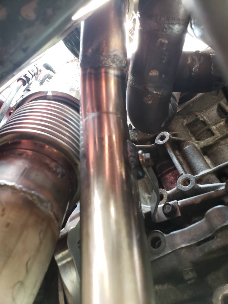

After 5 days of waiting around I grew tried of waiting around on base doing nothing but playing smash and watching TV. I went out to my buddy's house and picked up my truck from storage. And loaded it up with tools and parts in preparation to work on the car for the weekend while its in storage at another friends house.
This morning I started off by swapping the Non-abs differential for a s14 VLSD diff. I don't want to run a VLSD but, this will work for now. After the deployment I have 2 paths i can follow ether swap the Cusco 2-way I picked up in Japan 2 years ago or finish my Z33 diff subframe but I have yet to find a decent ring and pinion instead of the R51 2.3 I currently have in the diff. The Z33 diff swap will probably have to wait till I step up to wide body tho cause the axles are very close to being to long for the stock track.
https://scontent.forf1-2.fna.fbcdn.n...e9&oe=5D75EFB7
https://scontent.forf1-2.fna.fbcdn.n...1b&oe=5D635E12
The drive shaft I ordered while in Florida fit like a charm. When ordering I had no clue how long the drive was but, I knew I had the K24 in about the same location as the KA24, just maybe 1/2" forward of stock. I choose to call it safe and get a ABS KA24 to CD009 driveshaft to use with a ABS diff, vs getting a NON-ABS driveshaft for an extra ~3/4". It worked out if I ordered the NON-ABS driveshaft it may have been a smidge to long. Most drive shaft manufacturers recommend ~1/2" of plunge left in the drive shaft yoke anyways even for IRS suspension.
https://scontent.forf1-2.fna.fbcdn.n...7e&oe=5D72DCA1
Threw the catback on which hang a bit low for my taste but its as high as i can get it. I wonder how JZ guys keep their exhaust of the ground? Later I may have to use oval pipe for the down pipe for better clearance. Still doesn't go as low as to lowest section of the transmission tho.

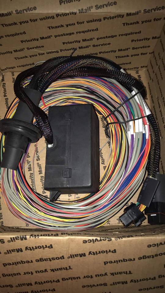

Broswing Ebay the other nite I found an open box haltech 2500 premium universal harness for 50% off MSRP. Then went ahead and ordered the missing turbo speed sensor connector and a few DT connectors. So a tucked harness coming through the firewall on he drivers side will be in works this weekend. After I verify I can get the VSS output working and FPCU.

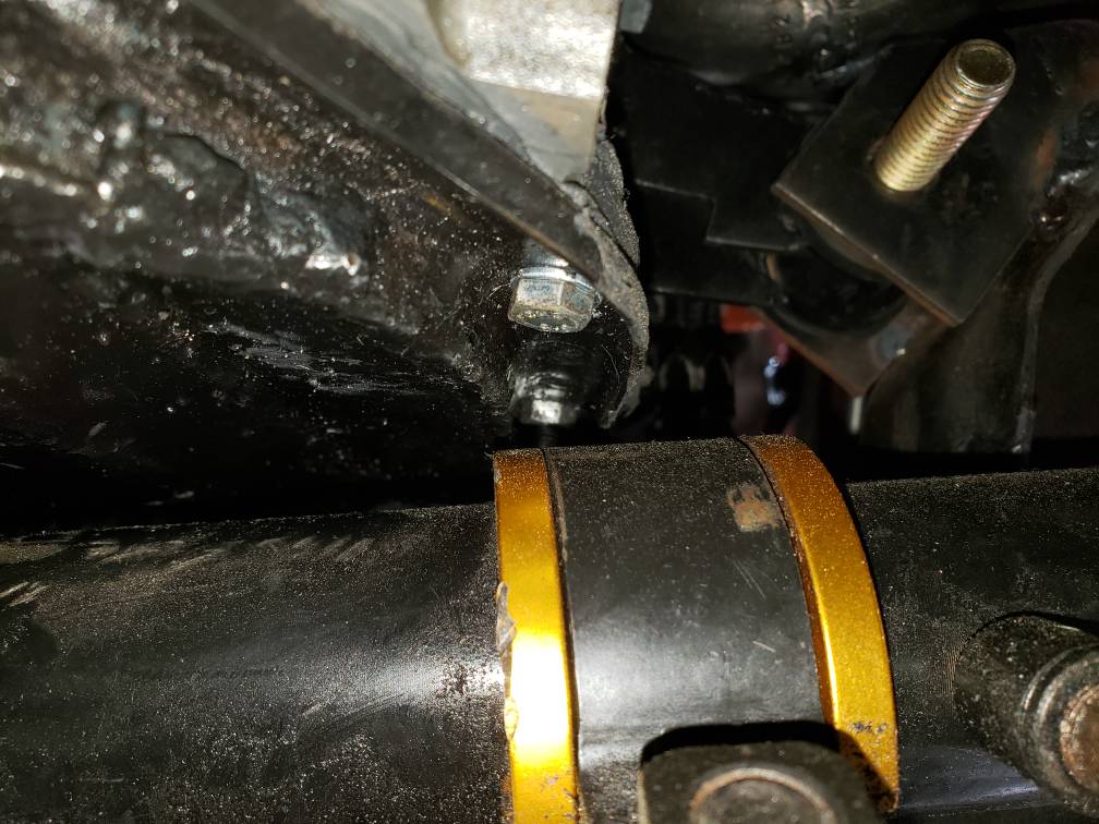

Yesterday I got off work early and headed to picknpull. Droped the subframe, oil pan, and pump on a 03 accord to get messurements for the bolt pattern of the oil pan flange. After inputing dimensions into autocad the pattern looks a bit off. One day this week I will go back and pull the motor to measure out of the car. Wish I still had access to a garage as it would be nice to have a spare block for fabrication work. A tip for easily measuring flanges with threaded holes, use bolts with a shoulder to get a more accurate reading. I used valve cover bolts from a Nissan QR25 to make each hole a 8.9mm dowel.

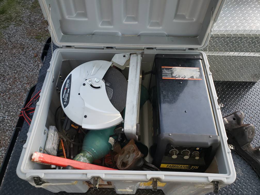

Made a run to buddy's house last nite for tools. Grabbed a ton of tools to rewire the enigne with a haltech premium harness and to make a new oil pan. Got this free box from work no clue what went it in before but it fits all of my fabrication tools and straps down nice to to the flat bed. Deffinalty gona be my new tool box for fabrication on the go.

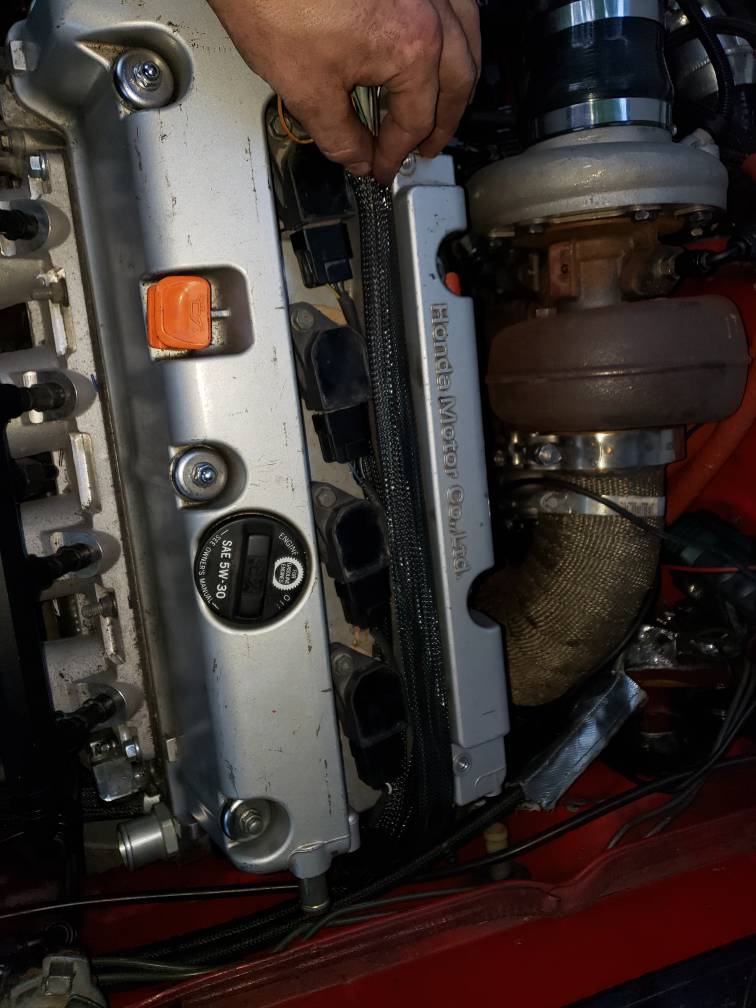

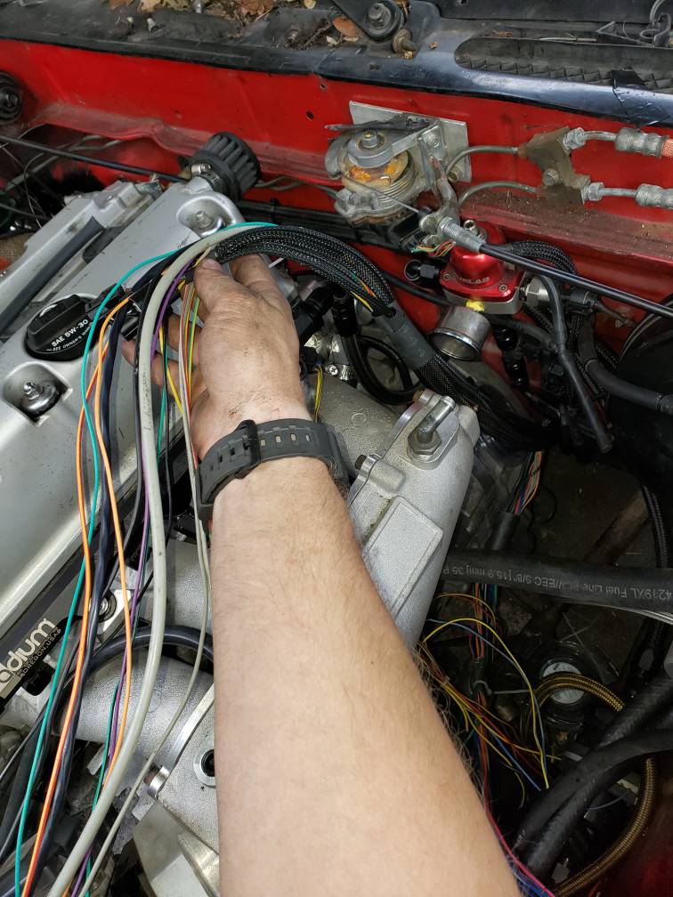

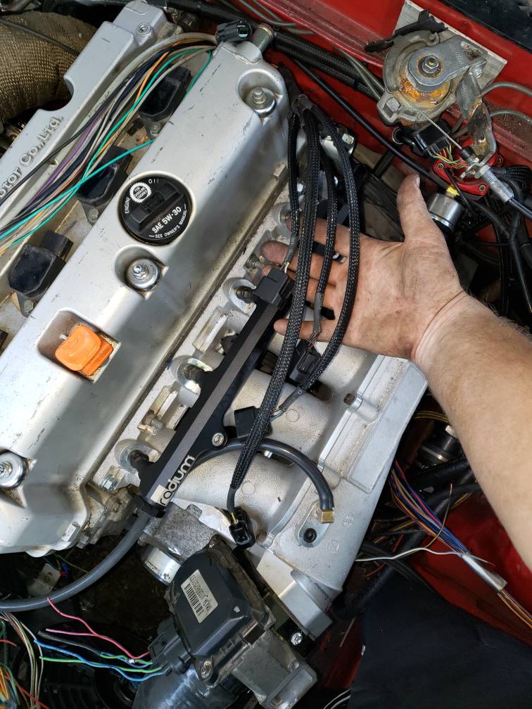

foreverdeath 05-17-2019 08:17 PM

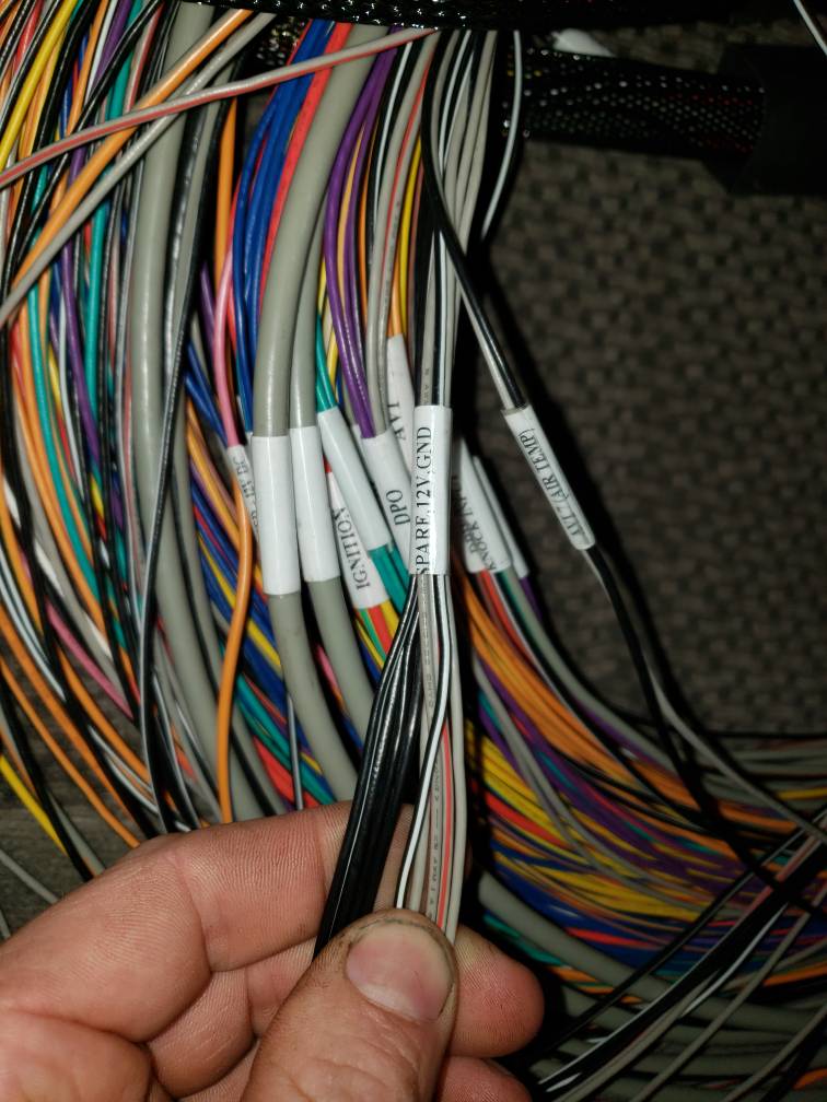

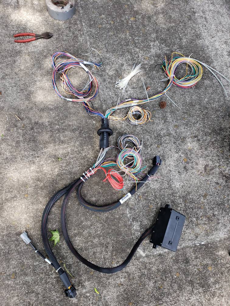

Start making the new harness today. Thru out the week I've been going through the 2500 harness removing wires not used on my 1500 and sectioning wires off into branchs. Then laying the harness out the car so find out how much wire I had to play with. I drilled a 2inch hole just below the throttle pedal mount and passed it all through. The ecu and fuse box will mount where the glove box was. And eventually I'll clean up my custom body harness and mount my chassis fuse box there too and get back my glove box.
First branch I did was the fuel branch which only has the flex fuel sensor, fuel pressure sensor and throttle pedal sensor. Haltechs harness is well thought out giving plenty of extra signal ground wires, 5v ref, and 12V, with dedicated wires for coil power and injector power.
Next I started the valve cover branch which is the biggest one. Starting of with the 2 cam sensors and CLT behind the head all the way to EBC and turbo speed on the passenger shock tower. I only managed to get up to finishing the coil pack wiring done before it started to get dark. I did toss on some more sleeve to get me an idea of what I'll be finishing tomorrow though.https://uploads.tapatalk-cdn.com/201...d83788b066.jpghttps://uploads.tapatalk-cdn.com/201...23f0f7cd18.jpghttps://uploads.tapatalk-cdn.com/201...b39bd0fd82.jpghttps://uploads.tapatalk-cdn.com/201...03b571d8e6.jpghttps://uploads.tapatalk-cdn.com/201...89d5d5cd22.jpg
Sent from my SM-G960U using Tapatalk

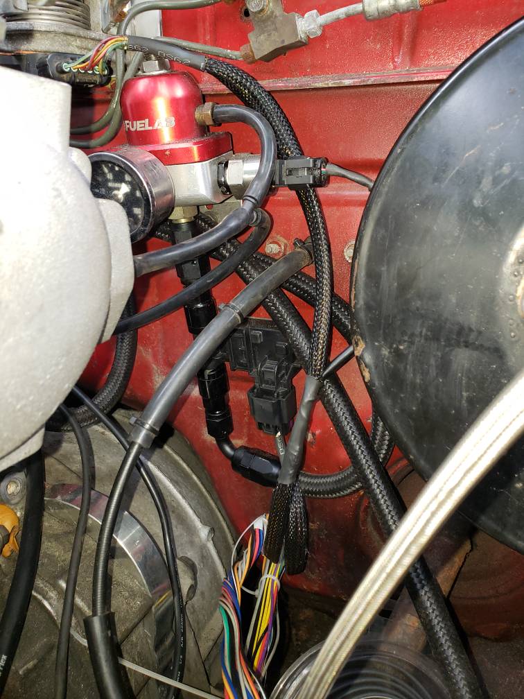

foreverdeath 05-19-2019 06:57 PM
Finished the new wiring harness today, which cleaned up the bay a lot. I've never tried to make a harness with sleeving before I've always just used tape. Which took a good bit more planning and time it make.
https://scontent-yyz1-1.xx.fbcdn.net...d7&oe=5D9D95CC
https://scontent-yyz1-1.xx.fbcdn.net...31&oe=5D6BA627
https://scontent-yyz1-1.xx.fbcdn.net...80&oe=5D551C5A
The harness comes threw just behind the throttle pedal. On the Chasssis side it connects via a 12pin DTM connector and all power is pinned into my chassis fuse box.
https://scontent-yyz1-1.xx.fbcdn.net...a9&oe=5D996907
https://scontent-yyz1-1.xx.fbcdn.net...bf&oe=5D9BA173
The ECU and Fuse box are not mounted yet. I've verifed everything still work that used to but, now the flex fuel sensor is working showing 93 pump gas at 8% Ethanol and 100F on a 85F day. Also checked on the newly connected Turbo speed senor now that I have the connector for it. After double checking pinout and haltech config im currently stumped. thinking it a a dead sensor as instead of a 5v DC pluse I get a 4.9v plugged in and 0.1v unplugged.

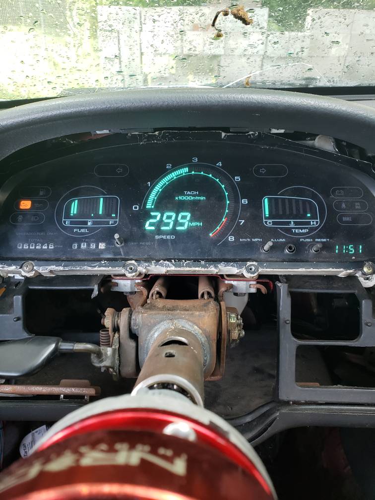

Next weekend will be a 4 day weekend for me. Plenty of time to install the dakota digital and make a new oil pan. Then start doing some street tuning.

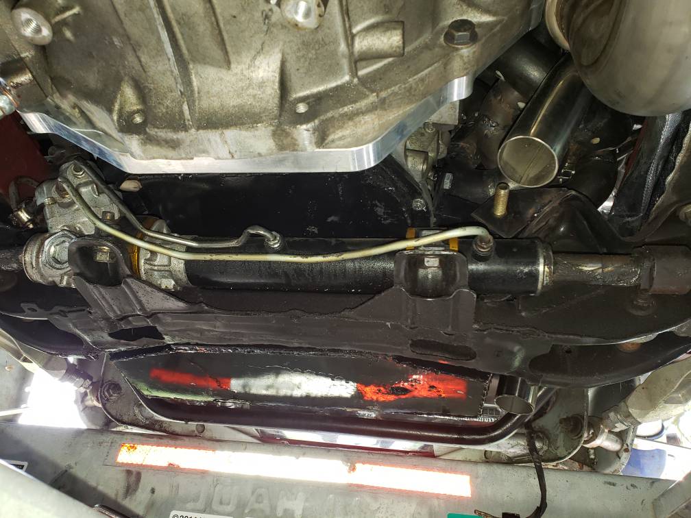

Been busy knocking out the new oil pan over the last 2 days. Started off by making a brace to keep the oil pan from warping this time. But, that's not where the leak was on the old pan was, turns out it was leaking from the top of the tube used to access one of the oil pan bolts on the short side of the pan. which would be impossible to fix with out cutting the pan up. Then remeasuring the oil pan flange bolt pattern for later use. I think one of the thing that was giving me trouble last time was I would accidentally bump the the zero button and throw of my measurements without me realizing it.
https://scontent.forf1-1.fna.fbcdn.n...c2&oe=5D54F4C3
https://scontent.forf1-1.fna.fbcdn.n...82&oe=5D511CF1
Next came removing the old oil pan to measure and make a altered copy. This engine support beam might be one of the best tools i keep (didn't get rid of anything actully) from my old career. Without this I would of have to pull the motor and tranns, not something im tring to do outside and with limited tools. Here you can see the modifications to the subframe for the swap. Changed the passenger side rack bracket to have a stud to gain all the clearance I could and removed the front lip on the front of the subframe, welding the seam back together.
https://scontent.forf1-2.fna.fbcdn.n...0f&oe=5D60B75D
Making the new pan I started with the easy section the rear shelf that is cut to clear the subframe and powersteering rack.
https://scontent.forf1-2.fna.fbcdn.n...b2&oe=5D95C2E7
Then the tricky bit, which I forgot to take pictures of, the front and rear face to the sump extension. Which tacks a lot of PAD (Posterboard Aided Design) and an Angle finder. Of the changes I'm making I'm made the sump a ~1/4 deeper, lowering the top of the passenger side to give access to bolts, and elongating the front of the sump for my capacity. Even with shorting the passenger side a bit i should gain about ~3/4 of a quart of oil.
One thing I did before starting to attach the sump was weld in some strips for rigidity where I ground away the rolled edge on the pan. The edge had to be removed to make bolts accessable via a wrench in the tight space, and the strips are there to help seal the pan and not warp the shit out of it when if I ever have to remove it.
https://scontent.forf1-2.fna.fbcdn.n...7f&oe=5D5A0B51
After 2 full days of work, I almost have a new pan. All thats left to do is to: weld any spots i missed, bungs, leak test, and redesign the baffles.
https://scontent.forf1-2.fna.fbcdn.n...ee&oe=5D56CC19
https://scontent.forf1-1.fna.fbcdn.n...8e&oe=5D9AC9B6

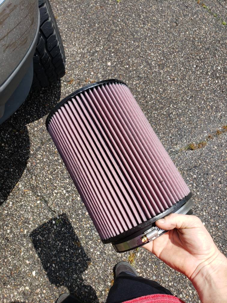

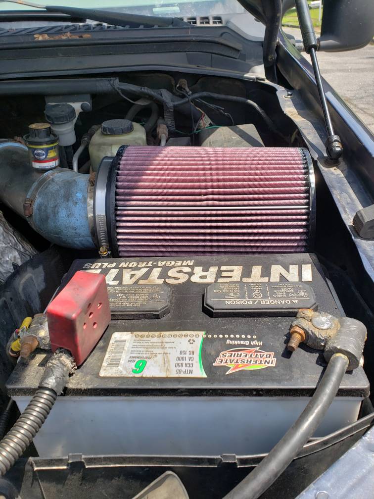

Next I set about making the cold intake for the turbo. But i started of with a bit of a problem. the air filter i ordered in theory was gona fit the in the fender. But, for some reason 10" seems a lot bigger once its in your hand. It was about 2 inchs to tall to fit in the fender so on the powerstroke it went. and I swapped the truck filter on to the 240 which was tapered cone of the same diameter, inlet size (6") and 2" shorter. I couldn't start building the intake tho as I was missing a 3" coupler.
https://uploads.tapatalk-cdn.com/201...5a0eb92e3c.jpghttps://uploads.tapatalk-cdn.com/201...86abe94ee3.jpg
I made a heat shield for the passenger side motor mount along with installed the proper length bolt, they have been loose till now.

I then moved onto electronics. I played with the FPCM but it only responds to 75-225Hz. Also tried low drive and low/high drive both act the same. But high drive does nothing. There are a few versions of this controller I wonder if mine does have a shut of. I'm done messing with this it works for what i need it.
Also got the turbo speed sensor working. The first time I started the engine that day It was at high idle at around 2300rpm cause of a DBW fault. But once I remedied the fault by pushing the throttle plate by hand it idle normal and the signal was gone. I have to do this every now and then, sometimes it just sticks after sitting, but after that it's fine. This throttle body came of a Honda Pilot flood car which the motor was hydro locked. The last shop I worked for would do a lot of subletted insurance work, so I got to do a lot of motor swaps and big suspension jobs. I pulled the compressor housing to see the sensor was recessed about 1mm. I took a file and slowly worked down the matting surface till it was flush. Its was still gone at idle but at 1100rpm the turbo is spinning fast enough to read, which is good enough for me as predicted full spool for 10psi is 2500-3000rpm. I'm Curious to why Borg Warner didn't set it close enough to constantly read or if did they feared contact with the compressor.
Yesterday I started off knocking out the last of the under car work. Welded flange nuts to a pair of 3/4" x 1/8" x 2" flat bars then bent em into 90s. Tacked them onto the dump pipes on car with the Mig then pulled them off and swapped cables on my machine to TIG them.
https://uploads.tapatalk-cdn.com/201...95a9cd9ad8.jpghttps://uploads.tapatalk-cdn.com/201...ae26a5c3b9.jpg
With more flat stock I made a bracket to connect each to the block. The front was simple but the rear got tricky.

Next came the Dakota Digital. I Split the output to both the cluster and ECU. Test run on the default settings before calibrating, It was reading pretty high 30mph idling in 1st... but this was the perfect time to answer an old question of mine. What's the max speed the NX1600 cluster will display? Turns out the internal circuitry maxes out at 299 not matter KPH or MPH. This was on Jack stands 2800rpm in 6th pictured is actually ~60mph. I haven't entered the calibration factor yet but, I do know to set it to 1/6 as the abs tone ring is 24 tooth will the factory speed sensor is 4 tooth.
https://uploads.tapatalk-cdn.com/201...35072283ed.jpg

Got back from deployment the other day. Already got a small box of parts from summit waiting for me to finish a few things so i can get back to fixing the drive ablity issues. Got a few things to sort out before i can get back to working on it tho.

Over the weekend I wrapped the turbo manifold to help with my heat issues melting parts. Ended up having to replace the turbo inlet coupler and a few lines.
https://scontent-yyz1-1.xx.fbcdn.net...26&oe=5DDE0BF6
https://scontent-yyz1-1.xx.fbcdn.net...22&oe=5DD912C4
https://scontent-yyz1-1.xx.fbcdn.net...e9&oe=5DD370D2
