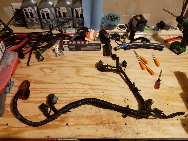

So with that, I starting going through all of the systems and making sure that everything worked properly..ya know..because it was going to be my DD until my cars showed up. Go to try the windshield washer...nothing. Oh boy was that fun. Seems the fluid was soo old that it has become gelatinous? :barf:
https://farm5.staticflickr.com/4215/...212369bf_b.jpg
https://farm5.staticflickr.com/4265/...f48331e9_b.jpg
https://farm5.staticflickr.com/4036/...8aac455e_b.jpg
Like, how the fuck does that even happen? Either way, I got that sorted and started ordering parts for the front end since it clunks and just feels like absolute shit. Scored a deal on a Nardi for a hundo. Scooped up a hub and threw it on. Also found a BNIB set of half/half bumper lights from Japan since everyone here wants crazy amount of money for used, cracked ones.

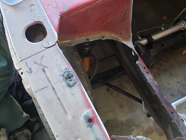

Threw it up on jack stands and starting stripping it down. I figured I could part the car and make most if not all my money back and still have all the important stuff I wanted in the first place.
https://farm5.staticflickr.com/4212/...94d4e678_b.jpg

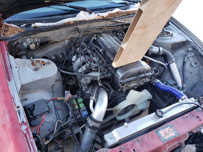

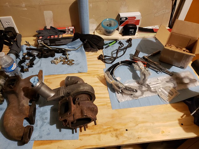

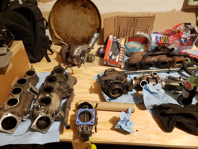

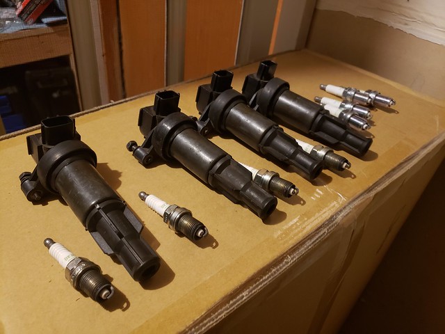

Haven't been much of any updates. I've been looking for some odds and ends and piecing together the rest of the Z-brakes. Kid went to sleep pretty early last night so I had a little extra time to mess around in the garage. Started tackling the motor I pulled from the part out.

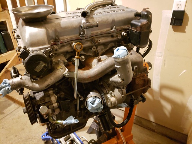

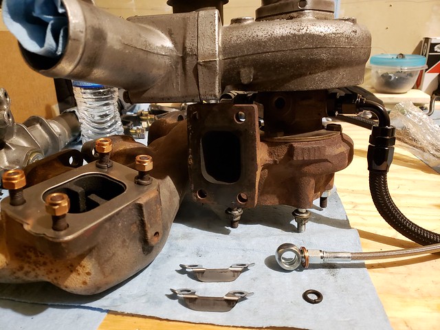

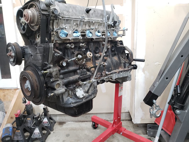

I knew going into it that quite a few of these parts would not be staying on the motor so I might as well remove them. Overall its in fairly decent shape....however, I was very suspect of the motor when I learned that the PO tried pushing 1000cc Injectors on a stock ECU and turbo :picardfp:
Check out CYL 2&3 exhaust ports..wet from fuel still. Also, No turbo outlet gasket, and no thermostat..come one now! He was impressively bad at using gasket maker so I've been planning on resealing the motor.

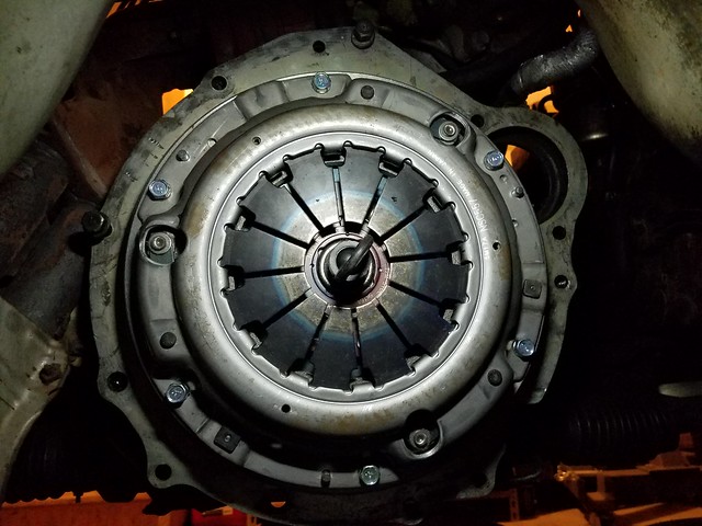

Going to get started on cleaning some stuff tonight and pulling the clutch of to see what it even is.

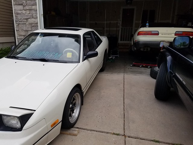

crash n' burn 07-05-2017 07:05 PM
Luckily the Photobucket debacle happened early on in this thread. Switched over to a new host, fixed the thread.

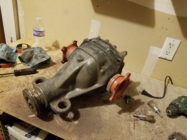

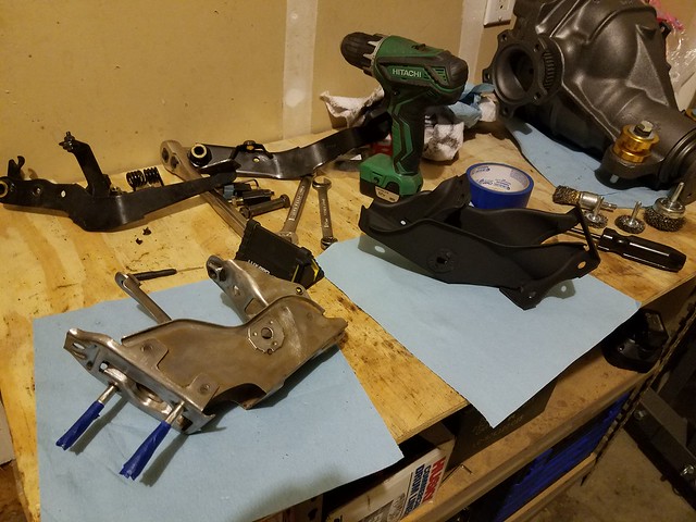

Little update though. Since I had some cash burning a hole in my pocket from selling the wagon, I treated the ole' girl to some suspension. Coils, rear arms, and bushings are ordered. Pretty back logged so I doubt any of it will be in before I head to my AT next week. Working on getting the last of the rear brakes and mulling over some 5-lug wheel options.
Since I was headed down memory lane transferring my pictures over, I figured I'd share my last coupe with you guys. This was the culmination of 5 years of beginning to rebuild this car from an empty shell as a broke ass 19yr old college kid. Some may have seen it, I also think I saw the shell for sale on here not too long ago; thought about buying it back for the hell of it. Can't believe I parted it out:facepalm:
https://farm5.staticflickr.com/4265/...5f66aac8_b.jpg
https://farm5.staticflickr.com/4281/...9e812e0f_b.jpg
https://farm5.staticflickr.com/4100/...de33c1ef_b.jpg

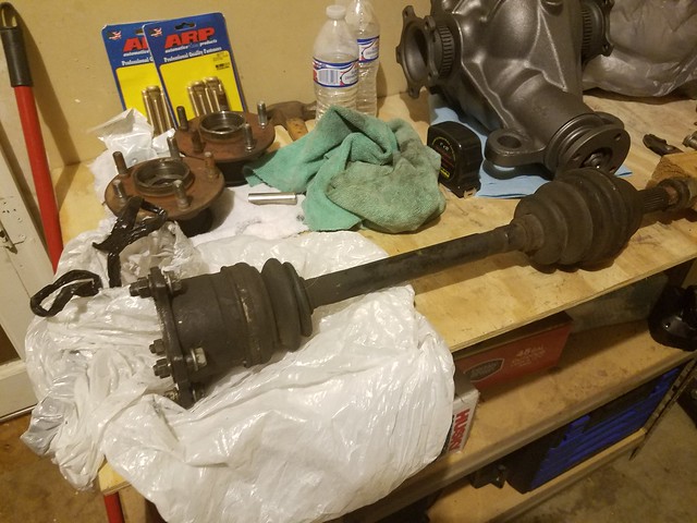

Lots of packages came while I was gone!! Lots of things have happened as well. The wife knows I've been looking for a new daily. While I was away, she found this and pretty much bought it for me. Shout out to her, Wife of the Year status for finding me a RWD one; and, for a hella good price too. Now I'm just waiting on the title to come from the P/O's bank so I can register it.
Got 1 or 2 more things to pick up; and all this can start going in. I wanted to wait on doing the 5-Lugs, but now that I'll have more than enough time, I'll probably just push forward with it.

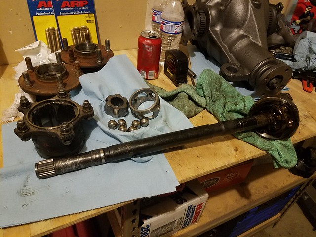

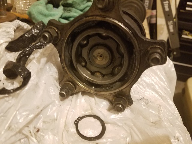

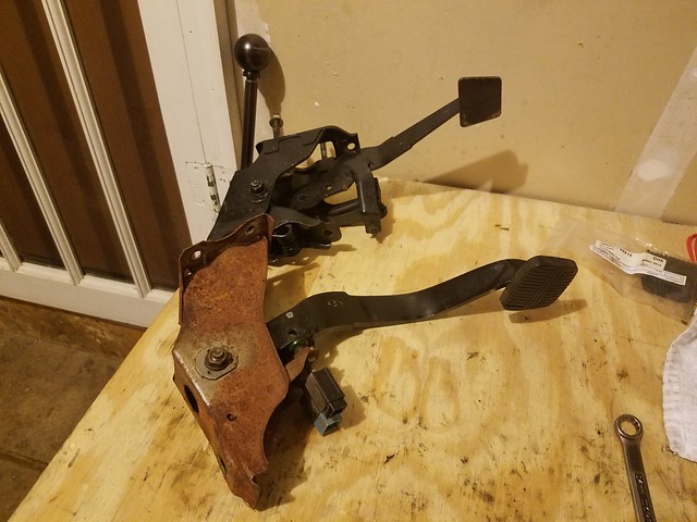

Honest opinions on the Villains output shafts to convert over to Z33 axles??

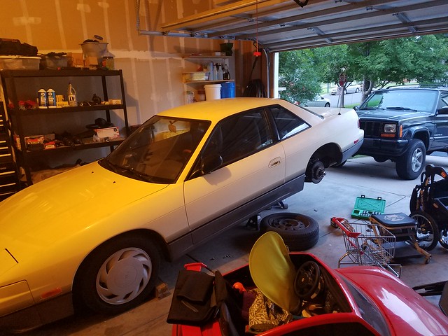

Finally an update worth posting. Now that I got my new DD, i've been able to focus on the coupe a little more.

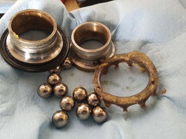

My front end was suuuper lose and I knew it was worn out; i'm glad I dealt with this deathtrap when I did. The balljoint practically fell apart when I took them out, bend tie-rods..etc etc. Looked to be original equipment..so this is MUCH better.
https://farm5.staticflickr.com/4360/...631e38a8_c.jpg
https://farm5.staticflickr.com/4421/...977c1486_c.jpg
https://farm5.staticflickr.com/4382/...c87b26d3_c.jpg

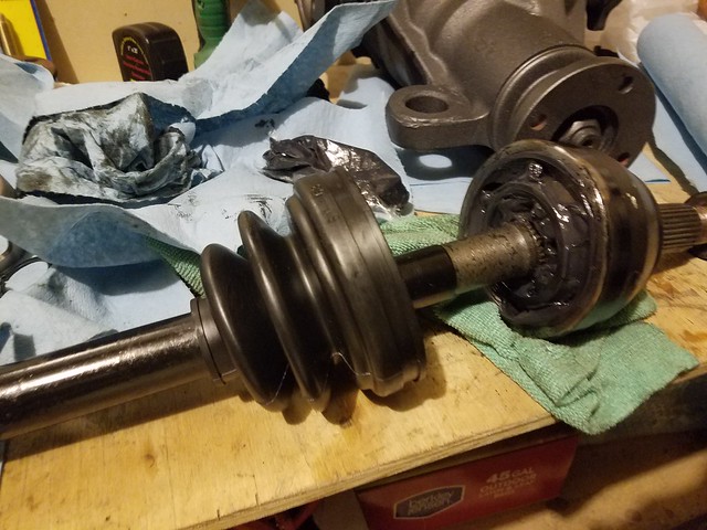

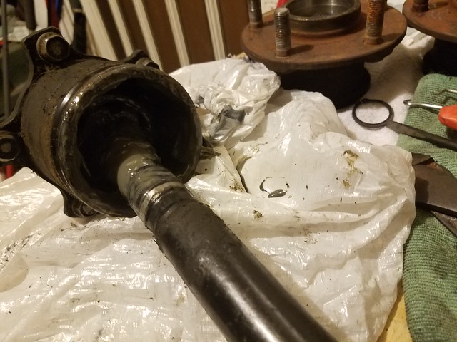

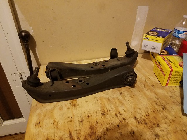

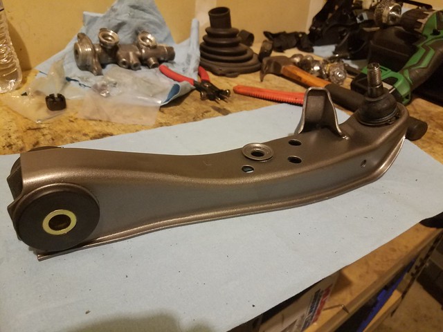

Moved to the back and pulled the subframe out. Cleaned up nicely, took the control arms and knuckles and installed new bushings and balljoints there as well. The subframe bushings are not in terrible shape honestly..but that's all I've got left to tackle before putting the rear end back together.
https://farm5.staticflickr.com/4395/...fe36a763_c.jpg
https://farm5.staticflickr.com/4398/...c2bce56c_c.jpg
https://farm5.staticflickr.com/4345/...f29f6016_c.jpg
https://farm5.staticflickr.com/4391/...cc728f2f_c.jpg

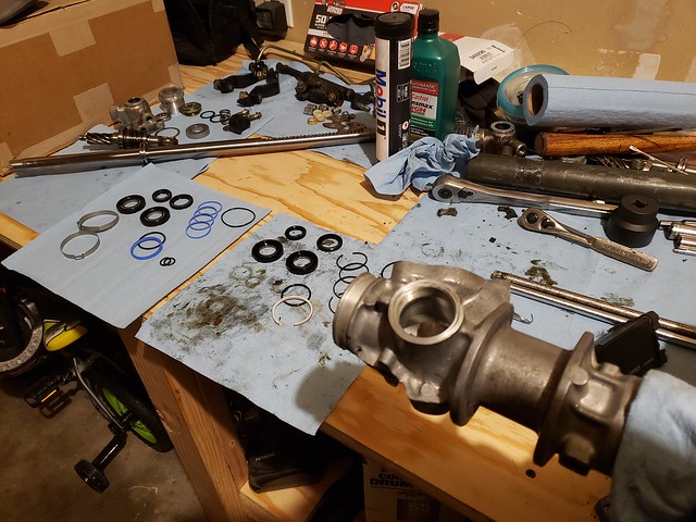

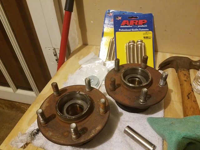

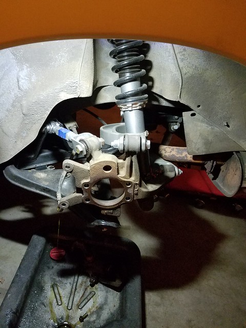

Spent a few nights shaving the caliper faces, stripping the old brush on paint, and rebuilding them. Picking up a set of s14se off my friend so I can do the 5-lugs/Z brakes. Also bought the last item I wanted for my 5spd swap. That'll all have to wait until we get settled in.
https://farm5.staticflickr.com/4537/...a94aab88_c.jpg[/url]
https://farm5.staticflickr.com/4518/...6c0dc9d2_c.jpg[/url]

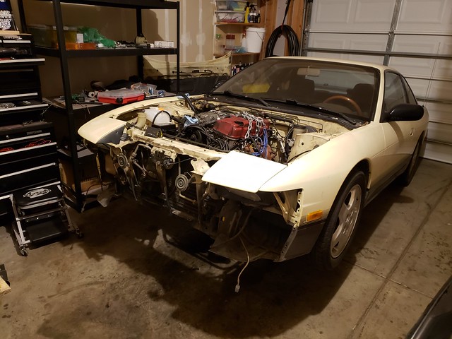

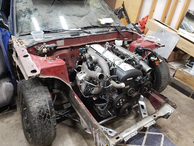

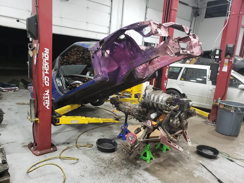

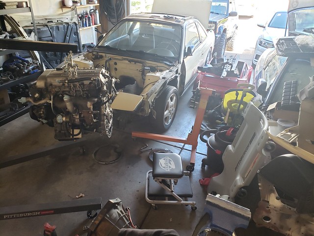

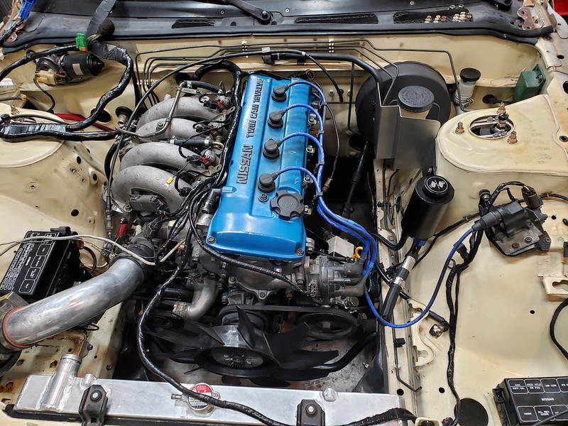

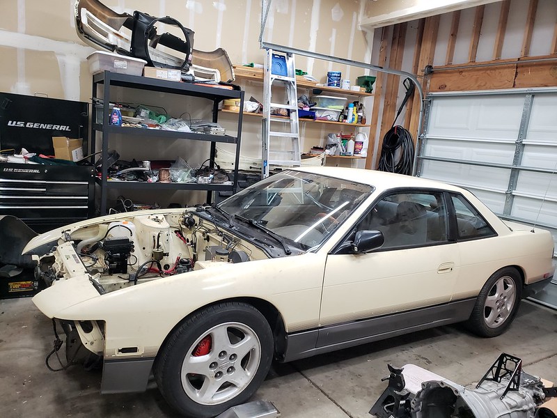

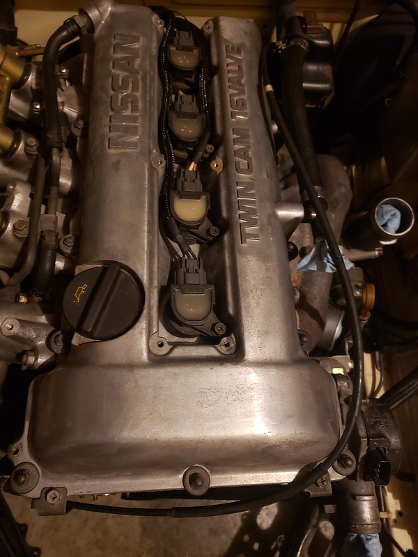

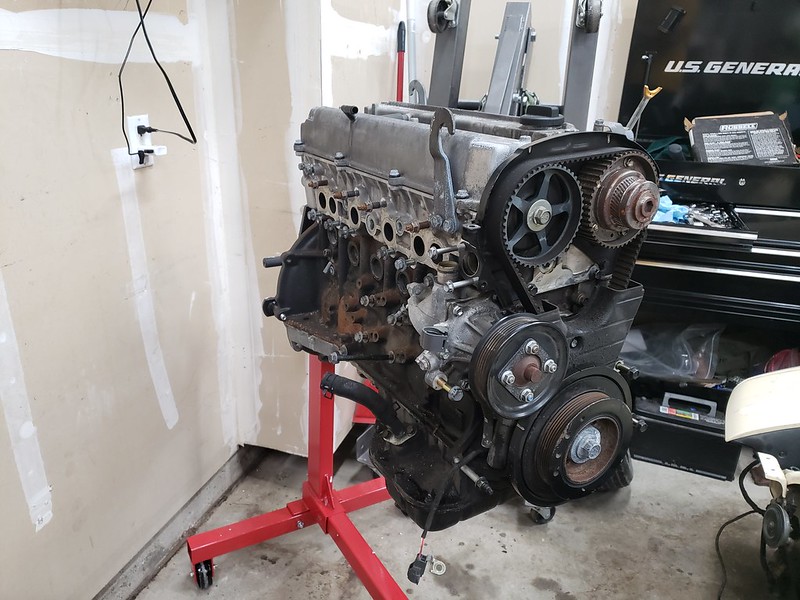

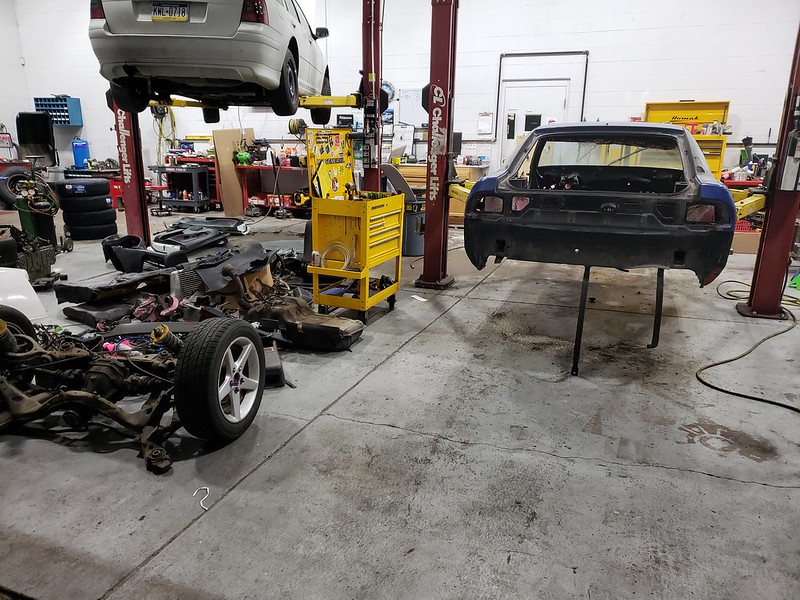

So, a simple HG change and ARP studs to prep it for turbo then turned into a motor swap and a half. motor was pissing coolant out of an empty exhaust stud. Excellent job extracting this stud; the dude charged him $50, and knowingly fucked it up because it was packed with JB weld. That stuff turns to putty with the coolant and heat.
https://farm5.staticflickr.com/4765/...38ff26d5_c.jpg
https://farm5.staticflickr.com/4695/...935a2ace_c.jpg

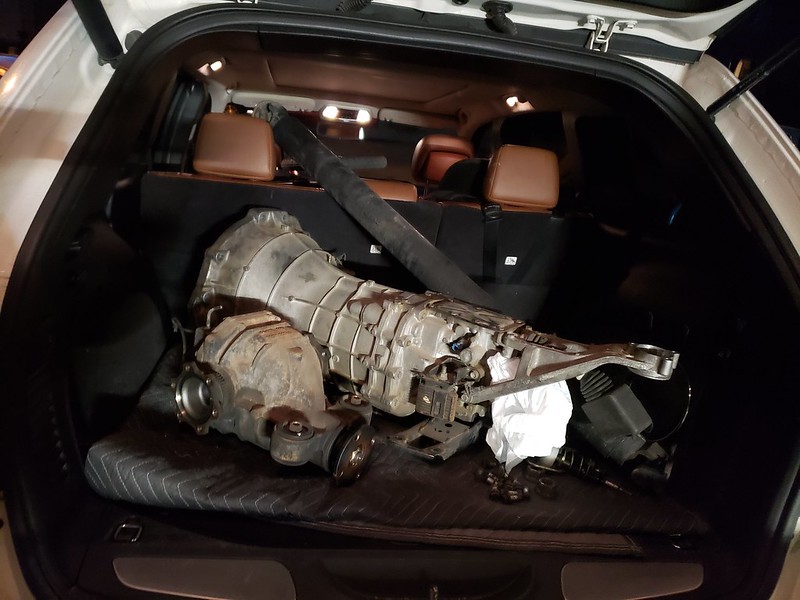

I made a phone call to a friend and sourced him a super clean motor on the low, built bottom end with a new clutch. It was a S14 motor so I swapped lower manifold, new top end gaskets and what not.
https://farm5.staticflickr.com/4604/...218288ba_c.jpg
https://farm5.staticflickr.com/4661/...5209bc47_c.jpg

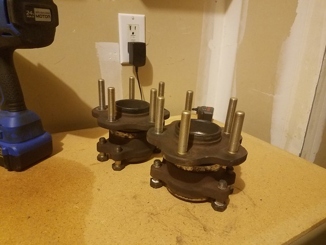

I also ended up 5lug swapping the rear, and correctly setting up his coilovers.
https://farm5.staticflickr.com/4756/...4c77110a_c.jpg
https://farm5.staticflickr.com/4676/...b3d6aa46_c.jpg
https://farm5.staticflickr.com/4652/...2cb52a8d_c.jpg

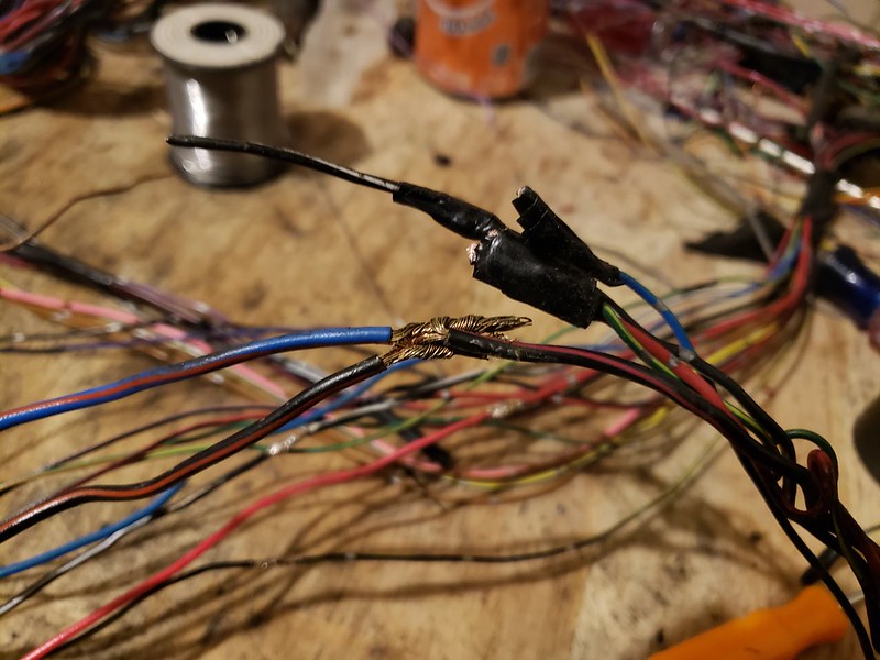

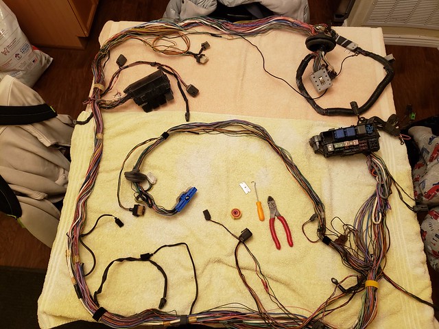

Did some other things here and there like fixing some wiring, gauges, aligning the car, fixing power steering, etc etc etc....basically undoing some of the hacked up shit on this car performed by a local shop from a dual cam swap. Motor fired up first crank and sounds incredibly healthy for a basically an unknown buy.

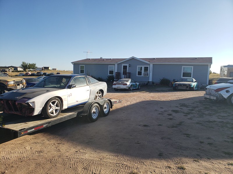

Then about 2.5mo and a different realtor later the day finally came! We had an offer on the house!! It was a cash deal, quick close, and went under contract that Monday. I immediately went house hunting and found a bangin' deal in the perfect neighborhood. They accepted the offer and went under contract Tuesday night.
This is where everything went to shit....like..worst possible time. Fountain had the worst hail storm in 20+ years. I woke up at a little before 2:30am to tennis and baseball hail hitting the house. Never had a chance. My stomach turned as I stood on the porch and watched everything in sight get obliterated for close to 2 hours. Every car parked outside was totaled, houses with holes in the roofs, etc. I'd already seen videos but never experienced it.
https://farm2.staticflickr.com/1749/...73106414_z.jpg
https://farm1.staticflickr.com/899/2...c60dd549_z.jpg
https://farm2.staticflickr.com/1728/...76743466_z.jpg
https://farm2.staticflickr.com/1830/...4814456d_z.jpg
Safe to say, I was heart broken. I knew it'd be a giant pain in the ass to get taken care of. Luckily I borrowed my buddy's beater while he was on vacation. I was set to move the family in 2 weeks. I got some work to do, will do a small follow up in a bit.

crash n' burn 07-31-2018 10:06 AM
Alrighty, took a week or so to get the garage cleared out enough to set it up how I wanted it for now. Ordered a few misc. pieces to finish up my project and get to work doing some small stuff while I wait.
Shout out to FRSport for shipping my parts to NC instead of CO and not responding to like 3 emails or picking up their phone after I'd placed the order...so there's that. Glad the new owner of the house was cool enough to hold on to the one package that got delivered by usps even though i have my mail being forwarded here.
Bought a new daily. Haven't owned one since high school, been itching to get a trail rig because there are hundreds of places to go out here. It was too good of a deal, 3" lift, leather interior, and the only one I could find without 200K+ miles that didn't cost an arm & leg.
https://farm1.staticflickr.com/835/2...56ec111f_z.jpg

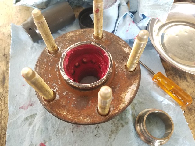

Alright, back to 240s. Smashed some new ARP studs in my front hubs. Still got the fronts to do.
https://farm1.staticflickr.com/937/4...08e664ba_z.jpg
https://farm2.staticflickr.com/1791/...70b8d17f_z.jpg

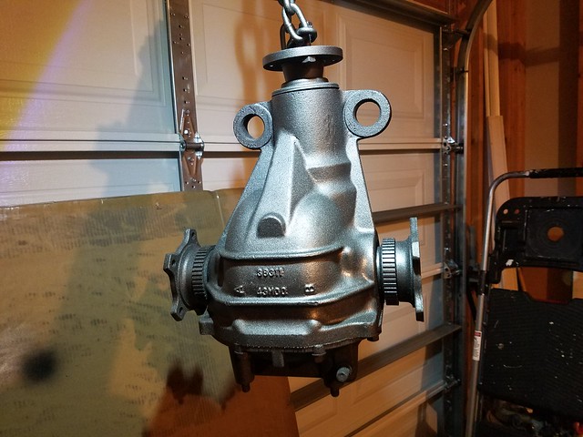

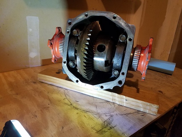

Then I got to work on the z32 vlsd I've had sitting in a corner for the past decade. Only put about 1000 miles on it before I broke an axle and couldn't find another 5 bolt axle so I swapped it back out and there it sat since 2008. Glad I opened it up instead of just a drain/fill; fluid was disgusting.
https://farm1.staticflickr.com/858/4...967cb962_z.jpg
https://farm1.staticflickr.com/862/4...4d255cb0_z.jpg
https://farm1.staticflickr.com/916/4...76a9fcd9_z.jpg
Then I hot-boi'd it with some new paint
https://farm1.staticflickr.com/854/4...31498264_z.jpg

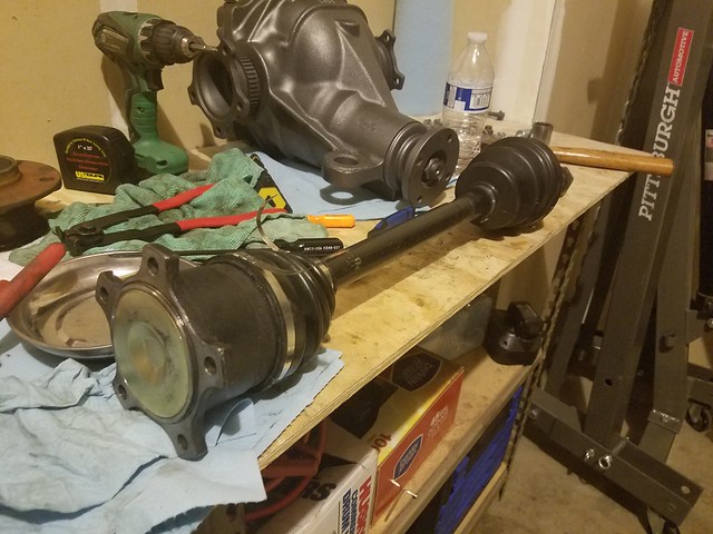

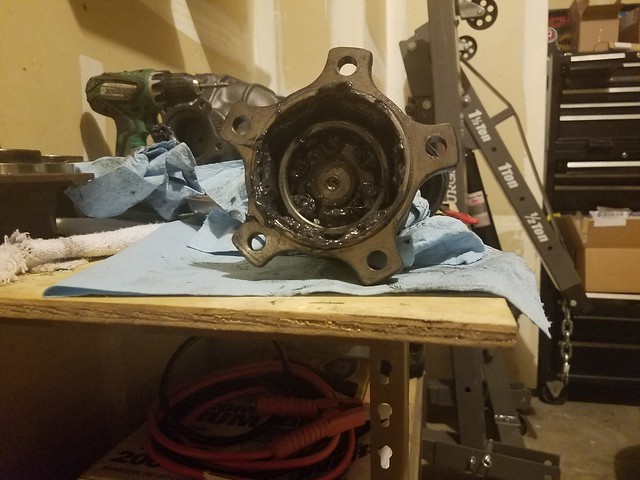

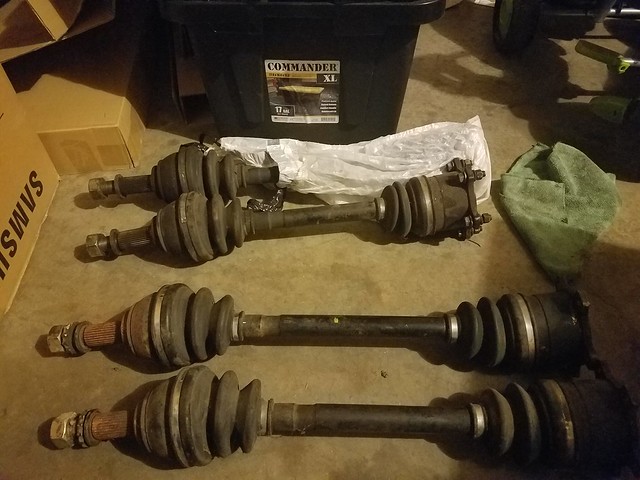

Friend came in clutch with some axles. I knew I wanted to break down and refresh whatever I found, so it worked out great that one of them had a blown out cover plate and ripped boot. He gave me a set of z32s for spare parts.
https://farm2.staticflickr.com/1771/...41995005_z.jpg
https://farm1.staticflickr.com/933/4...fbcc8e80_z.jpg
https://farm1.staticflickr.com/850/4...280dd425_z.jpg
https://farm2.staticflickr.com/1817/...f99d5f62_z.jpg
https://farm2.staticflickr.com/1793/...a6ee8b6e_z.jpg
Can't find my brass punches so I can't take apart the outer joint to clean. Waiting on boots anyways, so not a huge deal. I gotta pull the open diff out to weld so my buddy can have a spare diff for No Coast at the beginning of September....should be a party!
crash n' burn 08-02-2018 09:24 AM

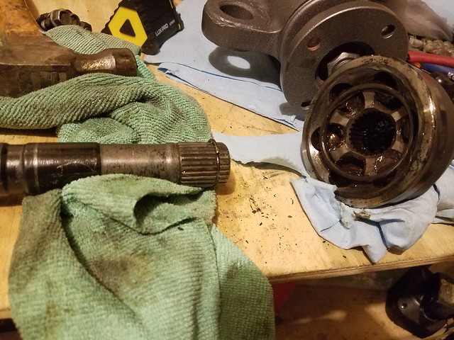

All wrapped up. I'm glad that I took a picture of the inner joint, I couldn't remember which was the outer race was oriented.
https://farm2.staticflickr.com/1797/...0b276bc4_z.jpg
Inner race of the outer joint didn't want to come out easily so opposed to forcing it, I just wiped out all the grease I could and hit it with a little brake cleaner to get what was left.
https://farm1.staticflickr.com/930/4...3a3c0376_z.jpg
Those races are a PITA to get lined up correctly but they only go 1 way and finally it slipped together like butter.
https://farm2.staticflickr.com/1800/...93702dfc_z.jpg
Flexed the joints to check for binding and get the grease where it needed to go. They're nice and quiet, no play, smooth movement. I've done jeep axles before, but this was a first and I'm pretty pleased with it. Hopefully they'll hold up a little better than the S13 tripod style axles that like to slip out on lowered cars. Those boot bands on the inner joint suuuuuuck though without the proper tool, I'm going to try and find some traditional CV boot straps.
https://farm2.staticflickr.com/1812/...0aa2a171_z.jpg

Alright. Got the rear end back together for now; but I have to re-attack it once the e-brake stuff some in from Z1. Not a big deal since I'm going to be doing the 5spd swap so I'm going to be back up under the car again anyways.
Speaking of the 5spd swap. I was waiting for brake lines to show up so I broke out the crusty brake pedal and started to clean it up along with the clutch pedal. Apparently the clutch had been rattle canned because all the paint started coming out while cleaning it. So break them both down, clean, repaint, re-grease and reassemble. No one is going to see them, but its the little things that count. My OCD would also be out of control if I'd left it..so there's that.

So now that its sitting back on the ground I switched to a little bit of front prep. These bushing did not want to some out smoothly like the S13 arms did. I absolutely hate burning out bushings but there was waaaay too much material left to get my small wire wheel in there to clean the bores. Finally got it all taken care of but the arms are a little rough so i'm going to give them a splash of paint before I put the new ball joints and bushings in.
https://farm2.staticflickr.com/1855/...a3dab4eb_z.jpg
https://farm2.staticflickr.com/1834/...93d0bc93_z.jpg

Started to clean up the arms and surface rust was showing up so I stripped them. Ended up being slightly pitted underneath everything but they came out nice with a couple coats of etch and filler primer then paint.
https://farm2.staticflickr.com/1867/...150e856d_z.jpg
Started digging around for the new e-brake stuff and got those together.
https://farm2.staticflickr.com/1888/...86f62223_z.jpg

Luckily I did because there wasn't much grease left in them and the rest was pretty dried out. No signs of scoring or scorching and there was no play previously which is amazing since they came off the drift slut that had 285k on the odometer.
https://farm2.staticflickr.com/1865/...a0f481fc_z.jpg

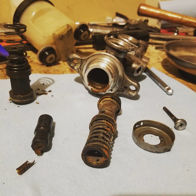

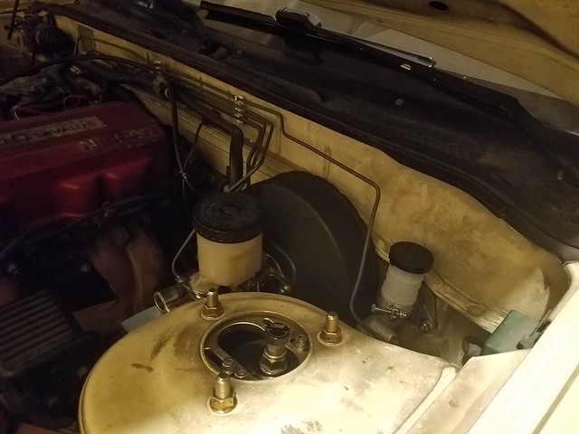

Pulled the master and cleaned the reservoir; shit was gross. I damn sure not about to put that back through the lines and my clean calipers.
https://farm2.staticflickr.com/1879/...7cdcb47e_z.jpg
Ended up pulling the booster out since an old BMC leak had ruined the paint and it was rusting. Figured now was a good of time as any to swap out the pedals. Also ended up drilling out the firewall for the clutch pedal as well.

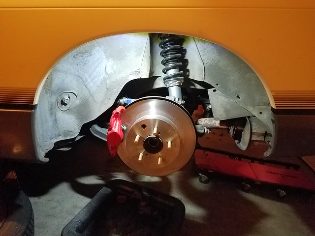

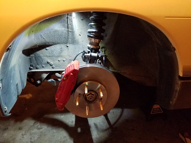

Right on! Got the rotors in, put the front back together and gave it a half ass alignment for now. Definitely needs to moar low.
https://farm2.staticflickr.com/1883/...0beb85e6_z.jpg
https://farm2.staticflickr.com/1844/...ab412a87_z.jpg

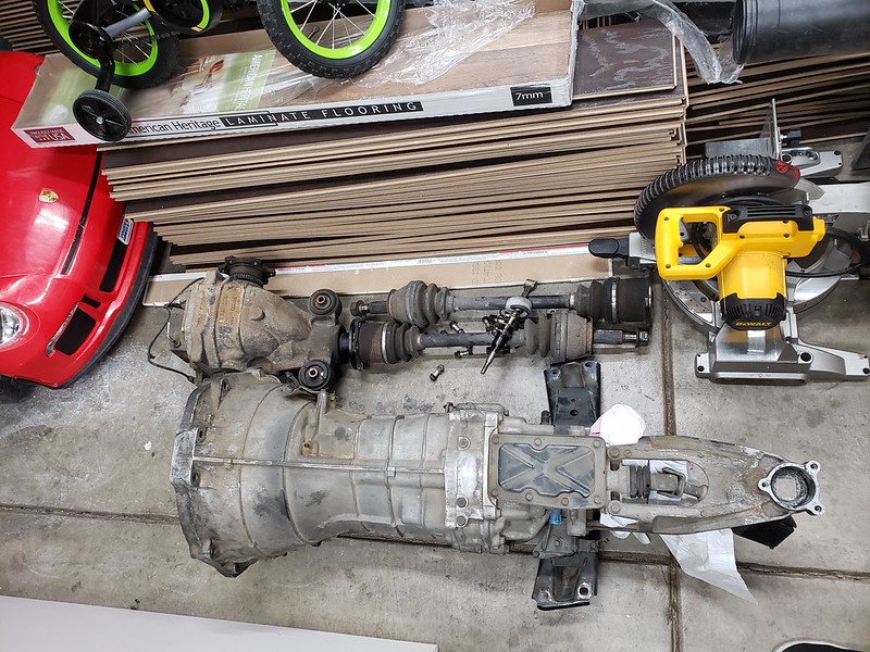

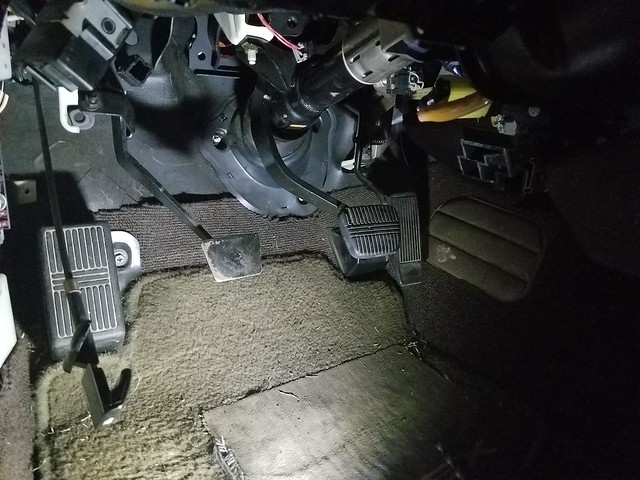

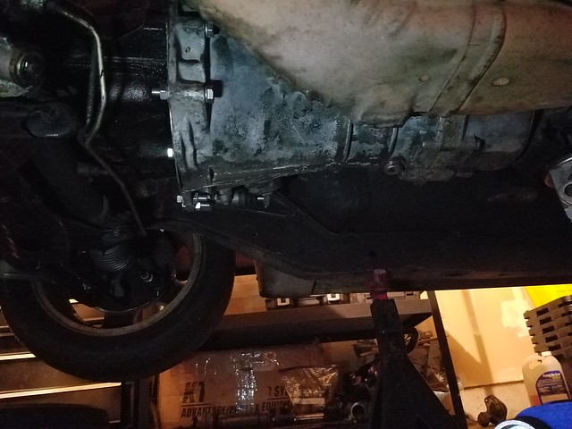

Then I continued with the 5spd swap. Wrestled with the top trans bolt but a little ingenuity won the day. Glad to get that trash out of there. Really hope all this effort is worth it.
https://farm2.staticflickr.com/1874/...12facba0_z.jpg
https://farm2.staticflickr.com/1873/...6b3bed17_z.jpg
I really enjoy driving the car even when it had the auto in it, so hopefully this will reinvigorate my passion. Also been trying to decide on the next step for the car; Silvia front end or wheels? hmmmmmmm

Took care of the wiring for inhibitor and reverse lights. love how theres only 2 wires for the reverse lights and 2 for the speed sensor now. I was going to tear apart and merge the entire lower harness, make it all pretty and tucked but that's more work than I feel like doing to a sohc KA, haha. Also, It'd be a total waste of my braided mesh wire loom.

think this is the first transmission the fill and drain plugs came out without getting destroyed. Didn't look too bad, nothing chunky. Was definitely overdue for a fluid change.
https://farm2.staticflickr.com/1885/...31143109_z.jpg
threw in the clutch, changed out the TOB and slave on the trans; she ready!

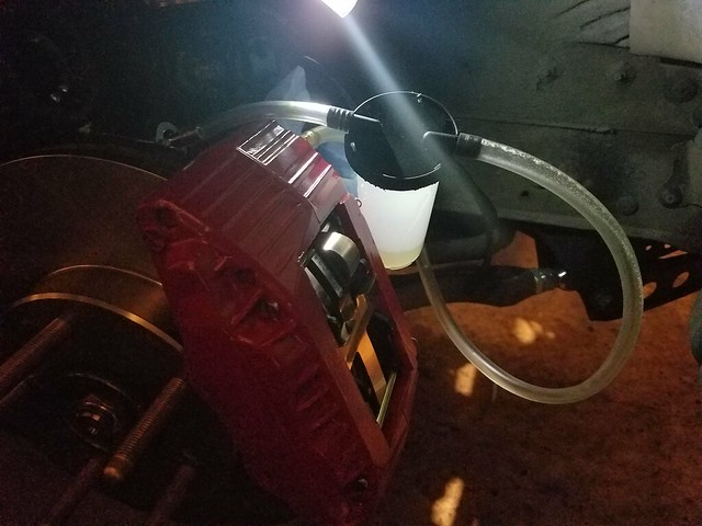

Excellent....that would be calcified dirt, old fluid, gunk, etc that was blocking the fluid from moving into the chamber from the secondary piston. Cleaned everything up, checked the seals for wear, and reassembled. Fluid shot half way across the garage on the first pump.
Oh yessss..shes a squirter..
https://farm2.staticflickr.com/1892/...18769911_z.jpg
Had to break out the vacuum bleeder for the fronts. once i started pulling fluid, they were able to bleed normally but pumping the pedal. Old fluid wasn't terrible but definitely needed a change either way.
https://farm2.staticflickr.com/1881/...a5fe70c0_z.jpg

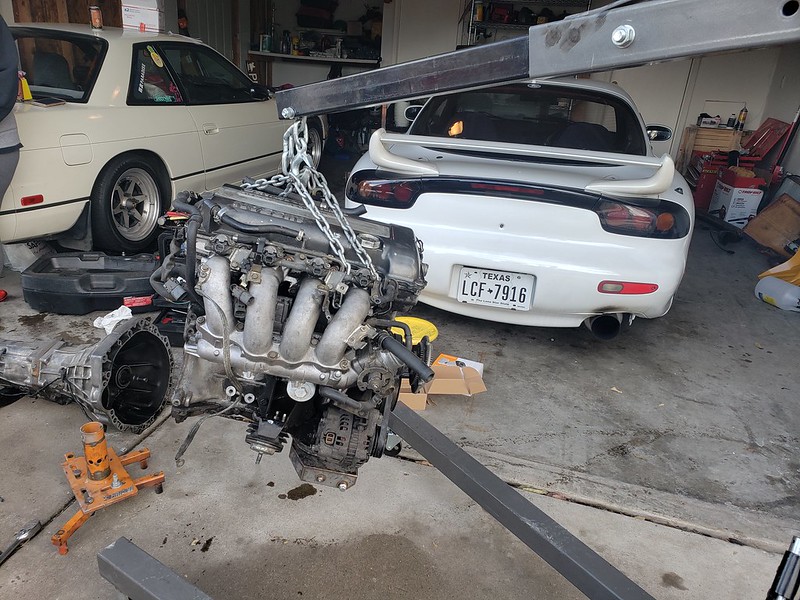

I got tired of wasting my time..fuck a SOHC; its been good to me but no thanks. Took me a couple days to find someone that would come evacuate the freon so I could disconnect it.
https://farm2.staticflickr.com/1923/...49b61bb5_z.jpg
https://farm2.staticflickr.com/1974/...fa9a61e8_z.jpg
https://farm2.staticflickr.com/1918/...fe0d862a_z.jpg
On to the next one..I cant wait to hit the bay with the pressure washer and see where its at; I've yet to find any rust or corrosion.

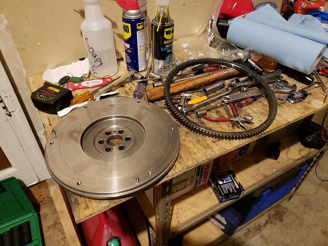

Fucking gear ring was spinning the whole time. Interference fit my ass, I was able to spin and remove the ring by hand. Apparently Exedy make decent clutches but shit flywheels. Easily remedied by throwing 4 evenly space tack welds like other manufactures or ya know..not having a 2pc design. Oh well, I got some decent cash for the motor..live and learn I guess.

Well, that escalated quickly. Just like that, I dont care about some stupid cheap flywheel. This is was just too gooda deal to pass it up.
https://farm2.staticflickr.com/1934/...541d05ec_z.jpg

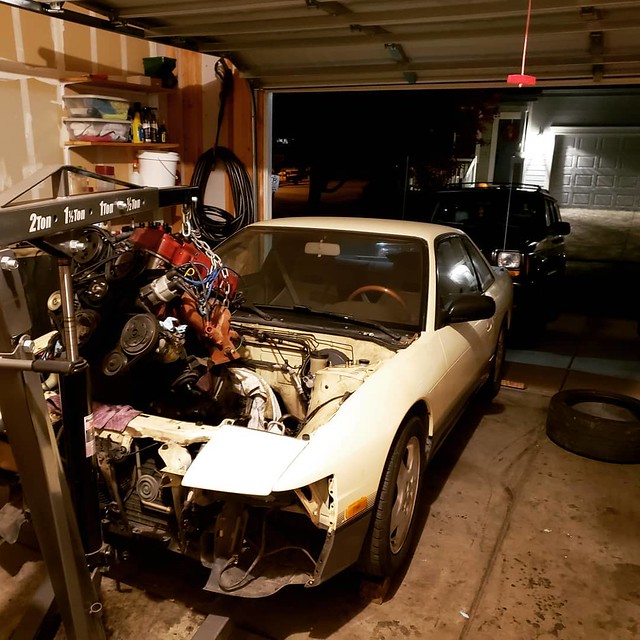

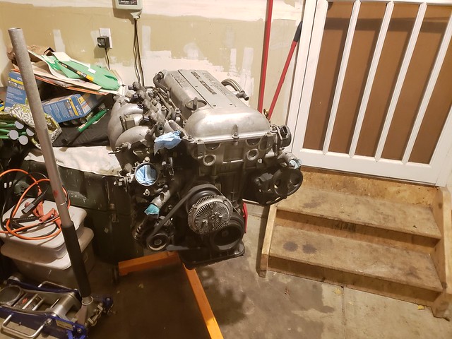

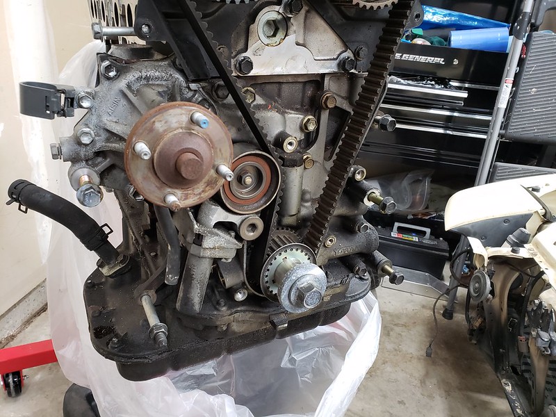

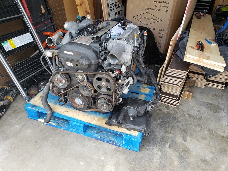

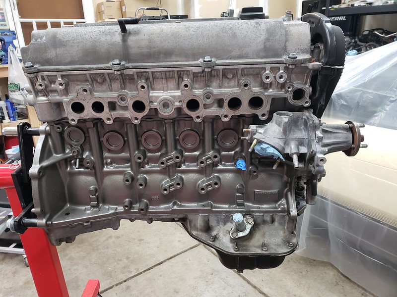

I sold my sohc setup the night after I pulled it, got a decent price for it. I also has a bit of cash laying around because I had been planning to buy some silvia front end parts. Now, I was on the hunt for a motorset and there was a front clip locally for an arguably good price since it had everything to drop and go.
This thing popped up Thursday before I left work, told the wife it was an impossibly good deal to pass on. I did some quick math on what it'd cost me to buy the missing parts and it definitely made sense. After checking it out, we tossed it in the jeep with probably another $1000 worth of parts in boxes, an engine stand and 2ton hoist.
https://farm2.staticflickr.com/1961/...68e6de01_z.jpg
So..why such a good deal? A rebuilt SR with about 5k miles on it. After I sell off the parts I won't be using, this thing cost me a grand total of $0 as it sits. Needs a starter, fuel rail, 1 injector, clutch, manifold, and a transmission before I can toss it in the car. The wiring is meh, so I'm going to have to spend some time on it. The P/O was running a Power FC setup, 750s, and top mount that made about 350 wheel. Like I said, it needs a few things, but considering the front clip I was looking at costs 3k, I would have spent money on new gaskets, water pump and thermo, oil pump, etc etc and other maintenance items, etc etc..this is going to cost me 1/2 that.
https://farm2.staticflickr.com/1970/...b516995b_z.jpg

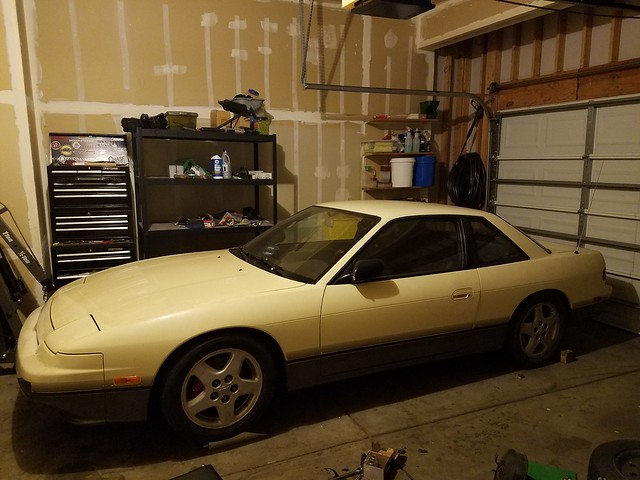

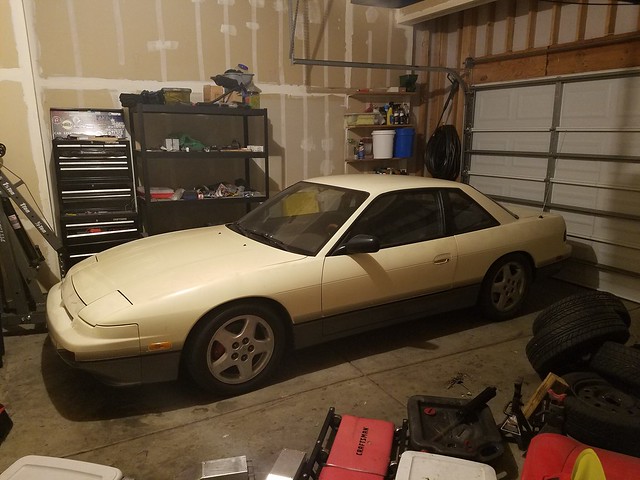

Took some time to clean the car, was really nice this weekend. came out looking fucking fire.
https://farm2.staticflickr.com/1917/...b0f4ec5d_z.jpg
https://farm2.staticflickr.com/1978/...5e7a8712_z.jpg

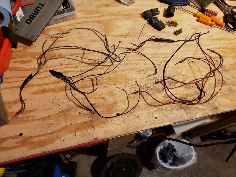

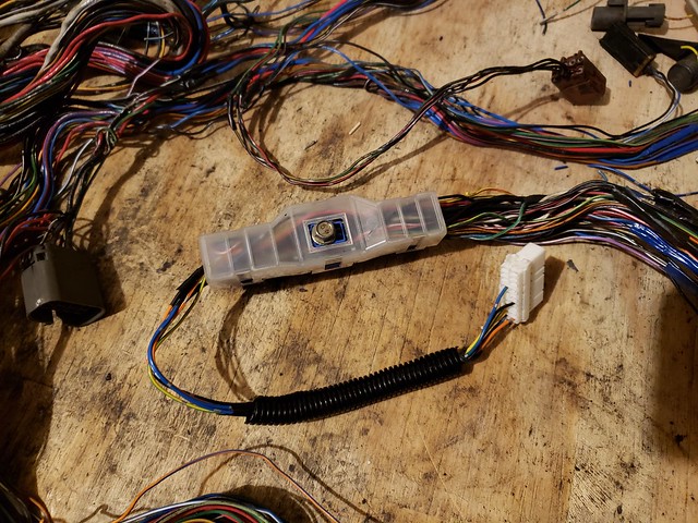

Started checking the harness. Boy..she needs some love. I have a feeling this thing will be temporary. I still want to build out my own and this one is a little worse for wear; guess I'll find out when I try to start it, ha. Started off swapping the sohc dash plug on there and de-pinned it so there's not a bunch of unused wire hanging off. I figured I'd just run through it from top to bottom.
https://farm2.staticflickr.com/1936/...99150714_z.jpg
https://farm2.staticflickr.com/1926/...e44f1512_z.jpg

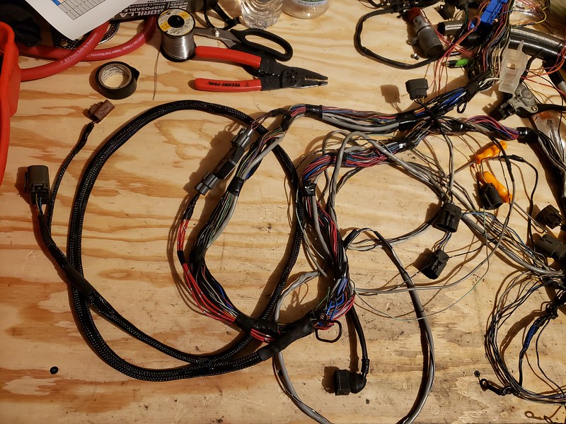

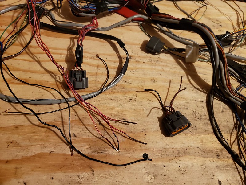

crash n' burn 11-16-2018 08:17 PM

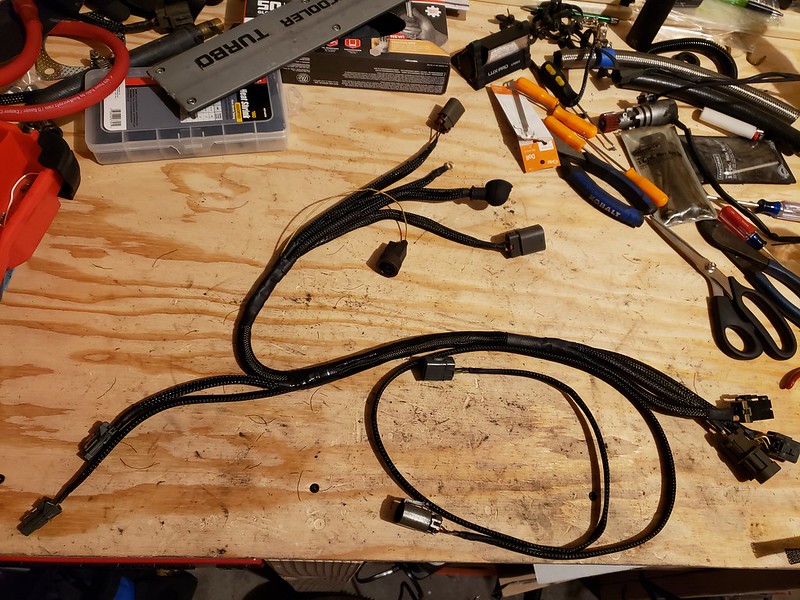

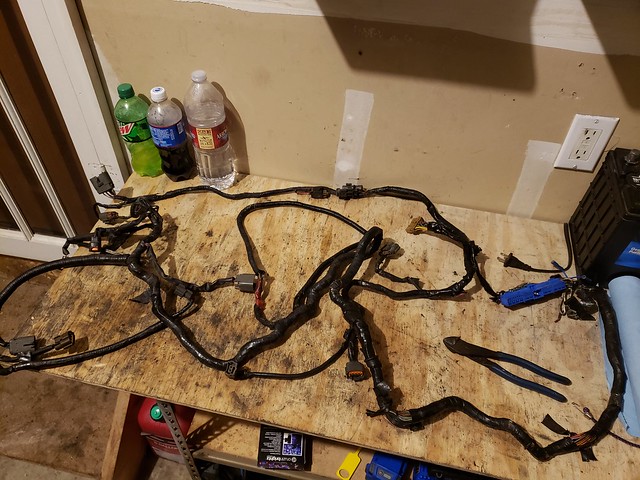

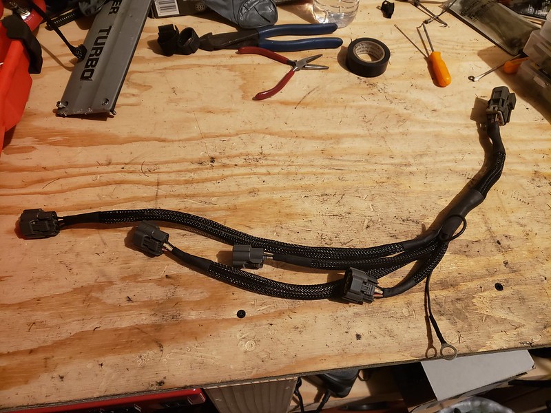

Finished up fixing the harness. This ridiculous shit is what I've had to deal with. Not a single solder or crimped connection in this entire harness, just twisted wires....hilarious
https://farm2.staticflickr.com/1938/...c5f5a108_c.jpg

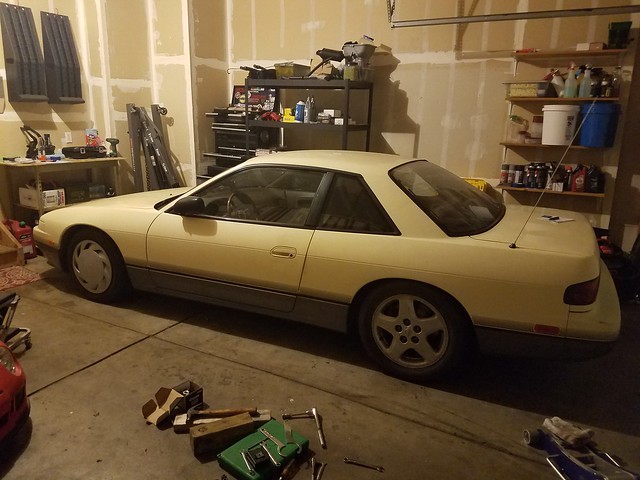

crash n' burn 03-20-2019 12:29 AM
Well..its certainly been a busy few months. Work kind of halted with the holidays, family drama, school work, and a home reno project. Car was on the back burner for the past 2 months.
https://farm5.staticflickr.com/4807/...12d9d4f8_z.jpg

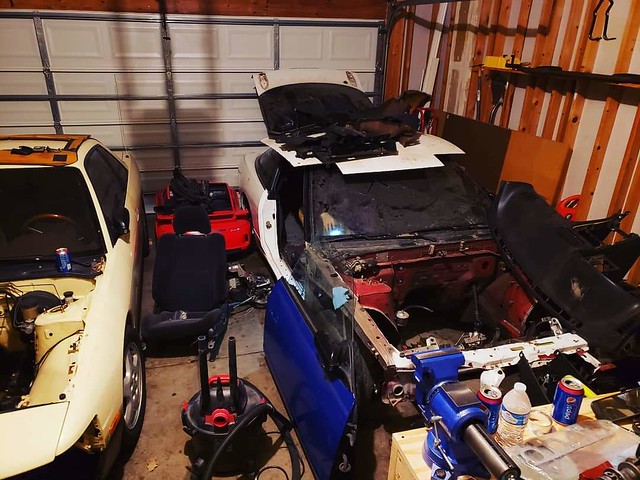

Once I got the garage all cleared out and cleaned up....Here comes another turd :duh:
https://farm8.staticflickr.com/7923/...e2a12342_z.jpg

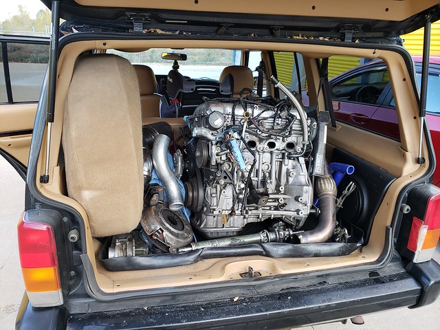

Buddy needed to store his car while hes deployed. Hatch is filled with 1jz vvti/cd009 swap parts hes been mailing to the house. But, I had to swap the lower plenum on the SR since it was tapped for a MAP sensor. New one I picked up was filled with sludge, so a quick soak and slapped that on.
https://farm8.staticflickr.com/7861/...48a55bd0_z.jpg

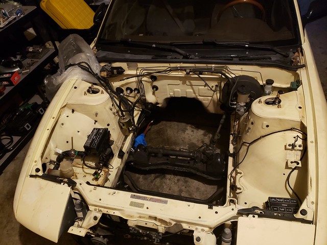

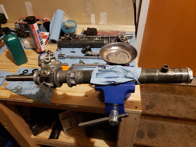

I pulled the steering rack apart to re-seal it. When I replaced my tie-rods last October, the boots were filled with fluid so I knew it needed it. Very smooth process, hope the gates seal kit works out, i was super careful to cover up the teeth on the steering shaft while sliding on the center seal..that's where they fuck up 99% of the time.
https://farm8.staticflickr.com/7816/...a8133ae1_z.jpg
https://farm8.staticflickr.com/7814/...c644fd7c_z.jpg

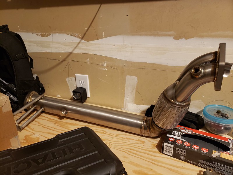

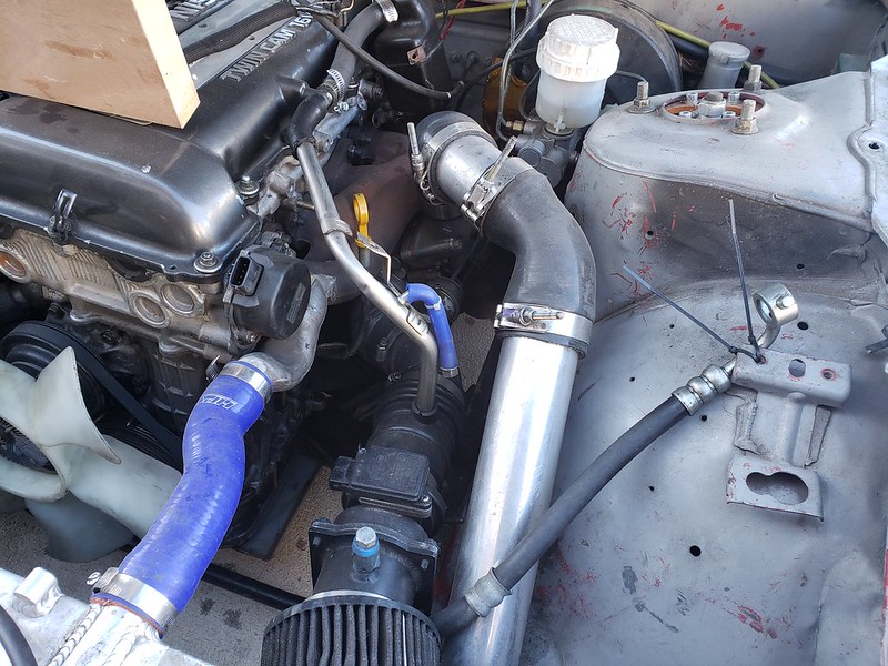

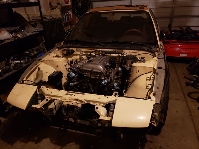

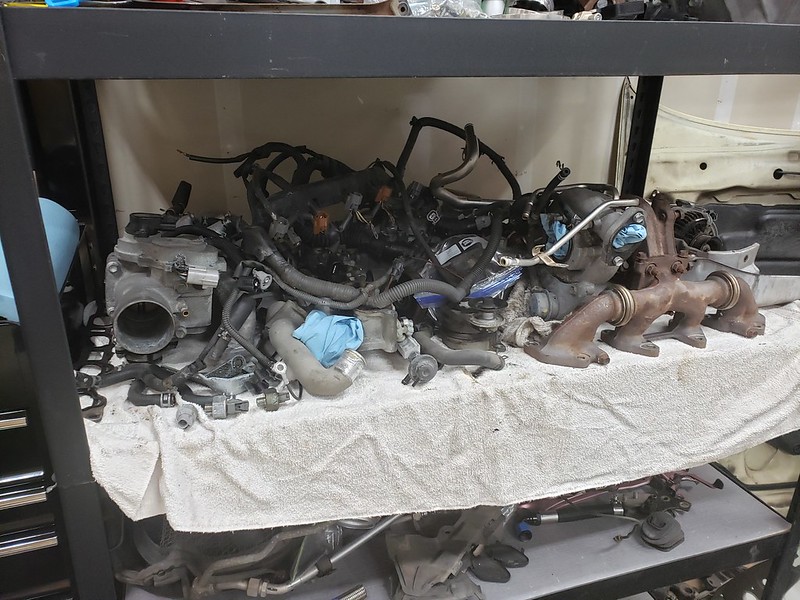

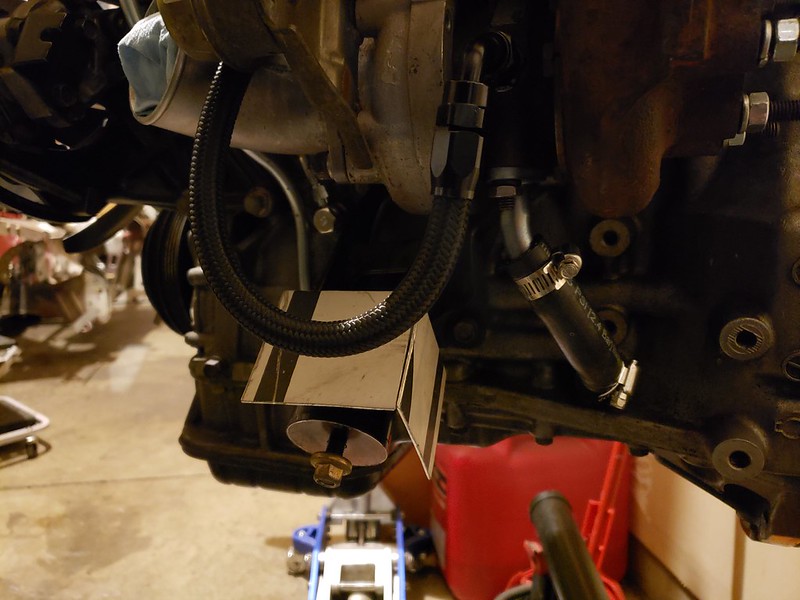

Then I decided to tackle the hot side and throw a bunch of new hardware and multi layer gaskets at it. I even found an old factory catch can to toss on. Will just need to clean ti up and hit it with a little paint.
https://farm8.staticflickr.com/7917/...ef51cd20_z.jpg
https://farm8.staticflickr.com/7810/...3043ccf2_z.jpg
https://farm8.staticflickr.com/7833/...6e62e0d3_z.jpg

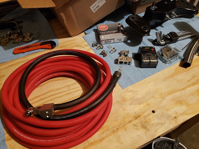

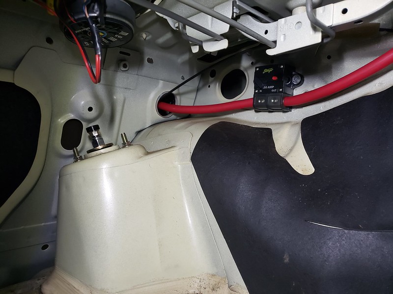

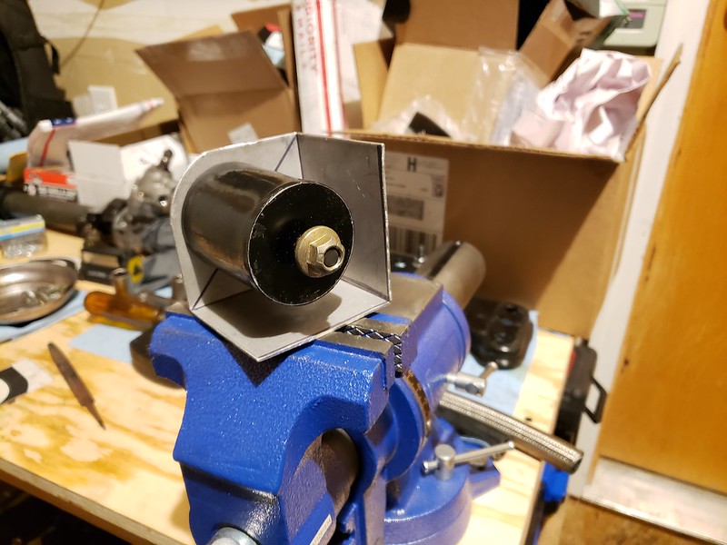

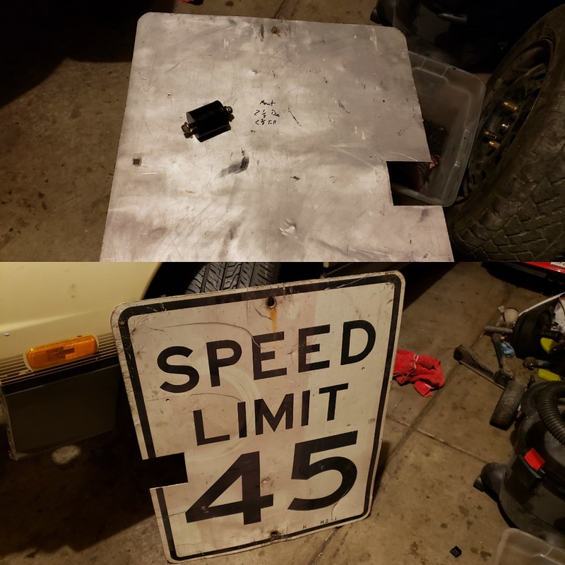

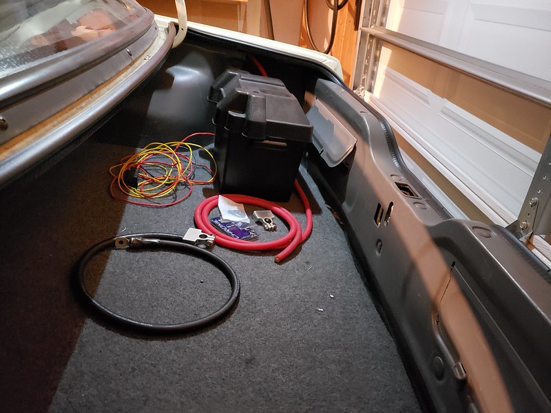

I also grabbed a few things for the battery relocation. I wanted something presentable but low key even if its in the trunk. I have to swap in the fuel pump while I'm back there running the lines as well.
https://farm8.staticflickr.com/7924/...80424b0d_z.jpg

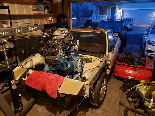

So, now that you're all up to speed, I've got a few things in route that will button up the drive train so I can get it in probably next weekend. I've still got to grab a radiator, intercooler, and turbo back exhaust stuff. We're in the final stretch and I hope to have it up and running for the start of summer.
da_crew10 03-20-2019 07:34 AM
Love the coupe!
Keep it up man.
crash n' burn 04-03-2019 11:49 PM
Small update.

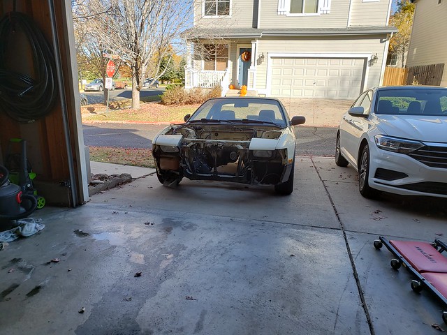

I was set to drop the drivetrain in this past weekend but I had to rush the wife to the ER early Sunday morning. Ended up needing emergency surgery to remove her gallbladder. She she was in bad shape and started to getting jaundice. Been taking primary on parental duties while shes recovering. Annnnnnnnyways.

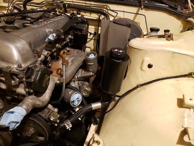

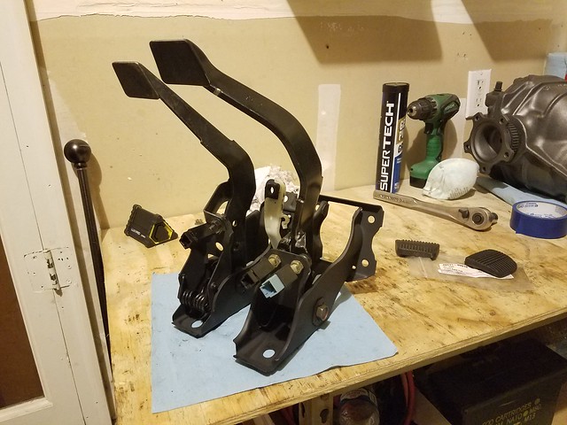

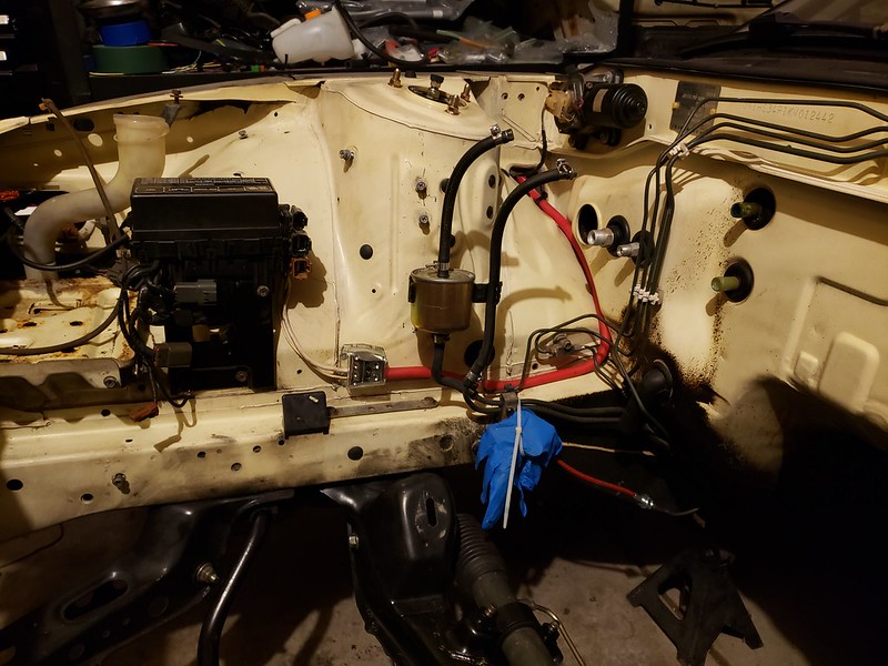

Been working on some small odds and ends. Still trying to decide on HMIC or FMIC. I love the idea of a high mount but a nice GReddy kit hanging off the front always looks tough.
Got the rack back in. Cleaned the cross member, wrapped up the relocation. Really happy about the fit and finish. I just need to toss in the fuel pump and wire in the relay to stabilize the voltage.

Since I'm running poly mounts, the driver's side needed a head shield. I had the skid plate from my old blue coupe laying around. Couple cuts and bends, we're golden. Thanks NCDOT!
https://live.staticflickr.com/7859/3...9b7a8c0d_c.jpg
https://live.staticflickr.com/7809/3...ce1161e0_c.jpg
https://live.staticflickr.com/7861/4...22db0723_c.jpg
Meanwhile, my quest for deals came in clutch. Shout out to THMotorsports for a KILLER price on a Hi-Power exhuast. I also scooped up a new PBM cobra flex from another member. Their shipping costs are ridiculous so it saved me like $100 on a new one. I need all the clearance I can get since i was just barely scraping my stock exhuast pulling into the garage.
https://live.staticflickr.com/7840/4...a12e09d6_c.jpg
https://live.staticflickr.com/7899/4...7d61d3a0_c.jpg
averyglass 04-29-2019 07:28 PM
Mind supplying the links for the battery relocation stuff? I want to do the exact same thing in my coupe.
crash n' burn 04-29-2019 09:33 PM
- 21ft red, Knu Konceptz cable, 1/0ga. Have about 5ft left after making a starter power wire)
- 3ft black, Knu Konceptz cable, 1/0ga.
- 2 set-screw ring terminal, Knu Konceptz, 1/0ga. Perfect size for starter stud and the other for ground.
-----------$54?
- Stinger SGP901501 150A breaker, does 1/0ga or 4ga with a removable insert.
- Stinger Select SSVLBTP & SSVLBTN battery terminals, has 0/4/(2)8ga terminals.
- Stinger SHD21 distro block, (2)1/0ga and (4)4ga or 8ga with removable insert.
-----------$65?
- Orielly's battery box.
-----------$15?
Not too bad, a lot of it is preference and it could be done cheaper. Cable can hold like 400A of current. Max alternator output is 85A factory, 125A if using the Quest alternator; both below the breaker threshold including the added resistance over 12ft.
crash n' burn 04-29-2019 09:40 PM
Had some time to kill yesterday afternoon, figured I'd toss everything in there. Super smooth install, my buddy Jack swung by with an adapter I needed and gave me a hand.
https://live.staticflickr.com/65535/...2c8e973b_z.jpg

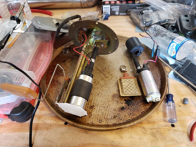

Wife started a new job that fits her school schedule; so now I get some uninterrupted wrench time on the weekends..yesssss!!!
Started off by tossing the new walbro in last night; soldered the harness in, re-flowed and added some new solder to all the hanger connections
https://live.staticflickr.com/65535/...d091cee0_z.jpg

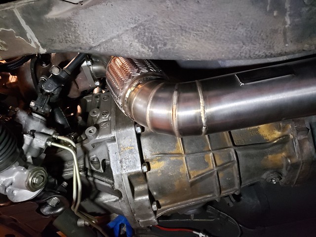

Power steering kit finally showed up after 2 months. Bolted in the down pipe in with a new O2 sensor and a fat to skinny conversion bung then got all the -an lines tightened up and oriented to my liking.
https://live.staticflickr.com/65535/...6d137ecc_z.jpg
https://live.staticflickr.com/65535/...00798cc2_z.jpg
Also popped some new plugs in it. The old ones had about 5k miles; motor look s to have been running very healthy..so fingers crossed it should be relatively trouble free.
https://live.staticflickr.com/65535/...681c7ee3_z.jpg

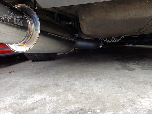

CamryOnBronze 05-14-2019 07:55 AM
Cool to see how well that HKS exhaust fits with the poly hanger bushings, PBM Cobra, and transmission mount. Having those things in place really seems to make all the difference!
crash n' burn 05-14-2019 08:13 AM

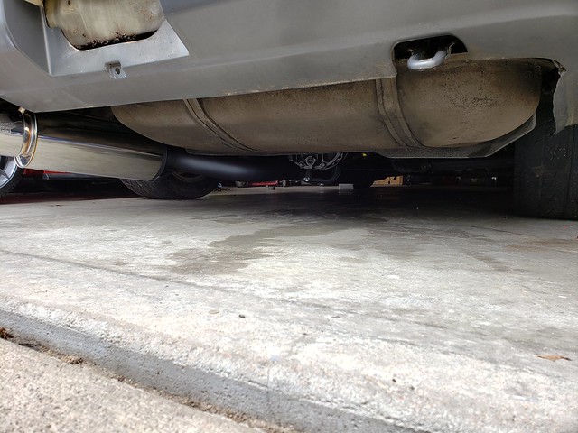

The only reservation I have is the gap between the downpipe and the floor pan, less than a 1/4" at most. There is no heat shield since that was part of the stock KA down pipe. I didn't get a real good look while tightening up the exhaust but I may have to come up with some heat protection so I don't roast my feet and destroy the undercoating from heat. Shouldn't be critical now that I'm living in such a dry climate; brake rotors still have no surface rust after being on the car for close to 6 months.
I really don't want to wrap the downpipe either, especially since that means pulling it back out :down:
DRFT180 05-14-2019 11:50 AM
DEI's tunnel heat shield has worked real well for me. I've lined my trans tunnel and above the exhaust when it turns under the car. Keeps my feet from burning while lapping at a track day.
http://designengineering.com/floor-t...e-heat-shield/
CamryOnBronze 05-15-2019 09:37 AM
I hear ya. I wrapped mine when I first had it many years ago, but when I put the car together the second time I was too lazy. I haven't looked really closely at it to see if it has caused any issues. Definitely feel a bit of heat from it, but adding dynamat to the interior helped for sure.
tuzzio 05-15-2019 10:05 AM
I wanna say the DEI stuff is what I used (can't remember as its been a few years) but I also riveted mine to the floor cause I knew the adhesive wouldn't last forever. I did from where the firewall starts to radius down (behind the pedals) pretty much past the trans and it made a HUGE difference.

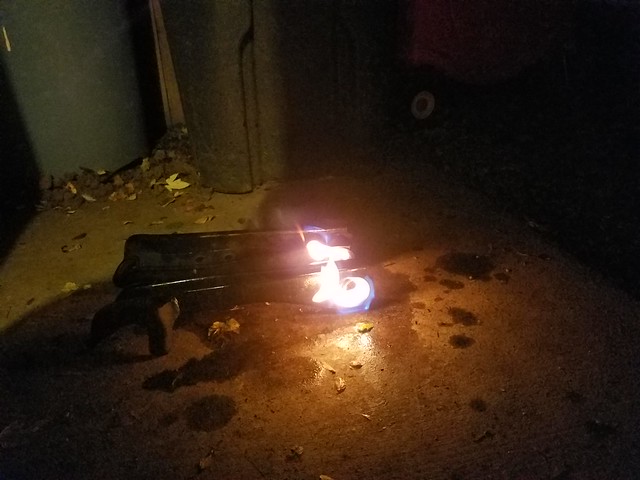

Been tinkering every night this week since I'm done with school til after the summer. Unfortunately some home projects are taking all my money so for now, its time to do some cheap improvements. The cable guy are work had some scrap braided sleeve so I stuffed it in the ole' lunch box at the end of the day and brought it home with me.
https://live.staticflickr.com/65535/...94e39730_c.jpg
https://live.staticflickr.com/65535/...ccd4d498_c.jpg
Came out super nice I think. I'm pretty happy with it, especially for something that not many people will even pay attention to. Next up is my coil pack harness. The wiring needs a little love (broken insulation, hardened and cracked outer sleeve, etc etc).
https://live.staticflickr.com/65535/...234ce274_c.jpg
crash n' burn 05-22-2019 12:41 AM
Things are coming together nicely. Slow..but I'm really happy with how this stuff is turning out.
I've been doing some heavy research and giving some serious thought to offering wiring services..I'm that rare person that gets satisfaction from doing it.
https://live.staticflickr.com/65535/...5f342f30_c.jpg
https://live.staticflickr.com/65535/...f23084bf_c.jpg
If you decide to opt for heat control and pull the exhaust back off, i'd recommend getting it ceramic coated. It's cost effective, looks good, wont rust, and will last for a long, long time.

crash n' burn 06-04-2019 12:57 AM
Haven't had much time to mess with the car. I've actually been collecting some parts for the other car in the garage.
I wrapped up repairing the last piece of jank wiring that was done to this harness.
https://live.staticflickr.com/65535/...d3429d6a_c.jpg
With that, however. That means I also relocated the ignitor inside the car so it will sit just below the HVAC matrix, nicely tucked up out of the way. Then, I tested every circuit for connectivity....le suck </3
But everything looks good! So, I started looming the parts of the harness I want to be presentable.
https://live.staticflickr.com/65535/...035b13fe_c.jpg
That last statement may sound confusing but after a lot of consideration, I'm going to just make a harness from scratch. I'm not 100% happy with this one due to various things that had to be fixed. The upside of it all; my friend has a super hack job harness on his drift car and I'm going to toss this one to him for just enough money to cover materials to build my new one. Win/Win.
crash n' burn 11-20-2019 10:14 PM
Been a hot minute..been doing stupid stuff; preparing for my wife to have major surgery at the beginning of December and we have been tight on money because we're trying to be smart and pay off all our debt before next summer. /sigh, I know its for the better, but I fucking hate it.
So lets see, I wanted to have my car running before my birthday, ha..sike.
Friend was looking for a SR and I came out on top big time by trading him money, a KBD kit, and a complete KA swap. Figured a running/driving car was better than a garage ornament.
LOL, I hate myself.
https://live.staticflickr.com/65535/...9098c3e4_c.jpg
https://live.staticflickr.com/65535/...0d98ba12_c.jpg
https://live.staticflickr.com/65535/...eb28663b_c.jpg

Most recently, I've been helping my buddy sort his hatch out after he got screwed over by a local tweaker/shop owner. Dude conned, stole, and ripped off him and about 6 other people. Packed up and left the state without telling a single person around March. Its a miracle the thing even ran with how bad this harness is. No coolant lines to the turbo (plugged block ports) and loose oil line fittings..turbo is now blown too :picardfp:
https://live.staticflickr.com/65535/...56beb3db_c.jpg
https://live.staticflickr.com/65535/...cea957d9_c.jpg
https://live.staticflickr.com/65535/...a4db1ee5_c.jpg

We made some progress on my buddy's car. After some measurements, we decided his front end was just way past saving. He also got his motor delivered, no better thing to do than test fit everything while we're at it. Of course, now that means a tucked bay; so I started on that with him.
https://live.staticflickr.com/65535/...3df1ff98_z.jpg
https://live.staticflickr.com/65535/...5c3a8ee7_z.jpg
https://live.staticflickr.com/65535/...285b6fcc_z.jpg

Overall, everything settled within a week and I decided to buy something a little older for me to have once she gets her graduation present next year. Towing in luxury <3
https://live.staticflickr.com/65535/...c2b5249d_c.jpg
Now, content that actually matters to you. I sold KA setup back in the beginning of the year. Not a KA fan anyways, made good money off a drop in swap so I'm not mad about it.
https://live.staticflickr.com/65535/...37c38400_c.jpg
So, that brings me to the last 2 weeks. After knocking out a ton of honey-do's I started buying up swap pieces; even found a screaming deal locally 2 weeks ago. Buddy went halvsies on it for the rear end setup.
https://live.staticflickr.com/65535/...12c5e049_c.jpg
https://live.staticflickr.com/65535/...e727569d_c.jpg

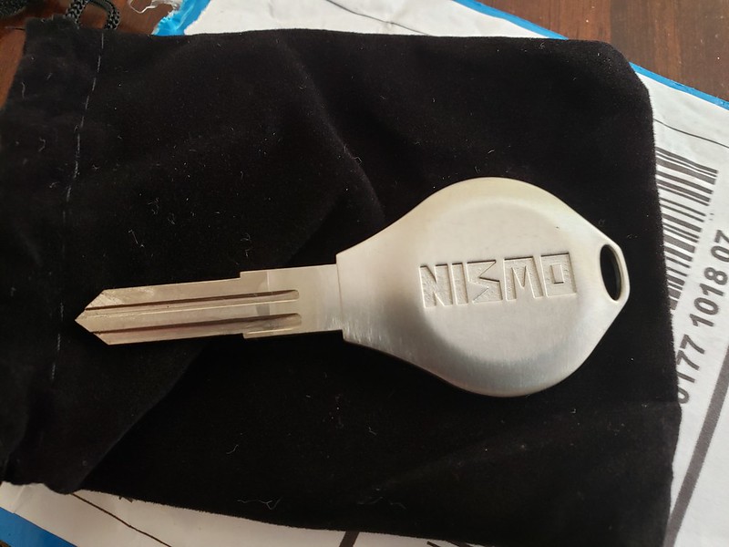

Also got in my group buy key with Ronin Imports. Surprisingly good quality. Needs some machine polishing to be perfect.
https://live.staticflickr.com/65535/...aba5257d_c.jpg

crash n' burn 04-29-2020 08:50 AM

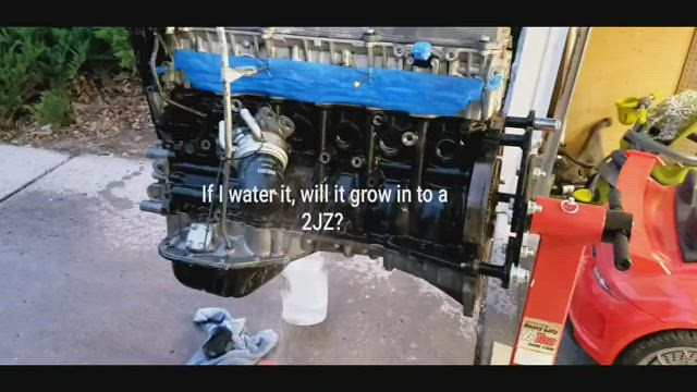

Motor showed up, not as clean as I'd hoped, but it's not missing anything. I don't think it was compression tested, so I got to rig that up later. Kind of disappointed with the lack of communication from JDM of San Diego. Looks like it got pulled out of the shipping container and had the shipping label slapped on it without ever being looked at. VVTi solenoid was broken and the ignitor was cut off for some reason? Luckily, there are a wealth of jzx100/110 swaps locally so parts are easy to come by. I already have the replacement solenoid and sending my computer off to have the immobilizer flashed out this afternoon.
I'm going to need to dive in to the motor deeper than I was hoping to and replace some "while you're in there" items; front main seal for sure with a lot of build up on the timing cover behind the crank pulley. Going to need a lot of cleaning with the amount of oxidation I've seen but it'll be a better product in the end, so I'm not mad about it.
Didn't get a chance to put it up on the engine stand though. I need to take some measurements of the auto bell housing vs the CD to make a decision on a cut or no-cut kit. I feel it may not even matter since the trans will hang down low no matter what, but i don't want to beat the shit out of the trans tunnel more than I have to.
https://live.staticflickr.com/65535/...841c3988_c.jpg
crash n' burn 05-04-2020 11:25 AM
Finally started tearing in to it this weekend. Everything is in really good condition. Just going through and cataloging what I want to replace, bypass, and upgrade. Should have have the block cleaned up and painted in the next couple days.
https://live.staticflickr.com/65535/...a66c0db5_c.jpg
https://live.staticflickr.com/65535/...59cb8f3f_c.jpg

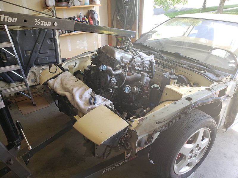

I guess I'll start tackling everything that hangs off it so I can get it in ASAP. Got more than enough stuff to keep me busy at night this week. Also ordered my adapter kit for the CD. Did quite a bit of measurements for the a340 vs CD. Decided for the sake of my firewall and more importantly ground clearance, cut kit for for me. Really wanted to retain the external slave but an extra inch is worth it.
That's what she said..
https://live.staticflickr.com/65535/...5c44b000_c.jpg

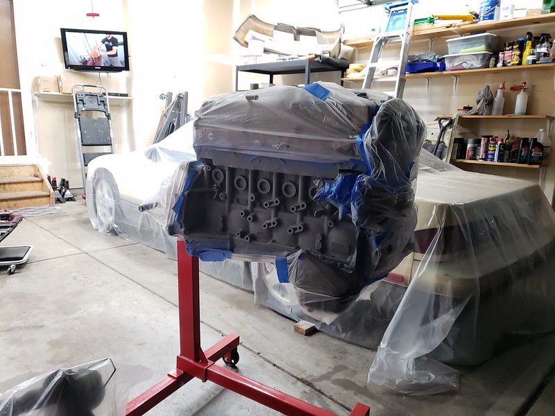

crash n' burn 05-18-2020 09:36 AM
Busy couple weeks, back on it this weekend though.
After measuring my bell-housings , I found I was going to gain back well over an inch of ground clearance using the auto bell-housing. As much as it pains me to convert to an internal slave the benefits of not having the trans hang down soo low are totally worth it. Ordered that adapter kit, slave and clutch. I also grabbed a banjo fitting for the master cylinder, some -3 conversion fittings, and bleeder fittings; going to have to test fit and measure for a clutch line so I don't make one too long or too short as well as a mounting solution for a remote bleeder.
Pulled off the crank pulley to check the front main more than anything since I have some build up around the pulley, its as dry as a can be.
https://live.staticflickr.com/65535/...ec855cec_c.jpg
I'm thinking the oil pressure release bolt has a super minor leak? Cant remove it without pulling off the waterpump, which requires pulling off the timing belt....both things I don't feel like doing at the moment so I'll keep an I out on it. Got to work scrubbing and degreasing the block.
https://live.staticflickr.com/31337/...fec37462_z.jpg
Hit the head with a brass brush, the block with a stainless one and small wire wheel for the tight spots.
https://live.staticflickr.com/65535/...fddc3a4d_c.jpg
Came out really good I think. Everything is exceptionally clean and ready to go back together. I'm not a fan of black engine blocks because you can't see leaks. I'll get around to the valve covers here shortly once the engine goes in for "good".
https://live.staticflickr.com/65535/...1757298e_c.jpg

Matt Schumann on YouTube did the cut housing kit on His jz/cd setup and his flywheel exploded. Saw that video literally right before I almost bought the AE kit and spent the few extra bucks on SerialNine. Best kit out there hands down.
Nice build though! Subbed
Video for reference
https://youtu.be/2QjcDMVh_iw
Sent from my iPhone using Tapatalk Pro
DJTTon 05-20-2020 08:15 AM
Is that a Z33/G35 diff? Whats the plan with that?
TheRealSy90 05-20-2020 09:51 AM
I feel you on the budget thing, the "youtuber" that had the issue received a revised kit from them and still had problems. Hope it works out for you.
