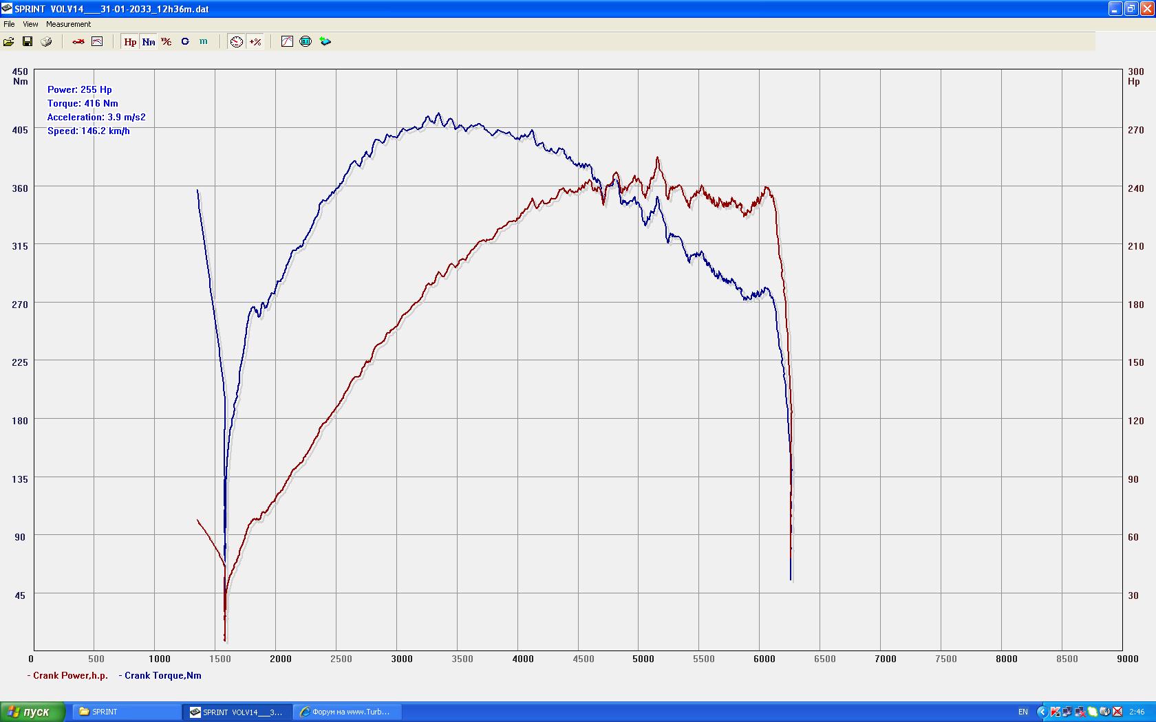

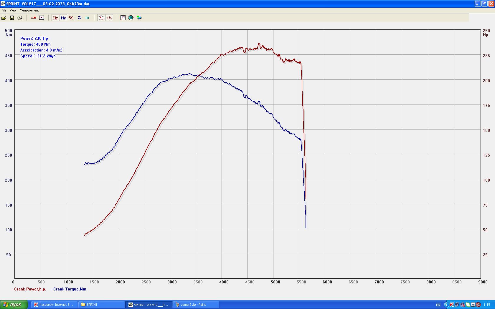

NISMOldova 04-11-2012 02:48 AM
Hi guys!
I am from moldova(in is somewere near Russia :)
I have S13 with KA24E
Now i am bilding KA24e-T
Stock turbo from S14 SR20DET (gt28R)
"Invent" ECU
Big intrecooler
HKS SSqv
Apexi power intake
NJK coils
Stock ignition coils from BMW
custom manifold
70 mm exhoust system with stock S14 muffler on the end( very smoll)
ALL INTERNALS ARE STOCK
My results: 10psi cranck angle on hi revs 17
http://s019.radikal.ru/i607/1204/d0/2a199943f3fe.jpg
8 psi cranck angle on hi revs 19
http://s019.radikal.ru/i622/1204/e3/68606b171155.jpg
Due to smoll mufler i cant rise psi to 14.
I have a question:
How many Nm can handle stock connecting-rodы ????
sorry for my spelling.
