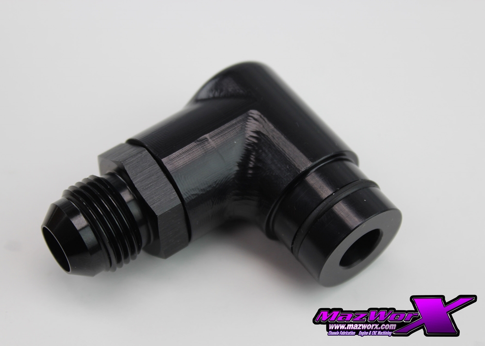

5t341tH 01-25-2021 08:35 PM
hey wanted to bump this up. So what are people doing at this piece? I have a AN fitting on the valve cover side and the other end just slips over the pipe. Just wanted to see if there's a nicer solution
EDIT: I see these pieces available but they require removing the head to install
https://www.mazworx.com/resize/Share...bh=1000&h=1000
https://scontent-lax3-1.xx.fbcdn.net...1e&oe=60356A56
240boosted 05-29-2021 08:58 PM
I getting my car setup and I using the Mazworx part and let me tell you I love it
