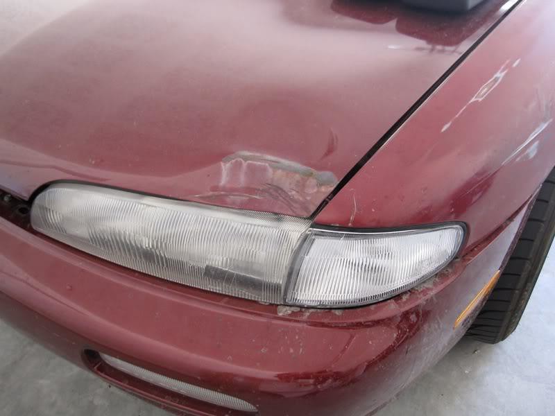

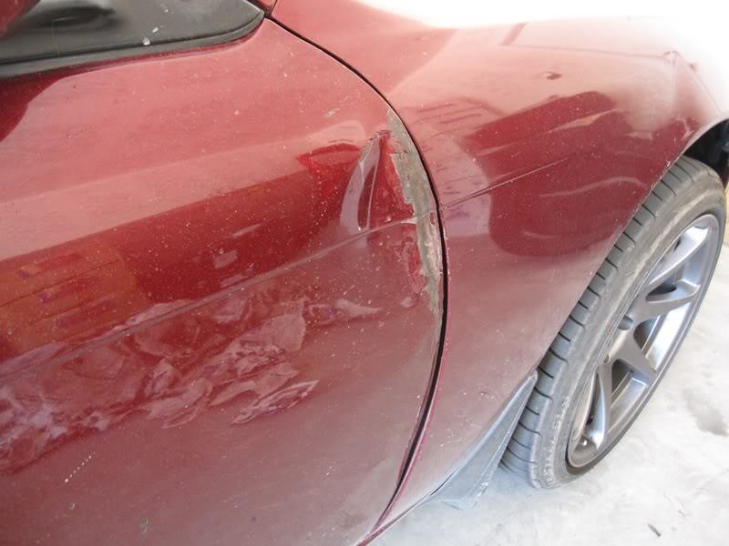

Clearly the car had been in a front end accident, there was no hiding that. The hood and passenger door both had huge bends and paint damage. The entire passenger side fender had been replaced but not painted.

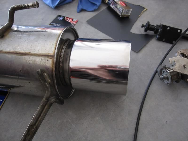

I decided that this would also be a great time to clean up the HKS Hi-Power exhaust that I had brought back with me and get that thrown on the car. I had also acquired a wingless trunk before leaving Japan and I felt that this was a good time to throw it on. This piece is very special to me because it is wingless and it has no 3rd brake light. For some reason that 3rd brake light makes me so salty. Threw on the wingless trunk and sold the old trunk with the SE wing.

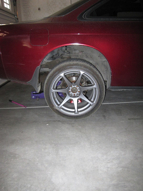

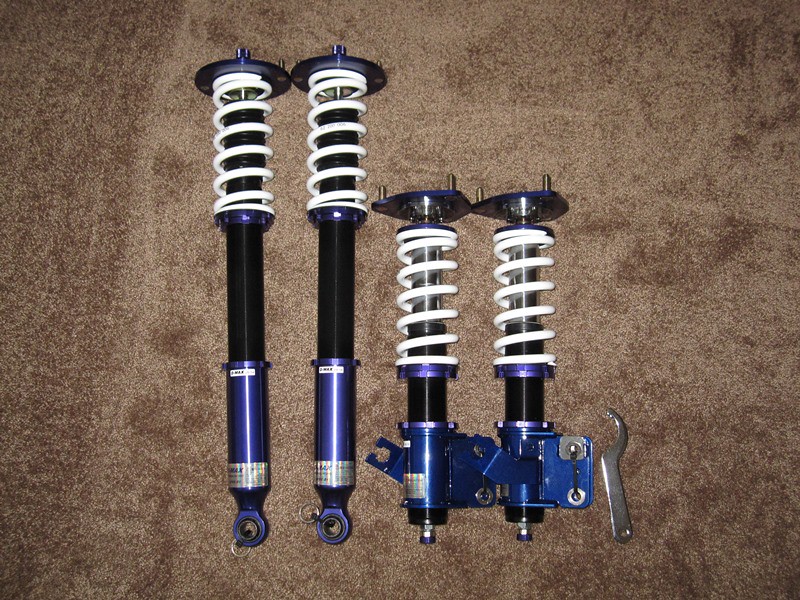

One thing that I didn’t bring with me was suspension. I ended up picking up some brand new D-Max D1 Spec coilovers from Forrest and Get Nuts Lab back when he was sponsored by them. So fucking fresh and I love the colors. I had these on the 180 back in Japan and loved the way that they felt; it was an obvious choice for me.
https://farm1.staticflickr.com/618/2...75fb57ef_b.jpg
Wheels and more low achieved. It’s actually starting to look decent…but not really.
https://farm1.staticflickr.com/685/2...562ae7dc_b.jpg

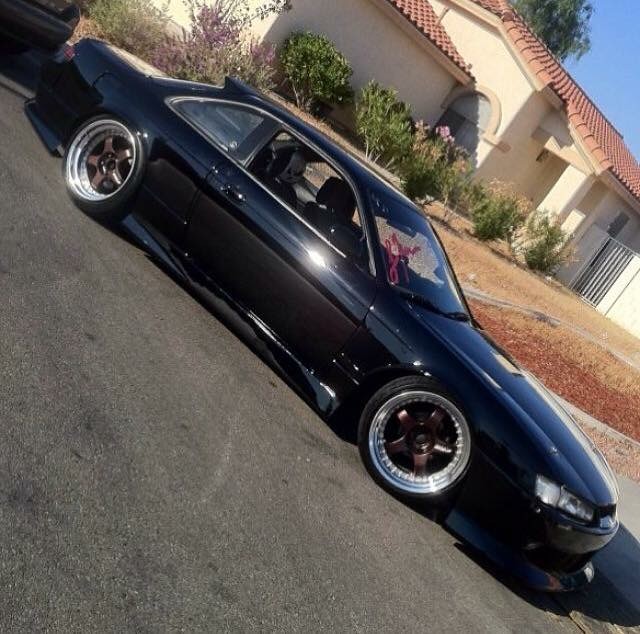

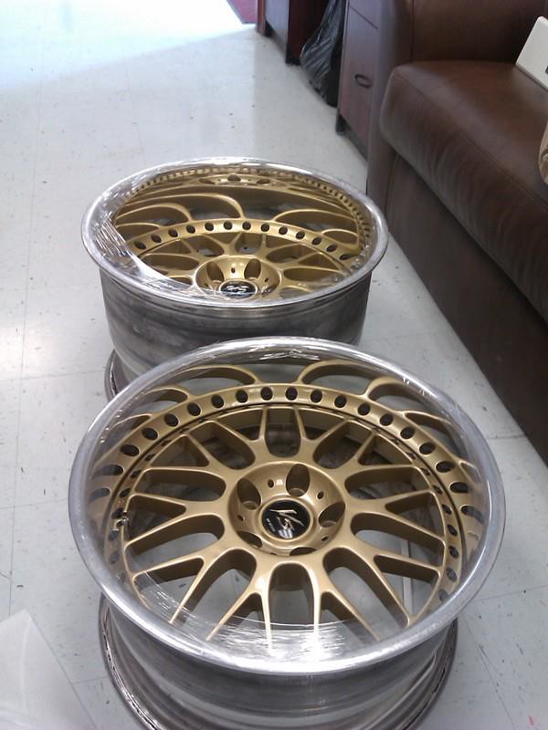

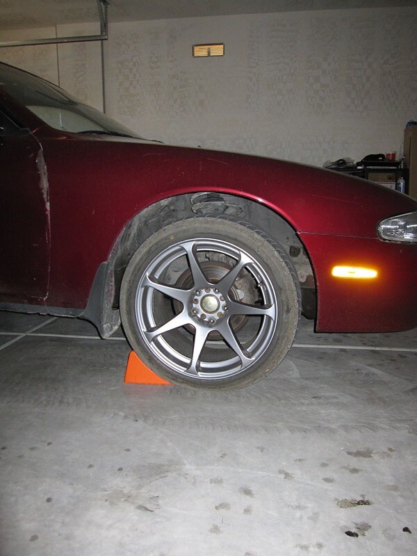

Well, by the end of the month I found a set of wheels online that I was really looking at. They would require me to go wide body, but I just couldn’t decide if I wanted to do that or not. I ended up showing the wheels to one of my co-workers. He gave me the old, “you won’t do it, you’re not down.” Less than 30 minutes later I pulled the trigger and sent a payment to VR Wheels.
Front – 18x10 +0
Rear – 18x12 -7
https://farm1.staticflickr.com/721/2...6768becd_b.jpg

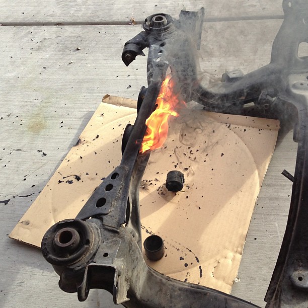

I can’t honestly remember why I was burning these bushings (I think I was selling the subframe with bushings removed) but it was rad and it belongs here.
https://farm1.staticflickr.com/756/2...66dccb0e_z.jpg

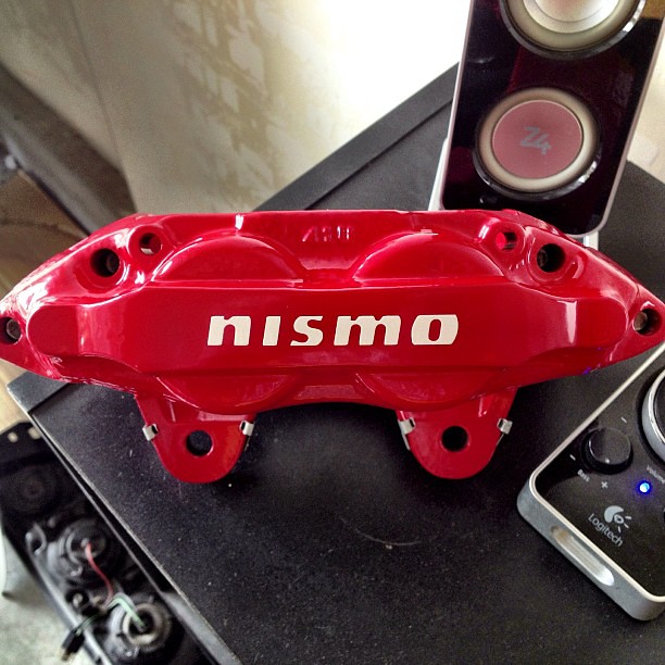

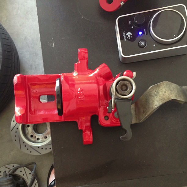

Next order of business was to get some color on the calipers. I also picked up some decals to throw on the Z brakes. They turned out just how I wanted them, perfect! Also, took this opportunity to put some GKtech handbrake levers on the stock rear brakes to help them lock up a little better.
https://farm1.staticflickr.com/576/2...1286922b_z.jpg
https://farm1.staticflickr.com/638/2...34ed4783_z.jpg

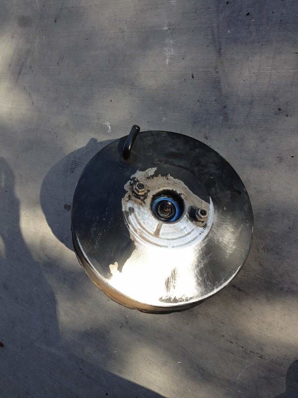

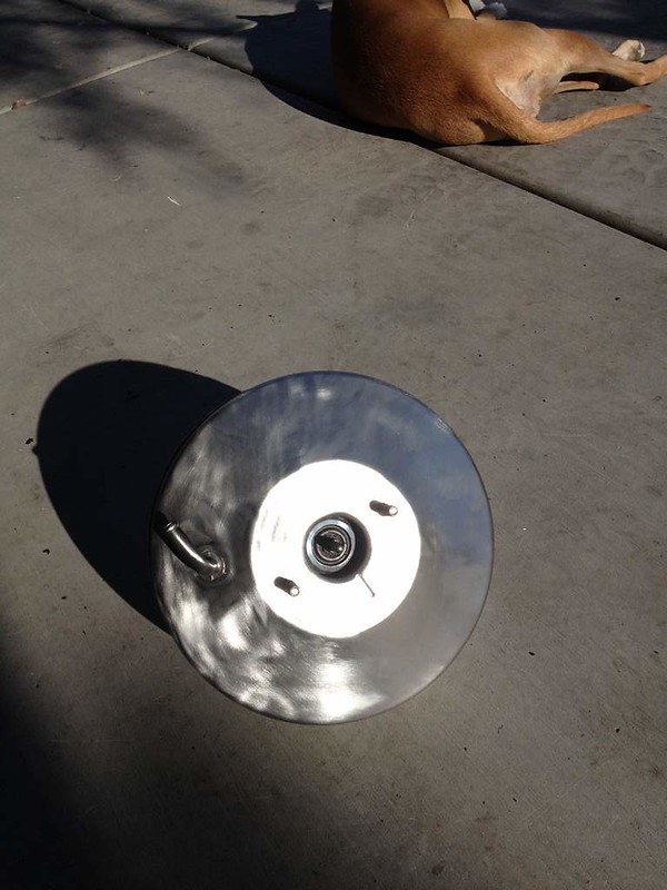

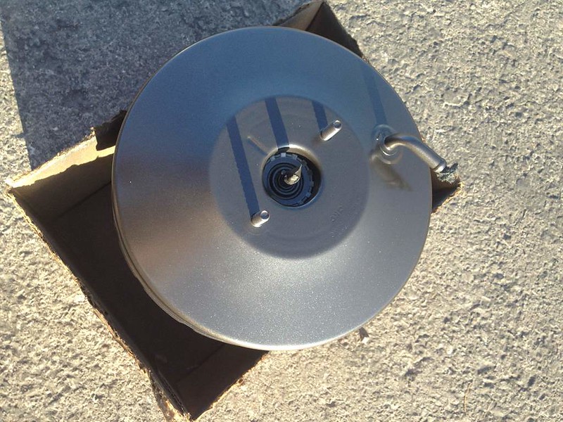

The brake booster had seen better days so I decided to strip it and repaint it with some engine paint. I think it turned out pretty good.
https://farm6.staticflickr.com/5770/...1e8ca78b_c.jpg
https://farm1.staticflickr.com/755/2...9021be9a_c.jpg
https://farm6.staticflickr.com/5683/...071f2626_c.jpg

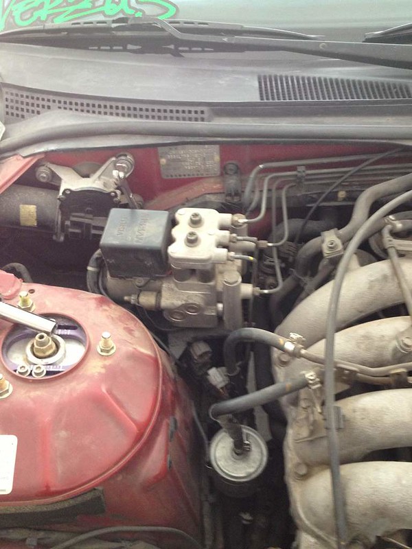

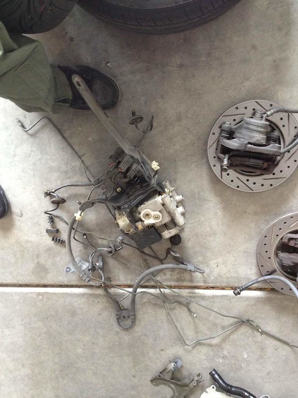

I made the decision that ABS wasn’t for me, so I got to work removing that crap. I wanted to do this the right way so I bought brand new non-ABS factory hard lines and got a 1” BMC with three ports. I went with the 1” since I was keeping the rear brakes stock.
https://farm6.staticflickr.com/5679/...f0f5fc86_c.jpg
https://farm1.staticflickr.com/588/2...67cbab18_c.jpg
https://farm1.staticflickr.com/620/2...8c472933_c.jpg
https://farm1.staticflickr.com/624/2...4d2ca6f2_c.jpg

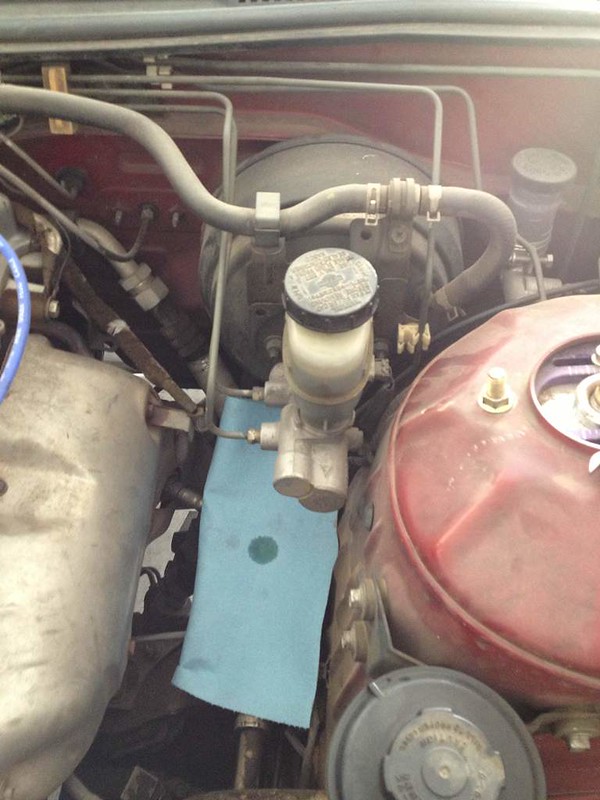

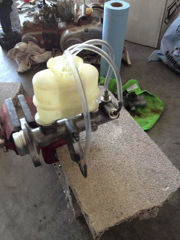

Bench bleeding the “new” master cylinder. Super ghetto setup, but it worked perfectly.
https://farm1.staticflickr.com/579/2...169d53d6_c.jpg

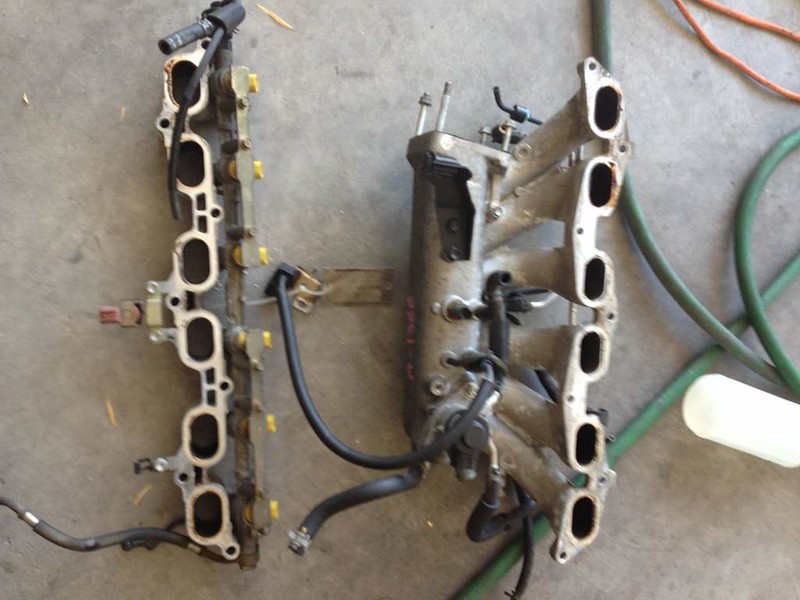

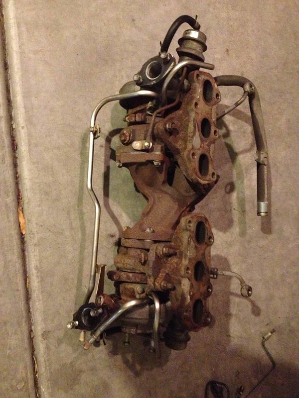

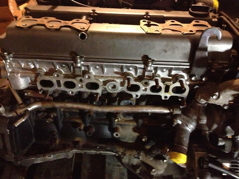

The twin turbos were the first thing that needed to go, as well as the intake manifold.
https://farm6.staticflickr.com/5662/...c6a3e5ec_c.jpg
https://farm1.staticflickr.com/757/2...ff3d2b60_c.jpg
https://farm1.staticflickr.com/736/2...b46e3028_c.jpg
https://farm1.staticflickr.com/724/2...af852d1b_c.jpg

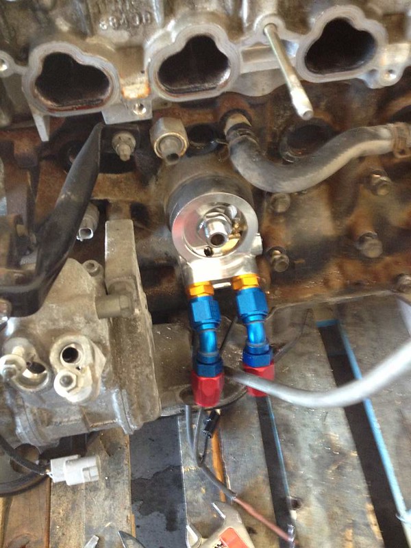

One thing that really bothered me when I got the intake manifold was the factory oil cooler. It was so damn bulky and annoying. I decided that I wanted to get rid of it since I was going to run an aftermarket oil cooler anyway. I bought a threaded union pipe, proceeded to remove the factory oil cooler, and installed the Greddy oil cooler adapter. This adapter has a built in thermostat and I just happened to have it sitting in my garage, so win-win for me. I had originally bought the adapter for the S14 SR that I had, then I found out that it would also fit the KA so I kept it after I sold the SR. Well, I then found out that it also fits the 1JZ motor, so I finally ended up using it, HAHA.
https://farm6.staticflickr.com/5801/...6c780f45_c.jpg
https://farm6.staticflickr.com/5823/...e05af88b_c.jpg

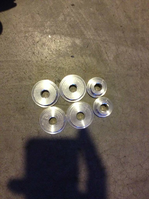

The guys at SerialNine are all about that Toyota life so I contacted them to CNC me a set of bushings for the tripod shifter. They explained that they weren’t making them anymore but they agreed to make me a set. I knocked out all of the old bushings and pressed the new ones in. Great fit and obviously super solid.
https://farm6.staticflickr.com/5722/...ea4918a2_c.jpg
https://farm1.staticflickr.com/617/2...4b93d9d9_c.jpg
https://farm1.staticflickr.com/677/2...aabf7dd1_c.jpg

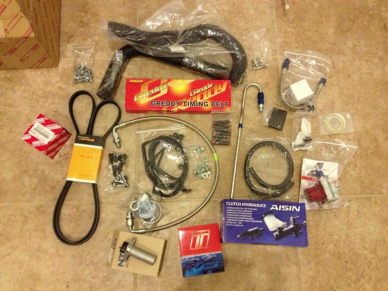

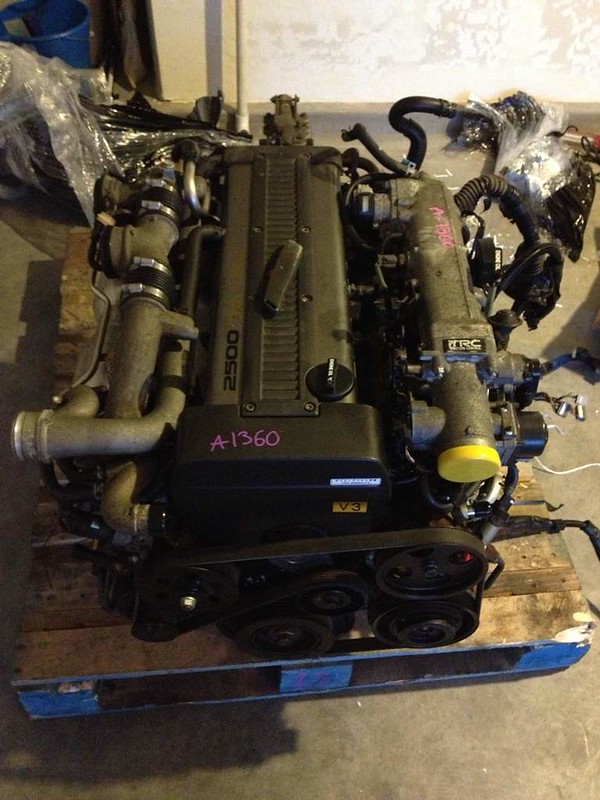

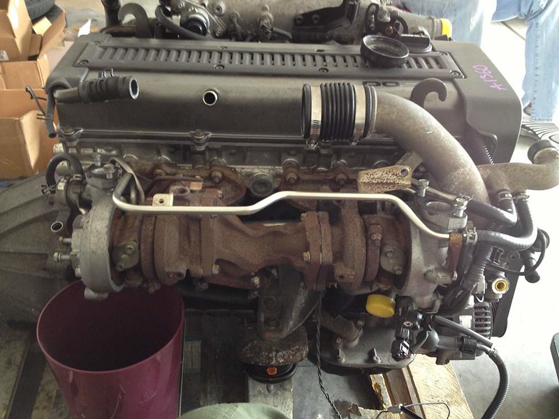

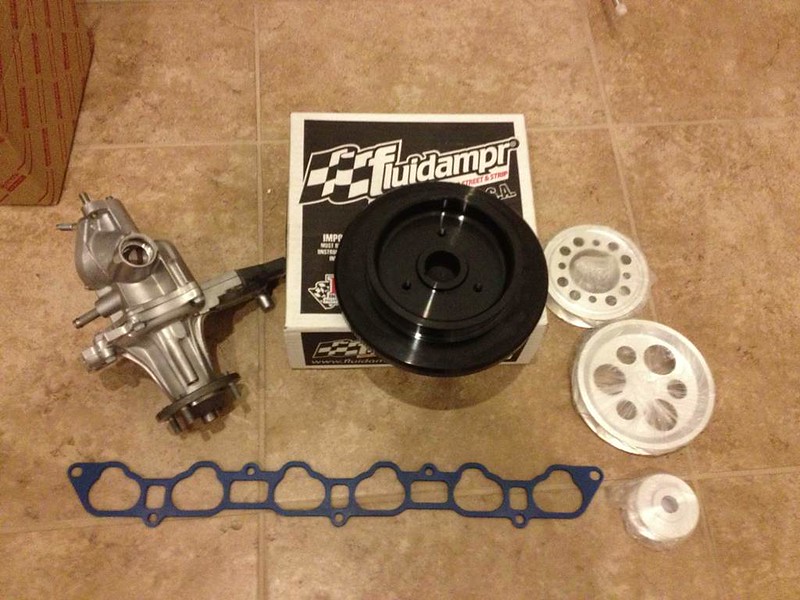

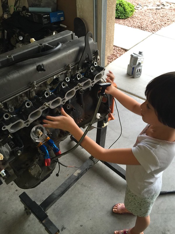

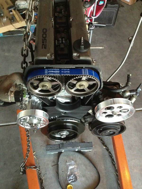

It was time to start buying parts for the motor, so I went on a purchasing spree on Driftmotion.
https://farm1.staticflickr.com/593/2...44f1c66c_c.jpg
https://farm6.staticflickr.com/5774/...b7d2f0f8_c.jpg

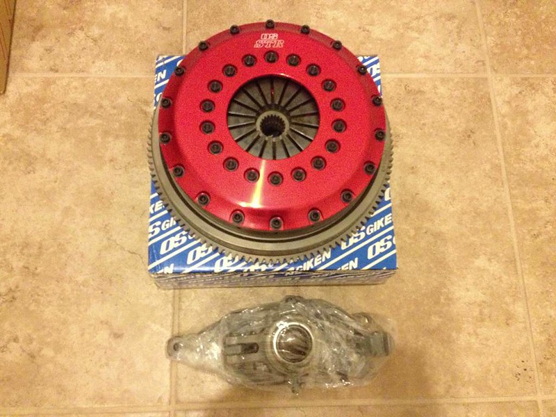

Went with an OS Giken twin plate clutch with the pull-to-push conversion. I have used OS products in the past and have always been impressed with the quality.
https://farm1.staticflickr.com/763/2...73111aff_c.jpg

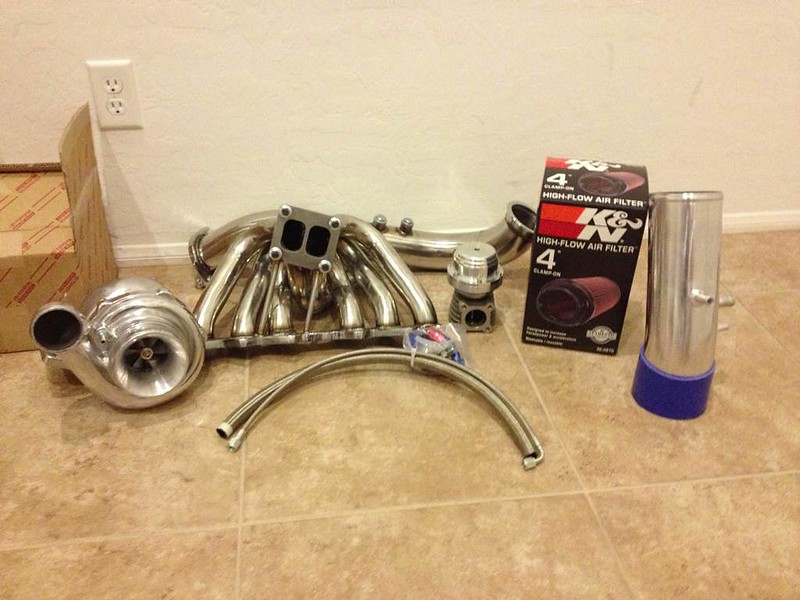

Also picked up a 57 trim turbo kit from Driftmotion.
https://farm1.staticflickr.com/639/2...afbdecf6_c.jpg
I was very reserved about putting the motor in before I could get the car registered as a classic rod, so I figured I would do some work on the car itself. I hit up SPL Parts and purchased all of the replacement arms for my car. I also purchased a GKtech subframe bracing kit and had my friend weld it up. He added a couple of additional braces as well and then I took it to get powder coated.
https://farm1.staticflickr.com/590/2...1cae61c4_c.jpg
https://farm1.staticflickr.com/592/2...dae9a248_c.jpg
https://farm6.staticflickr.com/5788/...62239246_c.jpg
https://farm6.staticflickr.com/5738/...61000887_c.jpg

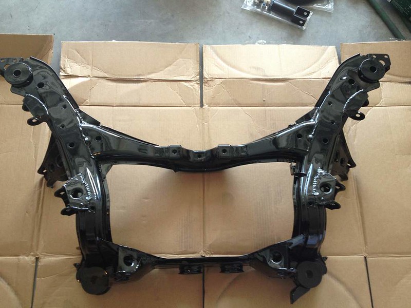

Everything assembled on the subframe
https://farm6.staticflickr.com/5710/...8127b530_c.jpg

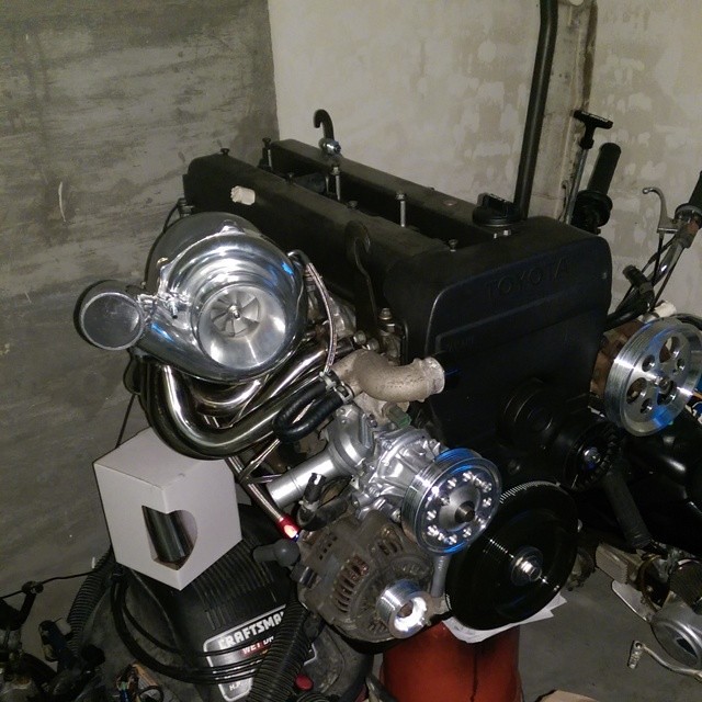

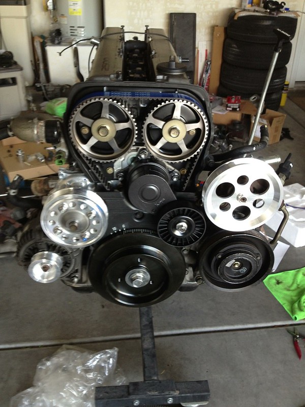

I ended up getting bored and decided to put some of the smaller parts on the motor. I got the Greddy timing belt, timing belt tensioner, water pump, crank pulley, front main seal, cam seals, and aluminum pulley set installed. I also took a little time to paint the serpentine belt tensioner with the same paint that I used on the brake booster and to get the surface rust off of the cam gears as well.
https://farm6.staticflickr.com/5719/...2d390ed1_c.jpg
https://farm6.staticflickr.com/5777/...830d900f_c.jpg

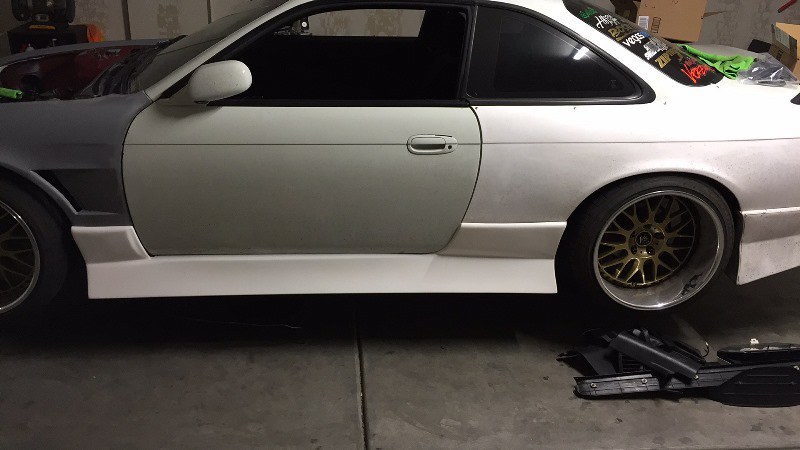

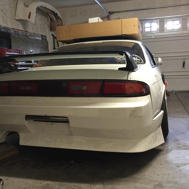

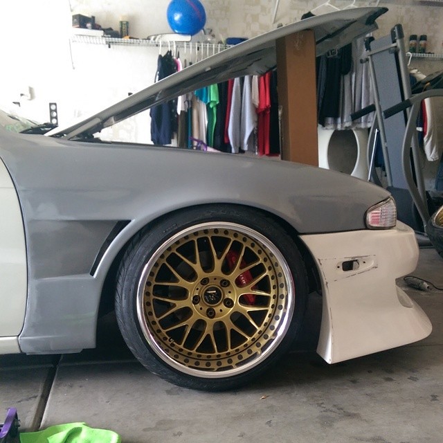

I forgot to take pics when I got the kit and the fenders, so sorry! I wanted a clean look so I decided to go with the Chargespeed 50mm rear fenders and Origin 20mm front fenders. I had my friend/fabricator chop the rear fenders and build me a bash bar for the front bumper that would work with the zenki blinkers.
https://farm1.staticflickr.com/604/2...87e0e670_z.jpg
https://farm1.staticflickr.com/586/2...0ccae49b_z.jpg

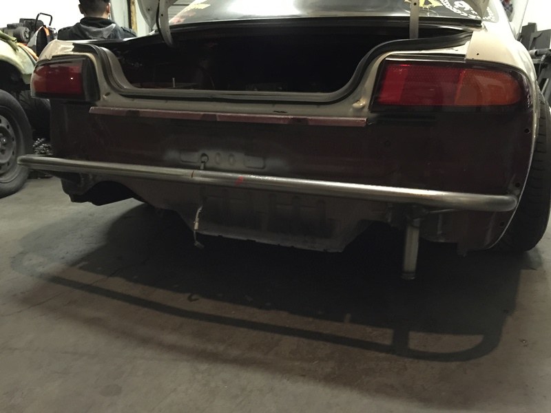

Ended up fitting the rear bumper, as well, and closed up the gap between the tires and fenders.
https://farm6.staticflickr.com/5811/...a7cd150d_z.jpg

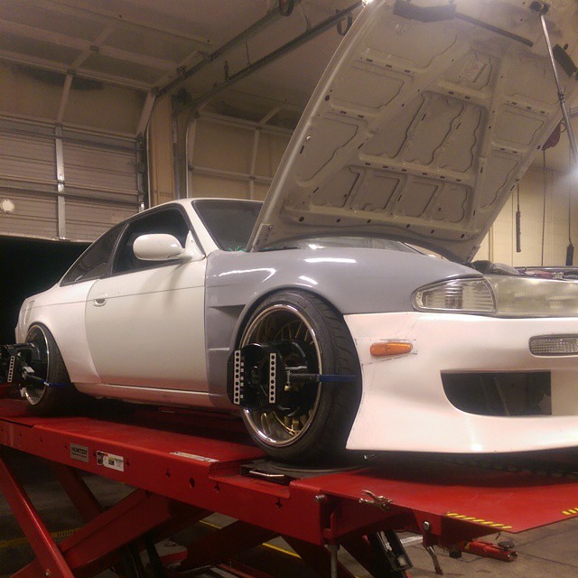

Like every good boy does, I went and got an alignment so I wouldn’t burn through my new tires at a ridiculous rate.
https://farm6.staticflickr.com/5804/...41e46925_z.jpg

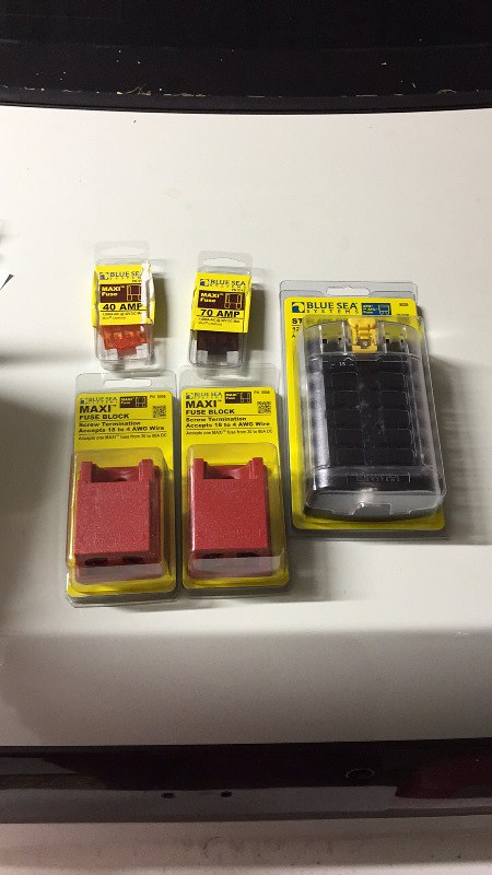

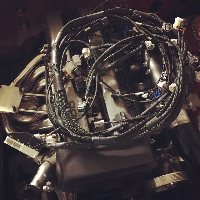

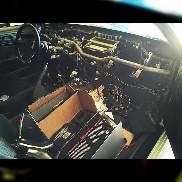

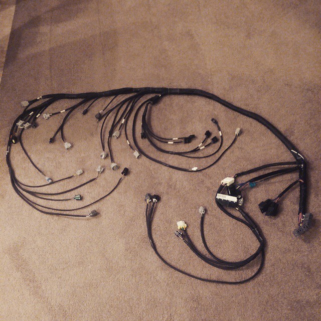

Somewhere along this build me and my good friend picked up a sponsorship from Wiring Specialties if we agreed to help them get the word out about their company and build quality cars to represent their product. Obviously this required no thought on our part and we took the deal. In January 2015 Wiring Specialties delivered on their promise and sent me one of their first completed 1JZ Pro harnesses. This thing is so nice I can’t even describe it. Thank you so much to Yury and the whole team at WS, the level of support that they have given us so far has been so good. I couldn’t have asked for a better group of people to be teamed up with.
https://farm6.staticflickr.com/5690/...d5ea5d73_z.jpg

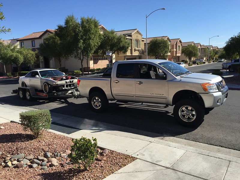

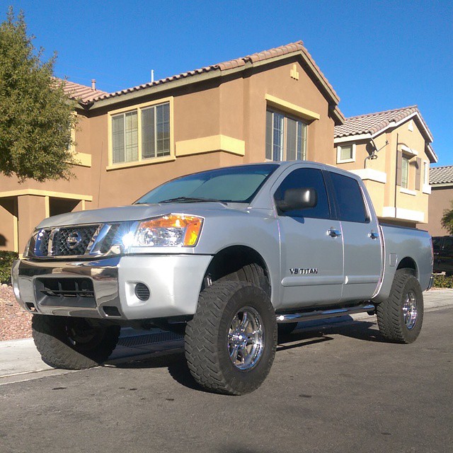

Several days after receiving the wiring harness I picked up a new DD. Obviously a truck is the worst DD you could ever have, but the convenience of having a vehicle that you can load up the bed or use to tow other vehicles far outweighs the gas mileage issues.

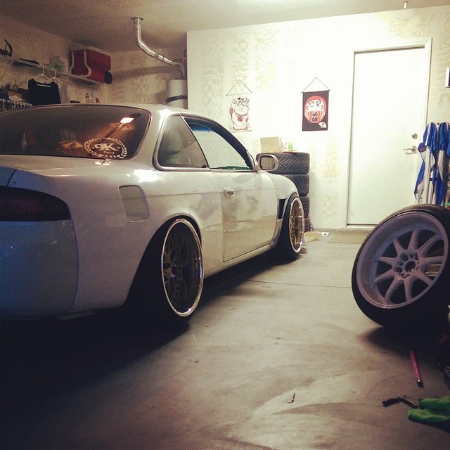

https://farm1.staticflickr.com/779/2...69a32cd0_z.jpg
Now that I had a truck it was time to get some things done with this build. It was the end of January 2015 and I found a buyer for the KA24. I bought an engine hoist and pulled the motor by myself in two days after work. It really wasn’t all that bad by myself; I have pulled so many SR’s I can’t even remember the count.

With the KA motor out of the car and sold it was time to get some more fabrication work done. I loaded the whip onto the trailer and took it down to my friend’s shop.
https://farm1.staticflickr.com/772/2...68a3b33c_c.jpg
https://farm1.staticflickr.com/708/2...cd31a7f1_c.jpg
While the car was at the shop, I spent more money on more parts. I ended up purchasing a set of front and rear drop knuckles from GKtech. I really wanted a low car but I’m not too fond of my suspension geometry being all messed up from being too low. I’m hoping this purchase will prevent any future issues from arising and I hope my car will handle amazingly once they are installed.
https://farm6.staticflickr.com/5644/...98a6d82f_z.jpg
https://farm6.staticflickr.com/5783/...a82499f5_z.jpg

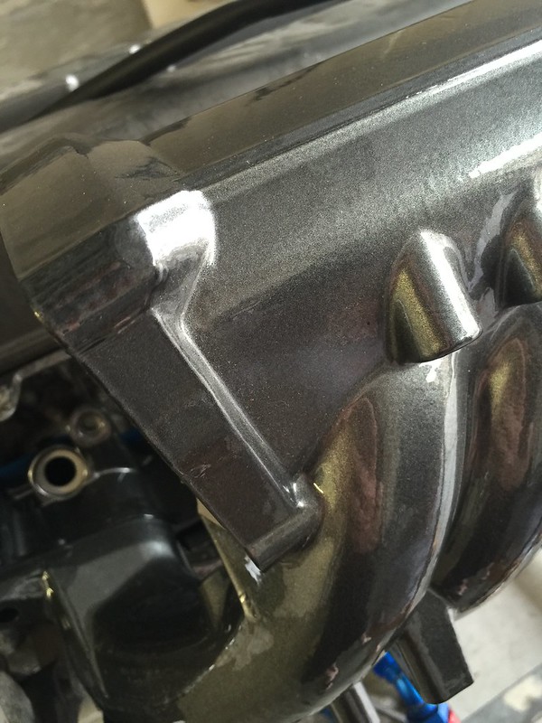

Took the intake manifold and fuel rail runners in to get powder coated. It turned out really well IMO. The color is called Slate Gray Metallic
https://farm1.staticflickr.com/735/2...0d5102fd_c.jpg
https://farm6.staticflickr.com/5719/...68c8aa5c_c.jpg

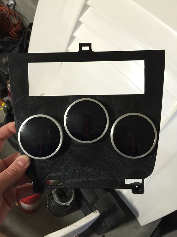

Found a guy on eBay that was 3D printing gauge panels to replace the S14 radio surround. He was only making them for 52mm gauges but I contacted him to see if he could make me a panel to fit my 60mm Defi’s and he did. SCORE!!!
https://farm1.staticflickr.com/658/2...29420256_c.jpg

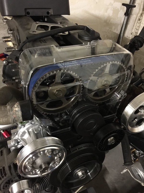

I also picked up a clear cam cover because I thought it was neat. Not sure if I will use it or not. Maybe swap back and forth between this and the stock one???

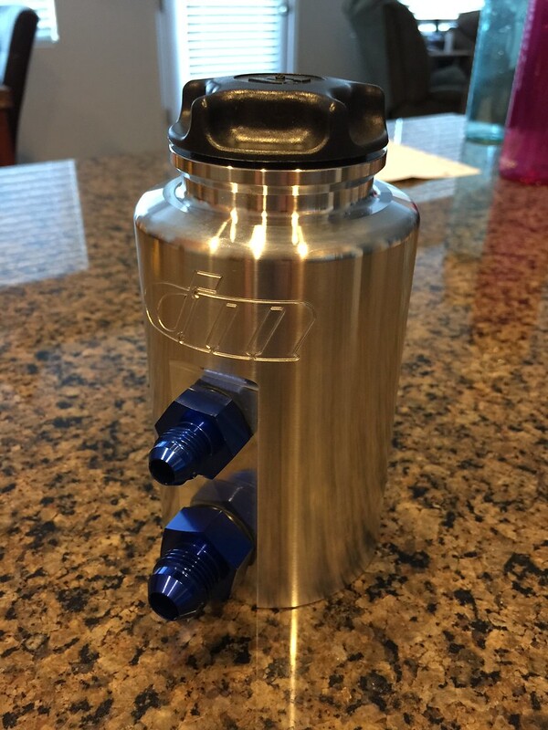

I was still waiting on a backordered Beech Performance Power Steering reservoir from Driftmotion (from a second parts order that I had placed) so I contacted them. They said they had no ETA on when Beech was going to be producing more reservoirs so they sent me one of their in house DM brand reservoirs that hadn’t even been released yet. So much nicer than the Beech unit IMO.

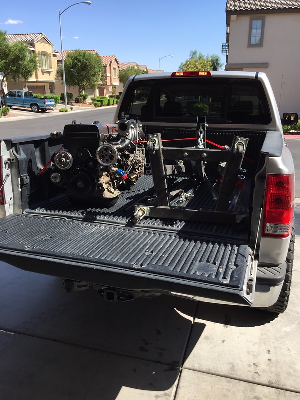

It is now May 2015 and my fabricator said that he was ready for me to bring the motor down. I picked a hell of a nice day to go. I loaded everything up and took it down to his shop to drop it off.
https://farm1.staticflickr.com/589/2...d1b32493_z.jpg
https://farm6.staticflickr.com/5701/...64b04cff_c.jpg

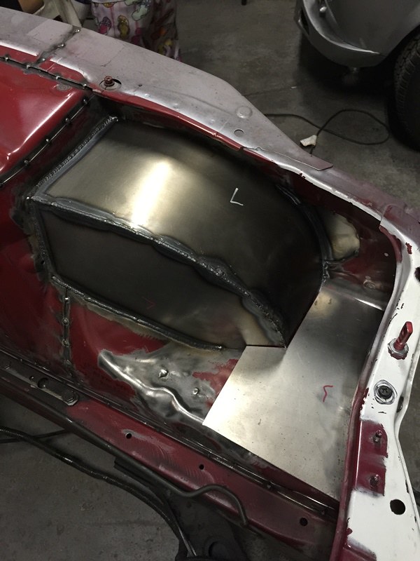

This was my first time getting to see any of the fab work and I was really impressed, as I usually am with Jesse’s work. Here are some shots of the tubs in progress.
https://farm1.staticflickr.com/571/2...b38c17fc_c.jpg
https://farm6.staticflickr.com/5813/...2b87e183_c.jpg
https://farm1.staticflickr.com/574/2...5ae5a9ed_c.jpg

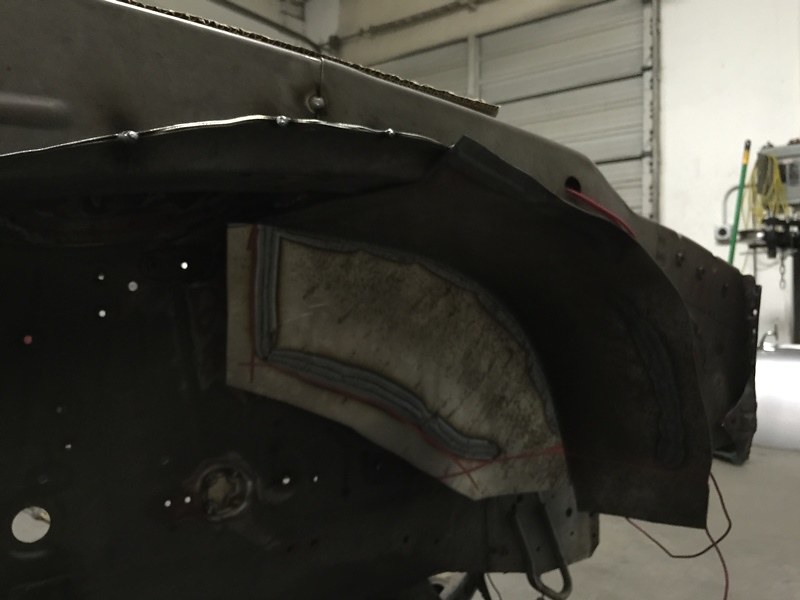

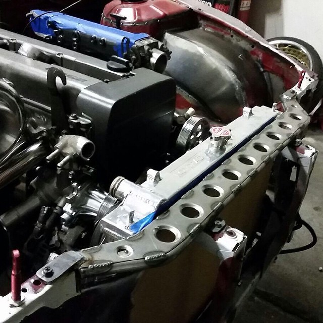

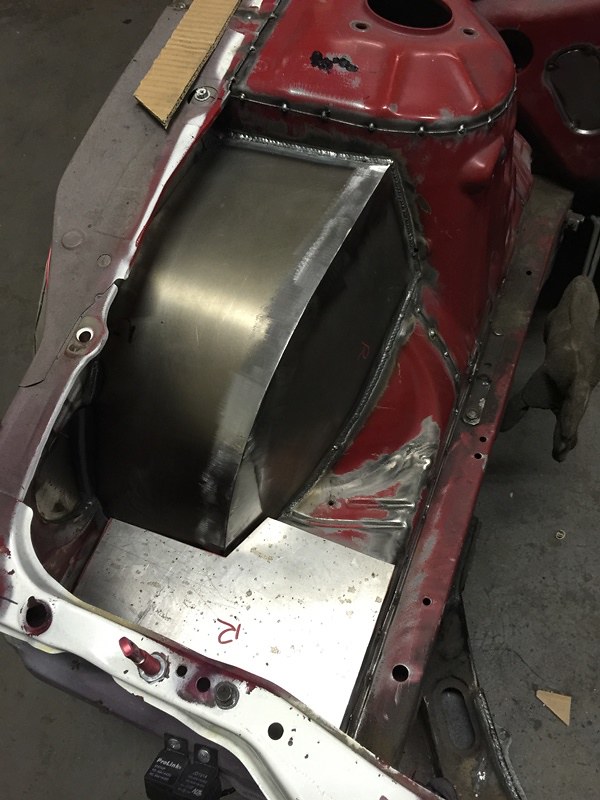

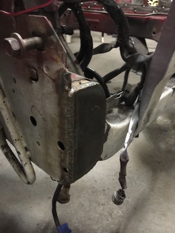

Among other things, I had him stitch weld the engine bay, build a rear bash bar with a jack point, and chop off the ends of the frame rails and box them in to make clearance for the intercooler.
https://farm1.staticflickr.com/713/2...60c71500_c.jpg
https://farm6.staticflickr.com/5790/...53f22750_c.jpg

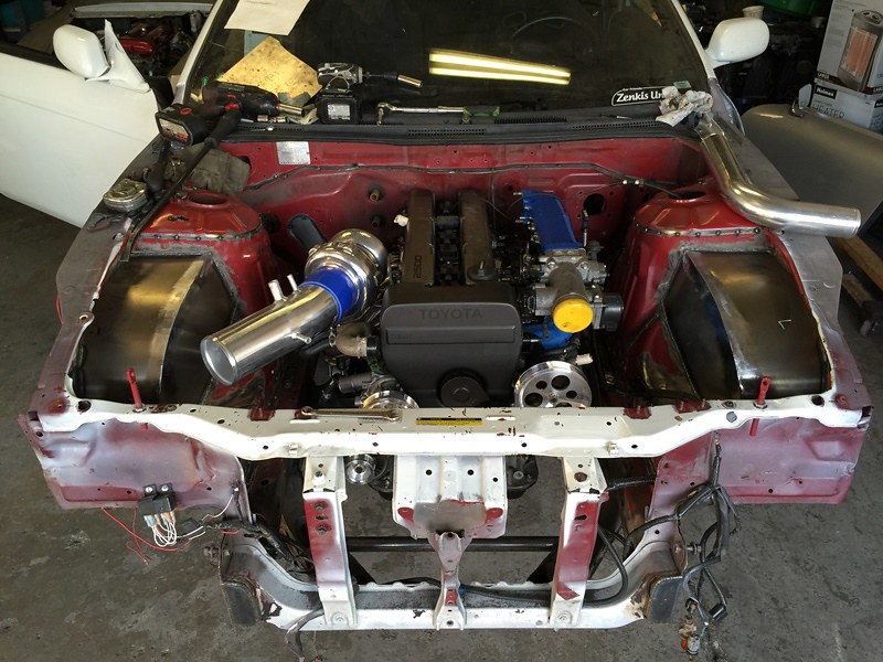

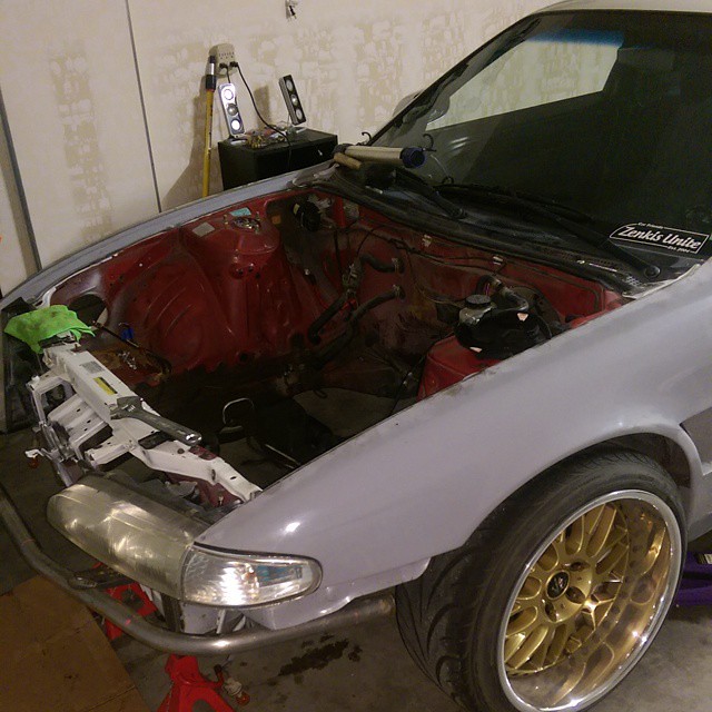

We dropped in the motor and I left everything with Jesse to finish up what we could at this point. With the Freed Engineering mount kit and Cusco solid motor mounts the engine sat perfectly. There was more than enough room in the transmission tunnel for me to drop the motor in and not have to bang anything with a hammer.
https://farm6.staticflickr.com/5620/...b52ee485_c.jpg
https://farm1.staticflickr.com/664/2...43ab971d_c.jpg
The next time I checked in with him the removable core support was completed, the throttle body had been chopped, the water neck was also modified. Here is an in progress shot that I took when I went back to Jesse’s shop. Everything on the core support is removable to make taking the engine out much easier than it normally would be. The throttle body had the traction control removed and the water neck was modified to work with the KA Koyo radiator that I already had.

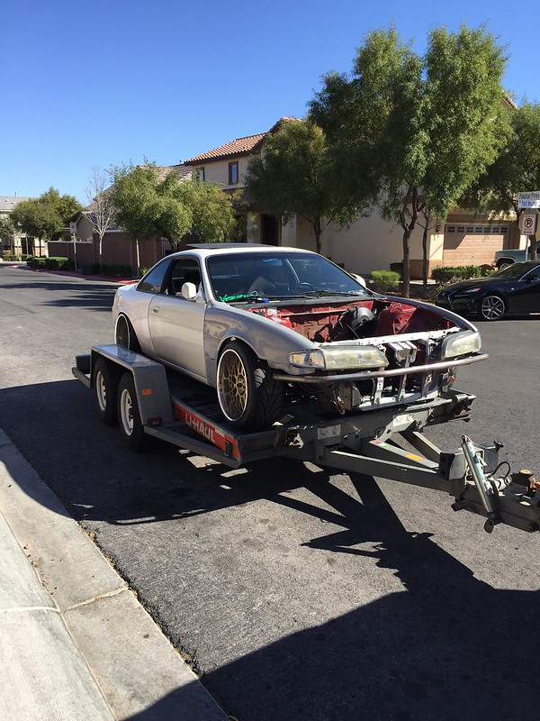

A few days later I got to pick up the car and get it back to the garage. I wasn’t ready to install the engine harness, but I wanted to take a picture of the first time the harness and motor have actually met….
https://farm6.staticflickr.com/5829/...446975f8_z.jpg

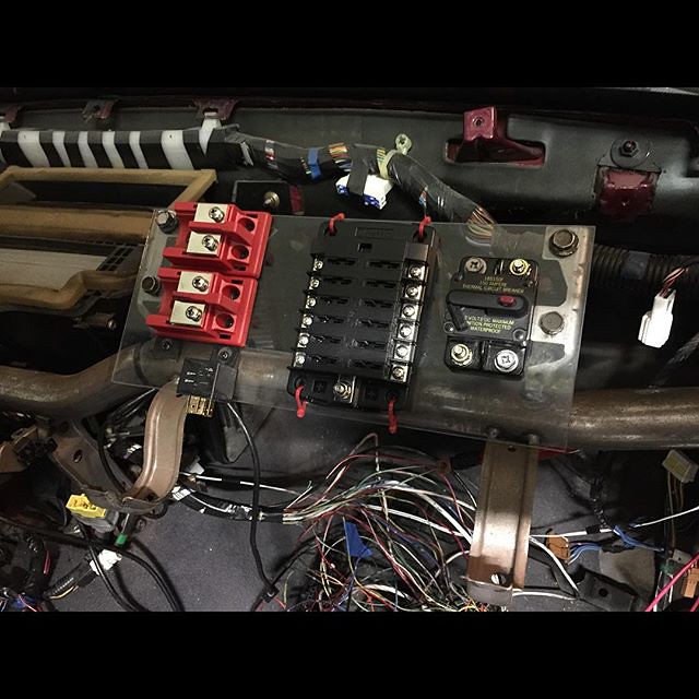

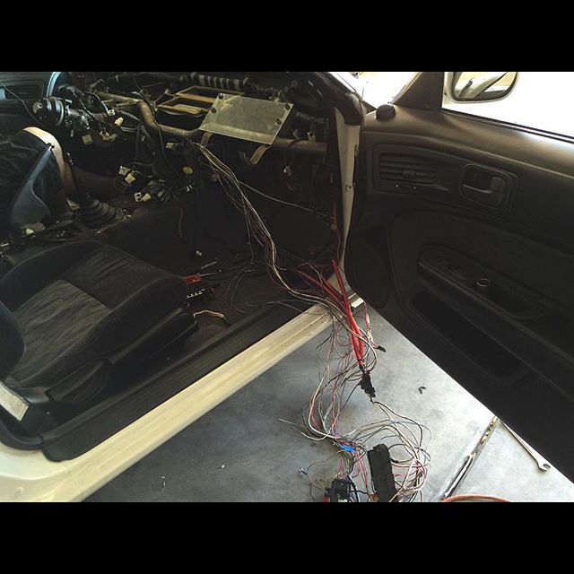

The interior in the car is still out so it was time to get to work on finishing up the wire tuck that one of my friends had done for me. I bought some fuse blocks and started to get to work. I’m no master of wiring, but the little amount of crap that my boy Ross had left for me was simple enough that I could clean it up.
https://farm6.staticflickr.com/5697/...2fe663ef_c.jpg
You can see what’s left of the original fuse box on the floor board.
https://farm6.staticflickr.com/5622/...0db9e88d_z.jpg
I want to cut out the rest of the slack so I straightened everything out as much as I could and got to labeling.
https://farm1.staticflickr.com/685/2...7396ce23_z.jpg
The zipties are temporary, but this is what me and my homie Eric came up with. It’s not fancy but I think it will get the job done. I’m checking into some things though and this may not be my final setup.

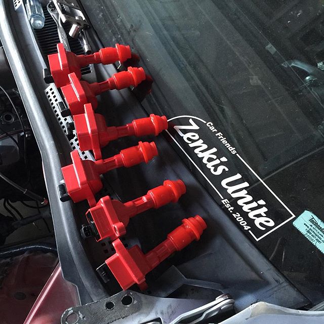

I cleaned up the SuperSpark coilpacks that I bought and then realized that I need to go buy some new screws before I throw them on the motor.
https://farm1.staticflickr.com/719/2...c5929e57_z.jpg
I got some time to fit the side skirts as well and I have to say that the fit is pretty good right from Origin, but there are some areas that need to be trimmed so I won’t be leaving these on for now.
https://farm1.staticflickr.com/651/2...8aeb0248_c.jpg

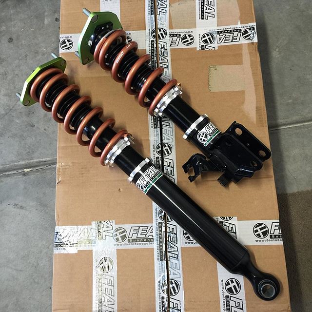

The end of the month came and the Street Driven Tour passed through the city. I contacted Odi from Feal Suspension to see if he could build me a custom set of coilovers and bring them to the Street Driven Tour to save me money on shipping. He built them, brought them, and they are REALLY nice.
It’s a Feal 441 drift setup with 14kg Swift springs in front and 6kg Swift springs in the rear. When they build coilovers for you they valve them according to the spring rates that you asked for in your build. This was the main reason I went with their suspension; I can’t wait to drive on these things.
https://farm1.staticflickr.com/674/2...8c1f3c71_z.jpg
https://farm1.staticflickr.com/578/2...de5f8c87_z.jpg

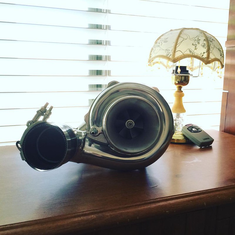

That’s all I have right now, so here is a picture of my turbo sunbathing. Excuse the extremely ugly ass lamp…I’m not even sure why we still have that.

I'm interested in seeing more on that removable core support. Looked amazing. I love seeing clean fab work. Makes me jealous of all those guys who can do things I have not yet had the pleasure to try.
I'll be getting some more pics of that next time I remove the motor. I have only tried welding once, so I had to leave this project up to my friend. I want to learn to weld eventually but haven't had the time to do so.

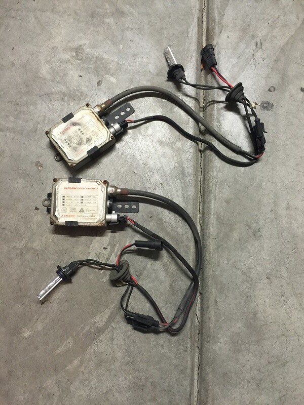

Headlamp bulb on the truck went out, so I ripped out this shitty PnP HID kit that came with the truck and threw in some Sylvania bulbs.

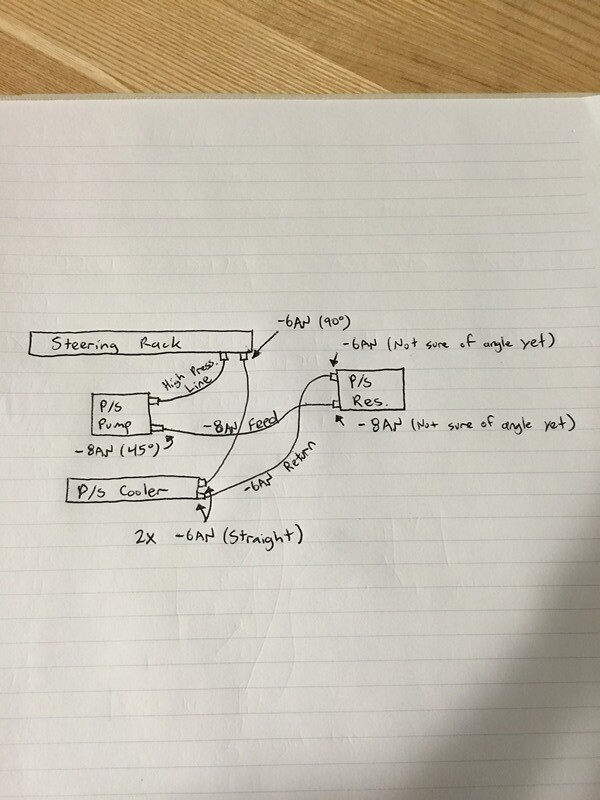

What are all of your thoughts on AN fitting colors?
I want to do my power steering system in black braided hose and nickel plated fittings. The oil cooler already has steel braided hose and blue/red fittings. I was thinking about doing the valve cover and intake hoses with black braided hose and blue/red fittings.
Do you think it would look weird having a combination of two different colored fittings?
Here is how I planned my P/S system (will be using 90 degree fittings on reservoir):
https://farm1.staticflickr.com/761/2...e59616b5_b.jpg
