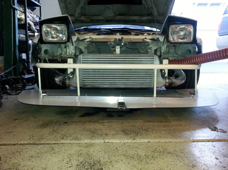

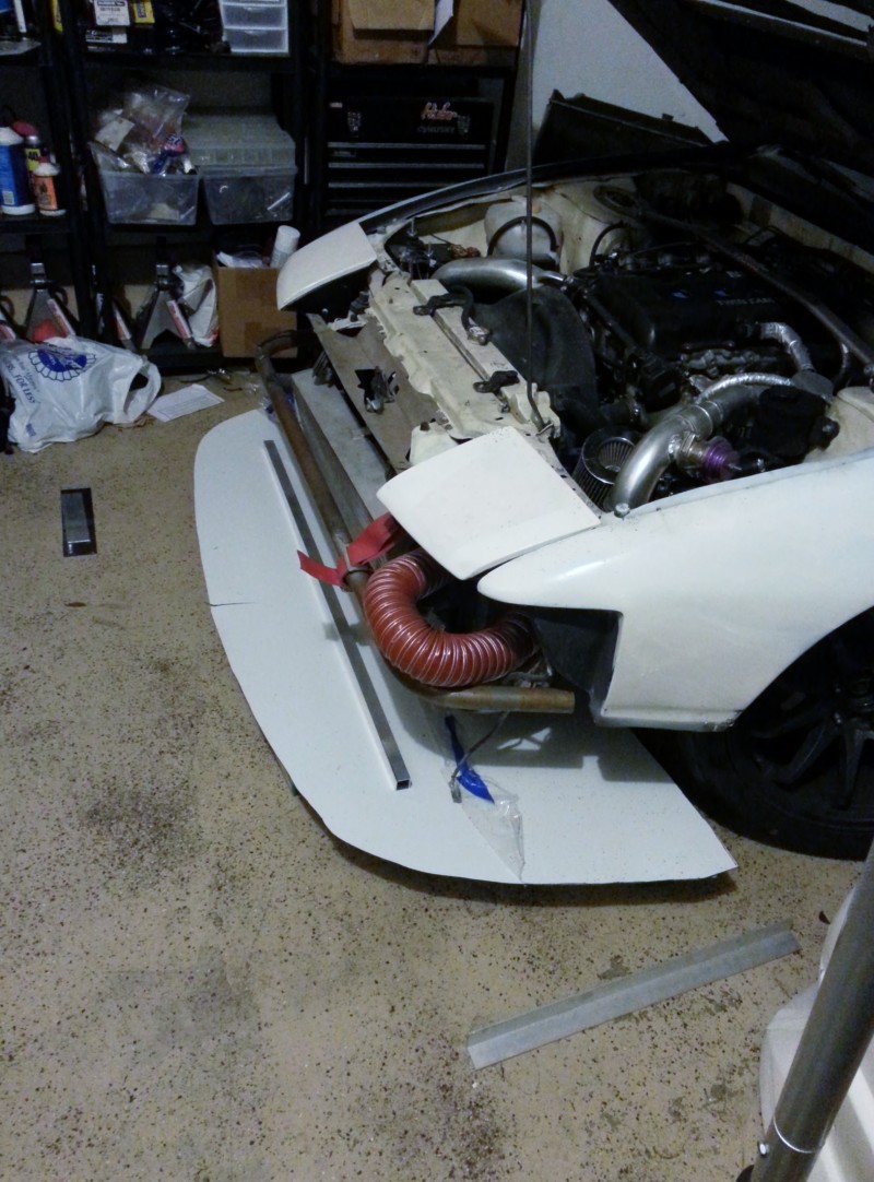

worked on F/R suspension

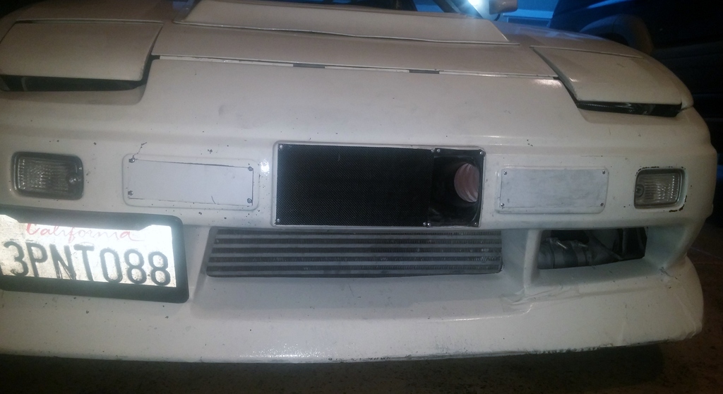

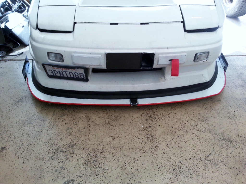

Added front mount intercooler/ front bumper
https://s3.amazonaws.com/static.fixp...pscbfrlttx.jpg

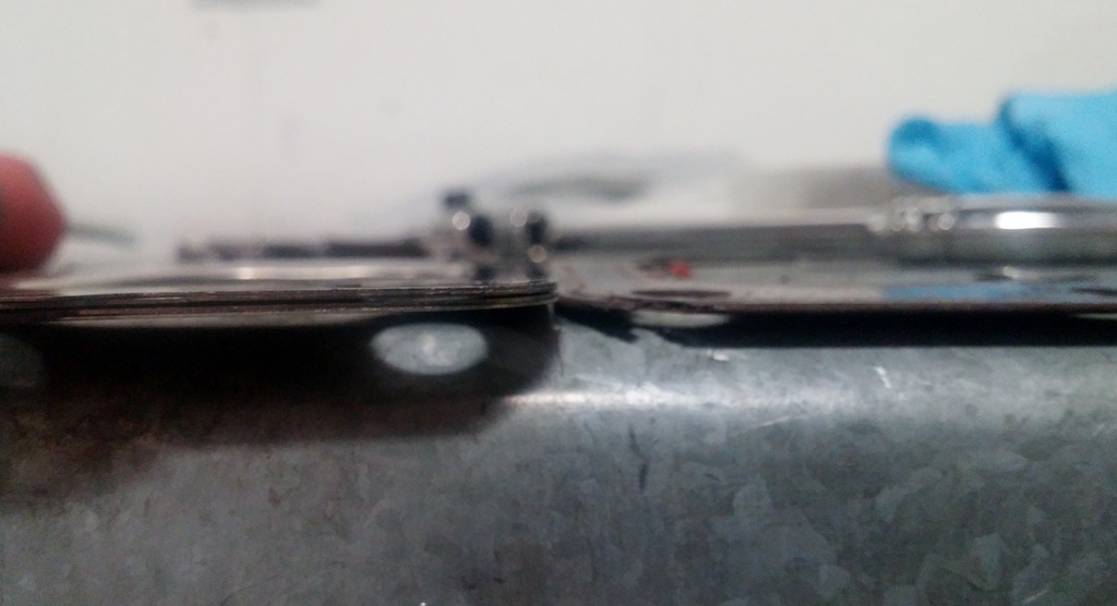

Found out stock head gasket was bad.

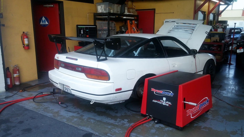

upgraded to t28/ 555cc/ JWT Ecu

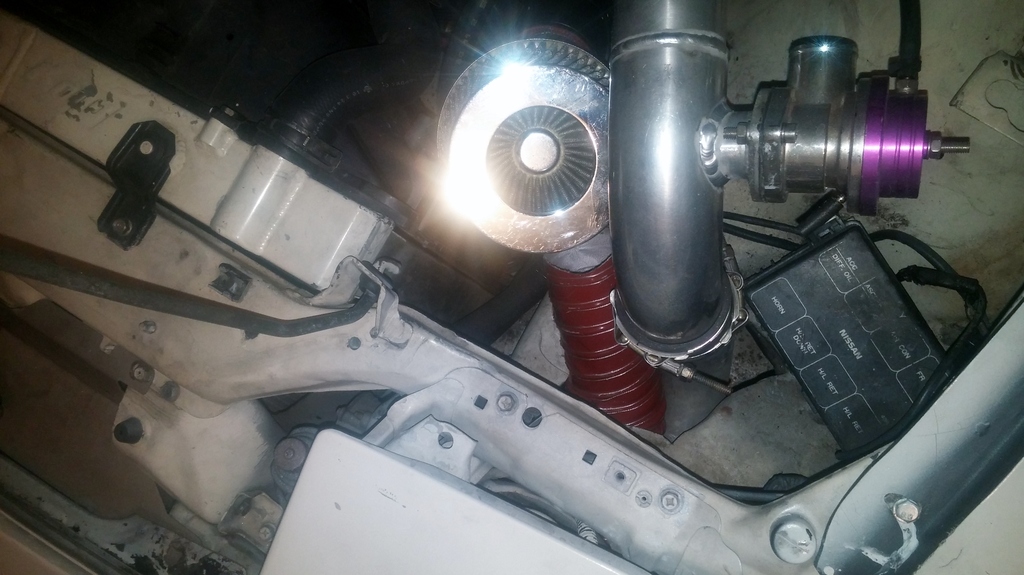

https://s3.amazonaws.com/static.fixp...psj0hddqik.jpg

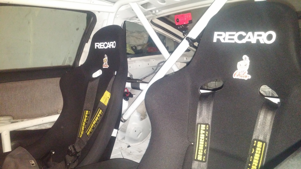

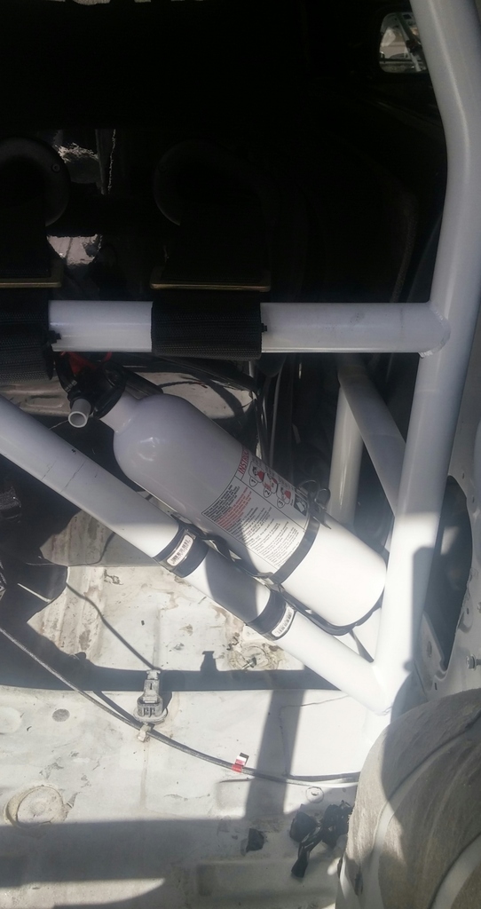

Along with t28, I wanted to keep myself safe at the track. Notice I have a bat dog with laser eyes. very rare breed.
https://s3.amazonaws.com/static.fixp...pspjlibbcw.jpg

Keeping earth greener : magnaflow 100 cell
https://s3.amazonaws.com/static.fixp...ps4nkuckmf.jpg
https://s3.amazonaws.com/static.fixp...psw6mxwq7r.jpg
https://s3.amazonaws.com/static.fixp...pszdmielq2.jpg

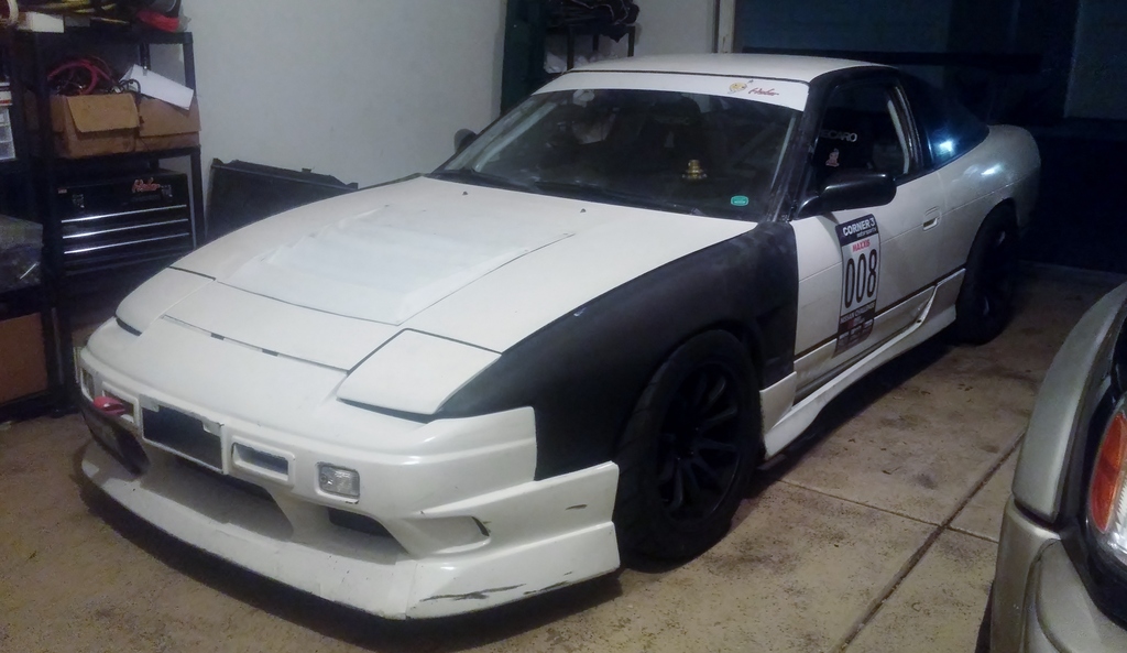

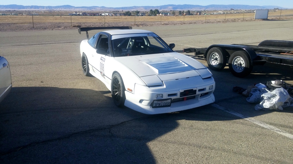

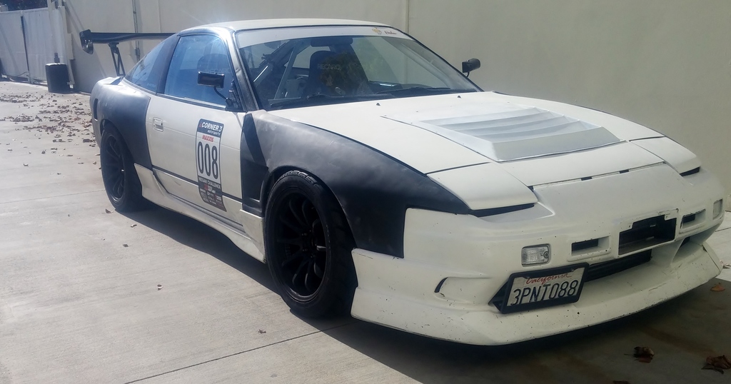

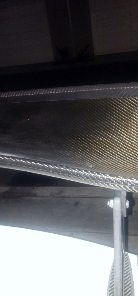

Vented hood. Apr spoiler
https://s3.amazonaws.com/static.fixp...psiuhdlj2g.jpg
http://www.youtube.com/watch?v=uP6DMlzvWs4

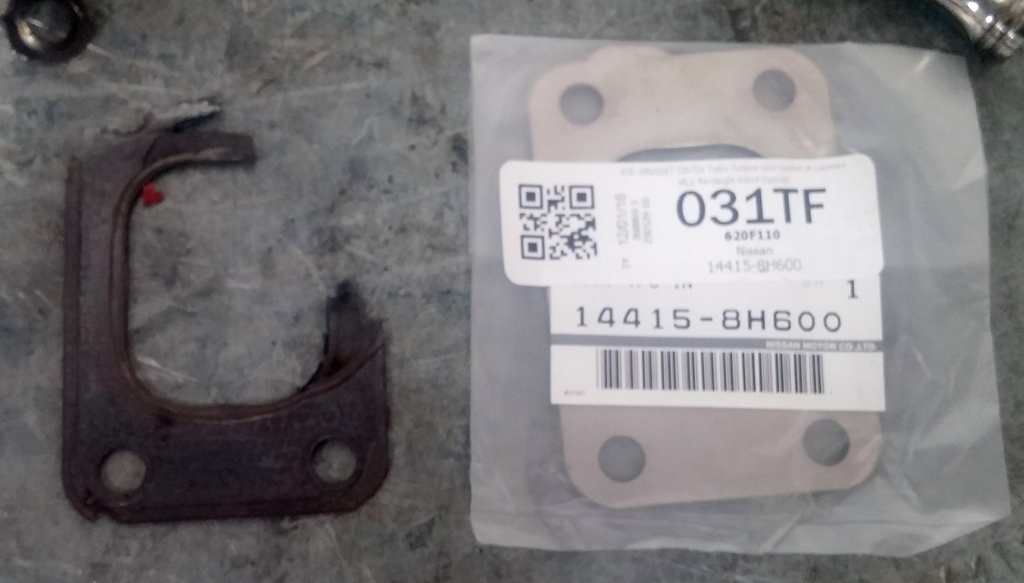

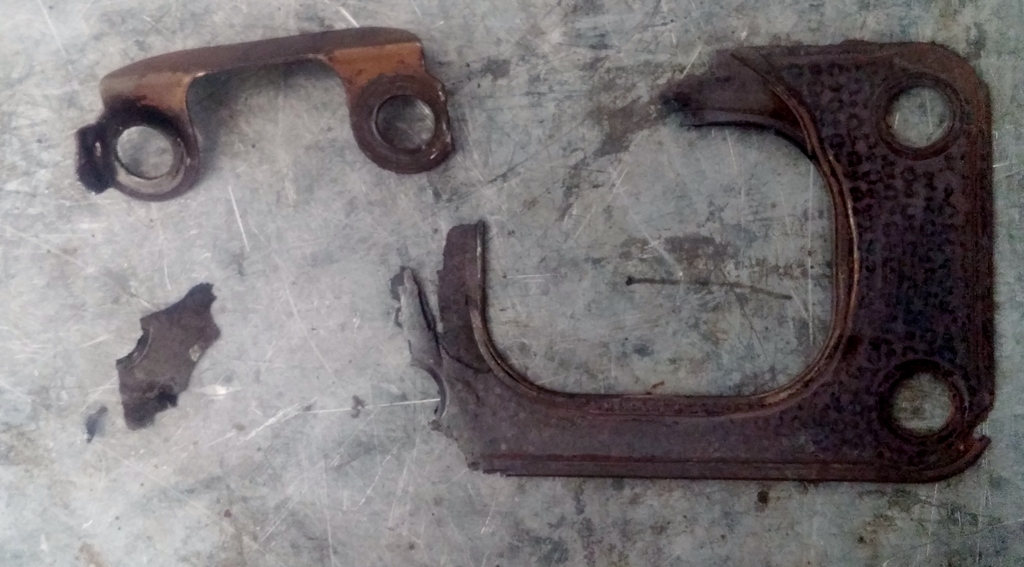

three downpipe bolts decided to shoot out after continuous heating/cooling/vibration. had to tow the car home :-/
http://www.youtube.com/watch?v=UkdVeXS2RWw

Are the door bars constrictive? I noticed that you maintained complete door panels so that puts the door bars close to your body. Does it bother you at all?
I want to keep my door panels too and am debating whether to do it like you did or not.
I see the complexity in what you are considering. my cage is actually a Enjuku kit for s13. So money was an issue affecting my choice. If money was not a factor, I would have definitely space it away. Plus, at the time, My plan was to run full interior to run in a lower group but I just got lazy and decided not to put the interior back.

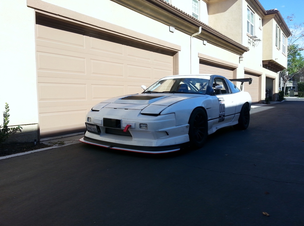

2014
https://s3.amazonaws.com/static.fixp...psgjbr8c6i.jpg
2016

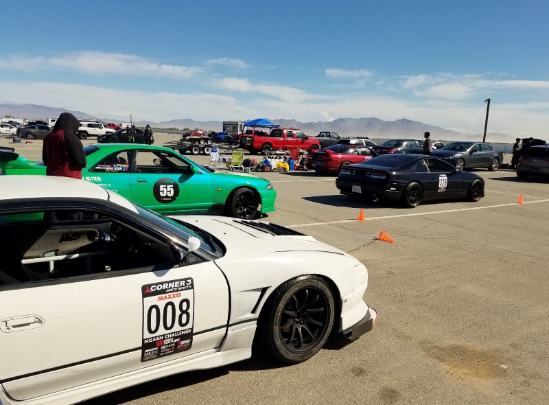

Getting ready for ACS Roval (California Speedway) 8/13/2016
https://s3.amazonaws.com/static.fixp...psnyy2mm9h.jpg

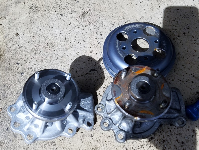

Changed water pump pulley
https://s3.amazonaws.com/static.fixp...psrmdxxbbj.jpg

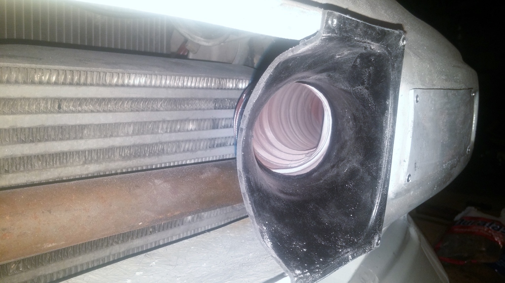

Added stock oil separator to see how much better it is. If this doesn't do much, I'm gonna have to modify the valve cover
https://s3.amazonaws.com/static.fixp...psfbbljcbp.jpg

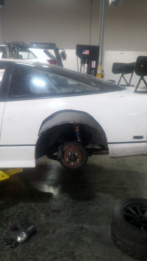

Added whiteline sway bar on the front.
When I installed both whiteline fr/rr, car oversteered just as before.
I ended up with 27mm front and 15mm on the rear. Hopefully this setup works better.

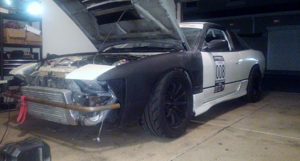

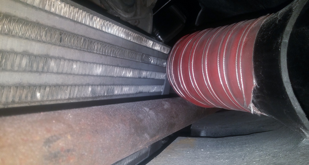

battery1882 08-18-2016 04:08 PM
I went back out to ACS only to find more trouble.
https://s3.amazonaws.com/static.fixp...ps4wxx76n8.jpg
First session after warm up lap, my intercooler hose blew. No big deal, just clamp it down tighter and go out on the next session.
Session 2: as I finish my lap 1, car started to lose power. I look at the temp gauge and it was pegged hot. I try to pull over to a safe area but car eventully died and never started back up.:facepalm:
Looking back, I think my timing was set wrong (on retard) which caused my engine to run hot. Once it got hot and built pressure, one of my radiator hose clamp was not fully tight as all of the coolant leaked out.
I verified this by pressurizing coolant system.
compression on cylinders are 90-90-90-20. probably seized the piston as well.
It's all my fault. having a warning gauge would have been nice in retrospect.
I'm gonna try to figure out where to go from here. maybe another SR or VQ.
Definitely planning on keeping the engine stock as possible.

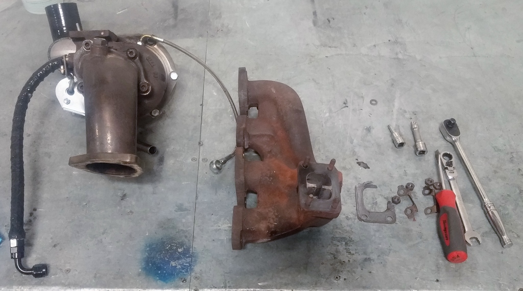

Been busy with traveling and some personal issues..
https://s3.amazonaws.com/static.fixp...psz9khsd65.jpg
Managed to pull the motor out
https://s3.amazonaws.com/static.fixp...psxwkpares.jpg
Found this! looks like it was resting against the turbo. Perhaps, that's the reason for overheating...
https://s3.amazonaws.com/static.fixp...psklz7mkcn.jpg

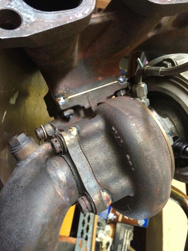

Mounted gt2871r
https://s3.amazonaws.com/static.fixp...psjtvcreqz.jpg
Safety wired the elbow
https://s3.amazonaws.com/static.fixp...pscjz5d57d.jpg

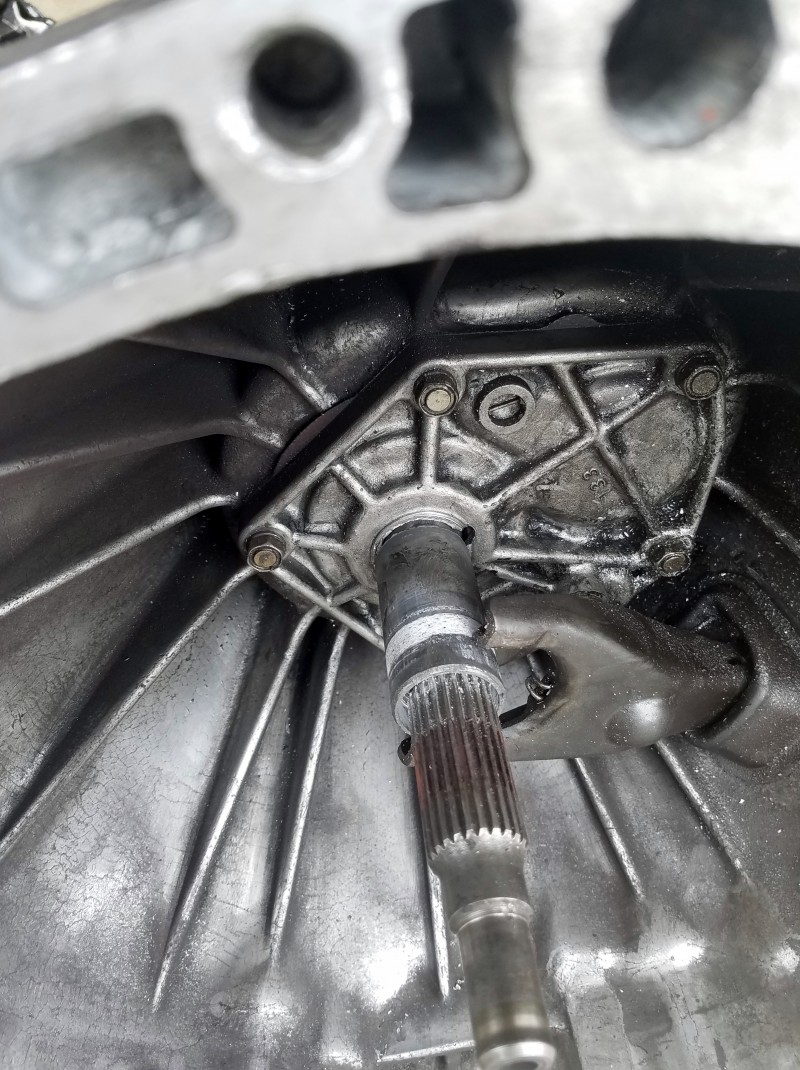

Changed trans front seal along with couple gaskets
https://s3.amazonaws.com/static.fixp...psja2bovjh.jpg

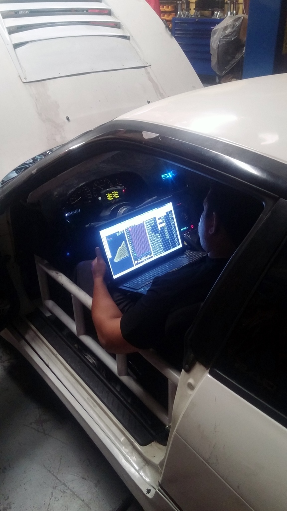

battery1882 10-10-2016 11:48 AM

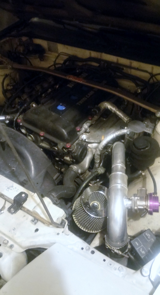

https://s3.amazonaws.com/static.fixp...psmipdcyri.jpg
Finally started the car back up.
https://s3.amazonaws.com/static.fixp...ps8x28tv1e.jpg
Had a welder weld in some bungs and intercooler pipe
https://s3.amazonaws.com/static.fixp...psvydzcgdt.jpg
https://s3.amazonaws.com/static.fixp...psudbpudsj.jpg
https://s3.amazonaws.com/static.fixp...pslor0nhi7.jpg
https://s3.amazonaws.com/static.fixp...psffob40dw.jpg
compression were all good
some more minor work and it will be ready for shakedown!

Mounted oil catch can and moved the intake down low.
https://s3.amazonaws.com/static.fixp...ps0thgxmql.jpg

aem ems mounted and cleaned up some wiring. Really need to paint the floor..
https://s3.amazonaws.com/static.fixp...psbhfhmasl.jpg
https://s3.amazonaws.com/static.fixp...psoglvoe1h.jpg

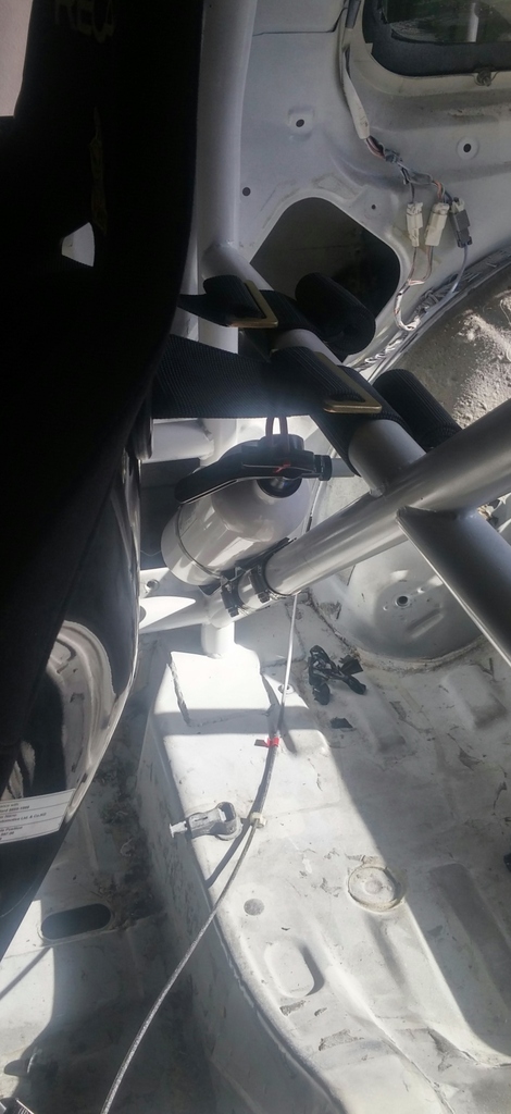

bought a 2.5 lb fire extinguisher, hopefully I won't use it.
https://s3.amazonaws.com/static.fixp...psmsgrbumg.mp4

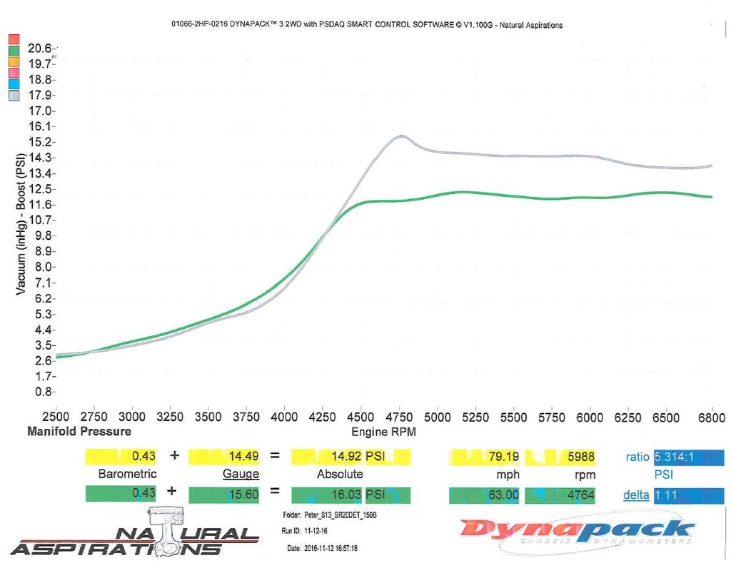

battery1882 11-14-2016 09:44 AM

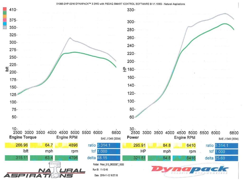

Had the car dynoed at Natural Aspirations over the weekend.
https://s3.amazonaws.com/static.fixp...pszmblj0dp.jpg
https://s3.amazonaws.com/static.fixp...pshyelgotw.jpg
https://s3.amazonaws.com/static.fixp...psyjonrnpx.jpg
Happy with the dyno result. especially the torque. (Please read below edit)
keep in mind that my car still has a cat so Chris had to pull a lot of timing out. There was too much back pressure.
https://s3.amazonaws.com/static.fixp...psoxwf0e0v.jpg
https://s3.amazonaws.com/static.fixp...psvxeh0vbf.jpg
Mounted a new camera mount I got from ebay lol. super cheap! Can't believe I was using more expensive one that did the worse job.. this one is sturdy.
https://s3.amazonaws.com/static.fixp...pspbpxck6i.jpg
Edit (4/11/2017) :
I've been battling high exhaust temp and I have opened my engine after running this tune for a few track days.
Bad news : piston edge melted from excessive temp.
Chris @ Natural Aspirations is a nice guy and he is willing to help, but I would not go back to him for another tune.

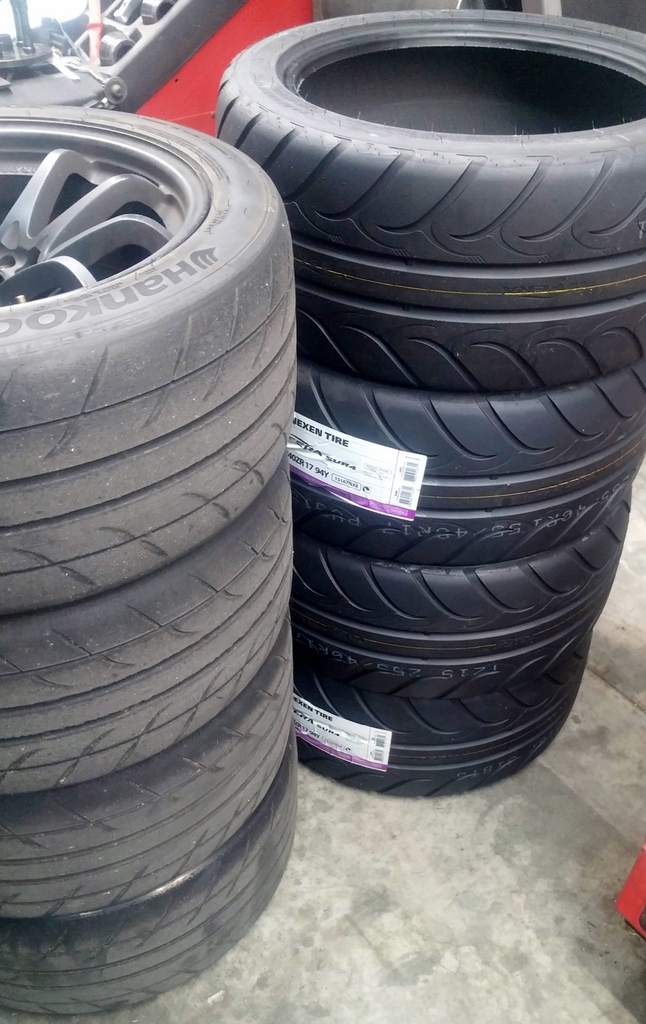

Update from SOW CCW event
https://s3.amazonaws.com/static.fixp...psngzvfa3v.jpg
This time I went with Nexen SUR4 because I've never tried them and heard many good things. They handled great and did not get greasy as quickly as the rs3s.
https://s3.amazonaws.com/static.fixp...pst9jds37g.jpg
Arrived at the track and signed up for Nissan Challange.
http://www.youtube.com/watch?v=aDyVrzARztA
All of the work paid off and I had a problem-free day (almost) which is always nice.
Ended up beating my M3 time and also won the nissan challenge class 2. :)

It's funny that I'm quoting myself.. Well the manifold to turbo bolts, as well as, turbo to elbow bolts all backed out a little (heard from exhaust leak). This was going to be a tough battle against the heat and vibration.
https://s3.amazonaws.com/static.fixp...ps9lurbtzo.jpg
https://s3.amazonaws.com/static.fixp...sb0iflqng.jpeg
So I decided to have the flanges welded. I wasn't comfortable with welding cast iron to cast steel, so heliarc_hustler handled it!
https://s3.amazonaws.com/static.fixp...pslmzsj4zo.jpg
https://s3.amazonaws.com/static.fixp...ps2ypmhvtu.jpg
https://s3.amazonaws.com/static.fixp...ps3c5abnhf.jpg
Also changed out the junk gasket to nissan 4 ply from s14 SR.
https://s3.amazonaws.com/static.fixp...psnwxy4r2m.jpg
https://s3.amazonaws.com/static.fixp...psvwxdos3e.jpg
https://s3.amazonaws.com/static.fixp...psu5r7bpir.jpg

TheRealSy90 12-16-2016 09:35 AM
How did the bolts that were safety wired back out?
battery1882 12-16-2016 09:45 AM
Safety wired bolts backed out tiny bit (verified by re-torquing) and obviously couldn't move from that point on.
Out of 5 bolts that are on the turbo to elbow, only 4 were safety wired, one that was not wired backed out good couple turns.
supersayianjim 12-16-2016 11:02 AM
why are the bolts popping out like that?
TheRealSy90 12-16-2016 11:15 AM
I think you might be better off running studs with nuts instead of bolts.
battery1882 12-16-2016 02:23 PM
Usually daily driving / wide open throttle for 10-20 seconds at a time doesn't really affect the bolt coming loose as much.
With this car, it's always boosting and staying at a higher temp. (around 1000-1500 degrees Fahrenheit and above 4000 rpm for 10-20 mins at a time) On top of that, I'm shaking the car left and right going through the turns. This puts a lot of stress on all of the turbo parts.
My turbo to manifold bolt loosening was actually caused by one of the broken tabs (oem locking tab) that hold the nut in place. I should have safety wired them looking back.
Thanks for the suggestion but I've welded the flanges now so it shouldn't come off. (hopefully) if it does, make sure to tell me "I told you so" :)

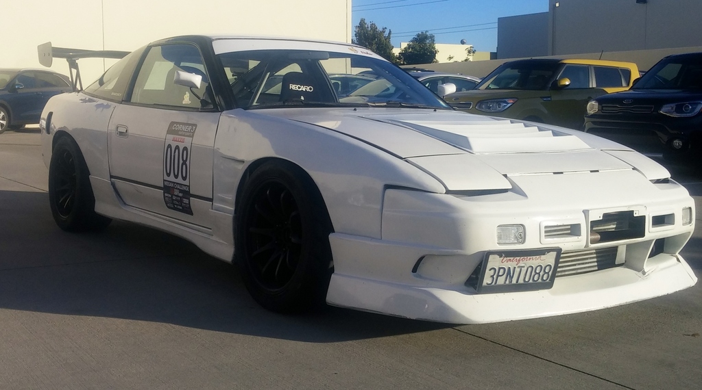

https://s3.amazonaws.com/static.fixp...psmliebmm2.jpg
https://s3.amazonaws.com/static.fixp...psrxbl7gpy.jpg
Installed overs / cheap mirrors and painted them. It was my first time painting alone with a gun; and there are alot of overruns. I'm happy it's one color :)
Prepping for laguna seca on 26th.. I hope to make it out there..

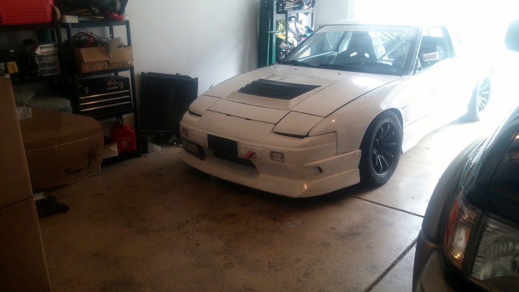

https://s3.amazonaws.com/static.fixp...pstbh187ew.jpg
went to APR and picked up a gurney flap. Hope I can tell the difference.
https://s3.amazonaws.com/static.fixp...psvajo8nnf.jpg
Also rerouted my intake as I don't think pulling dirty air from the bottom is the smartest thing.

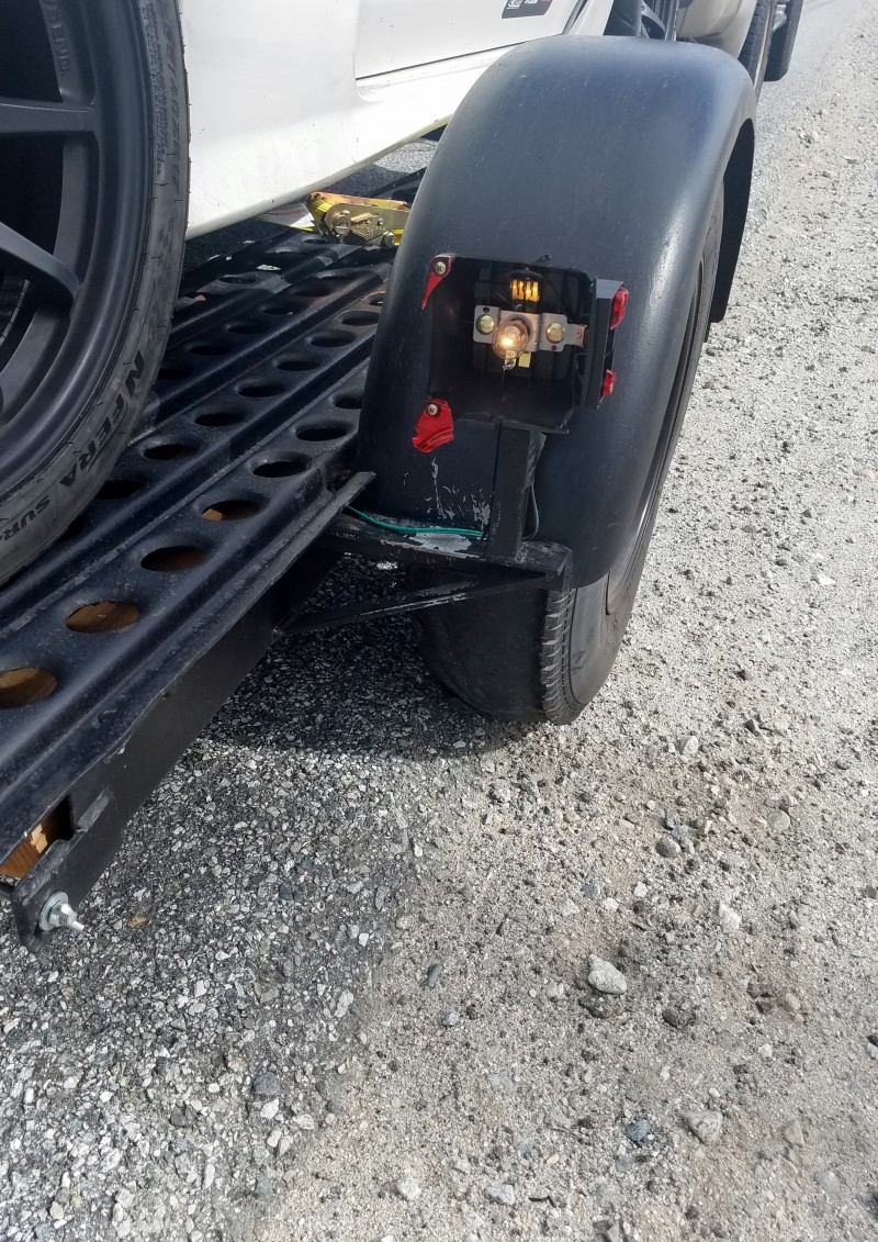

Didn't get to go to Laguna seca as the wheel bearing on my 4runner decided to give out..
It would have been nice but I guess there is always next time.
https://s3.amazonaws.com/static.fixp...psm8kjhoaf.jpg
Fixed the wheel bearing and took it off roading. Lots of fun.
https://s3.amazonaws.com/static.fixp...psdxy3gdbo.jpg

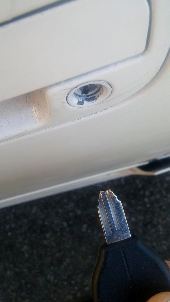

Locked the key one day and this happened lol

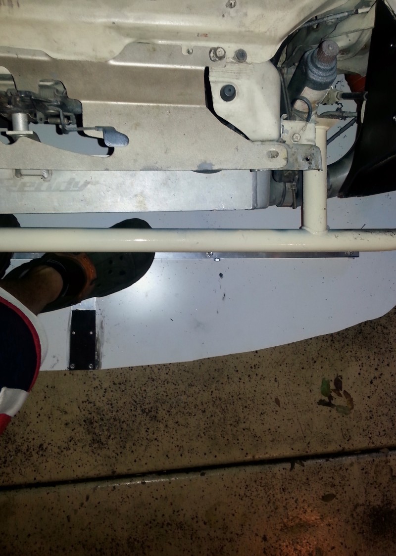

I wanted to block off unnecessary openings on the front bumper.
https://s3.amazonaws.com/static.fixp...psrwarhqbe.jpg
I used NACA duct to pull in cold air to the intake
https://s3.amazonaws.com/static.fixp...pstkglas7n.jpg
https://s3.amazonaws.com/static.fixp...psb7li8wma.jpg
Still need to build a shield around the filter.
https://s3.amazonaws.com/static.fixp...psit77bdj0.jpg
some carbon plate and duct tape to cover off rest of the area
https://s3.amazonaws.com/static.fixp...pseyymkp2f.jpg
https://s3.amazonaws.com/static.fixp...psekt8etc2.jpg

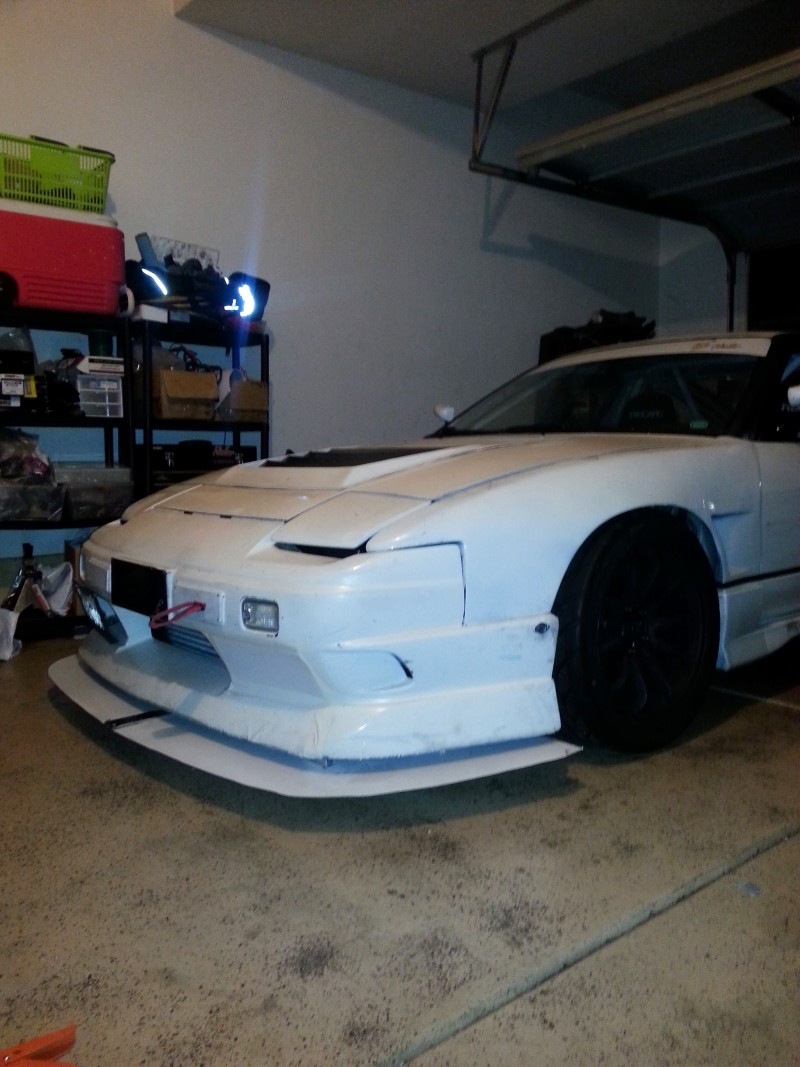

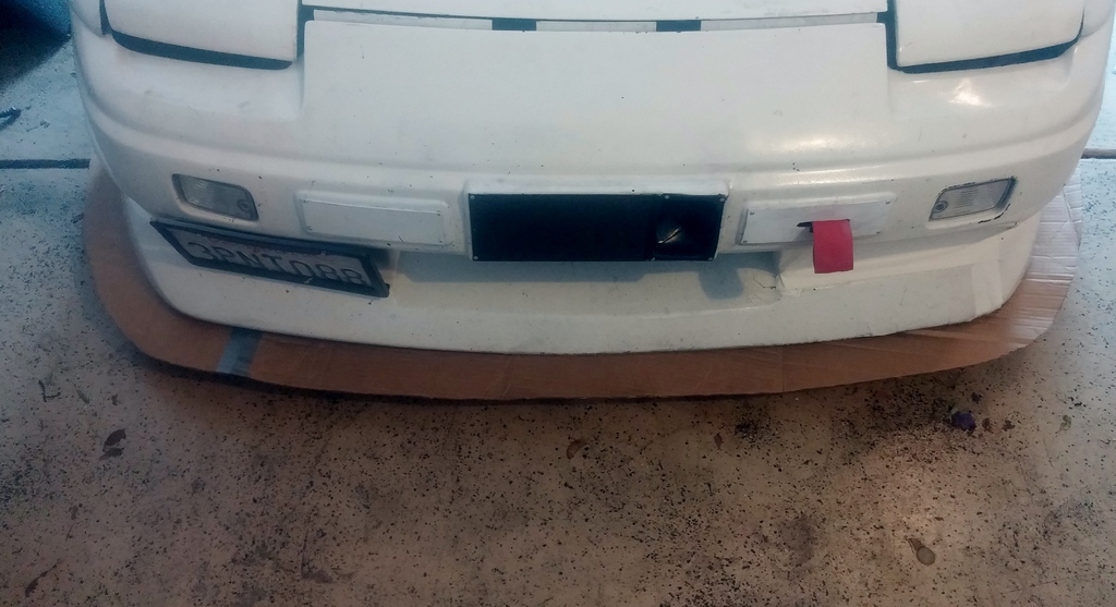

started with the splitter. Store that sells allumalite was closed so will be working on that soon.
Happy new year!
FaLKoN240 01-03-2017 10:37 AM
Originally Posted by battery1882 (Post 6151851)
http://i638.photobucket.com/albums/u...psekt8etc2.jpg
Who are you going through to get the alumilite?

Originally Posted by e1_griego (Post 6152363)
Stage 8 fasteners seemed to have kept my turbo attached for a few track days now.
The big thing is running that bracket from the downpipe to the transmission mount/crossmember and taking weight off the turbo.
The next time I have to take it apart I, too, am just going to weld the turbine housing to the manifold and call it.
YES!
Got done with the splitter :
https://image.ibb.co/dmaOHv/20170105_195659.jpg
https://image.ibb.co/j0Rfxv/20170108_182228.jpg
started with 2 stacks of 3mm aluminum composite panels. I used liquid nail to hold them together.
I used aluminum square tube to save weight on the bottom and welded some steel tubing to the bash bar.
https://image.ibb.co/kyDFVF/20170108_163301.jpg
https://image.ibb.co/myPNAF/20170108_163314.jpg
stood on it to make sure it will handle the downforce.
I tore the middle of the panel and it started spreading so I reinforced it it with aluminum plate and carbon plate on top. Maybe I can use it for gopro mount in the future.

Finally a track day!!
ACS event was cancelled due to rain..
https://image.ibb.co/cKeB4a/20170211_133658.jpg
https://image.ibb.co/nBFjPa/20170211_140343.jpg

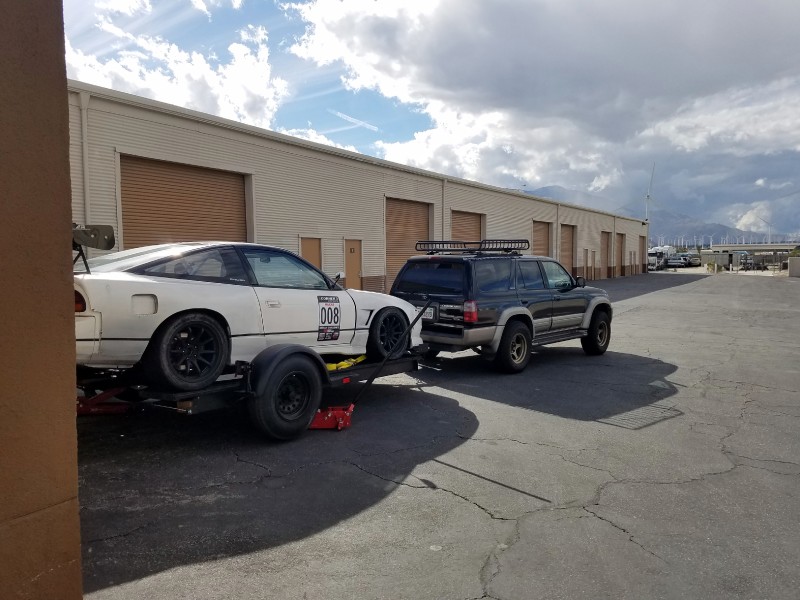

Little hiccup going to Chuckwalla. tire tread decided to chunk off. My fault for not checking the age on it. Guy that sold me the trailer said they had "new" tires. :ugh:
https://image.ibb.co/hmdhAF/20170211_171756.jpg
Spent a night at this mansion. :) it was actually really convenient and comfortable.
https://image.ibb.co/fjnW4a/20170212_111040.jpg
Love to own a GTR!
http://www.youtube.com/watch?v=4cV_kvUnxmI
I'm hanging on to 4th gear because it popped out on me a few times.
I also forgot to take my camera so was borrowing a friend's gopro. Can't really see the track on this vid but hope you enjoy it.
Overall, car gained lots of grip in the front with the splitter and has a lot more neutral steer than before. Car started getting little hot as I pushed it more. I need to work on that and swap out my tranny :-/

So I found out why the car started getting hot (highest of the day was 235degree F). I pressurized the cooling system and found puddle of water below the water pump weep hole.
It was a brand new s13 water pump so I'm not sure why it failed..
Good thing I had defi warning! it saved my engine..
https://image.ibb.co/cUEuPa/20170219_125309.jpg
S13 VS. S14/15 pump
https://image.ibb.co/fsR2AF/20170218_131746.jpg
https://image.ibb.co/h3vCAF/20170218_131753.jpg

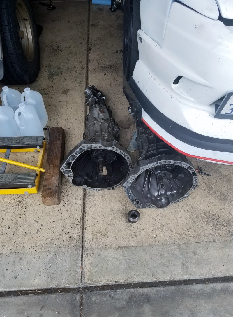

also changed out the tranny. I couldn't deal with 4th popping.
Interesting note : found the front cover cracked.. I'm guessing it's due to bad trans bearing.

Sorry forgot to answer your questions,
Cage is pre-made cage by Enjuku. I had Ted (heliarc_hustler instagram) tig weld it for me. He does great job!
My steering wheel is 330mm. (sparco 383). I personally prefer 330mm over 350mm. you can check it out at buttonwillow if you would like!

I would advise against using a S14 pump on a S13 SR20. The impellers are designed differently and the S14 pump actually flows less when used on a S13 SR20 and does cause cavitation at a much lower RPM
battery1882 02-20-2017 03:36 PM
Man.. I wish I would have asked before purchasing/installing it. :-/
I would like to know little more in detail if you could elaborate though. I would think "flows less" mean that the impellers are smaller given same rpm between s13/14 engines, wouldn't that cause less cavitation? unless there's something going on inside the block.. or if the blade design is different.well, let me know! I will change back to s13 water pump if I have to!
I do have bigger pulley so hope that it helps. I will report back after next track day!

Short of it is; S14 impellers are shorter when used on the S13 head due to the different casting between the heads. What this translate to is the impellers themselves simply do not reach far enough into the waterpump housing to have enough surface area to "pump" the water. Its like sticking half your hand out the window vs sticking all your hand out the window. Only half your hand actually gets acted on by the wind in the first scenario.
Look at them side-side. The details are not immediately apparent.
TheRealSy90 03-06-2017 02:42 PM
Yeah I honestly don't know where the misinformation came from saying that the s14 pump was better for s13 engines, I've never bought into that myself. It's better to retain a s13 pump but run an oversized water pump pulley instead to slow it down slightly.
FaLKoN240 03-06-2017 04:02 PM
I think people confuse it with the s14 water neck.
Misinformation comes from frsport.com (http://www.frsport.com/Nissan-21010-...ly_p_2218.html)
I wish I read a little more before purchasing the s14 pump.
https://image.ibb.co/kMoPqF/1112161602.jpg
I was having my car tuned over the weekend and we saw some knocking around 4-5000 rpm. We had to end the session early.
Looking back, I'm wondering if the water pump may have caused problem somewhere and brought the cylinder temperature up.. Coolant temp was fine. Regardless, I'm changing the pump back to s13 one and going over the car to find any issues.

Few people were telling me to upgrade to s15 water pump recently too. I still have the s13 water pump but sucks knowing the s14 pump could potentially be bad for s13
bardabe 03-10-2017 02:21 PM
I was always skeptic when people would tell me that, I've personally never recommended it. Glad i followed my gut instinct.
