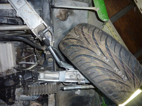

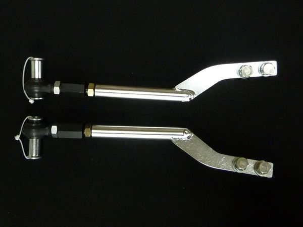

anton1o 01-24-2011 04:17 PM
Product by 3UP Japan
Thoughts? Opinions?
