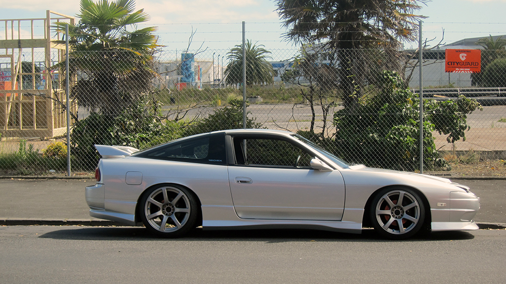

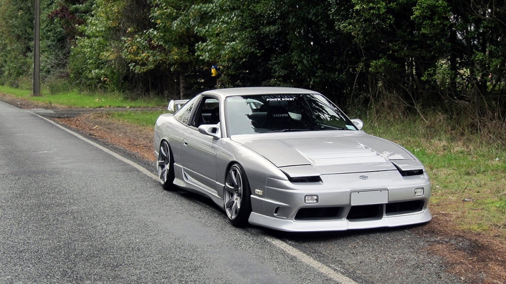

I used to own this:
https://taupakidriftclub.files.wordp...22-s.jpg?w=900
https://taupakidriftclub.files.wordp...15_o.jpg?w=900
https://taupakidriftclub.files.wordp...4618.jpg?w=900
http://taupakidriftclub.files.wordpr.../ass.jpg?w=900
Which was the car I was going to have for a long time. Then it was stolen and recovered and I parted it out.

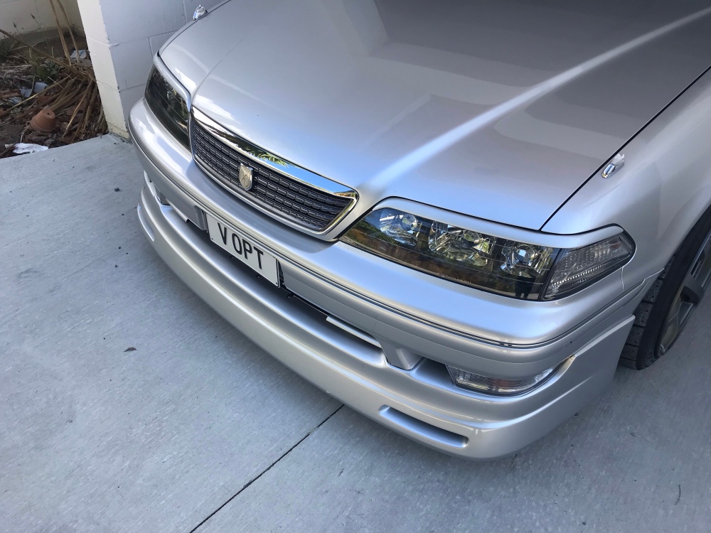

In the meantime I picked up a genuine Vertex Lip Kit from Toyota NZ which I found funny.. There is one Toyota Dealership in NZ that sells Genuine Vertex products as well as Cusco and a few other genuine brands. This kit hasn't been cut in half or anything like that.. the quality is amazing, it's far better quality than the hotroad kit I had on the 180. I also managed to find facelift tail lights and a boot for cheap as well.
https://taupakidriftclub.files.wordp...3870.jpg?w=900
https://taupakidriftclub.files.wordp...3872.jpg?w=900

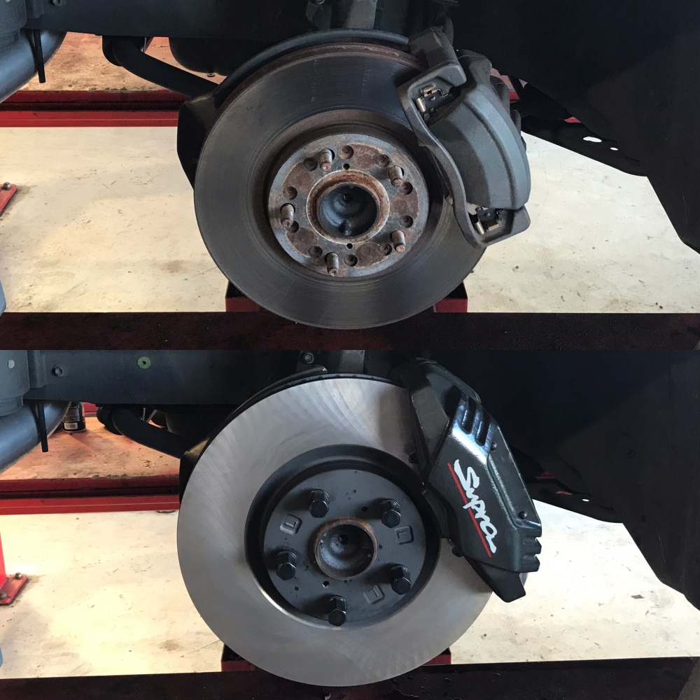

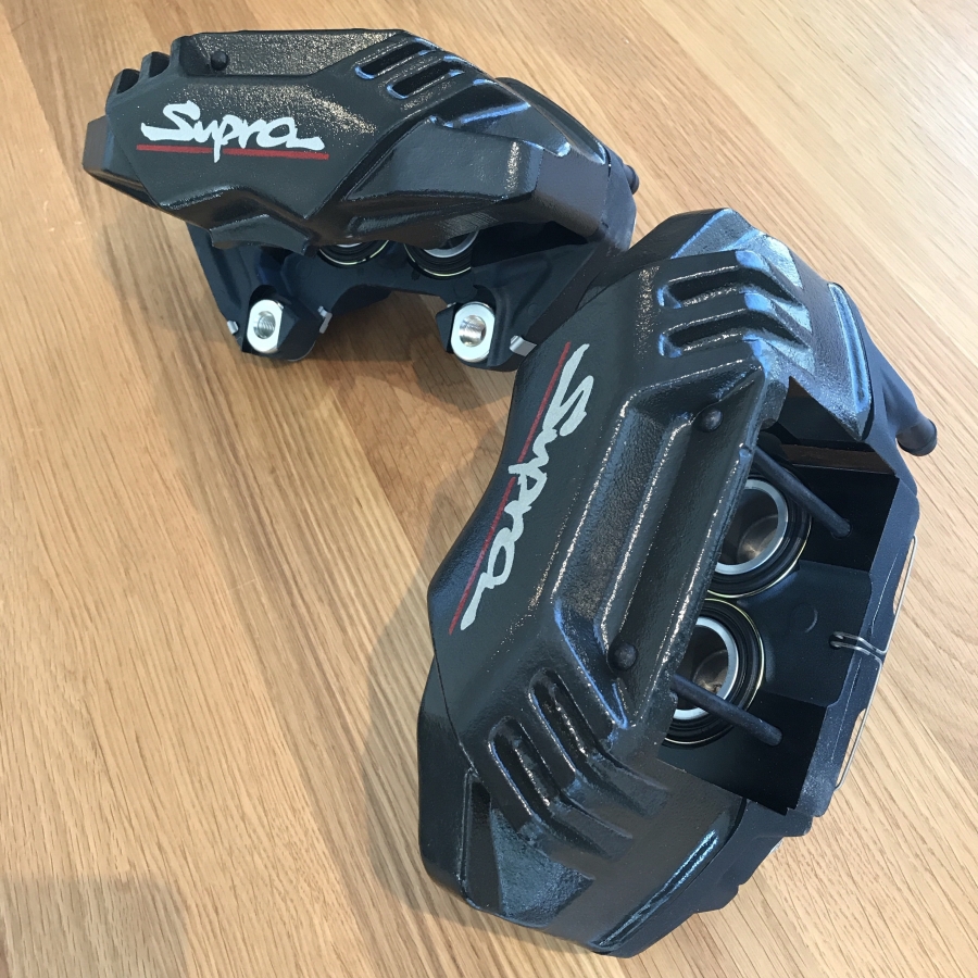

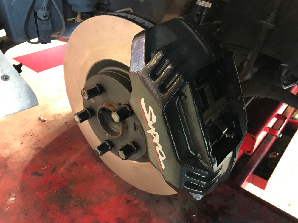

Then I refreshed the whole front end buying parts off Yahoo Auctions with Jesse's help. GX100 grill, Dmax corner lights and I modified some standard indicators (removed the orange inner plastic using a Dremel and then bought some orange bulbs)
https://taupakidriftclub.files.wordp...4912.jpg?w=900

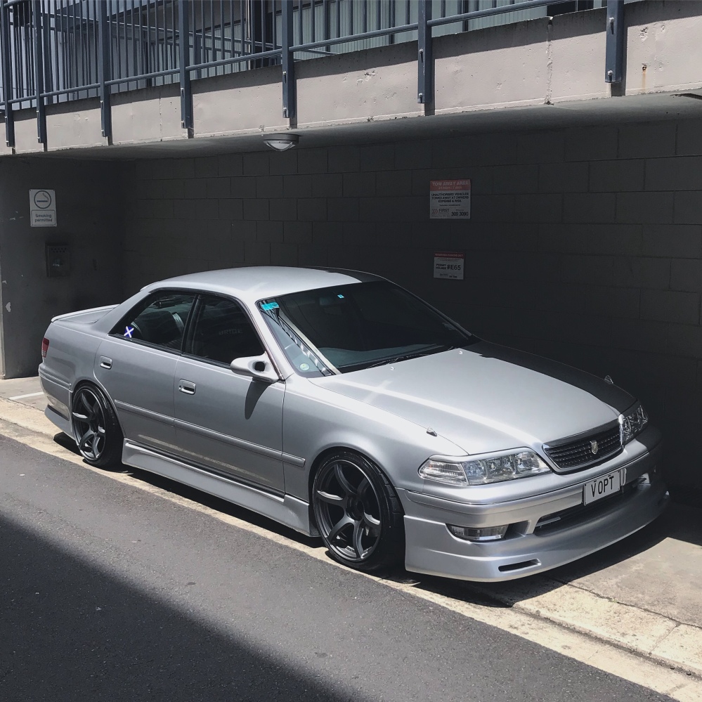

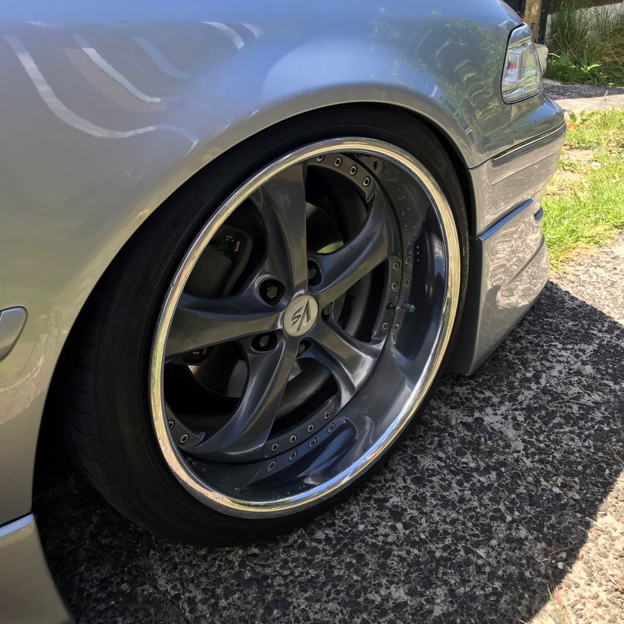

Then I needed some wheels, I wanted XT7.. basically to build a Mark II version of the 180.. Silver car / Matte Grey XT7.. anyway, I couldn't find any in NZ, since they've been discontinued they've become quite rare which sucks.
https://taupakidriftclub.files.wordp...vskf.png?w=900
It wasn't the end of the world, I did manage to pick these up, they're re-lipped (threepiece.us) Work VS-KF, 18x9.5+18 square so pretty much perfect sizes, and the centres are close the MGS colour.. I got them balanced by a wheel shop and checked over and then refurbished the inner barrels..

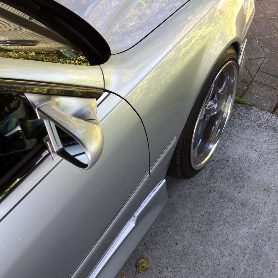

We lipped the guards in the rear and I've actually got away with keeping the inner guards up front but this will probably have to go as I do want to lower it a bit more. Tyre sizes are 225/40 & 235/40.
Then it went to paint to get the kit sorted, it took 2 times to get the paint right which was frustrating (silver sucks to paint) Anyway, got the car back and was stoked, we are going into summer in NZ so the timing is perfect.

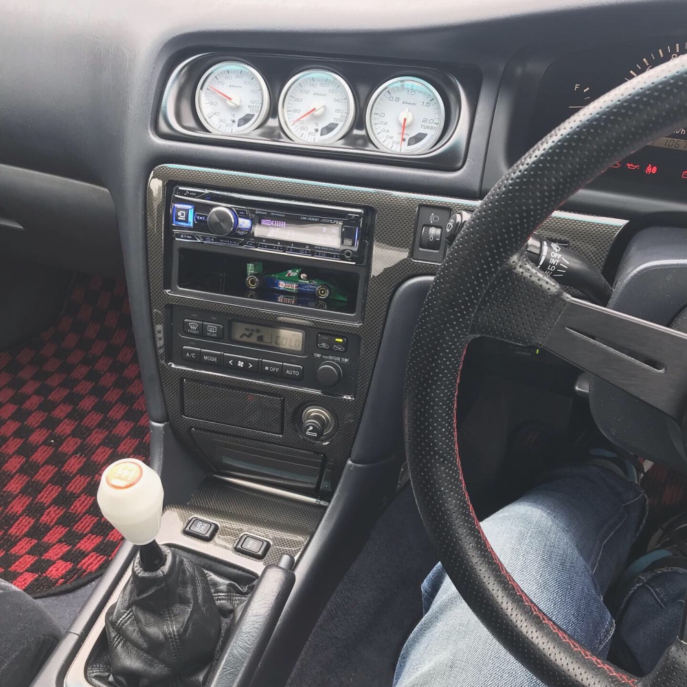

Right now I've just been working on the interior.. I'm halfway there. A Nardi Classic I got of Keisuke which was basically as new condition, but a lot cheaper than buying a new wheel...
https://taupakidriftclub.files.wordp...8962.jpg?w=900
https://taupakidriftclub.files.wordp...6909.jpg?w=900
& replaced the JDM double din with a new Alpine headunit.
https://taupakidriftclub.files.wordp...4377.jpg?w=900
The car is booked in to get the manual conversion and the diff installed early next month, the only other thing I'm keen to do before the end of summer is larger sway bars and maybe a subwoofer in the boot.

240sx_sr20det 10-20-2018 07:41 AM
That Trust knob looks amazing; is it powdercoated?
Olly 10-20-2018 10:40 PM
I believe it’s fake.

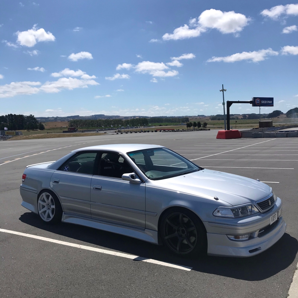

I had the opportunity to do a bit of a road trip this weekend and some spirited driving through a well known Northern road, I'm really stoked how it went.. no drama apart from eating away some of the inner guards
https://taupakidriftclub.files.wordp...7201.jpg?w=900

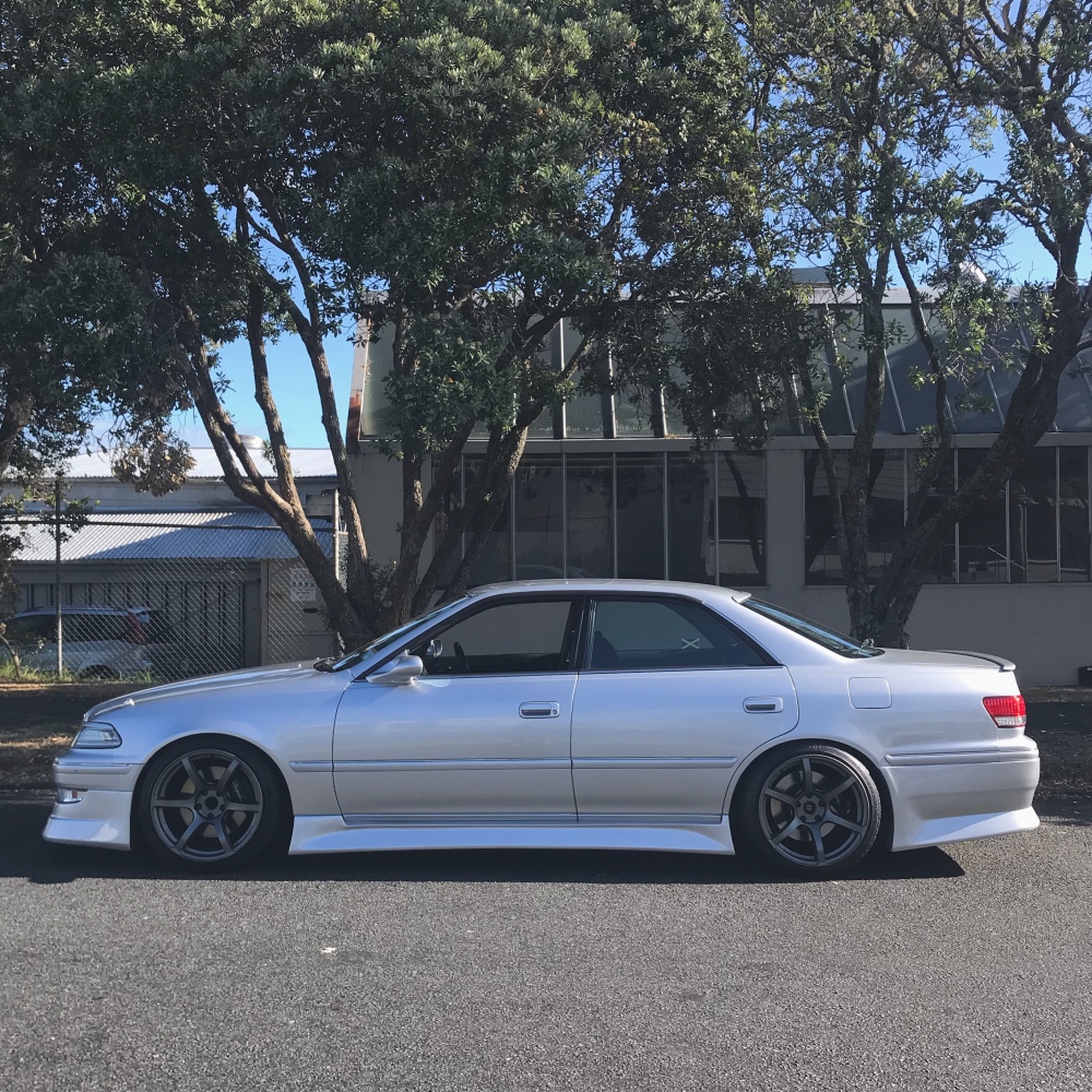

Got a call on Friday to say the car is 100% street legal :), so looking forward to getting it back next week and getting the rest of this stuff sorted.

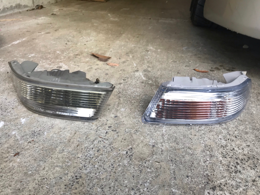

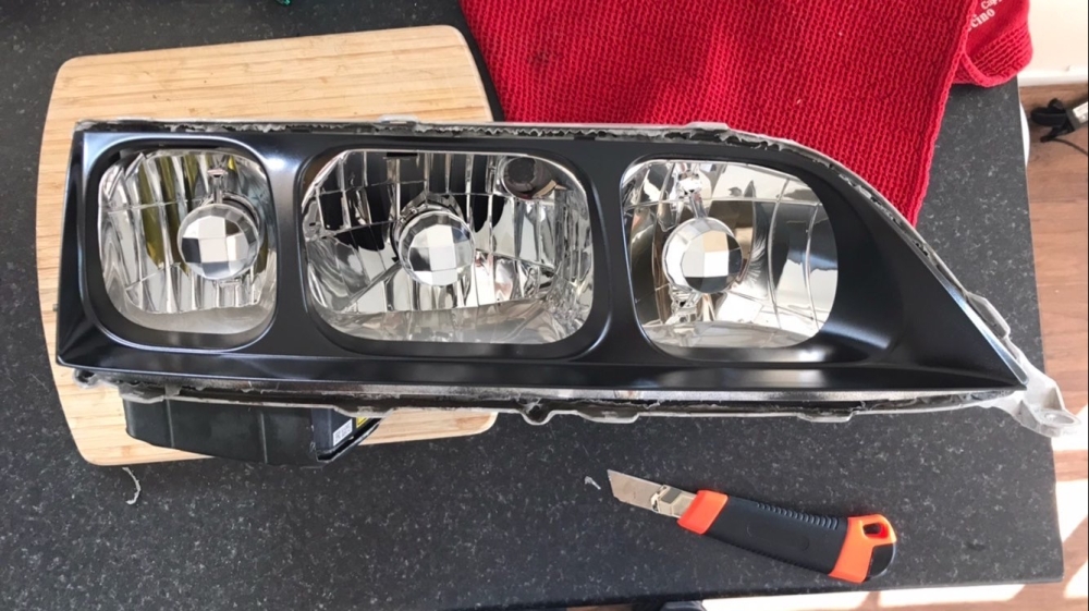

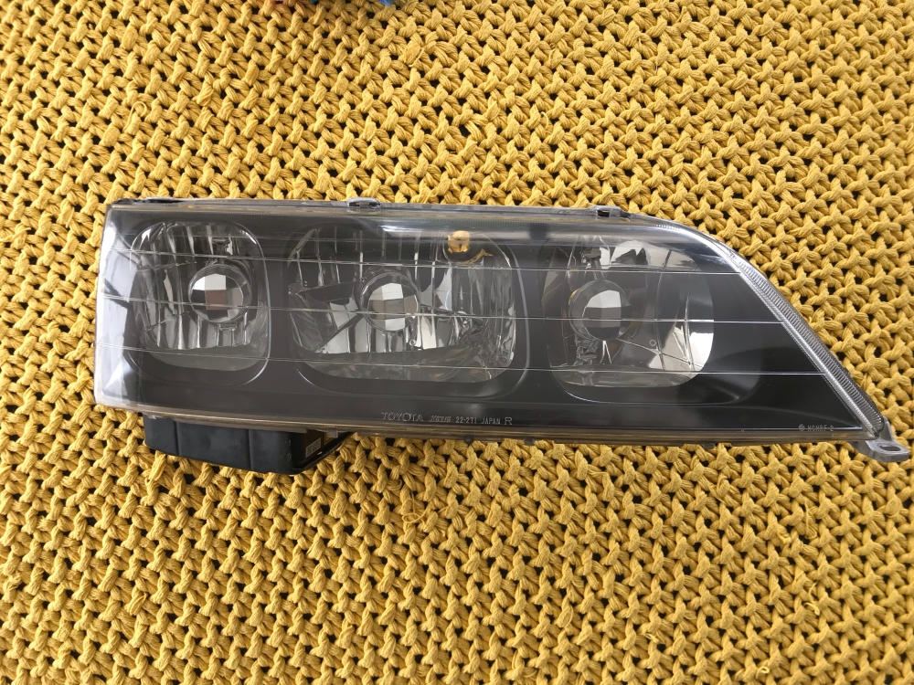

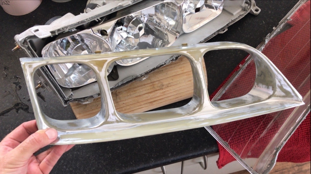

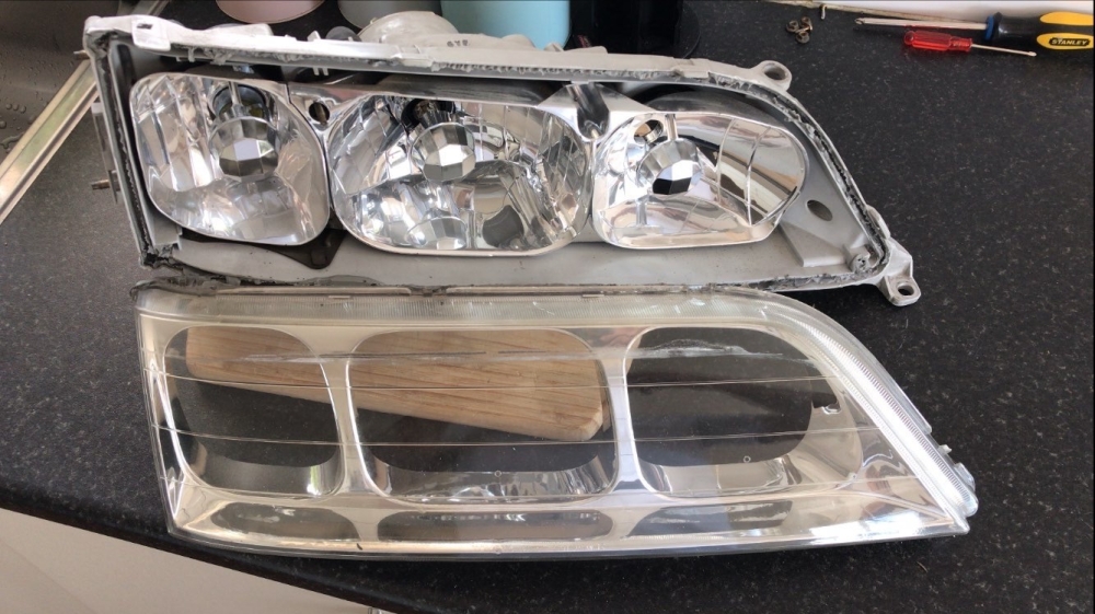

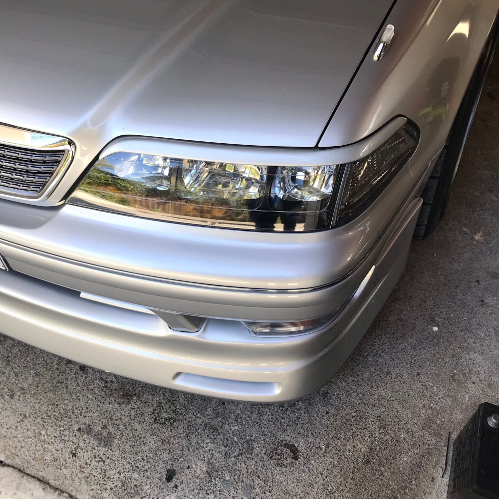

I also picked up a set of 'brick' headlights that needed a clean up, they're pretty rare in NZ and keen to see how they look on the car
Before
https://taupakidriftclub.files.wordp...00_n.jpg?w=900
After
https://taupakidriftclub.files.wordp...2068.jpg?w=900
Standard 12-15-2018 11:44 PM
Awesome build so far, loving it! Details on headlight resto? I do this frequently for customers, I typically wetsand then use compound for polishing only. Any clear coat used?
Olly 12-23-2018 01:27 AM
All I used was some rubbing compound and a DA.. I probably didn't do that great of a job tbh.

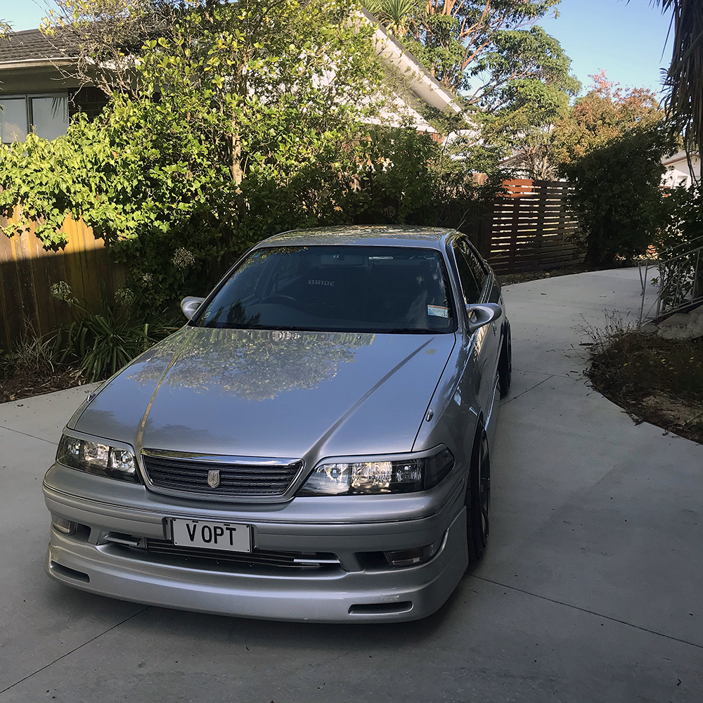

I got the car back on Friday certified, it didn't fail on a single aspect which is great. Once i had it back I gave it a good clean inside and out.
https://taupakidriftclub.files.wordp...34-1.jpg?w=900
https://taupakidriftclub.files.wordp...2243.jpg?w=900

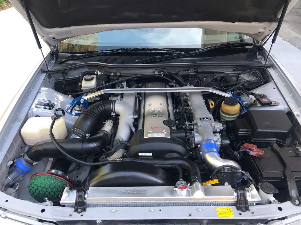

awesome car dude!! No engine bay shots though? :(
Juucso 12-25-2018 09:59 AM
Really nice! I like the floor mats, seem to suit the car really well. Gives her a old school vibes and I like it a lot!
crzsteveo 12-25-2018 10:10 AM
def looking forward to see how you fit the xt7s! looking for that same size for my 90, but im thinking ill have to roll/modify the rear arch a little.
Romango3 12-25-2018 05:00 PM
Awesome car and build. Was a huge fan of ur old 180
Olly 12-25-2018 07:43 PM
100% stock.

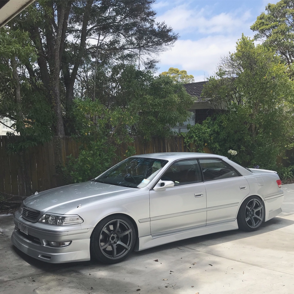

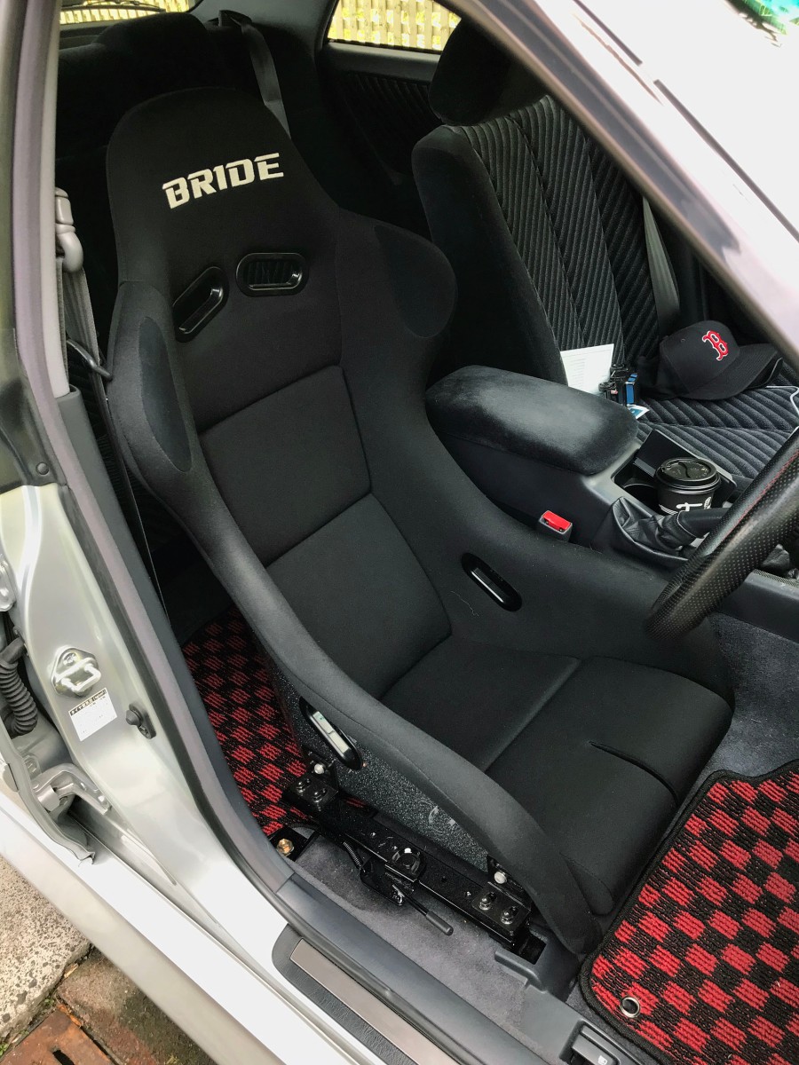

Olly 01-21-2019 03:02 AM
Got a seat rail and the Zeta in.. the graduation has to go. It does sit nice and low though which is a bonus.
https://taupakidriftclub.files.wordp...img_3036-1.jpg
Have been driving the car non-stop over Christmas and New Year which has been great.
https://taupakidriftclub.files.wordp...img_2798-3.jpg
Originally Posted by tricky_ab (Post 6314244)
Those are +12 offset yeah? From what I remember, there's going to be a bit of poke, and a bunch of camber... You can make it work though, but there's a lot of arch work, and fine tuning.
I tried them on and worked out what would need to be done which is realistically a decent roll or flare of the guard... I'm really not keen on ruining the stock guards, I think so many people completely stuff there cars up by doing this badly.. even with the 180sx I wasn't overly happy with how they came out..
So the XT7 were sold and I put a bit more effort into the VSKF.. one thing that bugged me about these wheels is the water marks and general dirty appearance of the lips.. they came from threepiece.us and I couldn't actually tell if they were anodized or polished alloy.. in the end I found they were the later which is a massive bonus, I picked up some autosol and the results were awesome.. seriously happy with how these look now. I've always owned single piece wheels in the past so the maintenance on these is a bit of a learning curve.

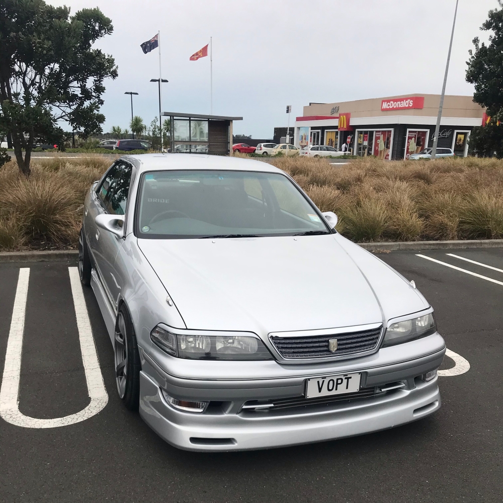

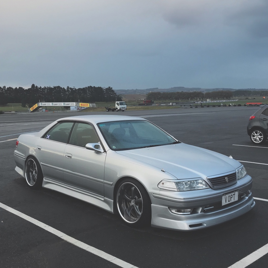

I also bought a plate.. I was always 50/50 on personal plates.. I honestly always hated NZ number plates with a passion, most of my photos I would blank them out. I could never justify buying a personal one.. and what would you get anyway?
A mate and I were looking at the website to see what might be available and V OPT came up as untaken.. I thought it was cool, it perfectly reflects the type of car style I like a lot.
https://taupakidriftclub.files.wordp...img_3224-1.jpg
And that's everything up to date.. I'd like to promise next update will be a track day and some in-car footage, but I'm pretty similar to Damon with my cars and just like tinkering and doing aesthetic stuff haha.

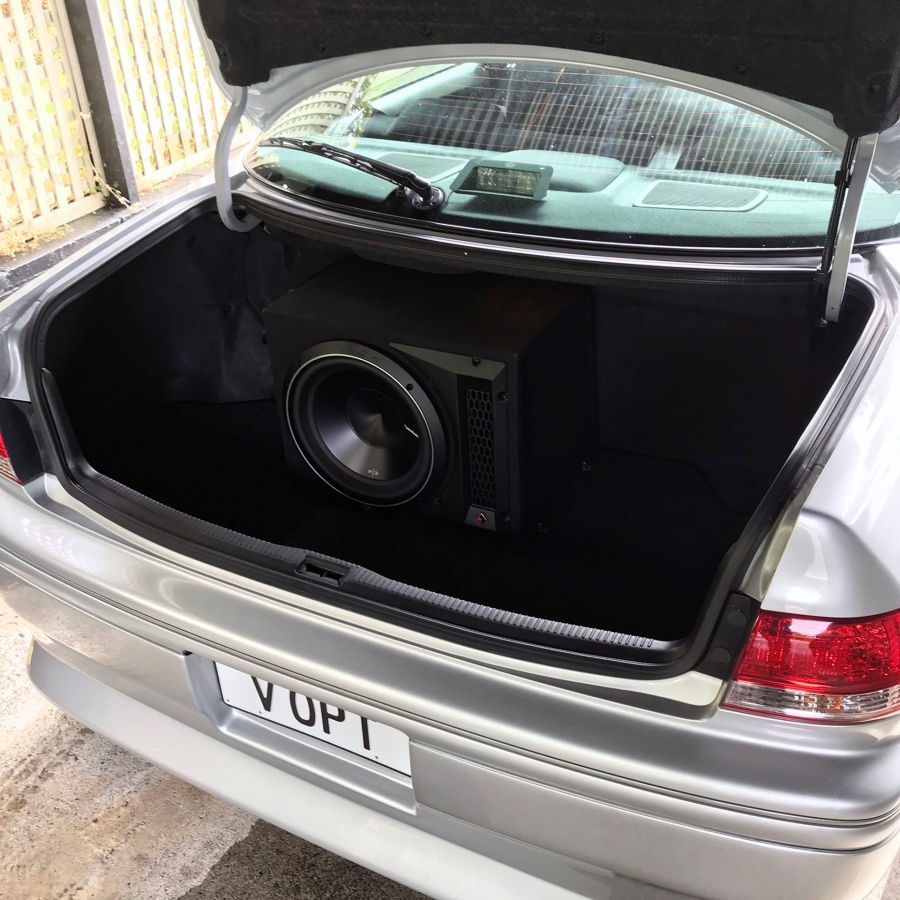

Most of my cars have had subs, probably 6 cars? so only a matter of time before this car got the same treatment.. I'm not an audiophile.. I probably spent more on this combo than I would have normally as I told myself I won't be selling this thing anytime soon. The 180sx had Alpine Type S 6.5" components and an average sub and amp.. and I loved it..
I ended up grabbing one of these: https://www.crutchfield.com/S-Ok9M4xeZCj0/p_5751P31X12/Rockford-Fosgate-P3-1X12.html[/url]
And a fairly chunky amp which I've aleady forgotten what it is lol, but its 760w RMS
https://taupakidriftclub.files.wordp...92-1.jpg?W=900
https://taupakidriftclub.files.wordp...02/4.jpg?w=900
The one thing I've noticed with the JZX is the fuel tank is behind the rear seats, so getting the sound through is actually pretty difficult. The JZX110 must have the fuel tank under the boot floor as there is plastic compartment that is removable.. I'm pretty sure I put the sub there in that car too.
So yeah, kinda underwhelmed with it so far as the fuel tank is blocking a lot out but once I get some components I'll get the audio shop to tune it. If anyone has recommendations for the components keen to hear them.

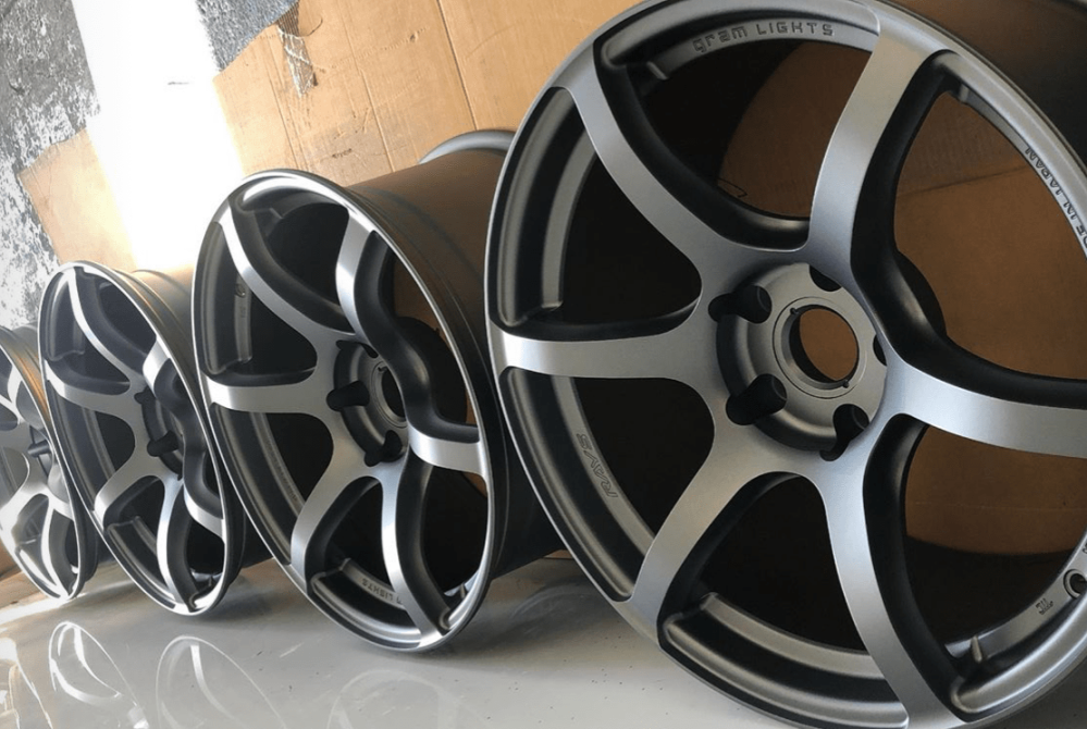

My ganadors & black seat cushions also showed up and are at the painters now, really stoked on the condition of these and they are the blue tinted glass which I've never had.

Still stoked how mint these lips came up, and updated with ganadors on now:
https://taupakidriftclub.files.wordp...ador.jpg?w=900
https://taupakidriftclub.files.wordp...dor2.jpg?w=900

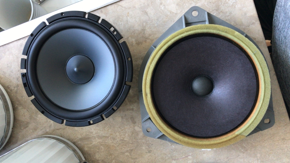

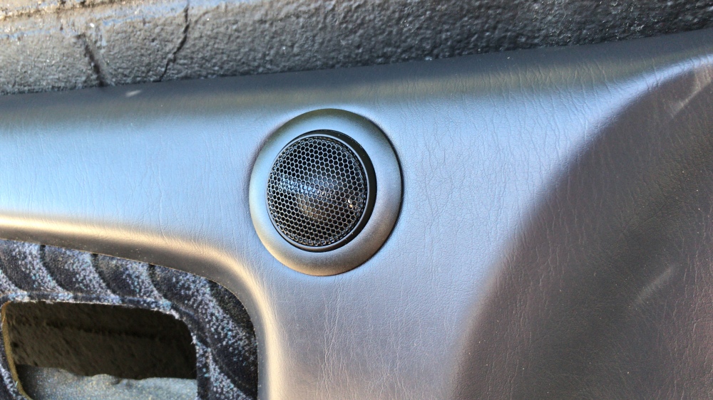

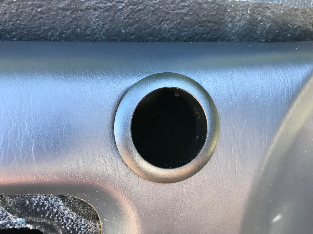

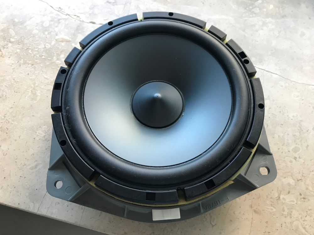

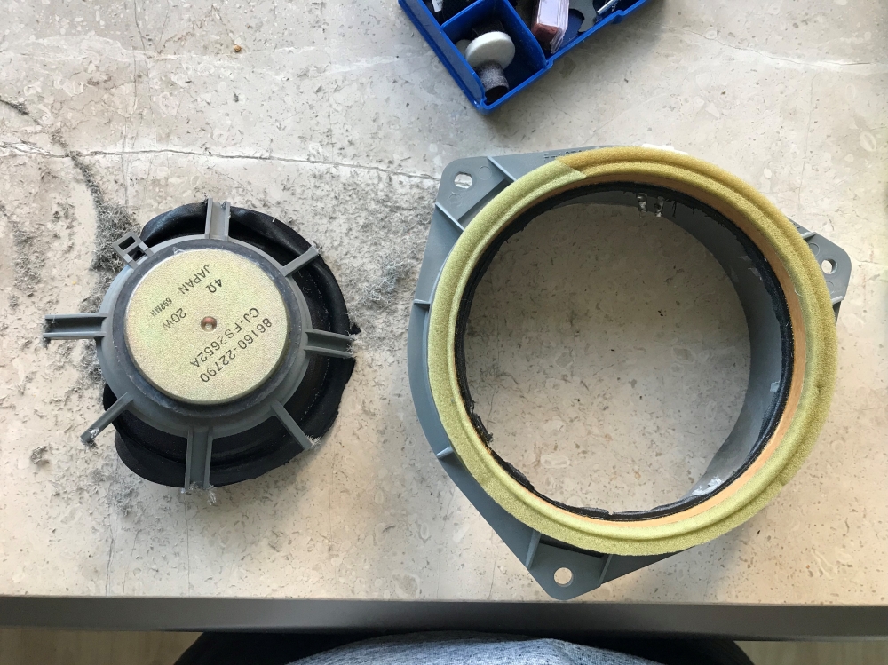

Replaced the tired components with Alpine Type S, which I had in the 180.. Pretty straight forward install in JZX100, I used the factory plastic mounts that I modified with a Dremel
https://taupakidriftclub.files.wordp...718.jpg?w=1000
https://taupakidriftclub.files.wordp...797.jpg?w=1000
https://taupakidriftclub.files.wordp...673.jpg?w=1000
https://taupakidriftclub.files.wordp...604.jpg?w=1000
https://taupakidriftclub.files.wordp...951.jpg?w=1000

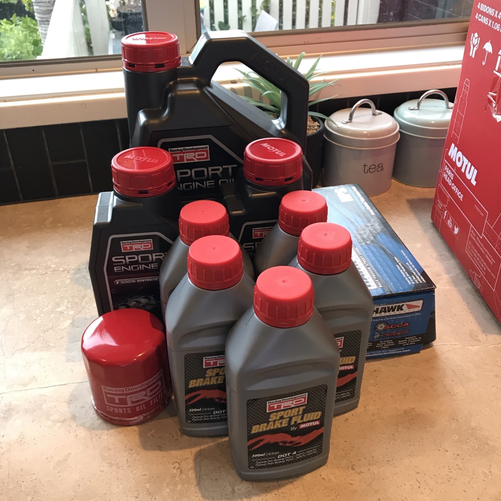

After that trip I had a lot of motivation to get to the track. I gave my car a decent service, went for a final test drive up north, got a helmet bought some decent pads which turned out to be useless and went and did a test day at Hampton Downs with my mate in his SR20 powered C35 Laurel.

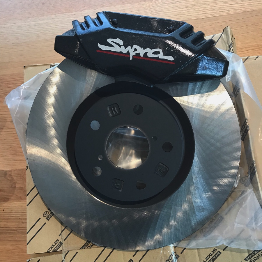

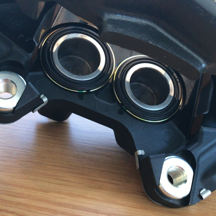

Slowly collecting parts to solve my average stock brake issues.. looked at Project Mu, LS400 & Wilwood, but decided to go with Supra due to value for money and the fact I could buy from Toyota again... just waiting on adapters from Figs to show up then good to go..
https://taupakidriftclub.files.wordp...187e.jpg?W=900
https://taupakidriftclub.files.wordp...8215.jpg?w=900
https://taupakidriftclub.files.wordp...6452.jpg?w=900
I'll probably do the rear brakes as well at some point, interesting that the rear rotor size is 324mm vs 323mm front.

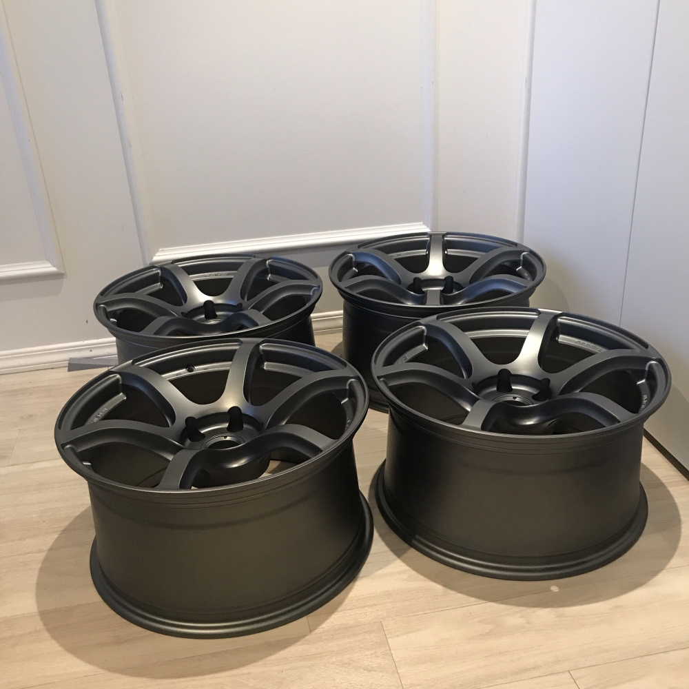

Olly 07-22-2019 04:36 AM

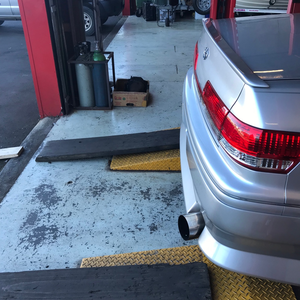

Small update - the rear adapters finally arrived so the car's getting the supra brakes put on this weekend.. finally.

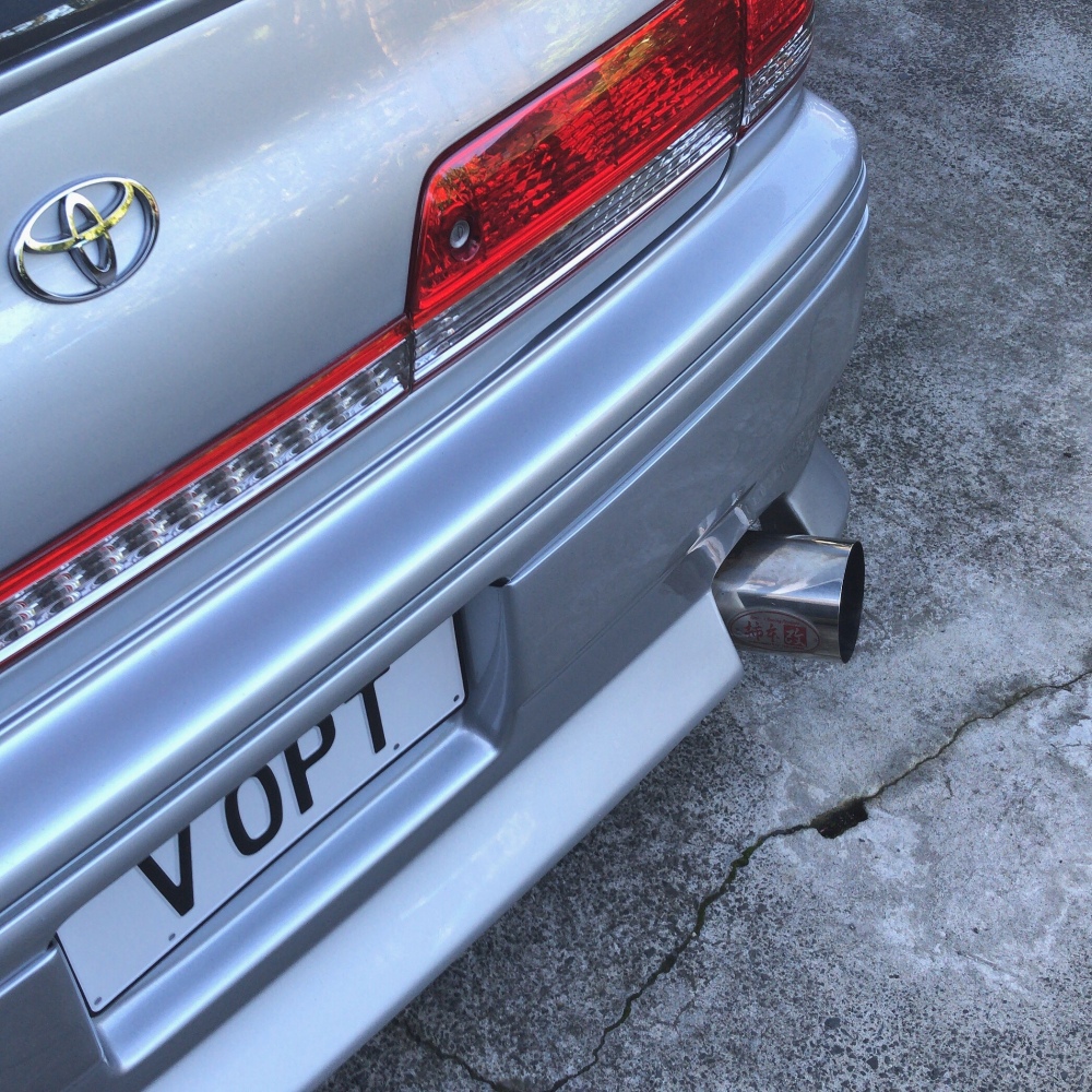

In the meantime I got the centre muffler deleted from my exhaust and the tip extended so it's not sunk in.
https://taupakidriftclub.files.wordp...884.jpg?w=1000
https://taupakidriftclub.files.wordp...854.jpg?w=1000
The sound isn't quite there but it's much more raspier than before and will do me for now, I want to run a full stainless 3" exhaust at some point and delete the cat, but want to get an ECU sorted before I go down this road.
In sad news the VSKF are O Disc - meaning there is no way in hell any large caliper is going to fit behind them.. maybe I shouldn't have sold the XT7 :D anyway I picked up some 57C6 and had them fixed up.

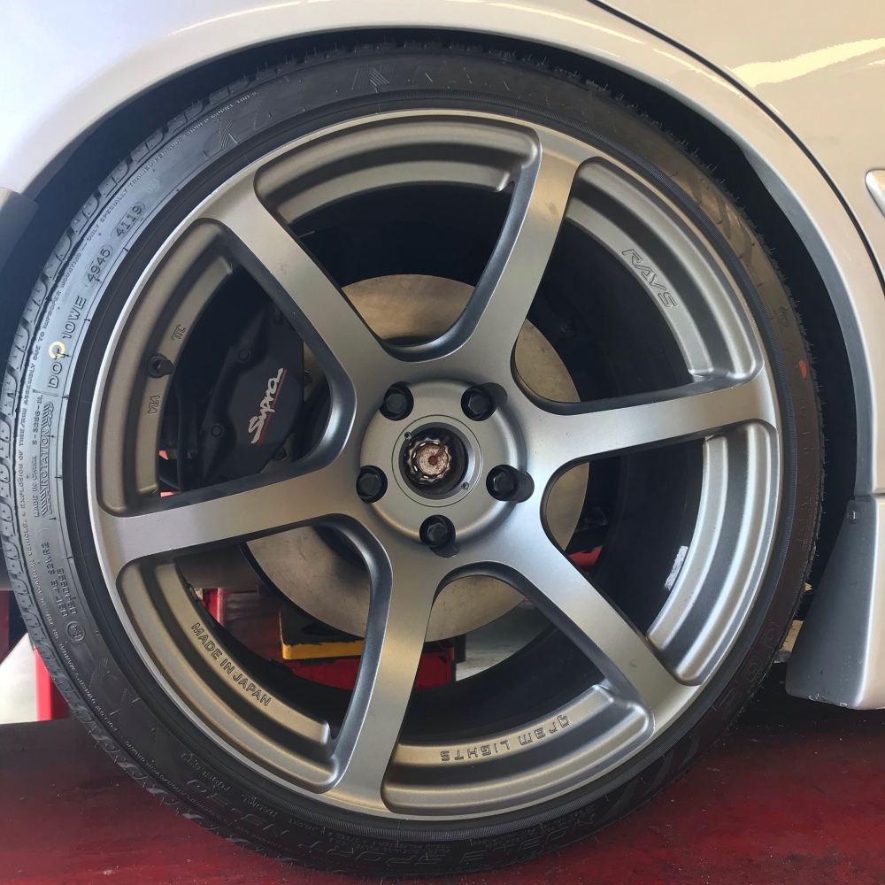

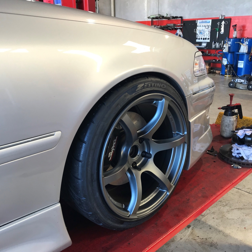

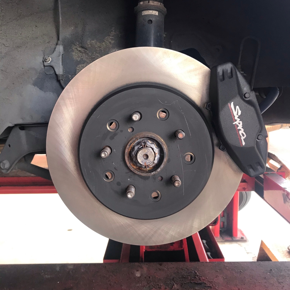

Managed to get the front Supra brakes and wheels on today. Very happy, stops so much better. The alignment needs a bit of tweaking and there's a bit too much poke but right now they're on, and don't rub anywhere which is awesome.
https://taupakidriftclub.files.wordp...0da.jpg?w=1000
https://taupakidriftclub.files.wordp...682.jpg?w=1000
https://taupakidriftclub.files.wordp...986.jpg?w=1000
https://taupakidriftclub.files.wordp...7c6.jpg?w=1000

Thanks guys, really stoked on it right now.. so similar to the 180 with the single piece wheels
https://www.driftworks.com/forum/att...29-jpg.300680/
Hopefully get the rear calipers on soon and get another track day sorted :D

Olly 10-06-2019 03:44 AM

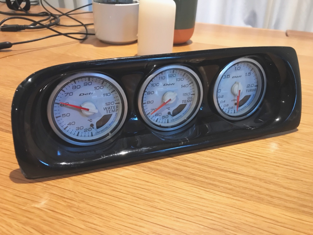

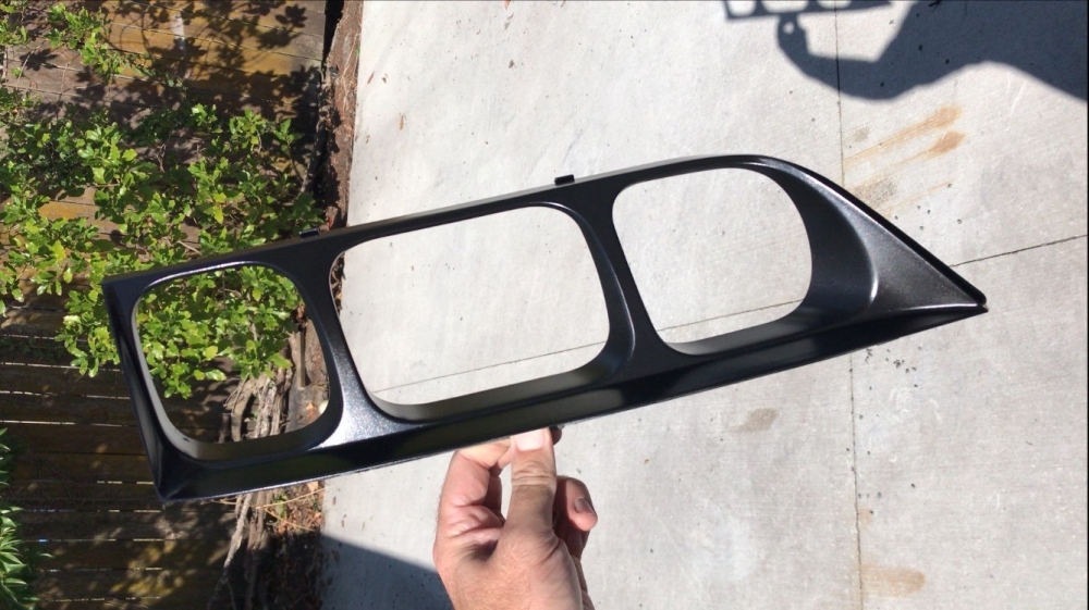

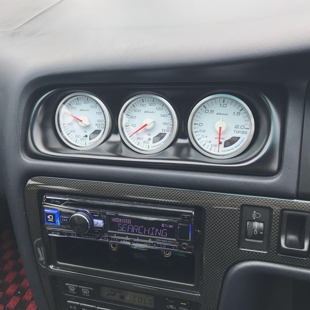

Thanks guys, glad you like it.. have done few things over the last month, mainly got my hands on some defi gauges (at first with no controller or wiring but I sorted that this week).
I was tempted to drill into the dash again like the 180 but a guy in NZ makes these holders out of FRP and I thought I'd give one a shot
https://taupakidriftclub.files.wordp...9-1.jpg?w=1000
Painted satin black and installed
https://taupakidriftclub.files.wordp...2ae.jpg?w=1000

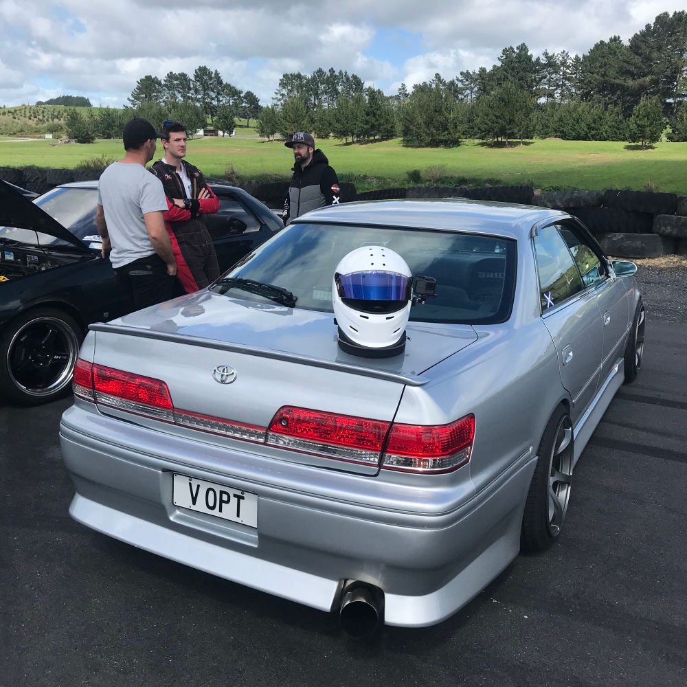

This weekend I managed to get back to Hampton Downs for another track day which gave me a great opportunity to try the supra brakes.. I took half a second off my best time which I thought was pretty good considering the club circuit is a 30 - 50 second circuit depending on what you're in so it's very very short.
Didn't get many photos but I'll try to upload a video later.
https://taupakidriftclub.files.wordp...6-1.jpg?w=1000
The car was awesome, all I did for prep was change oil and check fluids and tyre pressure.. the semi slicks combined with better braking just gave me so much more confidence and I really enjoyed the day a lot more than the last one.
I gave it absolute death for most of the sessions and probably had one cool down lap for every 5 or 6 fast laps I did. So stoked it had absolutely no issues at all :D

Been driving this thing quite a bit lately, summer's coming up and its been a champ. Drove to Taupo and watched some drifting.. NZ car style has changed quite a bit haha.. more missile based rather than 01 style.. was still a good trip down.
Car has a fair bit of poke which I might try to fix with an alignment this month.

I got a last minute call up to go and test the car at Hampton downs 'skid pan' which is a large concrete area with water jets that you can operate manually.. I've never drifted before but this was the most fun I've had in this car and probably any car, can't wait to get out again.
We started the day with a few donuts, then figure 8s, then set up a track which consisted of 3 or 4 corners.. mostly slow second gear stuff.. by the end of the day I got to battle a few cars (badly) and then I stopped as i was really pushing my luck and most of the other cars were missiles haha.

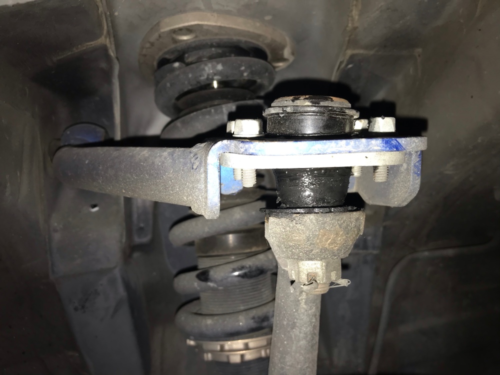

Someone asked me about the Cusco front camber arms and now after 10,000km or so of driving I can review them a bit better..
https://taupakidriftclub.files.wordp...090.jpg?w=1000
Apparently the above is due to excessive camber on the ball joint meaning the load is not evenly distributed. You can fix this by cutting and shortening the uprights but I'm not overly keen on relying on someone's welds with my son in the car all the time.
I guess that leads me to figuring out what to replace the Cusco front arms with. The only real option is a serial nine front arm.. but I'm a tad confused on what to get..

Also managed to find some brand new OEM clear indicators.

And I installed a Koyo Rad as I want to start doing some engine bay dress up stuff and make it look not so junk.
https://taupakidriftclub.files.wordp...af1.jpg?w=1000

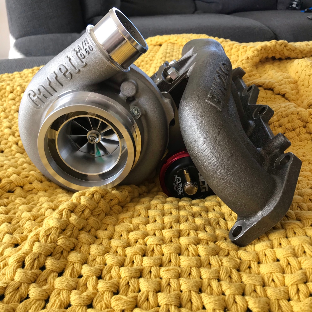

I'm in two minds right now with the car and the engine - I have a hi-flow turbo with a Garrett GTX3071 front wheel and standard steel rear wheel that I could put on, it should provide a bit more 'punch'. or I could sell it and run a GTX3076r Gen 2 setup which is way more money and probably over kill for the kindergarten run. :D

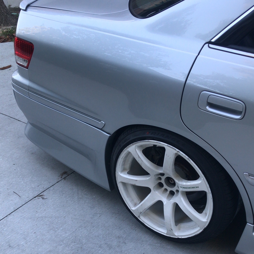

This photo really shows how bad the rear poke is

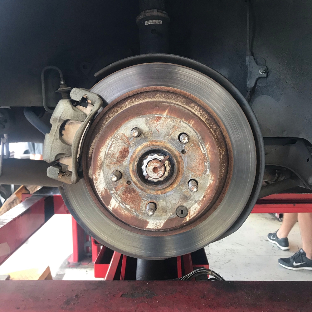

Small update - For anyone doing JZA80 Supra brake conversion on a JZX100, specifically the rear: JZA80 inner brake shoes for JZX100 are needed, this allows the factory handbrake to work. I haven't installed the rear calipers and rotors purely because I didn't know these existed and I wanted to do some drifting and it would have sucked without a handbrake.
There are 2 companies that make the shoes - Kazama and Project Mu. I went with Project Mu conversion shoes.. I've had some varying feedback on how good they are but we will find out.
Visually - having both Supra front and rear rules.. it looks 1000x cooler. It also surprised me what a difference it made to braking.. the rear helps a lot and the car pulls up a lot more evenly rather than the front dipping down under a lot of hard braking.
https://taupakidriftclub.files.wordp...00e.jpg?w=1000
The factory rear brakes are gross:
https://taupakidriftclub.files.wordp...825.jpg?w=1000
All new:
https://taupakidriftclub.files.wordp...414.jpg?w=1000
https://taupakidriftclub.files.wordp...297.jpg?w=1000

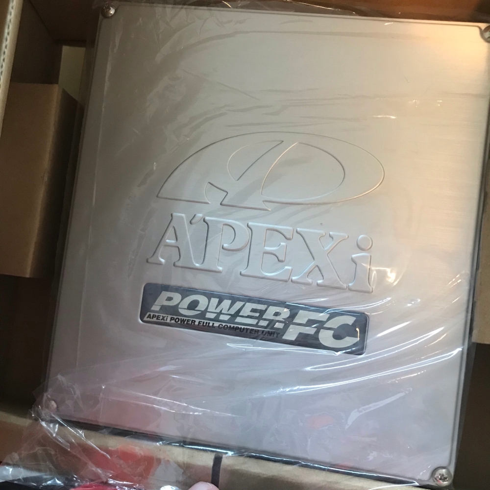

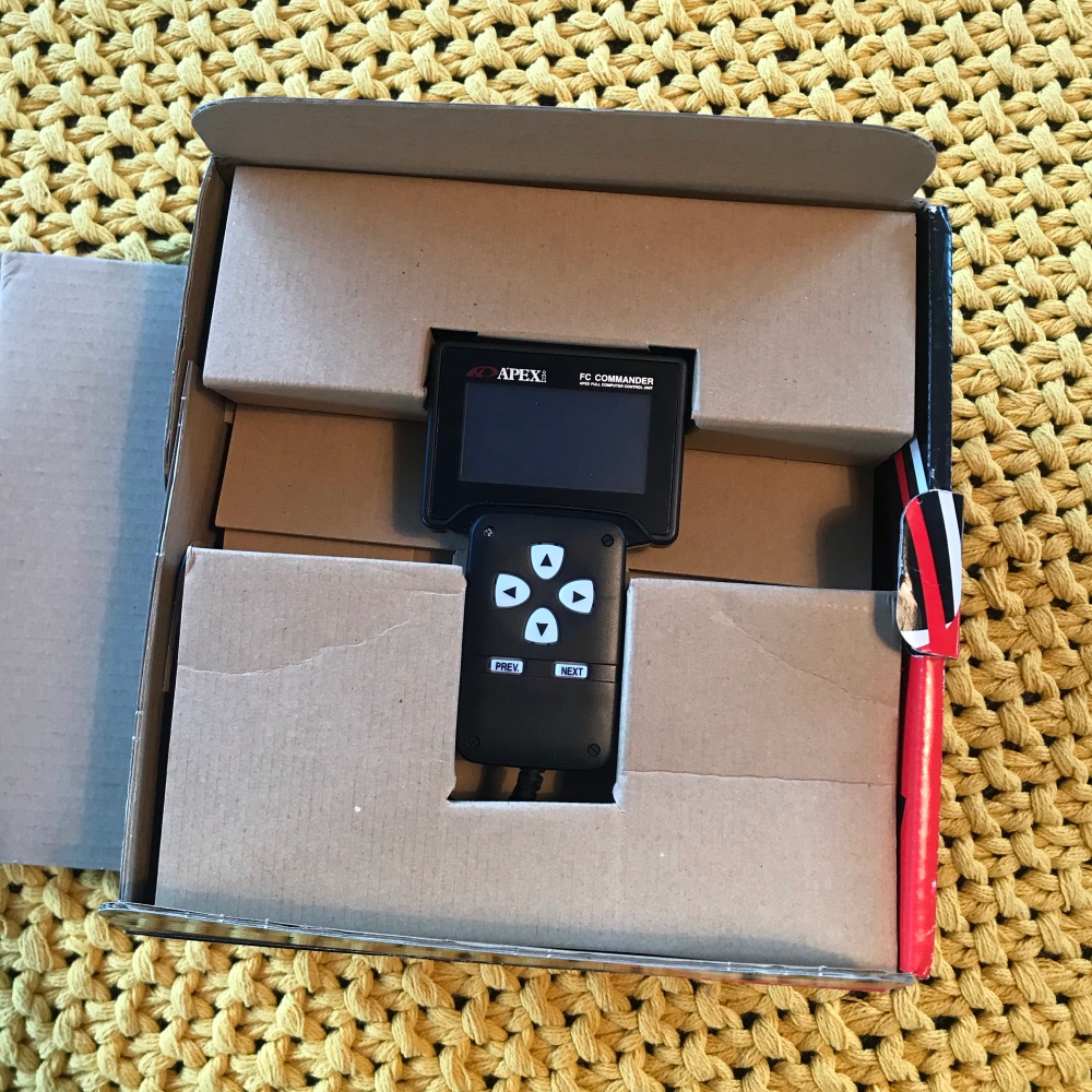

In other news, I managed to find a Power FC locally (new in box) for a really good price so I grabbed it, I also ordered a Tomei cast manfiold, tomei dump pipe and j-pipe delete kit.

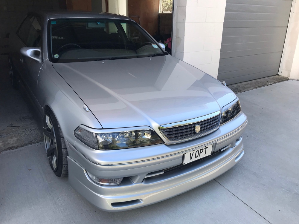

And I changed the headlights.
https://taupakidriftclub.files.wordp...635.jpg?w=1000
e30gangsta 03-07-2020 03:54 PM
Can you explain the differences in headlights? Different years different spec I guess?
Olly 03-07-2020 06:35 PM
I think there are 4 different types of front lights for a Mark II, Basically tripple vs double and chrome and black housings. The double housings which look similar to brick headlights or Chaser headlights were only available in GX100.
This car was kinda the reason I wanted to find some of the black housing ones.

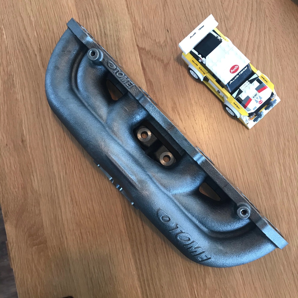

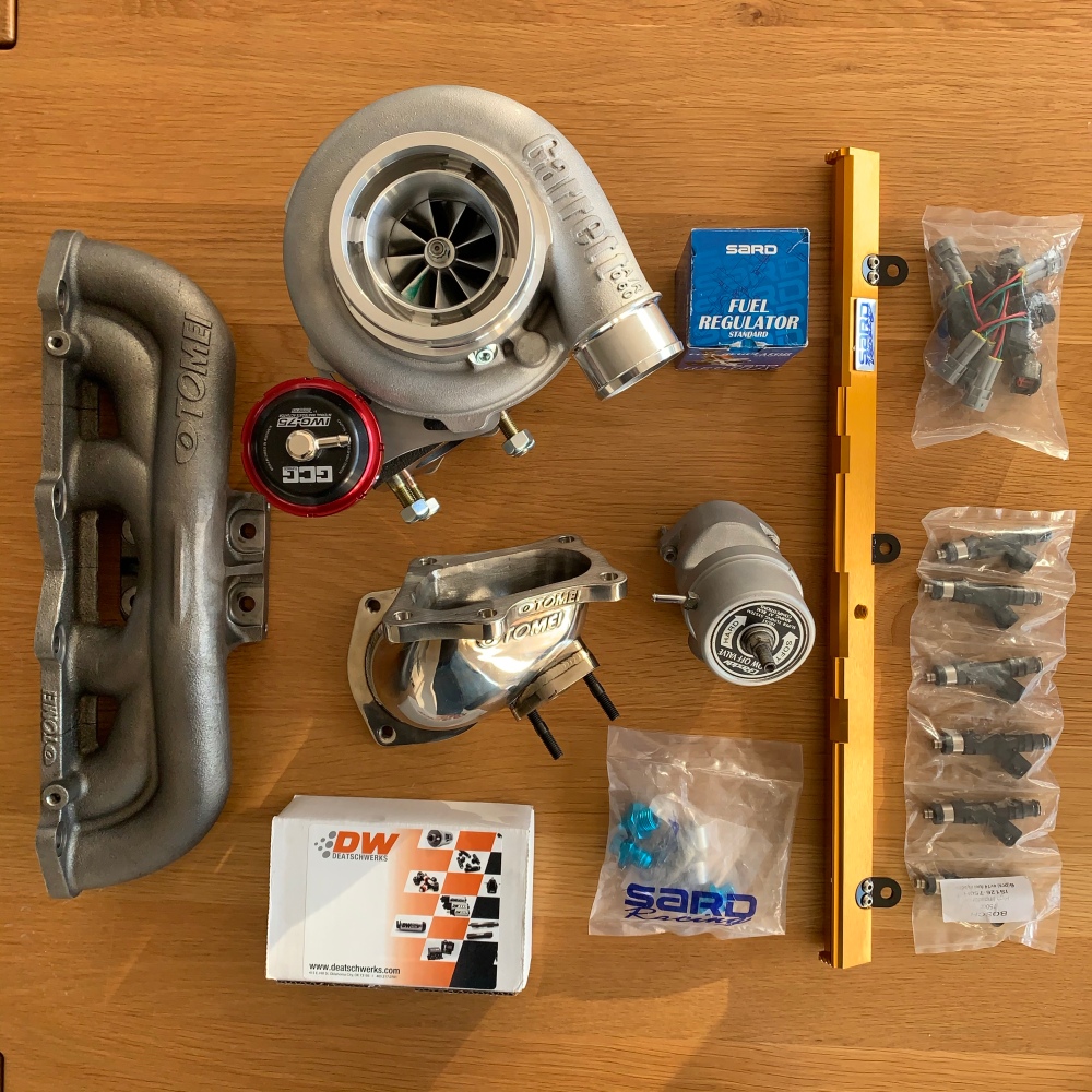

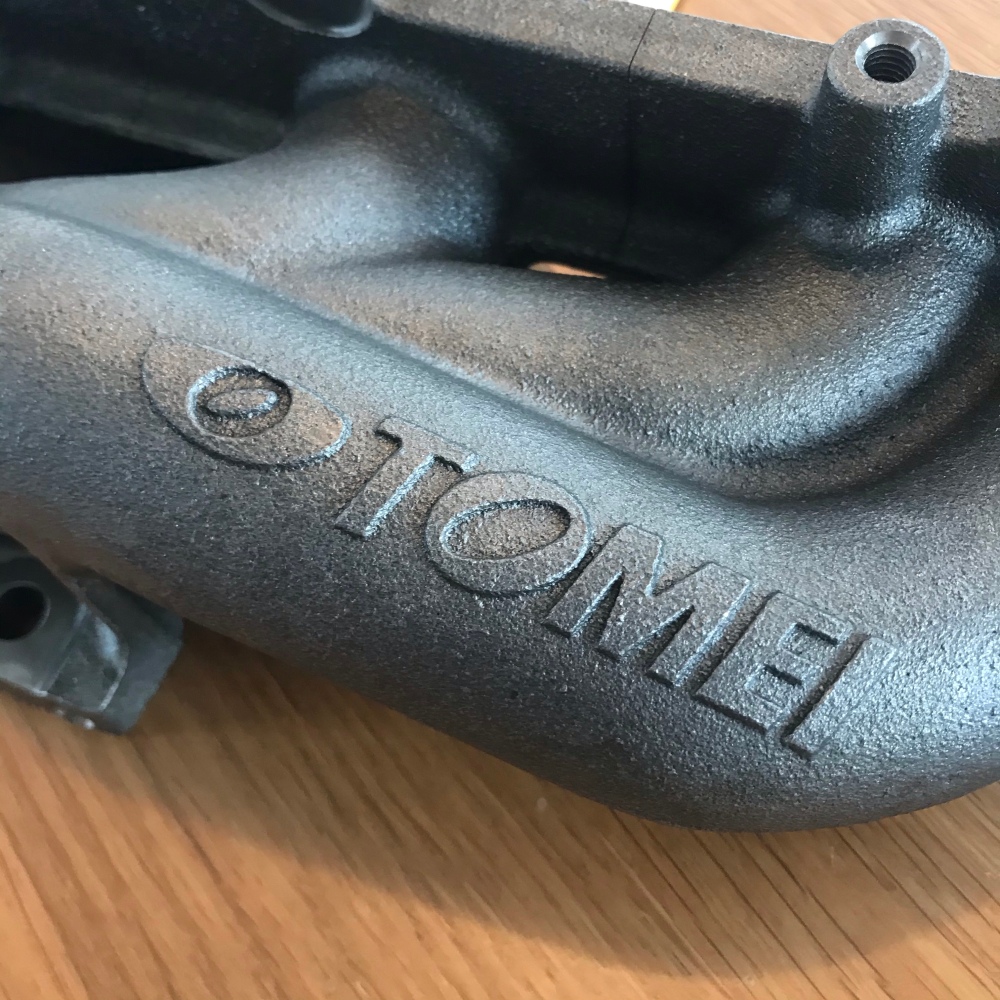

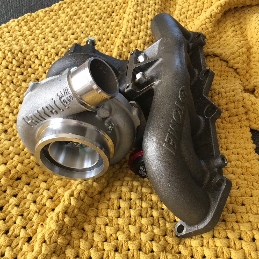

I ordered a Tomei Expreme Cast manifold
https://taupakidriftclub.files.wordp...1_b.jpg?w=1000

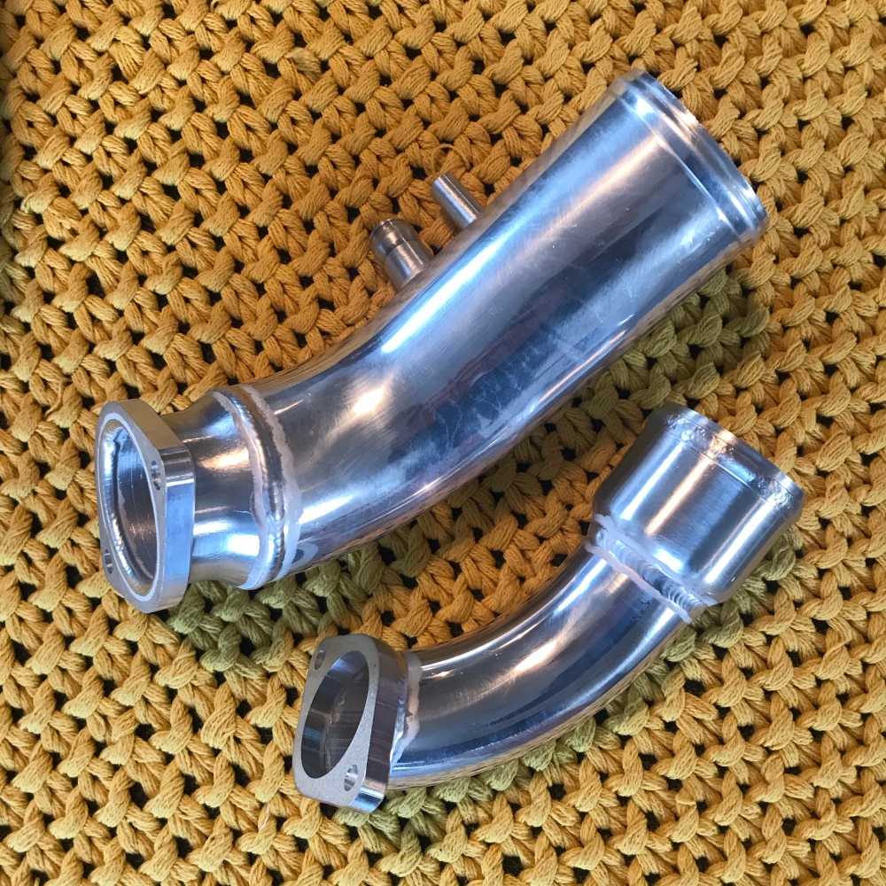

The Power FC & J-pipe delete kit showed up.
https://taupakidriftclub.files.wordp...846.jpg?w=1000
https://taupakidriftclub.files.wordp...686.jpg?w=1000
https://taupakidriftclub.files.wordp...685.jpg?w=1000

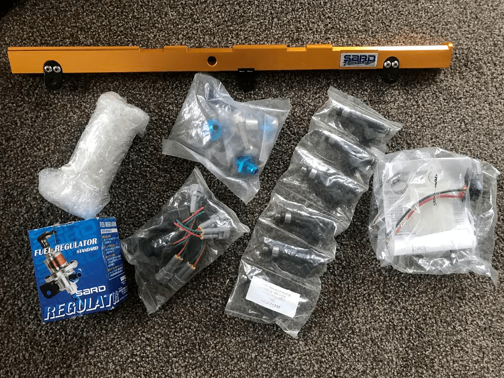

The guy I bought the Power FC off also had a decent fuel setup for sale that I bought too, it's a bit overkill but it's an awesome setup.
https://taupakidriftclub.files.wordp...4512161904.png
It's a Sard Fuel Rail, Bosch 750cc injectors & adapters, Sard FPR & Bosch 500hp fuel pump.
It saves me buying a lot of stuff separately and I guess all I need now is a boost controller and to get the defi's wired in properly and it's good to go for a tune.
I have a hi-flow turbo, fairly standard but with a Garrett GTX3071 front wheel.. It's not going to do much over 18psi but in all honesty.. if this thing makes 250 - 260kw to the wheels I will be over the moon!
The only other thing that might choke it would be the AFM, I could convert to a Z32 AFM or something but will see how it goes.
And yes I know I could have gone down the road of a Haltech or a Link but it totally doesn't fit what I'm trying to build here.

Which headlight corners are those with the blackhousings ?
Olly 03-30-2020 01:17 AM
The corner lights are DMAX smoked.
NZ is now in total lockdown, you can visit the doctor or the supermarket and that's about it. I am glad we got to this point sooner rather than later but at the same time I'm going a bit stir-crazy at home.
This weekend I decided to embark on a project with my old headlights, I split the lights by heating them in the oven to 100*c for 14 minutes.
https://taupakidriftclub.files.wordp...880.jpg?w=1000
Then wet sanded down the old chrome housings.
https://taupakidriftclub.files.wordp...238.jpg?w=1000
Some satin black paint
https://taupakidriftclub.files.wordp...994.jpg?w=1000
Mocked them up and deleted the yellow fog (will replace with white LED)
https://taupakidriftclub.files.wordp...565.jpg?w=1000
I then gave the interior plastic a really good clean and was suprised as to how much dirt was on the inside of the lense. Back into the oven for 14 minutes at 100*c and it's super easy to just push the plastic back into the housings. I gave the front of the plastic lenses a quick compound and this was how they came up
https://taupakidriftclub.files.wordp...696.jpg?w=1000
https://taupakidriftclub.files.wordp...981.jpg?w=1000
https://taupakidriftclub.files.wordp...980.jpg?w=1000
https://taupakidriftclub.files.wordp...874.jpg?w=1000
https://taupakidriftclub.files.wordp...2020/04/21.jpg
These look so clean now, like too clean almost for how average the rest of the car is. You may asked why I bothered, but the twin brick headlights have completely different plugs and run No HID, so you have to retrofit all this sh1t and I did most of it but it didn't really work that well. I want to use the factory HID, the factory fog lights and the factory headlight adjustment instead of having scattered light everywhere.

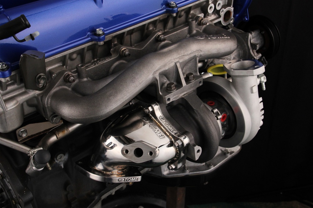

My tomei manifold also arrived just before lockdown (literally the morning of lockdown). So yeah, once we get out - it's all go with tuning haha. Hope everyone is taking care.

And finally - my car isn't going to get any cleaner, I painted the grill satin black and then ran out of things to do.

My defi gauges don't have any sensors so I found some on ali-express and a genuine boost gauge from RHD Japan, I have no idea how long the ali-express ones will take to get here..
I also had too much to drink one night and bought a turbo. It's a Garrett GTX3076R GEN 2, but in bottom mount configuration, so it will bolt on to my Tomei manifold and I can use a Tomei dump pipe as well.. I think it's good for around 300kw, 350kw with cams.
I'm not going that nuts, I want 270kw at the wheels, with this I think it'll get there easily and not struggle, with the hi-flow I had it would be maxed to get there. Should be fun and I'll post up a few images when it gets here next week.

Pretty happy about how this is coming together. The turbo arrived yesterday. NZ is out of full lock down on Tuesday, we're still limited in what we can do but the tuning shop is open from then.
Few things left to collect - mainly a boost controller and then we should be good to go.

For some reason that cast manifold is going to look so nice and clean in the engine bay, maybe even better than a big tube manifold.

The manifold came with instructions to run the factory heat shield so I'm not sure you're going to see it which sucks. I booked the car in to get tuned on the 27th and the only thing I need to find now is an air filter.
More boring parts photos.

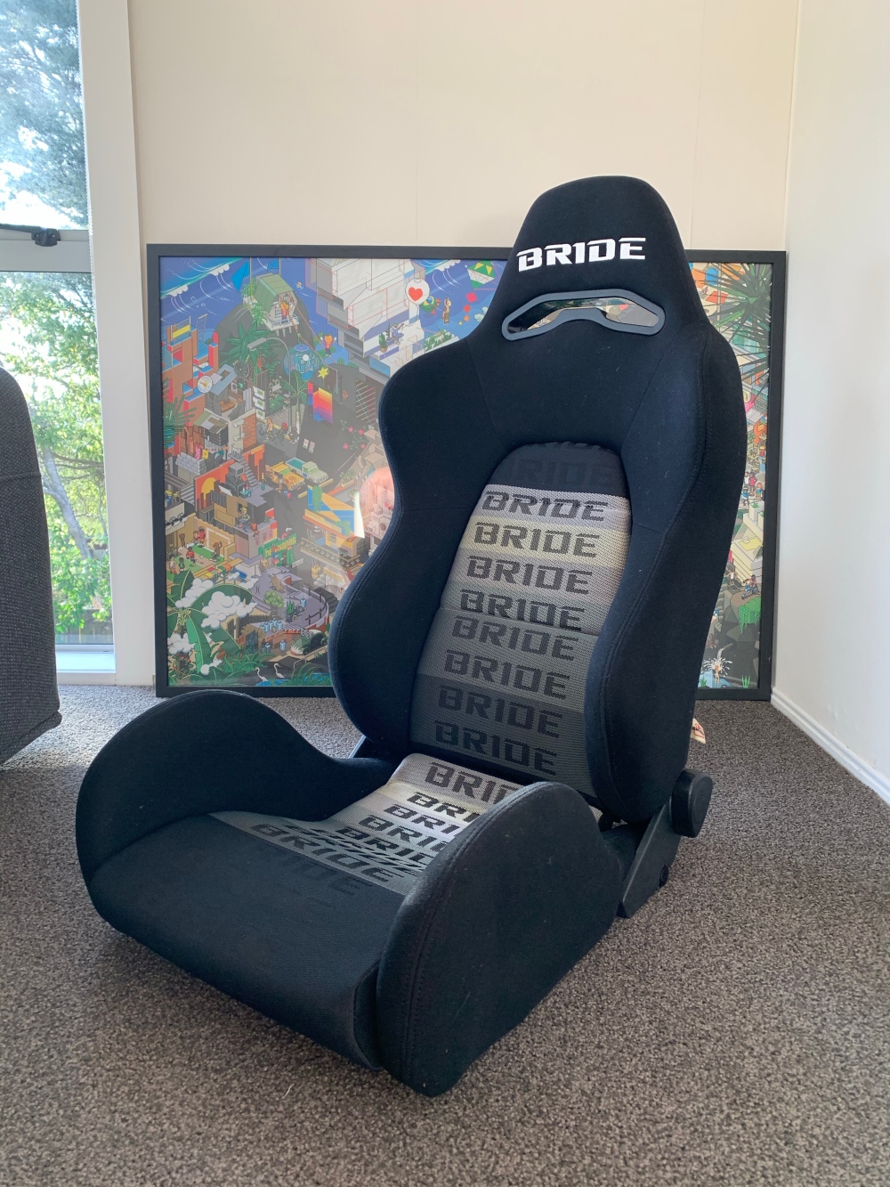

One thing I have picked up recently which I'm super stoked on is a Bride Ergo2. I loved my Brix2 in the 180, I was initially put off by the graduation on the Ergo but I've since discovered the middle cushions and lower seat are very easy to remove, so they're going to get recovered in a black perforated fabric asap.
I think the Zeta3/Ergo2 combo should look awesome.
