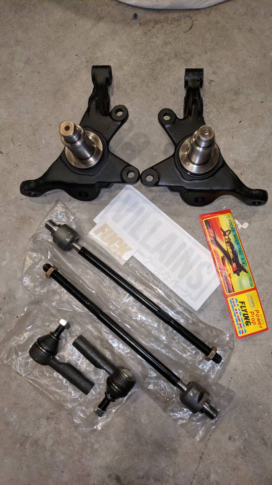

Another thing that I forgot to mention, I do have a Villains Drift Angle Kit. Nate Schewchuck out of Walla Walla, WA extended my LCA's and modded the knuckles. I'd recommend the kit for anyone that needs a quick angle kit. In the near future I'd like to get roll center correction, maybe Heatmaker or just get a set of PBM cast knuckles?
http://i.imgur.com/2wBrQQF.jpg
http://i.imgur.com/RiEEpl2.jpg

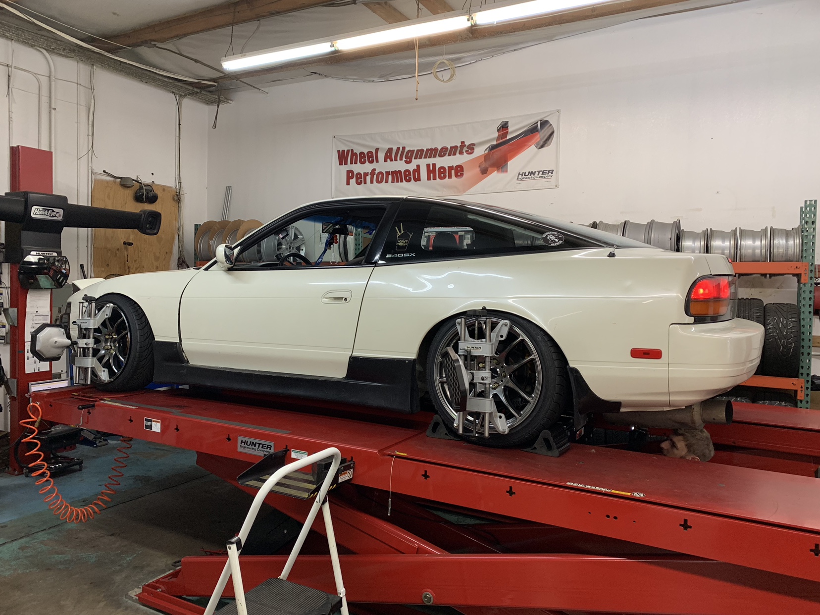

Current alignment is at this.
http://i.imgur.com/IeYE4kJ.jpg

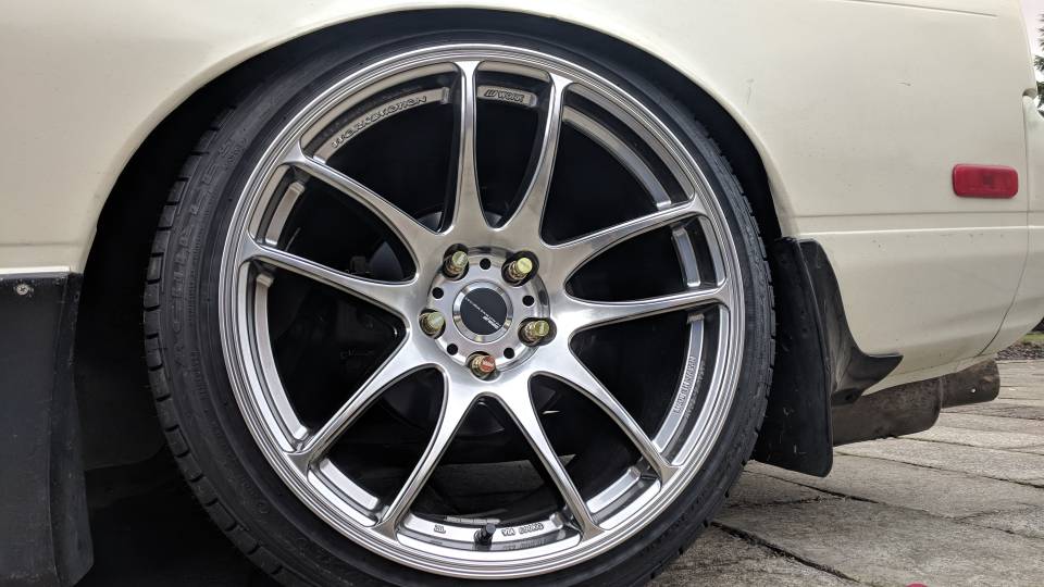

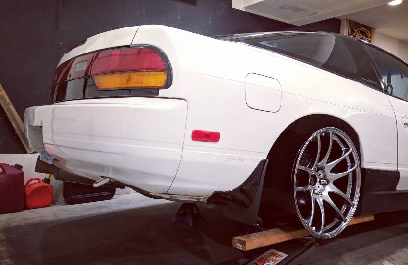

Wykydtron 11-04-2017 02:52 PM

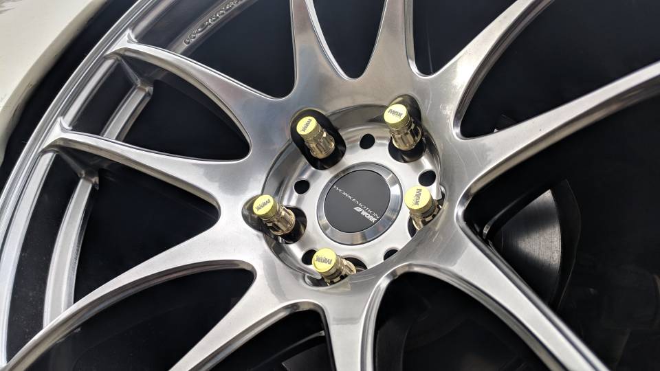

Time for winter build things.

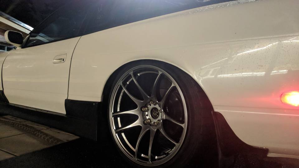

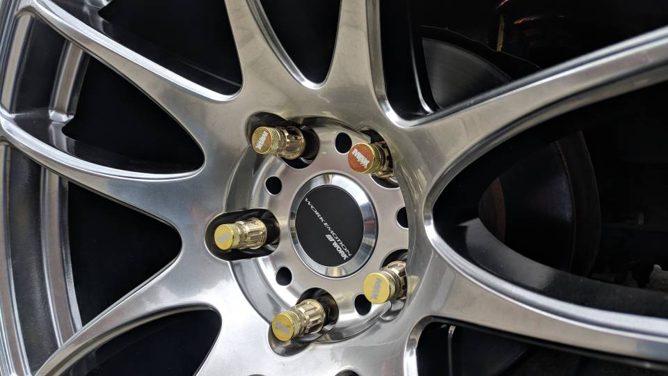

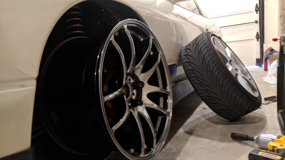

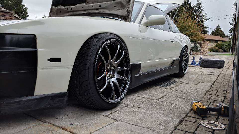

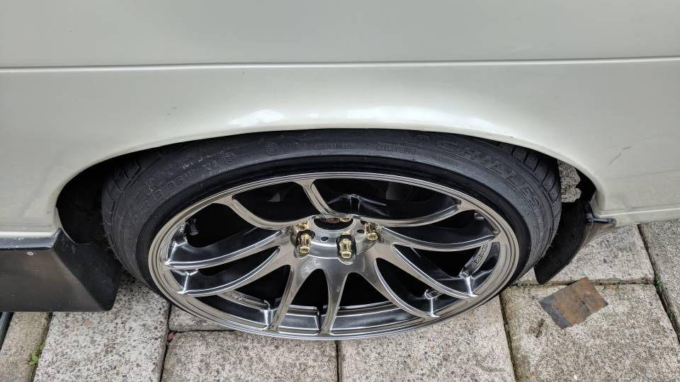

Bought CR Kiwami Ultra Deep Concaves. 18x10.5 +22 +15
https://i.imgur.com/fiyk1bW.jpg
https://i.imgur.com/SJAwJIl.jpg
https://i.imgur.com/Eguctfm.jpg
https://i.imgur.com/e4KH1Ie.jpg
https://i.imgur.com/YKoSyTO.jpg

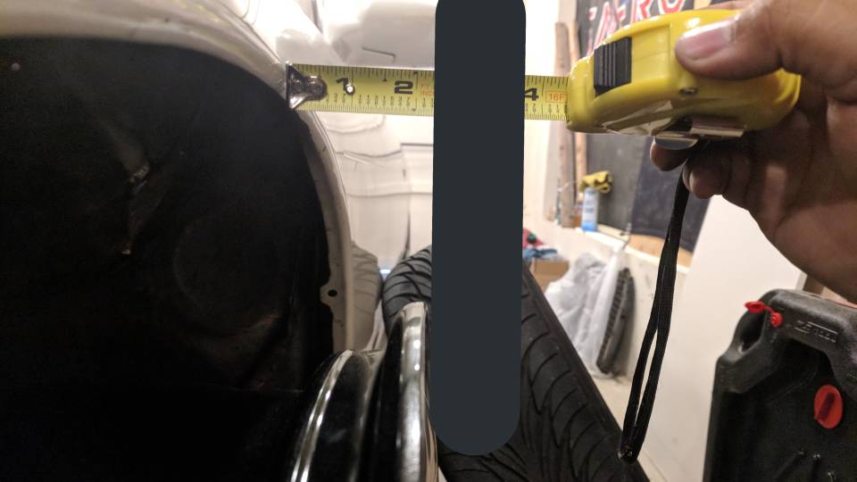

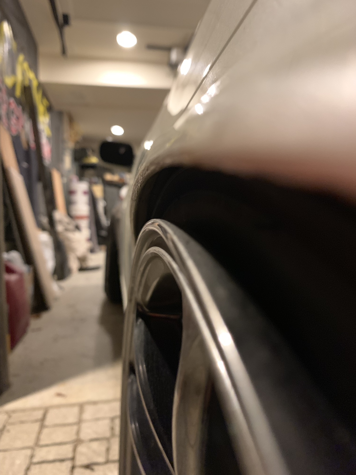

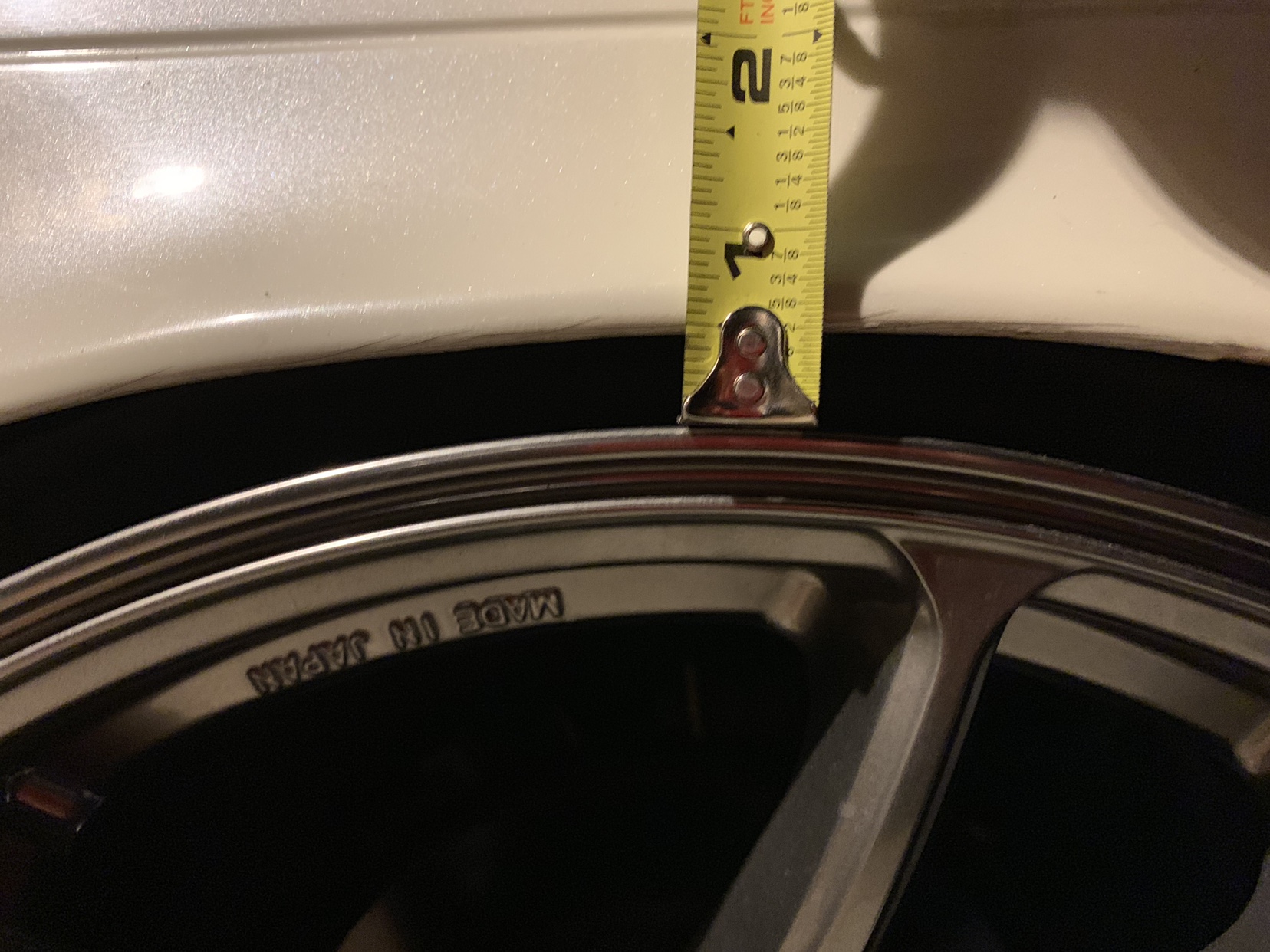

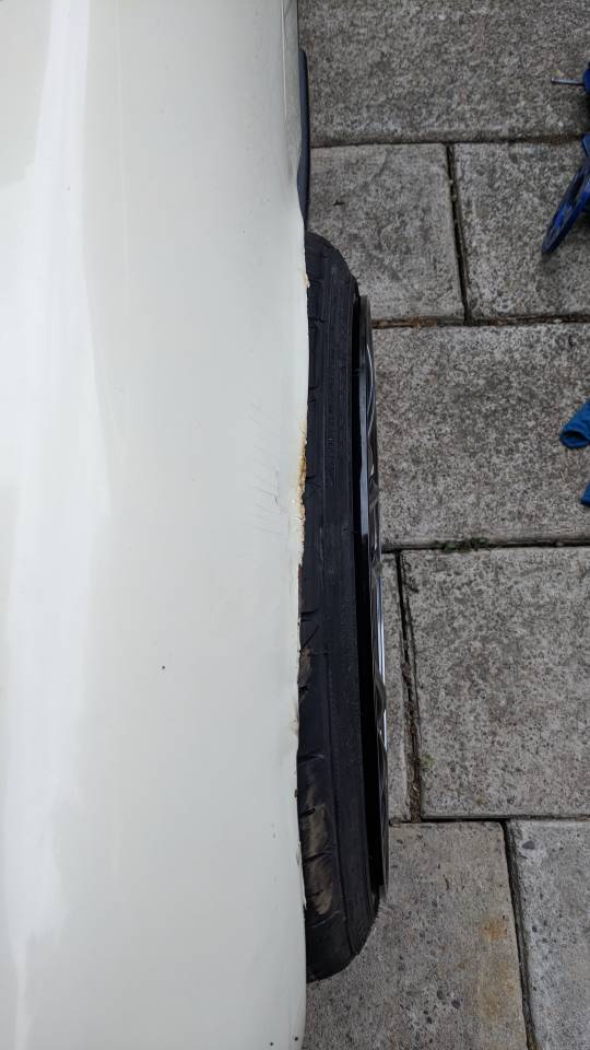

Here is how far they stick out with OEM fender. 18x10.5 +22. I have the Villains Drift angle kit, which includes 40mm extended LCA's. I have to use a 1 inch spacer to clear the coilover. I will get fenders later this winter.
https://i.imgur.com/uQwCgRD.jpg

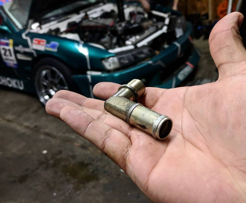

Today I discovered one of the small coolant lines from the throttle body had a pinhole leak. I dropped the alternator, starter, and oil filter to make clearance to drop the lower intake plenum on the KA24DE. I went and deleted the excessive vacuum and coolant lines. I used JB welded and vacuum nipples to cap off the lines I didn't need.
https://uploads.tapatalk-cdn.com/201...13bc32d2ab.jpg
https://uploads.tapatalk-cdn.com/201...0ecec2fa00.jpg
Sent from my Pixel XL using Tapatalk

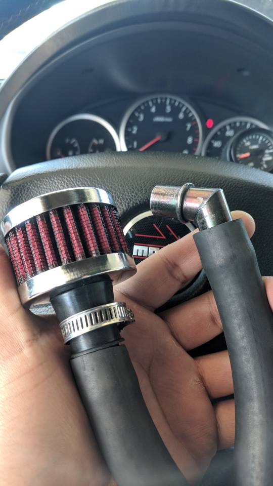

Needed the valve cover breather for a catch can. I lost mine. Zach Farrar had a spare laying around.
I'd be buying more car parts for the hatch, but I'm currently saving money to get into a new house (renting). That's putting me behind, but in the long run it should work out. I'm limited on space for storage, even with a storage unit... It would be better to get rid of my storage unit and have a bigger garage.

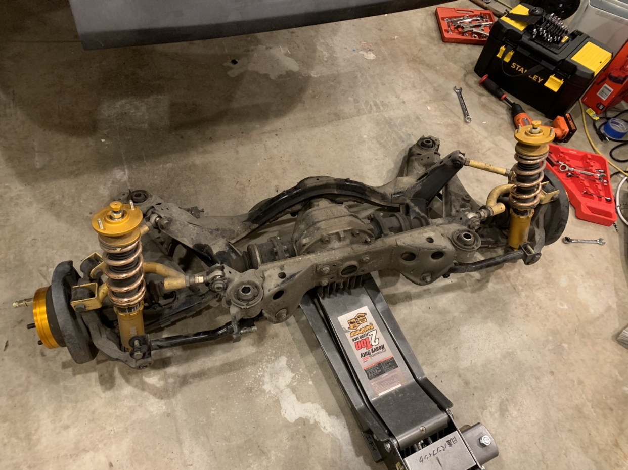

Wykydtron 01-27-2018 08:55 PM

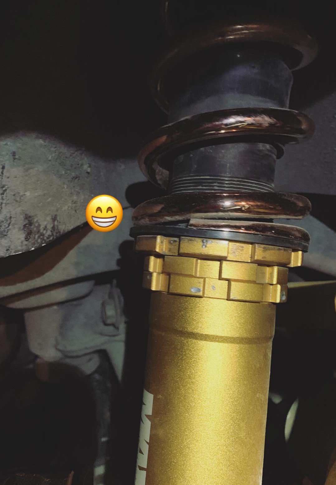

4 Attachment(s)
This morning I had to swing by Harbor Freight to buy a 2 ton low pro jack to replace my dead floor jack. It made it a lot easier to lift my chassis.
I went through and adjusted the coilovers to an ideal height. My driveway is BAD for low car. I was tempted to go more, but my front lip is already scraping like crazy.
I have my front coilovers 8 clicks from soft, and rears 3 clicks from soft. I decided to go with what PBM offers, 10k / 8k springs. While I was setting these up, I realized that this is probably the heights I can set the rears... So drop knuckles will be in the near future [emoji102]
Next up... Drift spares, RS Enthalpy tune, fiberglass, more tires.

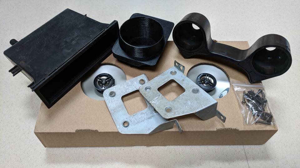

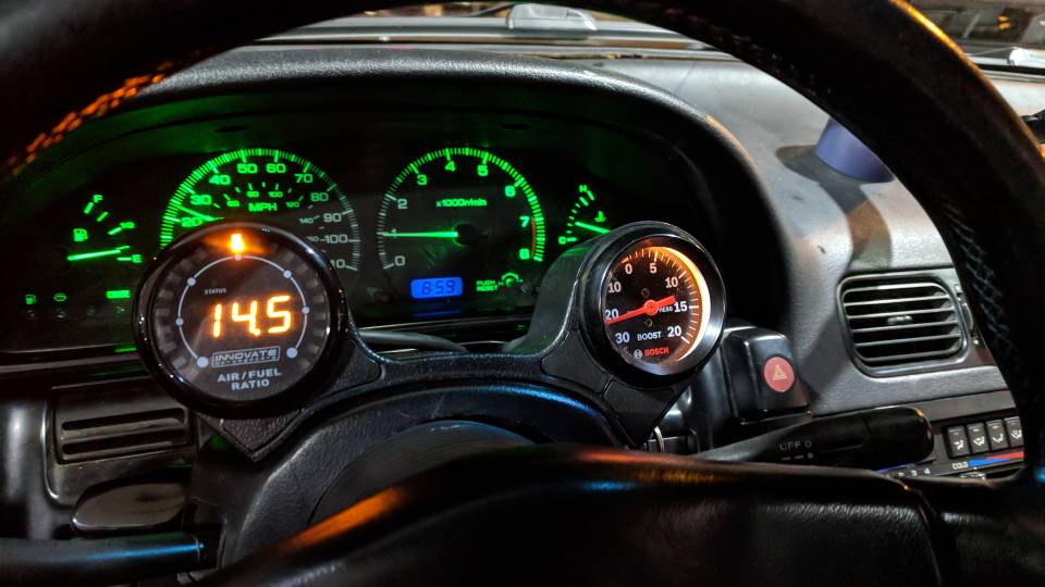

Ordered stereo brackets, CD tray, ashtray cup holder replacement, Mickey Mouse gauge pods, set of 6.5 speakers, and a Mishimoto radiator.
More wheels should be arriving this week.

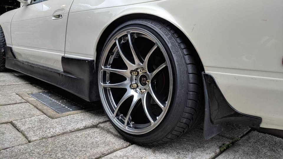

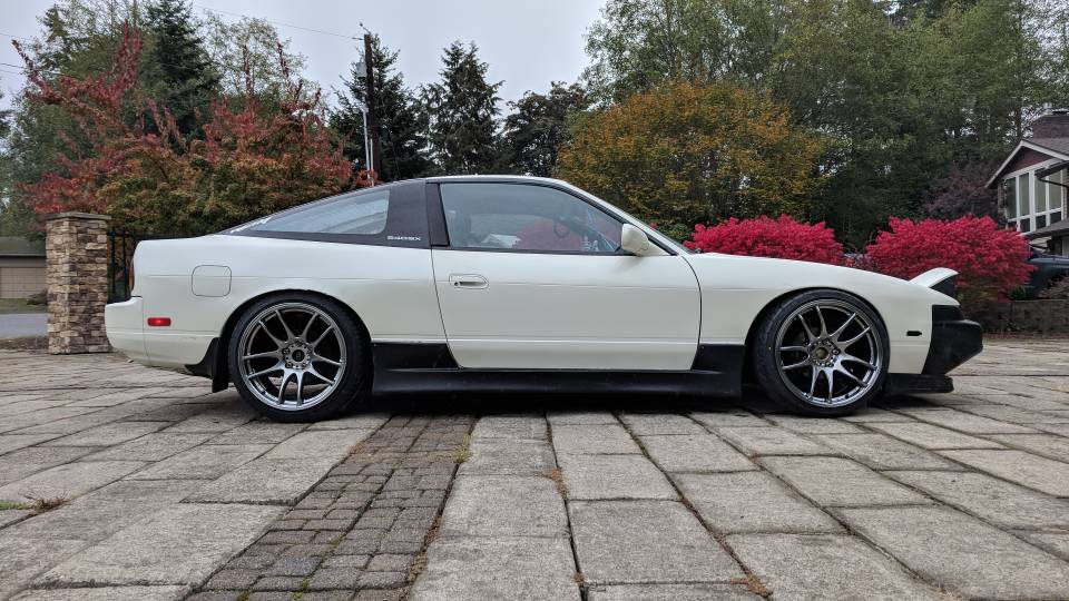

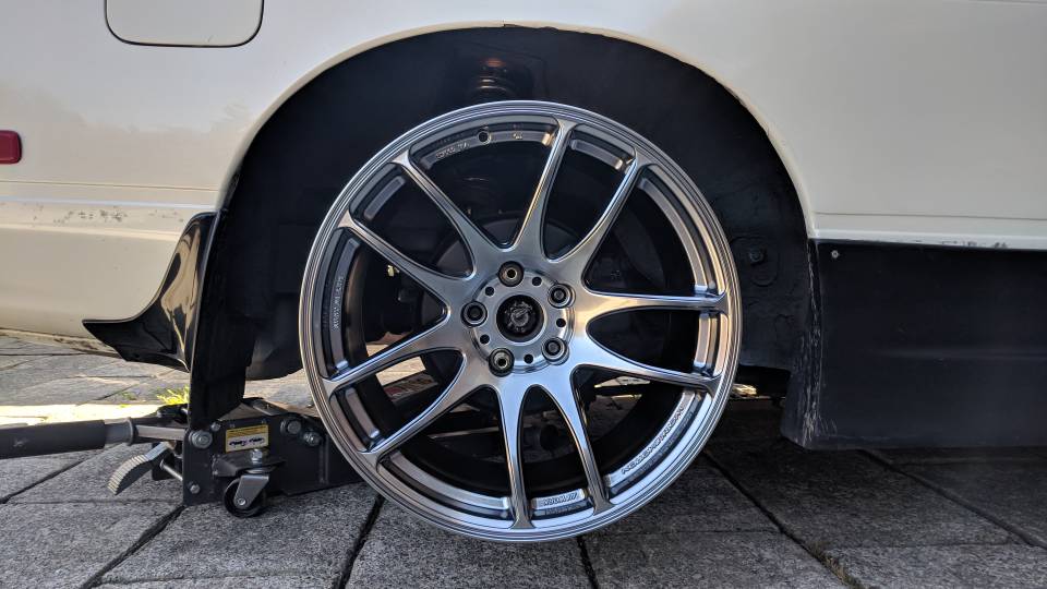

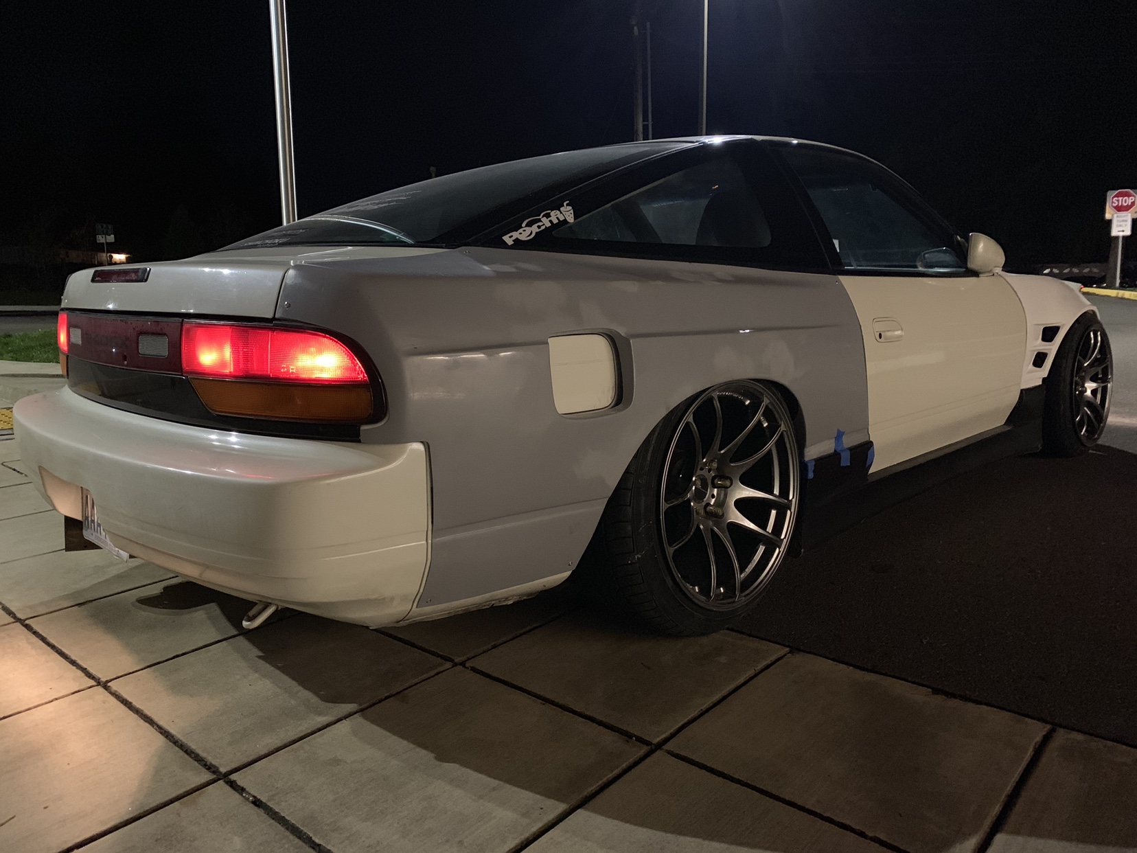

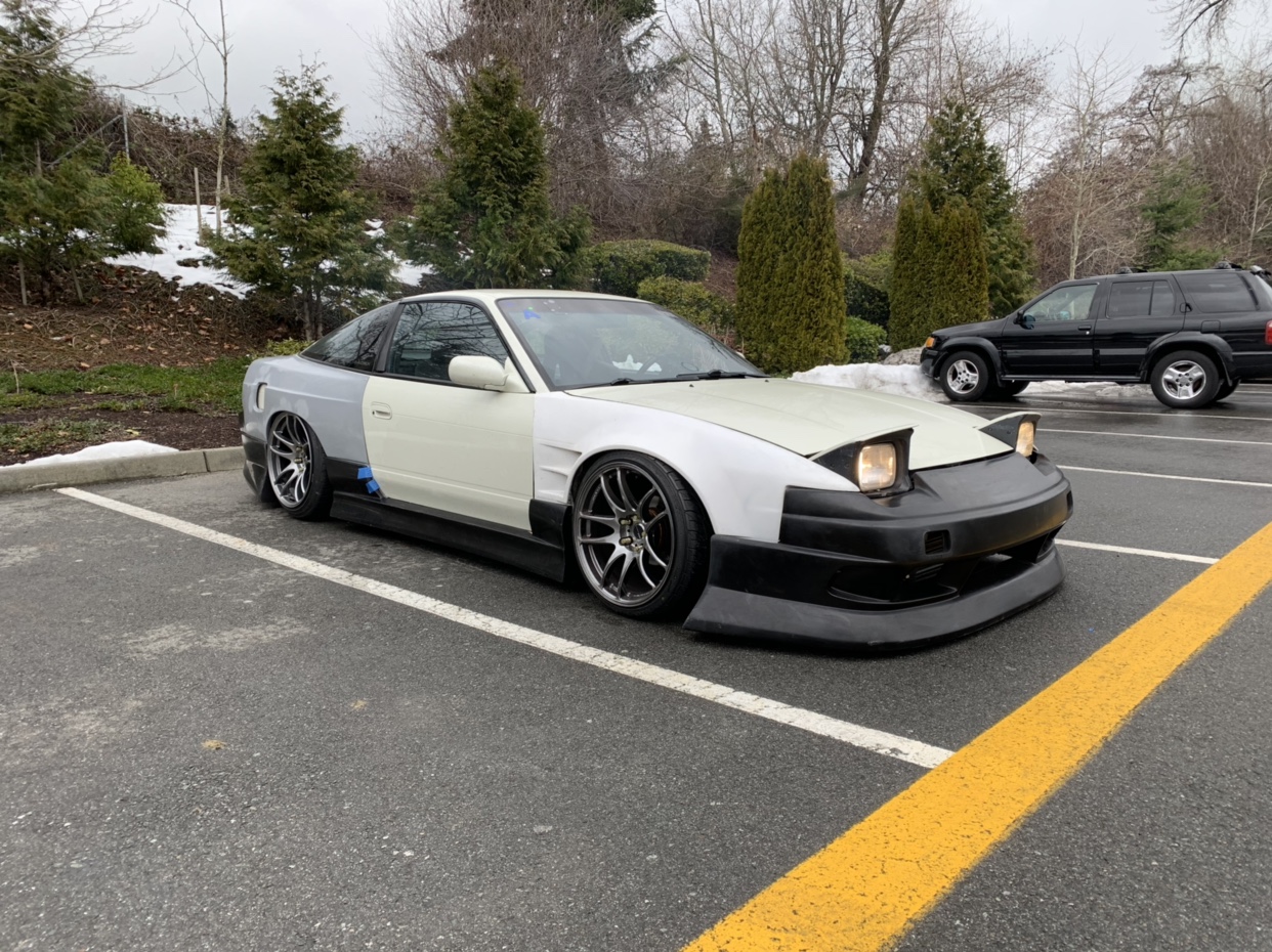

Just got a pair of 18x9.5j +20 CR Kiwamis in the mail. Fenders are ordered. I'll get 225/35/18 for these and get 235/40/18 for the 18x10.5j rears.
40mm LCAs and 1/2 inch spacer clears the street and brings the lip out a little over 2 inches.
https://uploads.tapatalk-cdn.com/201...5c14614525.jpg
https://uploads.tapatalk-cdn.com/201...eb46831cb6.jpg

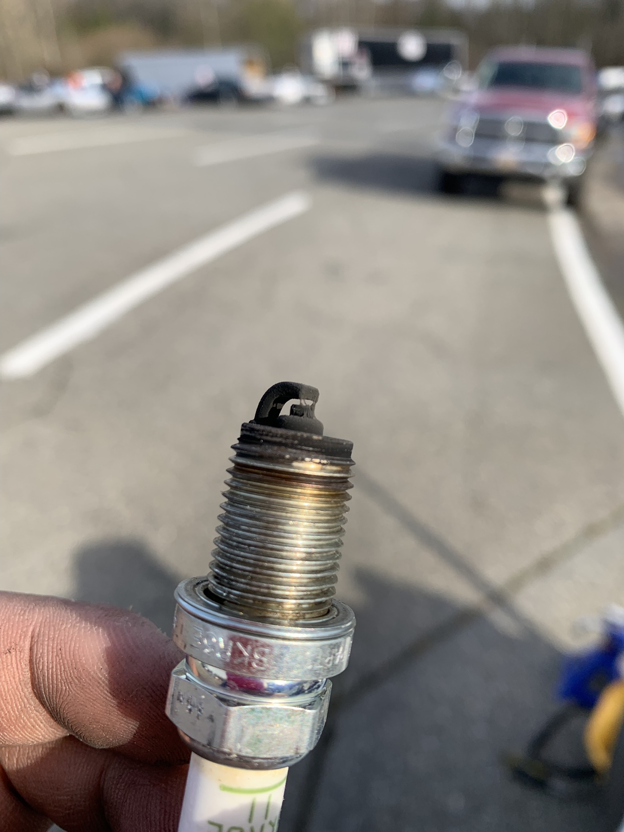

Another update I forgot to mention. My motor has hit 1200 miles since the rebuild. I've been mostly daily driving her around town and hitting up the skate parks. I don't commute with her since I work from home.
https://uploads.tapatalk-cdn.com/201...c1688a42f2.jpg
https://uploads.tapatalk-cdn.com/201...68ead2b1cb.jpg

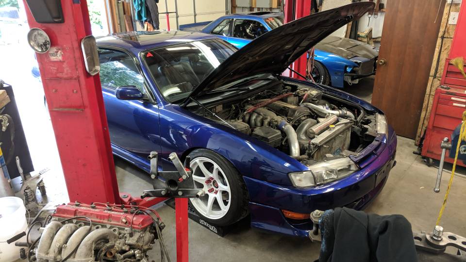

Few random photos from Patrick Healds shop. I bought all the A/C lines, compressor, brackets, evap, exchanger, and drier off Jim Heald. They were prepping a NASCAR 240. They threw in a bonus HVAC system and climate control (all the stuff under the dash).
Noah's coupe, he just threw on those AG wheels.
https://uploads.tapatalk-cdn.com/201...e8b8197d2e.jpg
Devon was working on his daily Kouki.
https://uploads.tapatalk-cdn.com/201...e62fdf7690.jpg
https://uploads.tapatalk-cdn.com/201...4037eac658.jpg

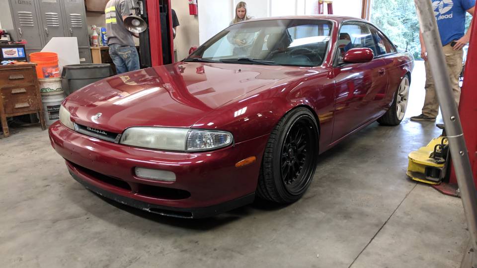

Alex's blue coupe is getting a new standalone and some wiring done.
https://uploads.tapatalk-cdn.com/201...4c5986da2b.jpg

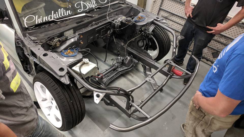

The tubed coupe is Devon's 240 with Silvia front. New tube front and painted bay.
https://uploads.tapatalk-cdn.com/201...1207bf5b91.jpg
https://uploads.tapatalk-cdn.com/201...4a22157e1f.jpg
And the Zenki is Patrick's daily.

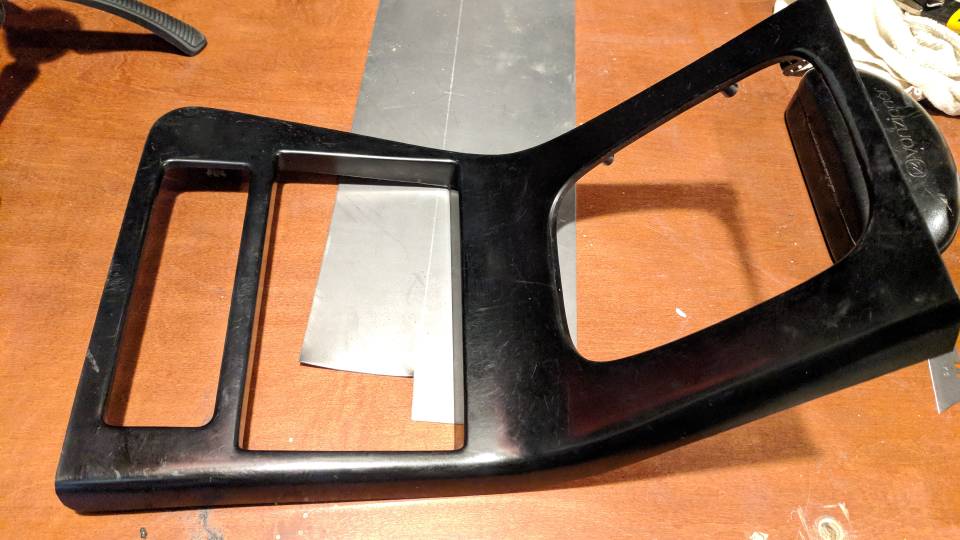

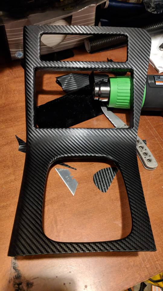

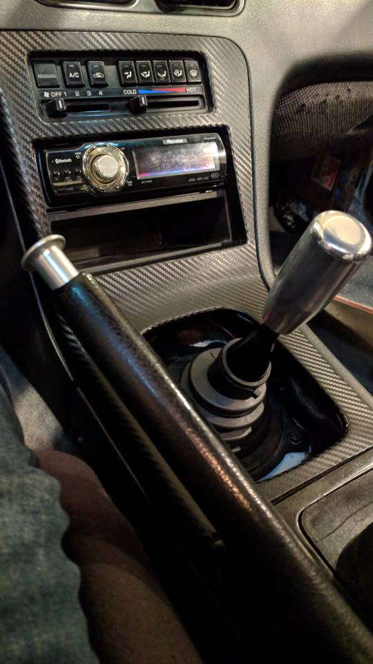

Decided to wrap the center bezel wince it was so scratched up. Not bad for my first wrap.
Side note: I need to pick up the plastic retainers for my S13's door sills. I bought the OEM S13 door sills that you normally have in the door jams since my shell never got those. The Nissan Parts number is 01553-06161 - they're not cheap. :/
https://uploads.tapatalk-cdn.com/201...40f64bd421.jpg
https://uploads.tapatalk-cdn.com/201...90dc5e8e72.jpg
https://uploads.tapatalk-cdn.com/201...1cf2f63e22.jpg

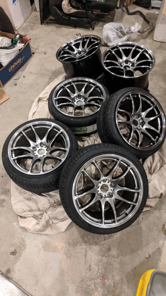

Wykydtron 09-17-2018 11:57 AM

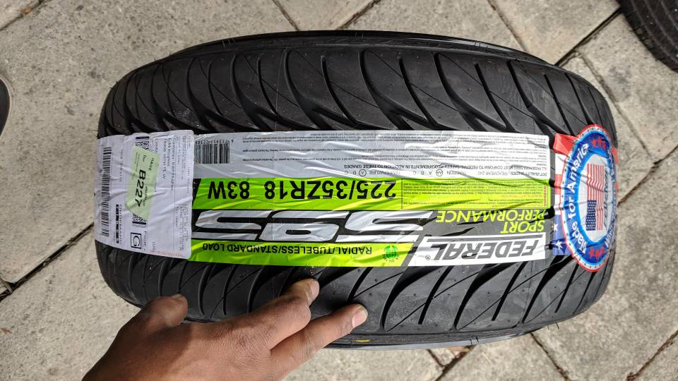

Going to order tires in the next couple of weeks.
225/35/18 fronts on 18x9.5j
235/40/18 rears on 18x10.5j

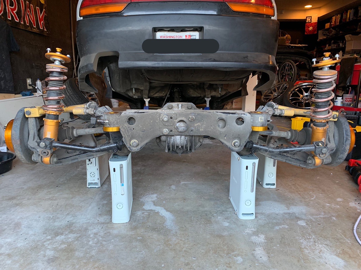

Yesterday I pulled my old driveline to replace it with another used one. After I pulled my old driveline I found out what was vibrating. The U-Joint was rattling, which probably caused the vibration and knocking noise when I came to a slow stop.
I can't believe how big of a difference a balanced driveline would make, but my car feels like a stock daily on the freeway now. Plus I can see through the rear view mirror.

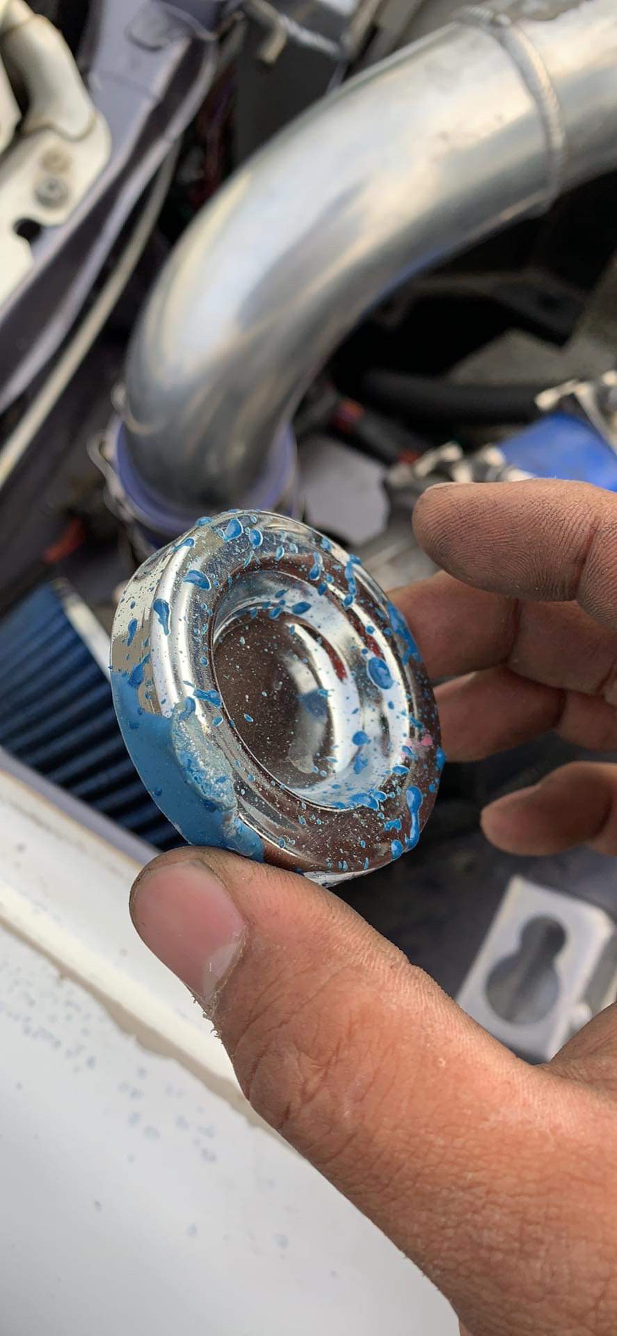

I don't have an oil catch can, and this being my first event in a freshly built 1200 mile, freshly tuned KA-T - I didn't want to risk spraying the bay with oil. Pardon my Hoonigan Bonus inspired catch can.
https://uploads.tapatalk-cdn.com/201...132bb4104a.jpg
https://uploads.tapatalk-cdn.com/201...8ae05ba970.jpg

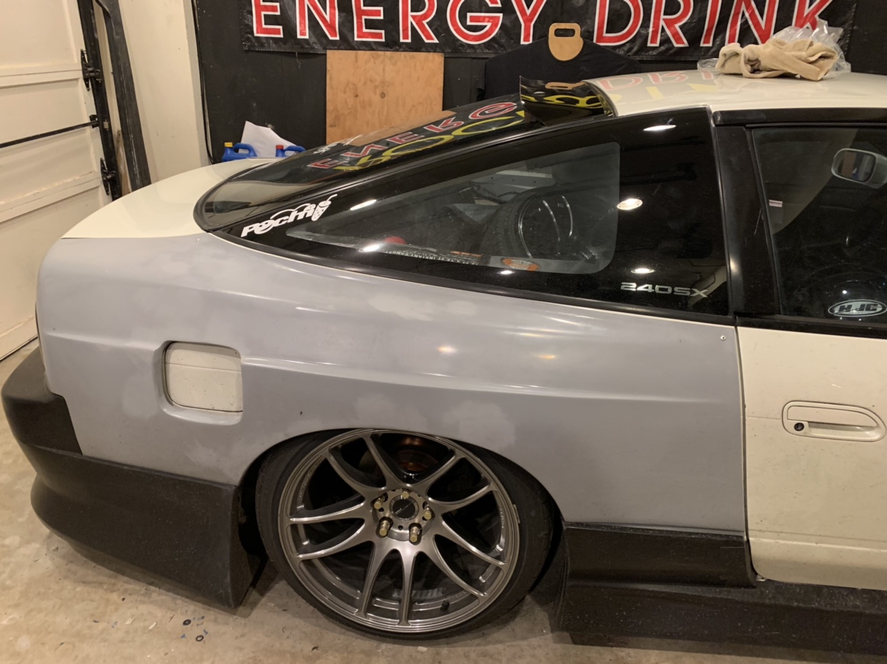

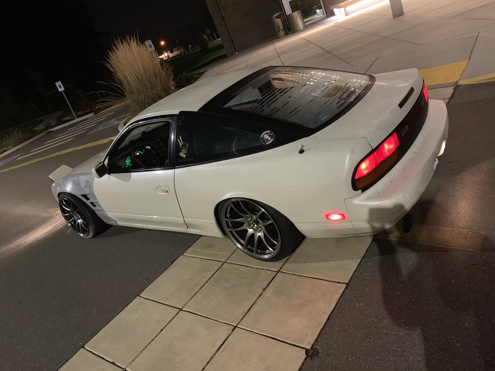

Meanwhile Sunday morning rolls around. I'm sore af and running off of 5 hours of sleep. I am determined to fit my wheels on my Schassis.

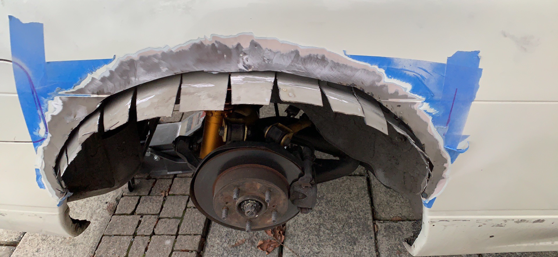

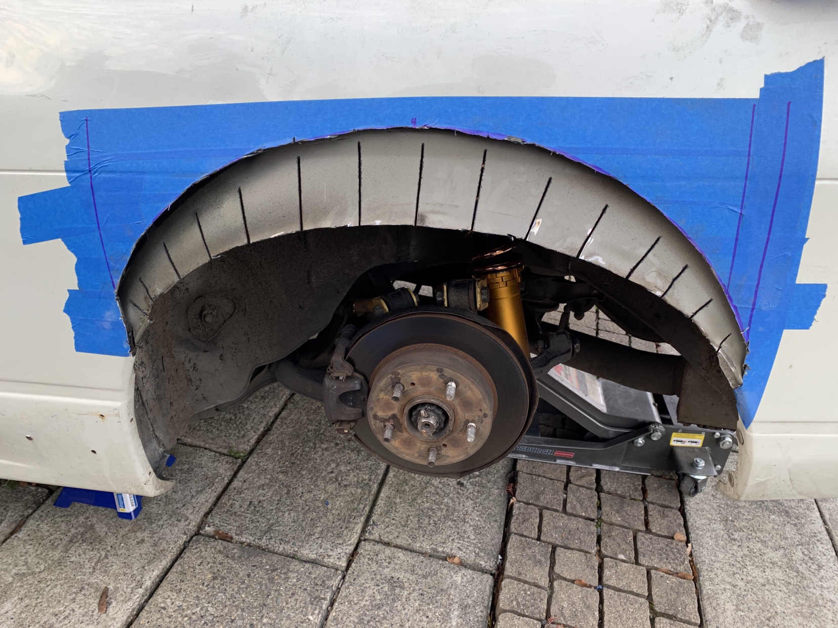

I was really sad to not have my type 3 fenders and I decided to go for it and roll my fronts. That proved to be pretty difficult. I also didn't like the monster truck stance, so I decided to drop the rear a full inch.*

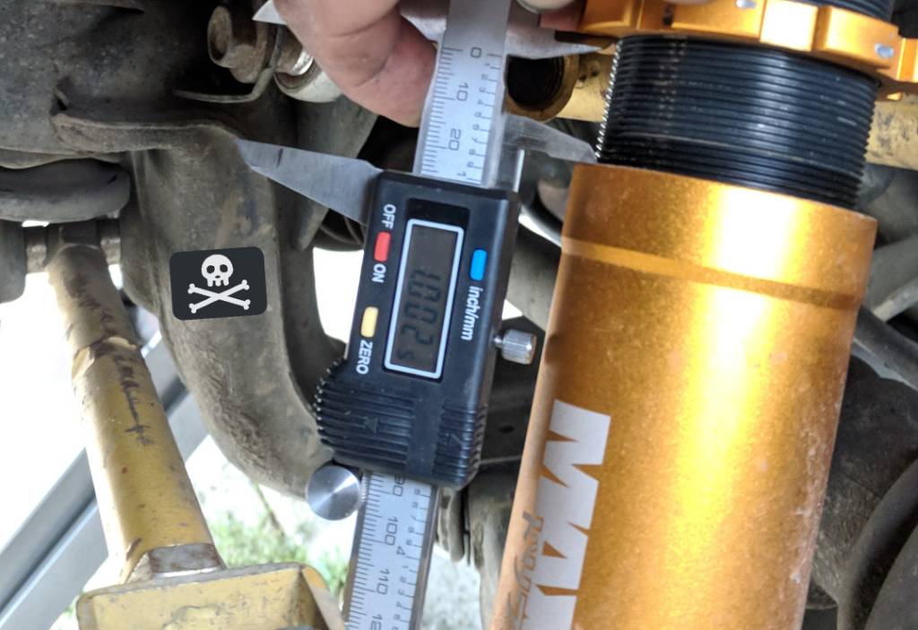

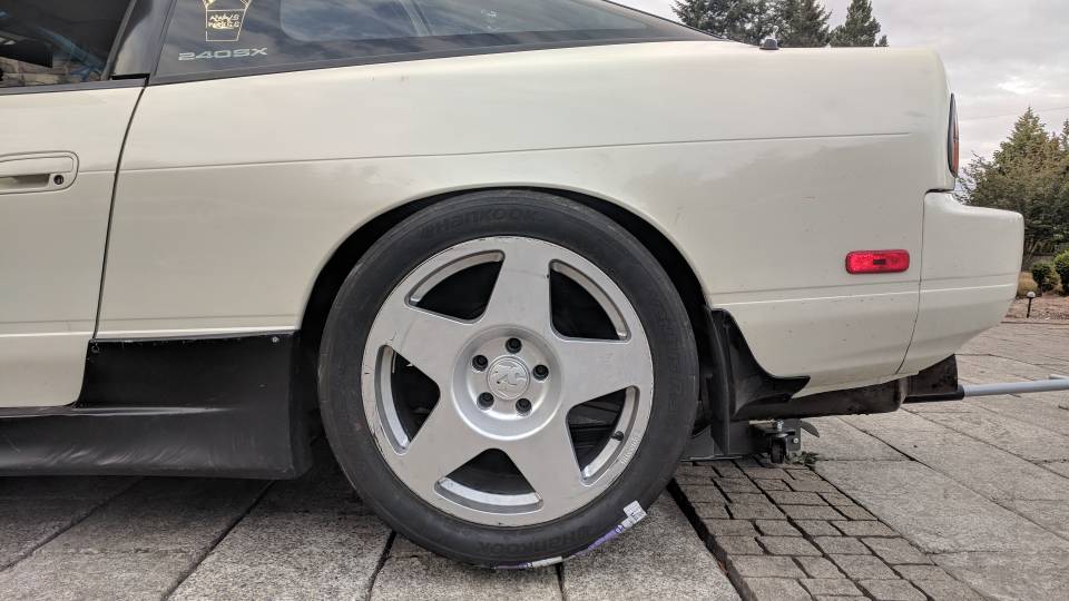

Images below are before I roll the front fenders and lower the rear.*NOTE: 39.5mm between the preload collars and the ride height collar.

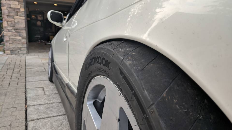

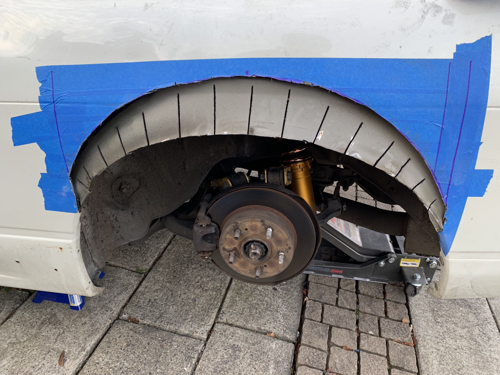

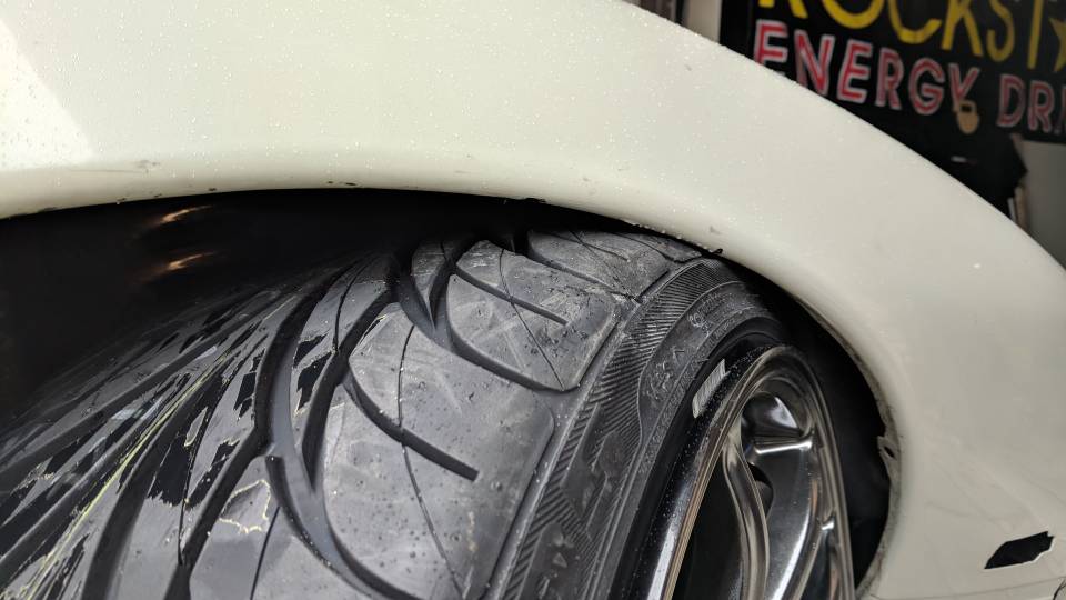

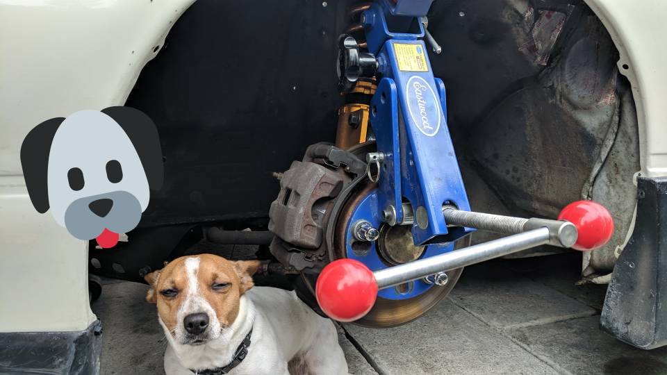

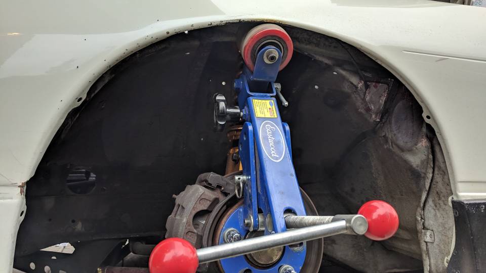

Rolling the front fenders was a long and painful process. This was the first time I have ever rolled fenders. My driver side was burnt from the rubbing (test run). My passenger side fender turned out great.
https://uploads.tapatalk-cdn.com/201...0bf9916aef.jpg
My doggo Dia wanted to help me with the fender roller. As soon as I pull the camera out to take a photo of her, she acts like I'm about to spank her... haha
https://uploads.tapatalk-cdn.com/201...4a0a522dda.jpg
https://uploads.tapatalk-cdn.com/201...6551402816.jpg

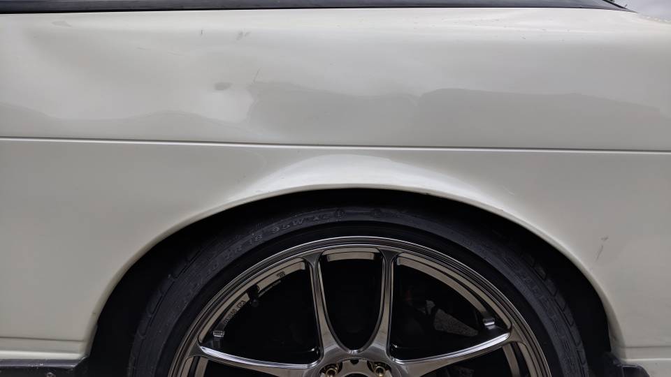

As you can see, from my test run the tire rubbed and burnt the edge of the lip. It's unfortunate I couldn't get the driver side fender to look nicer. But atleast it won't rub anymore. The photo above doesn't do it justice.
https://uploads.tapatalk-cdn.com/201...5d98ef7ec2.jpg
Above is a before photo of the passenger side fender.
https://uploads.tapatalk-cdn.com/201...0235e86f19.jpg
Photo above you can see I was able to get the passenger side fender to look decent.
Wykydtron 10-01-2018 09:03 PM
https://uploads.tapatalk-cdn.com/201...17295ad533.jpg

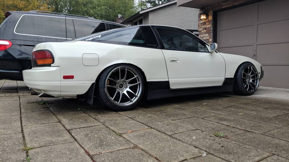

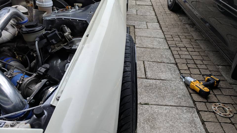

The photo above is before I lowered the car an inch. Standing back from the car it was pretty gross looking. If you look closely the waves in the rear quarter were actually from a previous incident.
https://uploads.tapatalk-cdn.com/201...6b9100e1af.jpg
By the end of the night I had the front fenders pulled and I lowered the rear an inch. I only rub on the passenger side, I may need to hammer deep in the fender well on the hump that forms in the center of the tub.
https://uploads.tapatalk-cdn.com/201...a174afe819.jpg
https://uploads.tapatalk-cdn.com/201...14491d4b7c.jpg

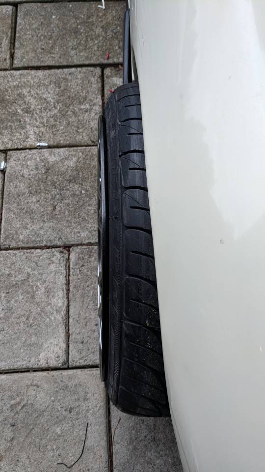

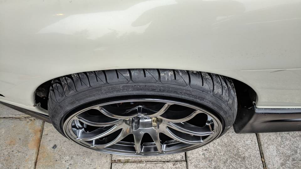

Don't mind the reverse rake... The car cannot physically go any lower in the front. I have Type 3 over fenders on order. I'm hoping to receive those later this month.
I am still having rubbing on the driver side rear fender when I hit big bumps. I'll have to hammer out the bump that forms in the inside wheel well. The front wheels rub the tubs at full lock. I will need to do some full lock "testing" and then take my hammer to those spots.

https://uploads.tapatalk-cdn.com/201...0de0ca2ddd.jpg
My car is in an awkward stage right now, but I'm happy I can drive it around and do hood rat shit. I will get 2 more tires ordered for my drift spares.

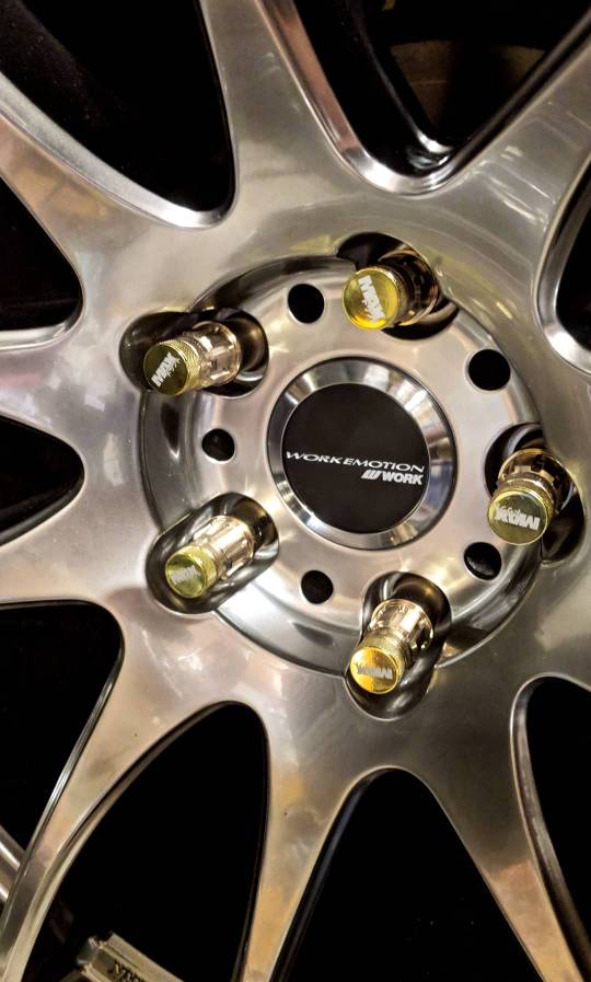

Wykydtron 10-10-2018 12:02 AM
Idk if you're supposed to use blue thread locker on lug nut end caps, but today I bought some. Why you ask? As media, I find lug nut end caps all over the middle of speedway. These go on hand tight, and I'm not about to use a crescent wrench on them to tighten them down.
Aside from the end caps, I spoke with Tommy from PBM and he recommended I start using anti seize grease on my lugs since I stripped 2 of them.

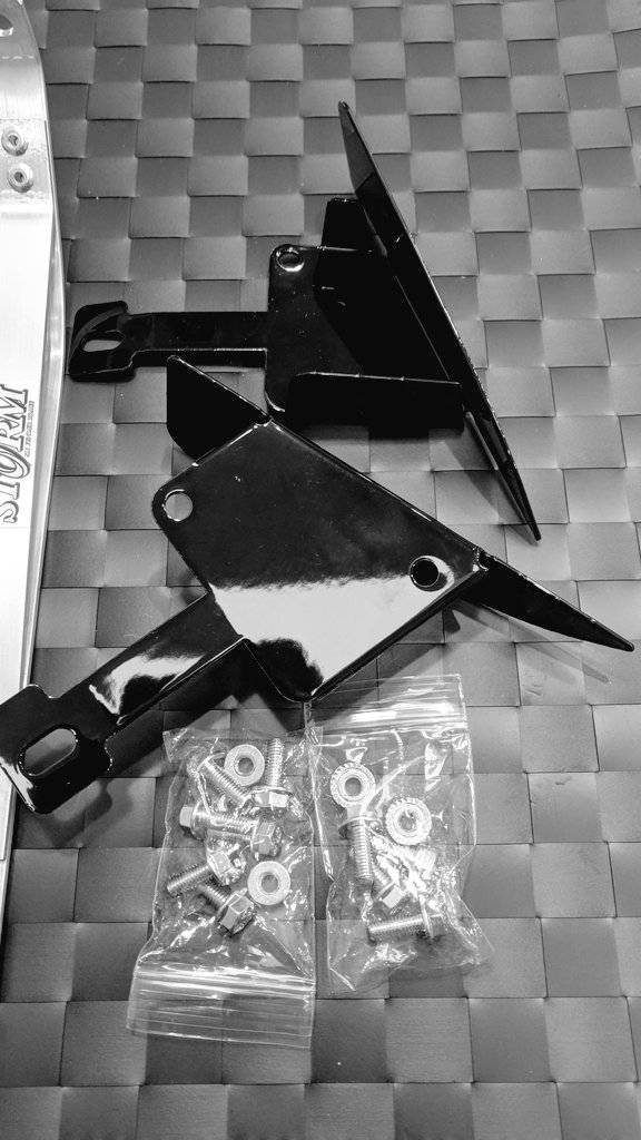

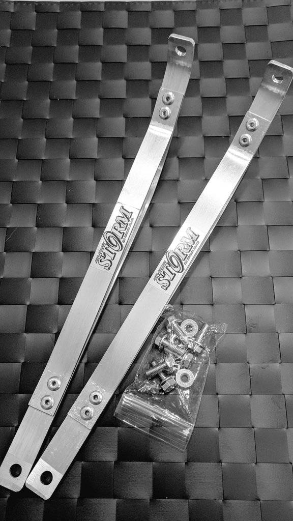

It looks like my Auto-CollectStorm bumper guides are in the mail. I also ordered the lower fender braces. Unfortunately I won't be ordering my body kit until after I get my suspension and clearances sorted. I want to get seat time this winter season!

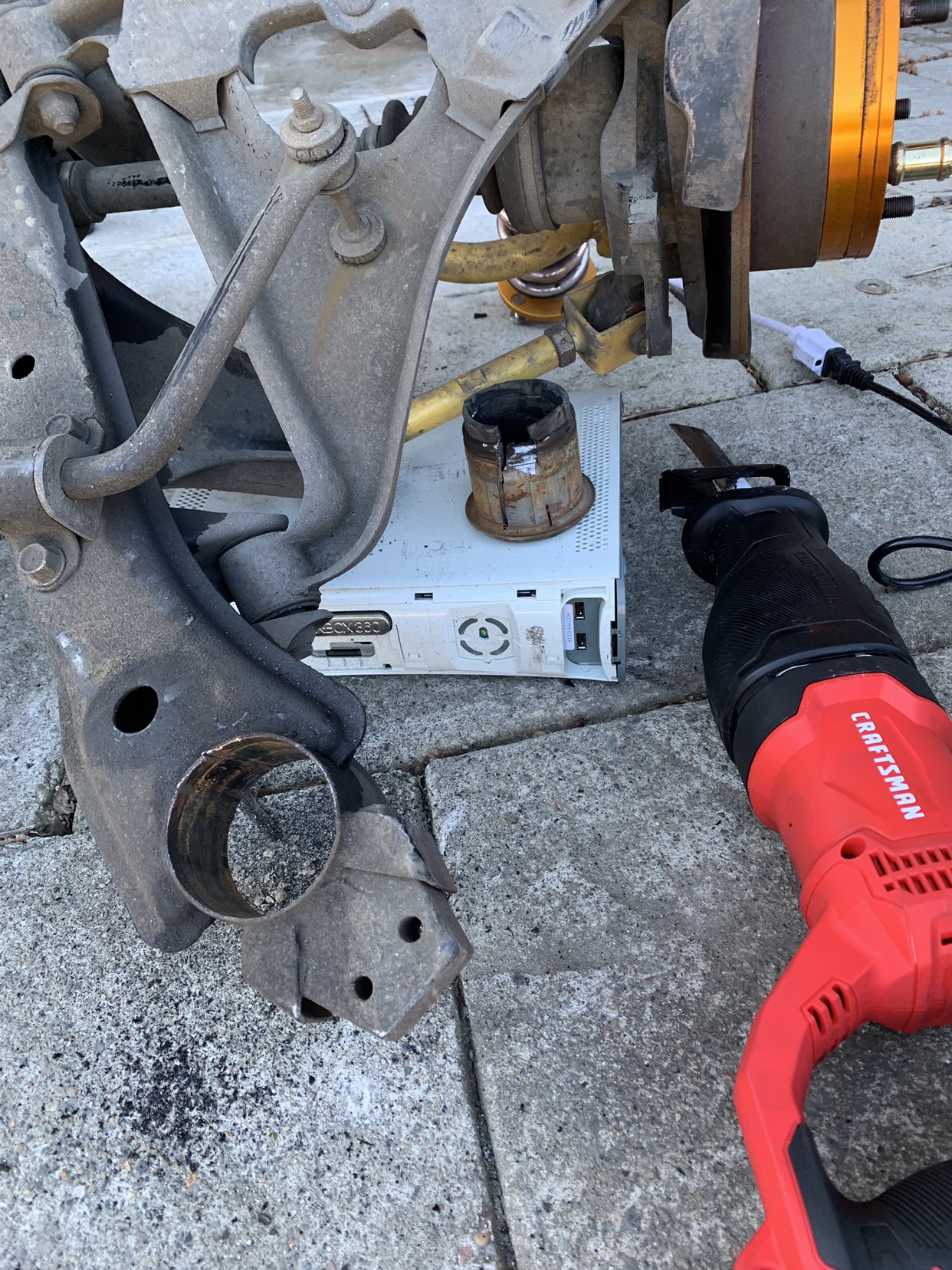

Friday night I got a my refreshed Villains knuckles in the mail and installed the new 50mm toe rods with machined in spacers. Along with that I installed my GKTech rear toe arms.
https://uploads.tapatalk-cdn.com/201...1f66d75330.jpg

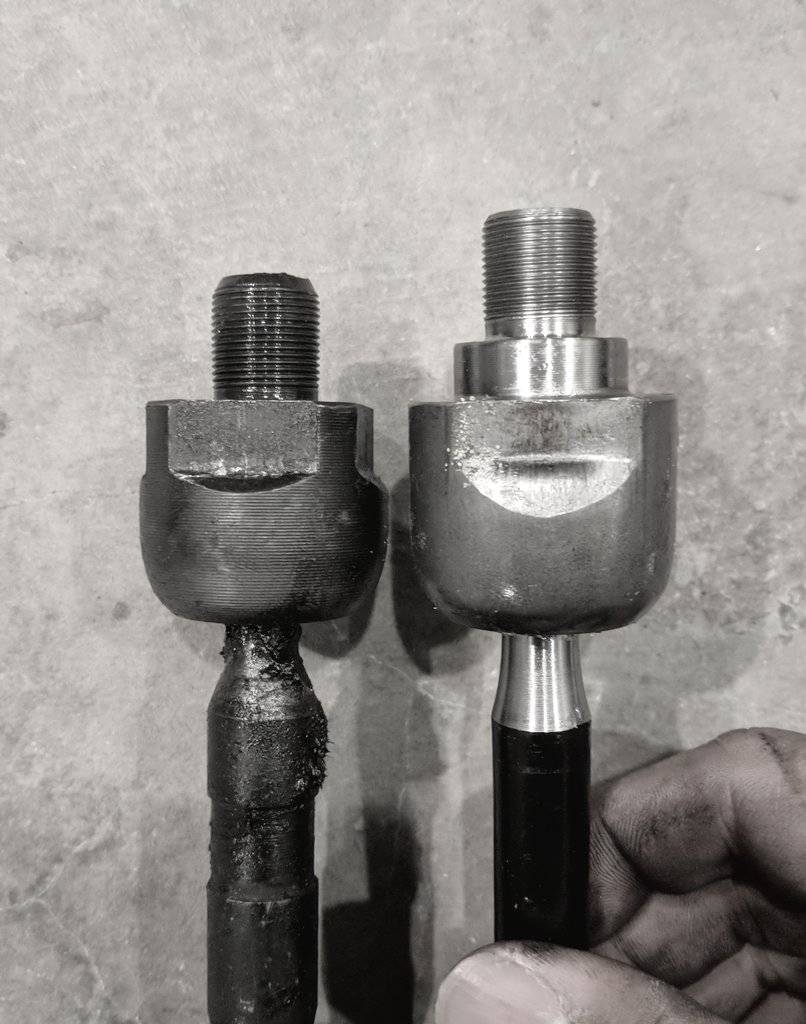

Below is the difference between the original inner tie rods that came with the older version Villains Angle Kit. It's a Maxima inner tie rod (from what I recall). The Villains now sell the kit and the tie rods optional with built in rack spacers. That extra machining allows the tie rod to go into the rack further but without losing theads.
https://uploads.tapatalk-cdn.com/201...840e8af507.jpg

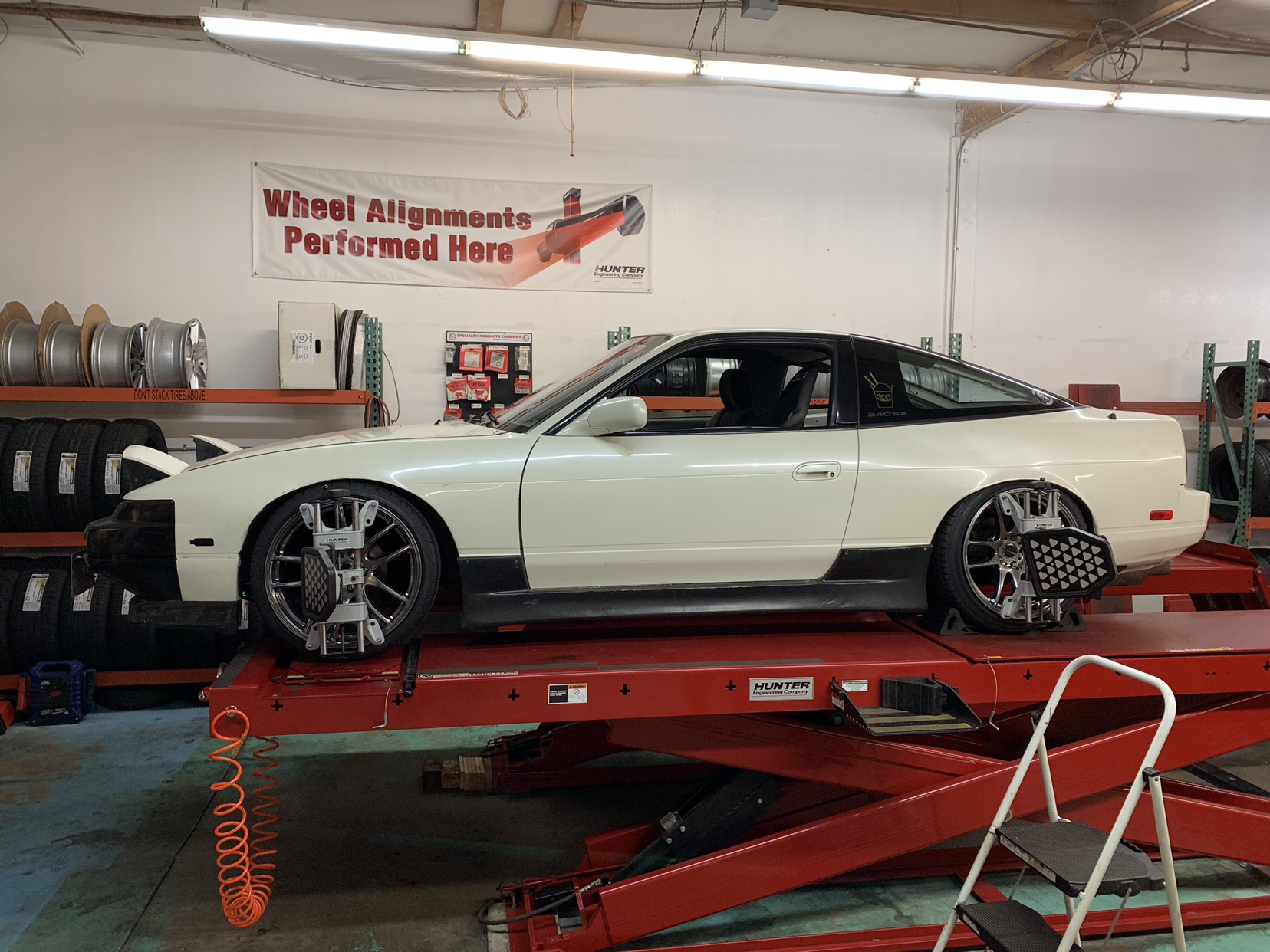

I brought my hatch into Hankook Tires Lynnwood where Kevin aligned everything to the best he could.
https://uploads.tapatalk-cdn.com/201...f75242ed88.jpg
https://uploads.tapatalk-cdn.com/201...f94c4b80b7.jpg

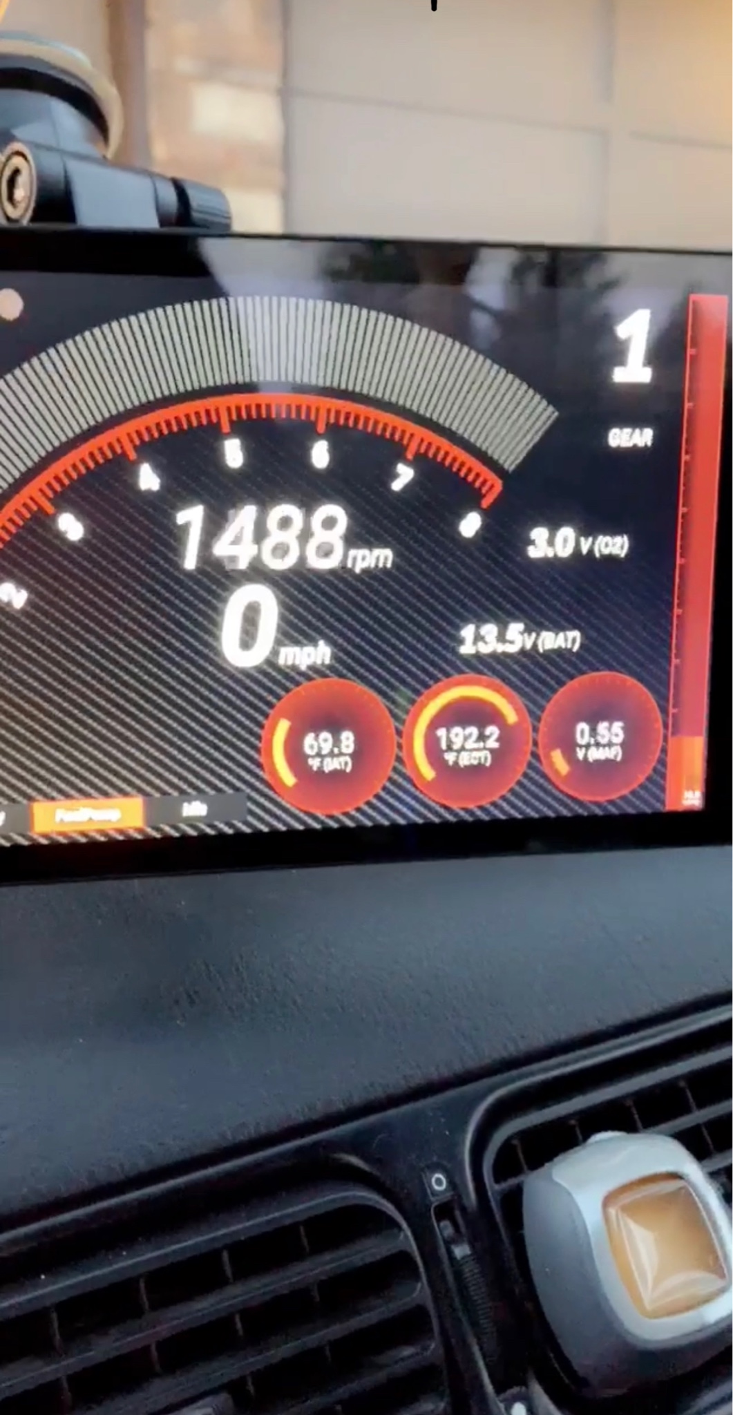

I also received the Nismotronic Bluetooth module in the mail. I connected it to my tablet and bought the license for TunerViewer. This app can display a wide variety of parameters and also datalog on the fly.

I also received my order (care package) from Autocollect Storm. I ordered the 180sx bumper guides and the fender braces. I should be betting my front fenders soon and maybe a body kit in before spring? We'll see...
https://uploads.tapatalk-cdn.com/201...eb081bdf8c.jpg
https://uploads.tapatalk-cdn.com/201...091dd27624.jpg

I freaking love the PNW on days like this. I finally got her dialed on clearance and have it setup for the rest of winter season. I'll be picking up fenders tomorrow.
Man it's a good feeling to drive to the track, put in a full day of driving, look at the rears and say "meh" and drive back home. I'm probably the minority but I don't mind having low HP. I could go for a little more to keep these 235/40/18's spinning.
‪Next time it's dry, I'm going to air up the rears to 60psi and go full speed into the 3/8ths to see if I can simulate what my NA KA on 17's could do. I had a little to much grip when it dried out today. [emoji848]‬

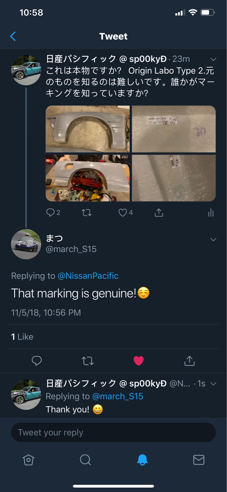

Sooo... Drove to Bellingham tonight. My friend Paul sold his mint hatch to a guy in Colorado Springs. Paul just got his Origin Lab fenders in a few weeks ago... Since he sold his hatch, he sold me his Origin Type 2 fenders!
https://uploads.tapatalk-cdn.com/201...effa3b0a2b.jpg
https://uploads.tapatalk-cdn.com/201...8f9122ff43.jpg
https://uploads.tapatalk-cdn.com/201...b3b5dcc9b6.jpg
https://uploads.tapatalk-cdn.com/201...5cb6cce358.jpg
https://uploads.tapatalk-cdn.com/201...d916a075aa.jpg

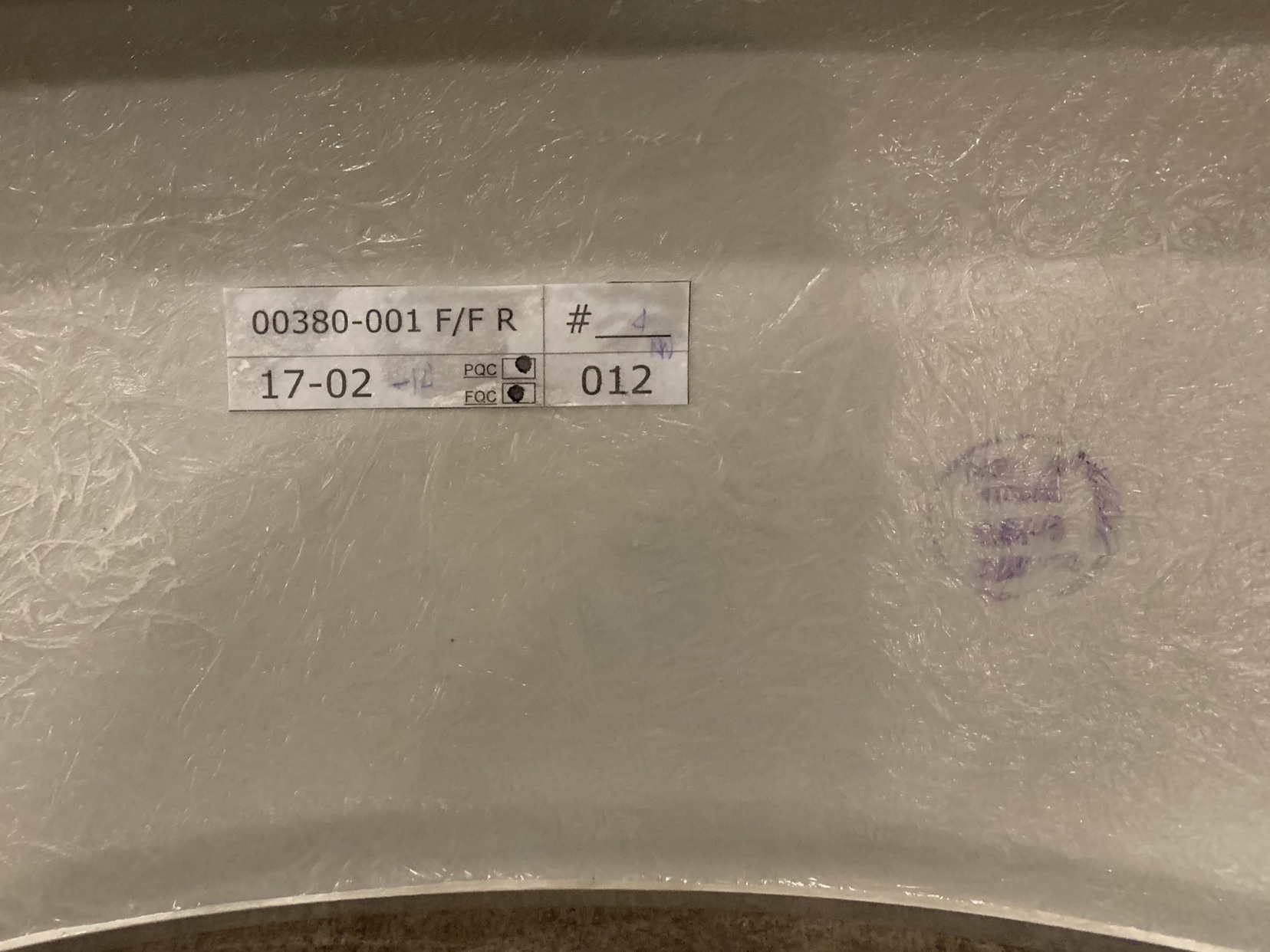

And if anyone is curious, I asked around Twitter if anyone could confirm authenticity.
https://uploads.tapatalk-cdn.com/201...bd4438b5d3.jpg

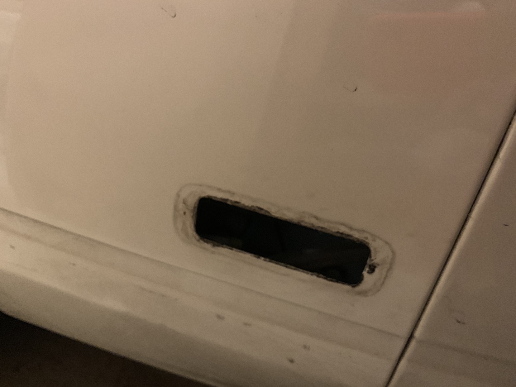

Last night I was pretty drunk at my friend Charie Touche birthday. I started screaming "my car isn't low enough" in front of the bar and my gf about slapped me. Rightly so, she should have for not making it lower.
https://uploads.tapatalk-cdn.com/201...82e61da89f.jpg
I decided to get off my ass today and do something about it.
https://uploads.tapatalk-cdn.com/201...30387e8cb4.jpg
https://uploads.tapatalk-cdn.com/201...cc73bd3444.jpg
https://uploads.tapatalk-cdn.com/201...1dfad0186a.jpg
https://uploads.tapatalk-cdn.com/201...2aecf50776.jpg
https://uploads.tapatalk-cdn.com/201...6d6d51b3ae.jpg

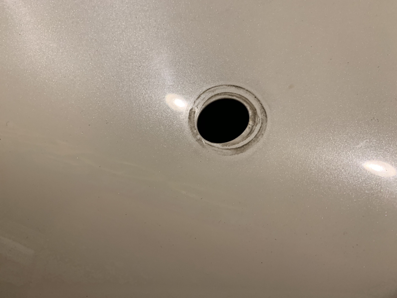

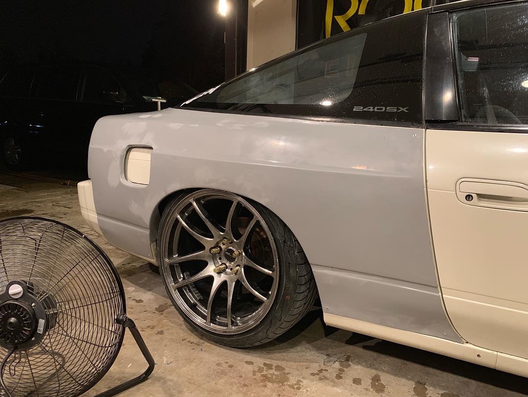

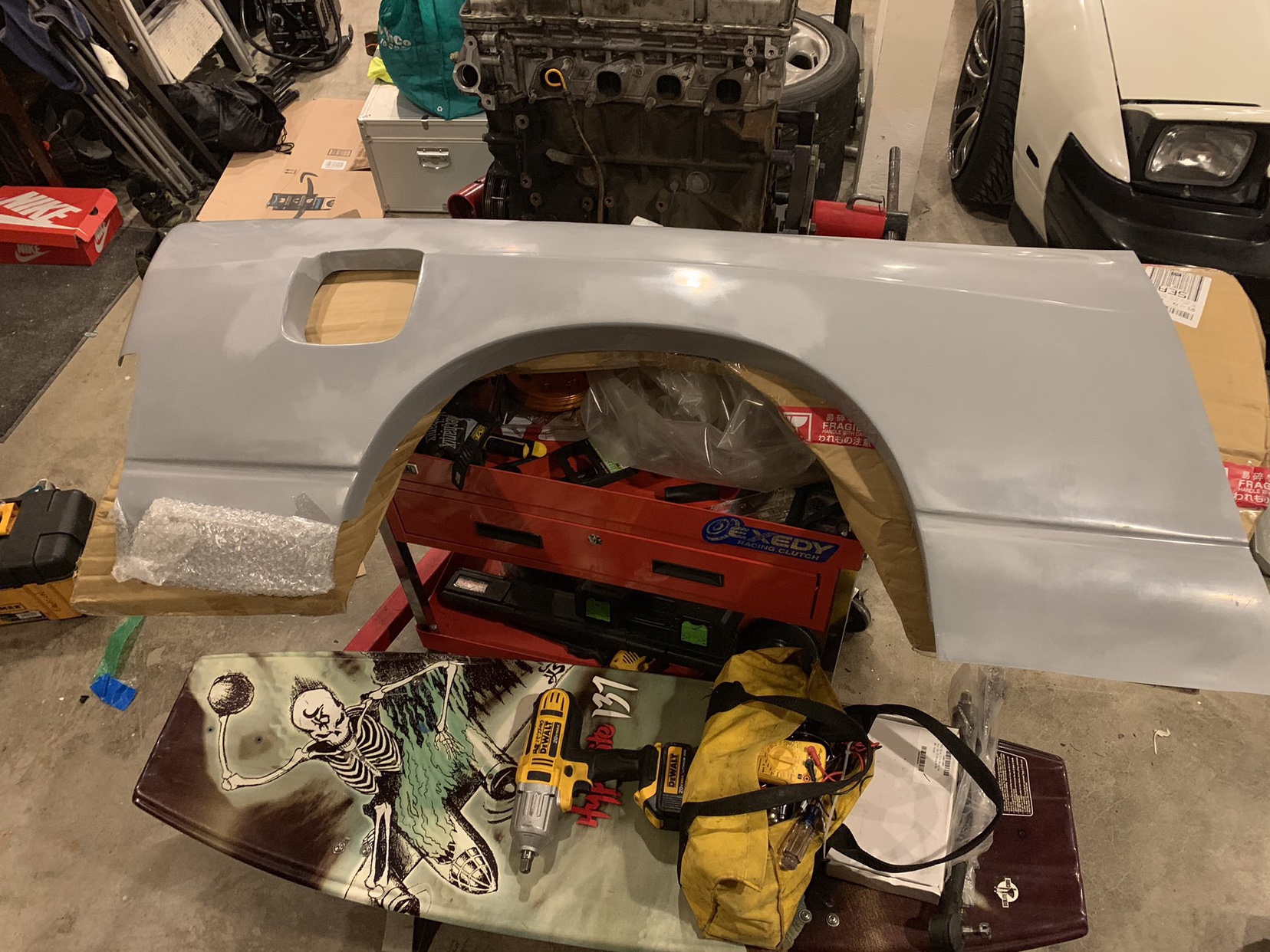

Wykydtron 11-16-2018 10:01 PM
Tron's S13 Hatch // PNW

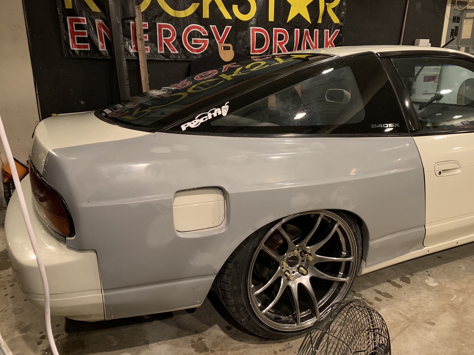

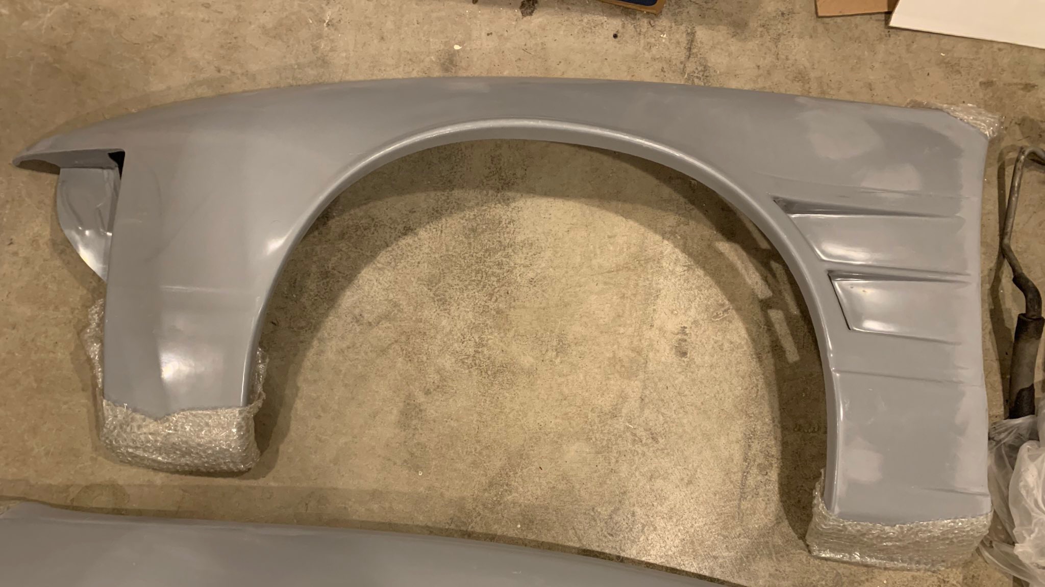

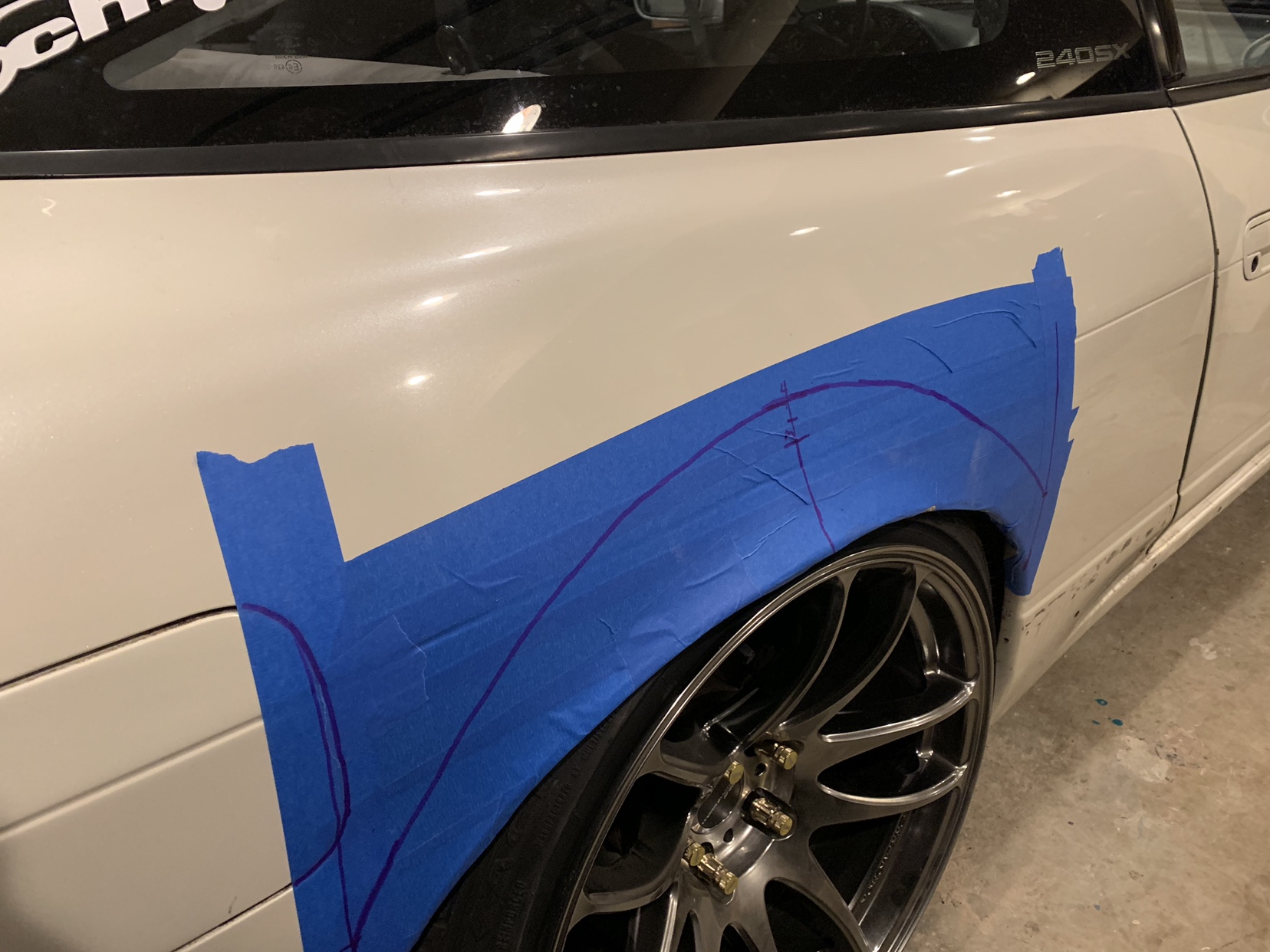

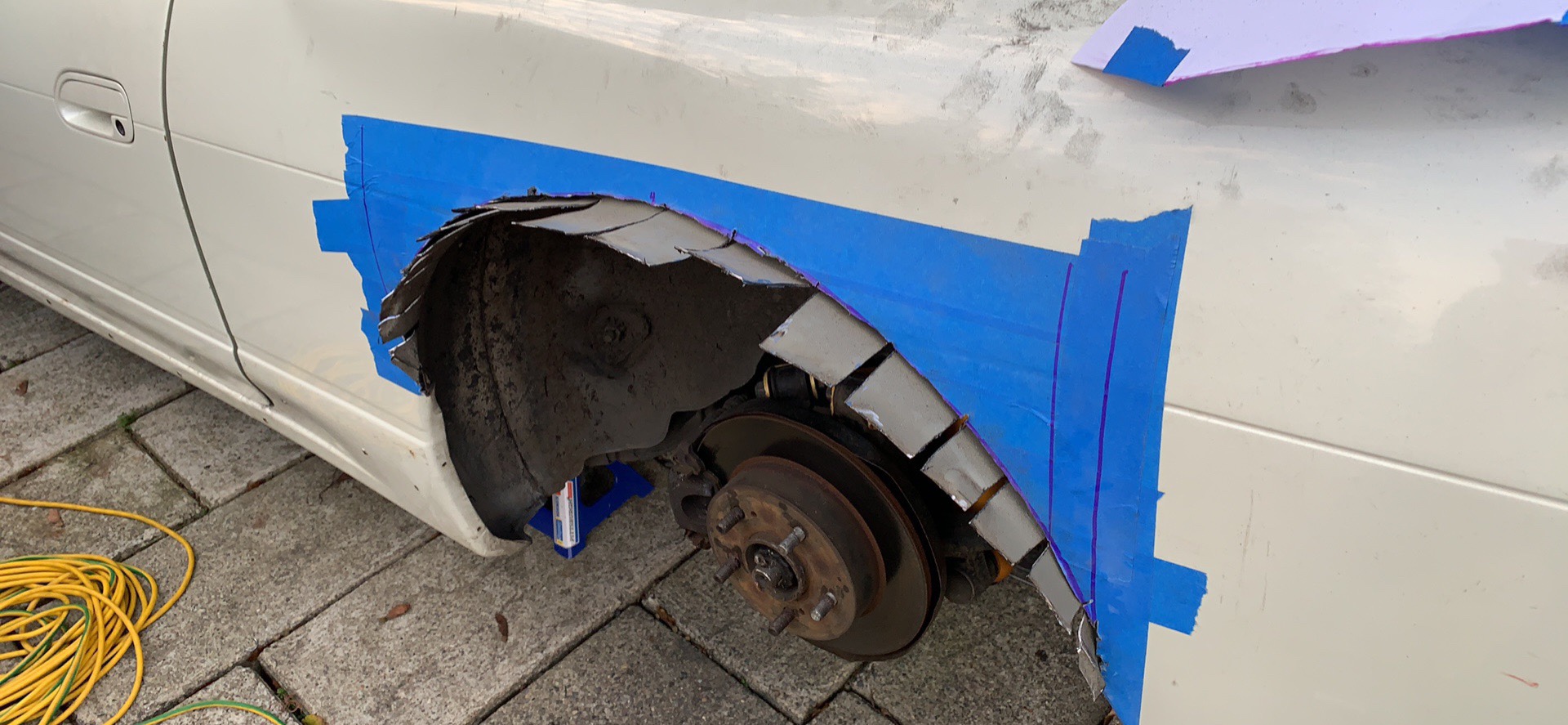

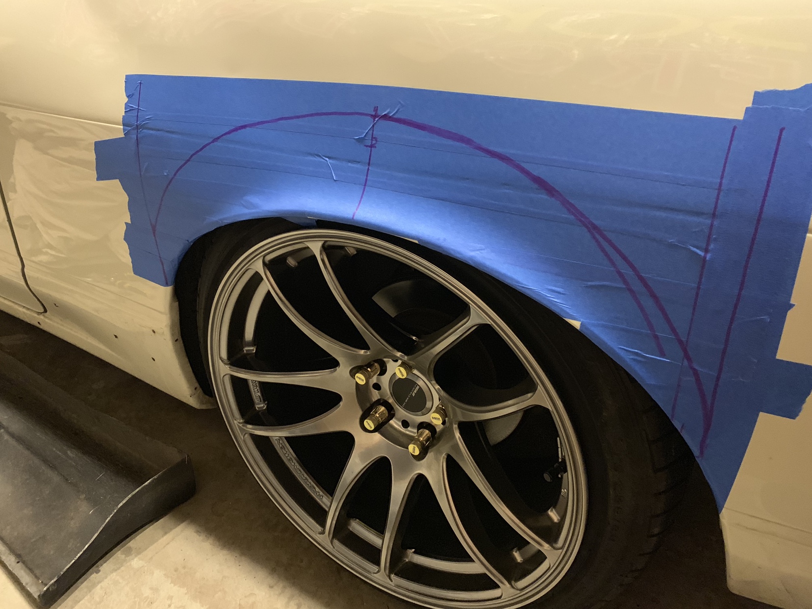

This was a long week, I spent my free time after work working on getting the over fenders fitted. I got my Type 3 front fenders yesterday and threw them on. I am filthy from all the dust. I just took her around the neighborhood and raged on her to hear for rubbing. Passenger side has a bit of rubbing, I may have to bring it up slightly until I can get heavier spring rates.
The front could probably go lower with stiffer springs. We shall see. The Fineline 180sx Type 3 fenders fit a little better than Origin Type 2. But the Fineline fenders are pretty rough compared to the Origins. I'll have to clean them up when I have time.
The rear Origin over fenders fit perfectly. I brought my wheels out slightly but left enough gap to allow them to tuck under load. Again I may raise it slightly. I just love how it looks dumped.
Big shout-out to my gf for putting up with my shit this week. This was the first time I've done this to an schassis. This is my 8th S13. So I'm stoked to finally embark on ruining a shell. Ive always loved big wheels slammed schassis.
Front 55mm fenders
Rear 50mm fenders
https://uploads.tapatalk-cdn.com/201...4b47ca0f50.jpg
https://uploads.tapatalk-cdn.com/201...39008f5fd5.jpg
https://uploads.tapatalk-cdn.com/201...c656a836fa.jpg
pjurisprudencia 11-20-2018 02:02 AM
Nice man! its getting there.
EFITTZY 11-20-2018 09:15 AM
I hope you welded and seam sealed those rears. Not an advocate for overfenders, but if you do it, do em right!

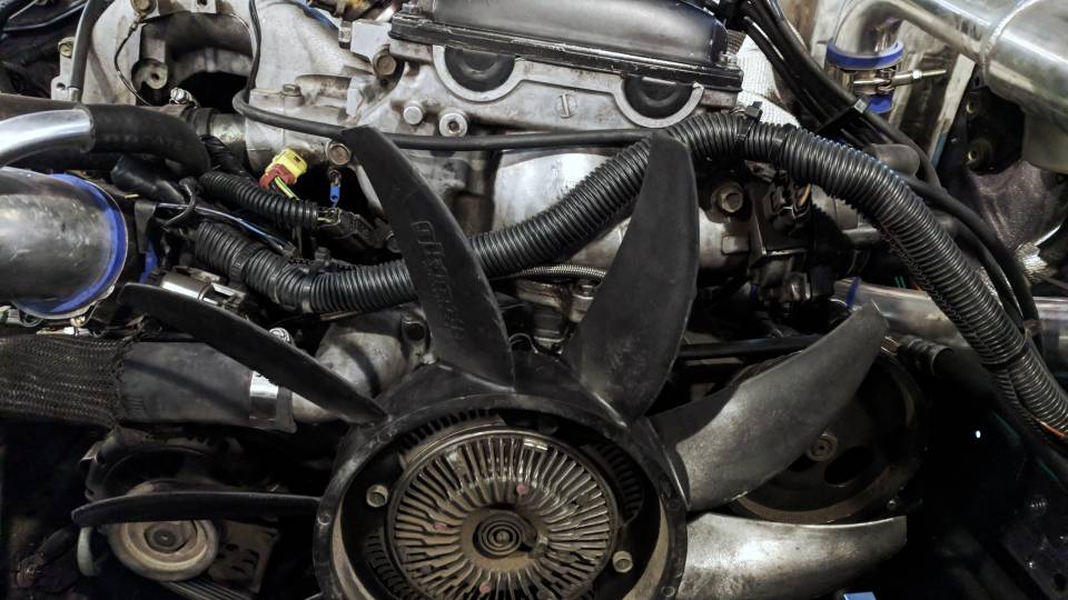

Wykydtron 12-04-2018 06:31 PM
This update is way over due... Uploading the photos right now and will type everything out on the computer. Watch for the edit.
Edit:

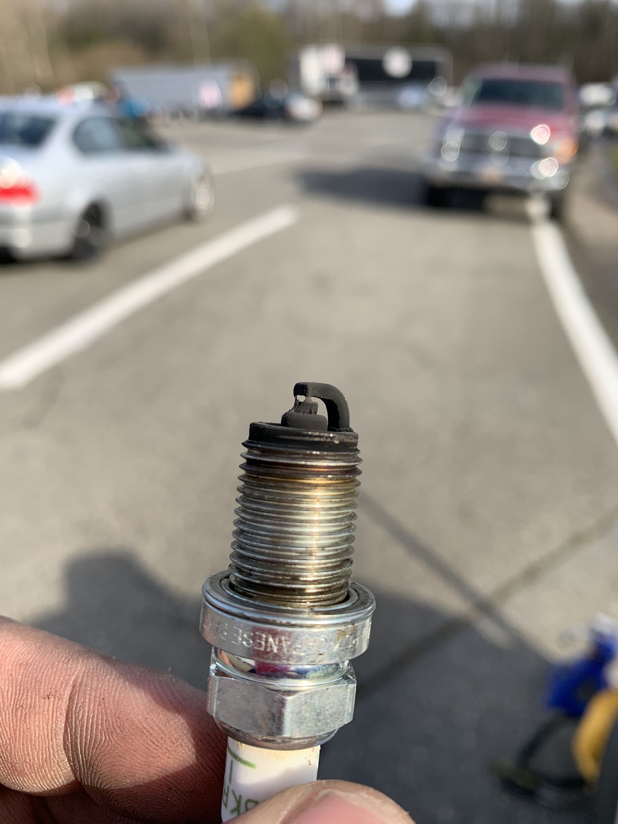

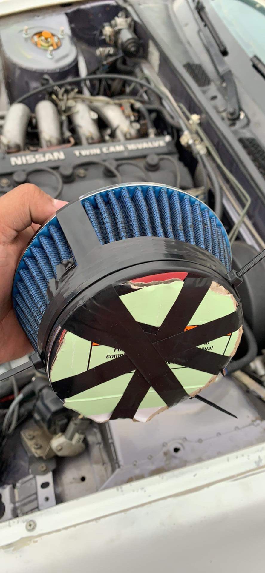

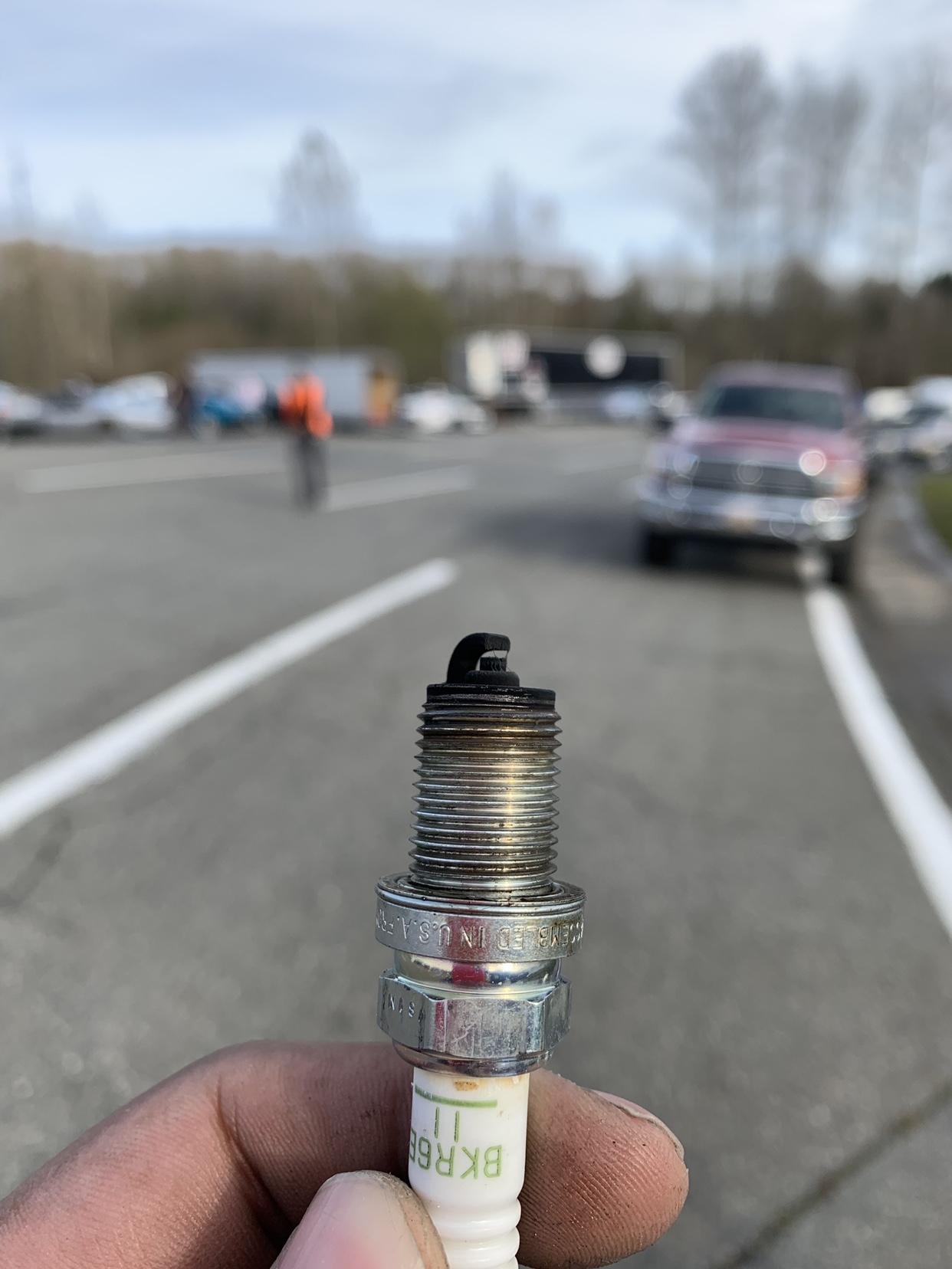

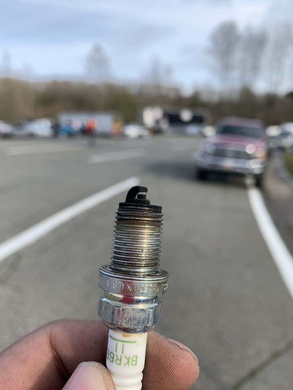

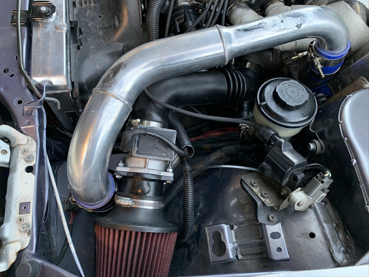

On November 24th I headed out to Evergreen Speedway for the Winter Drift event. The day started out fairly well. While I was driving, I attempting to film video of other drivers but hit a snag when my motor started to die.

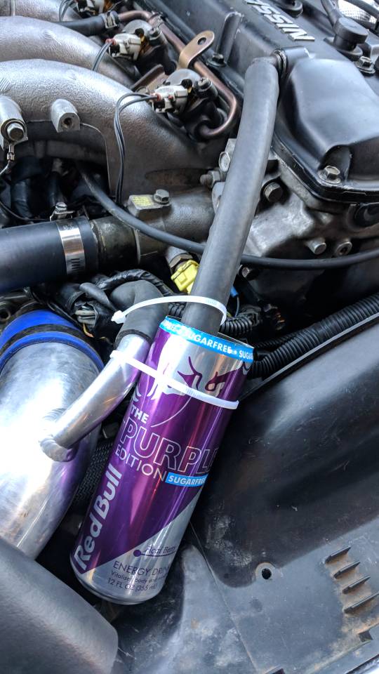

While I was drifting the cageless tandem course, my motor suddenly lost all power and fell on its face. I clutched in and it died. It took a few tries to start her back up, but I managed to limp her off the track by blipping the throttle and riding the clutch to prevent it from stalling. I couldn't get my car back into my pit area so I had to work on it in the 5/8ths pocket (bottom of the bank).
My motor wouldn't idle and needed constant throttle to keep it running. My AFR's were roughly 8-9. I could tell there was gas sputtering on the floor behind my muffler. I pulled the spark plugs and found they were covered in soot. :eek:
https://uploads.tapatalk-cdn.com/201...e9c5d97f6c.jpg
https://uploads.tapatalk-cdn.com/201...1a9dd564a3.jpg
https://uploads.tapatalk-cdn.com/201...e08968b3f2.jpg
https://uploads.tapatalk-cdn.com/201...e9a1ec22fb.jpg
We decided to clean the spark plugs up to see if it would idle. It was still struggling, so I went and bought new plugs. After putting the new plugs in, the motor would idle without me babying the throttle... I was still reading at 9-10 AFR's at idle.
Alex Lindsay was helping me out diagnose the issue, while we were looking at the motor he randomly asked how old my MAF was and if we should try a different sensor. He reached down for the air filter and felt a gaping hole in the top. :eek: We found that the top cap of the cone filter popped off and was blocking the MAF sensor completely! After pulling that out of the MAF sensor, the motor was running a lot better. But luck wasn't on our side just yet... The AFR's were still running super rich, but I was able to drift it on the track. While I was going full throttle, as soon as the boost went above 10psi it would go super rich and misfire. My tuner Nathan Shiel mentioned to me that the hole in the intake could be allowing to much air to hit the MAF sensor, causing it to run really rich. He recommended to block it or swap out the filter. I went with the ghetto cardboard, electrical tape, and zipties option...
https://uploads.tapatalk-cdn.com/201...7c23f286e4.jpg
https://uploads.tapatalk-cdn.com/201...e224e132a6.jpg
https://uploads.tapatalk-cdn.com/201...162602a39a.jpg
Needless to say, that didn't solve the issue. The motor was still running rich and bogging down in boost. My half day at the track came to an end, but I was able to drive her back home to further diagnose the issue.
Since it's been a while, I went ahead and changed the disturber cap, rotor, and spark plug wires in hopes that it would help. I event bought a new MAF, which didn't resolve the issue completely. The car was running good, but not top notch. :rant2:
https://uploads.tapatalk-cdn.com/201...ceb7037d5b.jpg
https://uploads.tapatalk-cdn.com/201...8aff039d73.jpg
Juan
https://uploads.tapatalk-cdn.com/201...8a964a7540.jpg
https://uploads.tapatalk-cdn.com/201...ebc45c19e7.jpg
Wykydtron 12-04-2018 06:47 PM

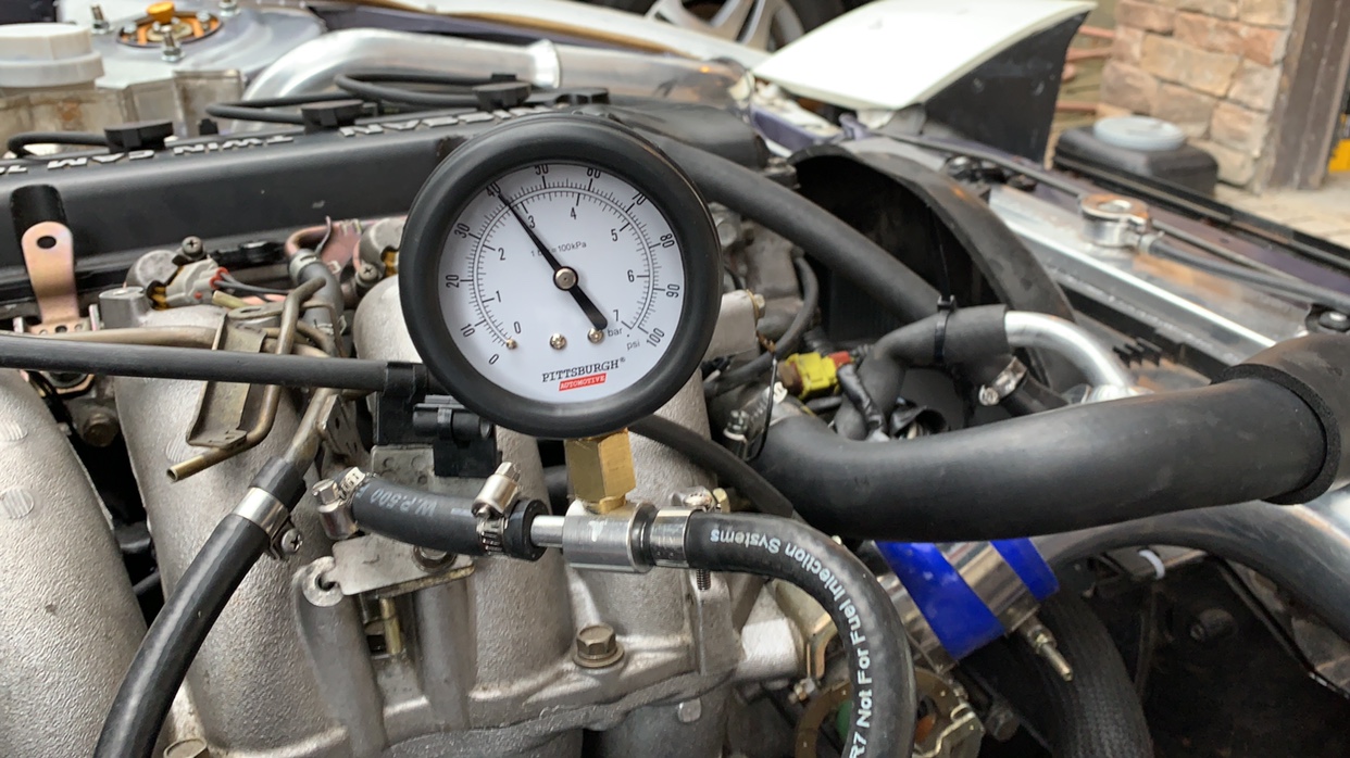

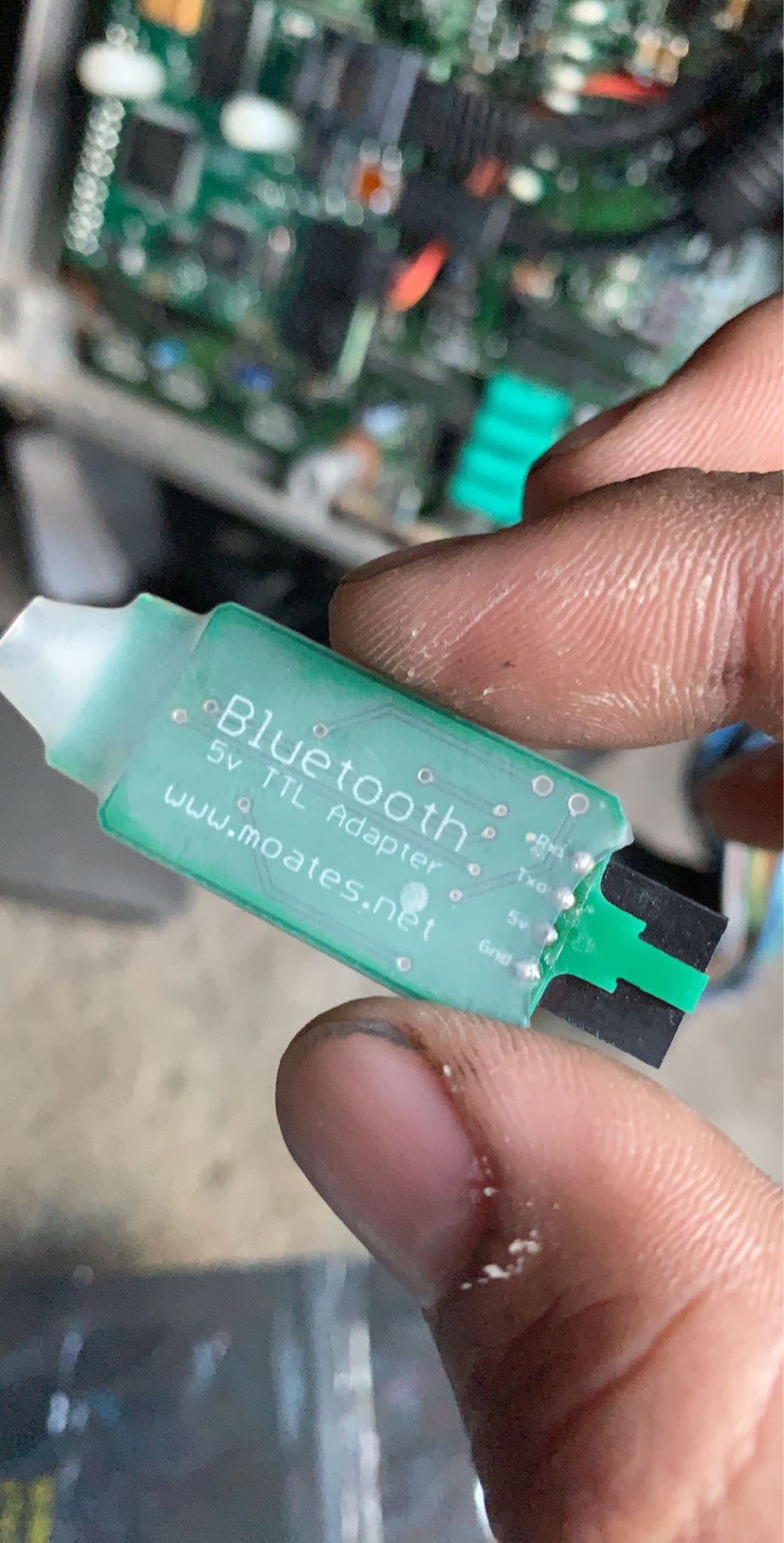

While I was working on trying to figure out what was going wrong, Alex Lindsay and a few other drivers were asking about the fuel pressure regulator, if I had the OEM FPR, and if I could test the fuel pressure.
Nikki loaned me her fuel pressure regulator and I ran the test. I have the S14 OEM FPR and Walbro 255 pump.
I was at 59 psi with the motor off but fuel pump on, 40 psi with motor idling, and around 37 psi when I revved and held the motor at about 3,000 rpm.
https://uploads.tapatalk-cdn.com/201...e2353d8188.jpg
While I was cruising to 7-Eleven to buy a few drinks, I recently posted on FB asking around to see if anyone had a spare air filter I could borrow. Ironically, I drove past my buddy Guy and he DM'd me asking how the motor was running.
I told him, "like shit when I hit boost" so I told him I wanted to throw out the CX Racing intake (or cut it down so I could run a normal filter pod). He had one in his garage! He brought over a stock SR intake pipe and a filter that didn't have the stupid cone/disk in the top.
https://uploads.tapatalk-cdn.com/201...0062ba1ff1.jpg
The motor was running decent that night, but I later found out it was still misfiring. Regardless, I drove down to Kent WA for NW Toy Run.
Wykydtron 12-04-2018 06:56 PM
Casey and I hopped into the hatch and met up with Guy the next morning. We drove all the way down to Kent and back without much issues. Keep in mind, I wasn't hauling ass on the freeway... :2f2f:
Later that night I went for a few late night highway pulls... the issue was still there. :-/
https://uploads.tapatalk-cdn.com/201...2659d33f61.jpg
https://uploads.tapatalk-cdn.com/201...d0b0aceb81.jpg
https://uploads.tapatalk-cdn.com/201...86886d1c61.jpg
https://uploads.tapatalk-cdn.com/201...9d131f403d.jpg

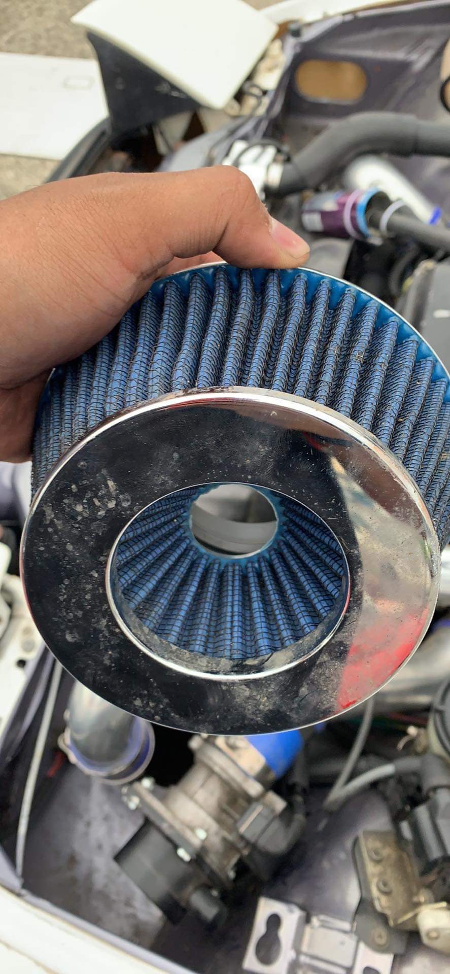

Wykydtron 12-04-2018 07:05 PM
Final conclusion of the mysterious misfiring in boost...
Well, let me start out by saying this... The air filter breaking and blocking the MAF obviously caused the spark plugs to get a shit ton of soot on them. After replacing the plugs with new spark plugs, the motor still was acting up. I went ahead and did a full tune up on the car as a preventative. Replacing the air filter and intake tube was another item I wanted to do for a while.
A few days ago I went and re-gapped the old spark plugs to 0.028 and sanded down the contact points to remove the black soot. The new spark plugs were at 0.042. Since I'm running 14 psi, my tuner mentioned it could have been spark blowout! The motor the past two days has been behaving well. While I was going over the entire motor, I also noticed my ground wire off my battery was lose to the chassis. I went and found a better location, cleaned up the contact points, and tightened her down.
Hard lessen learned? I should have started with the stupid simple solutions first and move on to more complex. I guess I was too frustrated to think about the smaller details. Needless to say, my motor was far overdue for a tune up!
I'm also determined to switch over to speed density so I don't have to deal with MAF issues again.

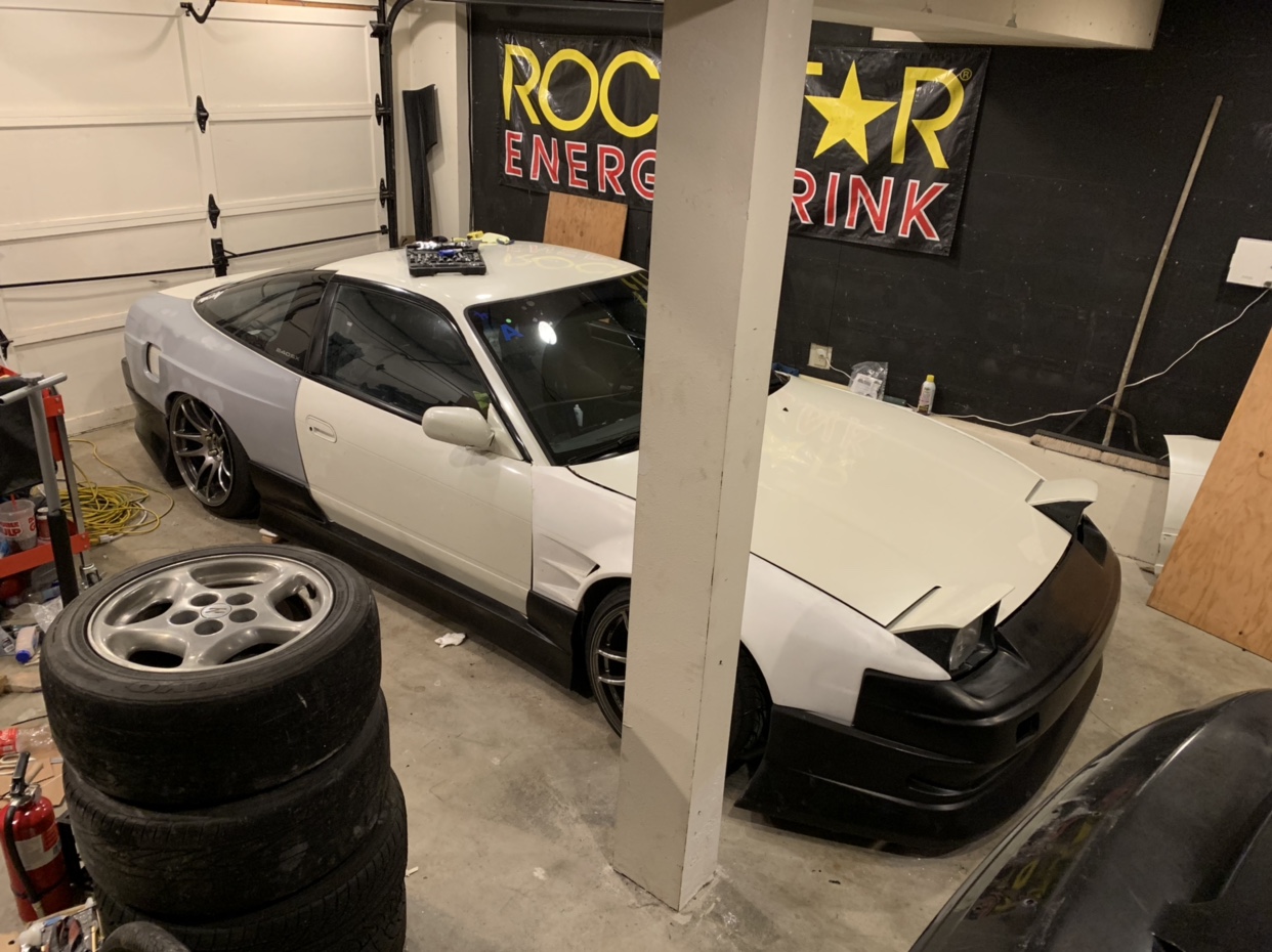

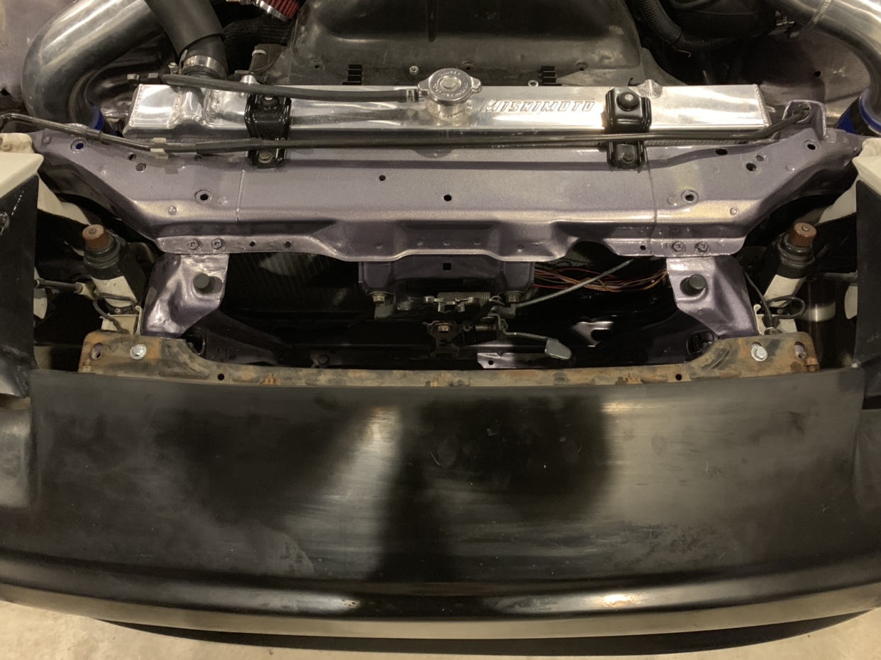

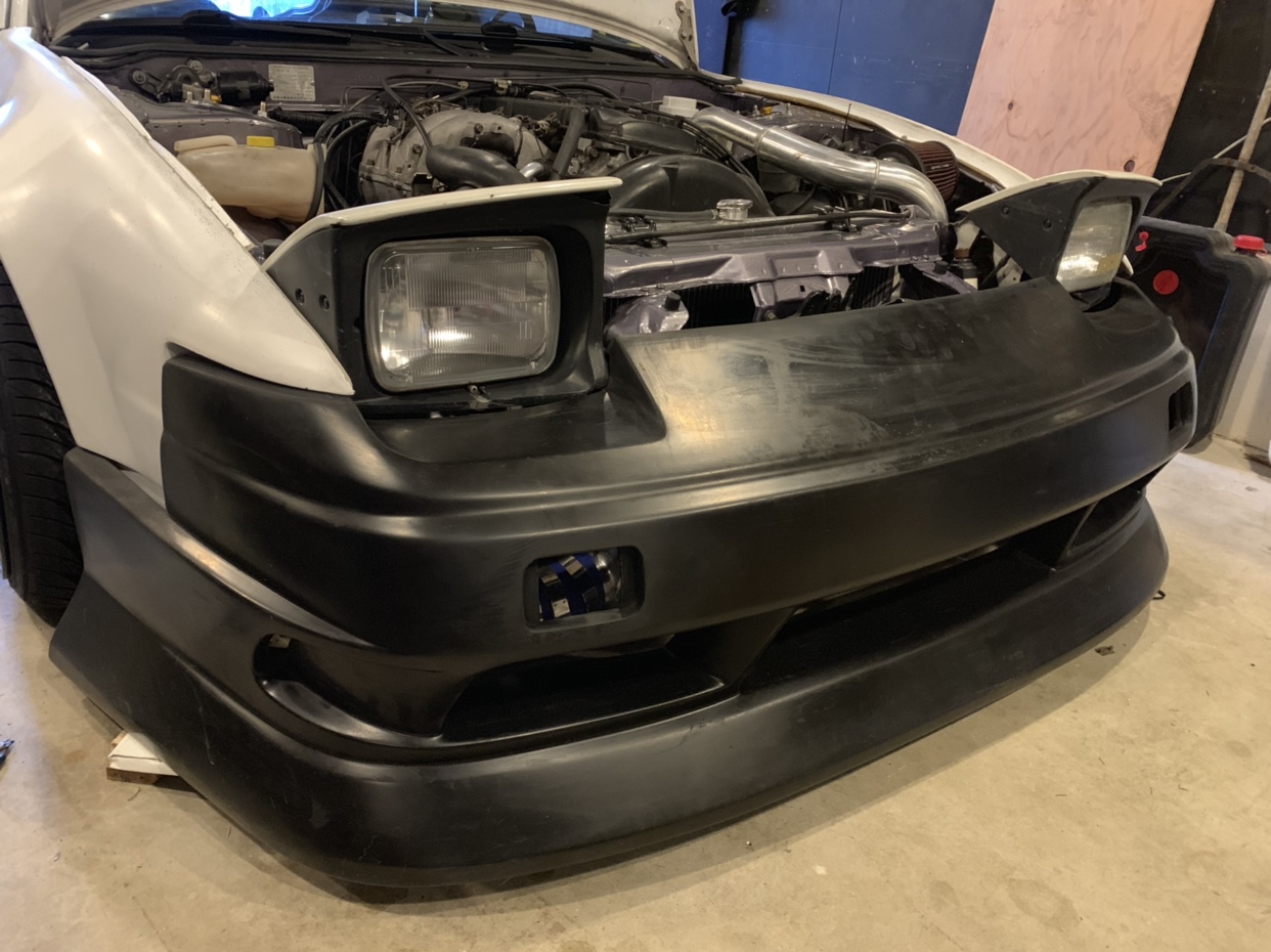

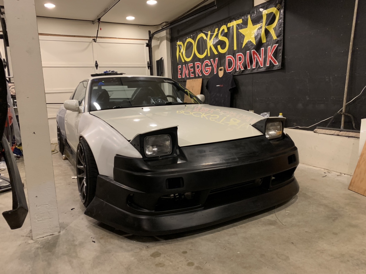

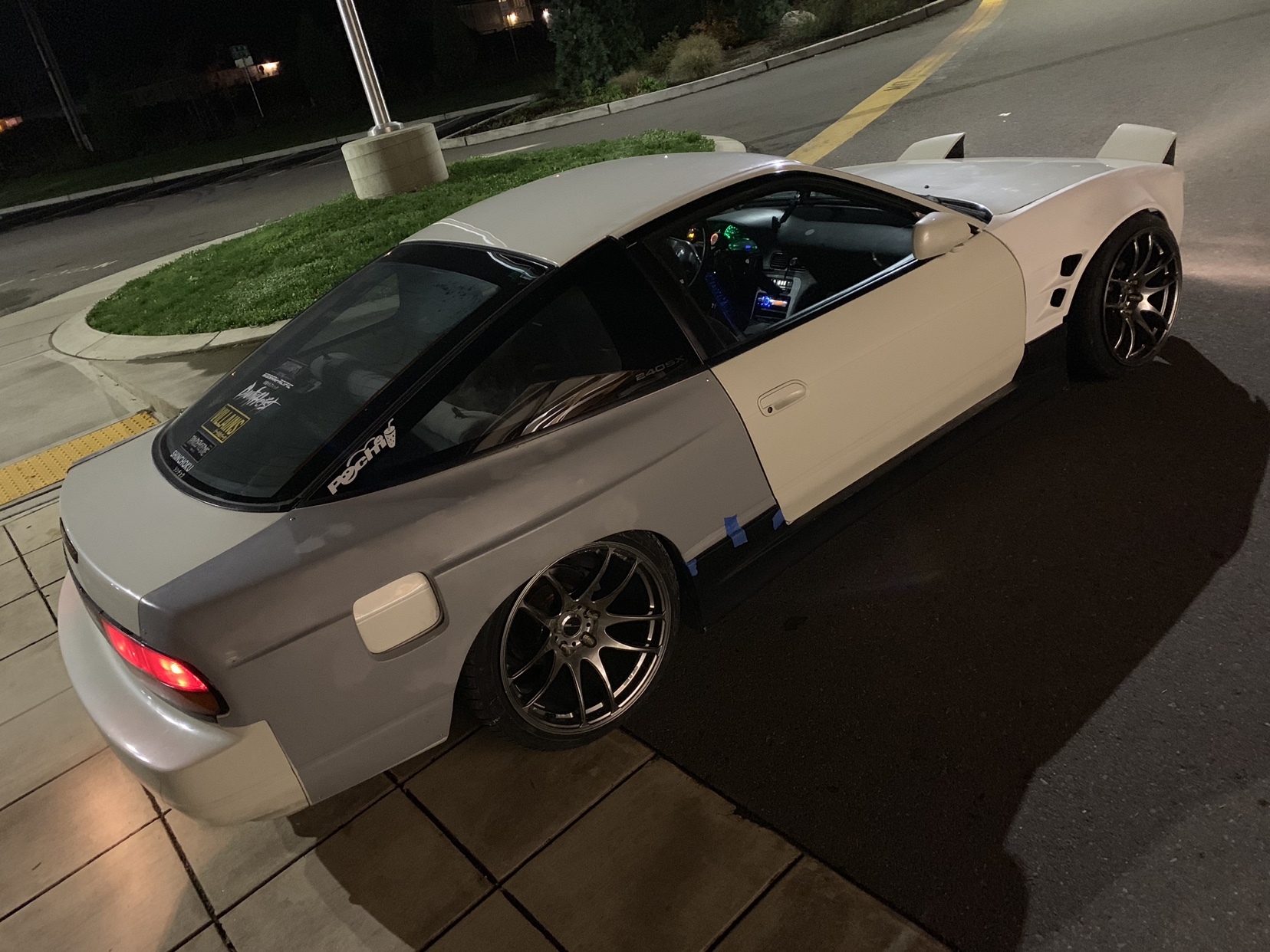

Wykydtron 02-03-2019 05:52 PM

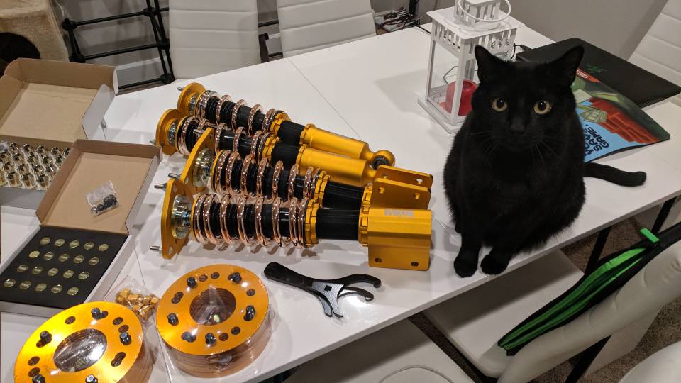

Mounting the kit on, I'm trying to retain as much of the OEM brackets to avoid sagging. I need to do some trimming and finish the rest of the mounting points.
https://uploads.tapatalk-cdn.com/201...0fbaaea1c1.jpg
https://uploads.tapatalk-cdn.com/201...98a12185c1.jpg
https://uploads.tapatalk-cdn.com/201...de5209e8c5.jpg

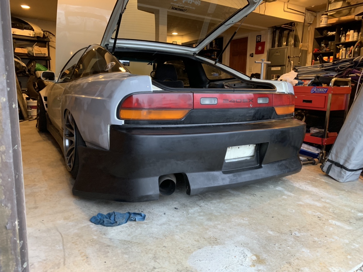

Wykydtron 02-10-2019 01:06 AM
‪She's finally on the ground. I still need to make brackets to flare the side skirts out to match the body line and bring the front bumper flares in. Better mounting up front maybe more trimming. For now, Ziptied as any 90's shit box. [emoji16]‬
https://uploads.tapatalk-cdn.com/201...7fe1c42864.jpg
https://uploads.tapatalk-cdn.com/201...738f50b78c.jpg
deolio 02-10-2019 12:46 PM
one of those chola-proof kbd kits i'm guessing? it's never gonna fit right without wasting 1000 hours that would have been better spent working a job to pay for something legit. storm bfg can only help so much :2f2f:
Wykydtron 02-20-2019 02:38 PM
yeeaaah it does fit like shit. I'll be messing around with it in my free time to see if I can get it to fit better. My pignose fit the fenders fine but the KBD needs a lot of work. Storm bfg was clean install, holds the front bumper kind of. I have to trim some areas on the bumper.
I'll have to talk to my buddy that I want to paint it and get his recommendations.

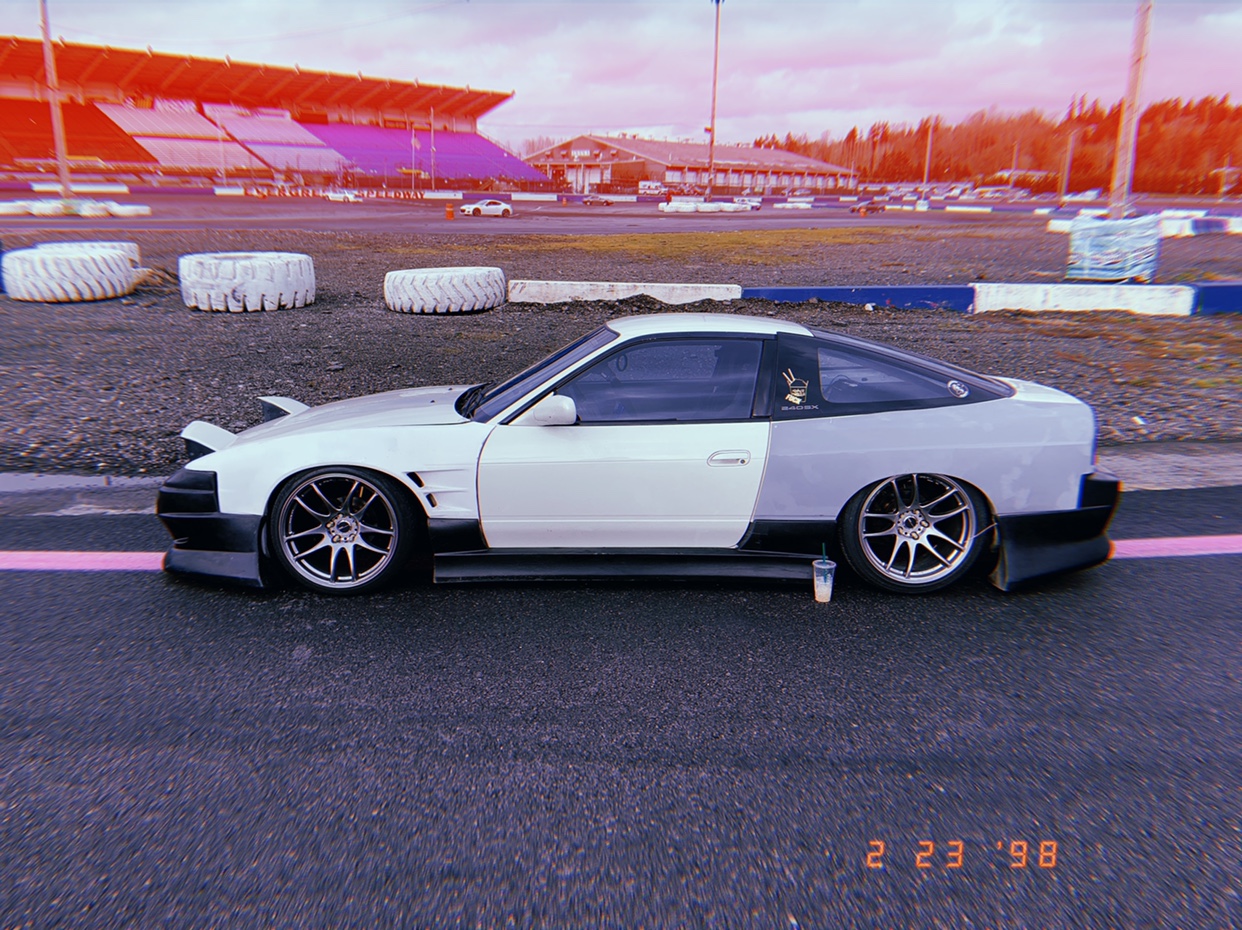

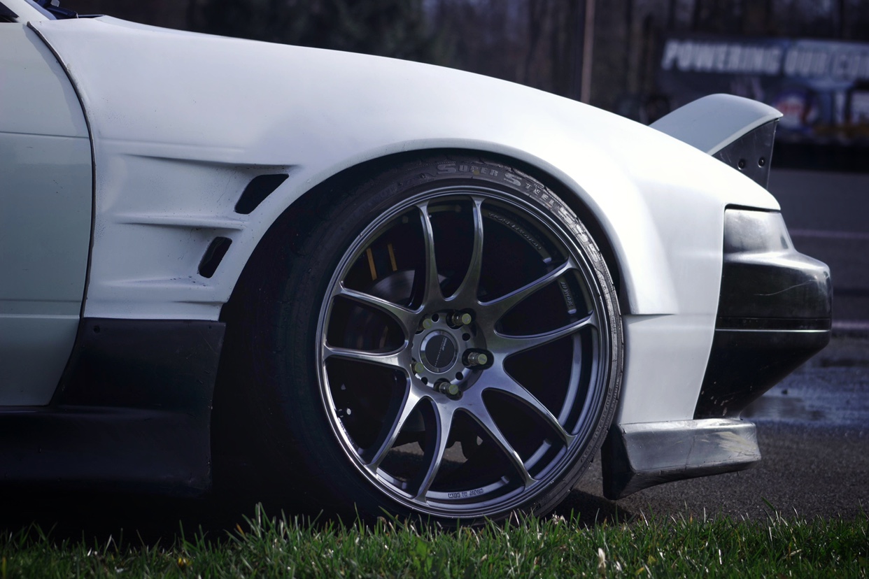

Wykydtron 02-27-2019 10:35 PM
Last week I installed a PBM skid plate and 10k springs. Lowered the front a few inches.
https://uploads.tapatalk-cdn.com/201...85f8734922.jpg
https://uploads.tapatalk-cdn.com/201...b8ff7de3cb.jpg
Got seat the this past weekend. Blair Photography stopped by the speedway and took a few photos. I applied the filter [emoji848]
https://uploads.tapatalk-cdn.com/201...95994a89f4.jpg
https://uploads.tapatalk-cdn.com/201...23830d2c49.jpg

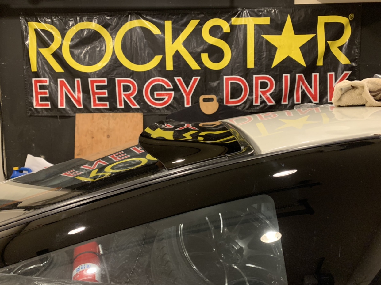

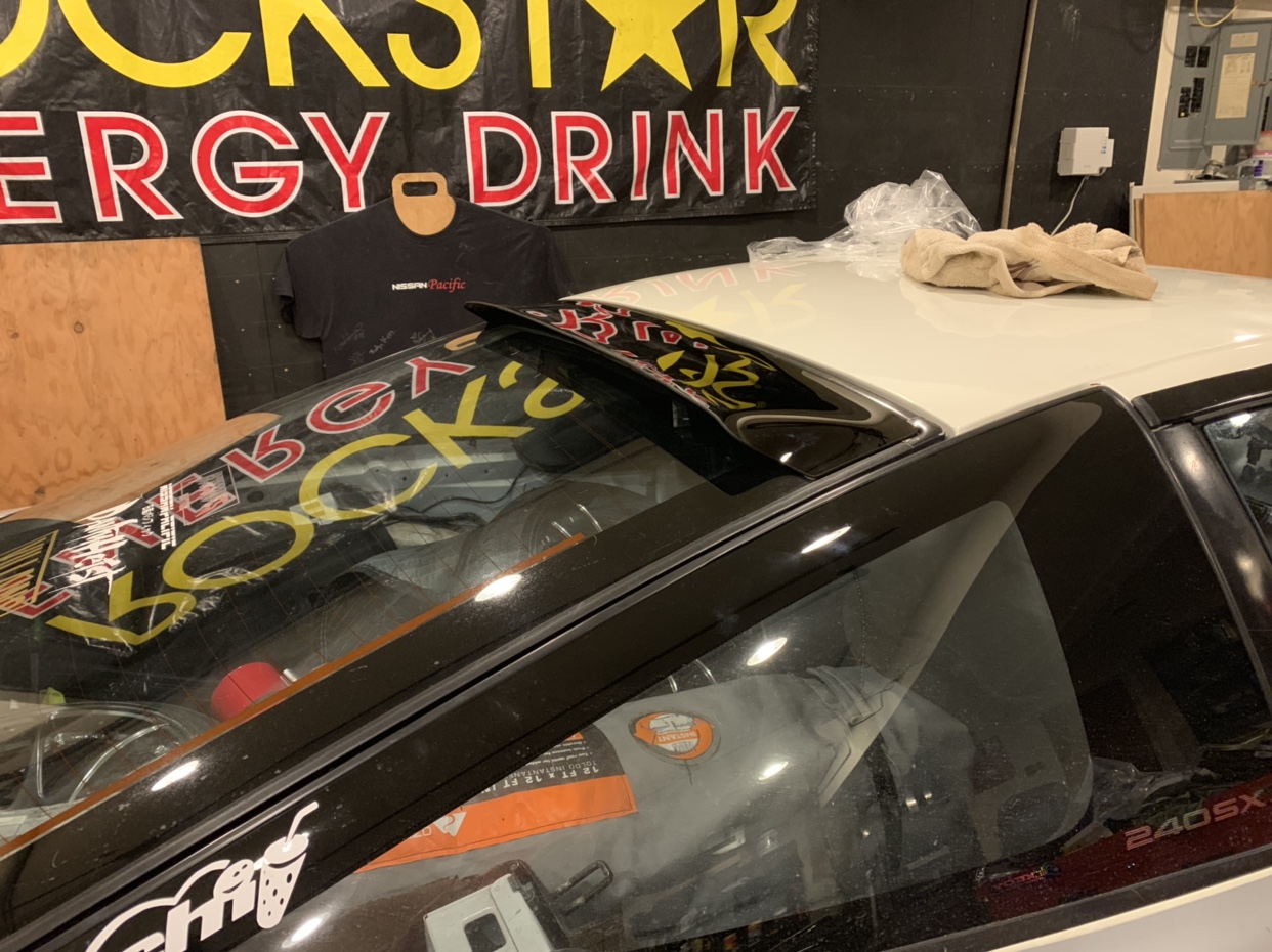

Decided to buy a roof wing to see how it looks.
https://uploads.tapatalk-cdn.com/201...ad7b3c5dea.jpg
https://uploads.tapatalk-cdn.com/201...89ab4bd2b3.jpg
https://uploads.tapatalk-cdn.com/201...e54a703afb.jpg
Really happy with my current setup. KA-T seems to be reliable, however its running a bit rich. It starts to run very rich when I go out hot lapping. I've seen it about 9-10 AFR after doing 3-4 hot laps in a row. Not sure why, my temps look good. I need to talk to my tuner about these symptoms.
I'd like to get an oil cooler to improve cooling.
3 open drifts this year, I haven't had to change the rear tires once. The mixture of wet and dry conditions coupled with low HP is getting me by. [emoji1690]

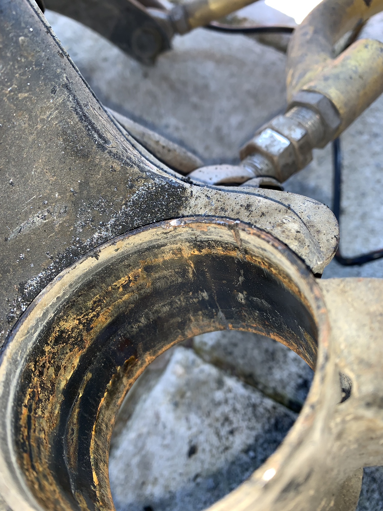

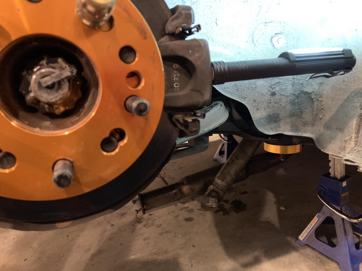

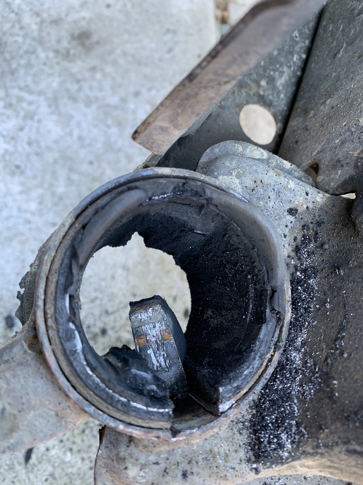

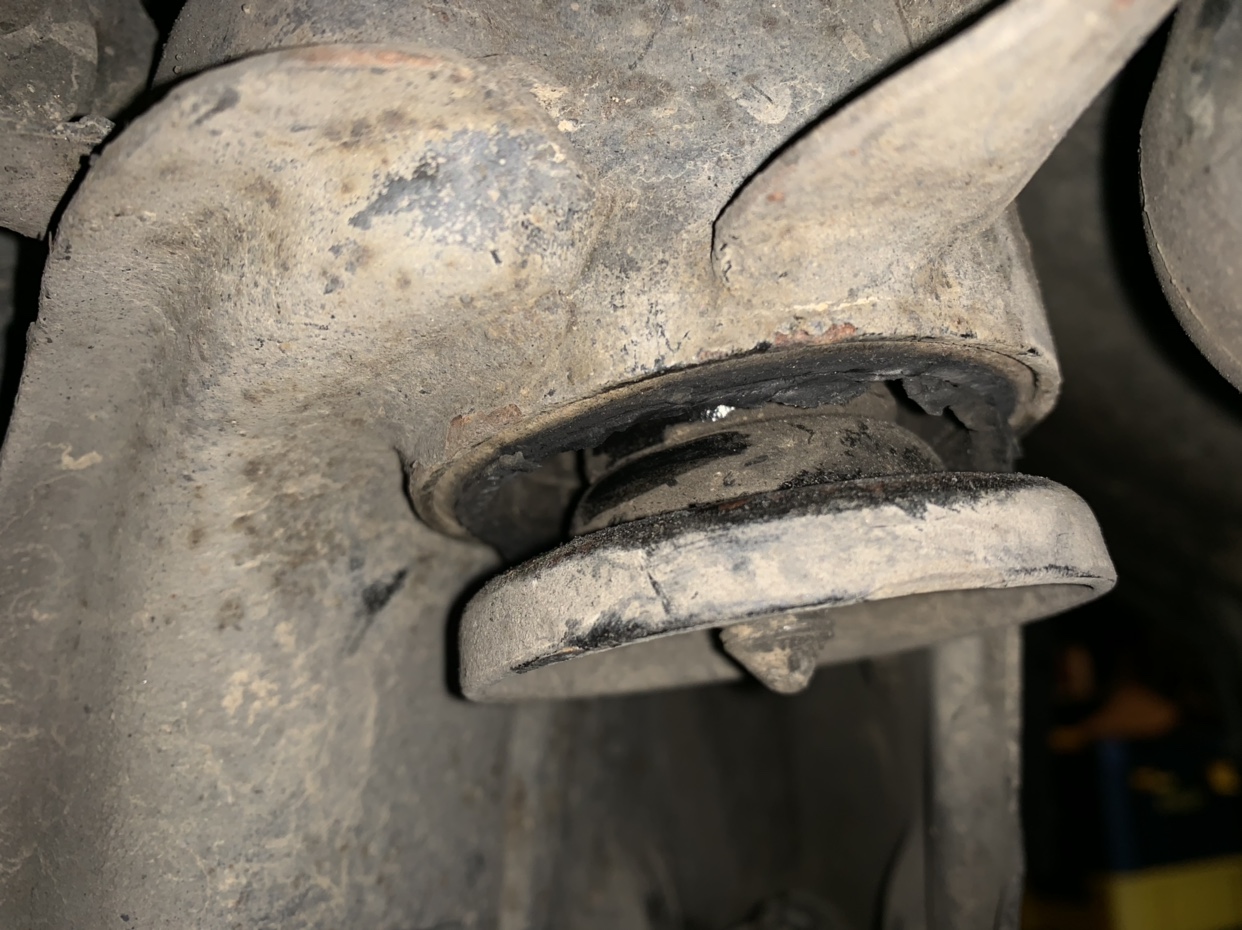

Wykydtron 03-08-2019 11:03 PM

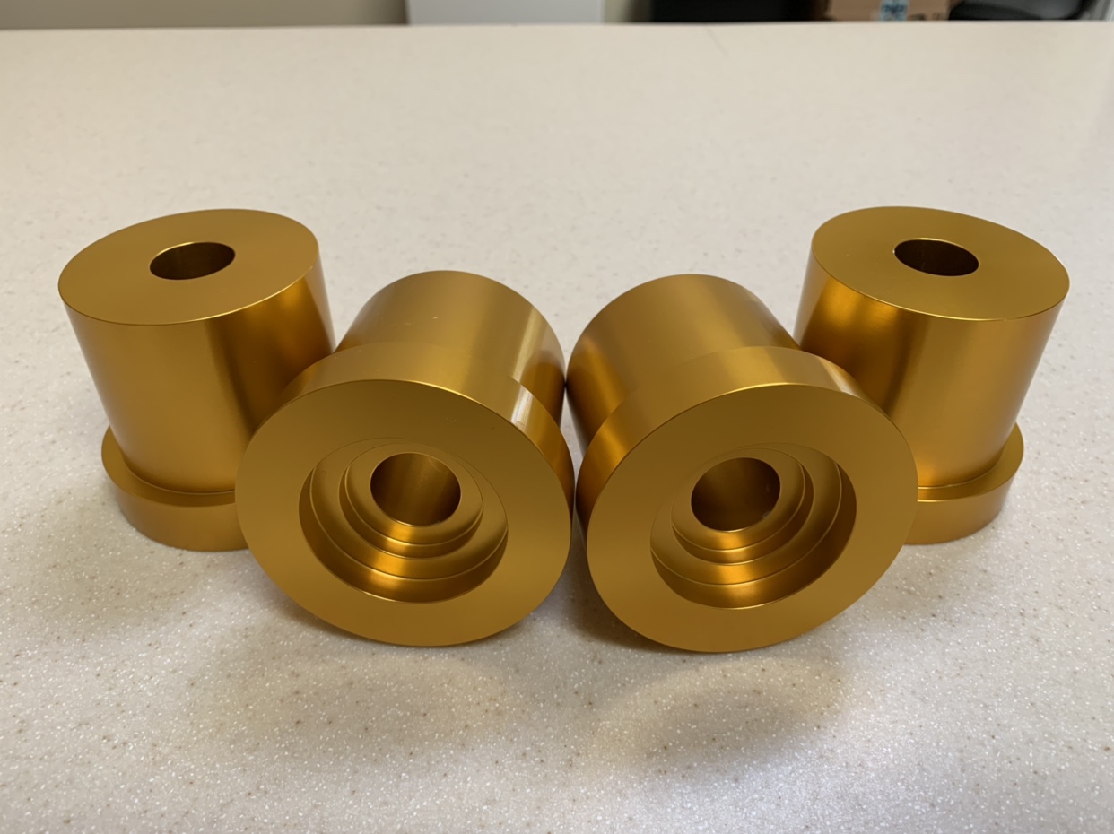

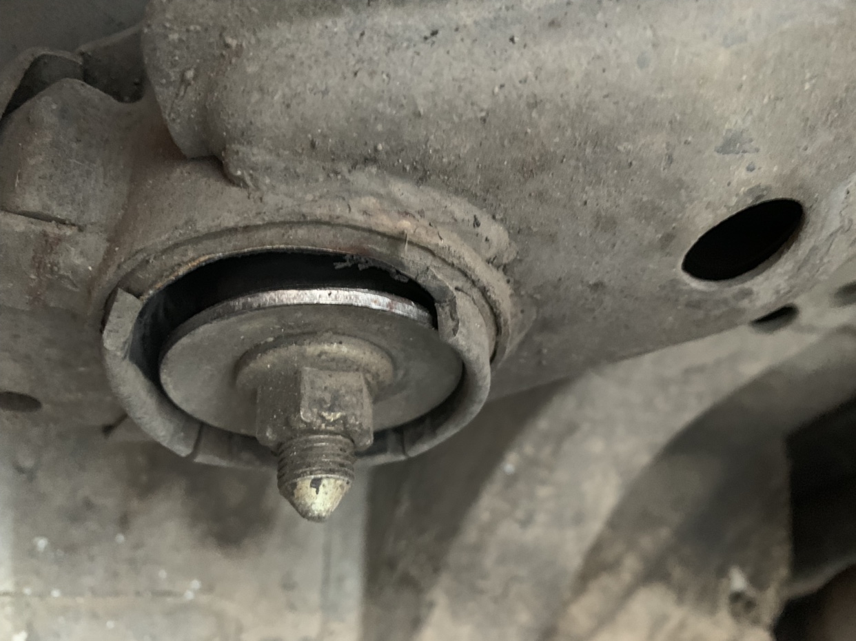

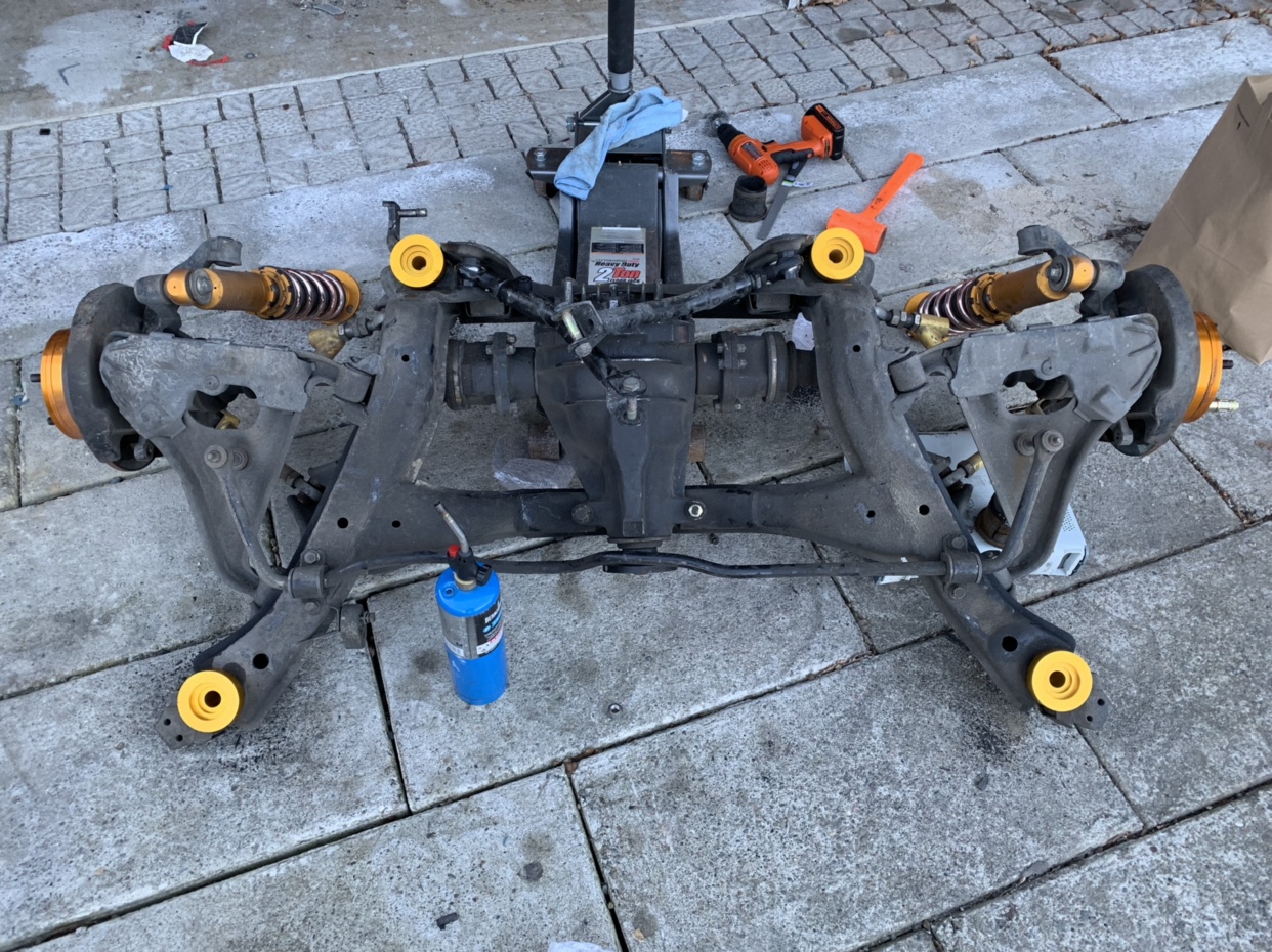

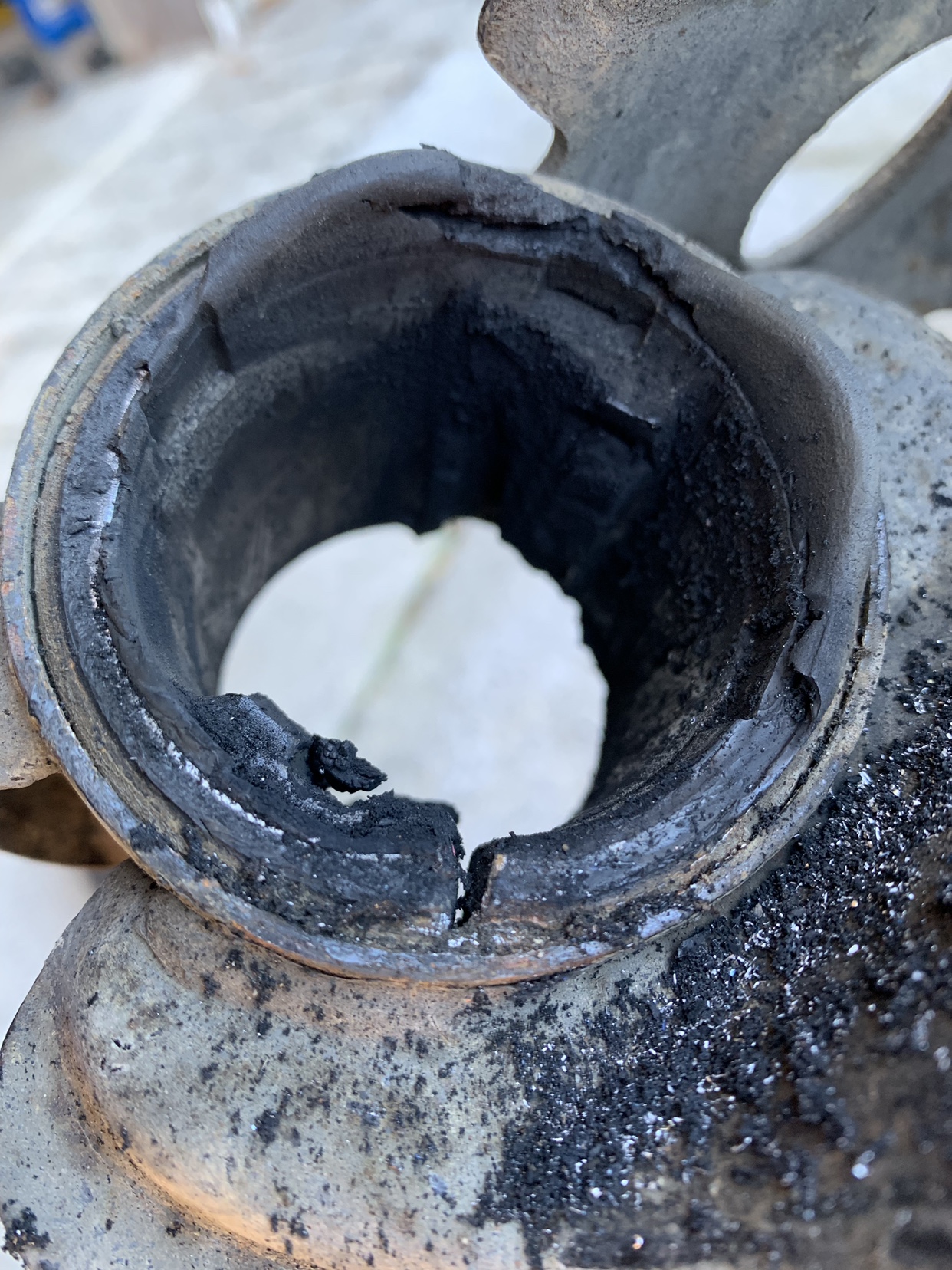

Had a lot of wheel hopping at the last EVD Open Drift. Bushings were shot. Ordered PBM solids on Sunday, going to pop them in this weekend. [emoji1690]
https://uploads.tapatalk-cdn.com/201...4b0eb16e4a.jpg
https://uploads.tapatalk-cdn.com/201...dfa4e70d73.jpg
https://uploads.tapatalk-cdn.com/201...2fc0482ab6.jpg
Wykydtron 03-10-2019 01:30 AM
Woke up to this
https://uploads.tapatalk-cdn.com/201...9ba34515dd.jpg

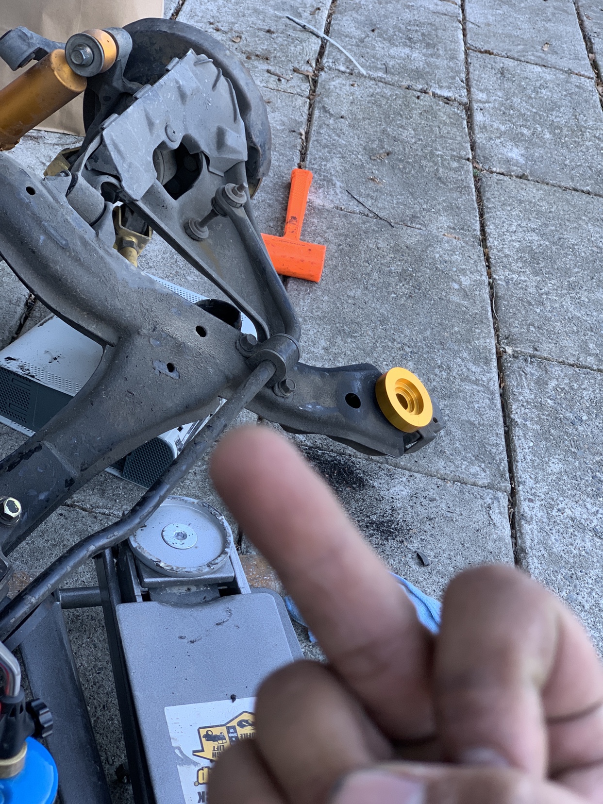

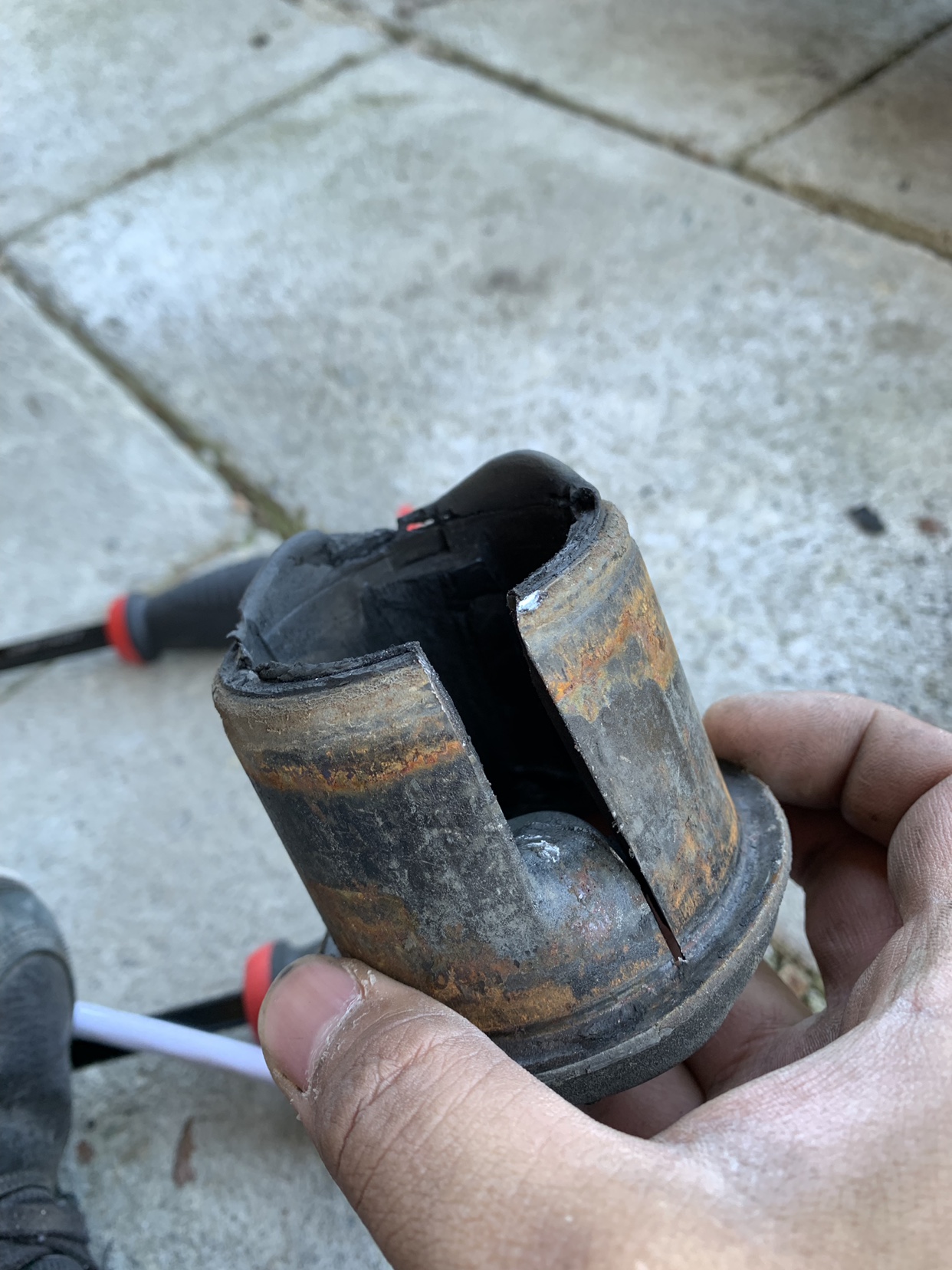

As soon as the Parts Shop MAX solid bushings came in, I put them in the freezer and brought them down to -20 Celsius.
https://uploads.tapatalk-cdn.com/201...5847d9df63.jpg
Being that this was my first time doing this, I wasn't sure how much to cut or how quickly it would cut. The sawzall made this whole process fast. I started by drilling the rubber out and then hammering out the metal centerpieces. Once that was done, I cut 2 lines so that I could punch out a section and have the metal insert taco.
https://uploads.tapatalk-cdn.com/201...e24127b150.jpg
https://uploads.tapatalk-cdn.com/201...4faef617ac.jpg
https://uploads.tapatalk-cdn.com/201...062b903fe7.jpg
https://uploads.tapatalk-cdn.com/201...93f27f0afd.jpg
https://uploads.tapatalk-cdn.com/201...8716af4547.jpg
I ended up using 2 1/2 inch wire wheel to hone/clear the cylinders. I then used a metal file to get rid of metal burr and file in a 45 degree taper.
The bushings were tight to start. Very difficult, my fingers hurt from how cold they were. I wrapped a towel around the bushings to prevent my fingers from freezing and smacked it with a rubber dead blow.
https://uploads.tapatalk-cdn.com/201...4c4346c2d7.jpg
https://uploads.tapatalk-cdn.com/201...b917697ab8.jpg
And then I went viral with this photo. [emoji23]
https://uploads.tapatalk-cdn.com/201...eea691cf31.jpg
Aligning the subframe to go back into the car with a floor jack is a pain in the ass. It took me a good 2 hours to get it to work. At one point I got the subframe jammed and stuck. I was so pissed.
https://uploads.tapatalk-cdn.com/201...9fadf564e8.jpg
I'm glad I got it all back together. Tomorrow I'll blew the brakes, double check all the bolts/nuts, check ebrake, and the hopefully cruise around town.
