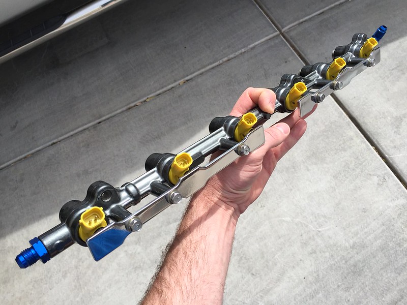

While the car was at the shop, I spent more money on more parts. I ended up purchasing a set of front and rear drop knuckles from GKtech. I really wanted a low car but I’m not too fond of my suspension geometry being all messed up from being too low. I’m hoping this purchase will prevent any future issues from arising and I hope my car will handle amazingly once they are installed.
https://farm6.staticflickr.com/5644/...98a6d82f_z.jpg
https://farm6.staticflickr.com/5783/...a82499f5_z.jpg

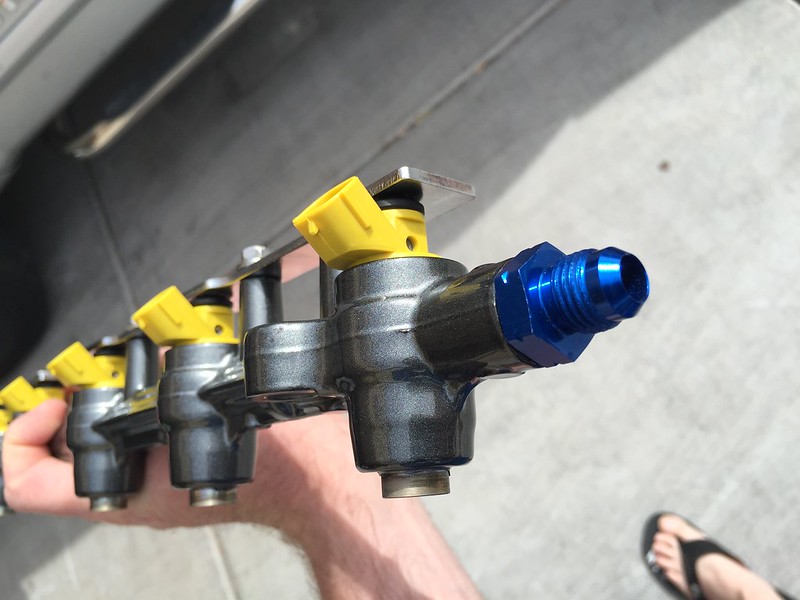

Took the intake manifold and fuel rail runners in to get powder coated. It turned out really well IMO. The color is called Slate Gray Metallic
https://farm1.staticflickr.com/735/2...0d5102fd_c.jpg
https://farm6.staticflickr.com/5719/...68c8aa5c_c.jpg

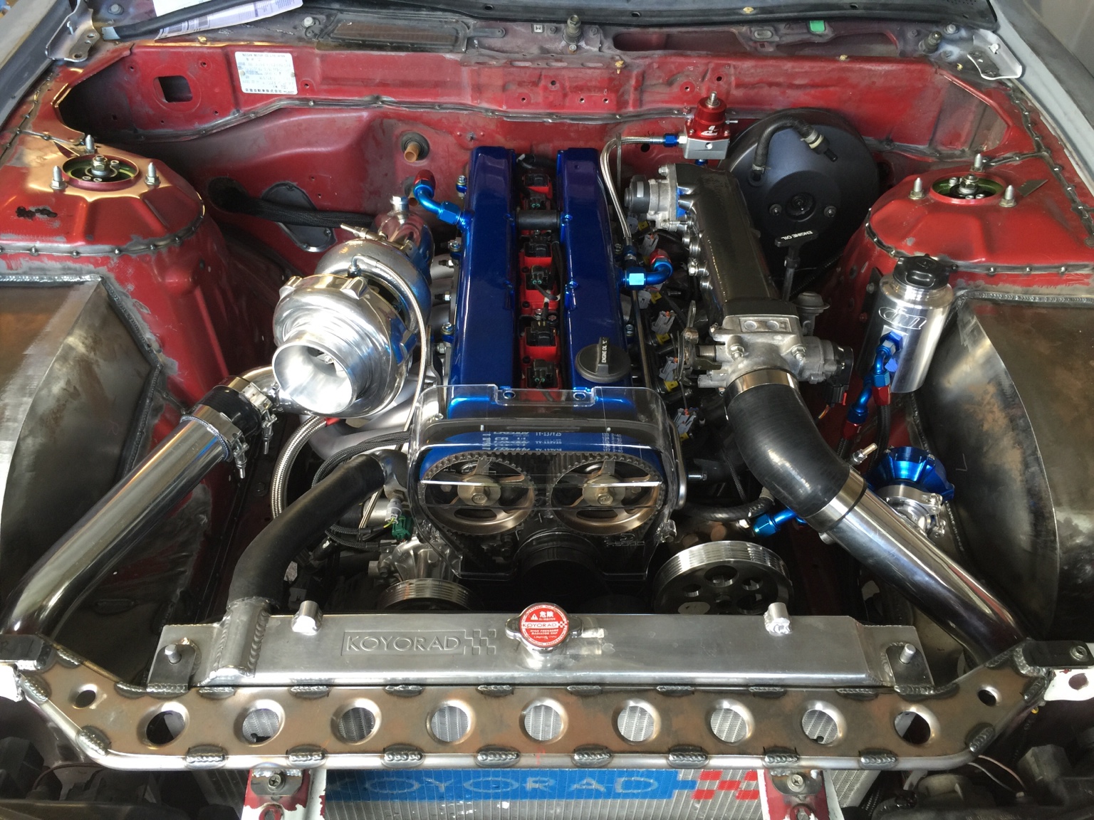

It is now May 2015 and my fabricator said that he was ready for me to bring the motor down. I picked a hell of a nice day to go. I loaded everything up and took it down to his shop to drop it off.
https://farm1.staticflickr.com/589/2...d1b32493_z.jpg
https://farm6.staticflickr.com/5701/...64b04cff_c.jpg
This was my first time getting to see any of the fab work and I was really impressed, as I usually am with Jesse’s work. Here are some shots of the tubs in progress.

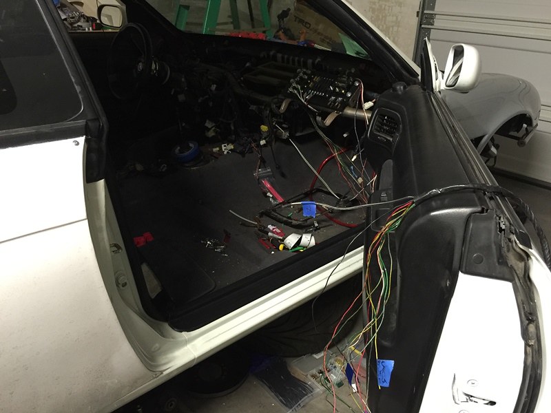

The interior in the car is still out so it was time to get to work on finishing up the wire tuck that one of my friends had done for me. I bought some fuse blocks and started to get to work. I’m no master of wiring, but the little amount of crap that my boy Ross had left for me was simple enough that I could clean it up.
https://farm6.staticflickr.com/5697/...2fe663ef_c.jpg
You can see what’s left of the original fuse box on the floor board.

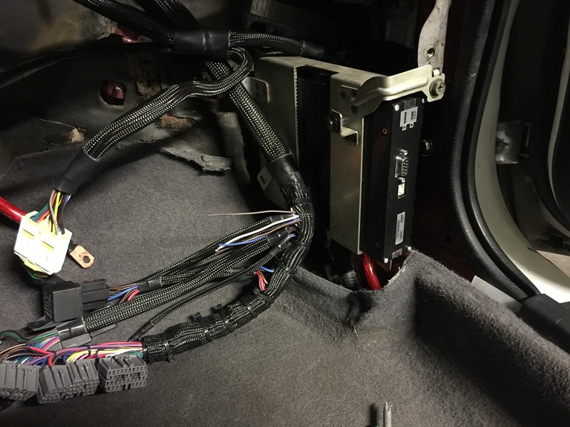

I want to cut out the rest of the slack so I straightened everything out as much as I could and got to labeling.
https://farm1.staticflickr.com/685/2...7396ce23_z.jpg
The zipties are temporary, but this is what me and my homie Eric came up with. It’s not fancy but I think it will get the job done. I’m checking into some things though and this may not be my final setup.

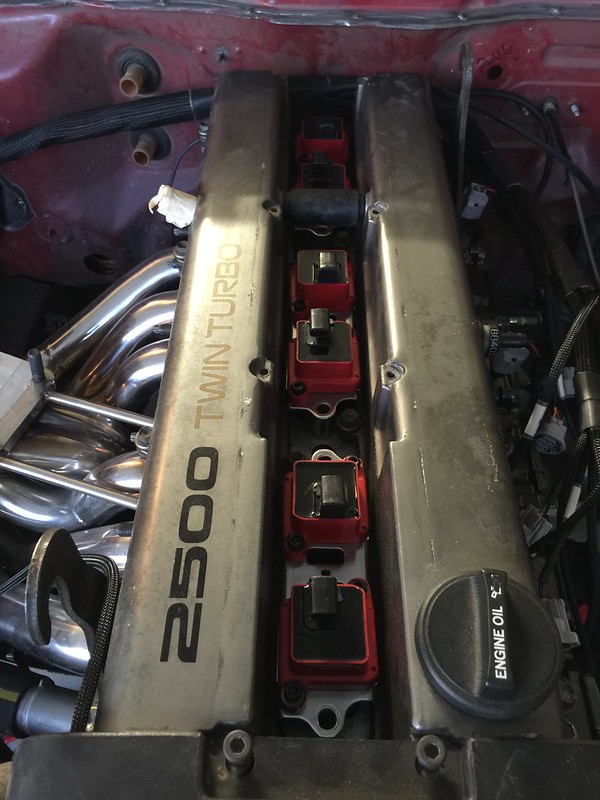

I cleaned up the SuperSpark coilpacks that I bought and then realized that I need to go buy some new screws before I throw them on the motor.
https://farm1.staticflickr.com/719/2...c5929e57_z.jpg

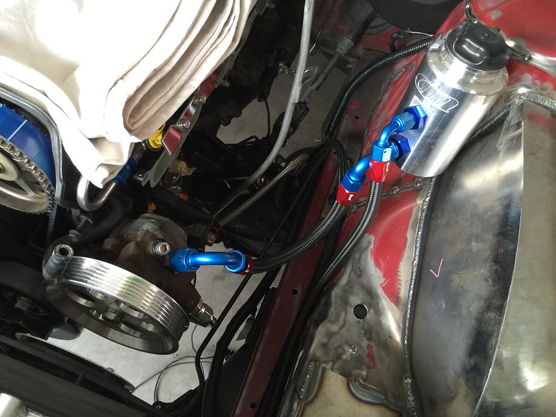

What are all of your thoughts on AN fitting colors?
I want to do my power steering system in black braided hose and nickel plated fittings. The oil cooler already has steel braided hose and blue/red fittings. I was thinking about doing the valve cover and intake hoses with black braided hose and blue/red fittings.
Do you think it would look weird having a combination of two different colored fittings?
Here is how I planned my P/S system (will be using 90 degree fittings on reservoir):

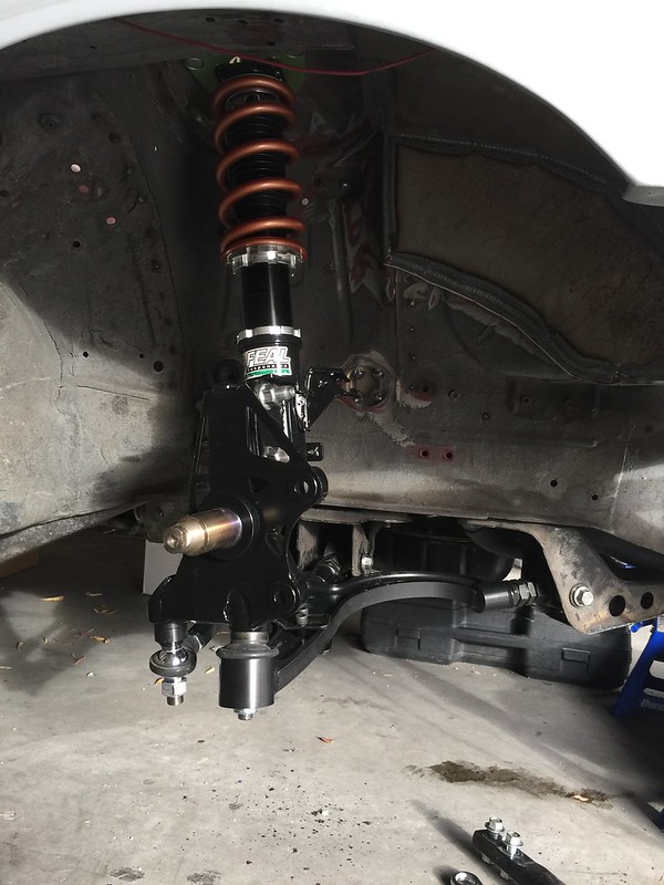

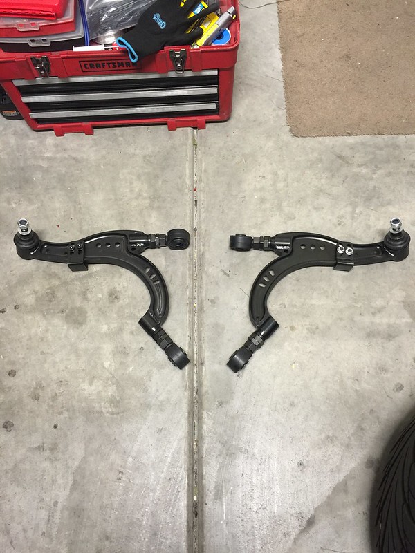

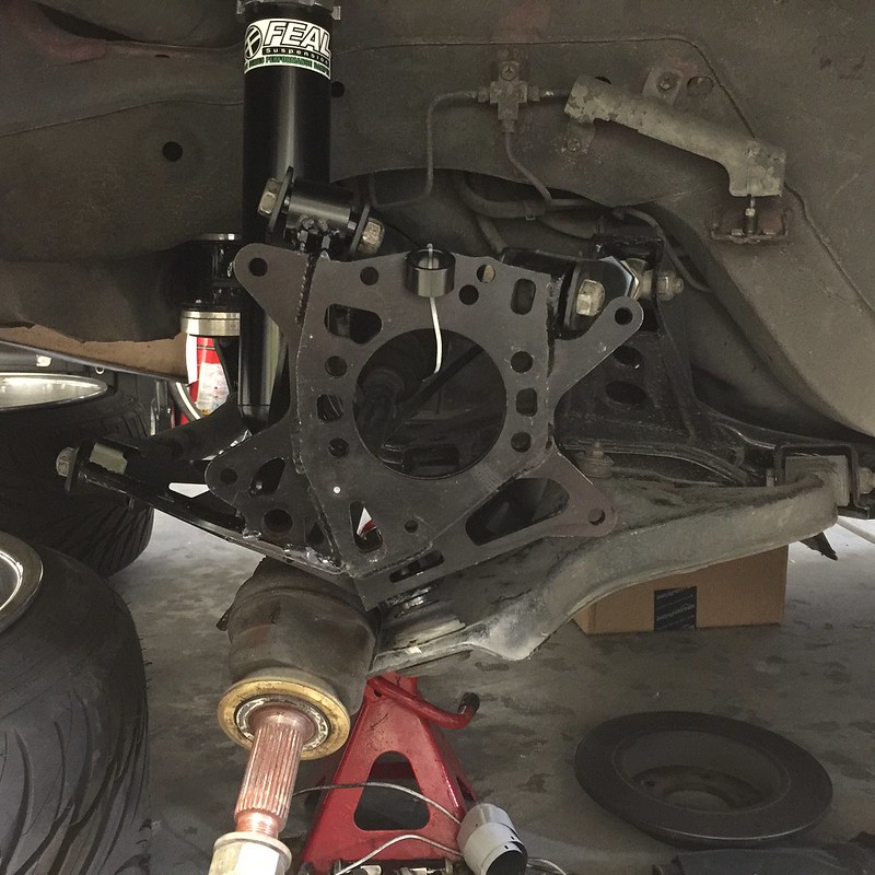

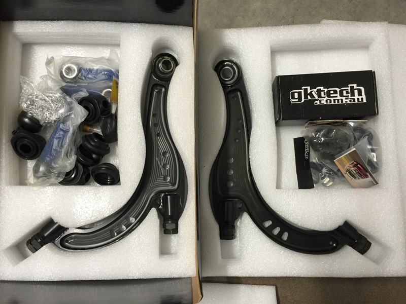

GK Tech Super Lock LCA's arrived the other day. Finding some time to install all of these parts that are piling up would be wonderful...
https://farm1.staticflickr.com/705/2...0f3384e9_o.jpg

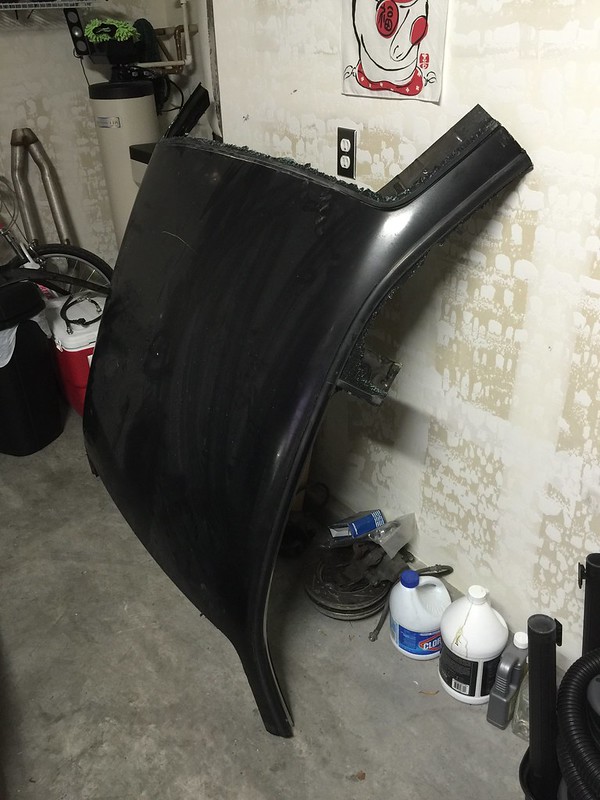

So I picked this up:
https://farm6.staticflickr.com/5825/...402b5339_c.jpg
To replace this bullshit:
https://farm6.staticflickr.com/5766/...faca5800_c.jpg

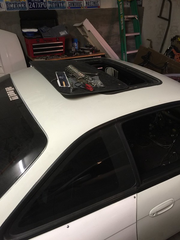

Roof panel appears to be in mint condition as well as the two braces underneath. Eventually she will be getting turned back into the glorious slick top SE that she was from the factory.
I just don't understand why people install aftermarket sunroofs. SMH :nono:

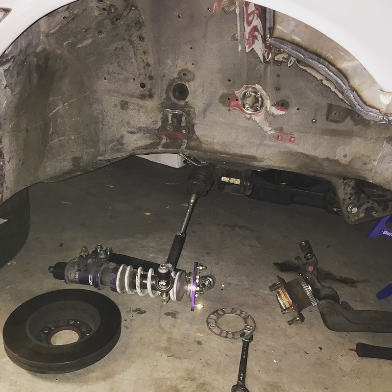

I started by ripping out basically everything on the front passenger's side.
https://farm2.staticflickr.com/1717/...75a11162_c.jpg
Then I got the LCA/tension rods assembled and ready to be put on the car. The bump stops aren't on correctly, I just put them on really quick to avoid losing any pieces.
https://farm2.staticflickr.com/1692/...f1878755_c.jpg
Once i got those bolted up I was able to start putting the rest of the pieces to the puzzle in place. The GKTech and Feal bits go real nice together! I can't wait to drive with this setup.
https://farm2.staticflickr.com/1576/...c52a71f0_c.jpg
Unfortunately when I went to do the other side I found this waiting for me in the box. No biggie, already contacted Feal and will be sending it back for inspection.
https://farm2.staticflickr.com/1521/...e3f2647a_c.jpg

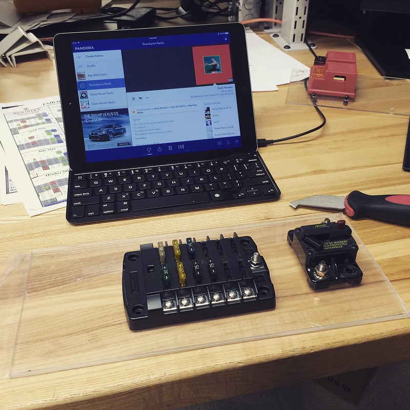

In lieu of suspension work I decided to gather my thoughts and turn my attention towards another task. I spent the rest of that day gathering a few needed materials for the next project. I got started on the final design of the fuse panel at work.
https://farm2.staticflickr.com/1472/...e96b998d_c.jpg
About halfway through design.
https://farm2.staticflickr.com/1511/...c649d6b8_c.jpg
My daughter wanted to help me mock some things up, so I let her jump in there.
https://farm2.staticflickr.com/1679/...f2b8c37e_c.jpg
Basically what it's going to look like minus the wiring. I think it turned out pretty decent.
https://farm2.staticflickr.com/1514/...05bcd37a_c.jpg

Well here we are again and as much as i didn't want to, it was time to tackle this wiring for the 50 millionth time.
https://farm2.staticflickr.com/1690/...796b1b60_c.jpg
https://farm2.staticflickr.com/1518/...e4a25f37_c.jpg
Excuse the super crude looking wires and labeling. I'm only using the stock harness to map things out so that I can get everything cut and wired to the correct length prior to building the actual harness that I will be using.
https://farm2.staticflickr.com/1453/...f4702da6_c.jpg

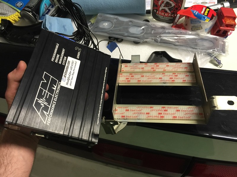

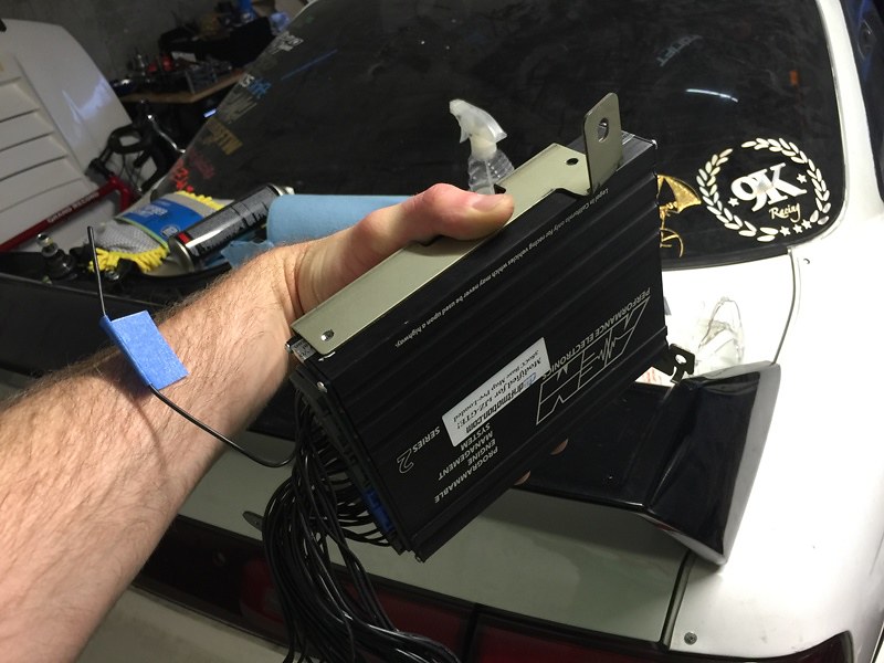

Going into this I wasn't really sure what I wanted to do as far as mounting the ECU. I hadn't really come across many good solutions, so in the interest of keeping the install clean and somewhat accessible, I decided to mount it using the factory ECU bracket. Thankfully I had one on hand.
First step was to find a reliable way of mounting the ECU to the bracket. Didn't really want to try and fabricate anything since I'm pretty bad at metal work, so I picked up the old industrial strength velcro. This stuff is serious business, it's like $100+ per box. Thankfully I have a hook-up and was able to get a few strips.
https://farm2.staticflickr.com/1590/...73827512_c.jpg
Stuck some strips on the bracket and and put the two together. Holds well and I have no doubts that it will securely hold it in place for a long time. Probably going to put some velcro straps around it just for extra security though.
https://farm2.staticflickr.com/1535/...9f91d532_c.jpg
https://farm2.staticflickr.com/1675/...67223796_c.jpg
And here it is in it's final mounting position. Turned out well and was very easy. I had originally wanted to run the USB and serial cables to some bulkheads somewhere in the car for easy access, but in the interest of cleanliness I opted to just leave it this way and remove the kick panel whenever access is needed. If the connections were used more frequently I'd consider the bulkheads.
https://farm2.staticflickr.com/1696/...416ca2a2_c.jpg
Until next time!
ka-titties 03-02-2016 02:52 PM
That's a great idea for the ECU install.
Mister.E 03-02-2016 03:45 PM
Thanks! It was simple and I think it will be more than adequate for the long term. Reality says that this will probably be the only/last car I build, so keeping it clean is one of my main objectives.

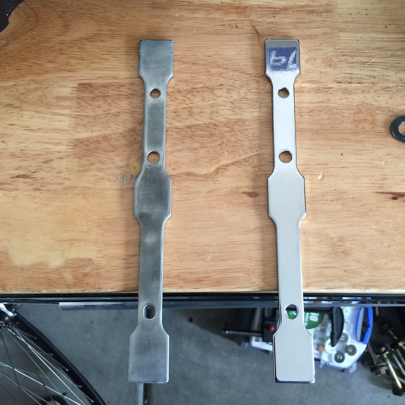

First time polishing metal with a serious motive. The left side is already wire wheeled, but the end product on the right looks WAY better than they both did when I started.
https://farm2.staticflickr.com/1623/...c24a7810_c.jpg
Finished assembling the fuel rail. Got the SARD 650cc injectors installed as well as some AN fittings for the fuel lines. The fuel rail was powder coated slate gray metallic by Snail Motorsports here in Vegas. Those polished brackets are looking pretty good on there too. :)
https://farm2.staticflickr.com/1687/...27ccccea_c.jpg
Better shot of the powder coat. Not too flashy, but oh so nice.
https://farm2.staticflickr.com/1555/...0b1e666c_c.jpg

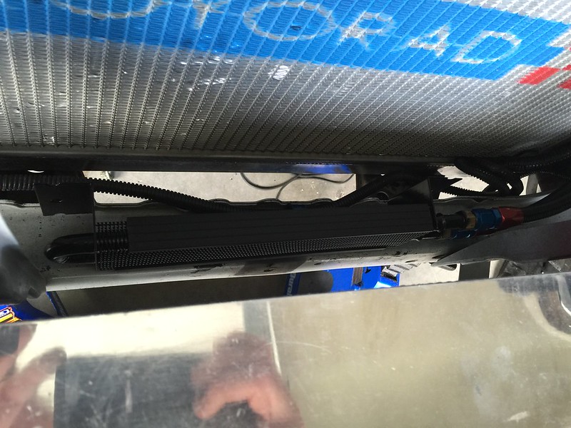

Almost forgot, but I need a little insight.
Is this dumb? I found this transmission cooler on Summit and I wanted to use it for my power steering cooler. Is it stupid to mount a solid object like this in front of the radiator? I really like this spot and it seems like the cooler was basically meant to go there from the start.
Do you think this cooler would be efficient? It's dual-pass, aluminum, and ultra-finned for her pleasure. The cooler is 12 inches long for reference. Would I be better off with the traditional style cooler that allows air to pass through? I'm no physics expert, but I'm pretty sure the air will flow right around this and into the radiator.
https://farm2.staticflickr.com/1461/...022bb1fc_c.jpg
RalliartRsX 03-08-2016 02:24 PM
The fins on the cooler act as a heat sink and airflow is not how it necessarily sheds heat. It sheds it based of area (more fins, more surface area to shed heat).
I would NOT put a solid object in front of the radiator.......The 240 already has enough problems getting flow to and then through the radiator without proper ducting, and this will just exaggerate the problem.
Mister.E 03-08-2016 02:36 PM
These were my thoughts as well. Maybe I should return it and buy a different type... :faint:
ka-titties 03-08-2016 03:14 PM
Or relocate it. That cooler is meant to be mounted in a way that the air flows along the cooler, not across it.
Mister.E 03-08-2016 03:23 PM
Good to know. The damn thing is 12 inches long so I'm not sure where i would put it so that the air would pass over it parallel to the length of the cooler. I'll see if i can find a spot to put it down by the bash bar or something.
Sent from my iPad using Tapatalk
Mister.E 03-08-2016 04:33 PM
Well a little research brought me to this: http://www.summitracing.com/parts/der-13309/overview/
So I'm thinking I'm going to return the cooler I have and get that.
Either that or the other option would be to get this and mount it in nearly the same spot as the one pictured.
http://www.summitracing.com/parts/der-13223/overview/
None of my previous cars had power steering coolers but I want to make sure I have something adequate enough for those hot summer days out here.
Do you think the additional passes of the first cooler would make for better cooling than the two much lengthier passes on the second cooler?
ka-titties 03-08-2016 05:09 PM
its all about total length. either of those will do more than enough though. just pick the one that fits your mounting place better.

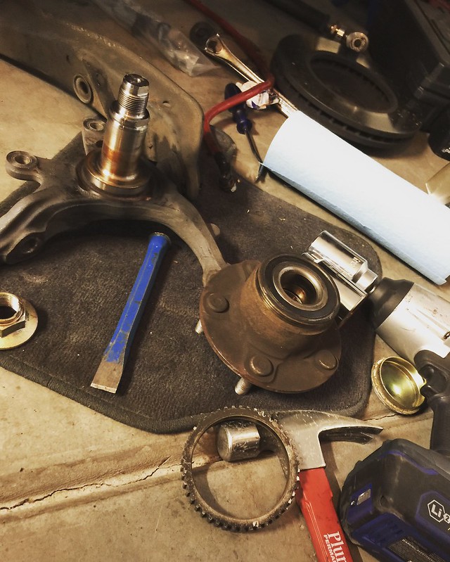

Decided that if I was going to remove ABS, I'd get rid of the rings on the hubs too. Don't half ass anything, right? :coolugh:
https://farm2.staticflickr.com/1553/...61121794_c.jpg
Temporarily laid the coil packs to rest after polishing the brackets a little bit.
https://farm2.staticflickr.com/1708/...5a4d5479_c.jpg
Per suggestion I returned the other cooling unit and bought this Derale P/S cooler with -6AN fittings already incorporated. Gonna have my buddy weld up some brackets for this next time the car is at his shop. I decided to complete the lines for the whole P/S system as well. They turned out pretty good IMO.
https://farm2.staticflickr.com/1638/...75bdd655_c.jpg
https://farm2.staticflickr.com/1700/...64aa379b_c.jpg
I had a chance to begin installing the rear knuckles as well. They are going to require a bit of adjustment on the arms to get everything squared up for initial install. Gonna work on that part later when I have some more time.
https://farm2.staticflickr.com/1597/...90531e38_c.jpg

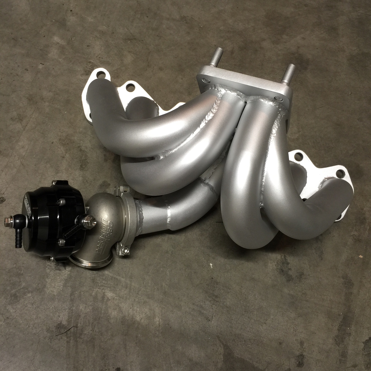

I did get the manifold ceramic coated in high temp silver and threw the wastegate on there.
http://uploads.tapatalk-cdn.com/2016...c8d6bb33ed.jpg

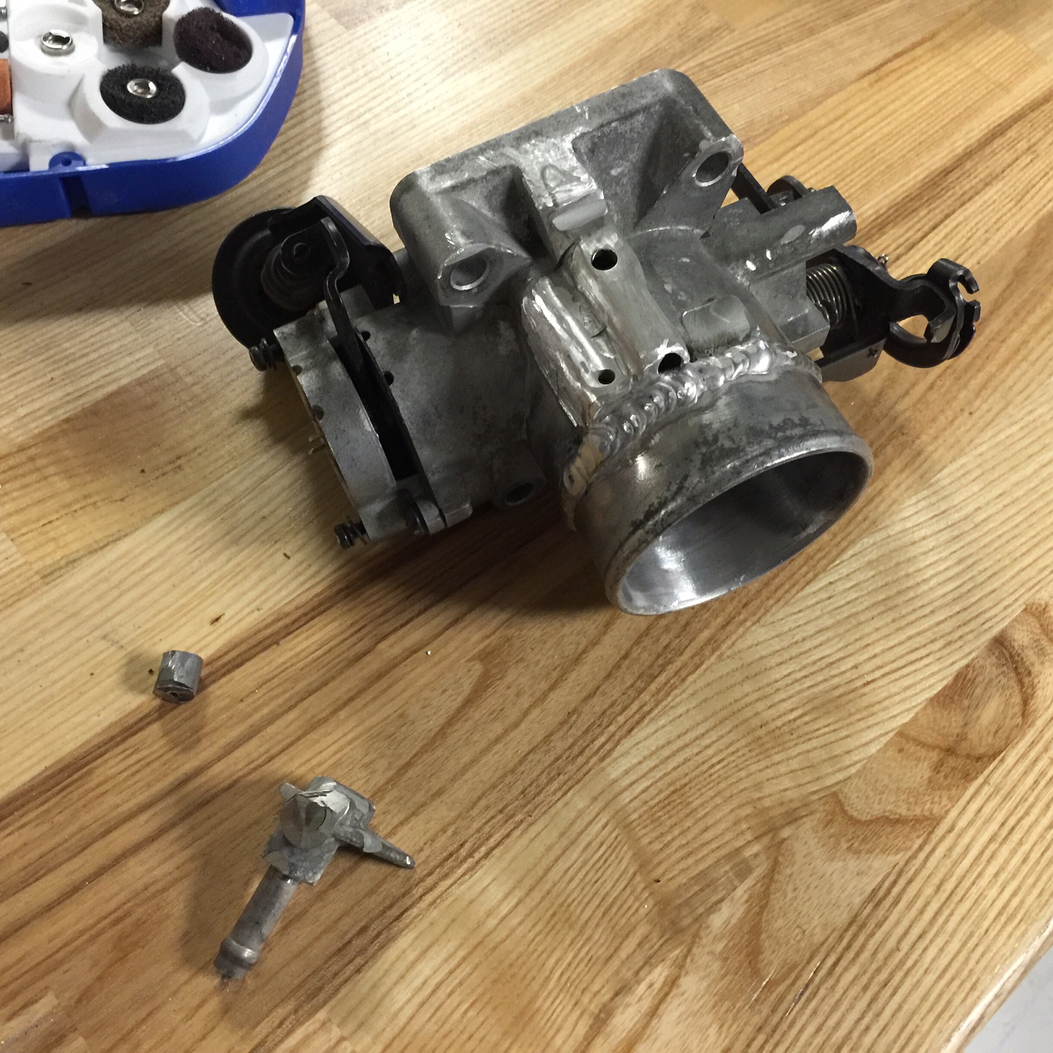

Haven't had much time to get anything done, so I decided to trim the last bit off excess crap off of the throttle body. Slowly but surely I will get this car finished.
http://uploads.tapatalk-cdn.com/2016...736eb1f6ad.jpg

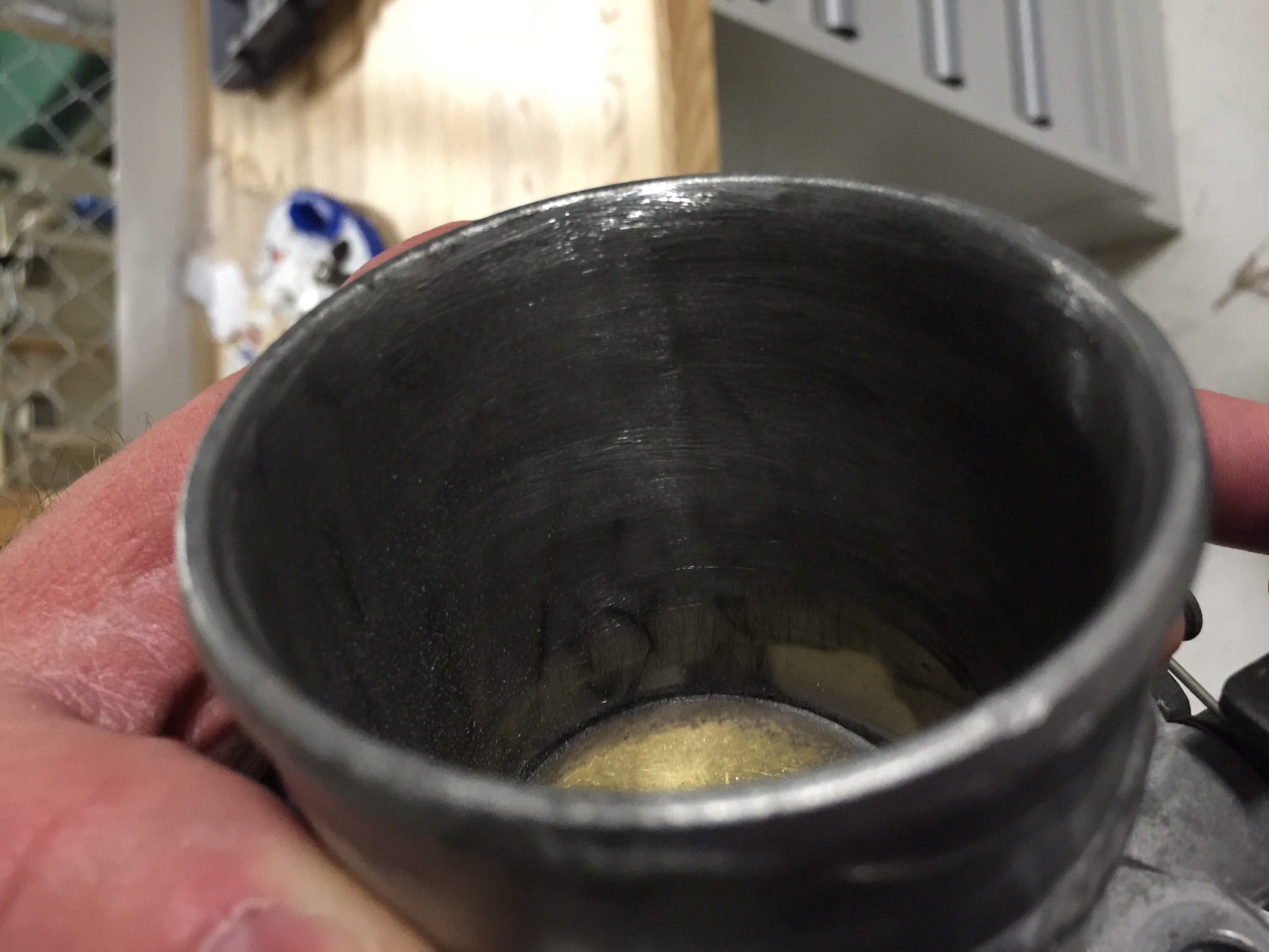

I also did a little work on smoothing out the inside of the throttle body where the two pieces were welded together.
http://uploads.tapatalk-cdn.com/2016...bdf382cc38.jpg

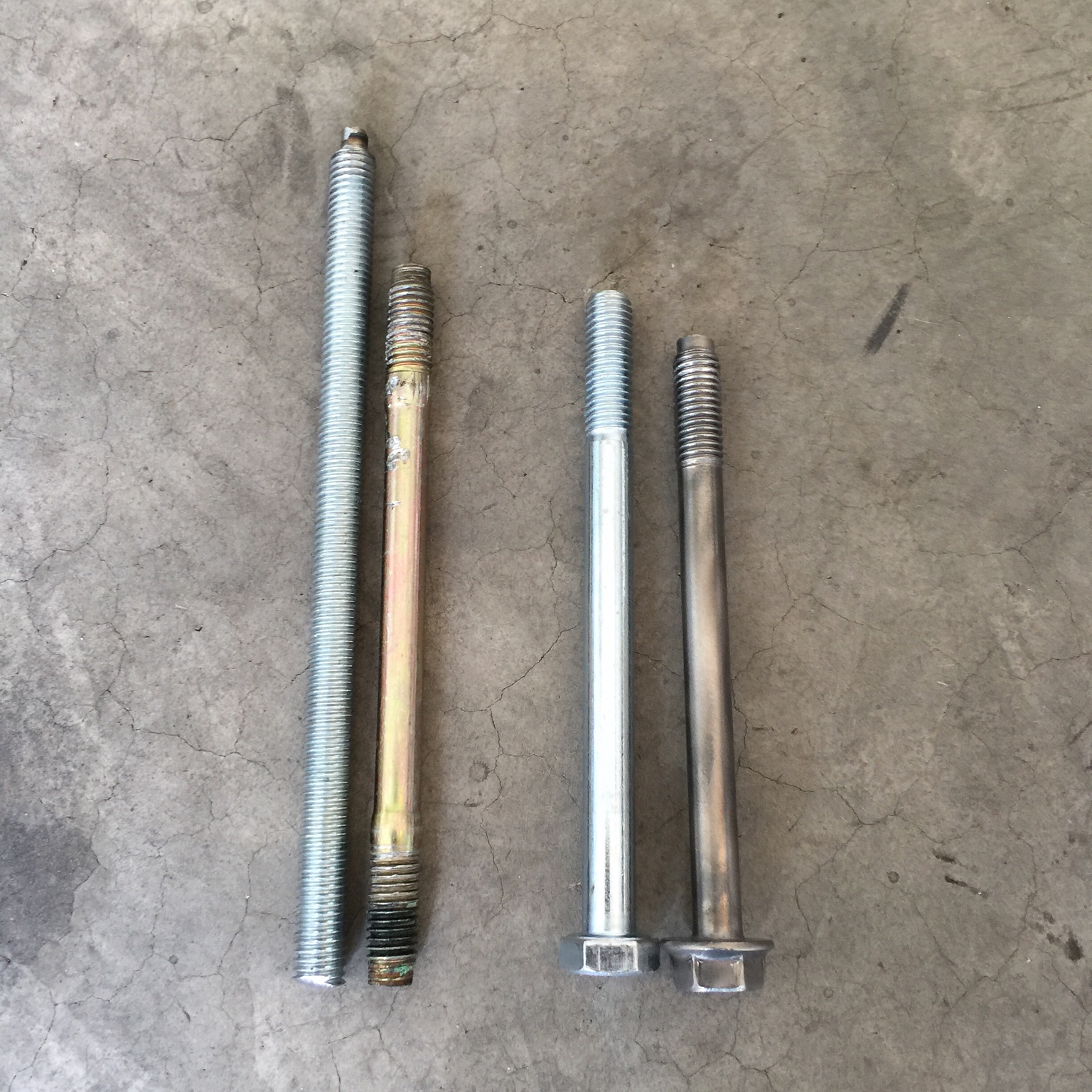

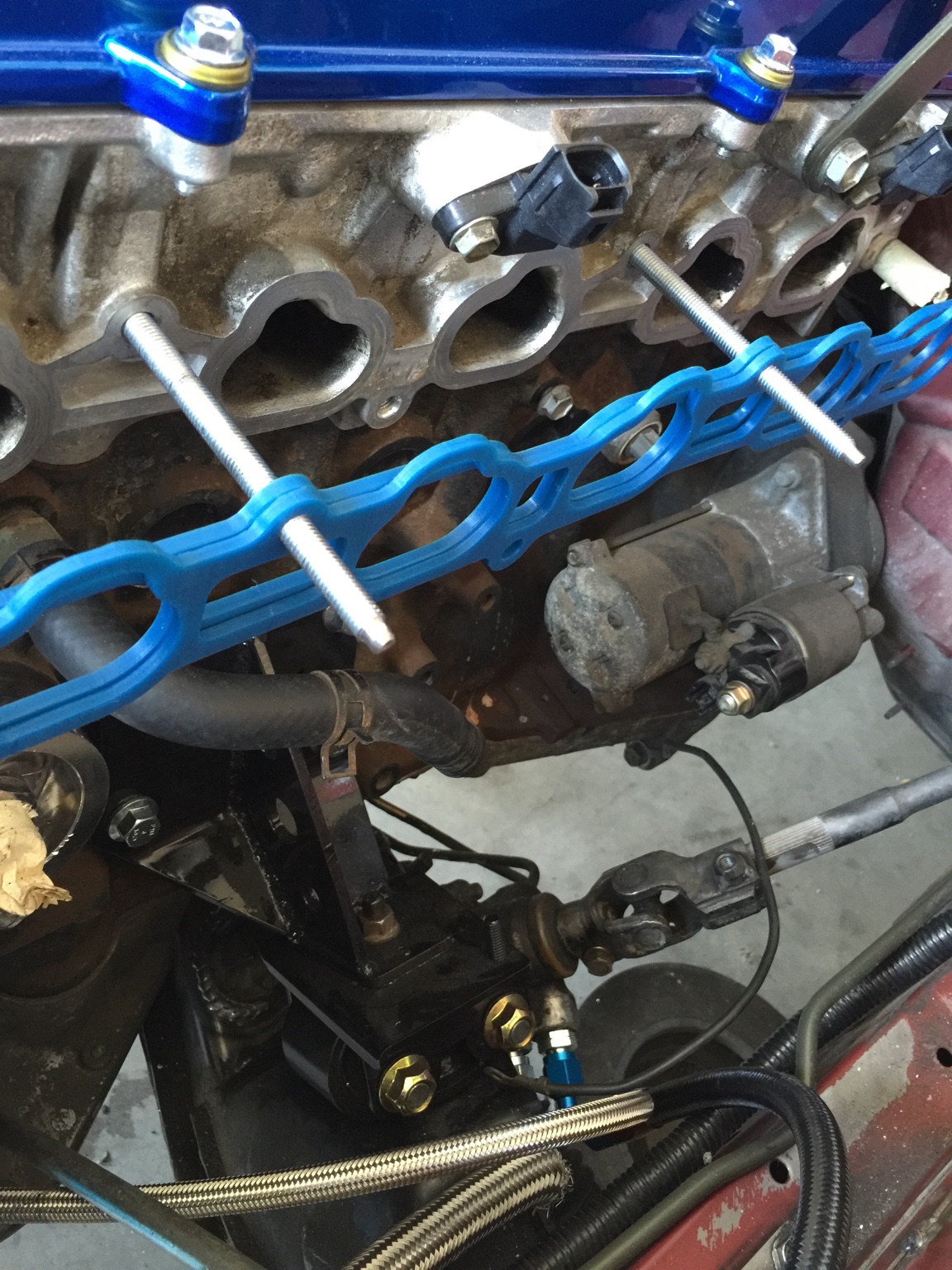

I stripped one of the studs on the intake manifold side of the head due to the increased thickness of the thermal gaskets. It was clear that I needed to make my own so I swooped by Lowes and picked up some M8x1.25 threaded rod and some slightly longer bolts to replace the factory ones.
http://uploads.tapatalk-cdn.com/2016...567a1106f6.jpg
I threw the two thermal gaskets on there so that you can see how much thickness is actually added. Had I known any better, I would have had the upper intake manifold welded to the lower runners to eliminate that second gasket. That shit is too difficult to source on it's own and I didn't want to run two thermal gaskets. I had my factory gasket but it was in absolutely terrible shape.
http://uploads.tapatalk-cdn.com/2016...3789185d54.jpg

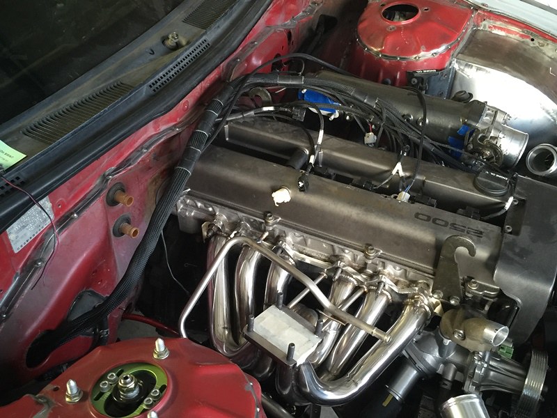

Put in some work today to get the engine back to a point that it hasn't been in for a long time. Valve covers were powder coated but there are still several components that need to be cleaned up. I was getting sick of parts sitting all around the garage and couldn't wait any longer to put this thing back together. I still have so much left to do, but I feel accomplished today. I managed to get the Wiring Specialties pro series harness installed as well. Now that the harness is in place, I can go back to the interior and finish up some things in there. The harness tucked in really nicely and it was a dream working with new connectors. Usually all of my connectors are stuck or broken.
If anyone needs anything from Wiring Specialties, you can use discount code ERIKDRIFT at checkout for 10% off your entire order.
http://uploads.tapatalk-cdn.com/2016...de4b1bc2aa.jpg

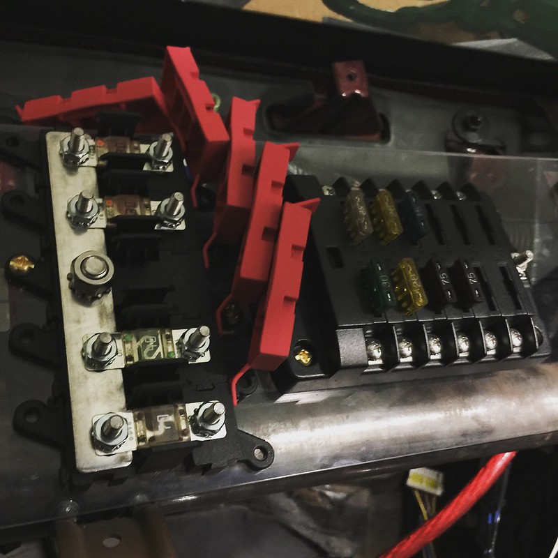

BiG MiKE86 05-24-2016 12:44 PM

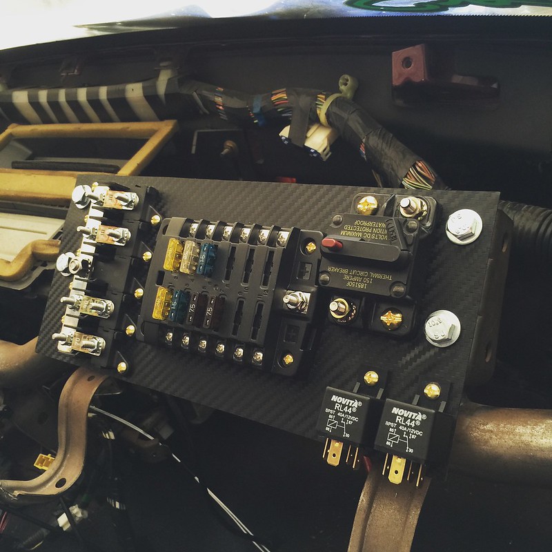

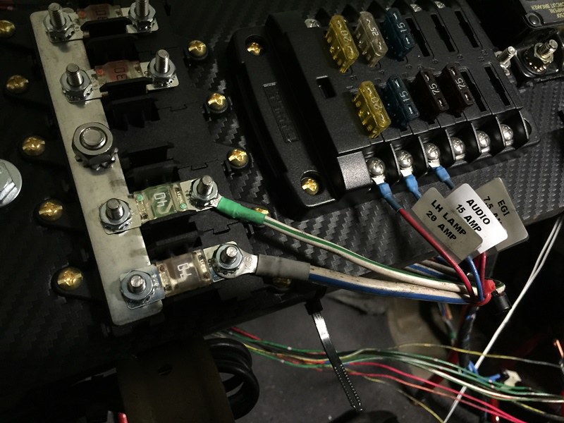

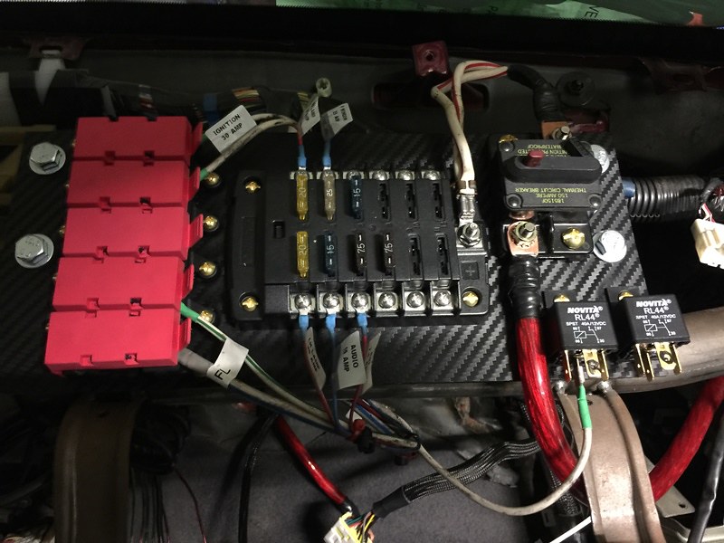

Just looked through the whole thread man - very nice build! Diggin the fuse panel you did it came out pretty clean
Mister.E 05-24-2016 12:49 PM
Thanks Mike! It's been a lot of work so far. I'm still hoping to have it running this summer and completed well before the end of the year. Wife is still taking night classes, so I'm constantly strapped for time to complete projects.
I still need to clean up the fuse panel and re-wire everything but I'm definitely pleased with the end result.
Sent from my iPhone

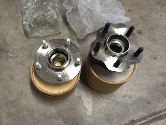

Not much of an update, but I bought all new hubs just because it's one of those things that I felt like replacing.
http://uploads.tapatalk-cdn.com/2016...ad1a90adbf.jpg

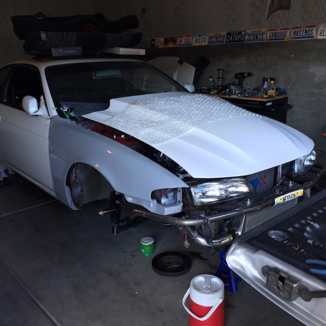

I have decided to join Paisa Drift as well. I copped this mustang hood so that I don't feel weird when I run over any innocent bystanders... [emoji16]
http://uploads.tapatalk-cdn.com/2016...159b3ea6f3.jpg

DJTTon 05-26-2016 03:41 PM
Hey few questions for ya,
you plan on making that hood fit?

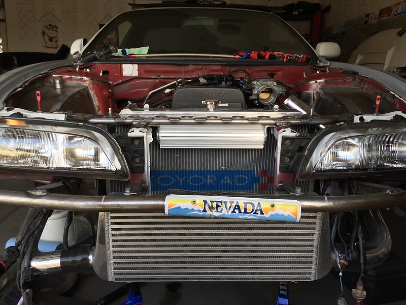

Whatd you use to make such a nice polish for the rails? did you clean up headlights too?
and are you considering a bashbar for all the roadkill?
