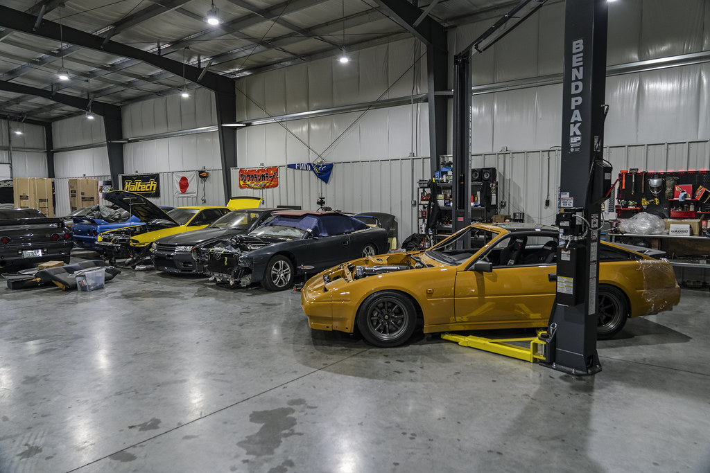

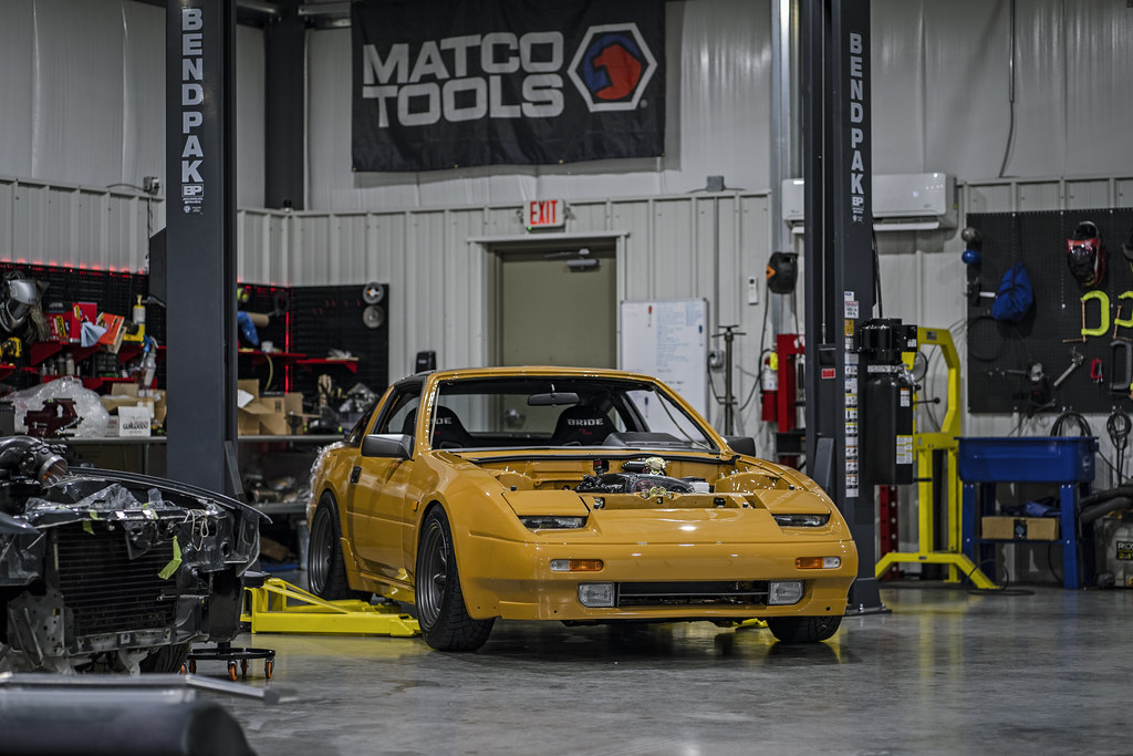

The chassis harness for the relays and lights etc is done being lengthened and snaked through the fenders and under the front lower rad support so now it will be completely invisible. The fuel lines are all run to the tank and I just need to put the flex fuel sensor in place. New pump is in the tank.
The custom power steering reservoir was painted to match the car. All the exterior trim is on the car now except for the windshield trim as the glass will go back in last.
Custom rear lower heim shock mounts are in and fixed all of the rear issues. The S13 lowers were binding on the rubber bushing due to the angle and the tube was touching one of the lower arm bolts. No more bind and clearance was vastly improved.
Headlights are fully installed as is the bumper bar. I am hoping to get the fenders and front bumper back on the car this weekend. Tail lights are in and a friend who has done a lot of the custom fab and wiring is on the way now to help with more electrical as well as getting the rear hatch on the car.
Next will be the engine harness and battery cables.

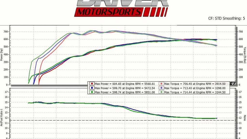

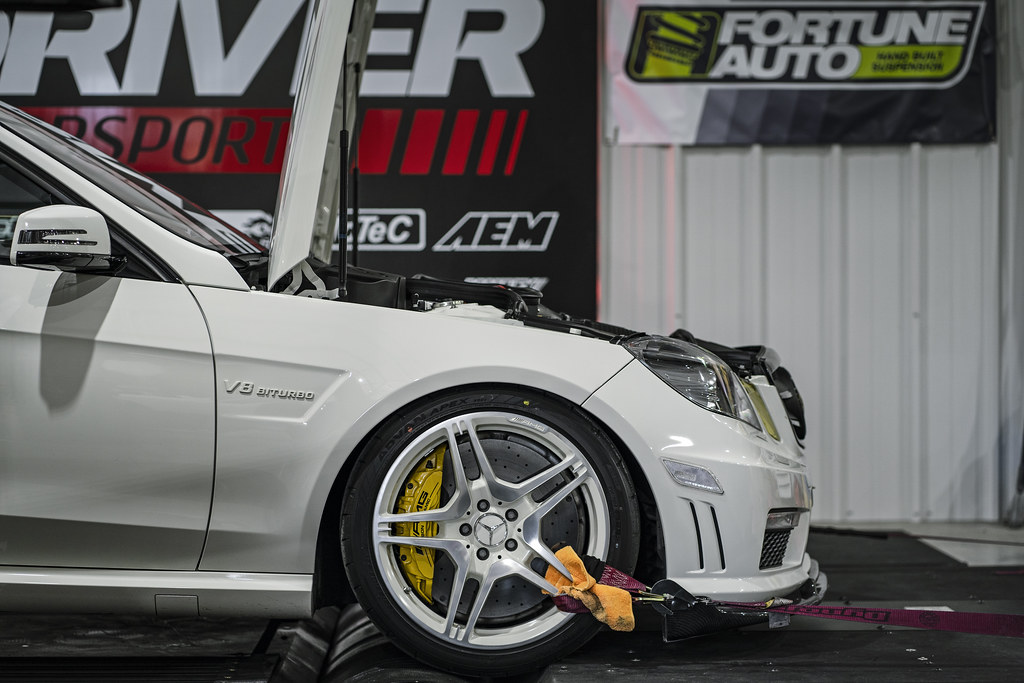

I also put my AMG Wagon on the dyno. 604 RWHP and 714 ft lbs!

Ka24Power 07-25-2021 09:53 AM
Looks so good in the daylight! Can't wait to hear the RB with the ITB header combo. It's going to be next level.
Nice numbers on the E63! Thing is a torque monster, lol.
