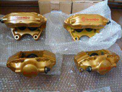

2. Evo/sti brembo brakes
Front: 04 STi Brembo calipers / Evo rotors
Rear: 04 STi Brembo calipers / Evo rotors
Brake lines: Brembo brake lines for STi Brembos
notes: rear caliper/ebrake. brembo calipers on your z32 setup:
#/f/tech-talk/93748-...ml#post1342840
note about sti rears:
#/f/tech-talk/93748-...ml#post2057367
front calipers need adapter bracket:
http://img223.imageshack.us/img223/3...ture0588ln.jpg
http://img249.imageshack.us/img249/3...racket1fs0.jpg
mounted picture (17" wheel)
http://www.driftclub-il.com/johnc/Ni...s/brakes11.jpg

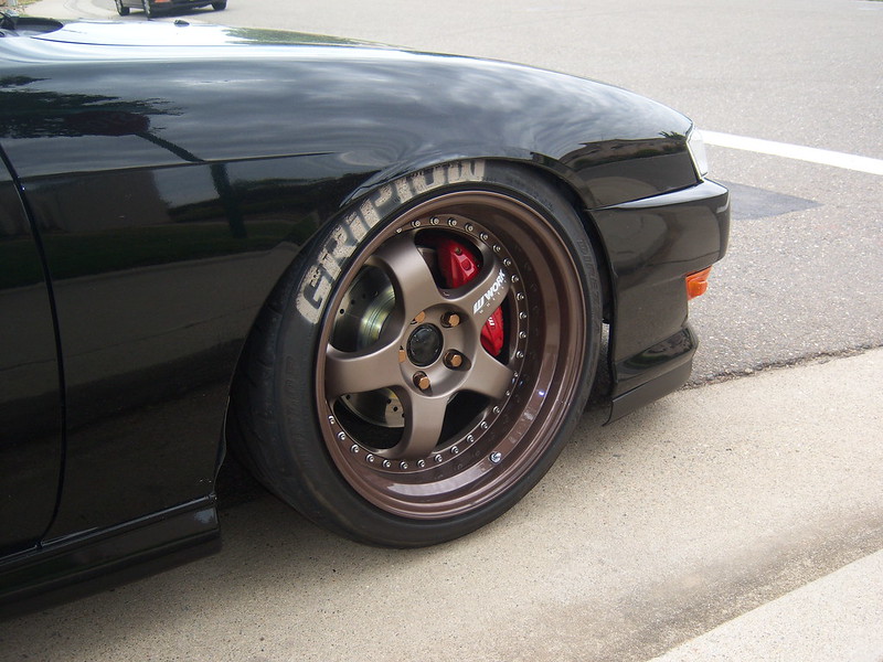

i dont really like my rear set up which is Sti + Z32 rotors, im thinking about a special order. IDC! lol dont mind the harness, i will be tucking it, and tubs!
http://farm8.staticflickr.com/7003/6...066c0ef740.jpg
IMG_3142 by d_2jzgte, on Flickr
JaredP 01-25-2012 10:28 PM
^^^sti brembos in the front right? what dont you like about the rears? feels unbiased? and what size is the wheel (im gonna guess 17")

killer240 01-26-2012 12:21 AM
yes Sti fronts and rears +17/16 BMC and yes those are 17's
Sti rear rotors are thicker than Z32's

I think I have decided to go with the Wilwood forged superlite 4 piston bbk on the front of my ls1 powered s14. Purpose of the car is street use, with a lot of autocross/ track use. Does anyone know what rear brakes would work well with this kit and result in a well balanced setup?

or a set of r34's brembo's from a proven brand instead of some honkey tonk bfe set of poverty bbks
http://www.nissansilvia.com/forums/u...4268_thumb.jpg

SMH. "Here are some OEM brakes, they are better than your OEM brakes and painted gold so you know they're better, now take them and replace your OEM brakes with these OEM brakes."

Te37 09-17-2013 04:49 PM
http://i306.photobucket.com/albums/n...D1D6D1EEE1.jpg

CaptainVlad 09-17-2013 05:02 PM
Not to rag on you, but my point exactly. ^^^(TE37s post)
Look at all the cars that run stuff like Wilwoods, and cars such as the one posted above. Chances are those cars that see the road course every weekend with their "redneck" brakes see more brake use in that one day than the ones with the "cool" brakes will see in their whole life.
