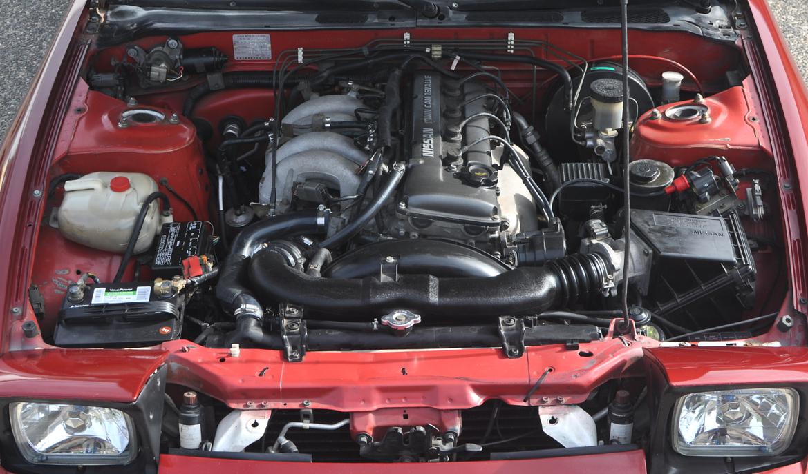

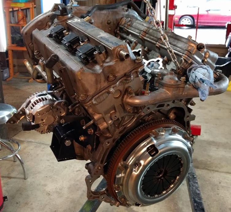

In this saga we start with Hawaii 2-4-Oh (KA24DE hatch):
https://s3.us-east-2.amazonaws.com/p...ge_mmthumb.png
And continue until today's version of Blue Bayou (VQ30DE, race suspension, aero, big brakes, fuel cell):

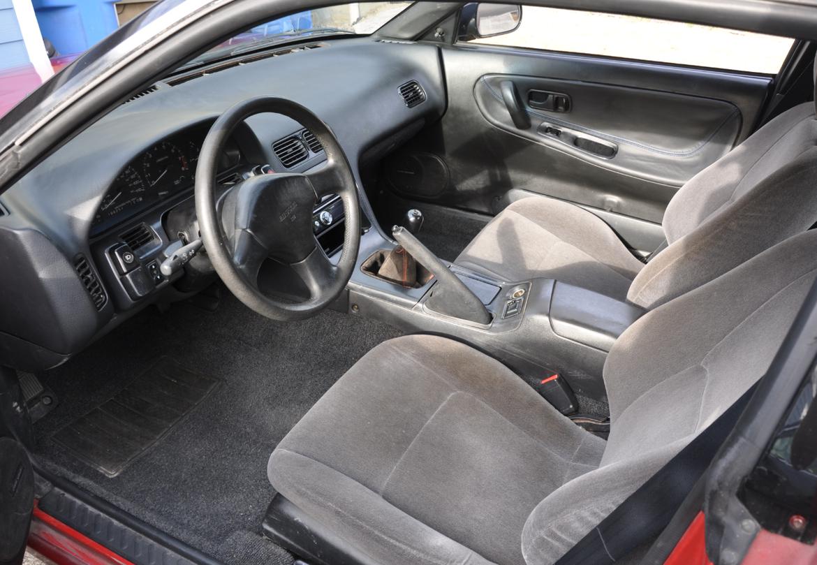

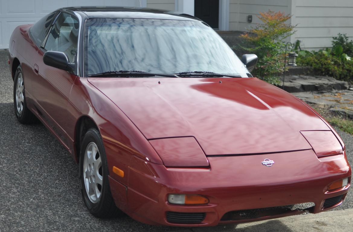

The 240SX was the next obvious car to become interested in, as it was like my first car only better in every way. My 200SX was angular in every way, yet the 240SX was smooth and new looking. I got my first 240SX in 2002 while I was going to college, a car that I still have. This car eventually developed rod knock, which turned into putting in the 2.0 turbo engine, paint/etc, bigger turbos, blowing that up, and eventually an LS1 that is still in the car (used primarily for drifting).
https://s3.us-east-2.amazonaws.com/p...ge_mmthumb.pnghttps://s3.us-east-2.amazonaws.com/p...ge_mmthumb.png

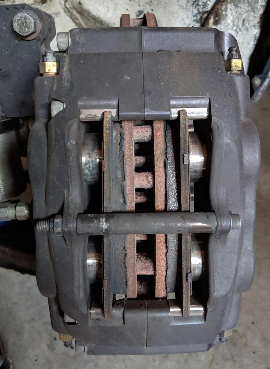

The brake pads..

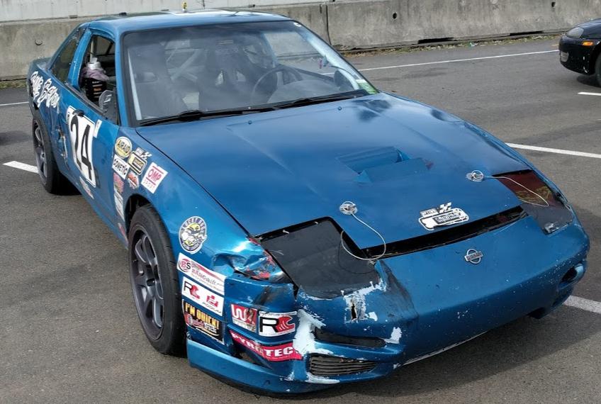

The Disaster (3/31/2013) - 10 hours - Portland International Raceway:
We started this race in the rain in 26th place. Nathan Feigion ran an excellent first stint and got us up to 5th place! I get in the car and we are fighting back and forth for 1st place in the rain with the front-wheel drive cars. This is the best we have ever ran and it is looking great for a podium! It's still wet when I pit in 2nd place to turn the car over to Dave. A dry line has developed, but is still quite wet off of that dry line. While coming down the straight at PIR, a car pops out to try to outbrake a bunch of cars. However those cars are on the dry line, so it is a very overly optimistic move. Dave never sees it coming, and gets slammed in the front end while going into the chicane. The right front strut tower is moved over a foot, our day is done.
Crash at 7:00 in this video:
http://www.youtube.com/watch?v=VpIvTo3vN8Y
Now we need to decide what we do about the car..

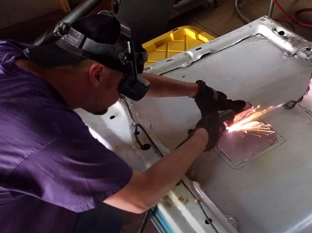

We bought a tubing bender and a pile of tubing. We also bought a plasma cutter, which I cannot recommend highly enough! It seems a lot of people think plasma cutters are only for bigger shops, but I think this tool should be right in line behind a welder. Every single time I use this thing I am so happy that we bought it. It is SOOO fast, easy to use, and compact. It also does not leave a sharp edge, which makes it perfect for chopping out sheet metal in a race car.
TECH TIP #5: Buy a plasma cutter, you will thank me! They aren't that expensive any more, and save so much time!

To help with our cooling situation, I made a vent in the factory hood.

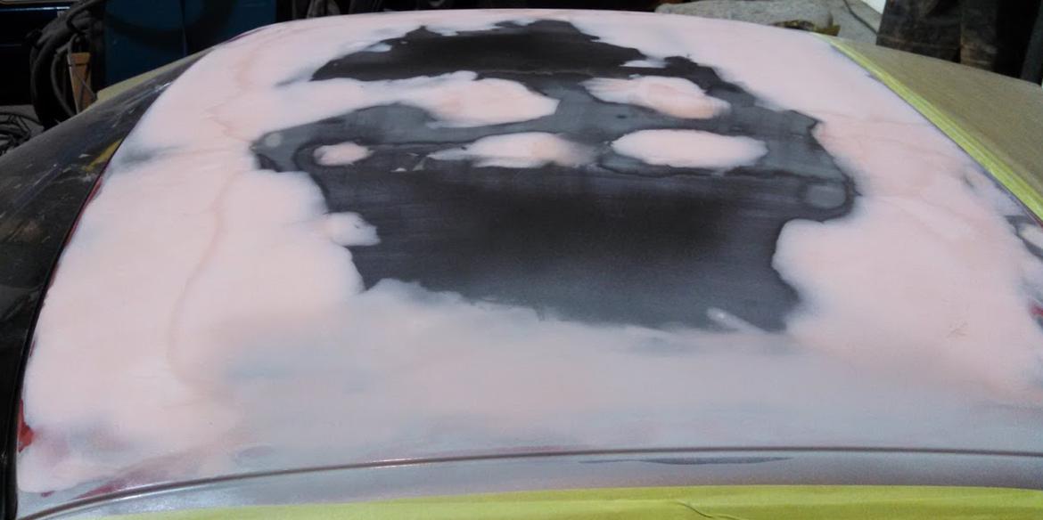

We set up a makeshift paint booth, and I tried spraying a car for the first time ever. With a race car, less pressure if I screw it up.
While it's far from perfect, I was pretty happy with how it came out. The biggest issue was I put three coats of paint on the rear quarterpanels and only two on the rest of the car and it was super obvious next to the door.

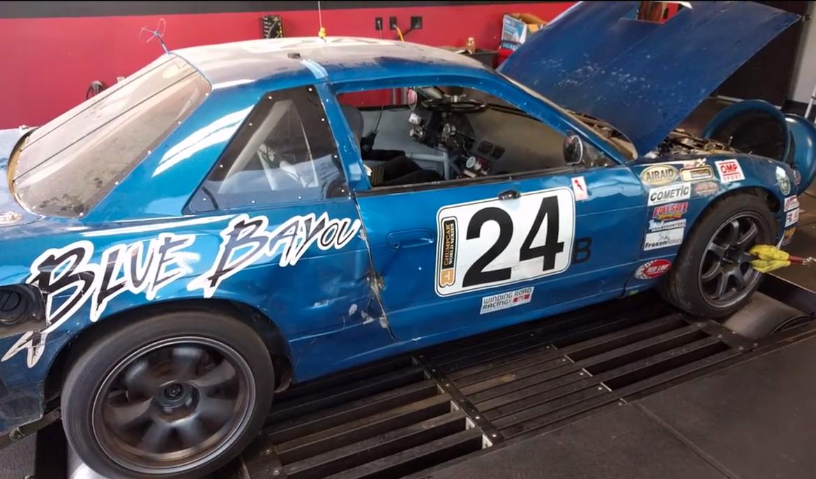

I borrowed our new team name based on the Mitsubishi paint named "Blue Bayou", this was my original sketch of the logo:
We are not from the South, and I know nothing about any real bayous, it's just a play on "Blew by you". I thought this was obvious enough, but I've had a variety of people come up to us saying that they hadn't realized this for a long time. There was even a Reddit thread about it that blew up:

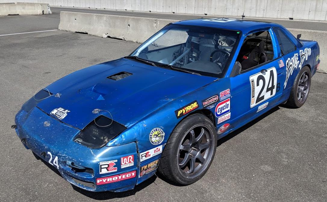

Here she is all done up and pretty!

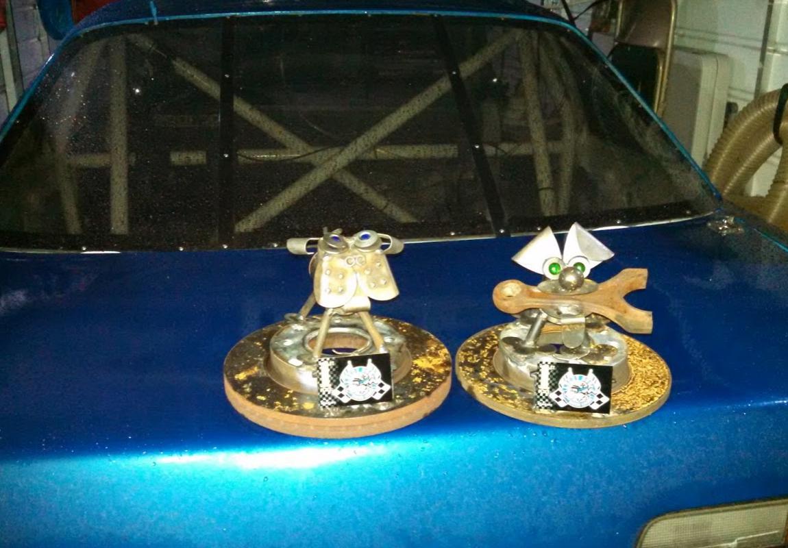

This is the massive and awesome Predator trophy, I love this thing!
Look at the awesome details here, how many hours does this take to build?? Way better than a generic chrome trophy..
We were also voted "Corner Worker's Choice" for the small trophy to the right, as they were entertained by drifter Nathan's "Amazing Saves" into turn 2.

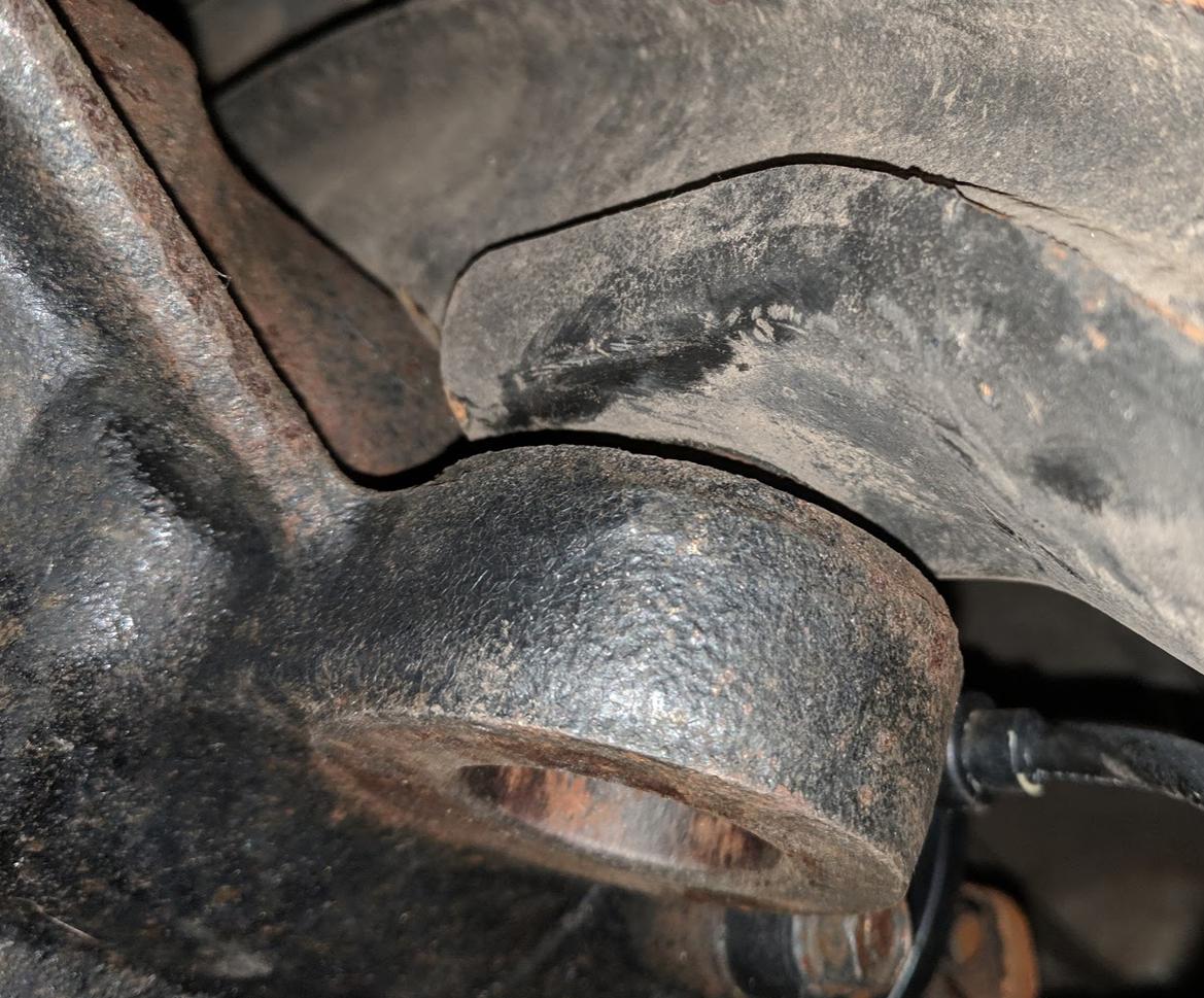

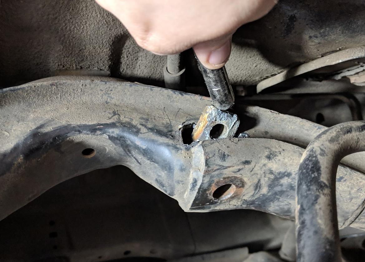

knate 12-28-2020 12:58 AM

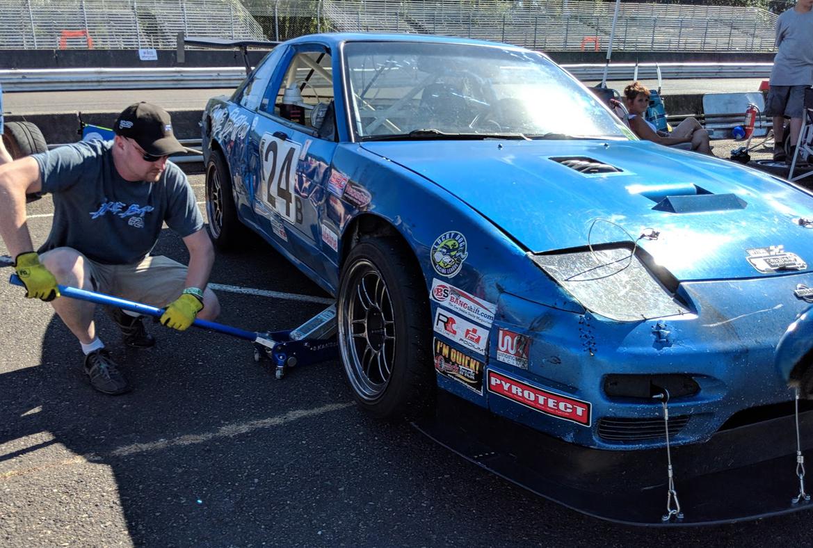

After the Ridge race we had some damage to try clean up. We picked up a Porta Power and try to straighten the sheet metal a bit. We did some pulling with a bracket on the outside, some hammering from the inside, and some Porta Power work. We also swapped the fuel tank as it had a softball sized dent.
We got the corner a lot straighter, as well as installed a new fire system.

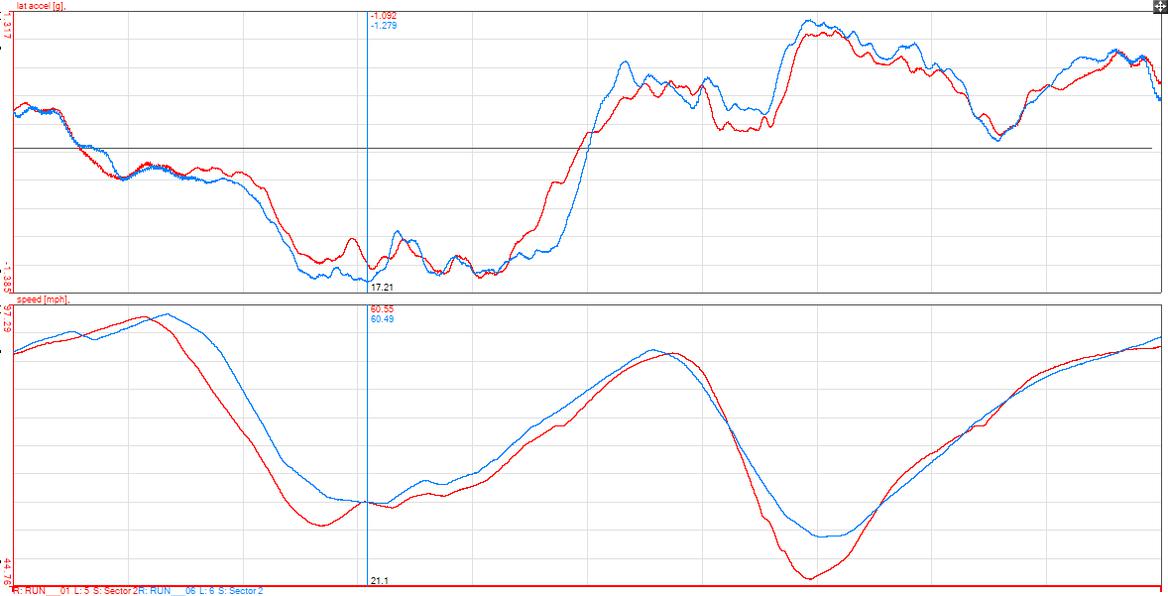

I get into the car in 26th place and start to get used to the track. This is a busy track. Normally there is a nice long straight to relax, check gauges, and reset. At Pacific Raceways the straight has a kink where you cross over to the end of the drag strip. That means you are lining up between cement barriers to get onto the straight, where you then move over to the left to prepare for a very fast turn 1. There is also some good elevation change dropping down a very tight 3a and 3b before you make it to the dangerous 5a and 5b corners with Grand Theft Auto style ramp curbing and a steep dropoff to the right.
https://upload.wikimedia.org/wikiped...ck_map.svg.png
For the next session my dad gets back into the car in 15th place. This time there's another car off this time in 5b, stuck partway up the hill. My dad finds that this track can be tricky to find safe places to pass, and without a lot of power the uphill sections and straight are difficult to make it past people.
I get in the car in 11th place, and this time I'm already warmed up so I start trying to see if I can improve on my lap time. I am pushing hard, but maybe just pushing too hard. I only get to within 0.5 seconds of my previous fastest. I get up to 8th place by the time the checkered flag is waved. Not bad for a first time and having a punctured tire! During the race we had tried to get the tire repaired, and found that it was a 2" long piece of a wheel weight that had gone all the way into the tire, and just doing a partial lap was enough to completely destroy the tire inside. So unfortunately with the tire looking brand new on the outside, it was now garbage.

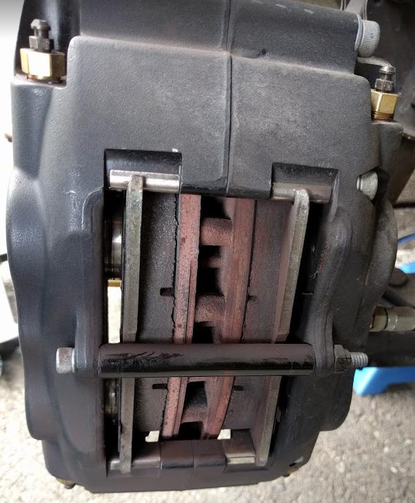

We were also getting much too familiar with changing brake pads after every single race. We were using Hawk Blues and stock brakes with ducting, but we needed more mass. However going with bigger brakes, meant bigger wheels, bigger tires, which would all keep adding more weight to the car. Not to mention when we had spares of everything, it's an expensive changeover. So we keep changing brakes...

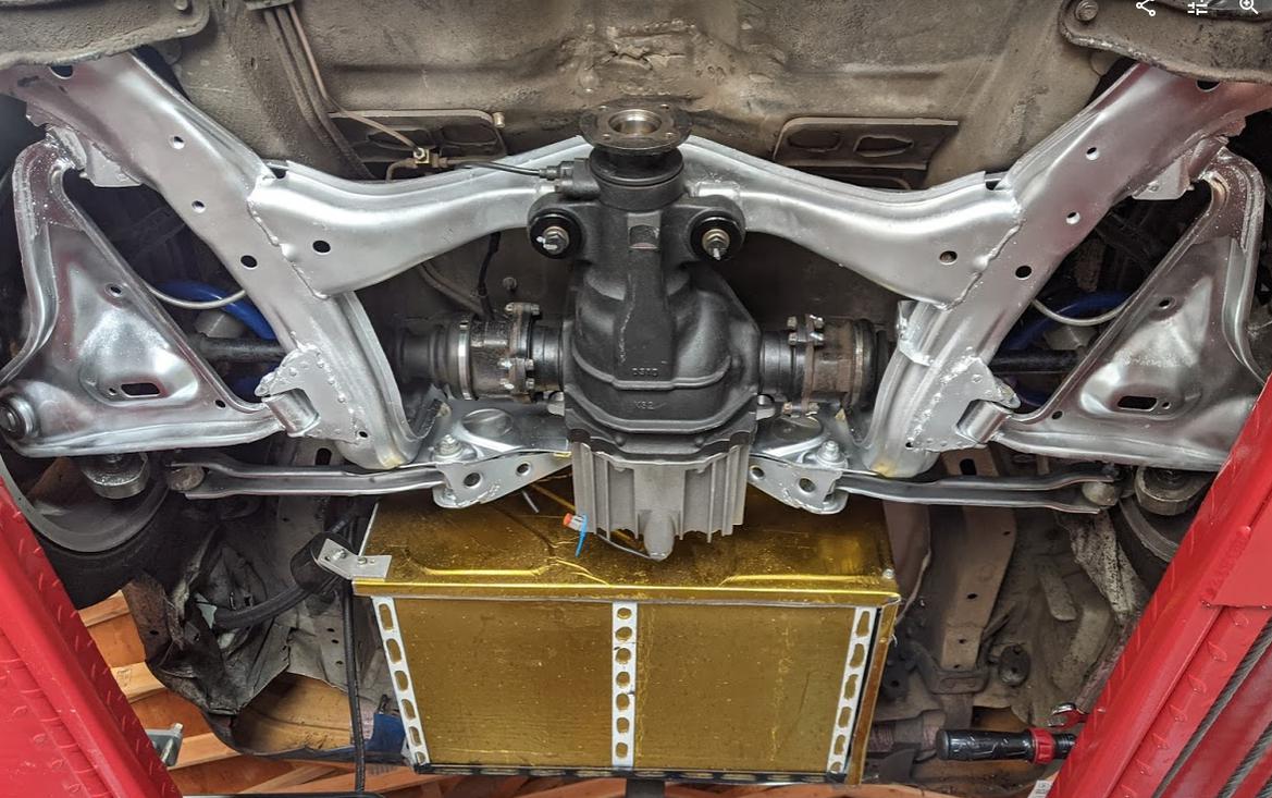

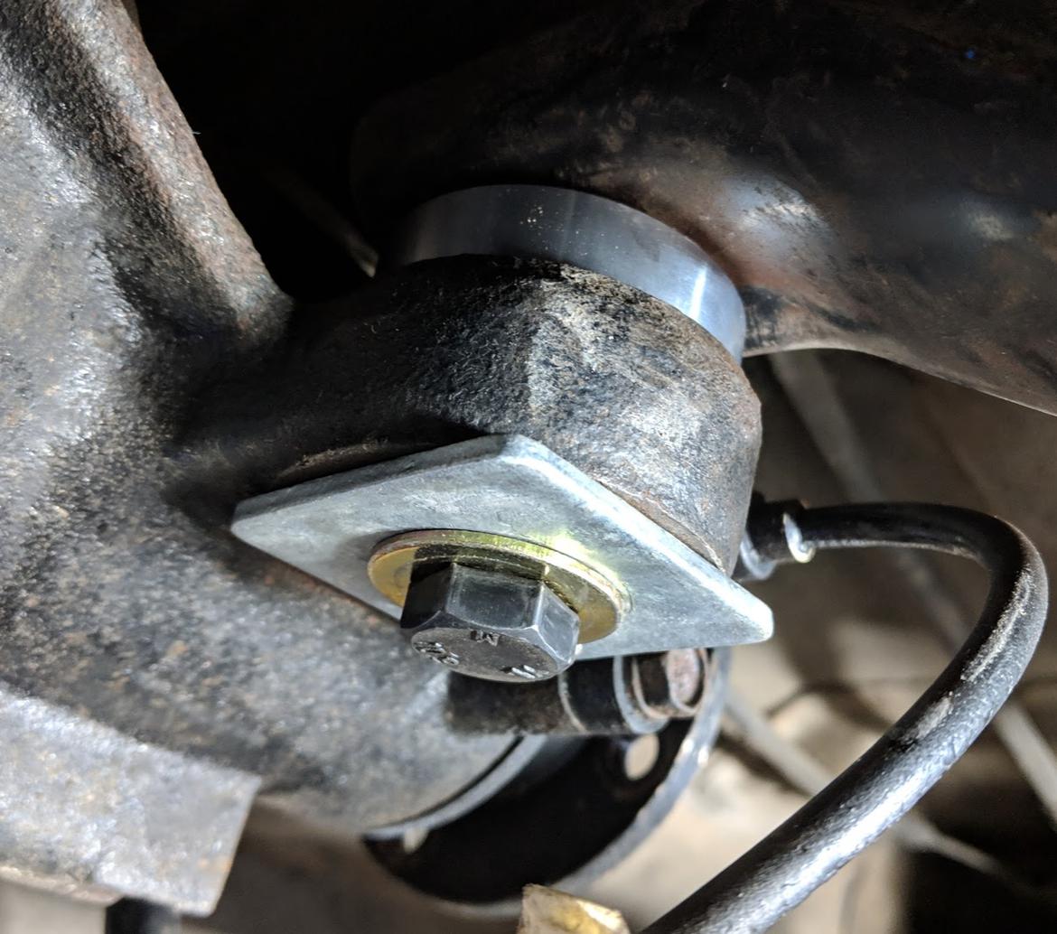

We had an S14 subframe (95-98), but with ChumpCar rules we would have to take points for installing it. Cutting/welding the S13 subframe to match the geometry however was free. The S14 subframe has less antisquat, which gives a little better grip under power. Here you can see my very scientific measuring..
Here you can see how raised the front of the control arm is on the S13:
Compared to the mostly flat LCA on the S14:
This was my solution:

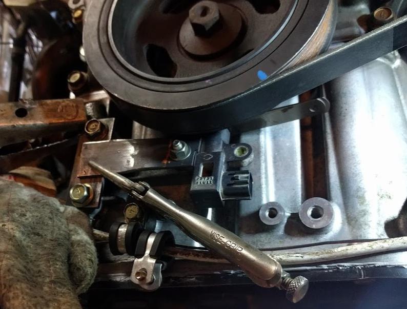

When putting the engine together we tried to use an S14 front cover.. and discovered that it causes an oil leak..

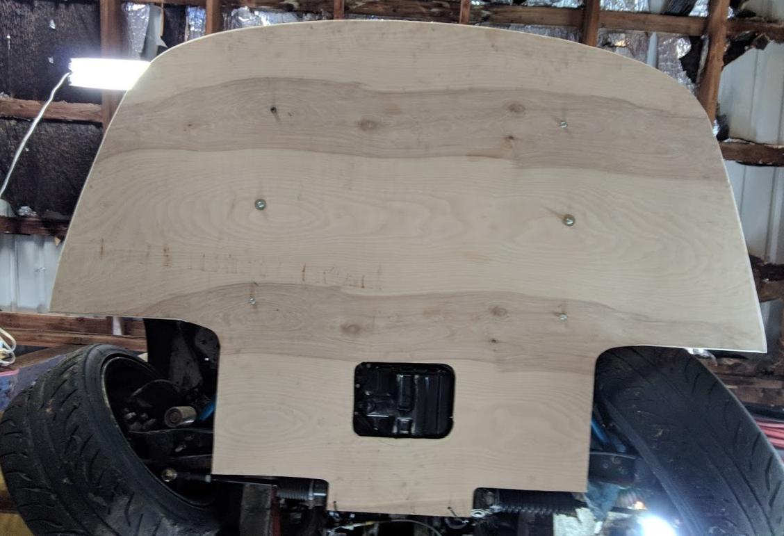

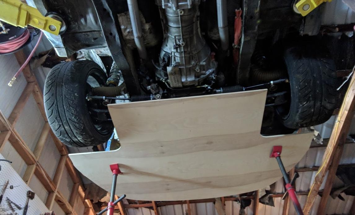

We had seat sliders, but they were stiff to adjust and we never moved them. So in order to drop the seat a little more, I made some custom seat mounts:

We also got a sneak peak at the trophies for the weekend, and there is an AT-AT, I want it!

I get in the car last, so it's all up to me now. Having a new driver in the car our original goal was to crack a top 10 finish. We had dropped to 14th during our pit stop, but I'm pretty consistently below the 2 minute mark so we are looking OK. The car is working great, the coolant temp is perfect and engine power is up to normal. Adequate, but not great, just like normal. It's now lap 150, there's just 30 minutes left in the race and I'm in 10th place. The brakes don't feel right, not stopping as good as they have been. I have a very fast and aggressive BMW behind me, so I point him by, not wanting to try fight with him with unknown brakes. He goes by me, and I tuck in behind him for turn 11, the extremely sharp left-hand turn before the straight. As I get to the brake marker I hit the brakes, AND THE PEDAL HITS THE FLOOR! Since I'm not slowing down, to avoid rear-ending the BMW I yank the wheel to the right and fly off into the gravel trap.

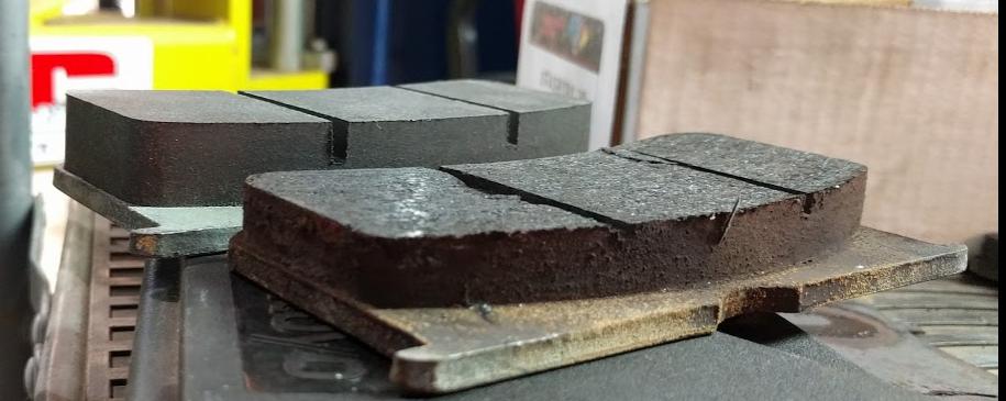

After I get pulled backwards out of the gravel, our undertray scooped up enough gravel they might have wanted to send us a bill! When talking to my dad afterwards he asked me if I had tried to use the emergency brake. I told him, "There was zero time for that! All I could do was yank the wheel to avoid hitting the other car." The interesting thing was when I watched the video back.. I actually start pulling the e-brake, but because I had just swerved the back end starts coming around. Going sideways into a gravel trap is a major risk for rollover. I put the e-brake back down while counter-steering with my left hand to try get the car going nose-first, and mostly succeed. All of this was essentially reflexes from drifting, as I didn't even remember touching the e-brake!
The cause of all this? Me being cheap/lazy with the brake pads, and thinking that the car would make it six hours on slightly used pads. Once the pad was gone, the piston over-extended and blew brake fluid all over when I went for the brakes that last time.
Tech Tip #12: Brake pads don't have linear life. A pad with 100% material stays cooler than one with 50% material, so once the pad is low it goes quickly! 50% thickness is beyond 50% of it's lifespan.

I take the car out next partway into my stint, I am trying to work my way around a gray 5-series BMW. The car is fast, but the driver is erratic and having issues with oversteer. I find out later that he is an experienced Spec E30 driver (experienced.. not necessarily skilled). I can't keep up on the straights, but can reel him back in again in corners. As I follow him into turn 11 I see him go wide and he is going off course. This is my chance! He will have to back out of it and I will have a chance to sail by. Except... he doesn't back out of it. Major Mistake #1: Even though he's fully off track, he stays in the throttle... and comes back on the track fully sideways! I aim left trying to miss his car but the gap is closing quickly. There just isn't enough room, and while I manage to miss his car by about one inch.. I am pointed towards the barrier and there is now no avoiding it. I smash the barrier with the front, then the back, then come to a halt. I now have a smashed car, and the guy that needed to just back out of throttle has a perfectly intact car. But he's not done yet.
There is a massive cloud of dust on track now and he is sideways on track on the left side of the track. This is off line, where nobody drives. Major Mistake #2: For some reason he panics, thinking someone may hit him, so he floors it trying to turn the car around quickly. The cloud of dust is mainly on the left side of the track as well. Mopar 4 Life (Dodge Neon) suddenly sees the BMW reappear out of the dust onto the racing line and turns left to avoid the BMW.
And.. here's where we get to Major Mistake #3: Thinking he can drift and can execute a quick donut to get going. He over-rotates, and now is coming back LEFT! Mopar 4 Life is trying to dodge, but the BMW driver thinks he is a Mustang leaving a Cars and Coffee and won't stop until there is some destruction.
At this point the BMW driver's insatiable appetite for chaos has been satisfied. The Neon slams into the BMW sending steam, glass and car parts everywhere. The BMW is totalled, and the Neon that has been towed from across the country has a destroyed front right corner and a broken windshield. Three smashed up cars due to one driver's poor choices.
Tech Tip #13: If you go off track, don't try to be a hero and save it. Just back out of it, gather it up, make sure it is safe to enter the track, and get on with your race.

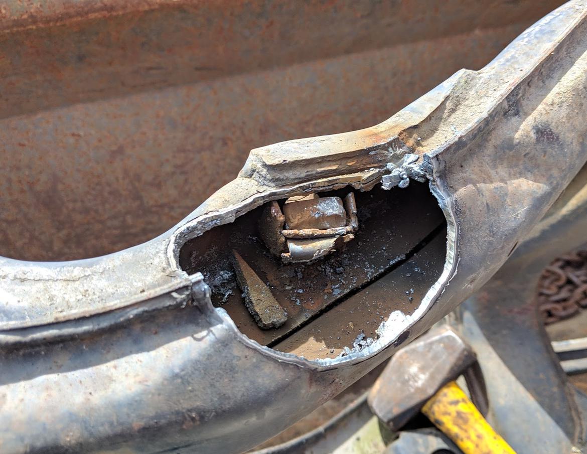

After I get checked out for a concussion (all good) I limp the car back into the garages. Time to fire up some A-team music and get to work! We assess the damage, and aside from all the smashed up sheetmetal, our worst problem is the lower control arm. We don't have any spare arms, and this arm is custom. We had cut and welded extra metal into it to lengthen it for more camber.
This arm is supposed to be straight across the top.. that's pretty bent. On the plus side, the area I had welded up showed now issue.
Even if we can find a stock arm, we would need both arms, and then we would destroy the outer edge of the tire due to lack of camber. Time to try fix it.
We borrow a torch and try getting it hot and putting 1 Lard-Ton of force into it. That doesn't work.
We end up cutting it most of the way through, bending it, then welding it back up. We had reinforcement metal borrowed from Wrecked'em Racing and a welder I believe borrowed from Tubby Butterman. Fellow racers are so awesome!!
We used some chain binders to pull the corner of the car out some and were feeling pretty happy about our progress. It's July 4th, the race is over, and the day is winding down. Wayne from Scrap Attack walks over to see how things are going, and says, "Hey, you guys are using the factory radiator brackets. We never use those anymore as it tends to crack the plastic end tanks if you hit something." I pull off the brackets and sure enough, our radiator is cracked! Thanks for saving us from some more pain Wayne! Unfortunately.. while we have an entire engine with us, we do not have a spare radiator. Time to see if we can fix this one. I had heard of 'plastic welding' using zip ties, so I grab my soldering iron and melt the crack together and use zip ties for filler.

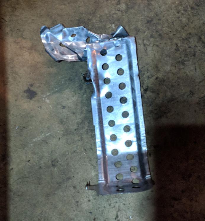

I woke up at 3am and could not stop thinking about the radiator. As I lay in bed I was trying to think of what I could do to make the fix more robust. RTV on it's own wasn't going to help, but if I could cap it to contain the RTV that should hold up. Unfortunately it was at the post on the radiator where the crack was, so I needed cap with a hole in it. I realize if I use a washer I could hold some RTV in. But if I wait until we go to the track in the morning, the RTV won't have time to cure. At around 4am I slip out of the hotel room, and head to the track. It was a little weird arriving in the dark and working on the car in the brightly lit garages with a ton of race cars and me being the only person there. I put together my washer stack and got it all RTV'd together and used zip ties to hold it down. While I didn't get very much sleep, I felt a whole lot better about the robustness of the fix now.

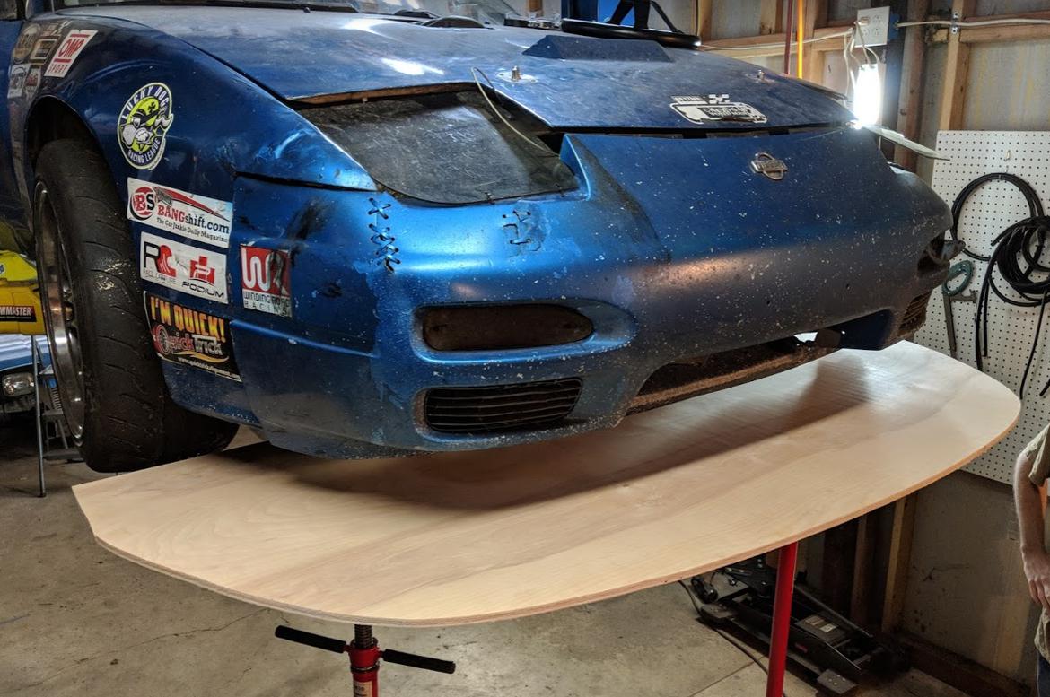

I also made a backing plate to help pull out the left corner of the car:
Then with the help of a Porta Power a couple of excavators..
We got the strut tower brace to match my other 240SX and got the corner looking roughly correct.

I also wanted to remake the lower control arms, and then we could use the old ones as spares. I picked up some new arms from RockAuto.
I cut the arm and added in the new metal to space the arm. Again the reason for extended control arms was this was "free" in ChumpCar points compared to commercially available camber adjustment.
Next up I added a bridge across the bottom (with my OK at best welding skills on display here).
At this point I have two extended control arms that would likely be strong enough.
But to reduce stress on the joint, I then wrap the top with sheet metal and plug weld some holes in it.
I add some more braces on the bottom, and then I'm sufficiently happy that the rest of the arm will bend before anything I cut breaks (just like the last arm proved).
A little paint, and they are ready for the car.

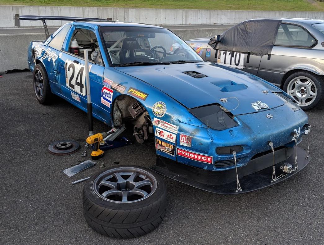

We jump into action to repair the car. This is the first time we've tried to do a caliper swap live during a race. And ... as you might imagine, it's HOT!! Like still smoking after being removed and on the ground kind of hot. The reason we lost brakes is our pads were so far gone that the piston popped out of the caliper. Again. Dave swaps the caliper on the right while I change the pads on the left side. I can't grab anything, even just my glove grazing the caliper is enough to send an instant wisp of smoke. I am trying to use a tool in each hand like some kind of caveman salad tongs. We get the new pads in and some new fluid in, and then bleed the brakes. Total time: 15 minutes. Not bad for a first time doing a hot change in the pits! In the picture below you can see the caliper smoking on the ground.
This brakes thing is getting ridiculous. To have 1st place snatched away due to brakes like this is frustrating. This will be our last race weekend on these brakes.. These Hawk Blue pads provide fantastic stopping power and feel, but in combination with stock brake hardware they just get too hot and disappear (even with our ducting). They used to be fine, but as we get faster we push the car harder.

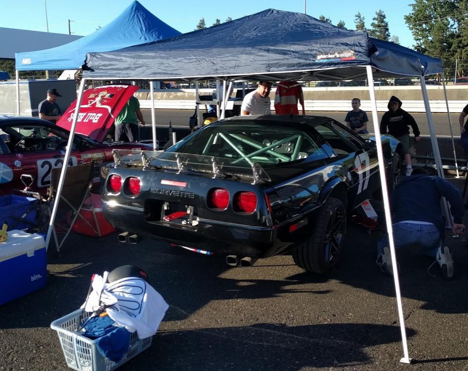

We were pretty happy with it but we are also really slow if you watch the Corvette racing team swap calipers..
http://www.youtube.com/watch?v=0cBpMas109g&

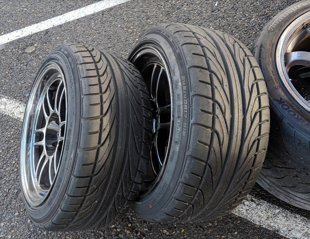

The difference in tire is pretty significant as well:
The 17x9s with 225s definitely change the look of the car:

And here is the best part.. I measured the brake pads after the race. We used up only 3 millimeters of front pad, and essentially none off the rears. That is with 13 hours of endurance races, 3.5 hours of sprint races, and another hour of practice! Finally some brakes that are not a maintenance nightmare, this is the best upgrade we have ever done for the car!
You can see the rears were hot and working.. but no measurable loss of pad thickness.
Here's a view of the dust shield turned brake duct. You can also see our camber spacers, currently set to 'MAX' (the other side says 'POOP').

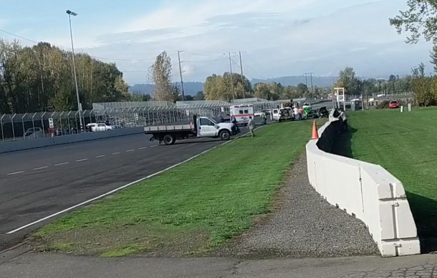

This Camaro was not so lucky and needed a tow.

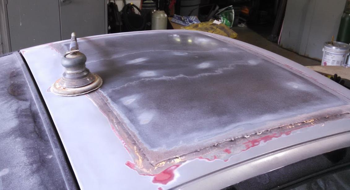

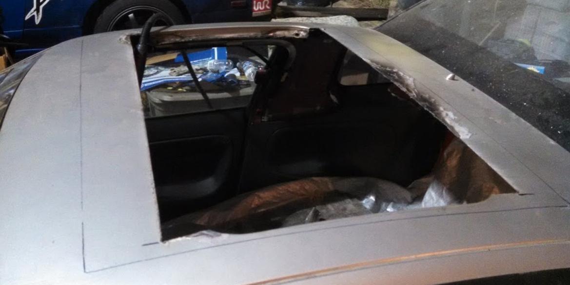

I also had been driving a beat up automatic 240SX and the transmission had failed on it. Rather than fix that car, since it was already not in good shape, I decided to put together a new 240SX street car.
I had this chassis which was fairly straight, but it had no engine and had a sunroof. I'm tall, so sunroofs are no good.
We also had another chassis that we had picked up to make our next race car out of.. but it had a bent/separated frame, so it was sitting there doing nothing. So I stole a piece of it's roof:

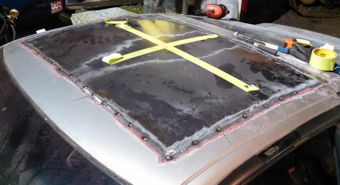

Then I cut the sunroof out out:
I tacked the new piece on, using my tape/measurements as a reference:

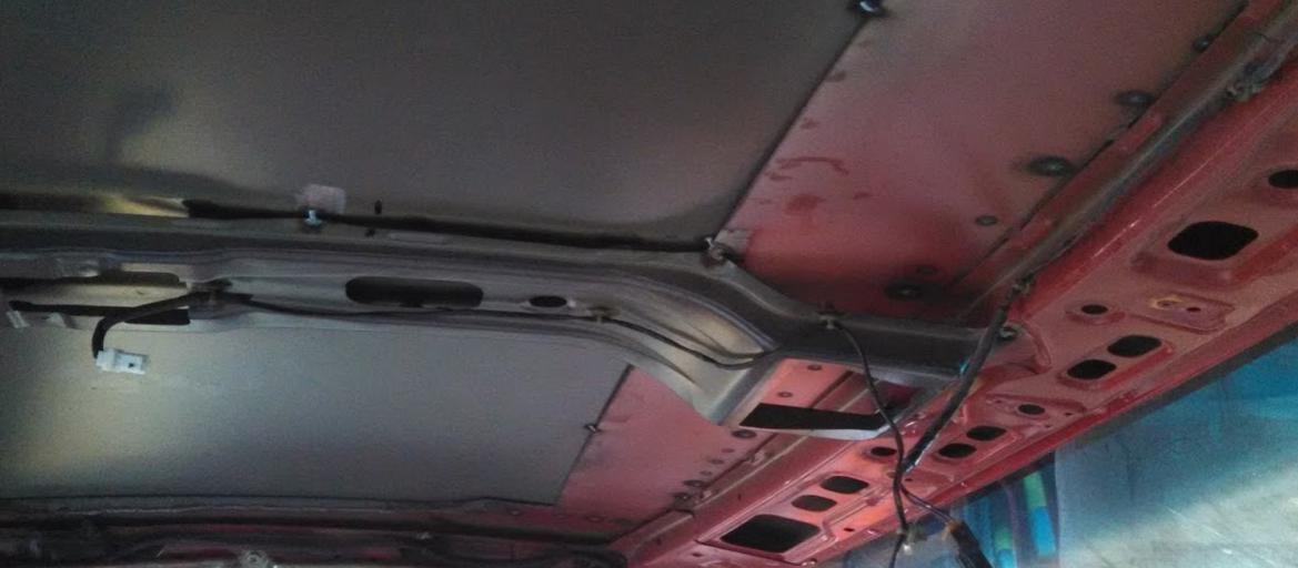

I also welded in the factory bracing so it would work like factory:

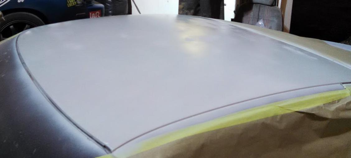

Then it was time for filler..
.. and some primer:

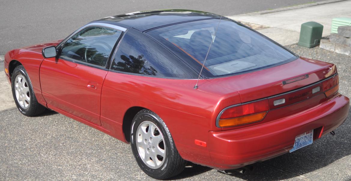

And with the car all together and some Hyundai red paint:
I put in manual belts, bluetooth stereo with mic, Bose stereo system out of a Maxima, etc.. a fairly comfortable street car.

While moving some stuff around.. took a picture of our very cool looking trophies:

Sunday morning we are still wearing Saturday's shoes (Direzza ZII) and haven't touched anything else on the car. It's so nice to not have to mess with the brakes! I start the race in 19th place on a dry track. I'm again frustrated by seemingly every car's ability to disappear from us on the straights, but we can make up enough time in the corners that our lap times are competitive (well, if ~3 seconds off of the fastest lap of the day is competitive). With a very busy track I get us up to 6th place with a fastest of 2:03.5 and turn the car over to my dad.
Dave gets ready to go out on track, and *just* misses getting out before the pace truck and a very slow lap. Oh well, you win some and you lose some. And here we basically just lost a lap. This knocks us all the way back to 25th place. It's a long race.. we can make it up. Dave continues through the dry track, eventually getting us back up to 6th with a fastest lap of 2:06.4.
Nathan Feigion is in the car next, and after a couple days of hard driving on them.. the Direzzas are getting greasy. Nathan is really trying to manage the traction, but these tires are pretty toast. Nathan has made his way all the way up to 2nd place with a 2:01.3, it's looking like we may be able to get another podium! Nathan has caught up quickly to the #3 Rainbow Unicorn E30 BMW, and they recognize us as a faster car. They point Nathan by on the straight.. but stay in the throttle. And they start slowly walking away. We really need some horsepower here! Rainbow Unicorn is now entering the fastest corner of the track (corner 1) while watching his mirrors to see if Nathan is going to come by him. Rainbow Unicorn brakes for the corner and Nathan looks to the inside to pass in the corner, just as Rainbow Unicorn locks up the rear brakes and spins directly in front of Nathan!

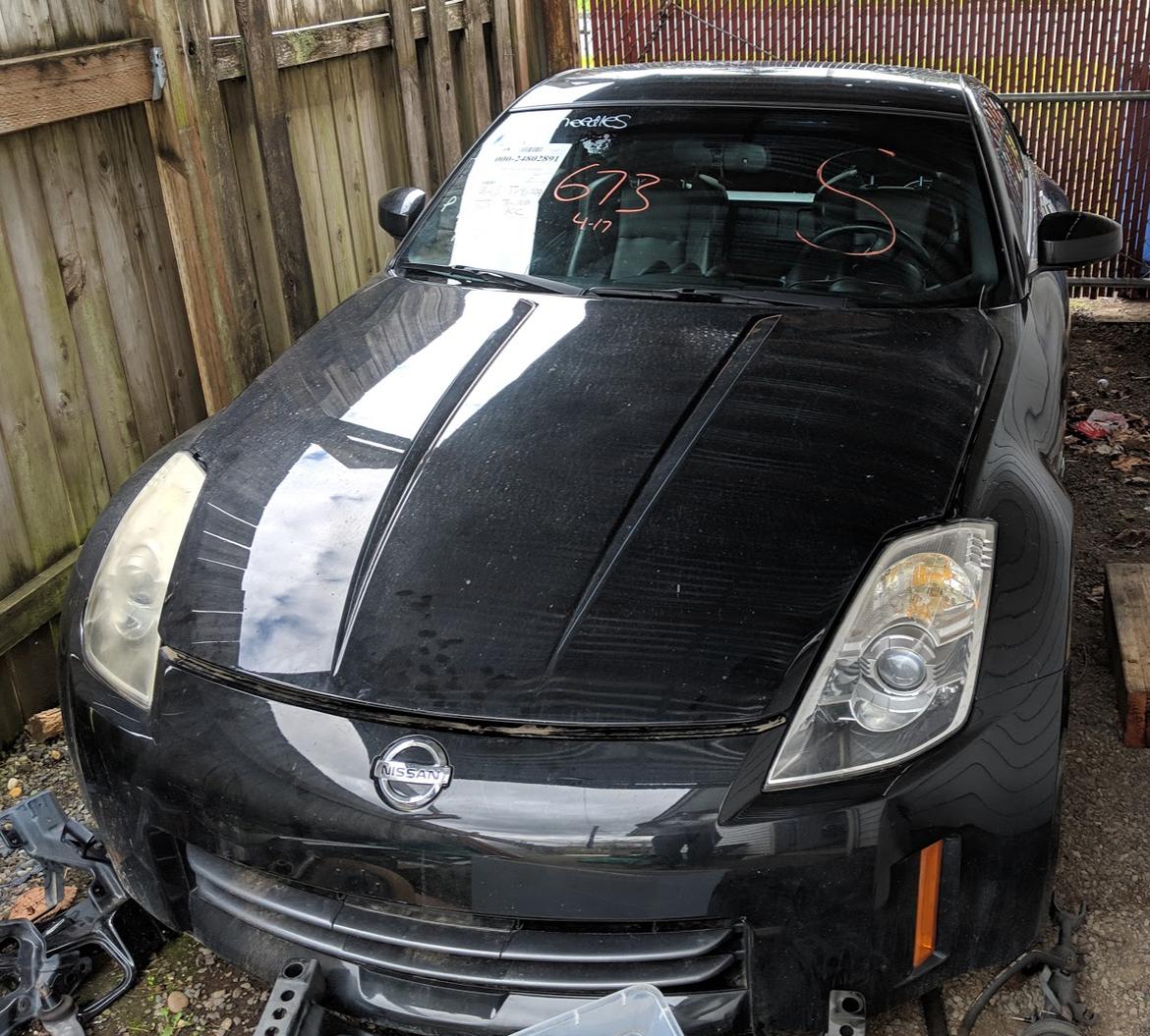

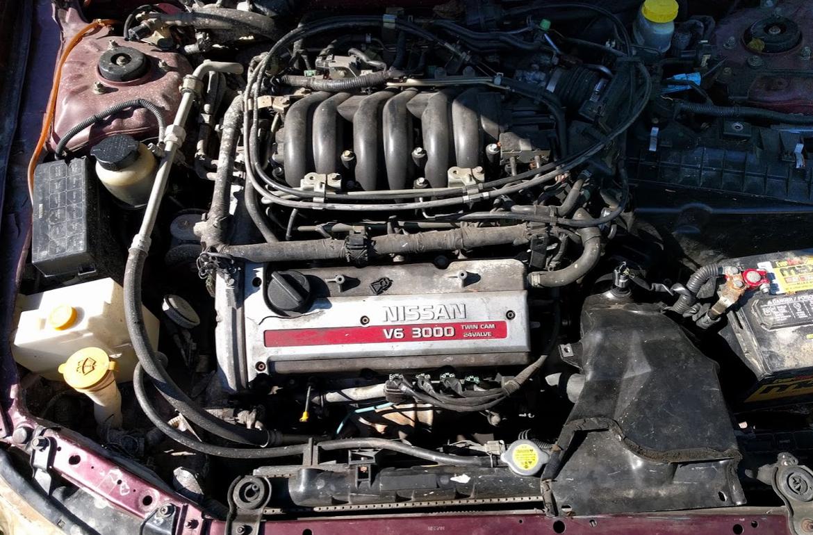

After some deliberation, we decided the best option was to go for the VQ30DE from the Maxima. It's a newer design engine compared to the KA24DE, makes just enough horsepower we don't get into big penalty lap issues, yet should still give us a big enough gain to be worth it. A good VQ30DE should make 190-200whp, and the average KA24DE makes 120-125whp so we were looking at nearly a 75 horse gain. That should keep those BMWs in range!

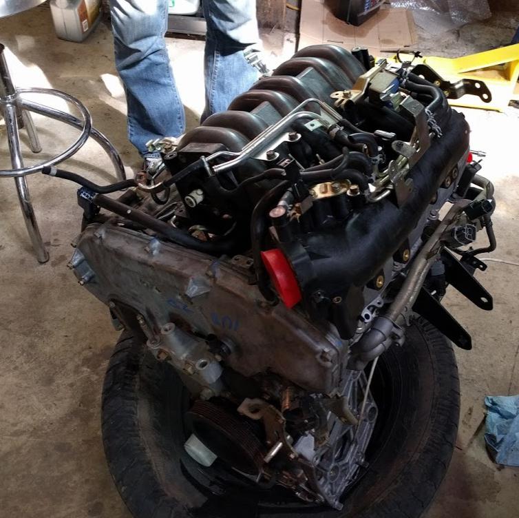

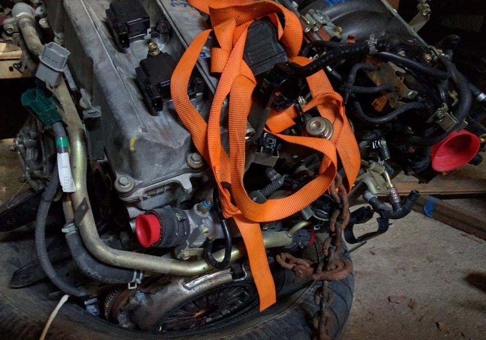

The first step, was to find as complete of an engine as we could. Piecing things together gets expensive fast. We started looking for donor cars, and stumbled on a great find. We picked up this 2001 Maxima for $100. It started and ran, but sounded a little rattly in the midrange (potential bearing issue). However it had the ecu, wiring, key, gauge cluster.. all the things we needed to make an engine run.

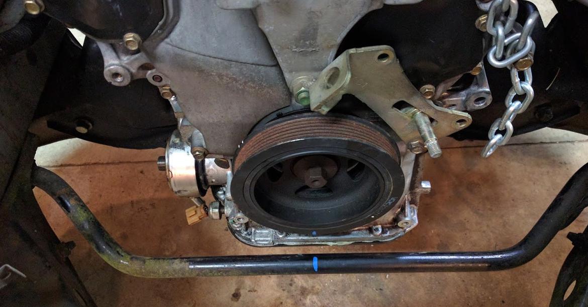

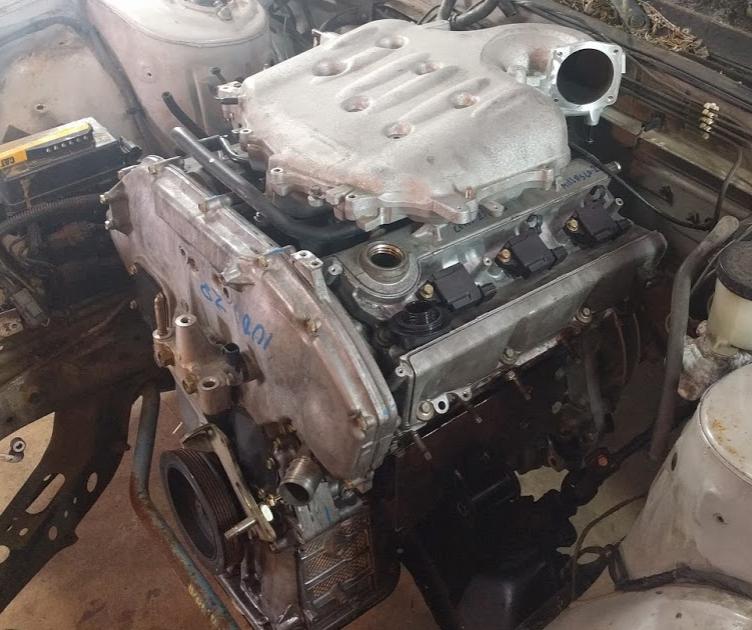

Turning the engine sideways meant turning it into a baby 350Z engine. We picked up the transmission (most expensive part of the swap at $675), 350Z exhaust manifolds ($40), and a 350Z oil pan ($100)/starter ($50) for the purpose of turning the front-wheel drive engine to rear-drive. One question we had during this project was, "Would it sound like a Maxima or a 350Z?" It was basically going to be a 3 liter 350Z engine, but is it the exhaust manifolds that give the Z it's distinct sound? Or the variable cam timing that we wouldn't have?

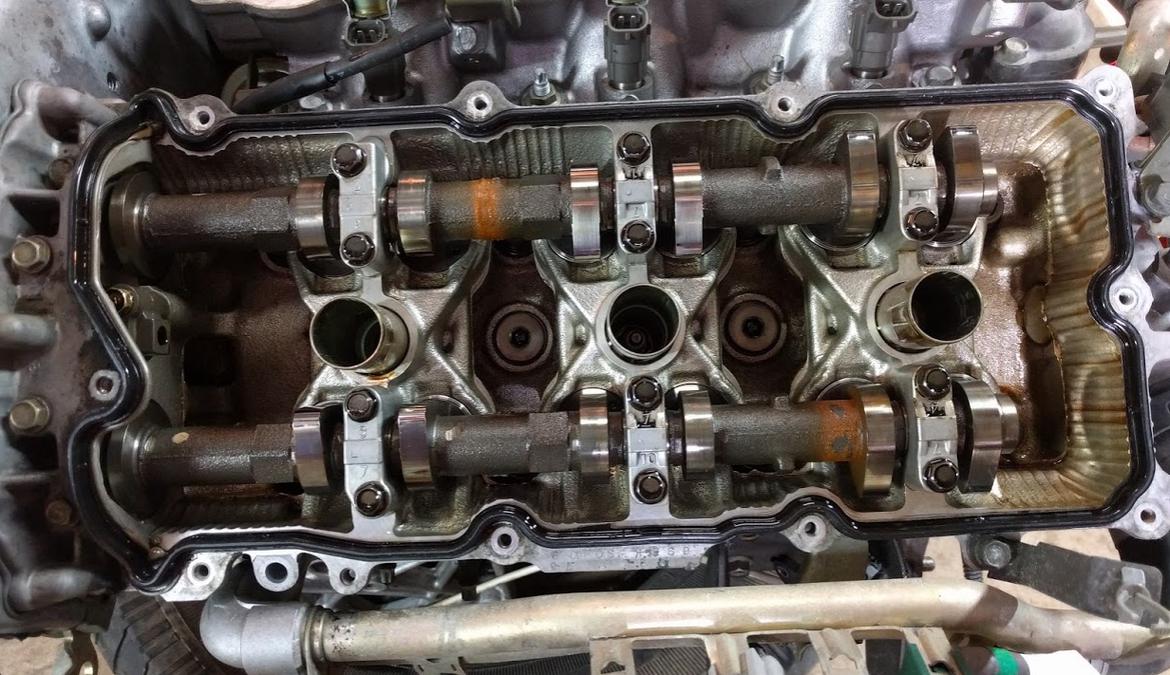

Our low-mileage junkyard engine looked nice and clean inside:

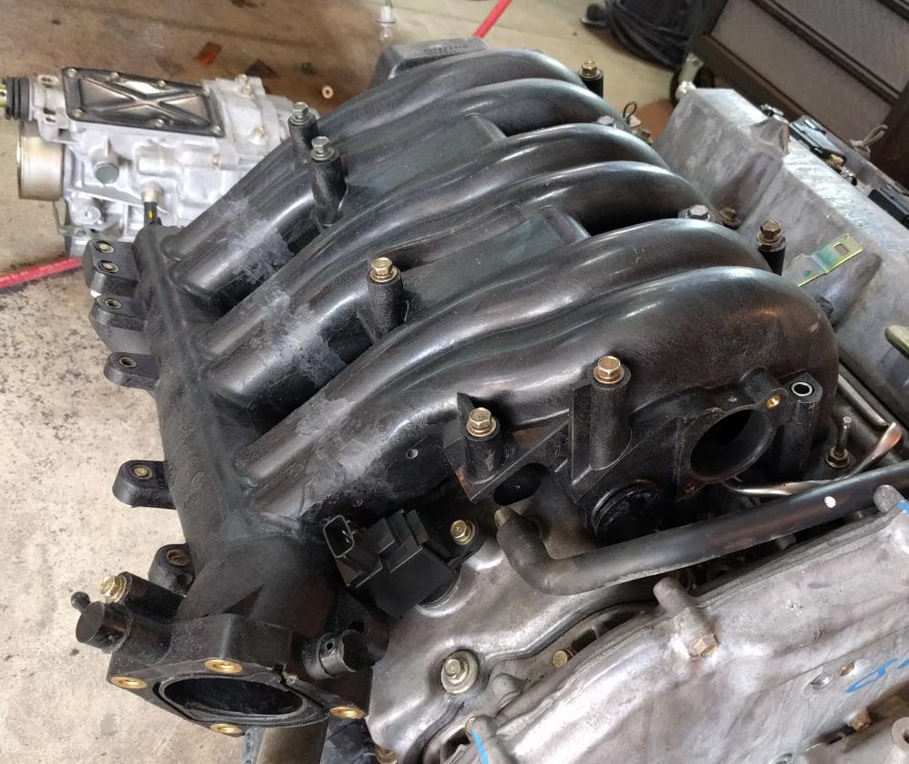

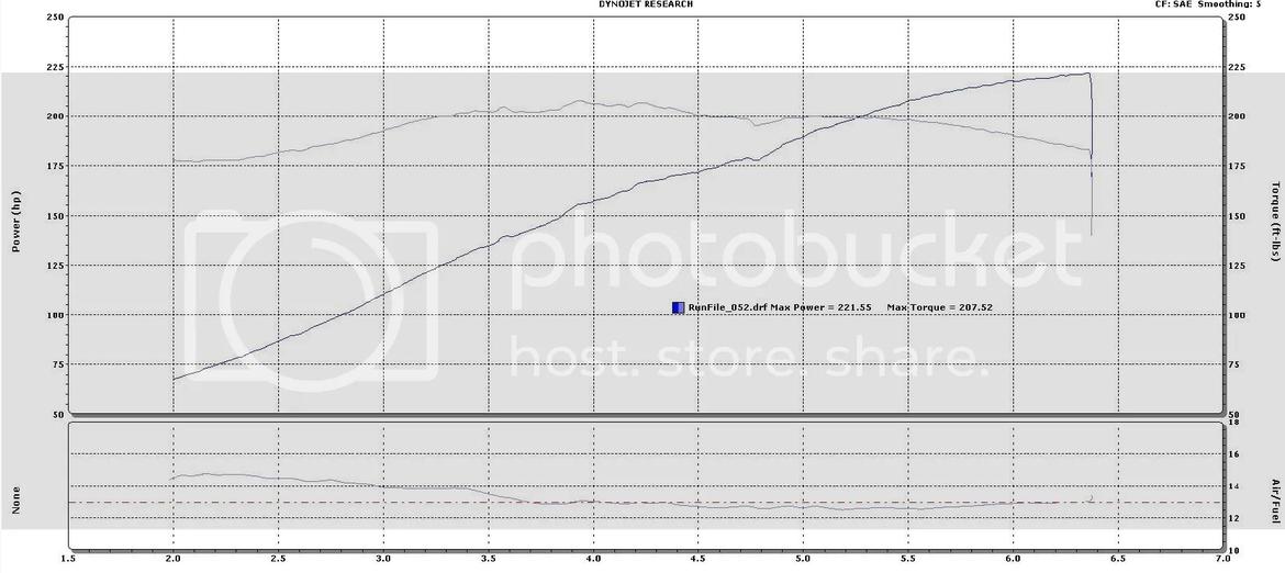

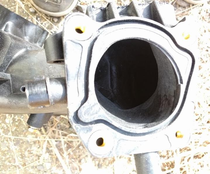

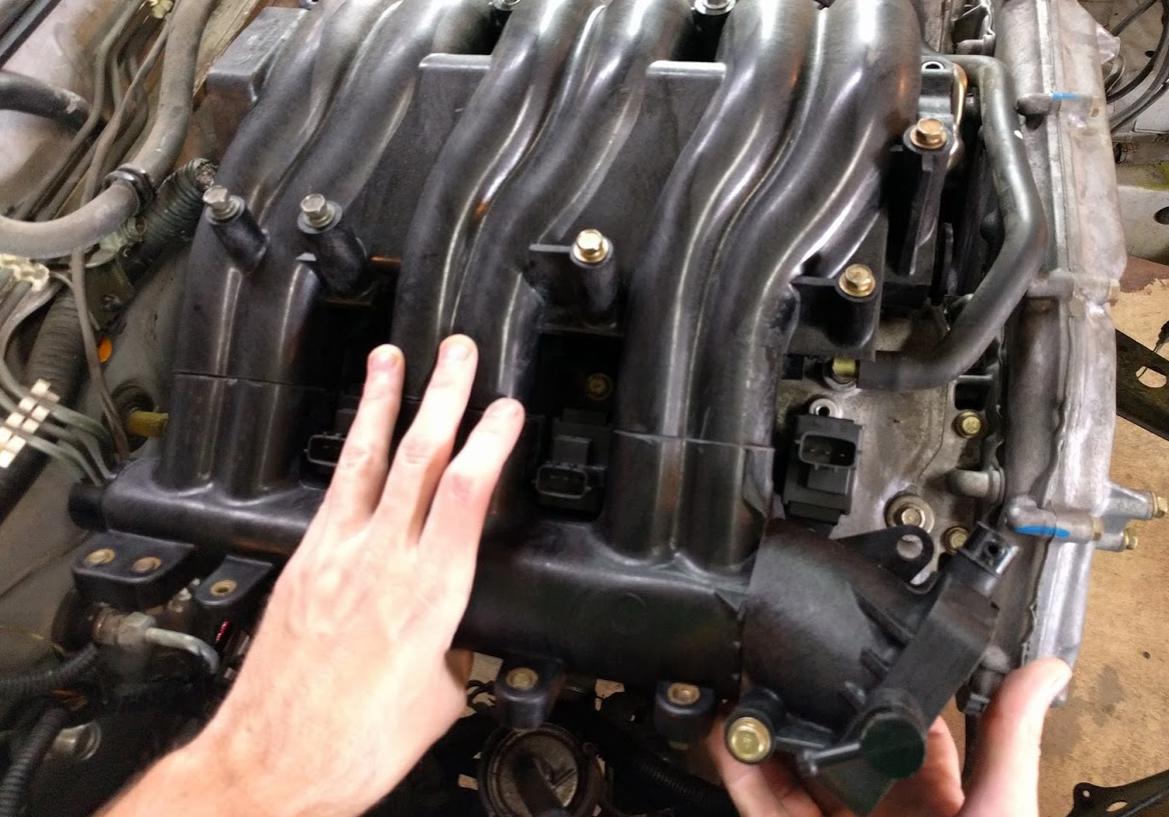

One of the first obvious issues we would run into, was the intake manifold. Rotating the engine to RWD would put the throttle in the firewall. We played with the idea of flipping the entire manifold 180 degrees, but the one valve cover is shorter than the other and this just wouldn't fit.
This plastic manifold is the main reason why this engine makes 222hp and the older model made 190hp, so I want to use it. It has a very trick variable length runner design. Nissan calls it VIAS, Variable Induction Air Control System. Basically it's a short runner/long runner setup, and the short runners are normally blocked off until around 5200 rpm. This way the engine can make good torque as well as good top end power.
The "power valve":
My idea for getting everything to fit... was to cut everything up, flipping some things around.. and fitting it all back up again.

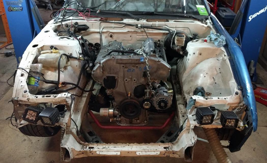

At the same time we got to work trying to mock up the engine/transmission in a donor chassis. Since Blue Bayou was working, we didn't want to touch it until we had some of these details worked out in case we didn't get this done before we wanted to race. The first things we discovered, was that the sway bar and steering shaft would both be tight:

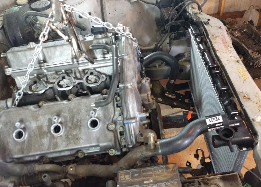

We also needed the coolant hoses to be at the front of the engine, so we picked up a Pathfinder coolant piece. It has a thermostat for the block, something the Maxima also had.

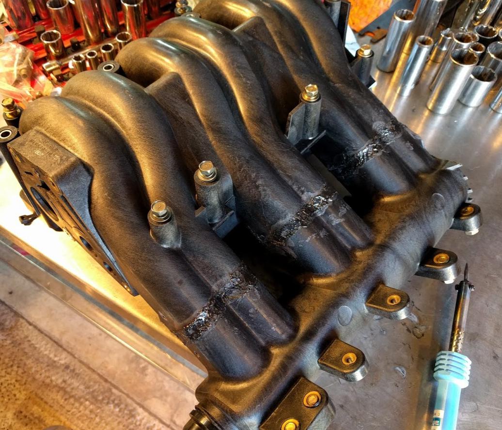

I beveled the edges of the manifold (fiber-filled Dupont 66 nylon) and made some brackets to hold it together.
Then my first pass was just with a soldering gun, melting the two together.
Then I started laying in some filler material, and as luck would have it, the Harbor Freight zip ties I bought were made of Dupont 66 nylon as well.
With a little porting, I actually had a straighter shot into the manifold than the factory setup had.
After getting it together and cleaned up, I was really happy with how it was looking:

For the back of the engine we were going to run the Maxima flywheel, since it has a unique pattern that is different from the 350Z flyweel. However the 350Z flywheel/clutch is significantly thicker than the Maxima setup, so we spaced the flywheel out by putting the automatic flexplate spacer behind the flywheel (~1/8" thick).
This also meant the starter moves in relation to the flywheel, along with the fact that the 350Z and Maxima flywheels are slightly different diameter. We found the perfect mesh for the starter gear, and found where that needed to be spaced and positioned. We then greased the starter and filled the area in with JB Weld so that the position would be repeatable and then popped the starter back out.
We also needed to space the throwout bearing closer to the clutch by around a half inch, so we lathed up a spacer and extended the throwout bearing holder:

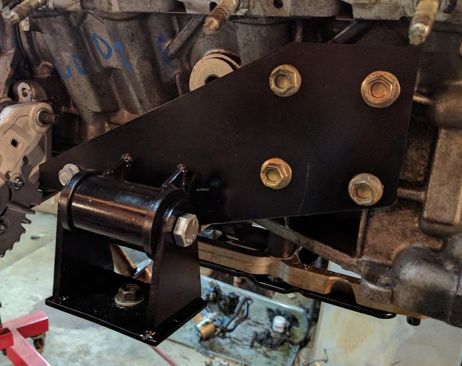

For motor mounts we bought a generic LS1 mount kit, then hacked them up. Since the engine is normally front-wheel drive, the plates to bolt to the engine were very different.
After a little optimizing/painting:

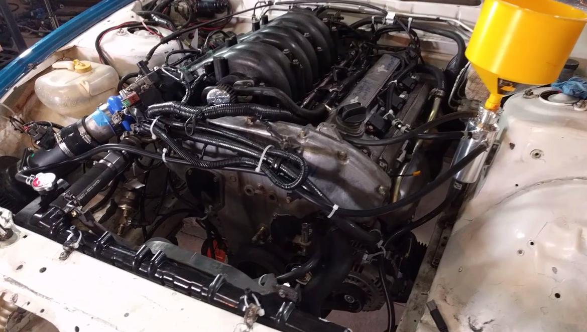

This is what it looked like when we were bleeding the coolant:

We hadn't raced in a year, and showed up to tech on Friday. Even though we are bringing a little more firepower, we start thinking that maybe we brought a knife to a gunfight. In addition to the usual suspects, there are some very rowdy sounding cars. There is a Corvette with the 1994 ZR1 OHV engine and various other cammed V8s that make us real nervous.
While waiting in line for tech, I am by myself while Nathan and Dave are doing the gear check. I need to move the car forward, and now the car which had started faithfully since the first try was not wanting to start. The car would crank, but just wouldn't fire.
By now a few people from other teams start taunting: "What a pile! Failed in the tech line, one less car to beat tomorrow! Hahaha!" I don't say anything.. but they are really ticking me off. It's bad enough to put that many hours into the car and have it start failing. I'm thinking, "Oh you just wait for tomorrow." I finally get the car to fire and make it through tech. I try to look into why the car hadn't started and find a failed code for the anti-theft system. I clear the code but I'm not able to find any smoking guns as to why it had happened. The wiring all seems OK as well as the key is ziptied directly touching the antenna. Well, hopefully it holds up.. it's been working fine.

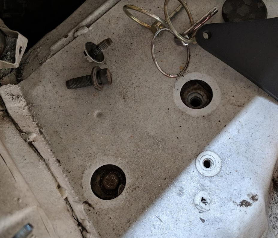

I decided to try mount to the chassis, and the logical point was through the bolts in the rear frame rails that hold the rear bumper.
I took the aluminum bumper from our engine donor Maxima and hacked it in half to use as the vertical supports. Then I made some steel plates that would pass through the trunk. To try get some clean air, we mounted the wing about the same height as the roof.
While this isn't all bolted together, you can see the bracket going down into the frame rail as well as the small bracket going back to the tail light area.
